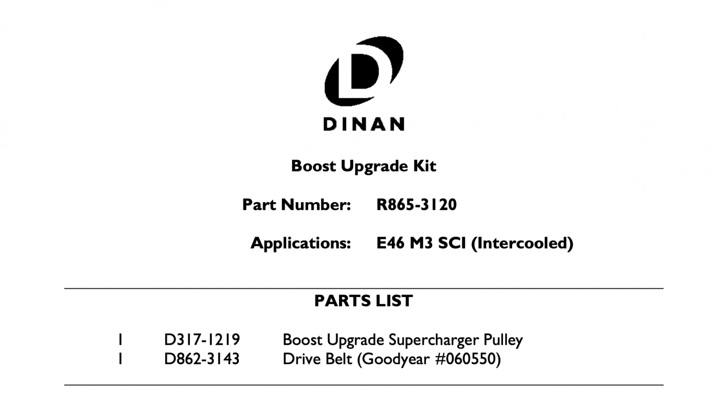

                    Does anyone have the Dinan "Boost Upgrade Kit" for this setup? Or know what the pulley diameter is?
Name:	Screenshot 2024-02-15 at 8.21.52 PM.png
                      I think that kit is to go from non-intercooled to intercooled.
                      I'm not aware of Dinan offering any boost upgrades for the S3-R.
                      If I remember correctly, stock is 4.1"
                      2004 Dinan S3-R M3
                      2023 X3M Competition
                        Thanks for the reply. That is interesting, but which one is 4.1 (Intercooled or non), and what is the other size?
                          S3-R is intercooled, S3 is non-intercooled.
                          IDK what size pulley the S3 uses. There's some other S3-Rs on the forum, but IDK of anyone that has a regular S3.
