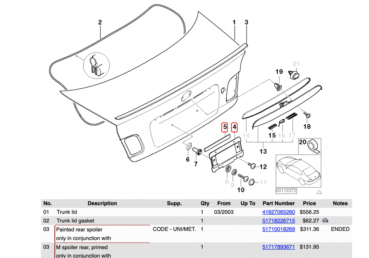

                What are you all doing for the license plate.
                I know we need to drill the holes, is this best done prior to paint, after paint . . . what size.
                i think i found some info to that last idea on REALOEm. . . with the license plate base, that will be attached to truck via "plug in nut"

                  You want to mount and fit the trunk to the car before paint - as well as doing any drilling required. Karbonius' mold is pretty damn good and fitment is tip top - but as with anything related to aftermarket body panels and an aging chassis that may have previously been messed with, there might be adjustments needed.

                    Drill before paint so paint can clean up any mess or errors.
