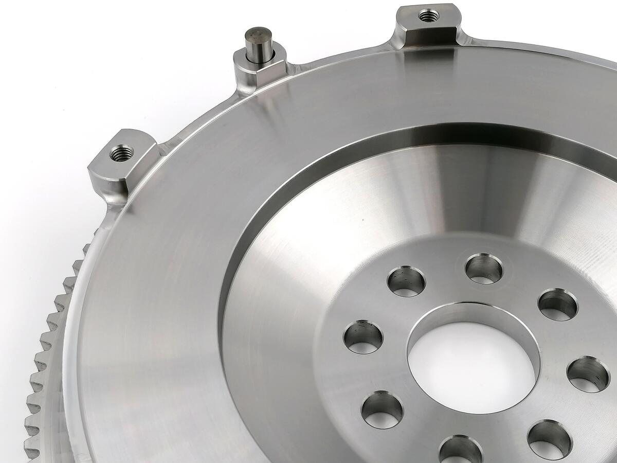

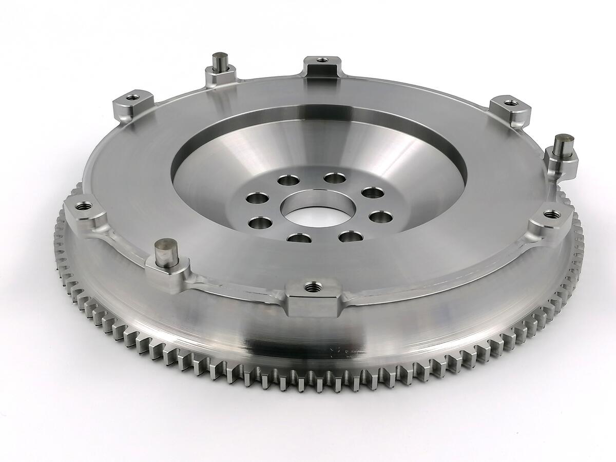

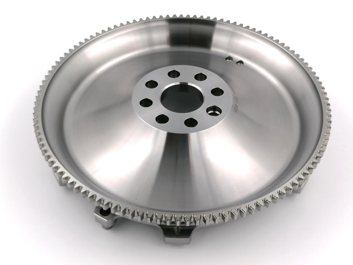

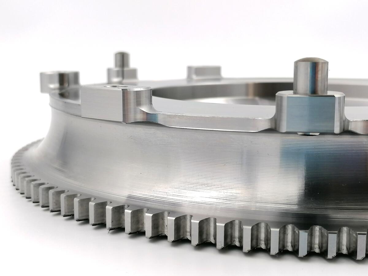

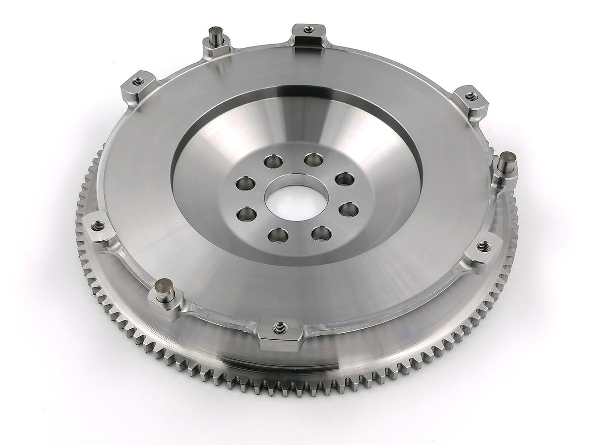

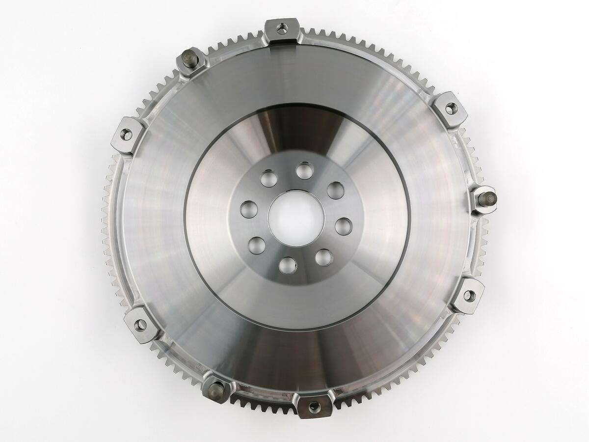

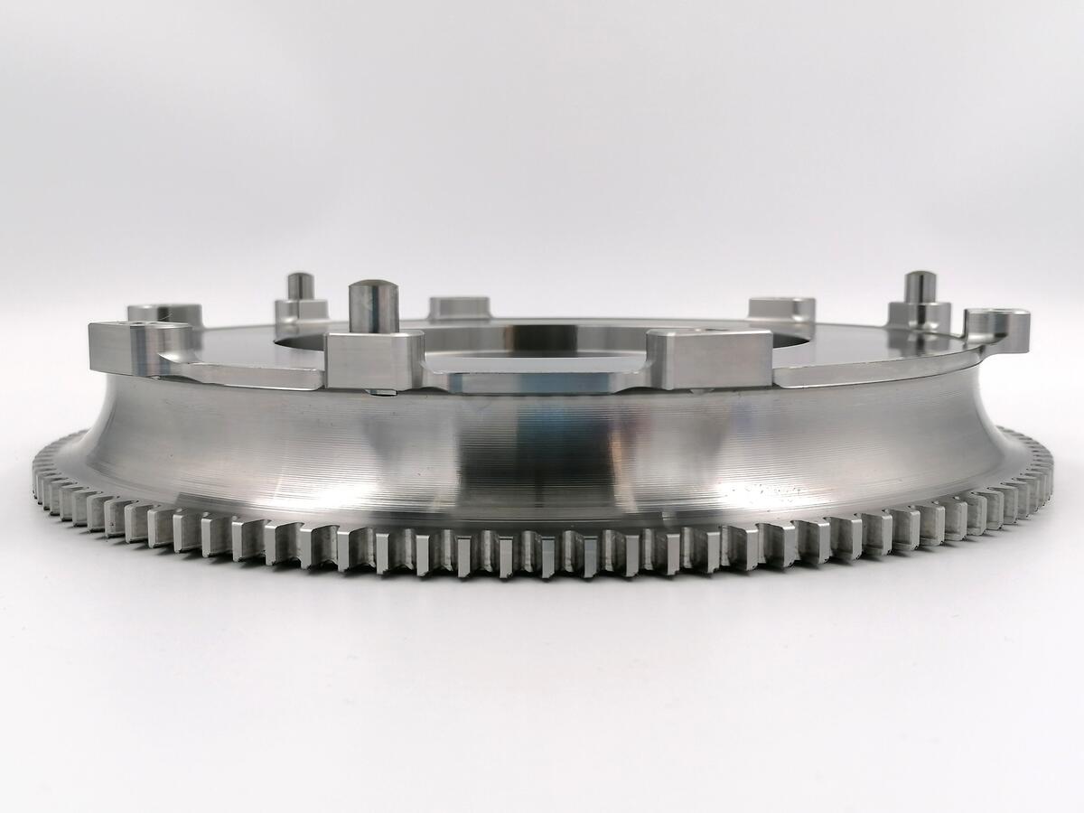

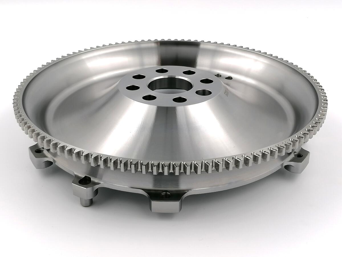

    I'm thinking this may be of interest for some of you.
    In the Fall of 2020, I organized a 20 set group buy for the E9X M3 TTV lightweight flywheel. It filled out rapidly. I run their DCT product.
    Ben @ TTV was impressed by the rapid support of the community. I have since been working with Ben to expand the product line to all other BMW M chassis in North America, Asia, Australia and the Middle East.
    This is their S54 Supalite flywheel. It weights 5.3 kg. The stock unit is 10.9kg. Great efficiency gains. These usually retail for 799 US, but I've been working Ben via the Connex for us at 600 US shipped. Could even be lower with 10x units.
    From my quick research into S54 flywheels, it seems there are many aluminum alternatives.
    What is you guys view on these?
    Link for more info: https://euroconnex.co/collections/e4...eight-flywheel

                            Here’s an excerpt from discussions with Ben @ TTV:
                            Aluminium is 1/3rd the weight of steel but its also 1/3rd the strength, as such, you need 3 times as much of it.
                            Having 2 different materials bolted together is not ideal when the parts warm up and start to expand as the expansion rates are different putting components under stress, this is more important when you consider the starter ring gear is steel. Failure here could be catastrophic.
                            Motorsport teams will not use aluminium flywheels due to their inherent reliability risks, the steel used for the friction faces tend to be of lower quality and wear out quickly when used with modern drivetrain friction materials.
