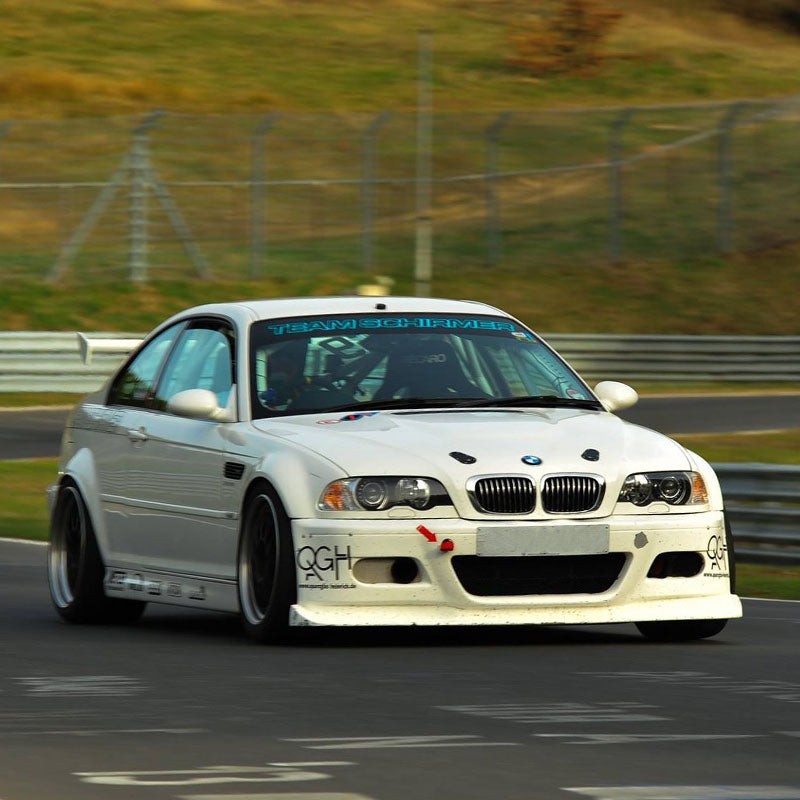

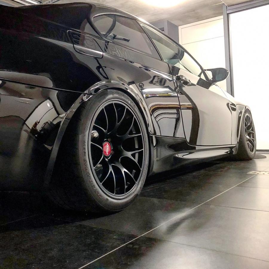

            If you look closely at all Schirmer builds, the fenders have been pulled. I struggled to fit my 9.5/10.5 ET22 E88's on my M3, I have no idea how people fit these Schirmer spec wheels without fender modifications.
            EDIT: Schirmer states on they're website: "Fender adjustments will be necessary."
            The Schirmer further development of the classic racing rim BBS E88 for BMW E90 E92 F80 F82 F87 M2 M3 M4! Available in 18 inch in 3-piece drop center version only. The rim stars are made from a high-strength aluminum forging blank. For optimal weight, the spokes are back milled to the classic design and then CNC drilled
            So yes, you will 100% need to modify your fenders to fit these wheel specs.
