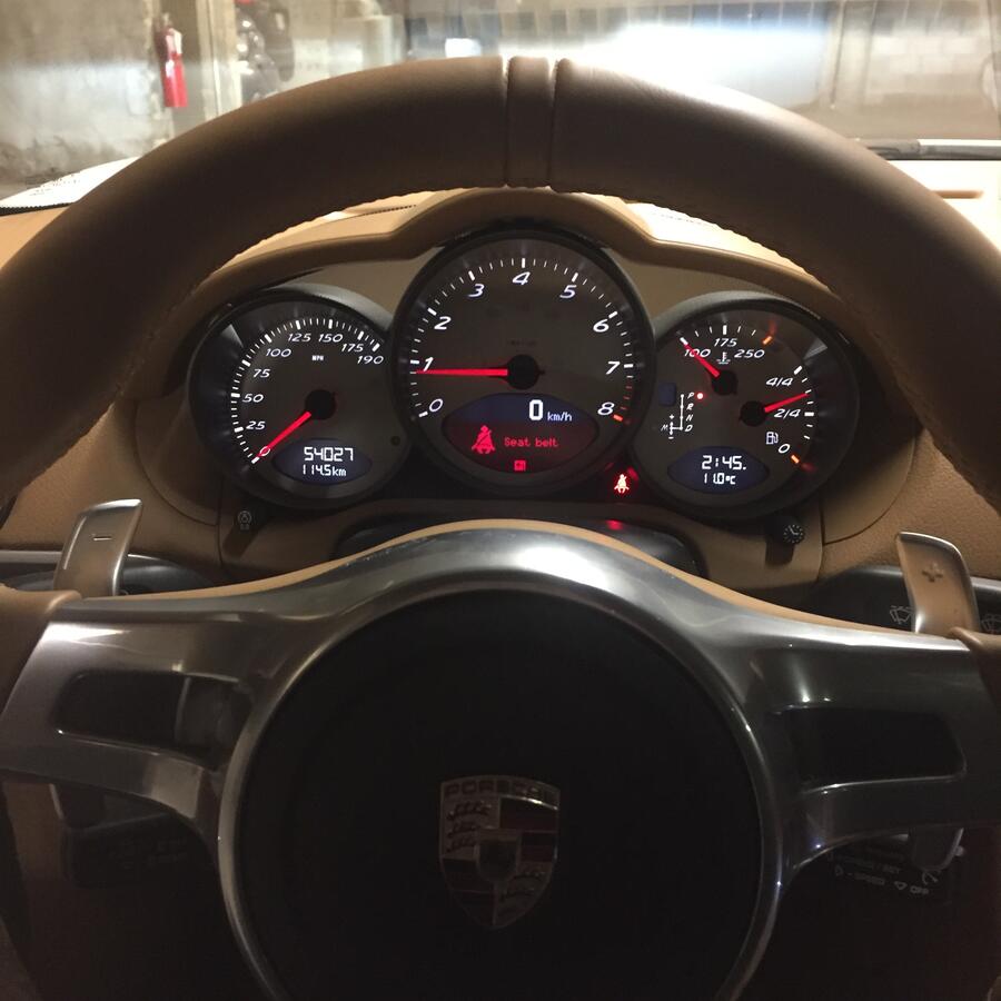

        I'm seeing this as a driving focused car - I'd run a no button steering if I could ala Porsche Cayman if I could! I miss that feeling.
        Pic from my old 987.2S
        Click image for larger version  Name:	6B0BB2AB-D558-4223-A439-A21E6B23791A.jpeg Views:	0 Size:	64.7 KB ID:	136095
