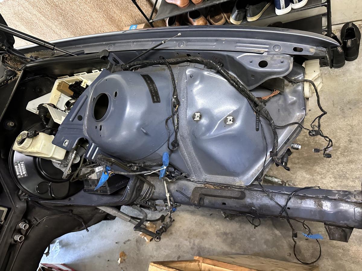

                  Started working on something yesterday that I haven't been looking forward to. When I did the MK60 swap, I bought a new firewall drug bin grommet, since the MK20 plug got pulled into the interior. Unfortunately there's a harness that runs through this grommet and the only way to get the new one in is to disconnect the harness from everything in the engine bay and feed each plug in one by one.
                  Hole left from cutting the original grommet and feeding MK20 connector through. Pretty big water ingress risk:

                  You can see the remaining harness that still runs through the grommet in that pic. Worked away for a couple hours and disconnected everything it went to, which was a lot of things. Even had to remove the passenger wheel well liner to get to one of the plugs. Here's the entire thing laid out:

                  Next step is to disassemble the interior and get the grommet out. Then I can feed the harness through the new one. I plan on rewrapping the entire thing in new tape, since it's 20 years old and super crumbly. Thought about using tesa tape, but then it wouldn't match the other side, so hopefully 3M super 33 will hold up to the conditions in the engine bay.
                  On the bright side, I now have access to a lot of engine bay spots that are very dirty and were pretty much impossible to clean with the harness in place. Will get all of that looking good before reinstalling.

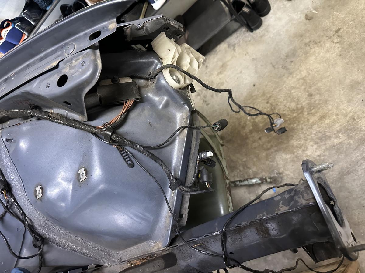

                                I’d say drivers side is easier. One exception being the fog light harness. Wait, m3 has a different front harness. There is a large connector that unplugs and allows the harness to be separated from left to right if memory serves.
                                Pics are of the 330i with an extension to the coolant reservoir plug.
