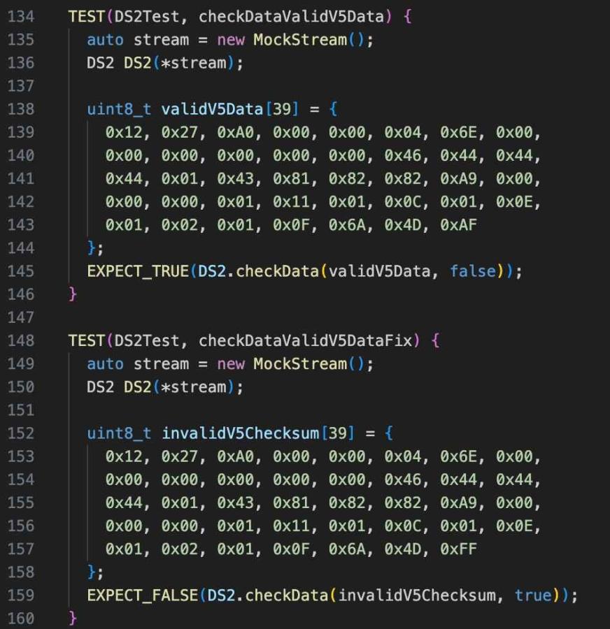

        First thing I did was build the DS2 library as a standalone to unit test it. Fed the tests some real data coming out of my DME and fortunately the logic in that library seems good. Test code snippet:

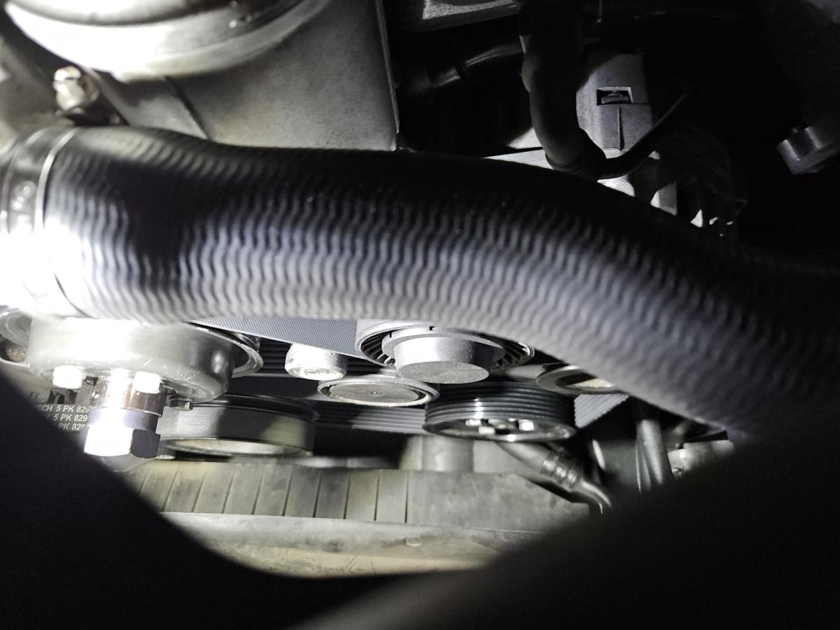

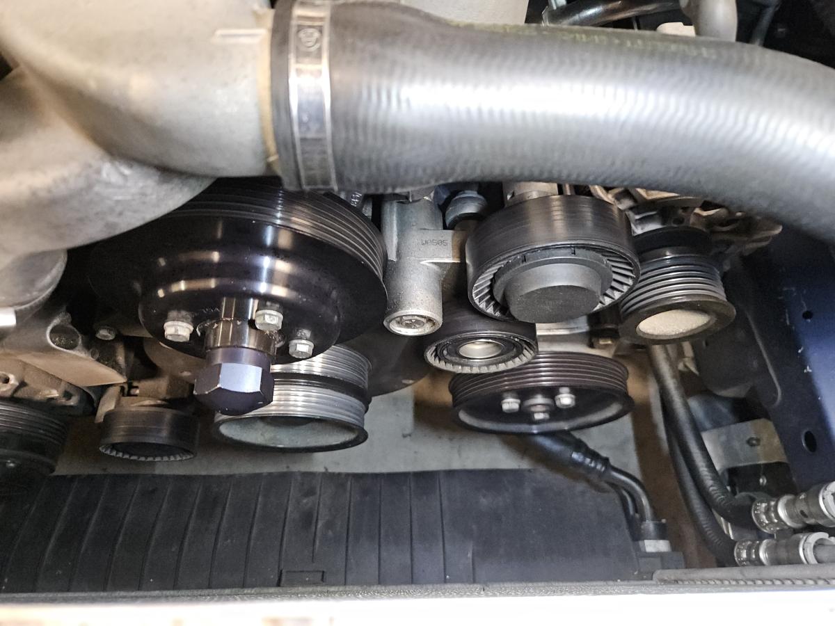

        Decided I didn't want the cooling efficiency tradeoff of the Rogue power pulleys anymore, so swapped them out for stock. Old stock PS pulley was cracked, so brand new one is in. Don't want to think about what that part is gonna cost in a few years.
        Power pulleys:
        Back to stock:
        Didn't order new idler pulleys because the ones on the car are fairly new, but of course I found them both to be bad with the belt off. It's crazy how little these things have lasted. Think I've gone through four sets since I bought the car? Oh well, new ones ordered.

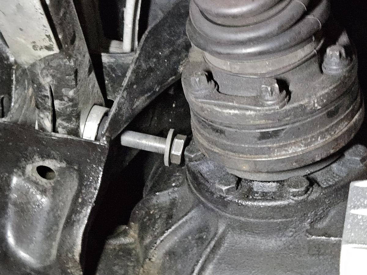

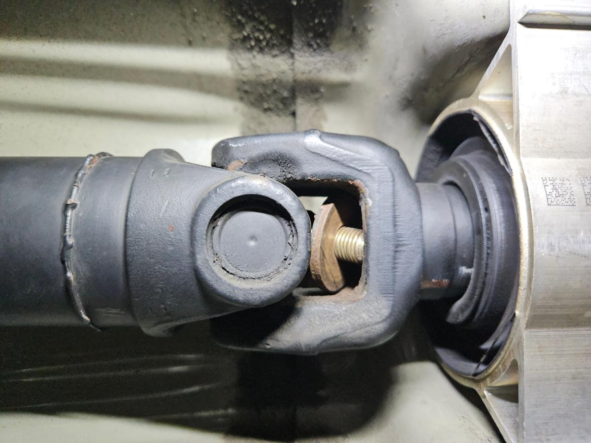

        And then on the way back home I heard the dreaded failed CSB rumble under load. Incredible timing with a track day less than a week away. Parked in the garage and immediately took things apart. Interestingly, I found the CSB in great shape. However, the real failure more was way, WAY scarier:
        I have no idea how this happened. I always torque this bolt with the driveshaft in the car, so that I can get as much torque on it as possible. Maybe another case of the track rattling things apart?
        Fortunately, both the bolt and the threads in the driveshaft were perfectly fine, so I poured two gallons of threadlocker on the bolt and did the double wrench thing to torque it to 750,000 lb-ft. Hopefully this doesn't come undone again.
        Perhaps unsurprisingly, torquing this bolt back up cured about 95% of my drivetrain clunk. It's crazy how much quieter the car is now. I thought it had been extra noisy recently... Will keep an ear out for similar noises in the future.

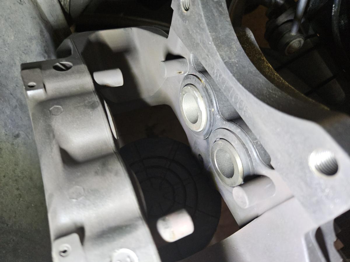

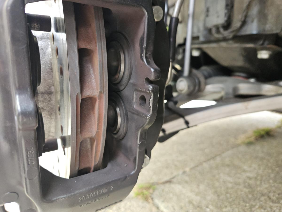

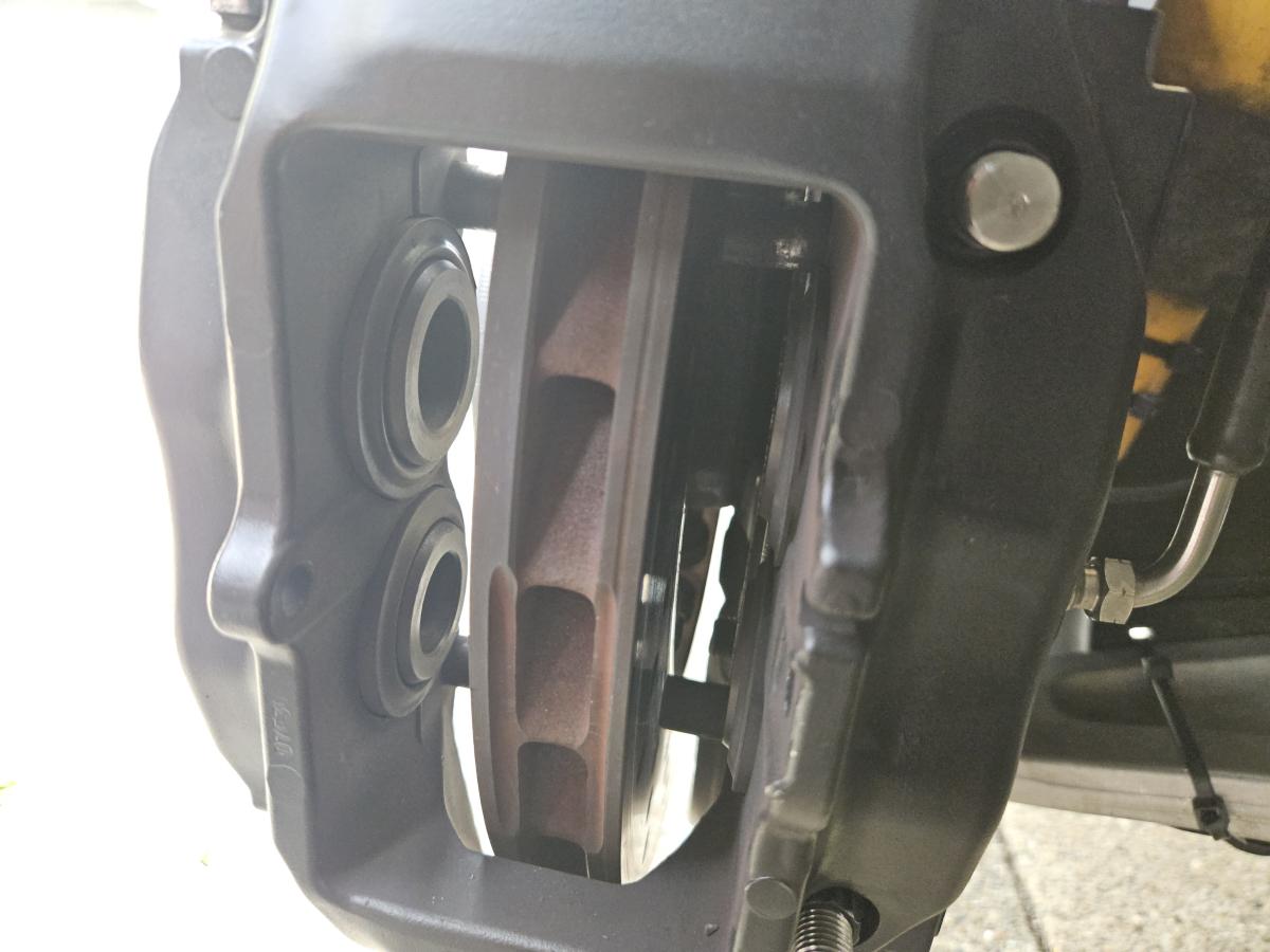

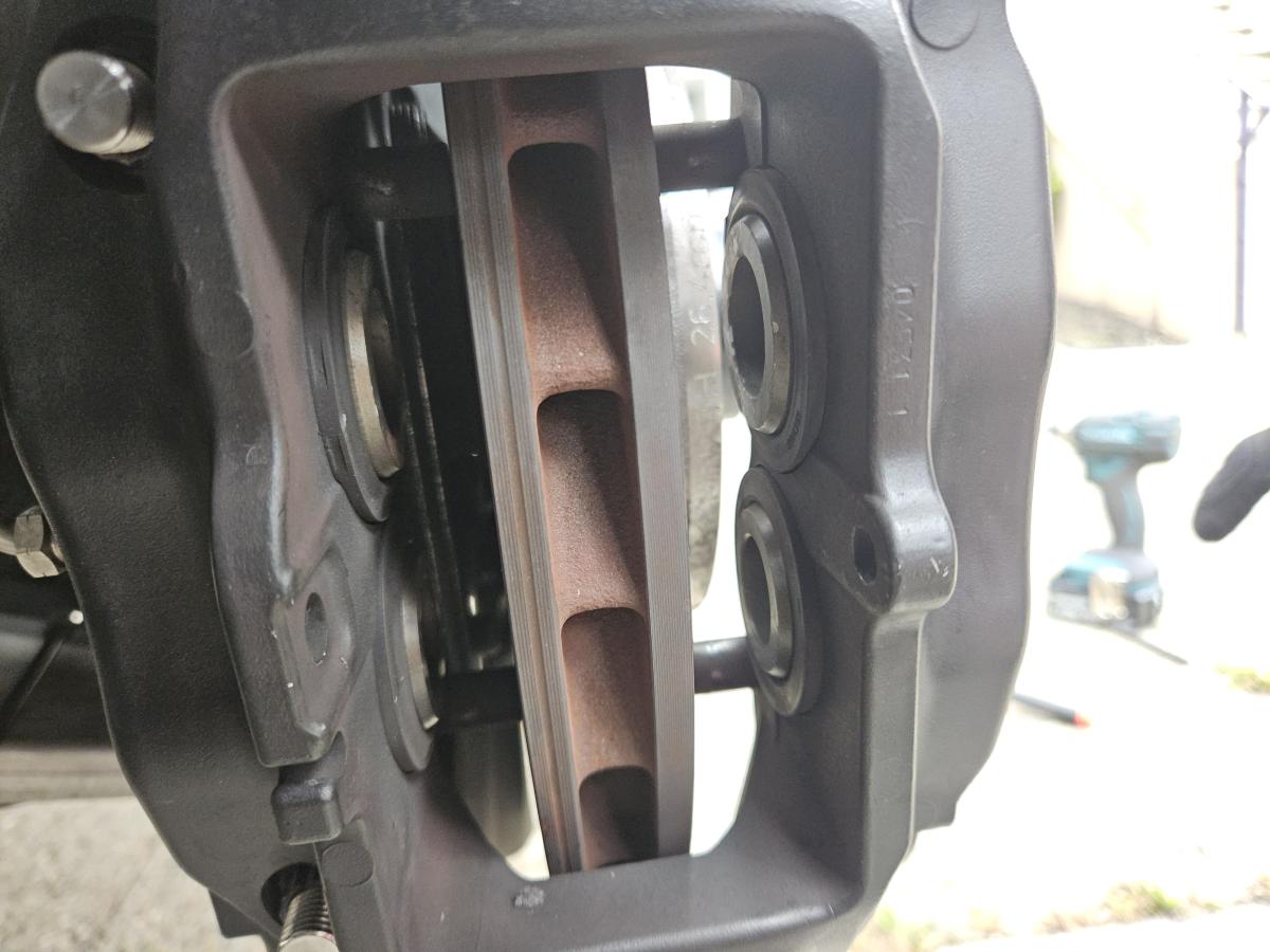

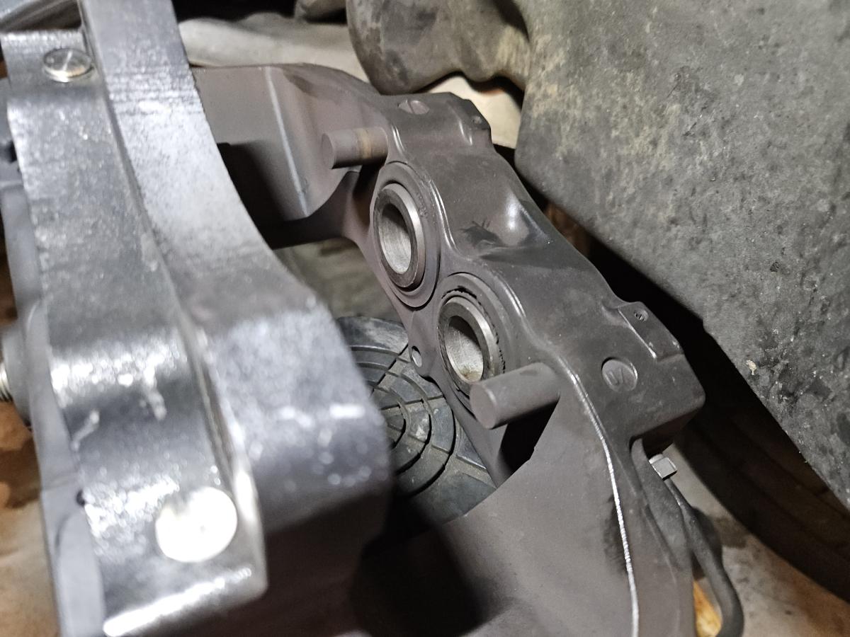

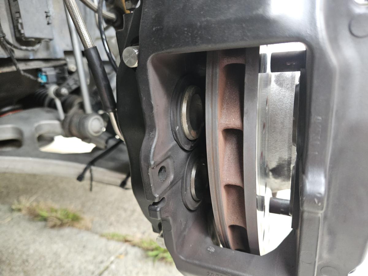

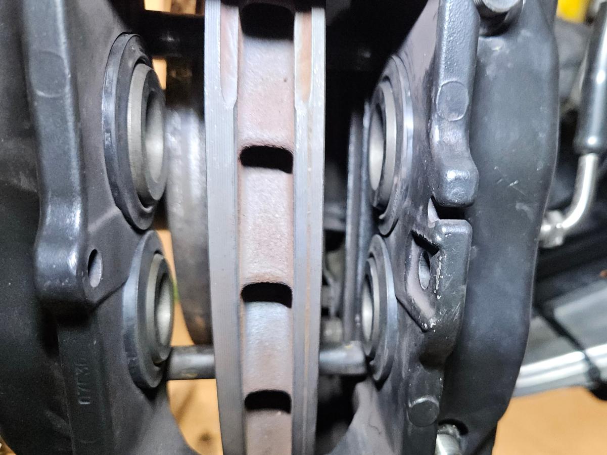

        And lastly, here's a photo dump of the dust boots on my front calipers. Want to run an experiment with the scoops, so swapped some fresh GiroDisc boots in.
        Old GiroDisc on FL caliper:

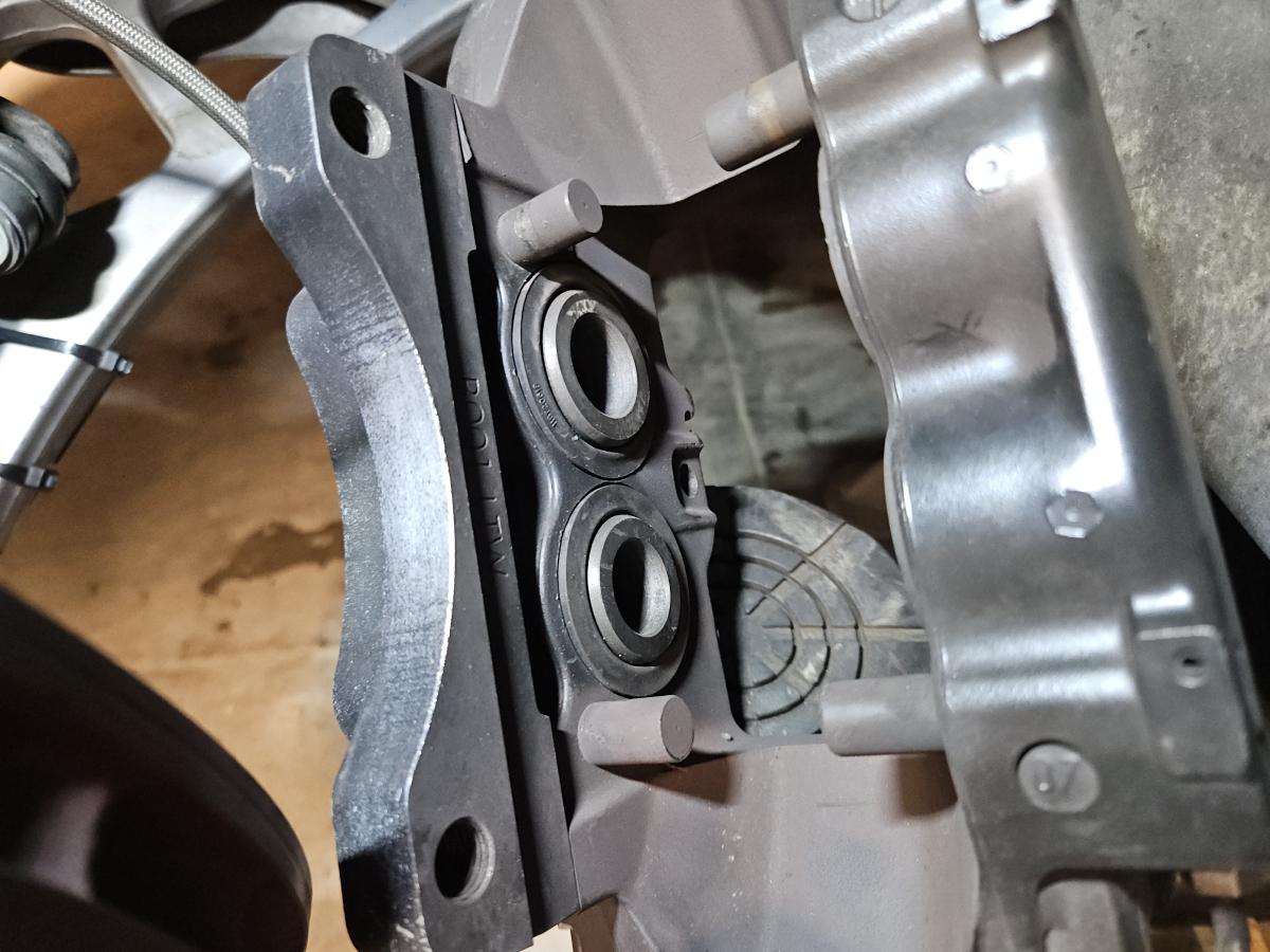

        Old GiroDisc on FR caliper:

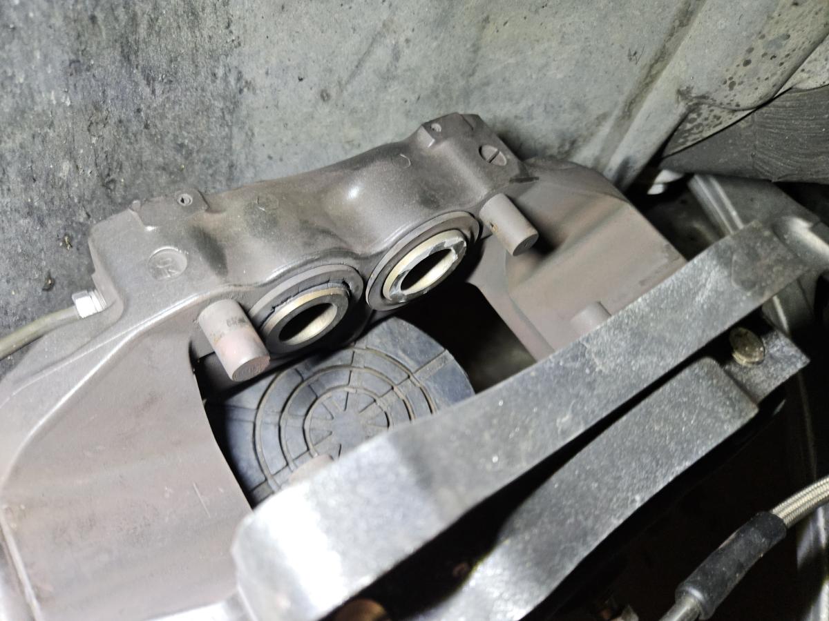

        New GiroDisc on FL caliper:
        New GiroDisc on FR caliper:
        Interestingly, the rear caliper boots are still the stock Porsche/Brembo ones and those are showing absolutely no signs of failure

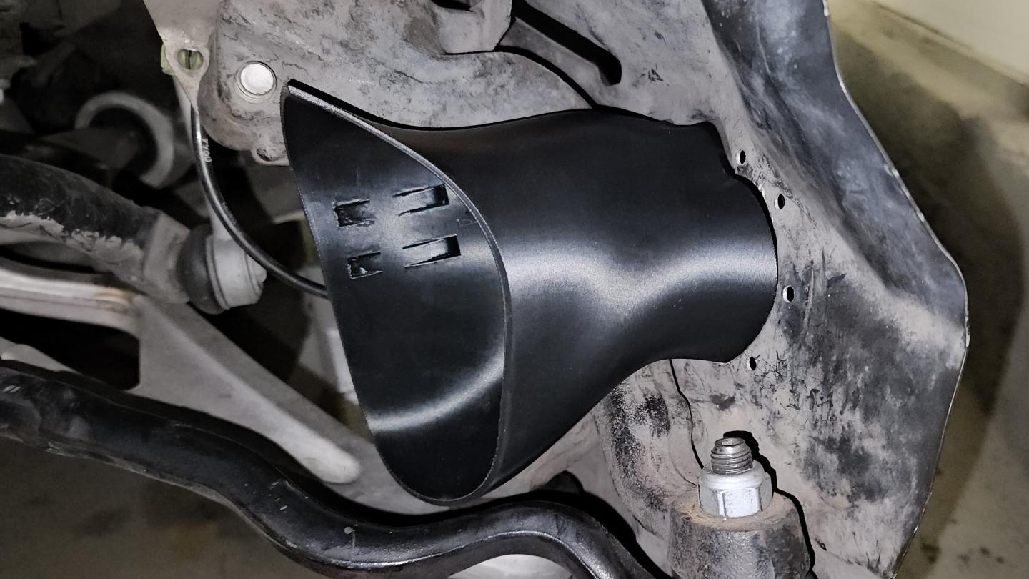

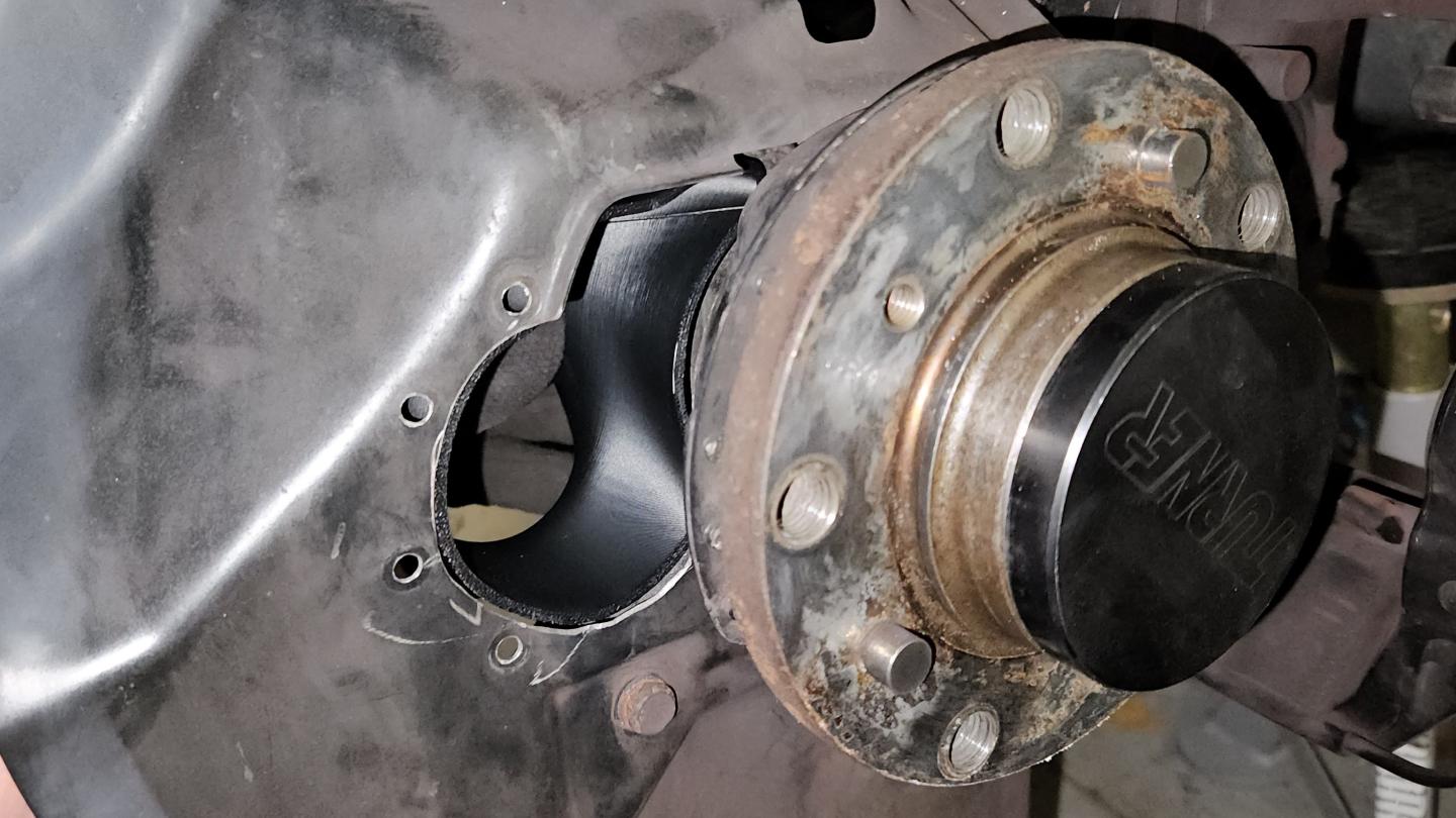

          Alright, time for a bit of science. Did some testing to qualify whether the brake scoops help the dust boot problem at the latest track day.
          This whole experiment is based on the assumption that my driving is consistent enough to draw somewhat reliable conclusions from. Thunderhill 3mi is definitely the track that I know the best, so I don't see much of an issue with consistency. Also, the two track days I'm comparing did happen at different times of the year, but the day with scoops was MUCH hotter, so the scoops needed to be extra efficient to make a difference. Here's a quick overview of the experiment design:
          No scoops track day:
          - Mar 2024
          - Thunderhill 3mi bypass configuration
          - 3.5 hrs of track time
          - Ambient temp: ~15 C
          - Cloudy skies
          - ~2:05 min/lap
          - More pad life
          Scoops track day:
          - Sep 2024
          - Ambient temp: ~35 C
          - Sunny skies
          - ~2:05 min/lap
          - Less pad life
          Car setup (same both days):
          - ~3200 lbs
          - ~315 whp
          - MK60
          - RBF600 (purposefully did not flush fluid so that the only potential difference would be worse thermal capacity on the scoops day)
          - Bridgestone Potenza RE-71RS
          - Cerakoted 996 calipers (finish supposedly helps dissipate heat)
          - Girodisc titanium pad shims
          - Brand new girodisc dust boots installed before each day
          - Same PFC08 pads front + rear (as in the same exact parts, not just the same compound)
          The experimental results are meant to be qualitative and not quantitative. Basically just trying to see if having the scoops makes the dust boots survive.

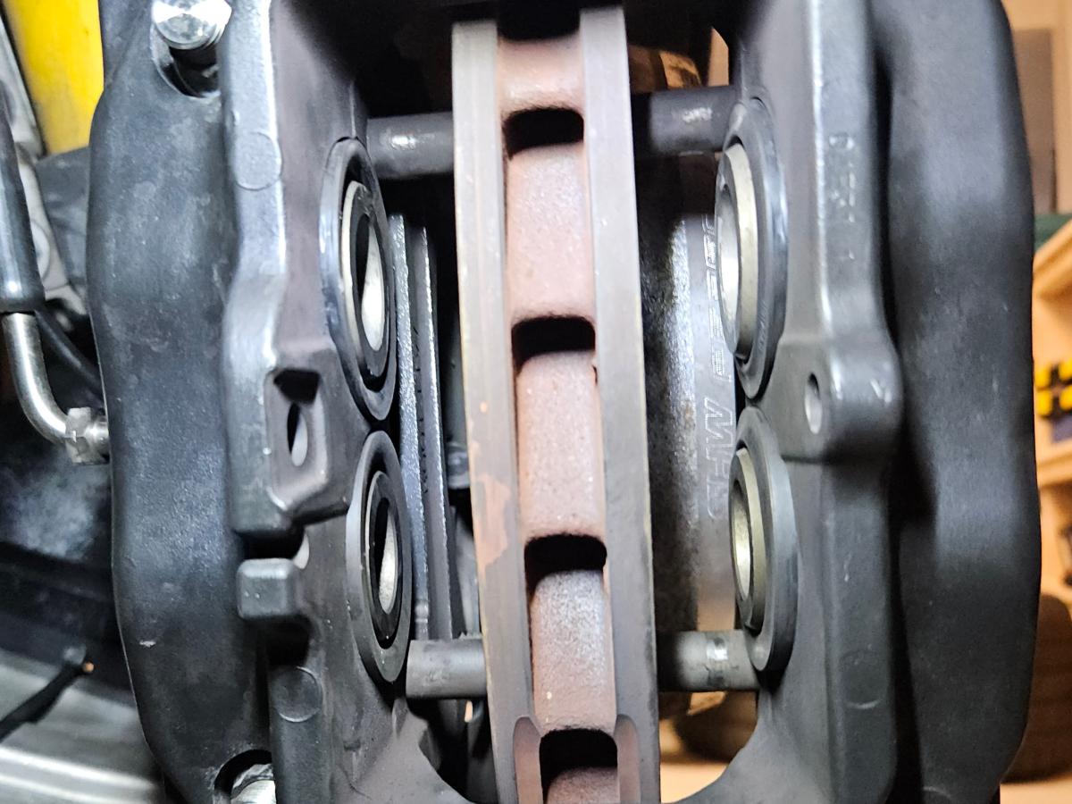

          I found one cooked dust boot on each side of the car after the no scoops track day. Scoops track day involved thinner pads and higher ambient temps, so zero cooked boots would point to working scoops and not increased thermal capacity in the system (in reality thermal capacity decreased).
          Aaand the results:
          Success! Dust boots seem totally fine We'll have to see how many more track days they last.

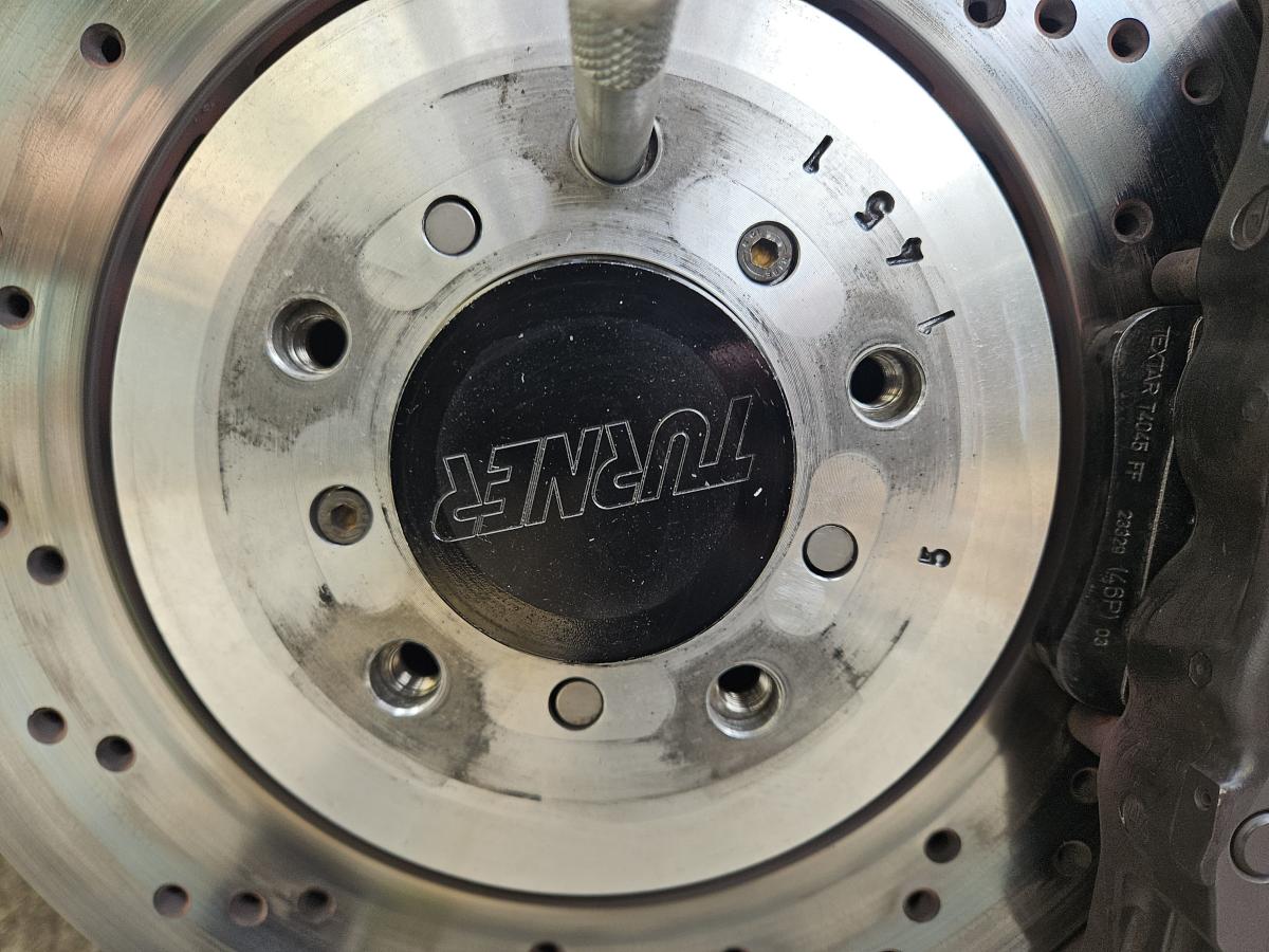

          These pins and screws used to be centered on the rotor holes:

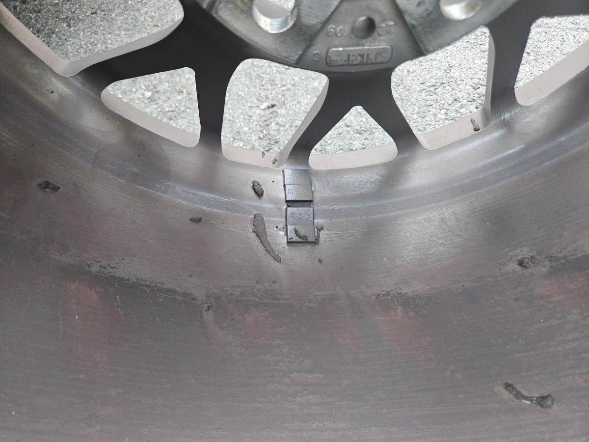

          Man, this last track day really made me remember how hard this sort of driving can be on the hardware. Tons of fun, but it really does age parts very fast.

            You had blanked the bumper brake duct holes for this one right? Ie: only clean air coming from under the car, not through the factory ducts, same as my testing?
              How can we get some of those scoops?!?!
              Old, not obsolete.
                Cash. Lots of cash.
                  Yep! The outlets I added to the stock ducts for brake cooling hose were taped off and the openings in the fender liners were covered with the stock clip in covers (used two of the solid ones, not the one with the holes). Also trimmed the pork chops. Basically just replicated the setup on your car cause that's what you tested with.

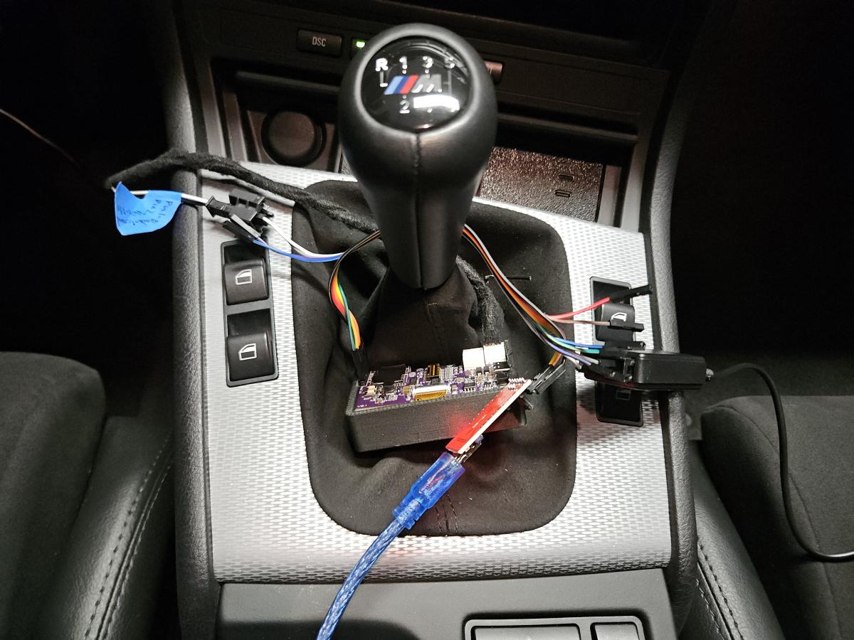

                    Got a few things done this past week.
                    First, wrote some super quick and dirty validation FW to make sure the V5 Gauge.S board could talk to the car. Did this to rule out the issue being a hardware one. Here's the validation code if anyone is interested: https://github.com/heinzboehmer/Gaug...54HP-Validator
                    Here's the test setup. From left to right, OBD II Gauge.S connecter with D bus tap, V5 Gauge.S board, ESP32 programmer, logic analyzer:
                    It works!
Name:	Screen Shot 2024-09-17 at 7.10.00 PM.png
                    After some conversations with sorek, we found that the FW for the new board was initializing serial comms with the TJA1021 with two stop bits, instead of the one stop bit called for in the ISO 9141-2 spec. Sorek built a beta FW for me with just one stop bit and it works great! It's nice to have the new HW working correctly now. No pics of the new board in the car cause it looks exactly the same as before.

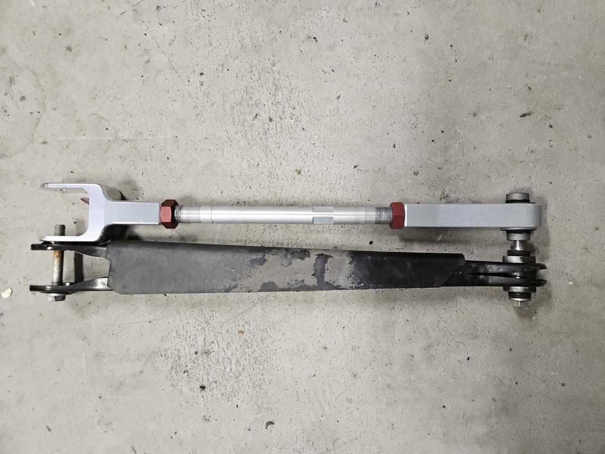

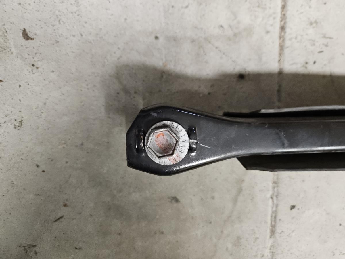

                    Then moved on to addressing the camber thing. I had been running about -1 deg camber in the rear and -2 in the front because I was limited by the stock rear camber arms. I had a set of aluminum Eibach camber arms sitting on the workbench, but had been putting off the install since I knew it was going to be a pain. However, the last track day really made it clear that I desperately need more camber, so I finally got around to it.
                    Pic of the amazing design that makes this a ~5 hr job, instead of a 30 min one:
                    I managed to cheat and get the bolts out by undoing the three diff bolts and just moving it around (leaving driveshaft and axles attached), but man, it was crazy tight. Couple mm longer bolts and I don't think this technique would have worked.
                    I marked the location of the eccentric bolt on the old arms and then matched the length of the new arms to that. Kinda hard to see the silver mark, but it's there on the right side of the bolt head:

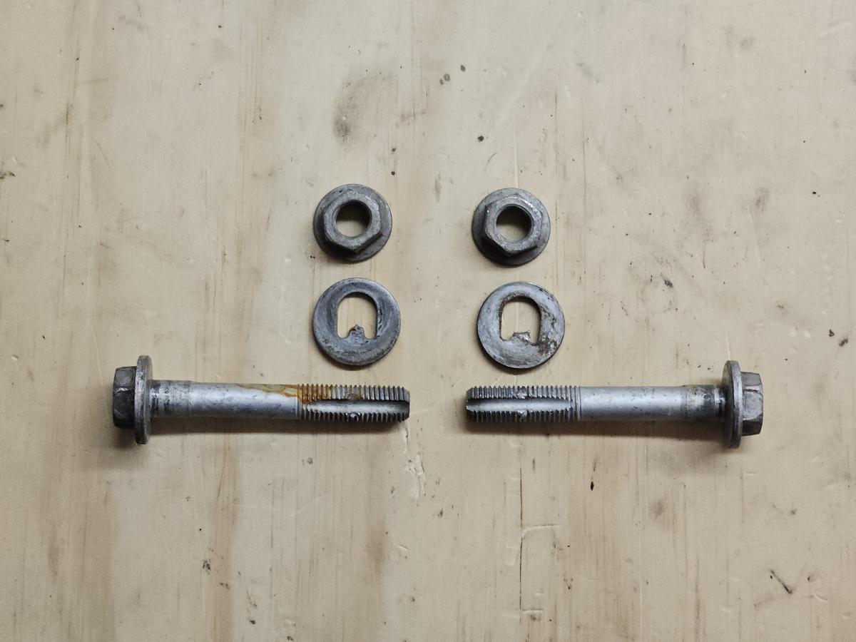

                    Also, this is what the stock eccentric bolts looked like. These parts were replaced when I installed the VinceBar, so only about four years old:
                    I blame this on the track. Don't think those small tabs were designed with the lateral forces that modern 200tw tires can generate in mind

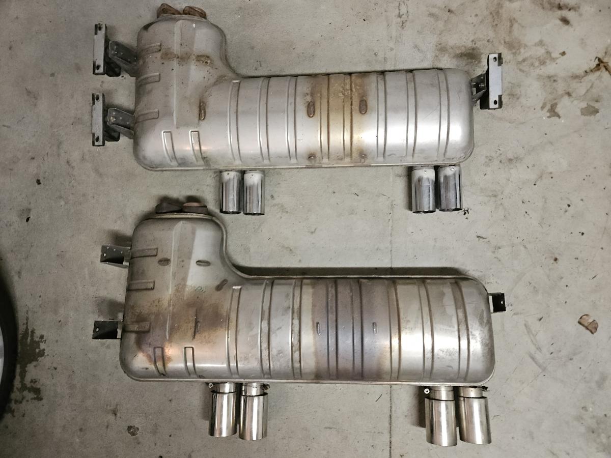

                    Since I had the exhaust out, I replaced the section 3 that was on the car with another stock one. Old one has started to rattle on cold starts and it was driving me crazy:
                    Kinda crazy to see how much more abuse the old (bottom) muffler had taken. Especially considering the new (top) one came off a ~200k mi car:
                    Old one looked very similar to the new one (and didn't rattle!) when I installed it a few years ago. Blaming this on the track as well.

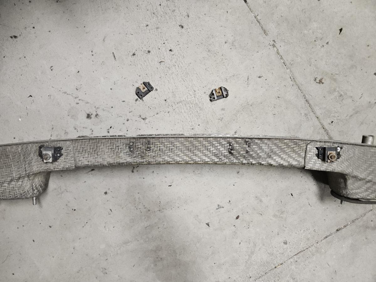

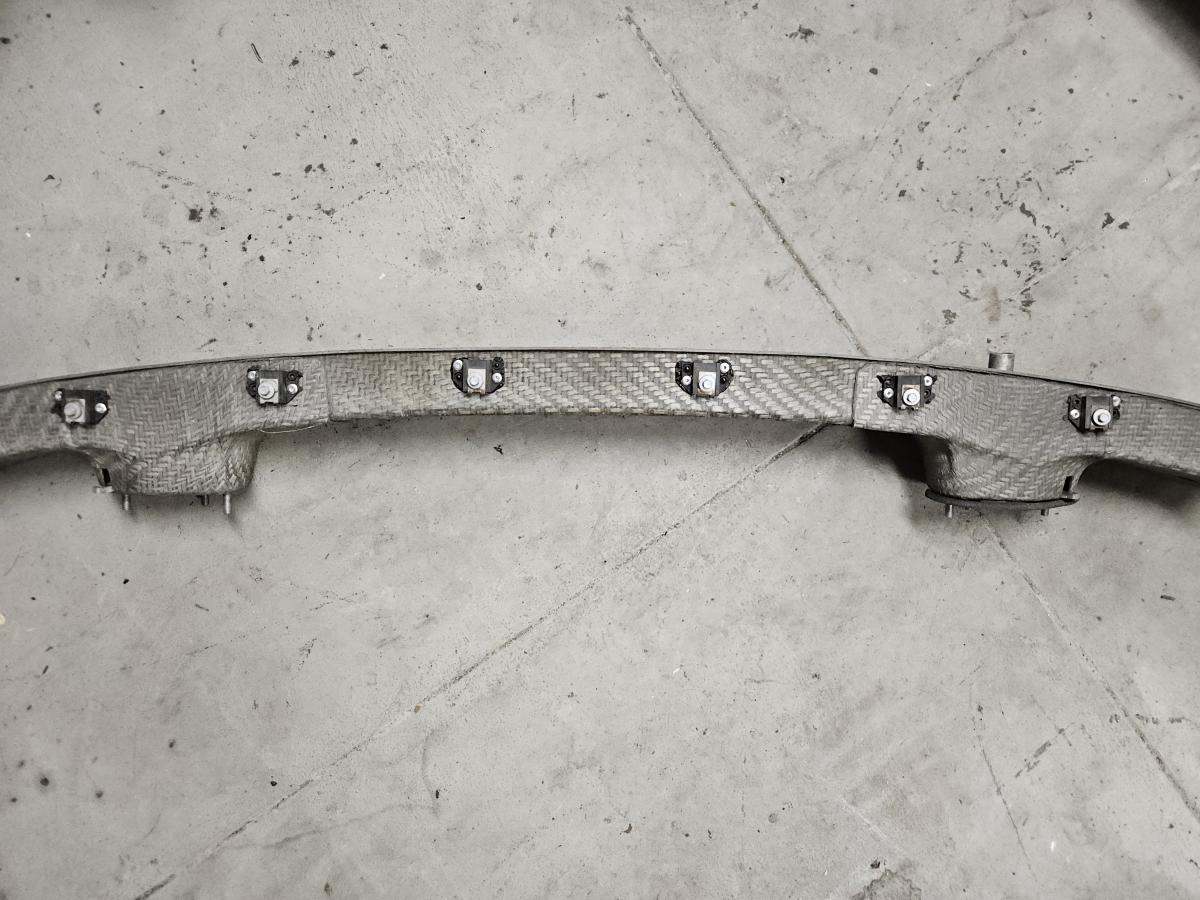

                    I took the rear bumper off to do the muffler swap and noticed that the adhesive on some of the crash bar tabs had failed, so fixed that. Cleaned the area and reattached the tabs with JB plastic bonder. I also decided to add a couple rivets to each tab (including the ones that still hadn't fallen off) for some extra security. Don't think these are coming off anytime soon.
                    Ended up doing a ton more work than expected for a pair of components that are held in with four bolts, but glad to be done with this now.

                              Also I believe heinzboehmer redesigned the upper duct to better match the dust shield if memory serves. Heinz, shoot me that file if you want.
                              Sorta. I redesigned the upper duct to match my modified brake shields. I had previously cut them to install circular flanges for traditional brake duct hoses.
                              Happy to share the files, but they're matched to the cut shields on my car, so not sure they'll be useful to anyone else.
