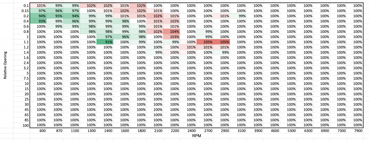

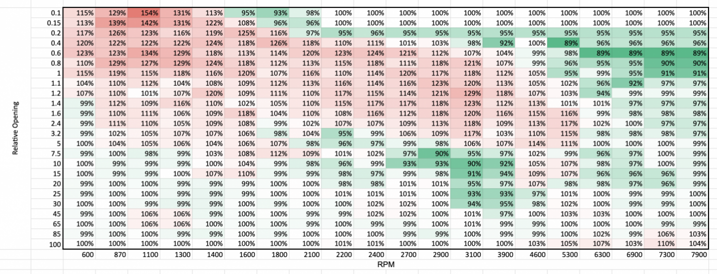

        Recently went through the partial throttle tuning process described here: https://nam3forum.com/forums/forum/s...or-drivability
        Man, what a difference. It's hard to put into words how the car feels now because it just feels so normal. Almost boring? As in, the car just drives like a car and requires no extra attention/skill to drive it smoothly around town. No more weird bucking, hesitation or stumbling. Still a riot at higher throttle inputs though. I'm very happy with the outcome.
        Wrote more detailed notes up in that original thread, but figured I'd post a quick summary here too.
        Here's a comparison of my final warm VE table to stock CSL after all the iterations:
        Click image for larger version  Name:	Screen Shot 2023-11-30 at 10.22.47 AM.png Views:	0 Size:	870.8 KB ID:	244565
        I also interpolated those corrections, applied them to the warm up VE table and did one iteration on it using the same technique. This is a comparison of the interpolated table and the table after one iteration:
        Click image for larger version  Name:	Screen Shot 2023-12-01 at 12.21.26 PM.png Views:	0 Size:	427.1 KB ID:	244566
        Effectively the same, so I stopped iterating there.

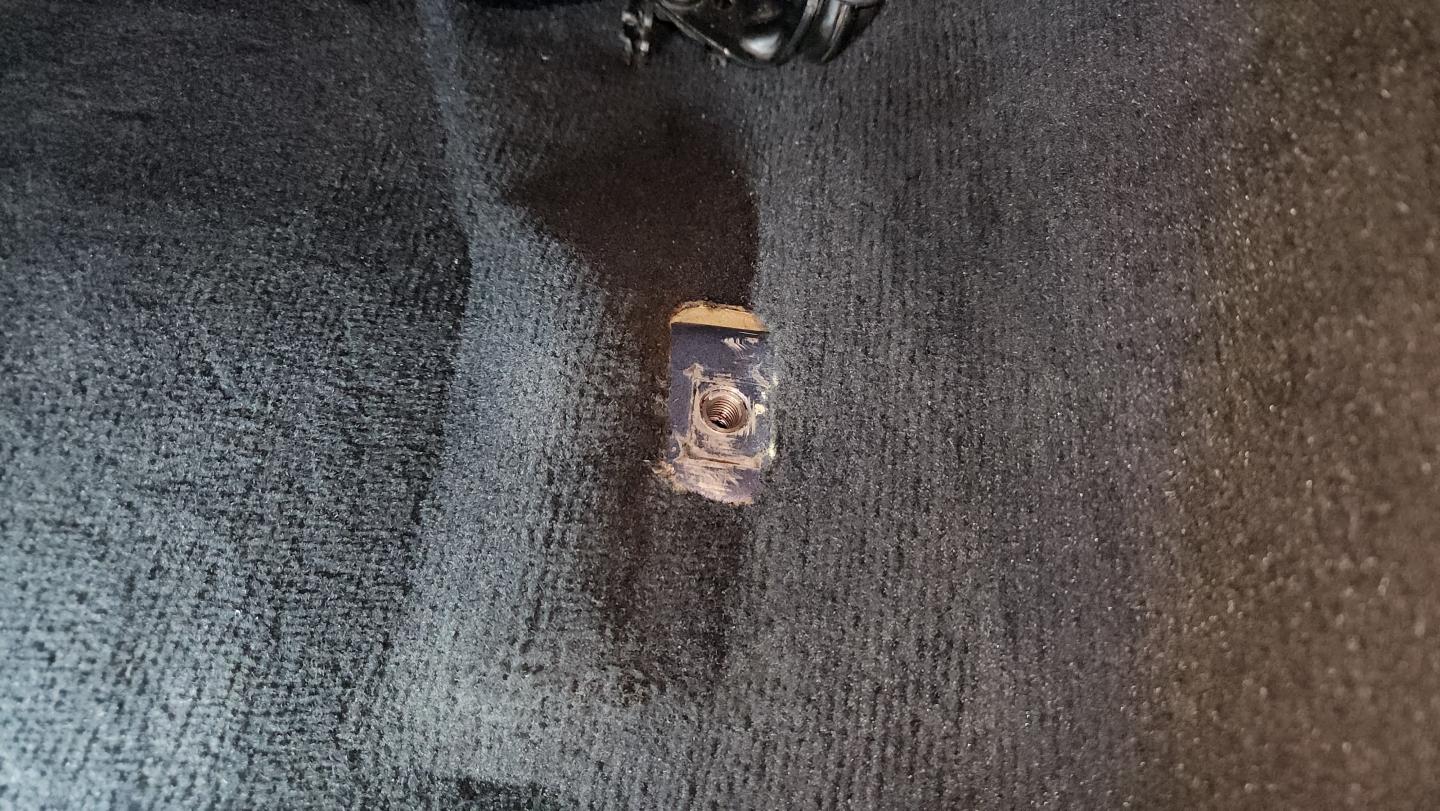

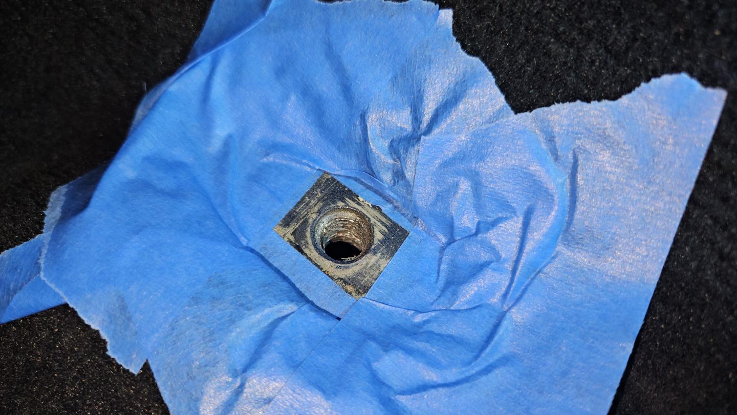

          And of course that wasn't the end of my seat mounting troubles. When I got the car, the threads for the back right bolt were cross threaded. I chased them and they held torque well, but it was only a matter of time until they fully failed. No big deal though, this one was way easier to fix with a timesert compared to the front ones.
          Destroyed (and masked so that metal shavings wouldn't get between the chassis and the carpet):

          Hard to see, but I added some locating marks to this insert as well. Not as important as the fronts, since this one does bottom out when fully installed, but figured why not.

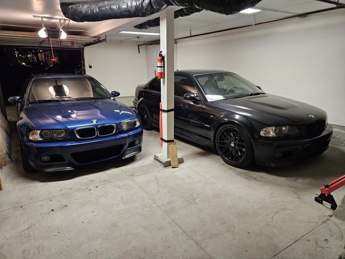

                    Ha. Did you get a 2nd?
                      Yep!
