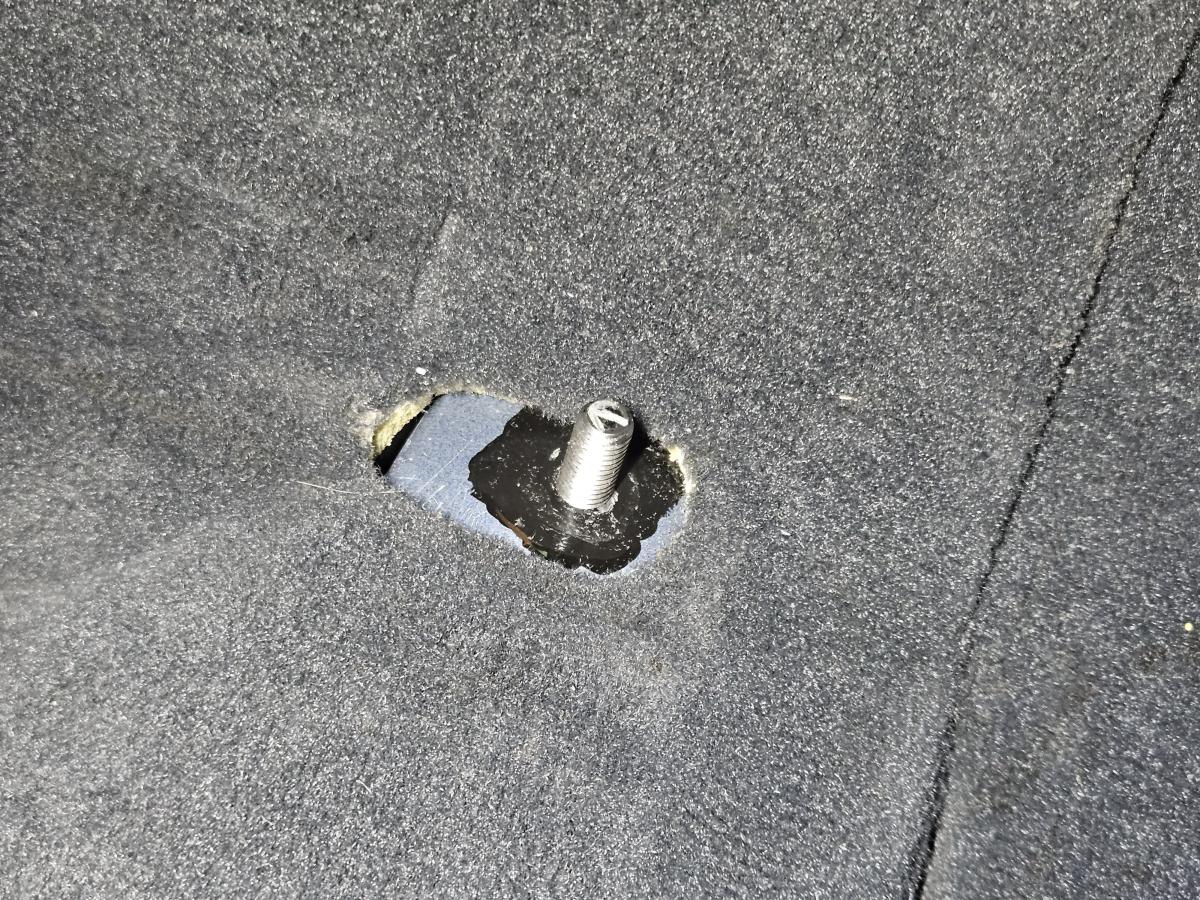

    Hardware I ordered to fix the seat studs arrived.
    New studs installed with red threadlocker:
    Cool...I've been wondering about replacing the seat studs in my car. Any reason to not install studs in the rear holes as well?
      No reason really. Went with bolts simply cause I had new ones in the garage and I did not have two more studs.

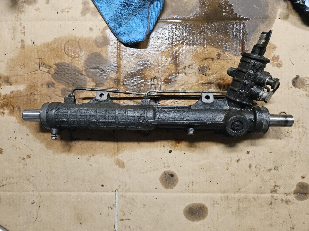

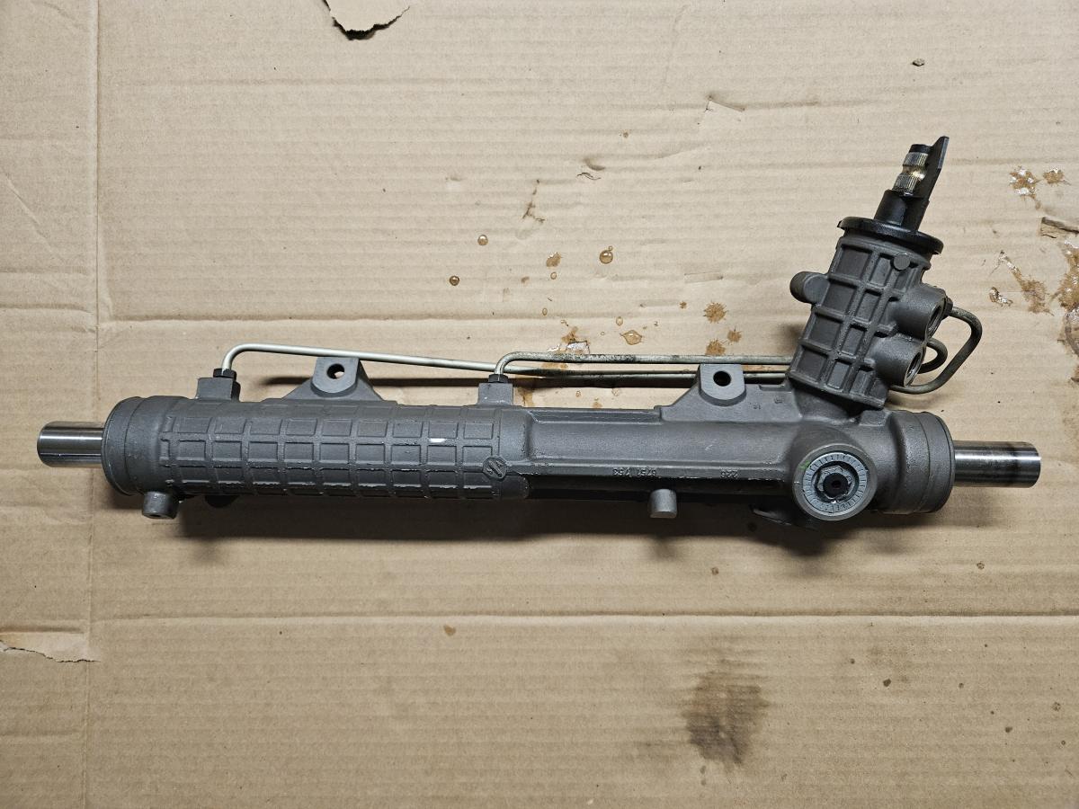

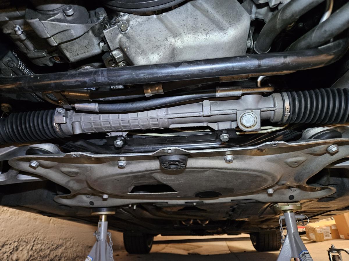

        Anyway, first thing I did was swap the ZCP steering rack into this car and code the MK60 for the new ratio:
        Click image for larger version  Name:	20240112_010656.jpg Views:	3 Size:	163.8 KB ID:	249491
        The steering rack was disgusting when it came out of the grey car. Here's a before (after some preliminary cleaning) and after:
        Click image for larger version  Name:	20240111_192253.jpg Views:	3 Size:	201.6 KB ID:	249493
        Click image for larger version  Name:	20240111_201620.jpg Views:	3 Size:	142.3 KB ID:	249494
        I also swapped in new inner tie rods, new outer tie rods and new boots. The rack feels perfectly fine, but I am going to rebuild it in the nearish future just because of the mileage. Have done a decent amount of research and it seems like a job that I should be able to get done without too much frustration. We'll see if that's true once it comes time to remove that inner seal though...

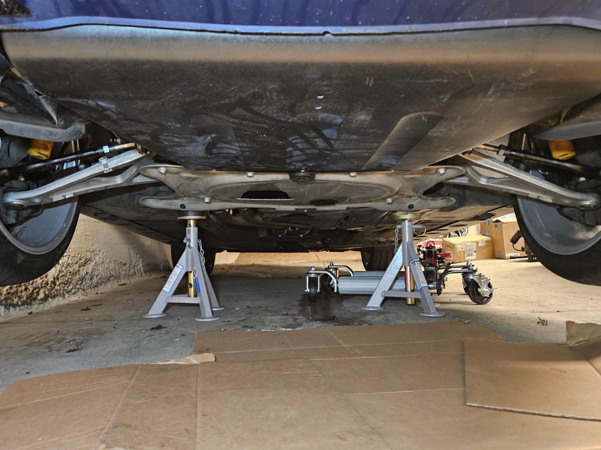

        After that came a brand new belly pan:
        Click image for larger version  Name:	20240112_183123.jpg Views:	3 Size:	138.7 KB ID:	249492
        And that's it? Feels weird to get a job done in a couple hours after the amount of hours I've been spending on the grey car.
        Haven't driven this car at all because I don't want to kill the front tires with my very (very) approximate toe settings. Have an alignment appointment on Friday, though, so will post up some impressions after that.

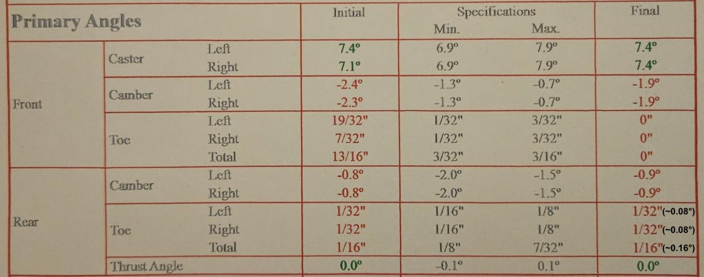

          Alignment done. As expected, front toe was way off:
          I say this every time I get an alignment, but I really really need camber arms in the rear so that I can get the camber I actually want (both front and rear).
          Anyway, car feels awesome. I am really liking the ZCP rack. The difference in ratio is pretty slight (which is a good thing!), but the difference in feel is huge. The dead center feeling is mostly gone and I really like the weight of it. Excited to rebuild the rack, as it should make it feel even better.

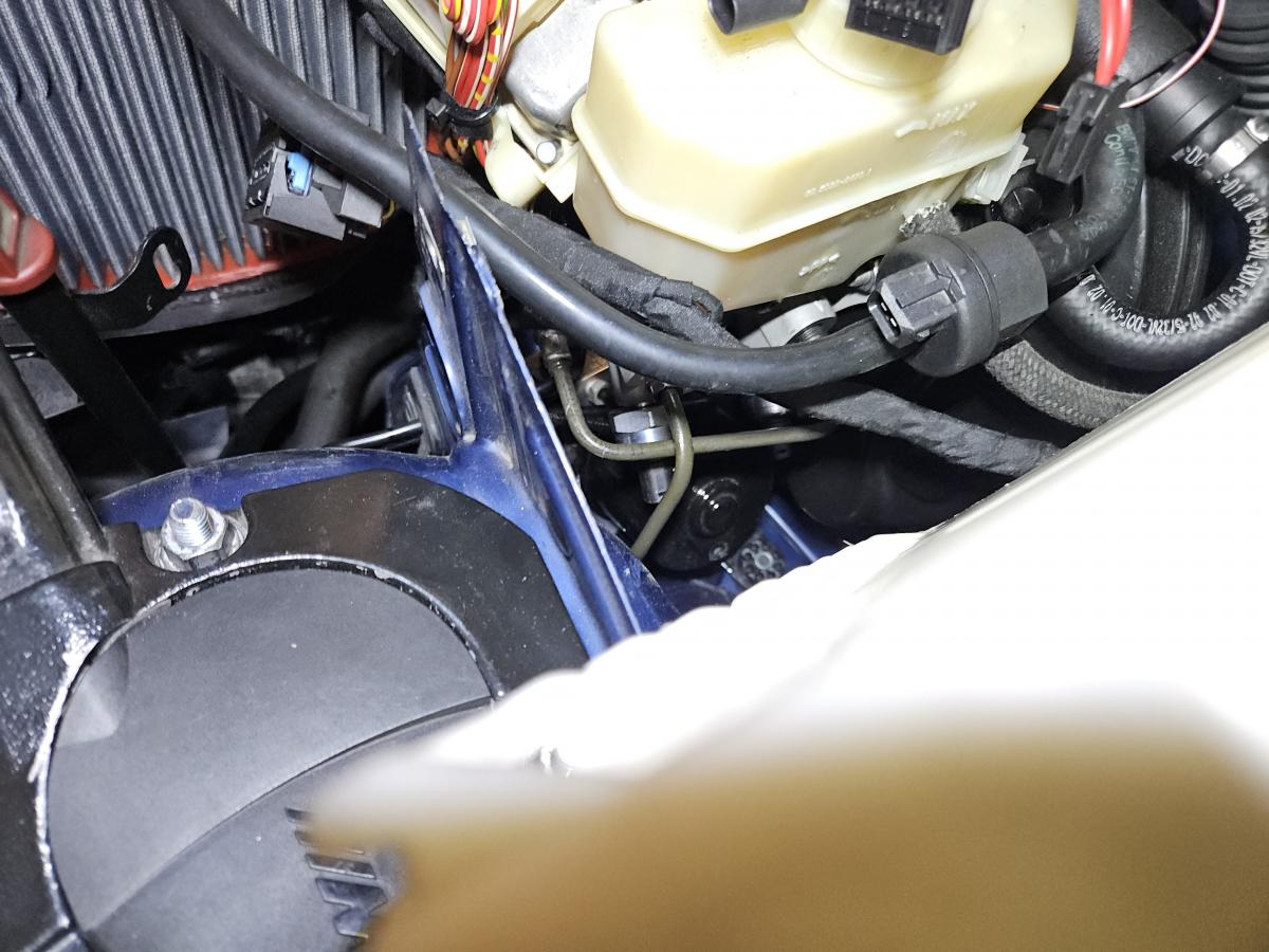

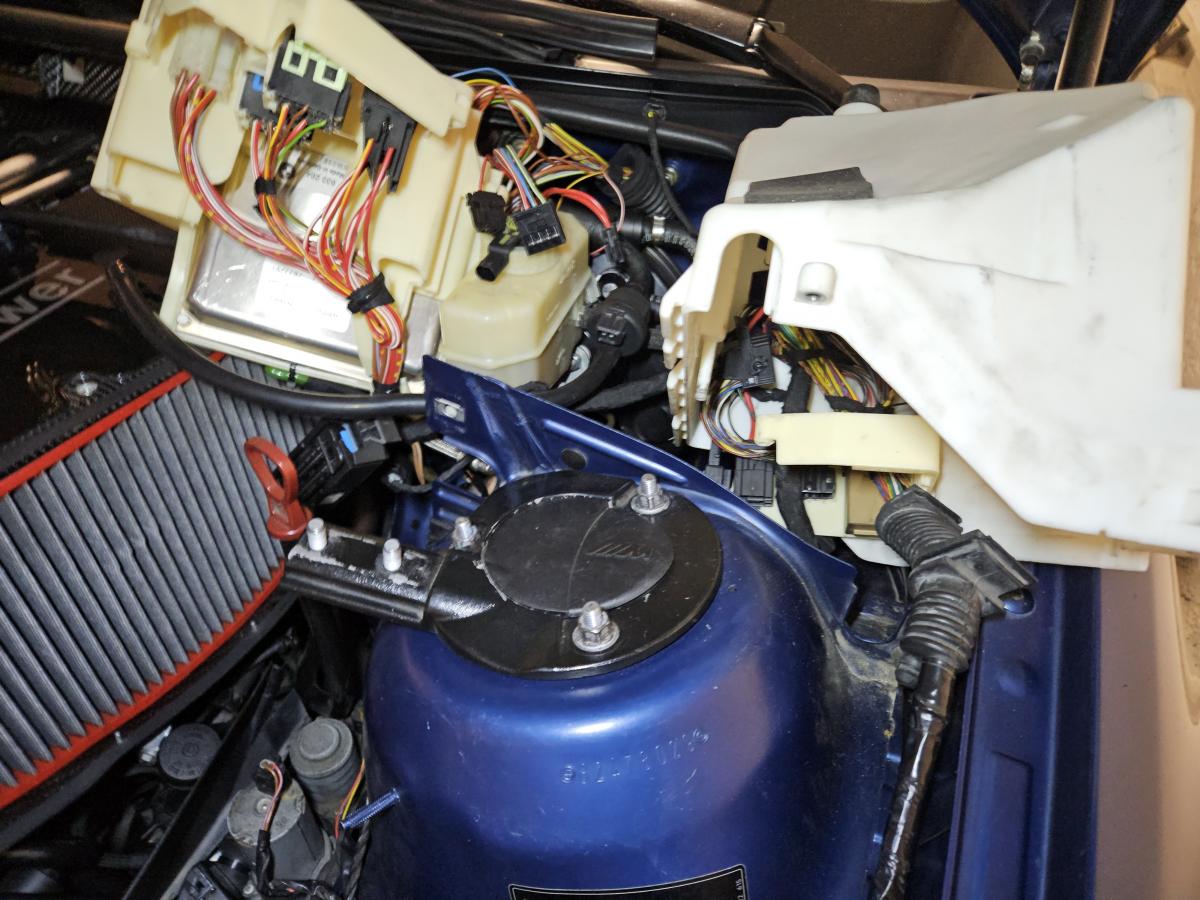

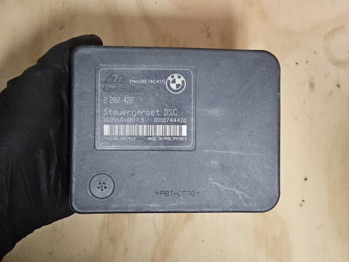

            Installed some more ZCP bits on this thing recently. First up, the 817.3 MK60:

            I moved all the electronics out of the way to make my life a bit easier:

            You can just barely see the pump down there in this pic:
            With the electronics out of the way, I was able to get a regular ratchet and socket in, so that was nice. It was still a pain to get out though. Had to lift the valve body much more than I expected to get the pump contacts on the 817.3 unit to clear. And then of course I dropped one of the fasteners for the DME plastics under the interior carpet, so had to disassemble a bunch of stuff in the driver's footwell to retrieve it. Anyway, it's now in!

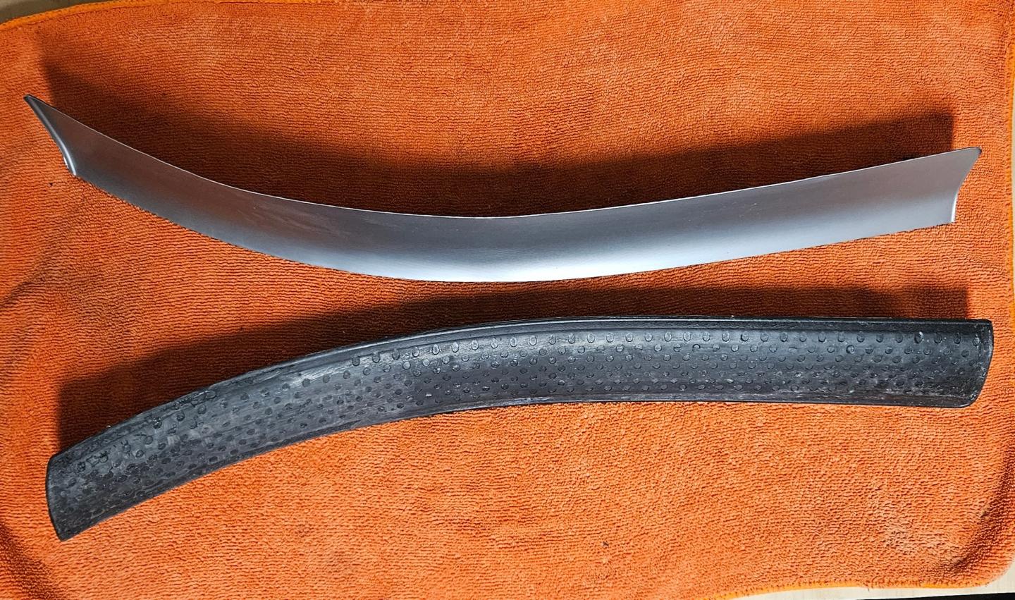

            After that came the trim. The passenger's side dashboard trim was falling apart on one side and had previously been reglued on the other, so I separated it entirely. Heat gun and some (very careful!) prying was all it took, but I was left with two pieces that were covered in adhesive:

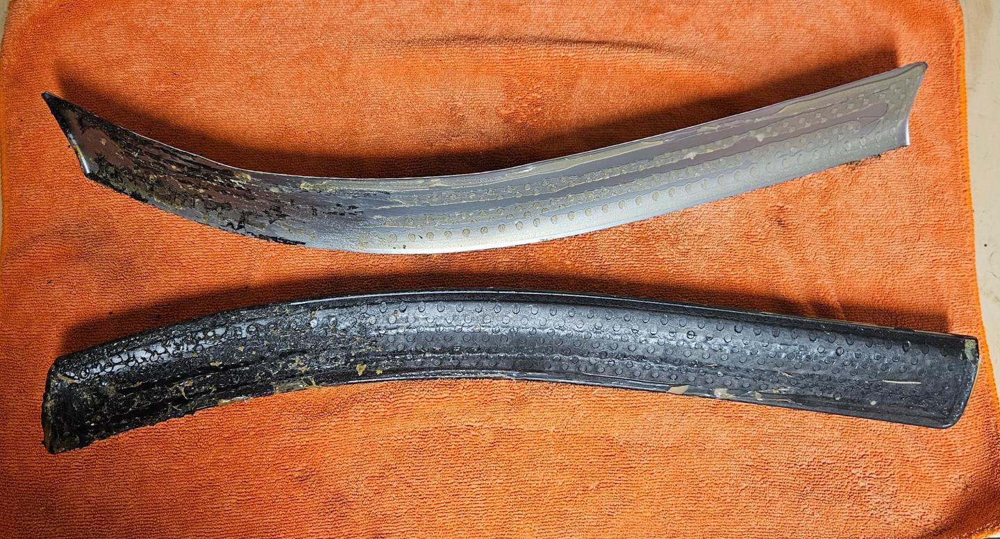

            The plastic was easy to clean, as I could just scrape everything off with a razor blade. I was scared to crease the aluminum with that method though, so instead I spent a million hours rubbing it down with a MF towel soaked in acetone. This is how they looked after some time:
            I then used my favorite trim adhesive and a bunch of clamps to glue it back on:

            Came out great!

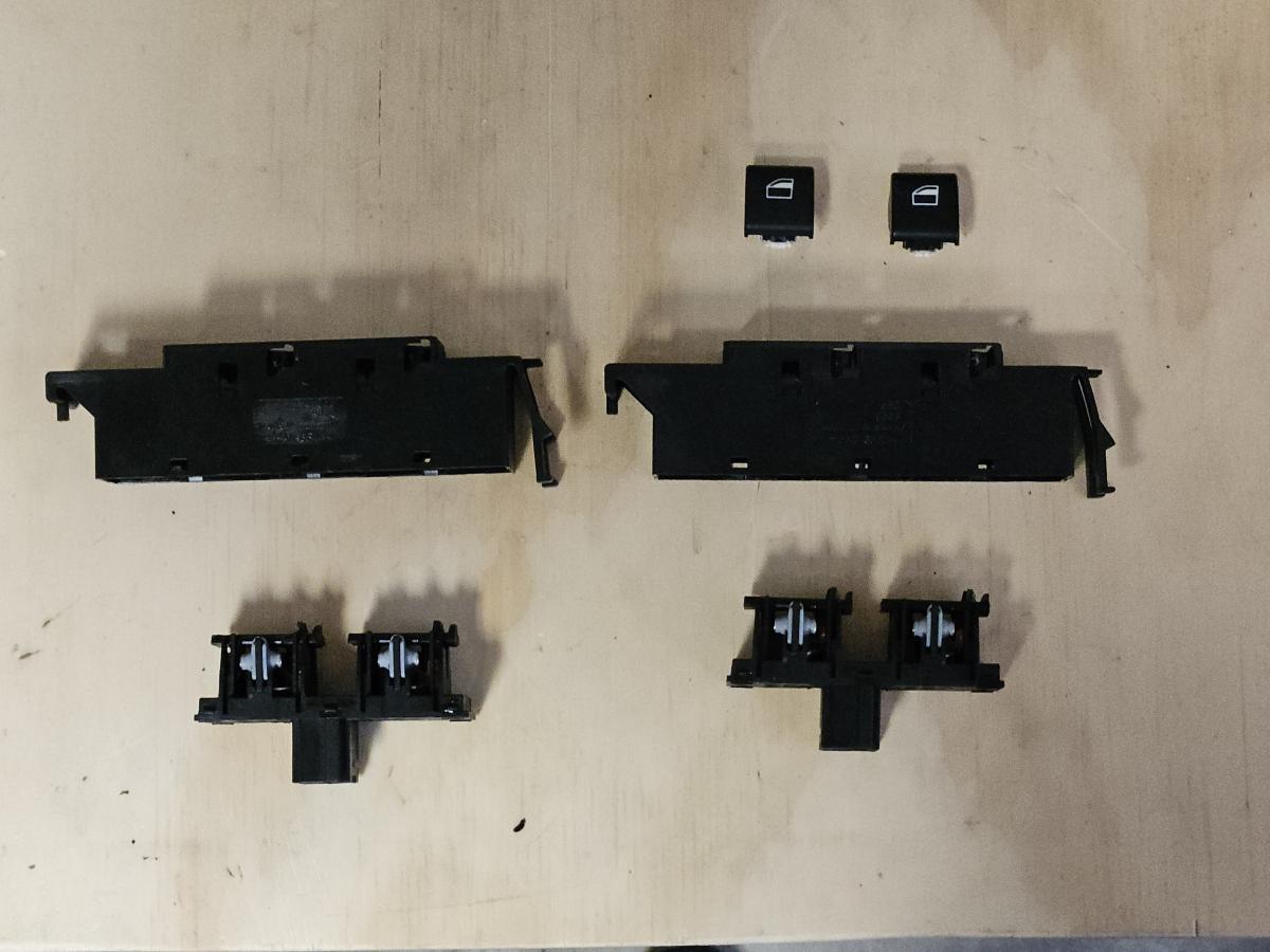

            Last thing I did was to replace the window switch that I had attempted to fix with another from the junkyard. The circuit board and switch caps were in worse shape than the one on my car, so I made a good unit out of the two:

                    Would love to get one of those zcp/csl dsc units

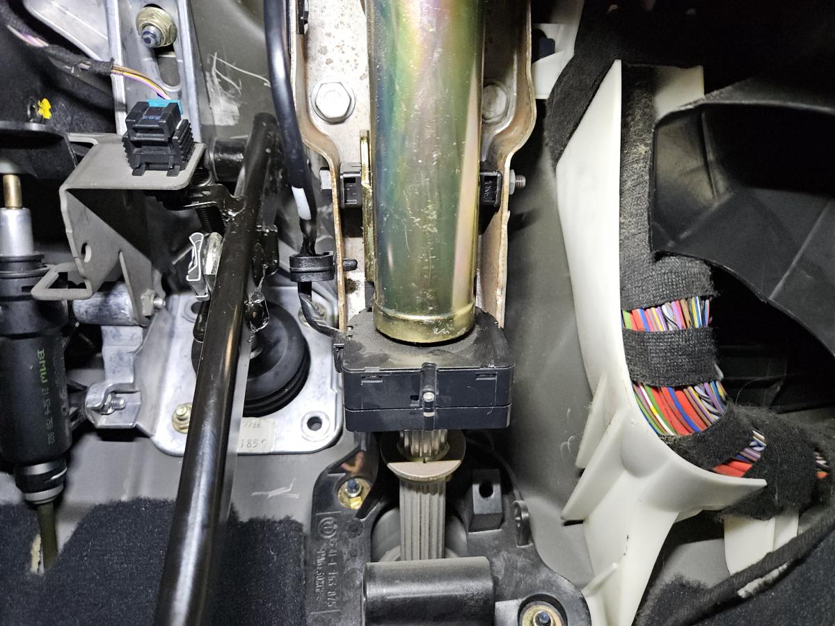

                              Tackled a small but much harder than expected job the other day: steering column bushings. Not a lot of pictures because I spent most of my time contorted under the dash struggling with the install.

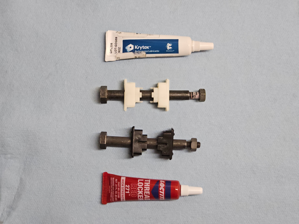

                              TIS says to "Install nut with Loctite", but doesn't specify the strength. The old bolt had what looked like red threadlocker, so I used that. Also lubed the sides of the bushings (where they slide against the fixed part of the column) just like the stock ones were. Whatever lube BMW used at the factory looked suspiciously similar to the Krytox I used. Probably some PTFE based lube as well.
                              Getting the bolt through the new bushings was incredibly hard. Required a prybar and a lot of messing around with things. I think I spent like 20 min trying to get the bolt perfectly aligned with the second bushing before it finally went in. In hindsight, lubing the shoulder of the bolt would have likely made my life much easier, but I realized this halfway through the install and did not want to pull things apart and restart.
                              Here are the new ones in place:
                              Bryson told me this, so I was kind of expecting it, but I was still surprised by how much firmer the new bushing design makes the column feel. Telescoping it in and out now requires a ton of force.
                              Driving impressions are all positive. To be honest, I didn't drive the car a lot with the ZCP rack and old bushings, but I can say that the rack and bushing swap has made the steering feel much, much better. Pretty happy with this!

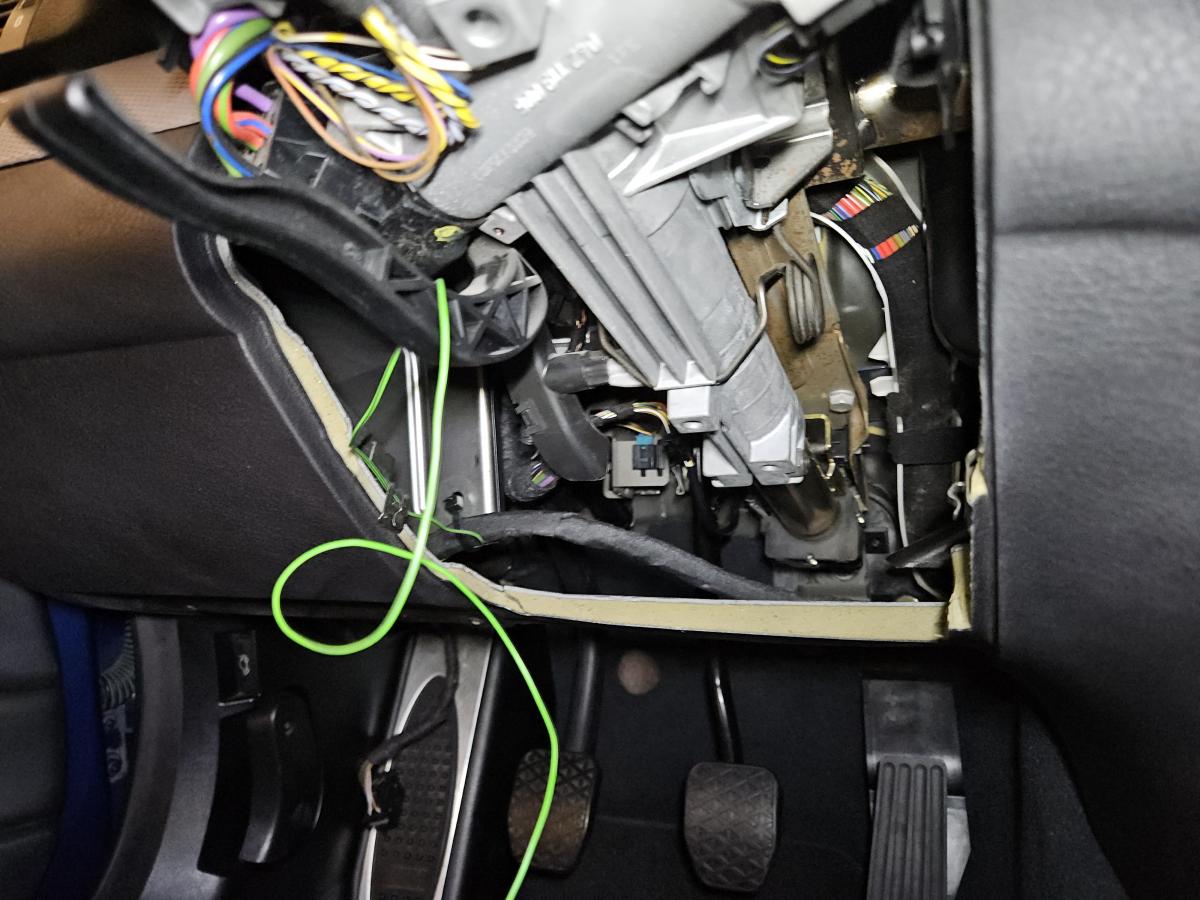

                              Also, when I did the MK60 swap, I added a wire for M track mode, just in case I ever stumbled upon a ZCP MK60. Now that that's in the car, I'll be wiring it to the E39 wiper stalk button, so I fished the wire out and set it in a more accessible spot:

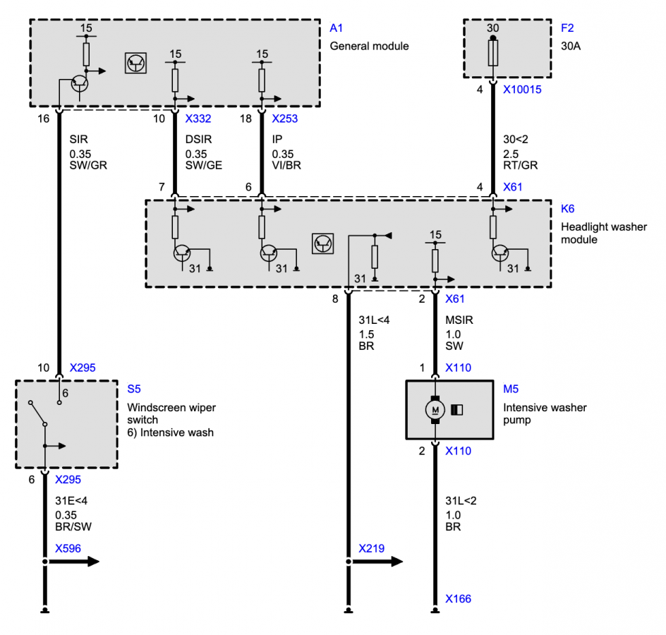

                              E39 stalk is arriving soon, so that'll be going in as well. If anyone reading this has wired that stalk up to a ZCP MK60, please let me know if it just wires right up or if I need to do some electronic trickery to get it working. Otherwise, I foresee some quality time with the multimeter in my future.
                                Hmm, TIS says that both the E39 stalk button and the M track mode button are switching to ground, so I might get lucky and not need to mess with anything. I'll probe my ZCP steering wheel trim and E39 stalk just in case.
                                E39:
                                Click image for larger version  Name:	Screenshot 2024-02-26 at 10.28.27 AM.png Views:	0 Size:	314.4 KB ID:	254951
                                E46:
                                Click image for larger version  Name:	Screenshot 2024-02-26 at 10.28.36 AM.png Views:	0 Size:	112.6 KB ID:	254952
Name:	Screenshot 2024-02-26 at 10.35.21 AM.png
