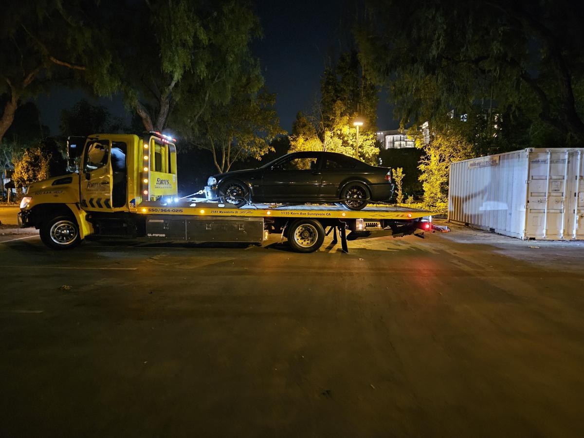

    Anyway, more pics. I did not want to keep driving the thing on the original rod bearings, so I had it towed home, where it has been sitting since:

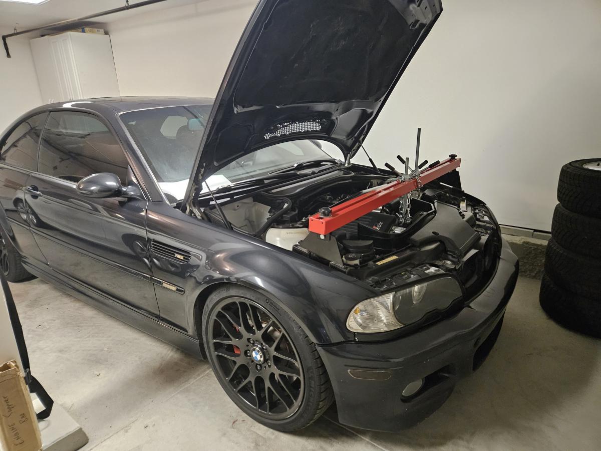

    And that's where the car will stay until I do the bearings. Also ordered other typical maintenance stuff like filters, engine + transmission mounts, FCABs, diff mounts, valve cover gasket, VANOS bolts, VANOS gasket, spark plugs, etc. There is mention of cooling system work on some of the paperwork I got with the car, so holding off on that for now until I start taking things apart in the engine bay and can inspect the work that was done.

                Unfortunately there was absolutely no drama. All the bolts came out without a problem and I found no sketchy repairs. This car is missing the front undertray, though, so everything was super grimey. Not fun.

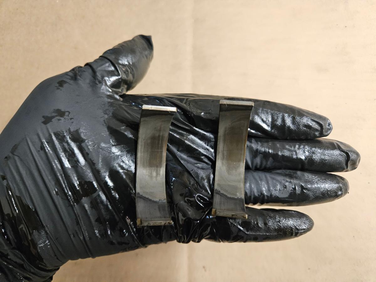

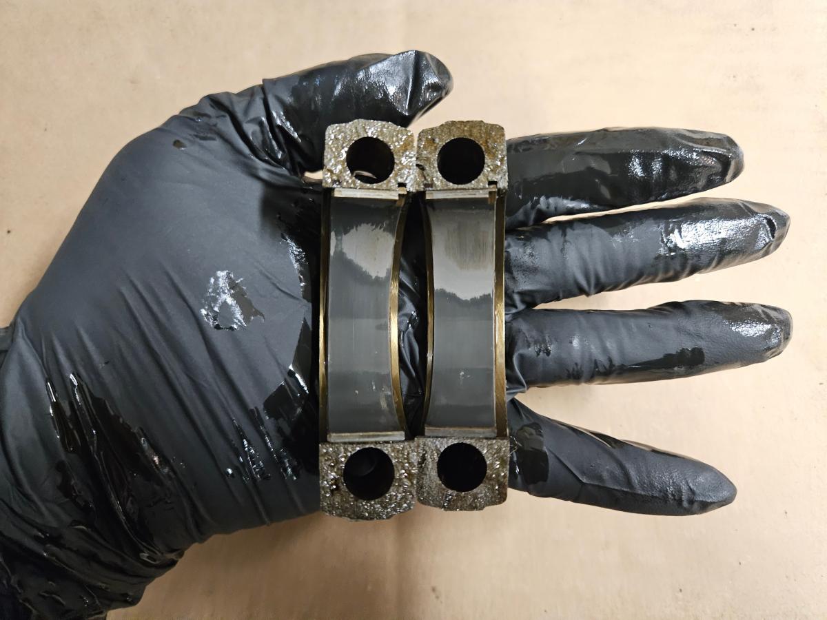

                Got the oil pan off yesterday and removed the rod caps from cylinders 3 and 4. This is what those bearings looked like:
                Looking much better than expected! Think I'm just gonna throw them back in and reassemble everything. No point in swapping stuff out if they've still got some life left

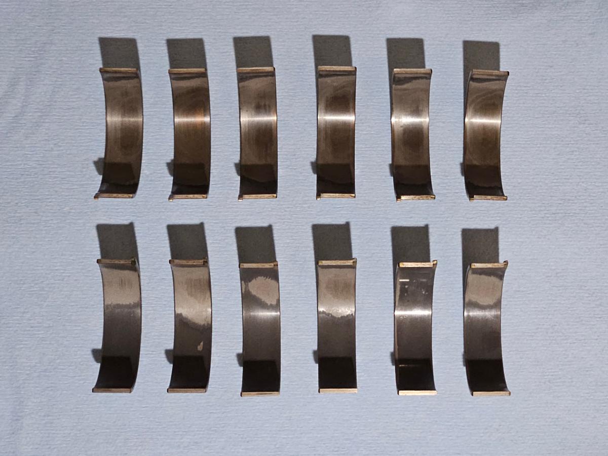

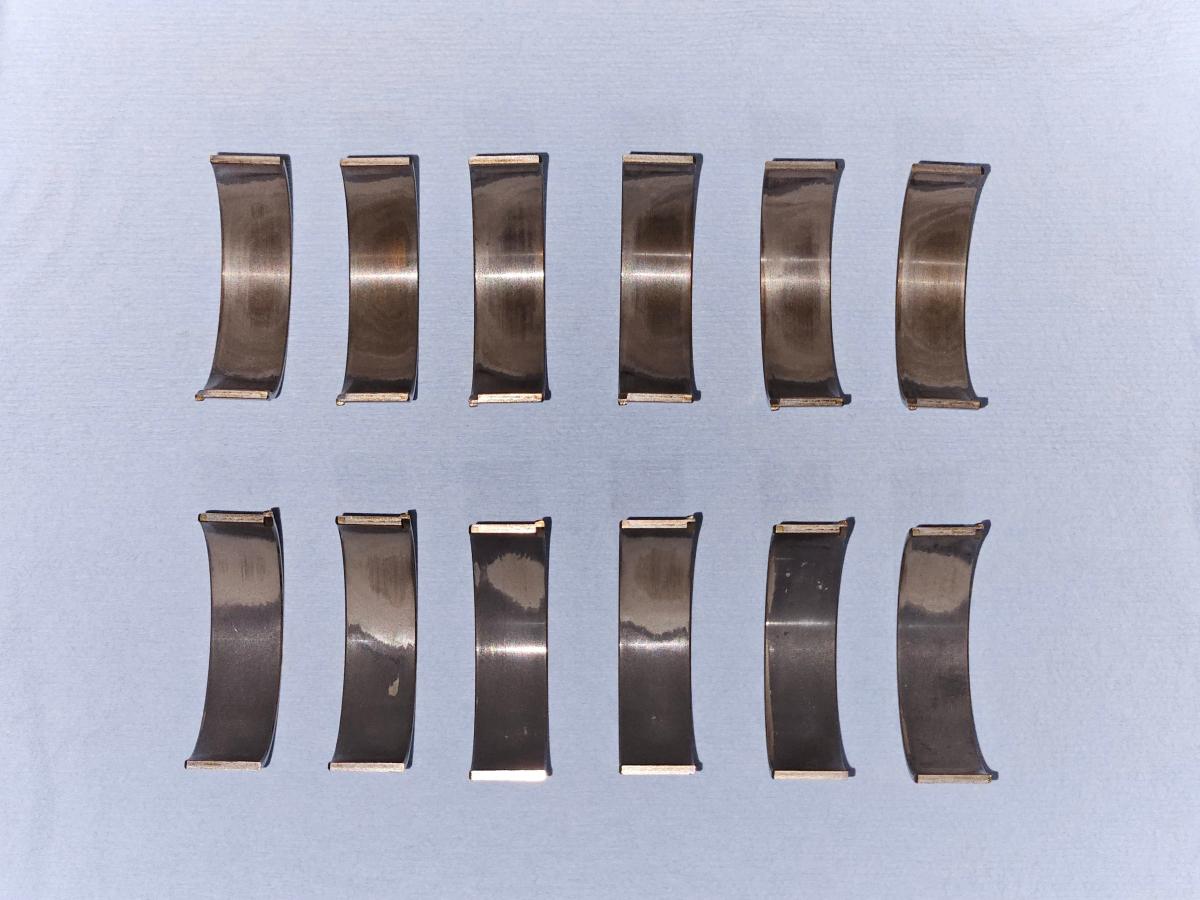

                              Finished up the bearings today. Here's what the old ones look like:
                              Not bad at all. There's a couple showing a little bit of copper, but they mostly look great.
                              I went with ACL bearings and stock rod bolts for the replacements. I did plastigage them and they were all well within spec. I'll post up more details (and pictures) soon.
