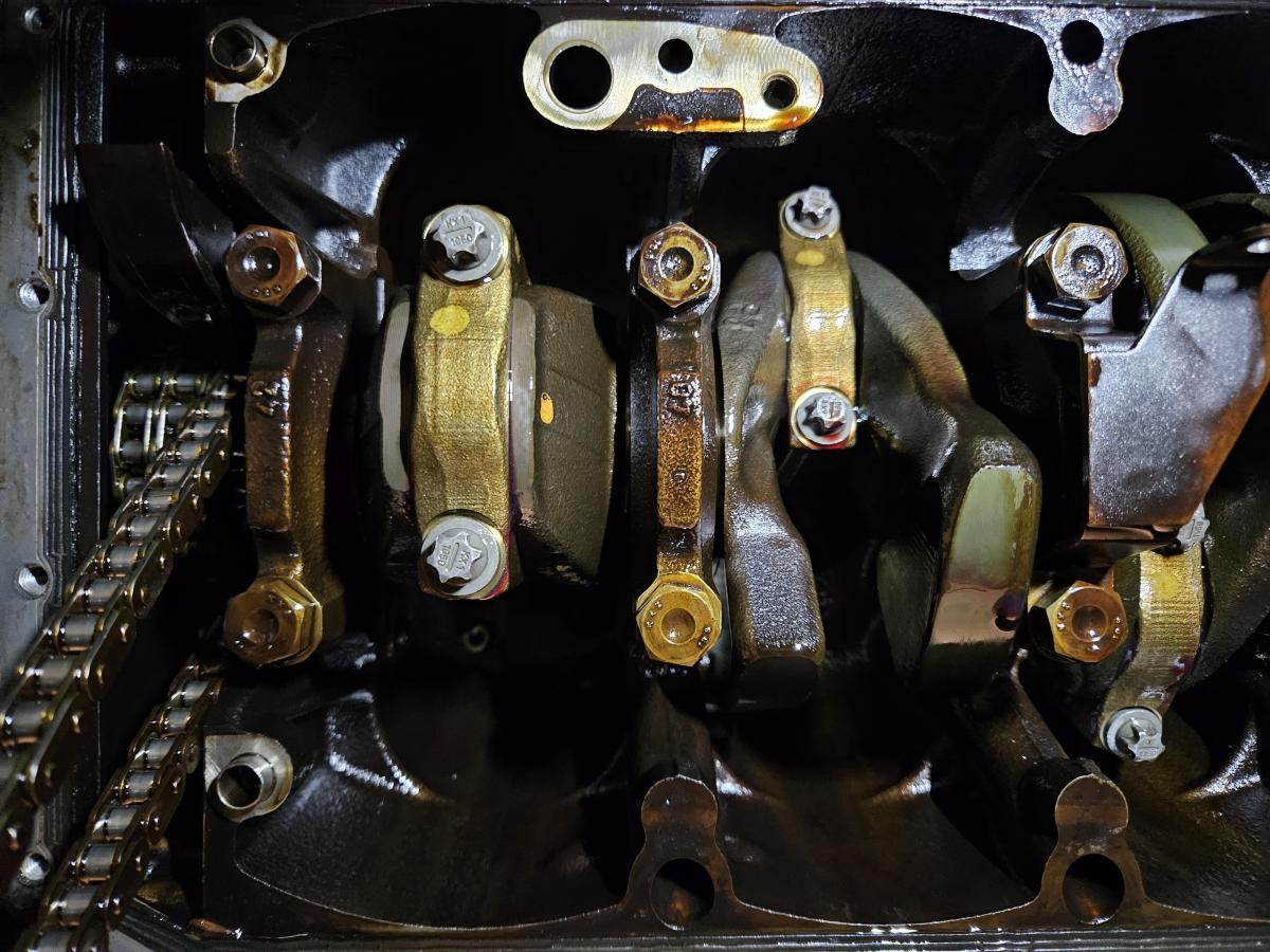

    Finished up the bearings today. Here's what the old ones look like:
    Not bad at all. There's a couple showing a little bit of copper, but they mostly look great.
    I went with ACL bearings and stock rod bolts for the replacements. I did plastigage them and they were all well within spec. I'll post up more details (and pictures) soon.

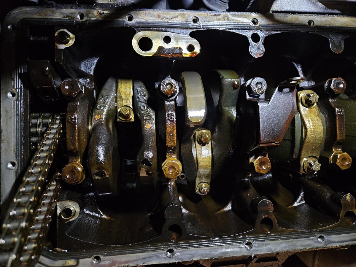

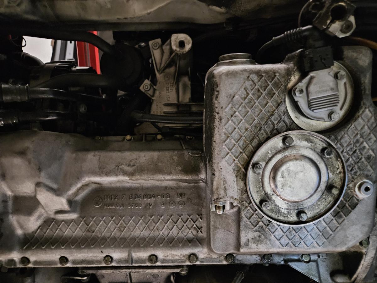

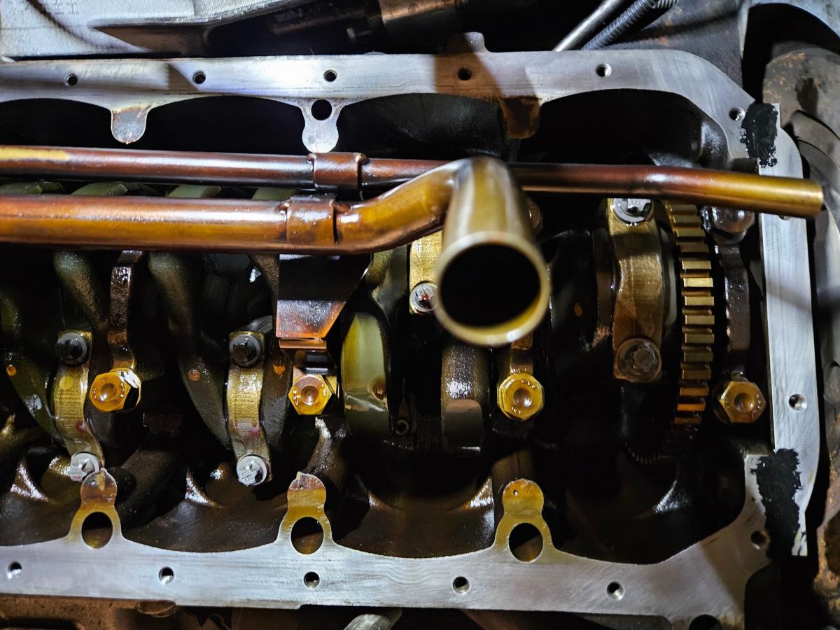

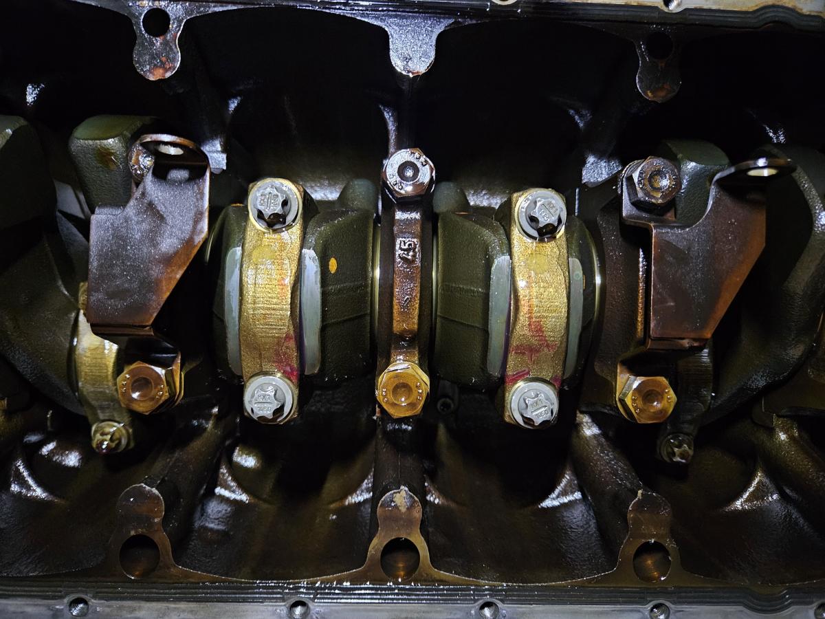

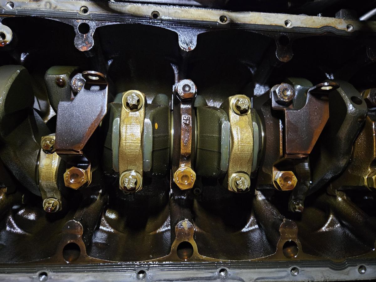

      Here's how I found everything when I took the oil pan off:

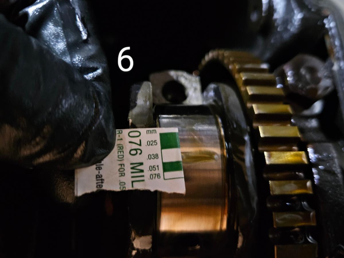

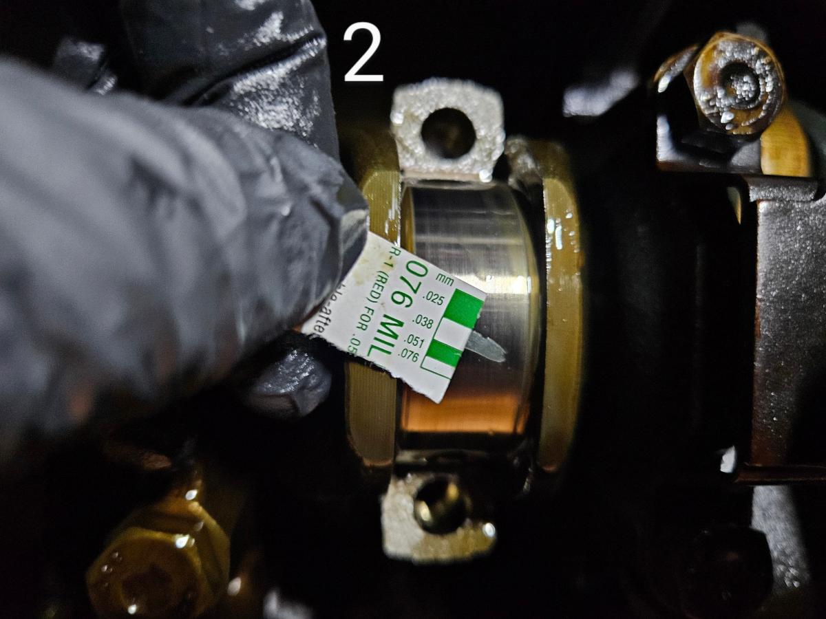

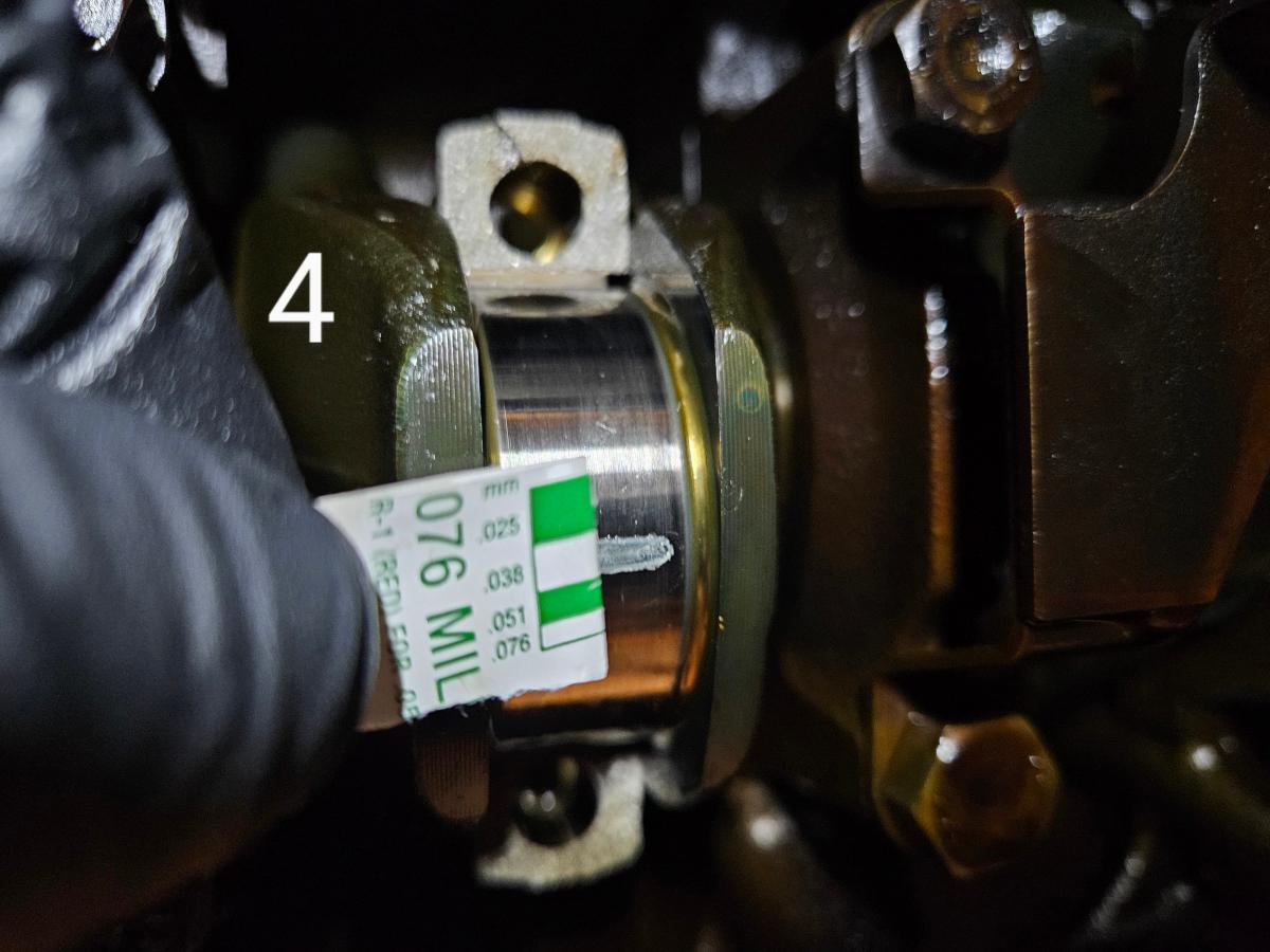

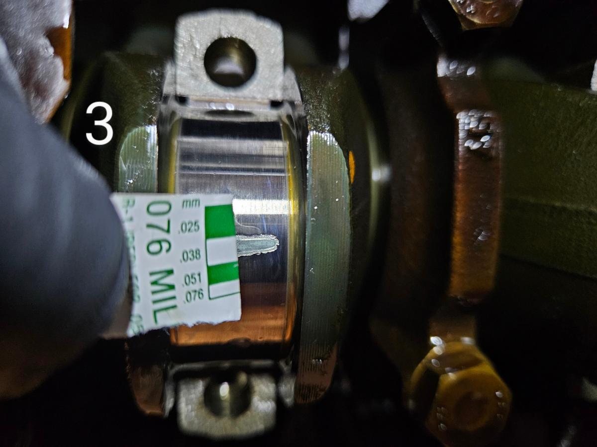

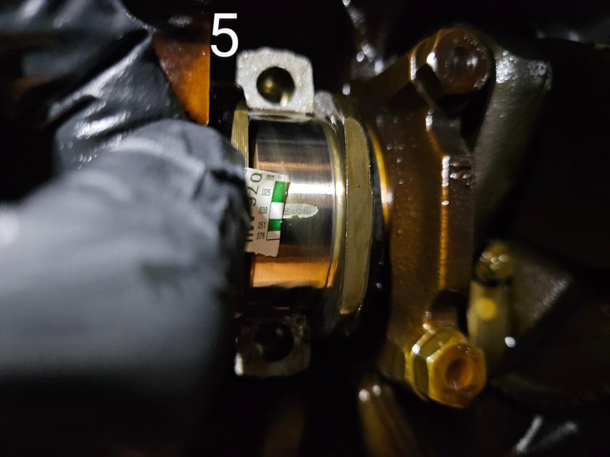

      And here's the clearance measurements with the new bearings:
      They all measured between 0.040 mm and 0.050 mm (roughly). Spec is 0.030-0.070 mm so they were perfect.

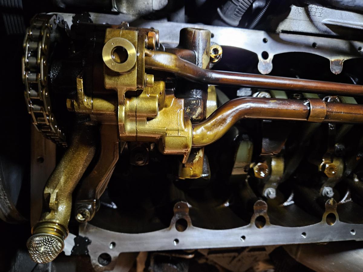

            Put the rest of the engine back together after swapping the bearings. Oil pump pickup had some wear, but less than expected for the mileage:
            Click image for larger version  Name:	20240109_195254.jpg Views:	0 Size:	135.3 KB ID:	249464

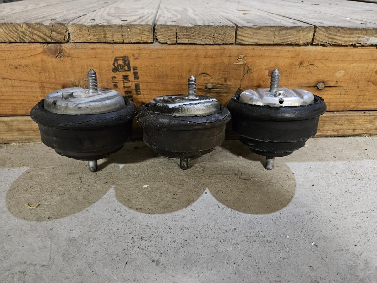

            Engine mounts replaced. Passenger's side on the left, driver's in the middle and new mount for comparison on the right:
            Click image for larger version  Name:	20240109_214249.jpg Views:	0 Size:	173.3 KB ID:	249469
            Driver's side was by far the worst one. It was so bad that the oil pan was almost touching the sway bar. It looked pretty terrible from up top too:
            Click image for larger version  Name:	20240109_214301.jpg Views:	0 Size:	134.9 KB ID:	249470
            Next was filling the engine back up with oil. It was here that I realized the pan had been timeserted before. Looks pretty well done, so I'm happy with that. It did seem to be leaking a bit because the insert was slightly more recessed into the pan than it should have been:
            Click image for larger version  Name:	20240110_182838.jpg Views:	0 Size:	164.4 KB ID:	249471
            Fortunately, I have the tool to mill the surface down from when I repaired the oil pan on the blue car. Would have been more convenient to do this when the pan was still off the car, but it wasn't a big deal either way. I did also forget to take a picture of the finished product, but it looks pretty much exactly the same, just with the insert flush against the pan. A week or so later and no leaks!

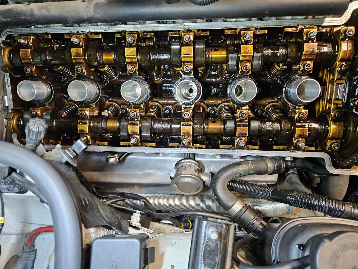

            Next up was the valve cover gasket and spark plugs. I was very pleased with how clean it was under the beauty cover:
            Click image for larger version  Name:	20240114_144846.jpg Views:	0 Size:	206.0 KB ID:	249474
            Unfortunately can't say the same about the header heat shield (and the side of the head/block). This thing was absolutely pouring oil of of the valve cover. Smell of burning oil was incredibly strong if you weren't moving and everything below that passenger's side edge was grimy:
            Click image for larger version  Name:	20240114_144902.jpg Views:	0 Size:	193.7 KB ID:	249475

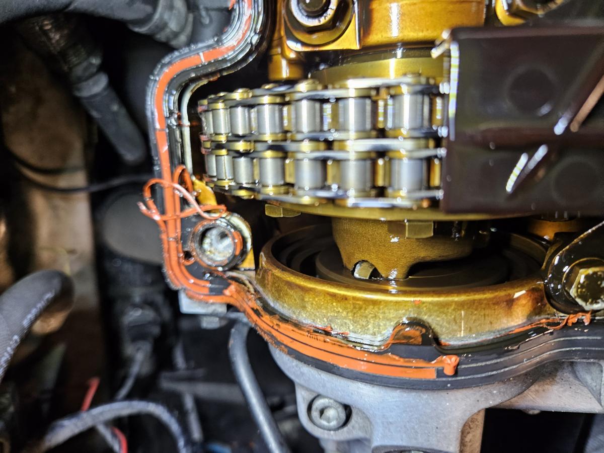

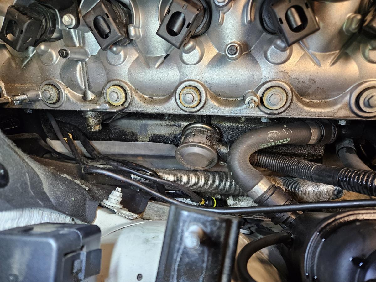

            The cause of the leak was extremely obvious after the valve cover came off (it was like this on both sides of the gasket):
            Click image for larger version  Name:	20240114_150314.jpg Views:	0 Size:	249.6 KB ID:	249476

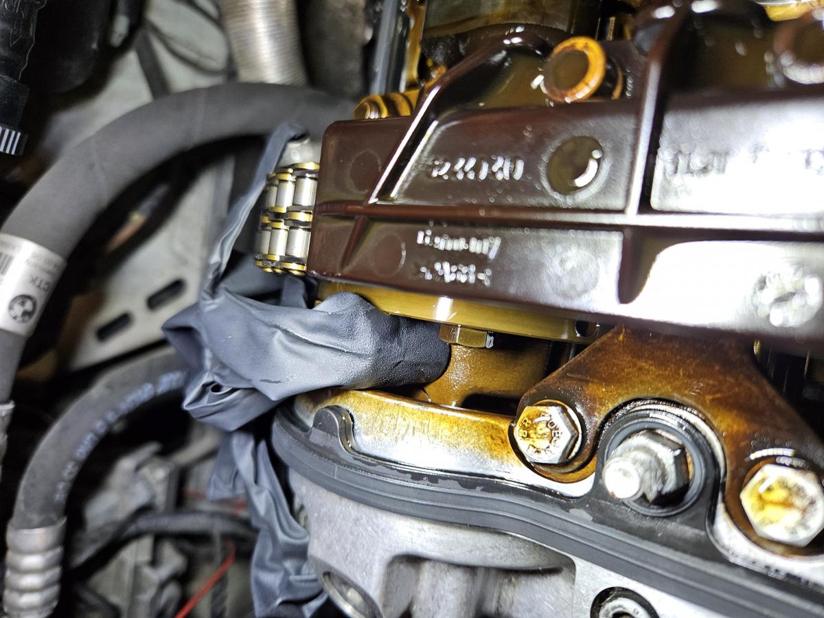

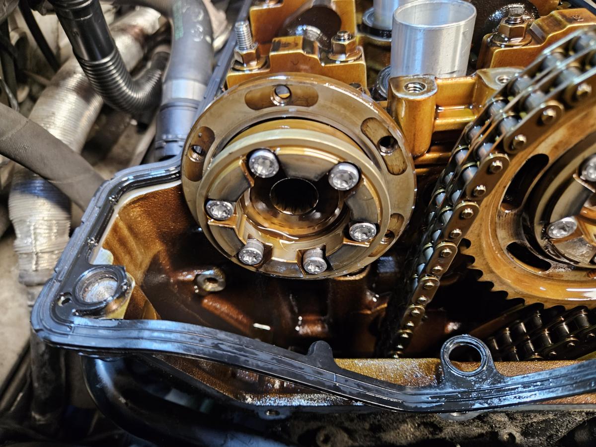

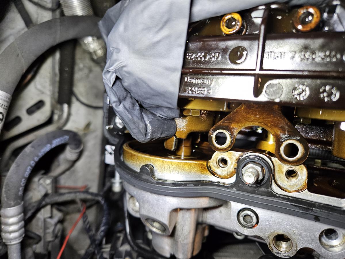

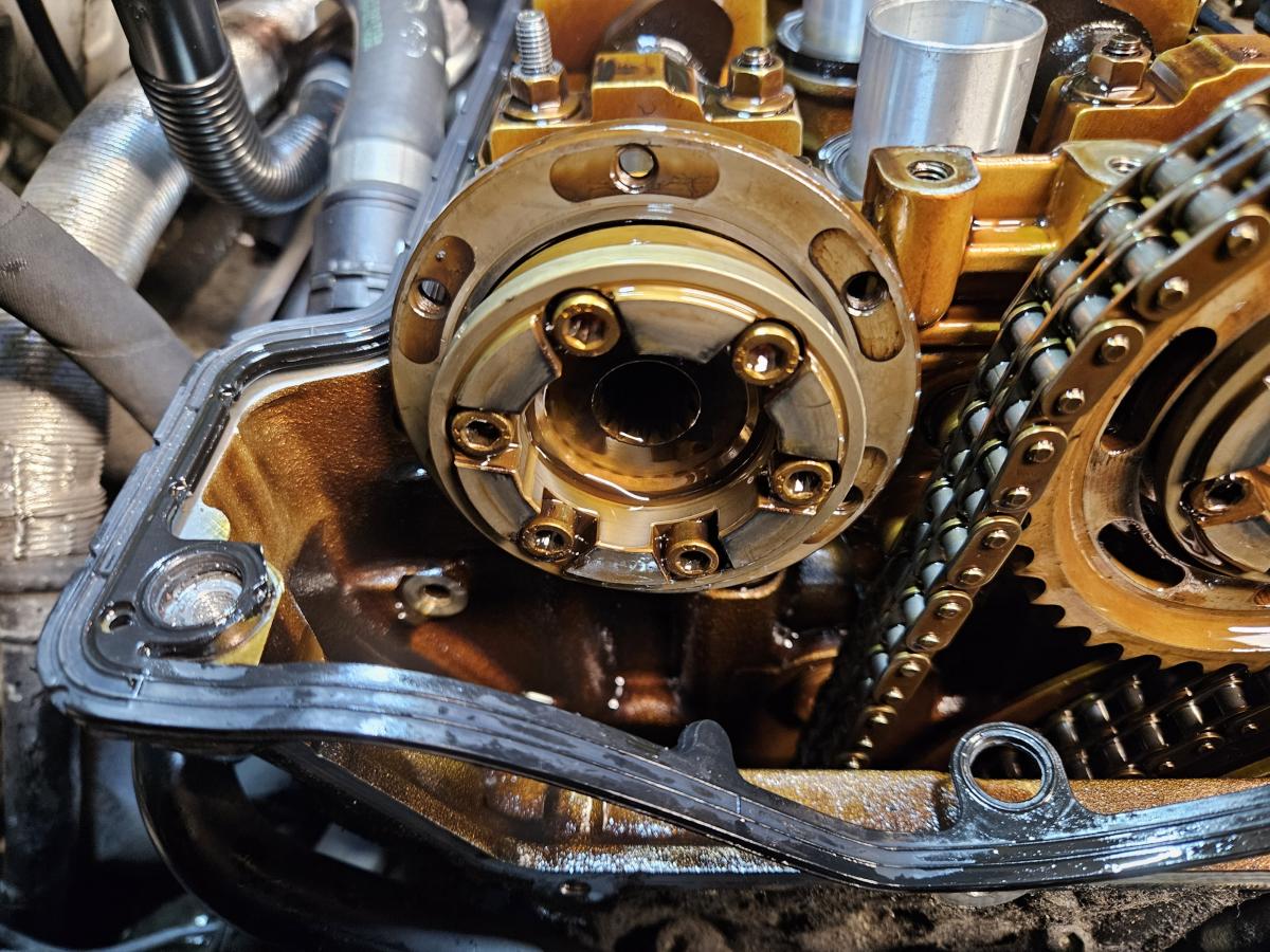

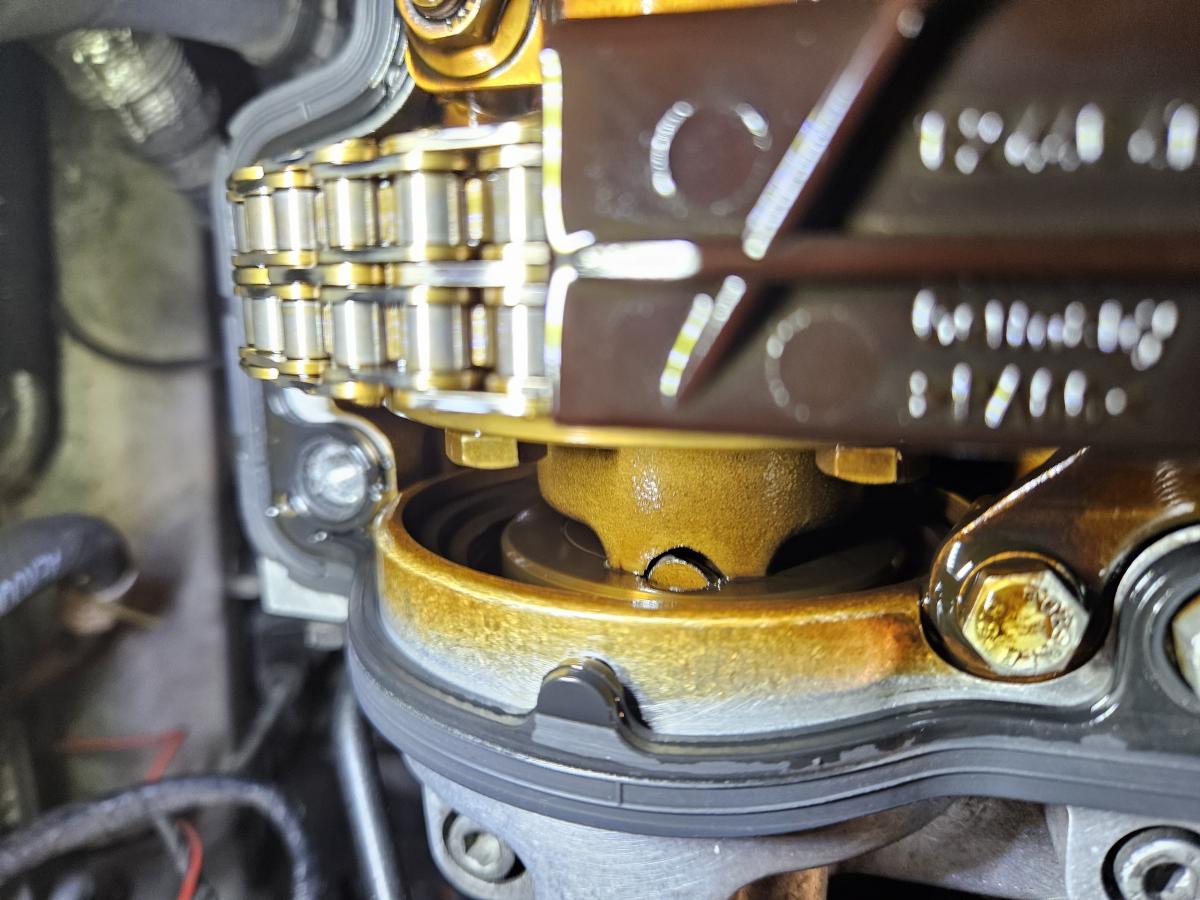

            I did also find a nice little surprise in the VANOS area:
            Click image for larger version  Name:	20240114_151403.jpg Views:	0 Size:	141.0 KB ID:	249477
            Only that one tab is broken and the broken part hasn't fallen out of the pump disc, so not a terrible outcome. Beisan hub and upper chain guide are on their way.
            I was originally planning on doing a valve adjustment along with the valve cover gasket, but I'll just do it when I swap out the VANOS parts. I do have receipts for the VANOS seals, so I'm going to leave those alone.

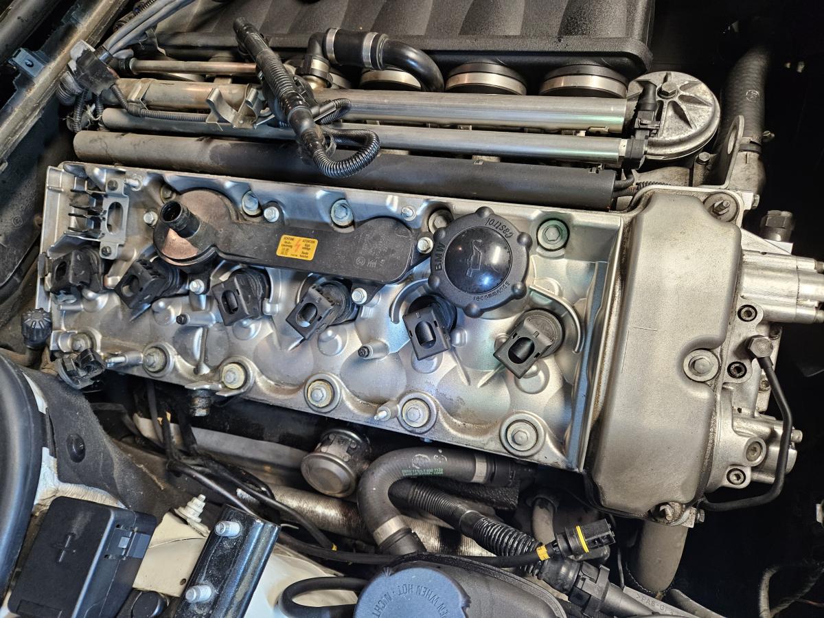

            Mating surfaces prepped, gasket maker added in the appropriate spots and new genuine gasket installed:
            Click image for larger version  Name:	20240114_155307.jpg Views:	0 Size:	206.1 KB ID:	249479

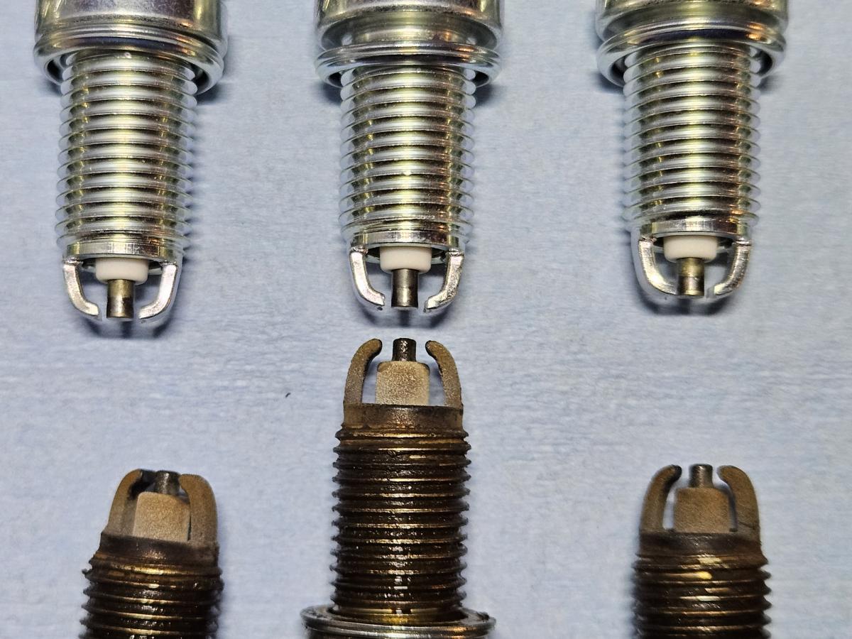

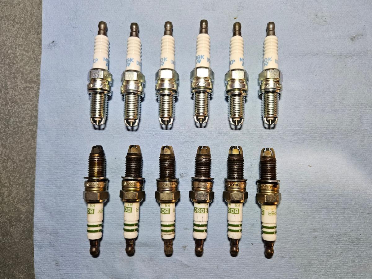

            Next up, the spark plugs. Looks like the correct type was used, but they were Bosch not NGK:
            Click image for larger version  Name:	20240114_162038.jpg Views:	0 Size:	183.1 KB ID:	249480
            Was definitely time for new ones:
            Click image for larger version  Name:	20240114_162208.jpg Views:	0 Size:	154.1 KB ID:	249481

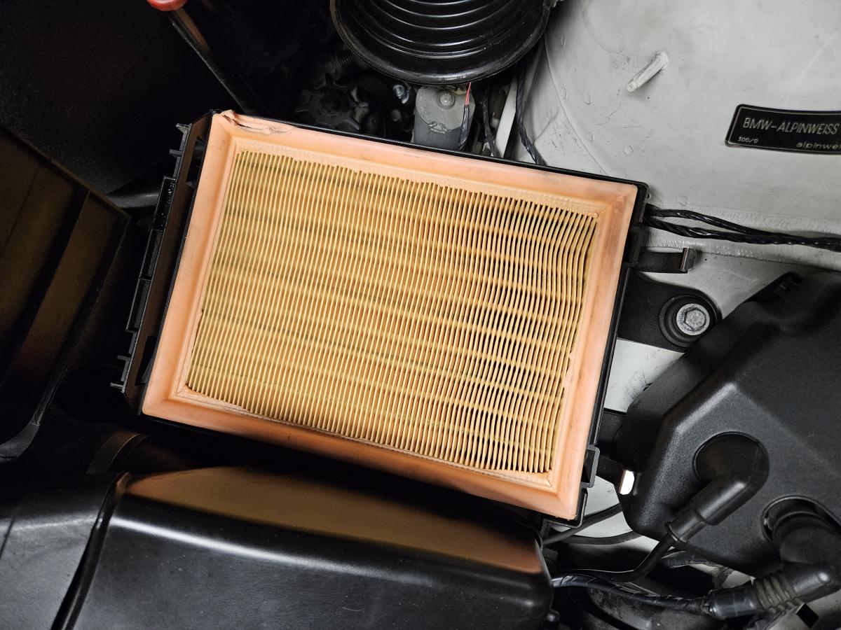

            Broken engine air filter removed:
            Click image for larger version  Name:	20240114_164823.jpg Views:	0 Size:	160.9 KB ID:	249483

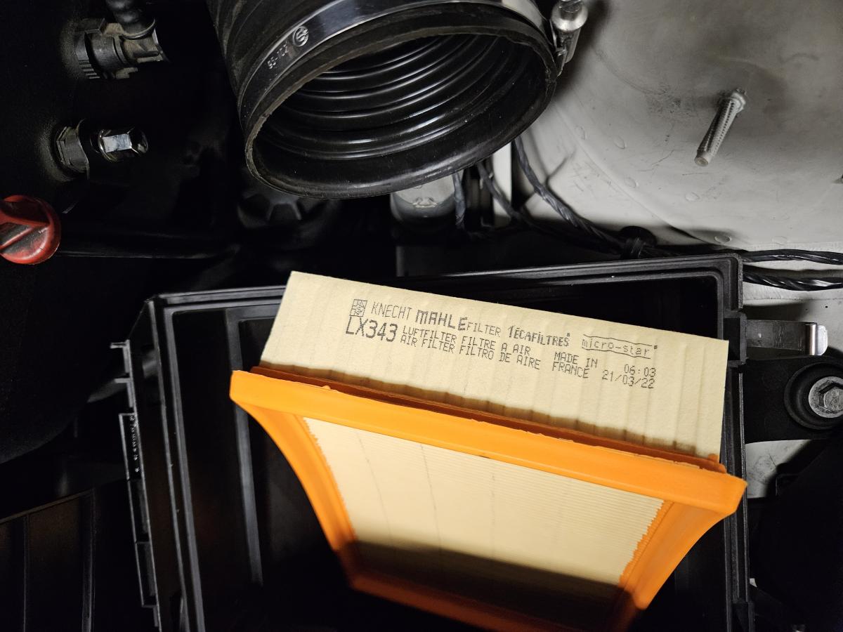

            And new Mahle filter to replace it:
            Click image for larger version  Name:	20240114_164900.jpg Views:	0 Size:	105.7 KB ID:	249484

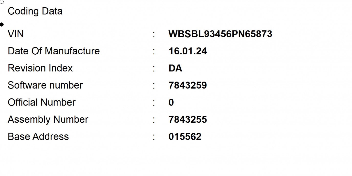

            Lastly, I went to flash the SMG ECU with the CSL software aaand bricked it during the flash. For some reason, the WinKFP install I was running on my usual BMW VM was dropping communications with the module halfway through flashing. I was still able to communicate with the module, but it would not control the transmission. I fired up another WinKFP install and was able to successfully get through the flashing with that:
            Click image for larger version  Name:	Screen Shot 2024-01-16 at 6.02.50 PM.png Views:	0 Size:	414.6 KB ID:	249485
            Also modified the DME tune with the CSL tables by following this thread: https://nam3forum.com/forums/forum/s...parameters-dme No issues there.

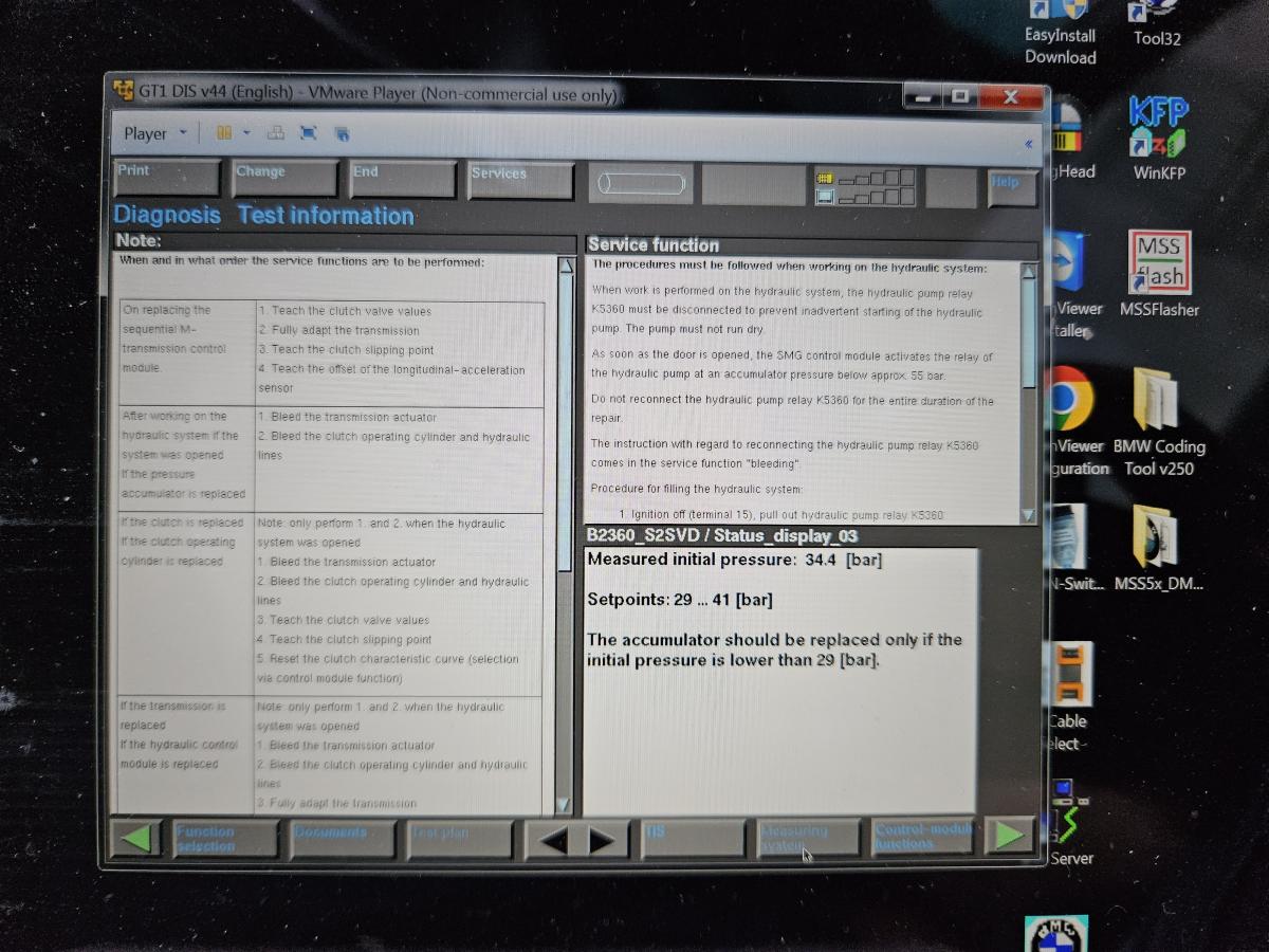

            And since I had the laptop out, I opened up DIS and poked around to see what routines were available for the SMG. Did a bleed of everything, relearned the clutch bite point and checked the accumulator health:
            Click image for larger version  Name:	20240116_154924.jpg Views:	0 Size:	150.3 KB ID:	249486
            Everything seems to be working well!

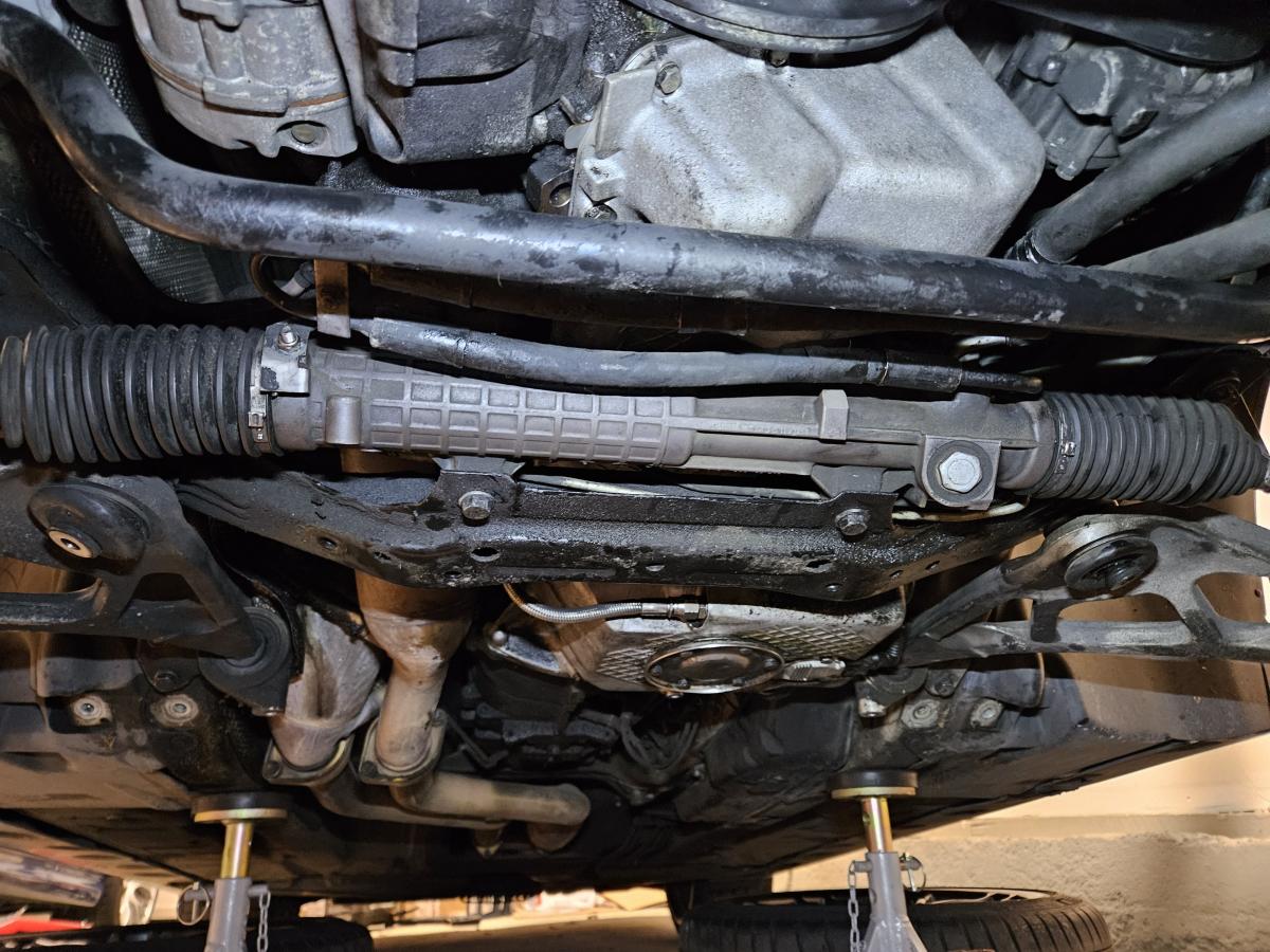

            Oh, I did also find this gift wedged between the front subframe and steering rack:
            Click image for larger version  Name:	20240114_181549.jpg Views:	0 Size:	99.0 KB ID:	249487
            Always a fun surprise.

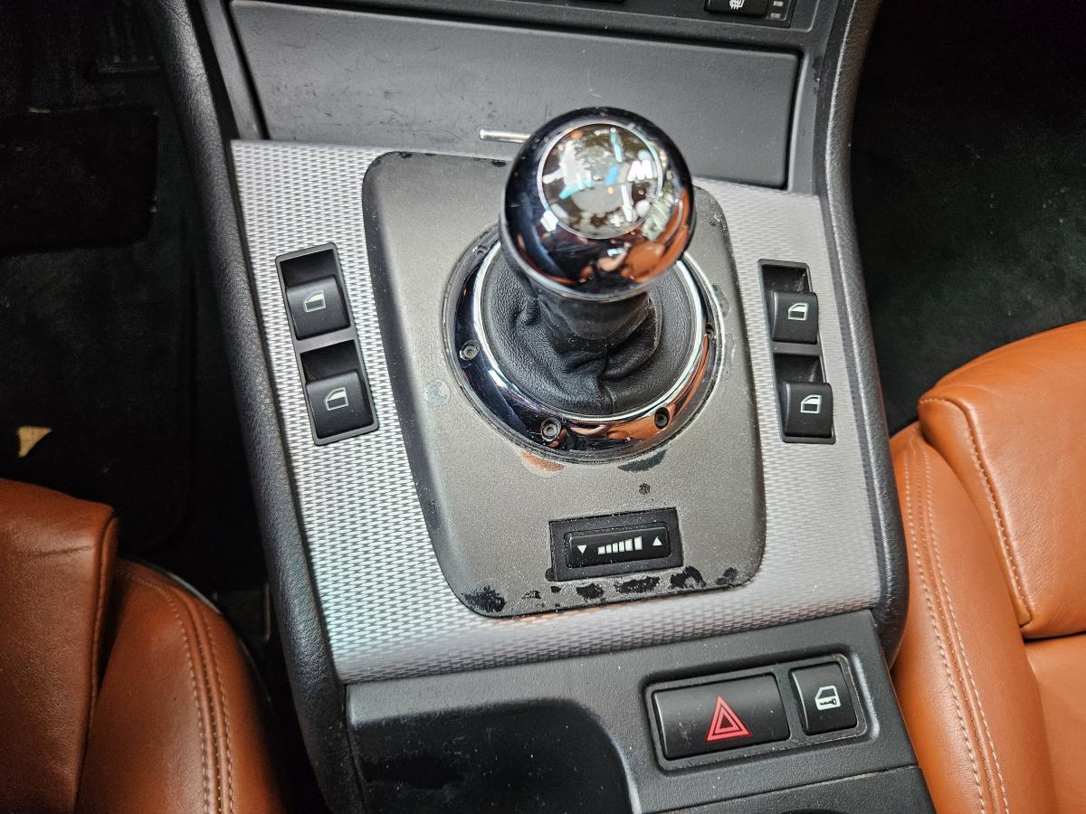

              Both airbags replaced this morning under the recall. Feels nice to have a brand new driver's airbag:

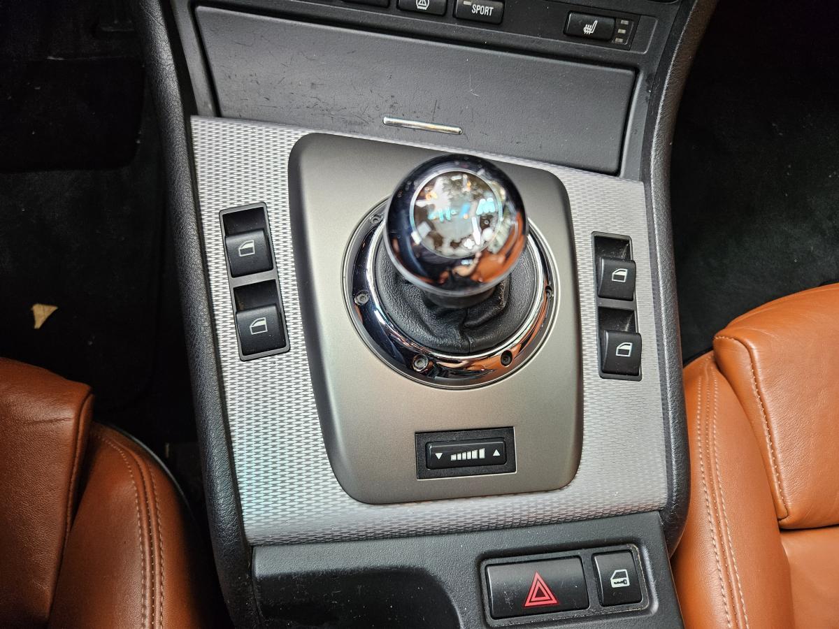

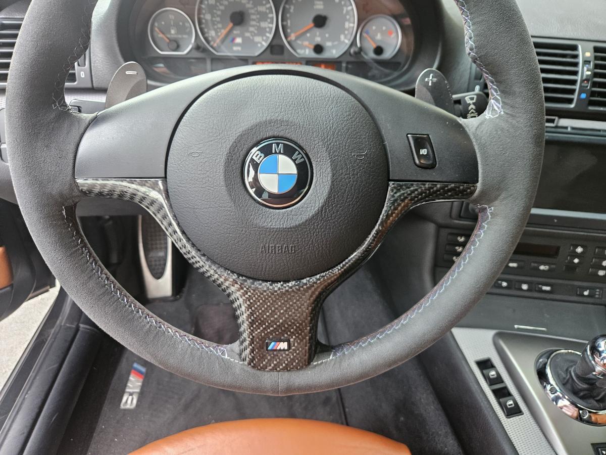

              Also replaced the old SMG trim. It was destroyed cosmetically and the tabs weren't holding it in place very well:
              Still need to give this interior a much more thorough clean, but it's looking better than before.

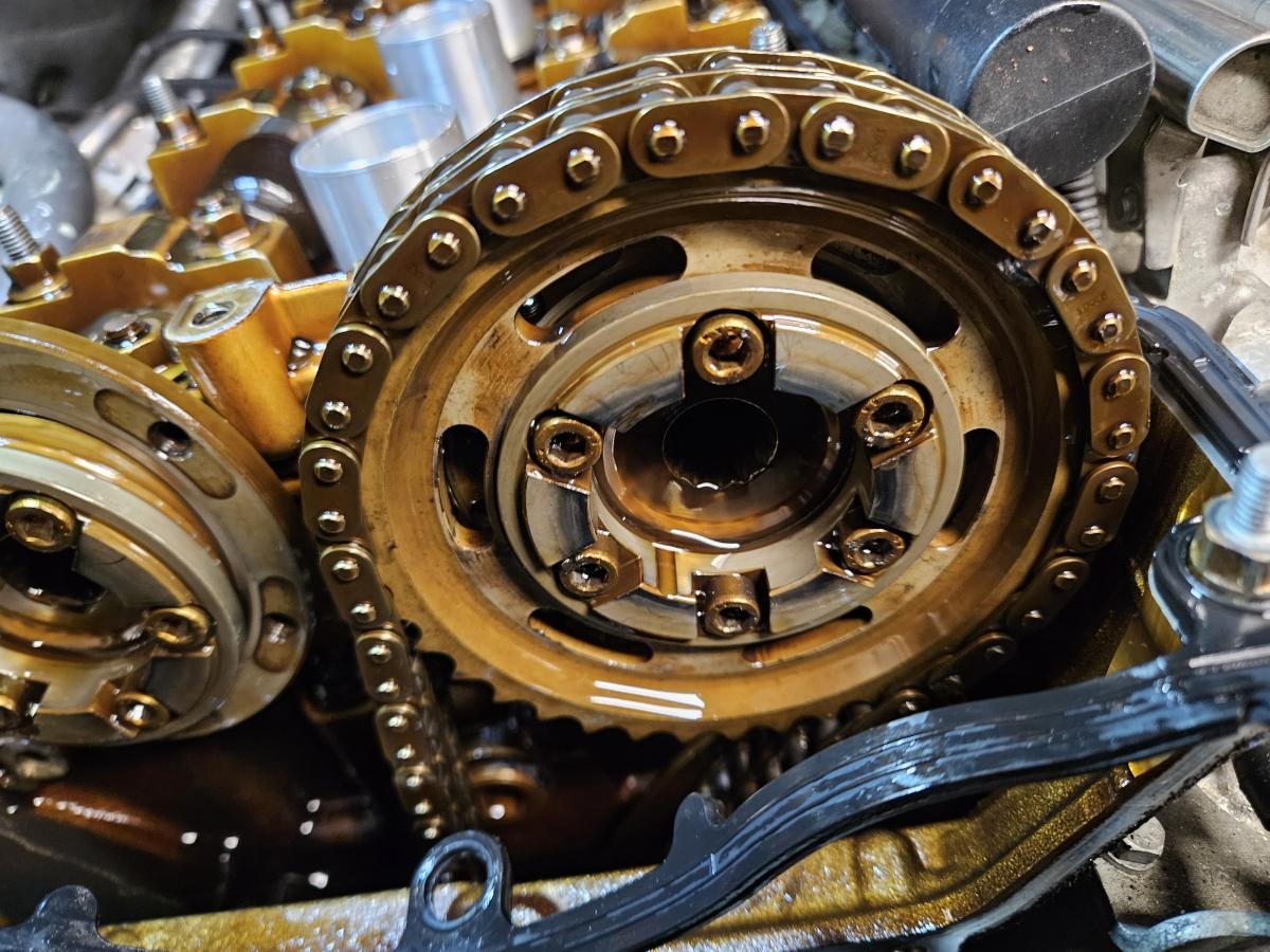

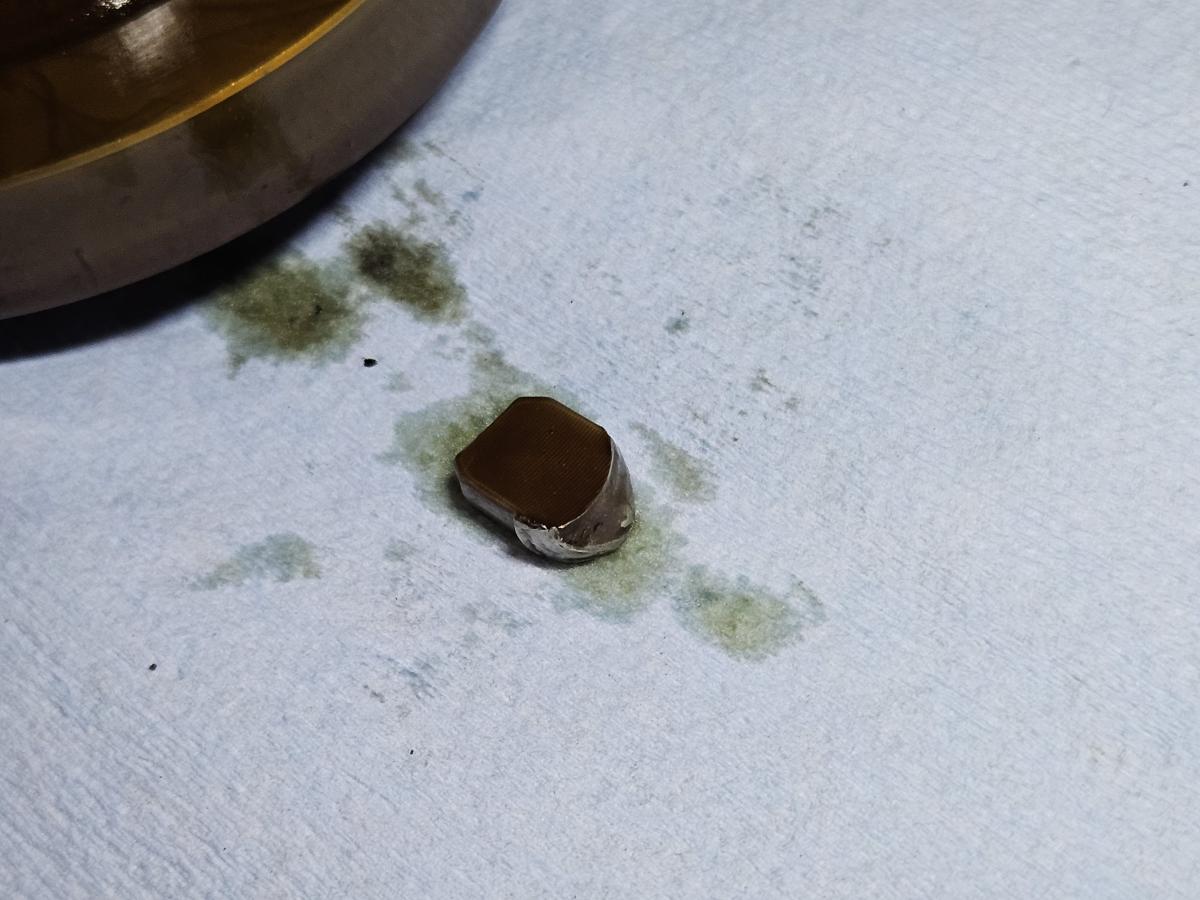

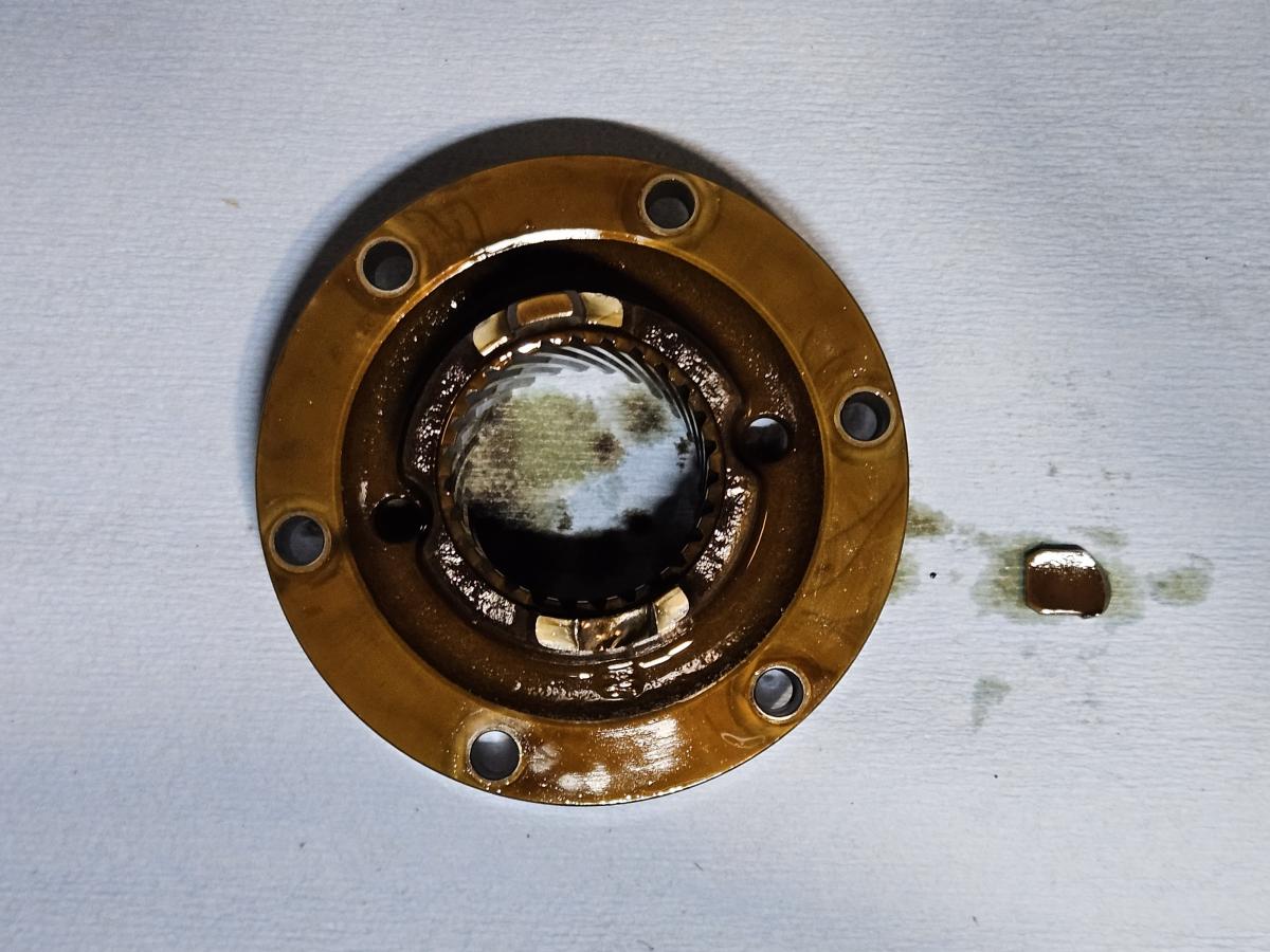

                  Started on the last bit of engine maintenance today. First up was getting the VANOS off without dropping the tab into the oil pan. This is what the broken tab looked like when I opened the valve cover:
                  If you compare the orientation of the tab to the previous pic I posted, it's pretty clear that the thing was moving around a lot. I don't think it had enough space to fall out, but I'm glad I'm taking care of it now. Would have sucked if that thing fell out and got stuck in the timing chain.
                  Before removing the VANOS, I stuck a powerful magnet on the hub just to make sure the tab didn't fall down:
                  Worked great!

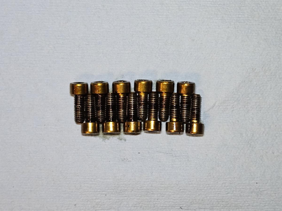

                  With that removed, I turned to the cam bolts. This is what they looked like:

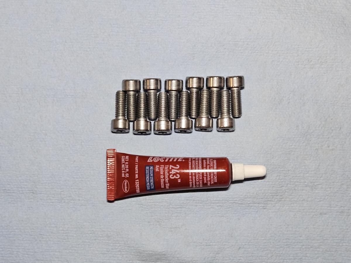

                  Nothing out of the ordinary, really. All bolts were still torqued to spec and were showing no signs of failure. I did go ahead and replace them anyway, since I had the parts.
                  New torx bolts installed with 243 loctite:

                  This is what the old ones looked like. Completely fine:

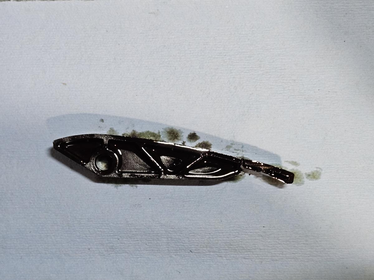

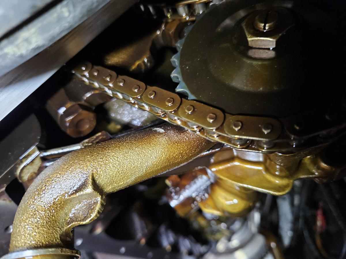

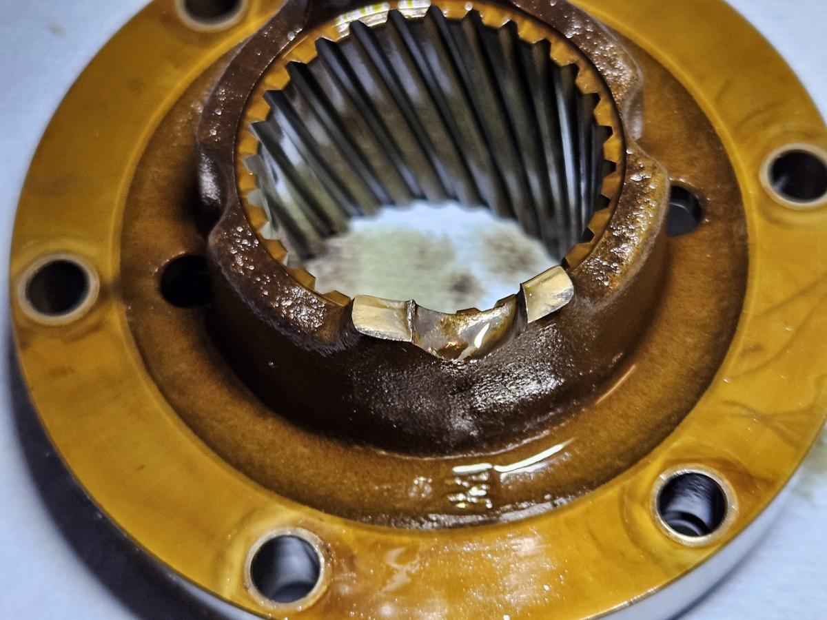

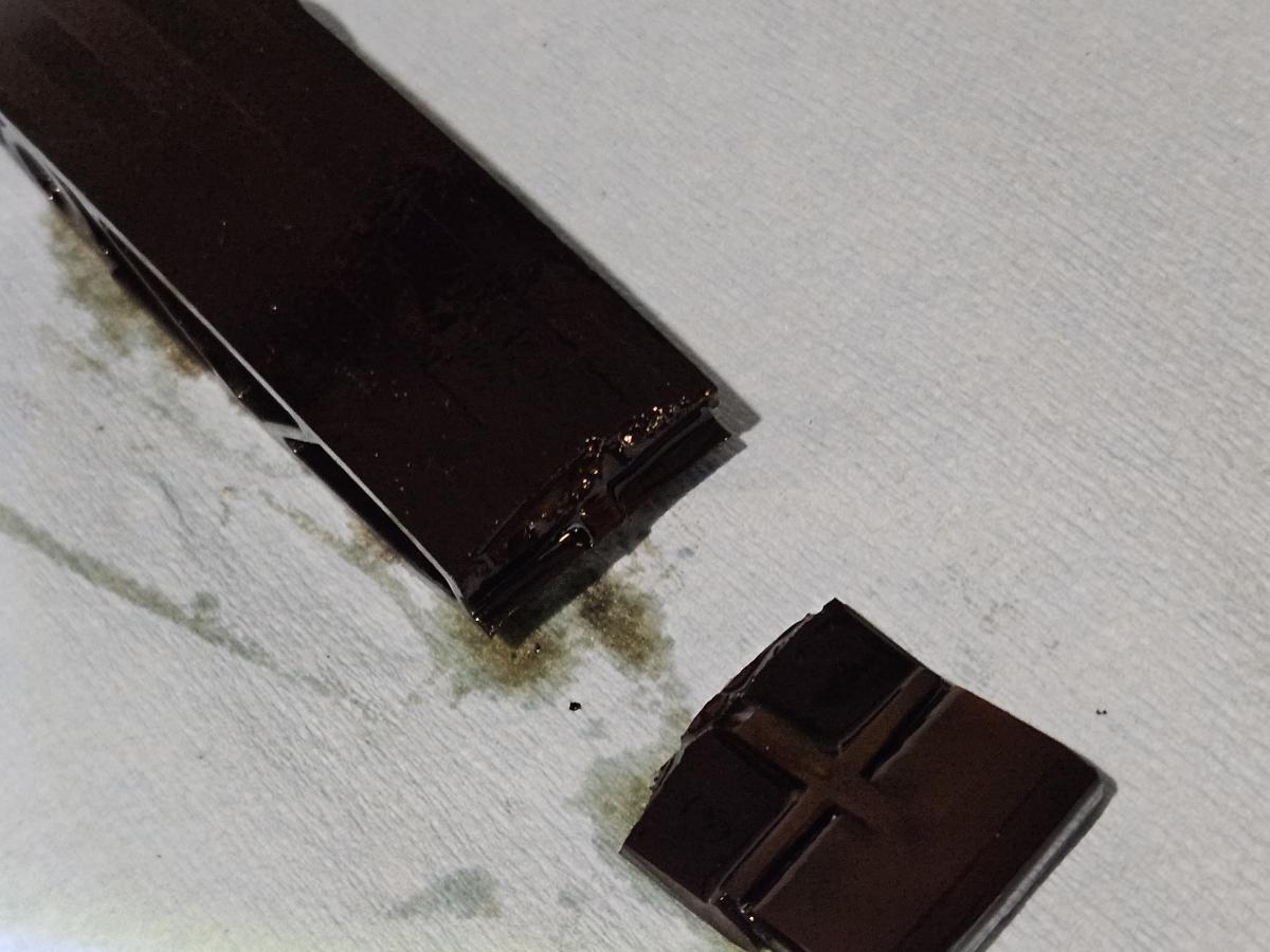

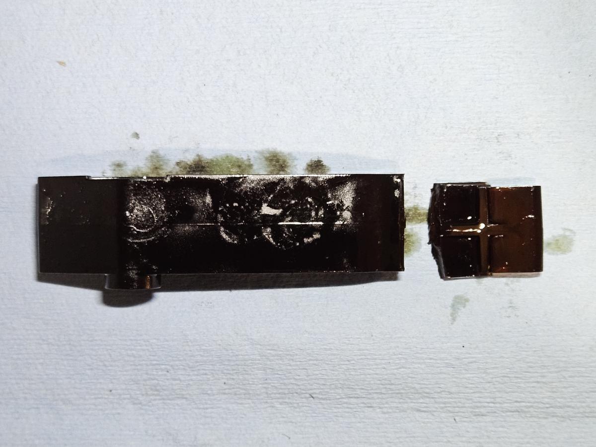

                  Next came the upper chain guide. I just assumed it would be broken in half, so I ordered a Beisan one. This is what it looked like when it came out:
                  Pretty much exactly what I was expecting.

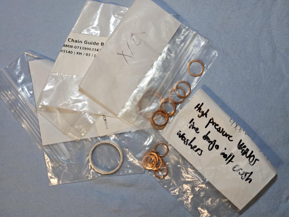

                  It was at this point that I realized I completely forgot to order a bunch of crush washers for when it came time to put all of this back together. Felt pretty good to dig through my stash of S54 parts and find everything I needed :

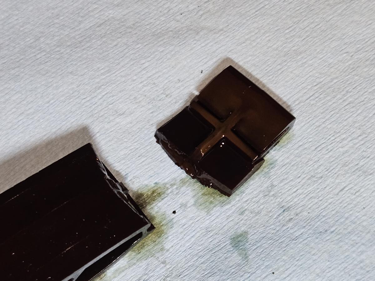

                  And lastly here's some close ups of the VANOS hub failure:
                  I'll be putting everything back together tomorrow. Will throw some more picture up on here showing how that goes.

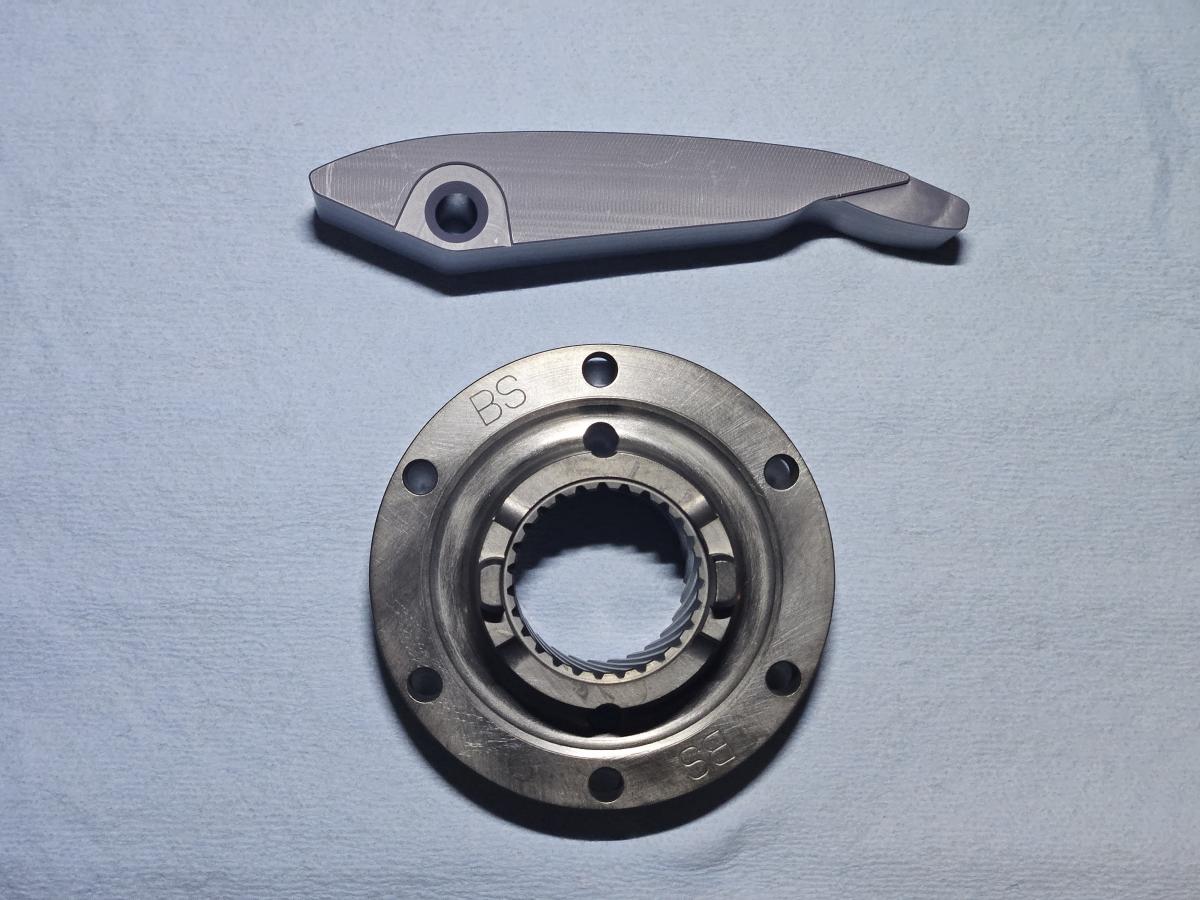

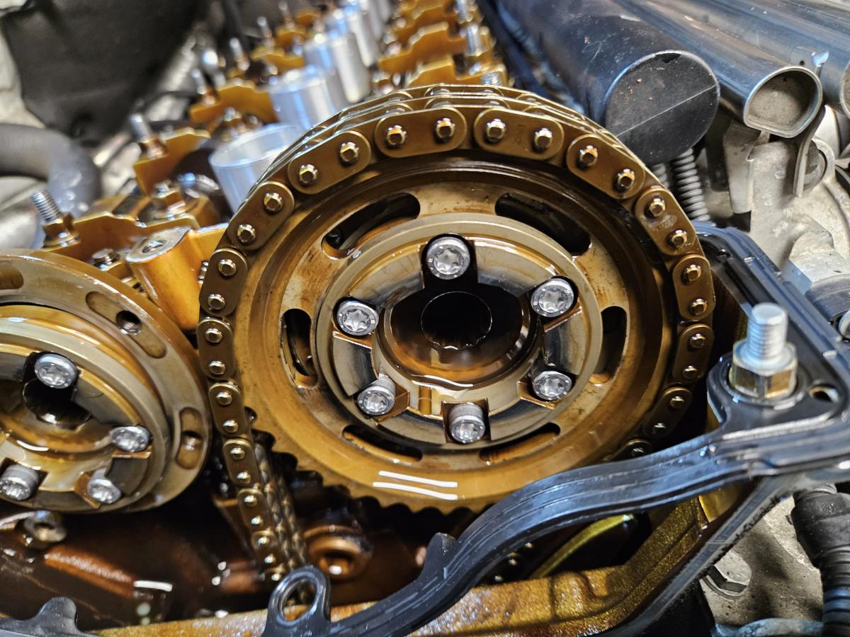

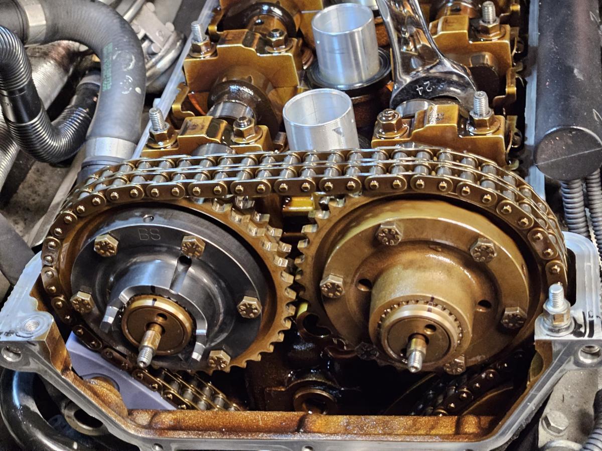

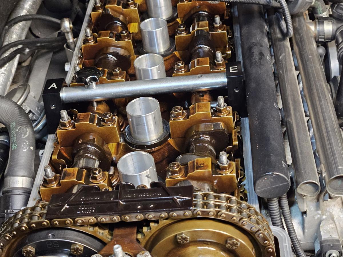

                          Beisan parts installed:
                          Click image for larger version  Name:	20240120_234720.jpg Views:	0 Size:	131.5 KB ID:	250281
                          Click image for larger version  Name:	20240121_145044.jpg Views:	0 Size:	192.4 KB ID:	250282
                          Click image for larger version  Name:	20240121_162837.jpg Views:	0 Size:	203.9 KB ID:	250283

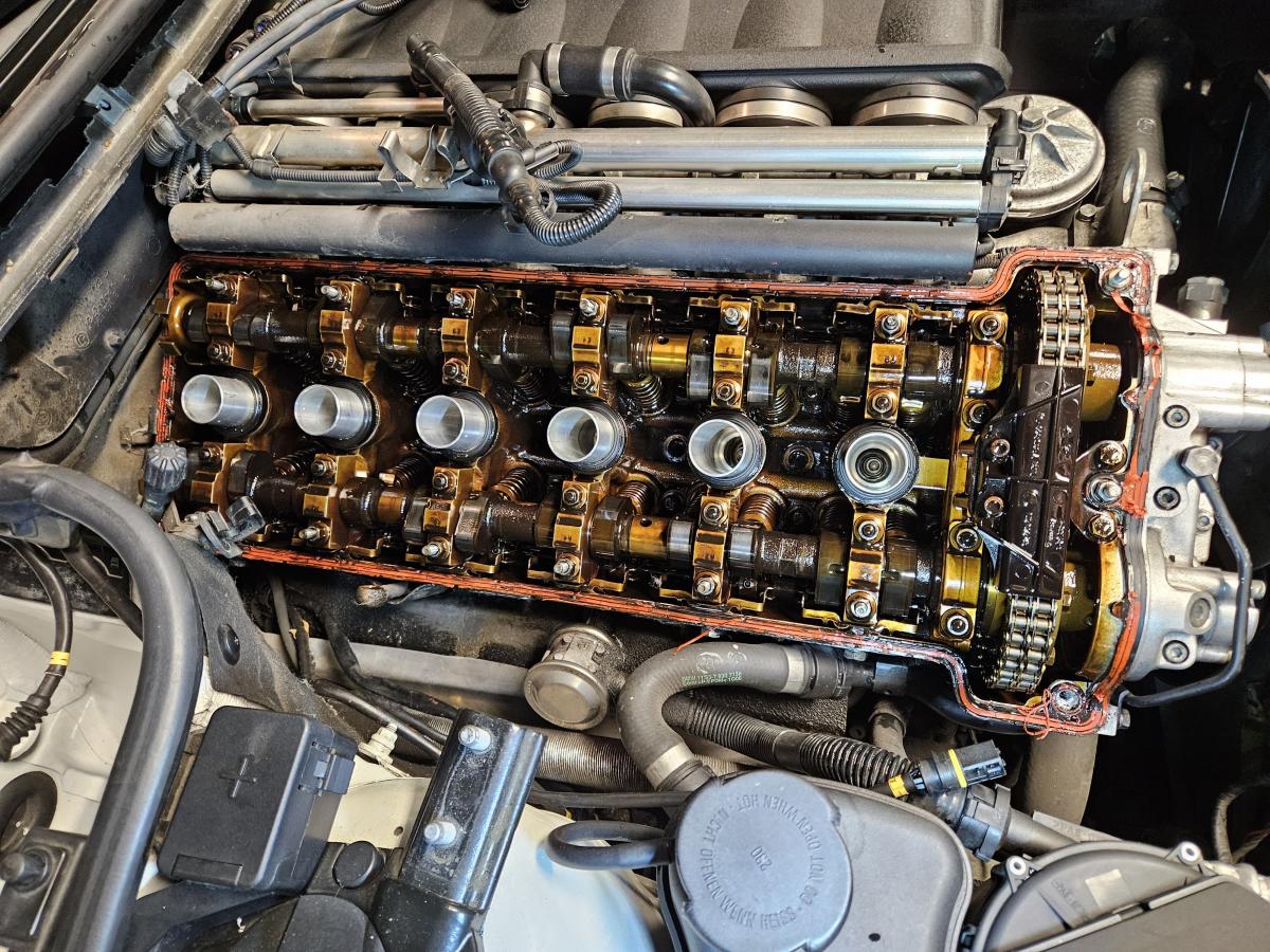

                          Engine retimed:
                          Click image for larger version  Name:	20240121_175830.jpg Views:	0 Size:	194.1 KB ID:	250284
                          Click image for larger version  Name:	20240121_175847.jpg Views:	0 Size:	196.4 KB ID:	250285

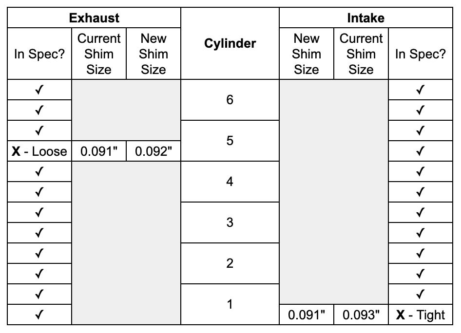

                          And valve adjustment complete. Here's a transcription of the notes I scribbled down while doing it:
                          Click image for larger version  Name:	Screenshot 2024-01-22 at 12.00.51 AM.png Views:	0 Size:	39.7 KB ID:	250286
                          The fact that only two were out of spec —combined with the crazy amount of RTV that I found when I first opened up the valve cover— makes me think that the valves were adjusted relatively recently. No complaints from me though! Made this a pretty quick job.
                          Car is put back together, but I didn't have a chance to take it for a test drive. Will do that soon just to make sure everything is working well.
                            I’m going through the same maintenance. 110k miles on my LSB and my bearings were toast. Like you, my clearances were all in spec. I went with VAC bearings and ARP bolts.
                              Wow yeah those are worse than the ones that came out of this car. Was your car ever driven in a cold climate?
                                Long history in Texas - I was surprised at the conditions and thought how lucky I was after driving it about 500 miles from purchase. I’ve finished the subframe reinforcement and the front mounts under the seat has minor cracks in the factory spot welds. Someone did the Vanos and hubs but it looks like the tensioners are stock. Crazy to go that far and not upgrade like you did.
