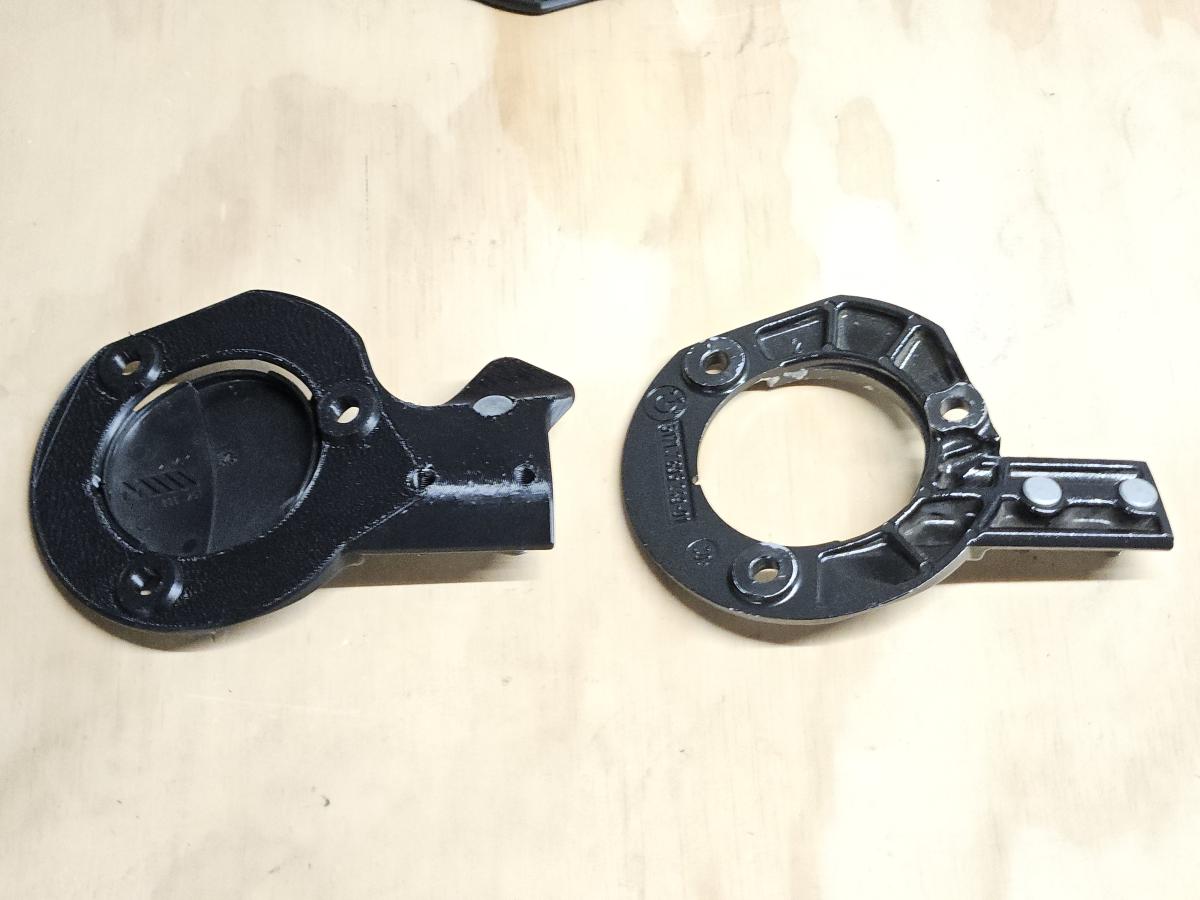

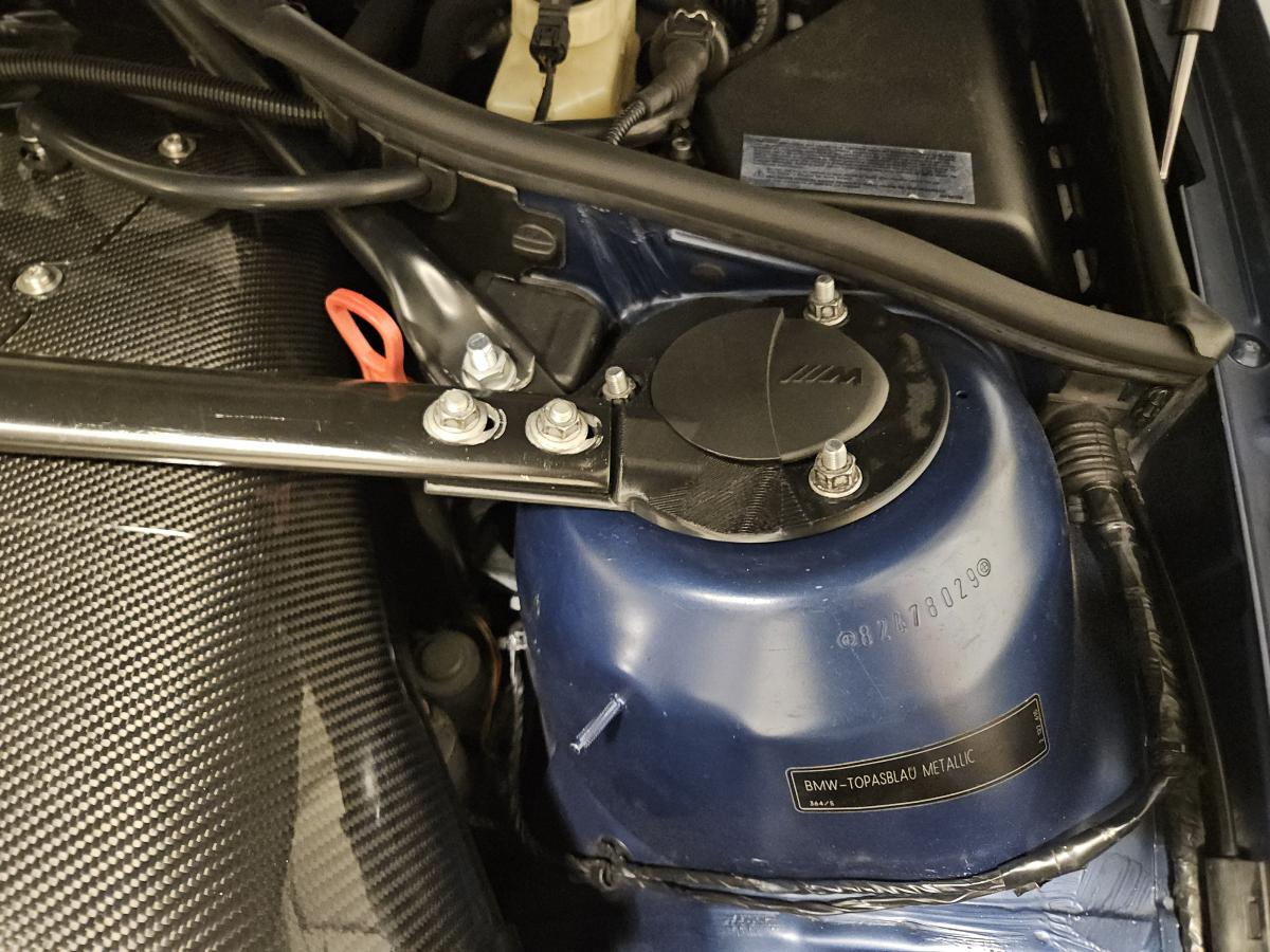

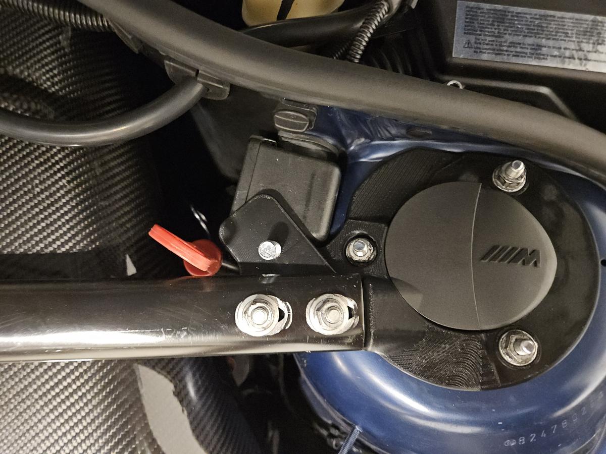

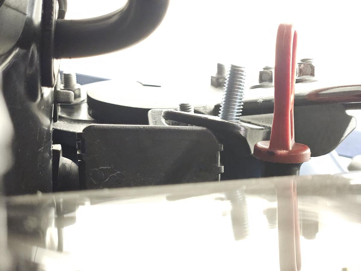

    This is getting exciting. Printed out a prototype in plastic to check basic geometry and clearances.

    I gotta say, even this early prototype is looking amazing. Clearances still as tight as before, but everything fits just fine.
    Eagle eyed viewers might notice that this is actually a right side bracket (with the clearance for the positive terminal) that's been mirrored over to look like a left side bracket. Wanted to get a feeling for the thickness of the bracket in the area around the positive terminal and at the same time wanted to check clearances against the engine wiring harness box. Doing it this way meant I only had to print out one prototype.
    Worth throwing a pic of the other side up for comparison, soo much worse:

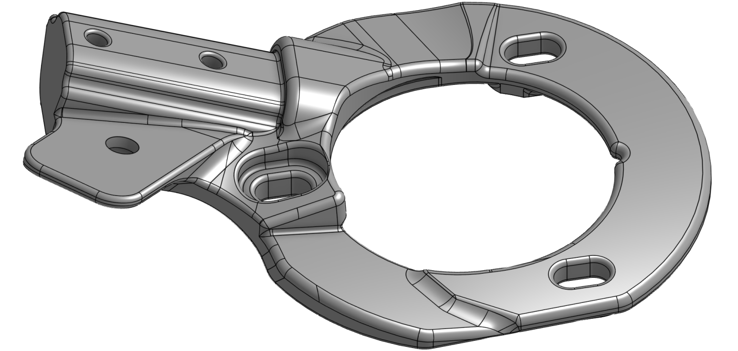

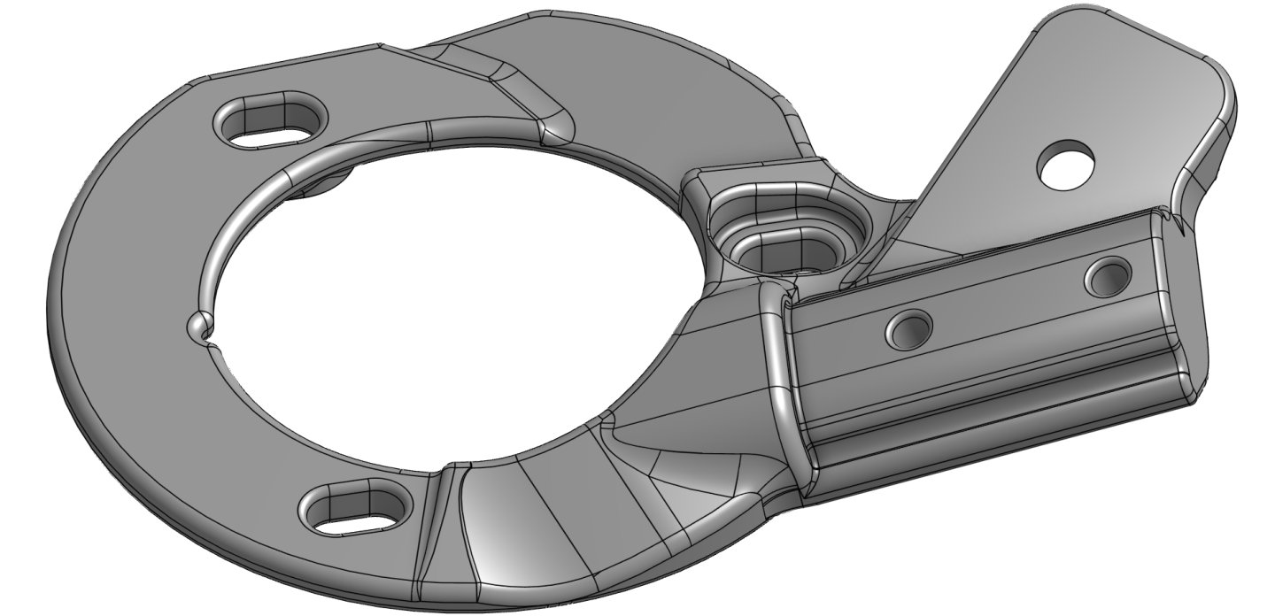

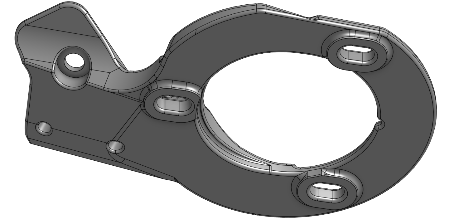

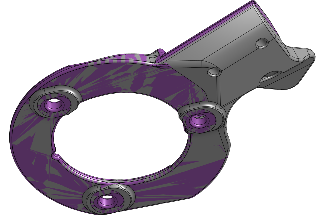

    Here's some pics of the mostly-final CAD. Biggest difference is that the holes for the top hat studs are now slotted so that the top hat can move around for camber adjustments and the strut tower brackets can stay in place:

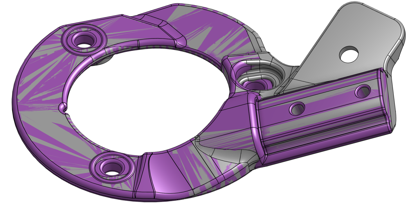

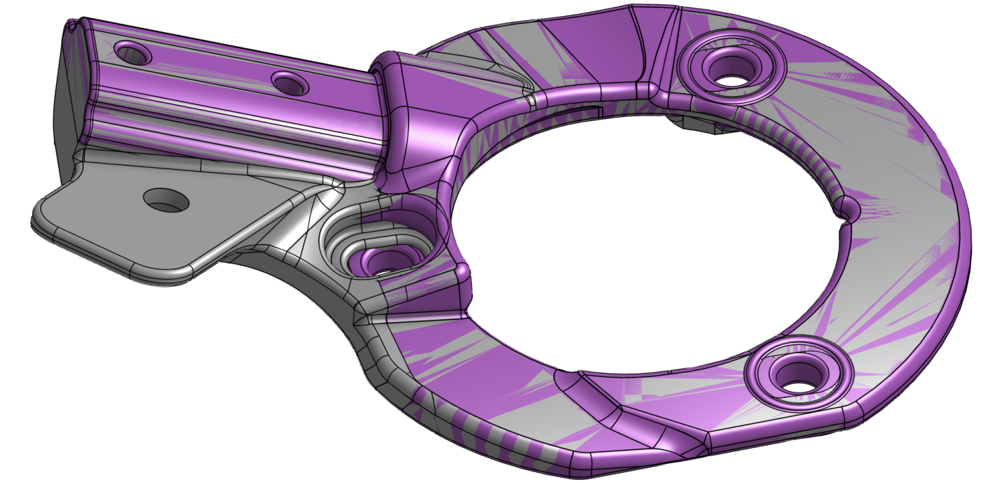

    Same pics, but this time with the stock part (purple) overlayed for comparison. Gives a good sense of where I added material to take the extra loads:
    Eagler eyed viewers might notice that this version does not have the "ridges" around the rearmost stud holes for the nuts to sit in. I tried including them for max stock-ness, but the slotted geometry means they interfere with the center "///M" trim piece, so will have to go without them
    Next up is printing another prototype to test the slots and running a bit of FEA as a sanity check.
    I also want to try extruding the bottom surface down to get rid of the bosses and make the part totally flat underneath. Not sure how well this will work with the existing geometry, but we'll see.

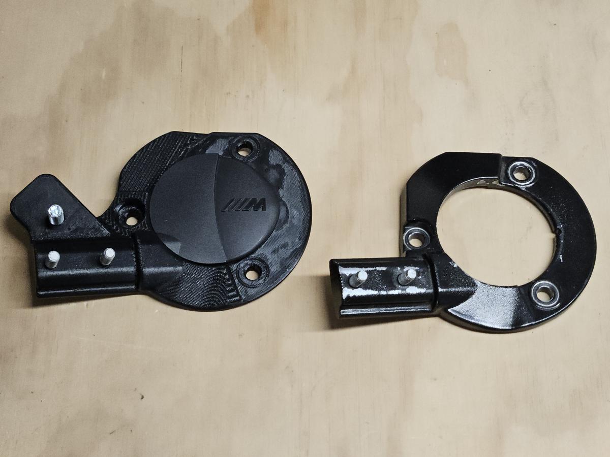

        I'm liking how the "no bosses" versions turned out!

        And then I might have gotten a little carried away...

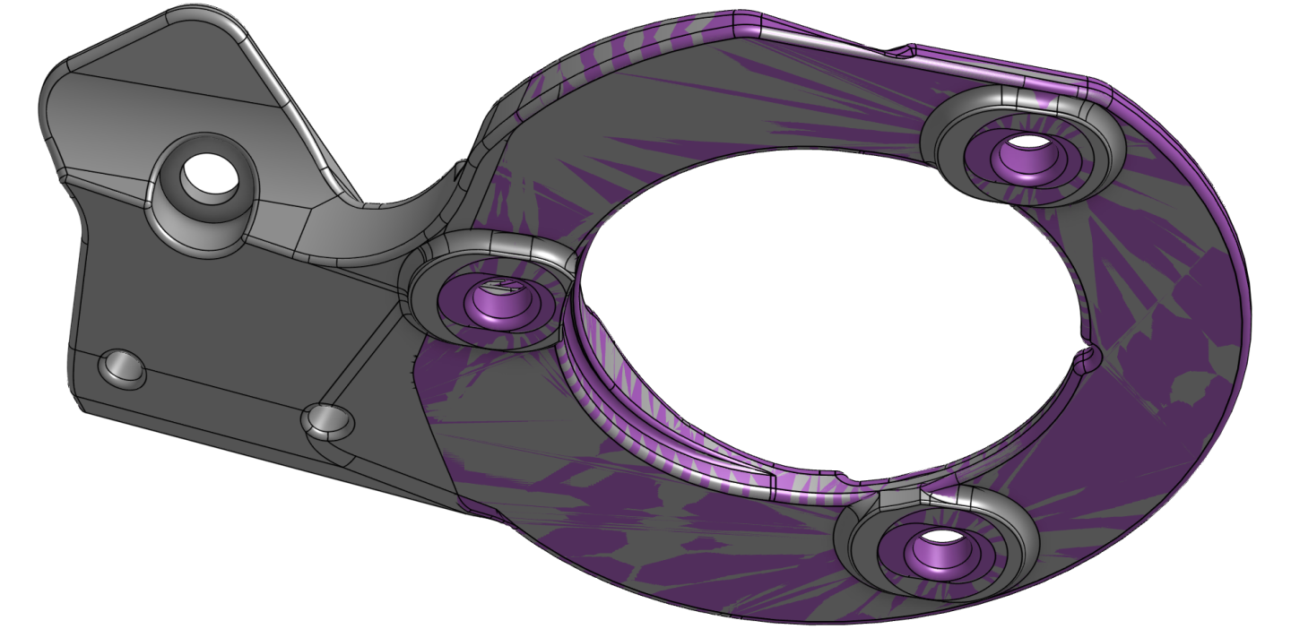

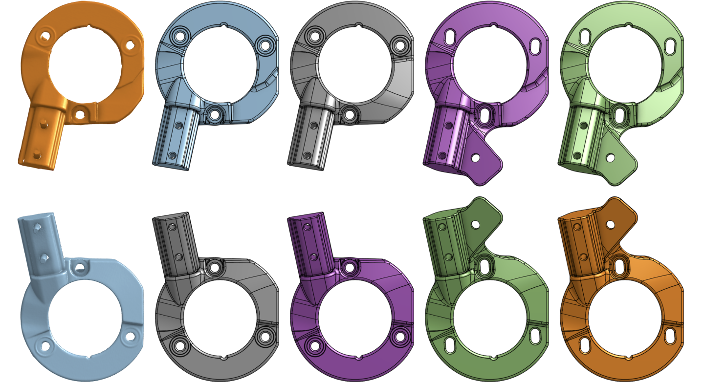

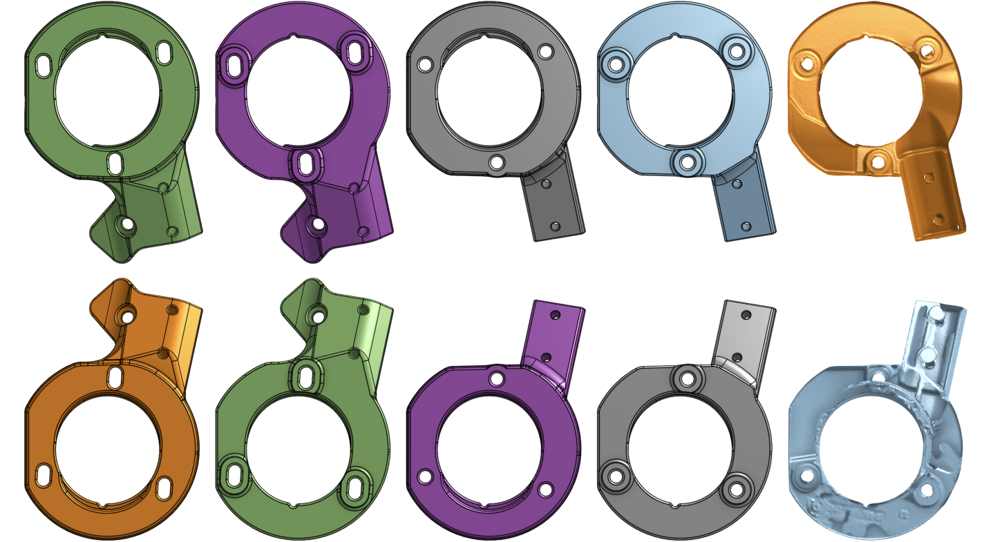

        From left to right:
        1. Scans
        2. Stock recreations
        3. Stock recreations, bosses replaced with a flat surface
        4. Modified with E86 pickup points and slots
        5. Modified with E86 pickup points, slots and bosses replaced with a flat surface
        Here's the bottom of all of them, for completion:

        Yes, I know, making the "no bosses" version of the stock brackets is completely useless for this project, but I had all the geometry right there! A few booleans, some cleanup and done. Couldn't help myself.
        Cubieman FYI, since I think you were looking for something like (3) above?
          This is great, flat stock brackets would be great, I would love some of those!!
          Just as long as the bar would still clear, I'll do some measurements to get a rough idea.
          I don't have any information to prove otherwise but I would think the completely flat surface would protect the towers better than the OEM setup with the much smaller surface area.

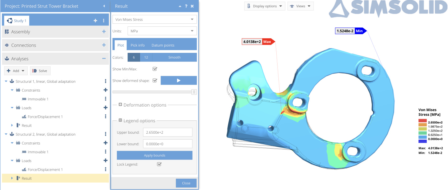

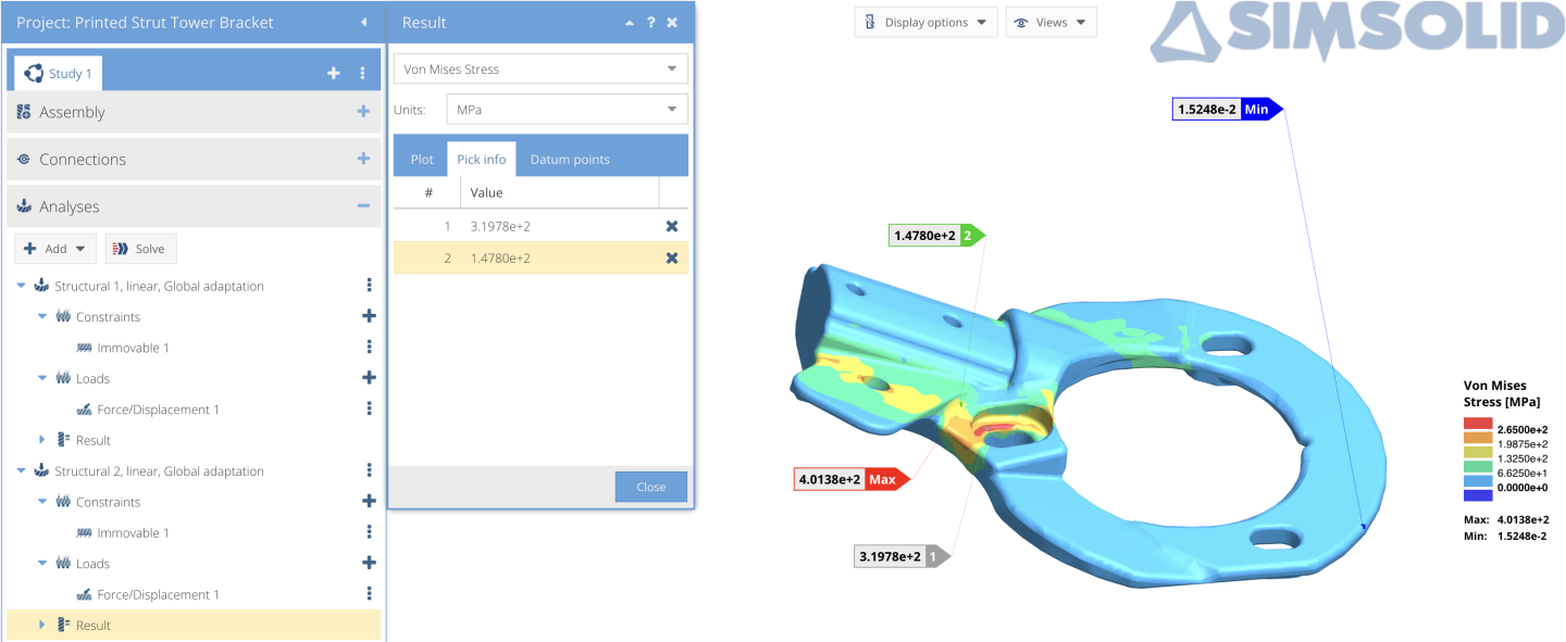

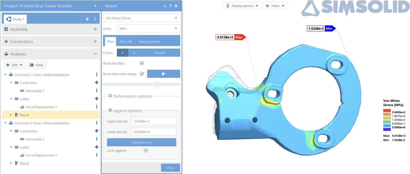

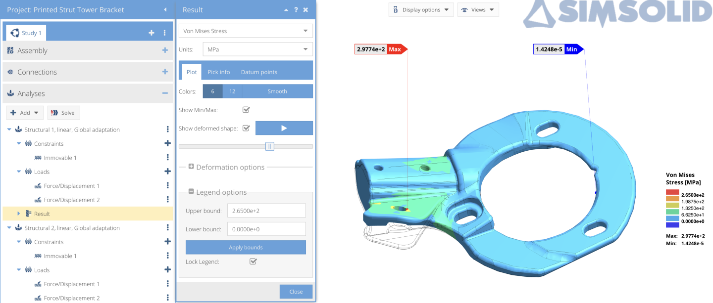

            Aaaand FEA looks promising. Most manufacturers that can print AlSi10Mg quote around 270-290 MPa for yield strength. I don't know if I believe that? But that's what I've been seeing.
            Using that same 21 kN load as before, the analysis says that the "no bosses" part will see stresses that are right up there, but not past the upper end of the range, which is good!
            Brace in tension:
Name:	No Bosses Brace in Tension.png
            Brace in compression:
Name:	No Bosses Brace in Compression.png

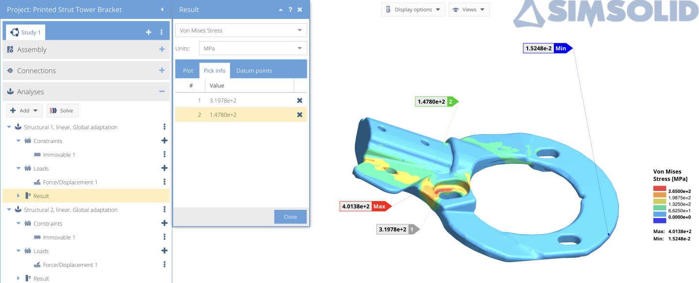

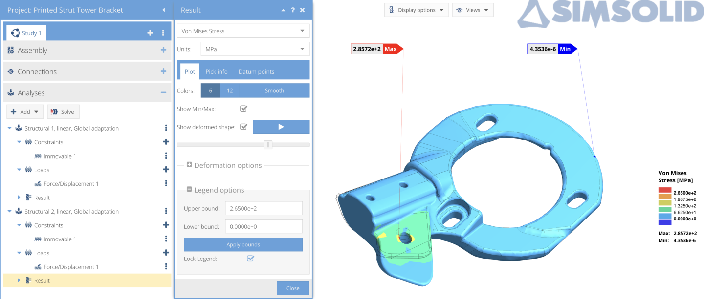

            As expected, the "bosses" version performs worse. There are a couple points where the stress exceeds the quoted yield strength, but the rest of the part is good.
            Brace in tension:
Name:	Brace in Tension Top.png
Name:	Brace in Tension Bottom.png
Name:	Brace in Compression Top.png
Name:	Brace in Compression Bottom.png
            Honestly not hugely concerned. The load that I ran the analysis with is the max load the part will see (since this is when the brace would buckle), so it's unlikely that the parts will be exposed to comparable loads during normal driving. I wonder if heat treating the printed part would help, but to be completely honest, I'm not gonna give it too much more thought, since I'll be using the "no bosses" version
            Worth noting that this is just the load from the E86 brace. I have absolutely no idea what loads the stock bar (between the towers) sees, so I threw the same 21 kN load on the top surface and reran the analysis on the "no bosses" version just to see what would happen:
Name:	Strut Bar Load.png
            Surprisingly, not a huge difference. Part displaces differently, but max stress is very close to the previous number.
            Now, the big question is fatigue. No good way to model this, but the mounts will eventually fatigue because they'll be made of Aluminum. It's just a matter of how fast that happens. Hopefully not until the end of the cars service life!
            I think it's time to stop messing around and just get these parts ordered. I'm running analyses with made up loads, which is unlikely to get me anywhere useful. Also, I've been thinking and, surprisingly, I don't think I care if these parts fail? They're dead easy to swap out, the price of manufacturing is super affordable and I've been dying to give metal 3D printing a shot. If they do fail, there's always CNC 7075 or printed Titanium

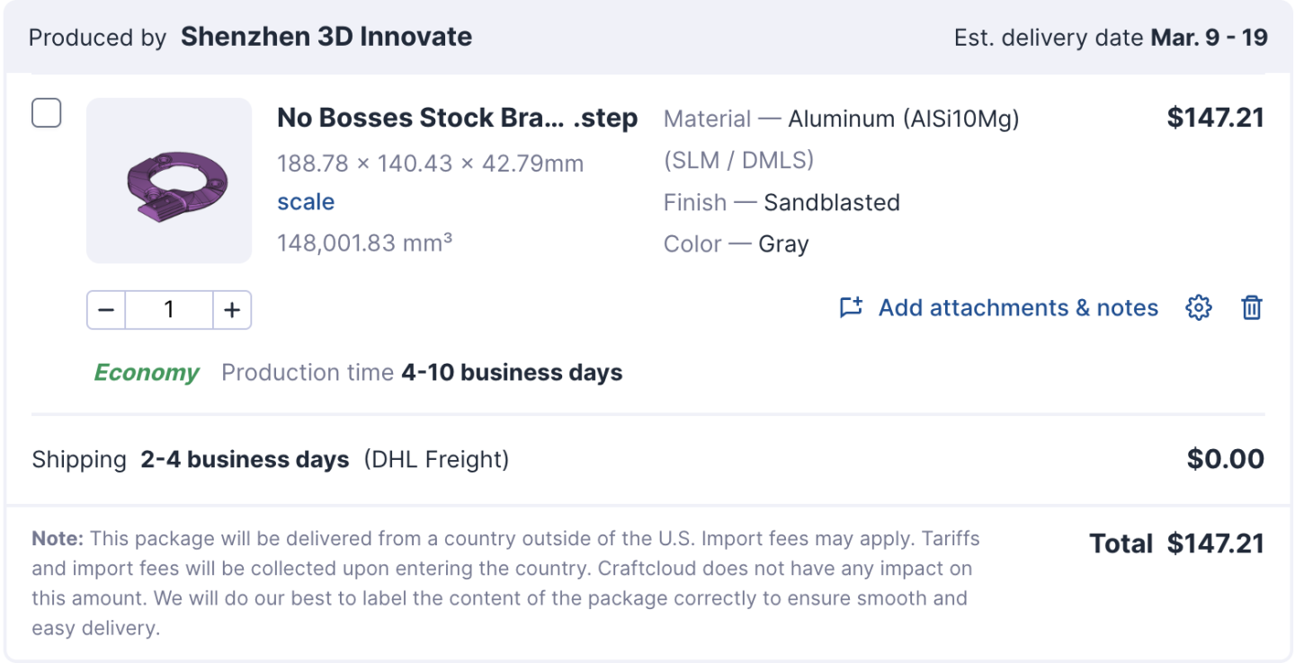

              Those brackets with the flat bottom are identical to stock, except for the flat bottom, of course. The bar will stay in the exact same spot where it is now, so should clear just fine!
              Let me know if you want the .step files. Looking like ~$150 per side for printing the flat bottom stock brackets in aluminum:

                      It is solid, no infill fanciness

                          Bummer. I wonder if I can model the infill in and have them manufacture it like that.
                          I could use a continuous volume infill like gyroid and add a couple drain holes to drain the powdered metal that will get trapped when printing.
                          Maybe I'm trying to approach the problem in too much of an FDM way and I should just do pockets instead? I don't know.
                          I'll give the modeled gyroid infill strategy a shot just cause it sounds novel and neat. Will report back once I've given up and decided to go back to the tried and true weight saving strategies.
