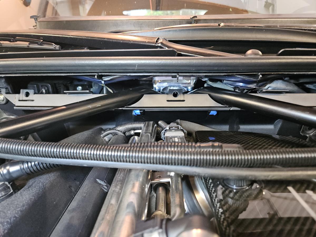

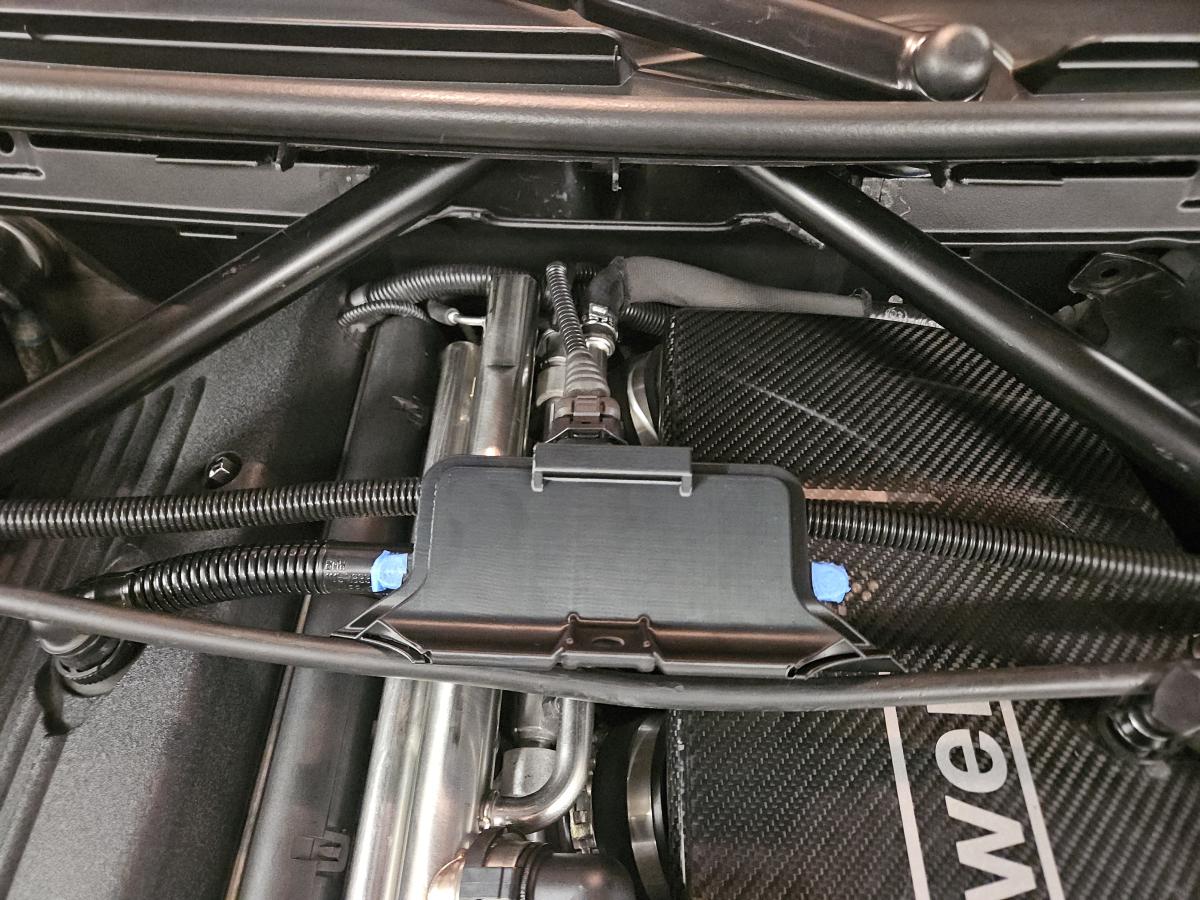

            Really happy with the design of the firewall plug insert. Prototype fits great and the magnets make it snap right into place, can almost just throw it on and it'll go where it needs to:

            (tape is only there to hold the magnets in place, didn't want to glue them to the prototype)

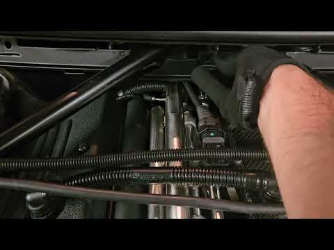

            Quick video showing how careless you can be when installing, it's pretty great:

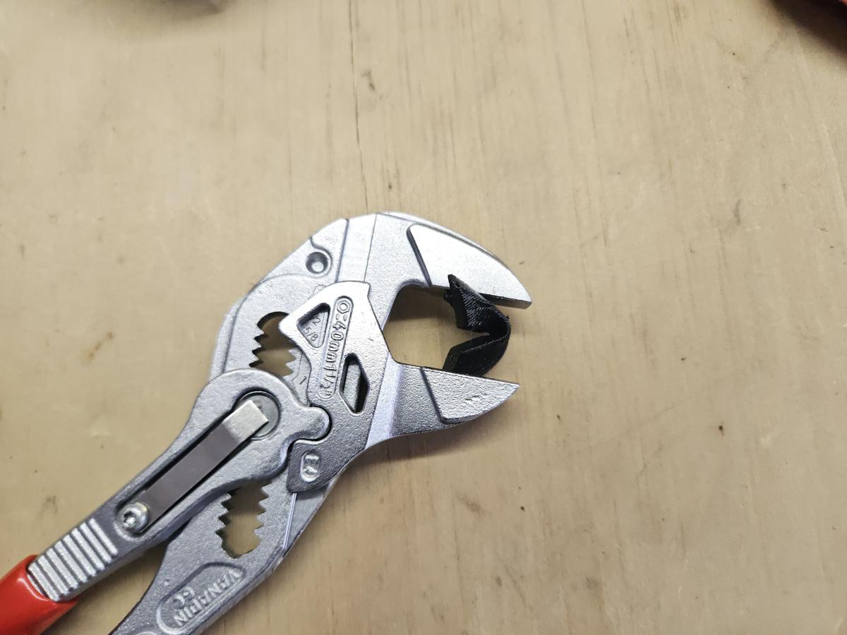

                  Unlike the insert -> plug gasket, these are super chunky and are made to flex a lot to accommodate any slight variations in the angle of the braces. Similar idea to the filter housing -> hood gaskets.
                  Printed this test piece with 0% infill and it's suuuper flexy, very happy with that:

                  (the part easily bends with just finger strength, pliers are just there for a clearer picture)

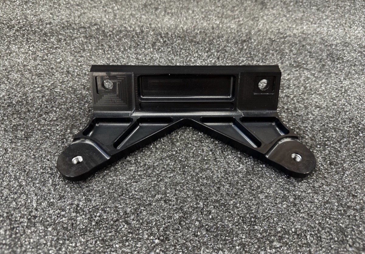

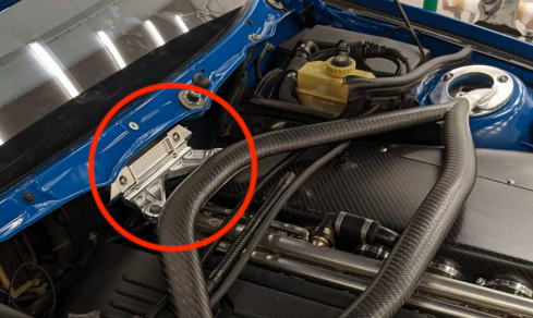

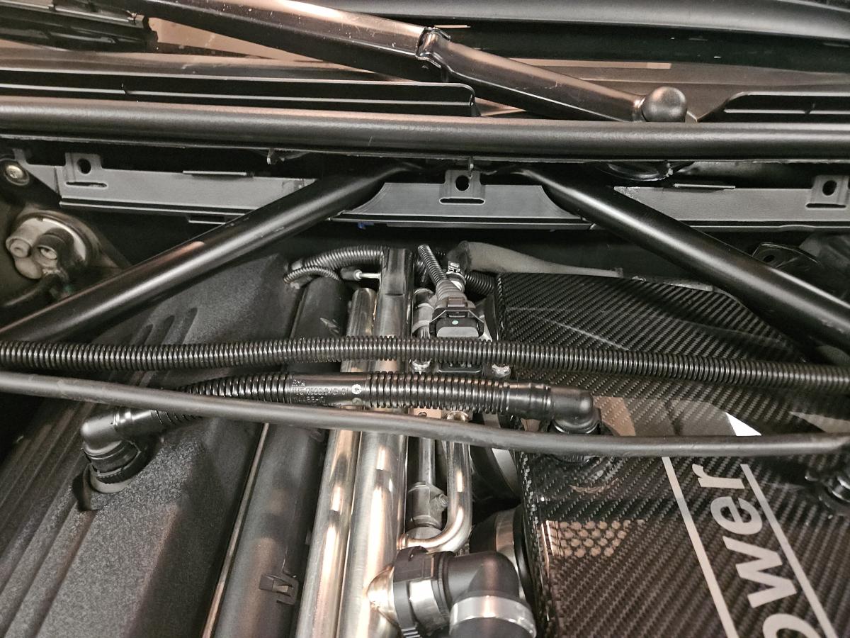

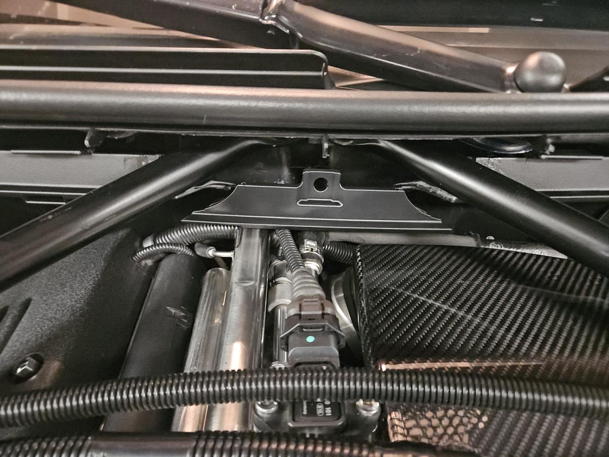

                      Hard to make a call about damage to the firewall, but the Slon solution has an aluminum, L shaped intermediate piece between the brace and the firewall mount, so I would bet that's gonna suffer more than the firewall. See below for images stolen from Obioban's thread:

                      I think the chances of any engine bracing making its way into the cabin in a crash are very, very slim. BUT, BMW did it on the E86 and E89 for some reason, so I wanted to emulate it. Like you said, it might be more about preserving the chassis in a crash, but regardless of what the reason is, it definitely makes me sleep better at night .

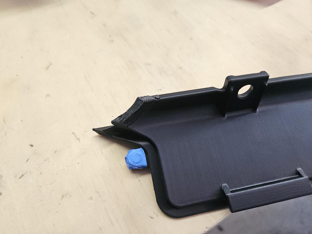

                        Muuuch better:
                        Left is straight out of the box and right is after drying for ~4 hours.

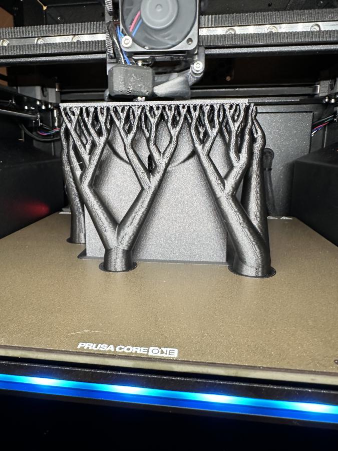

                        I think I need to experiment with supports or a different orientation. Getting some artifacts in the overhang.

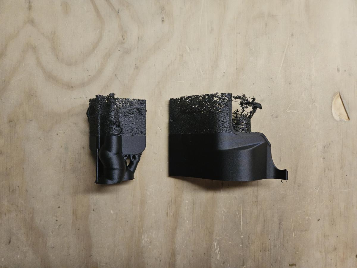

                          Man, this TPU is extremely hard to print with.
                          First off, it absorbs moisture like crazy. Needs to go back in for drying if it's left out for even a few hours.
                          Also, it's pretty soft, so any tall parts start to flex a lot and ruin the print. I think I've finally managed to find the correct combination of splits, orientations and supports that yields decent parts, but they're far from perfect.

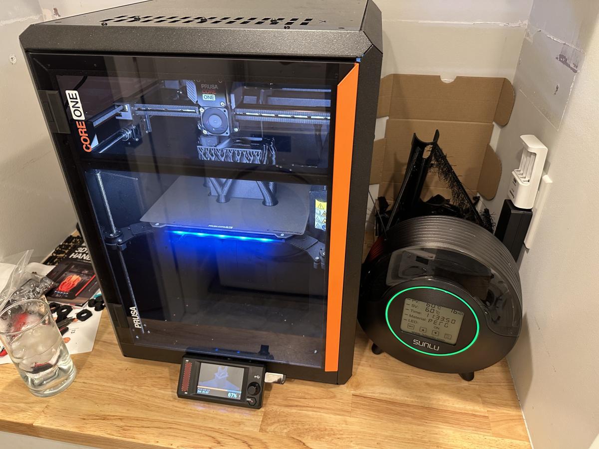

                          This material is really making me want both a dual extruder machine and one of those fancy drying chambers that you can directly print from.

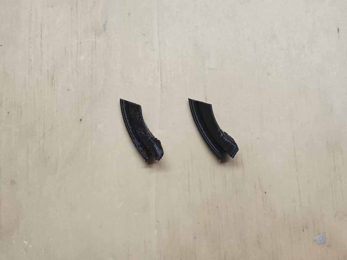

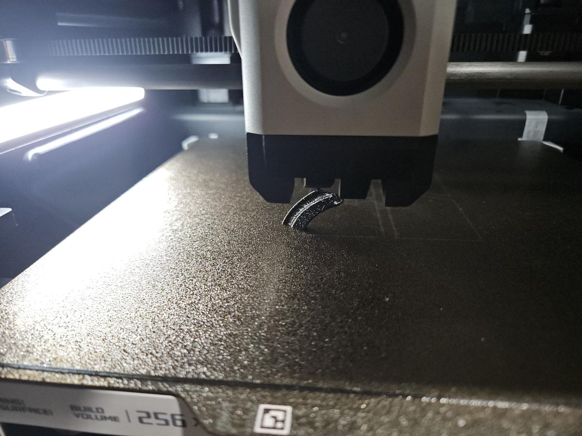

                                Printer is down because I finally killed my nozzle with all the hard-to-print filaments I've ran through it.
                                Don't think this is supposed to look like that:
                                Click image for larger version  Name:	20250818_100750.jpg Views:	0 Size:	101.5 KB ID:	316272
