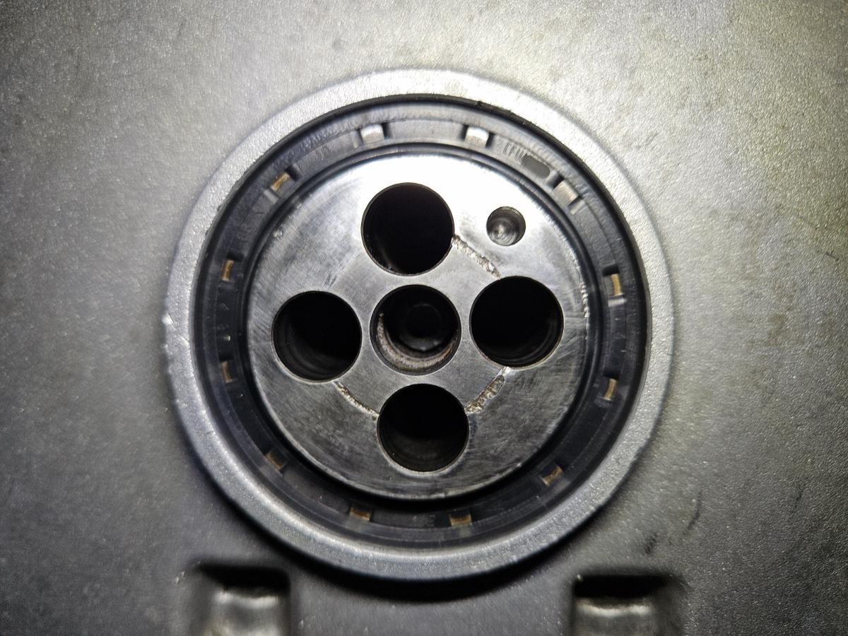

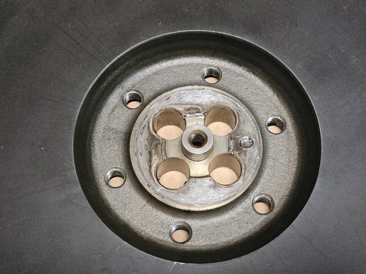

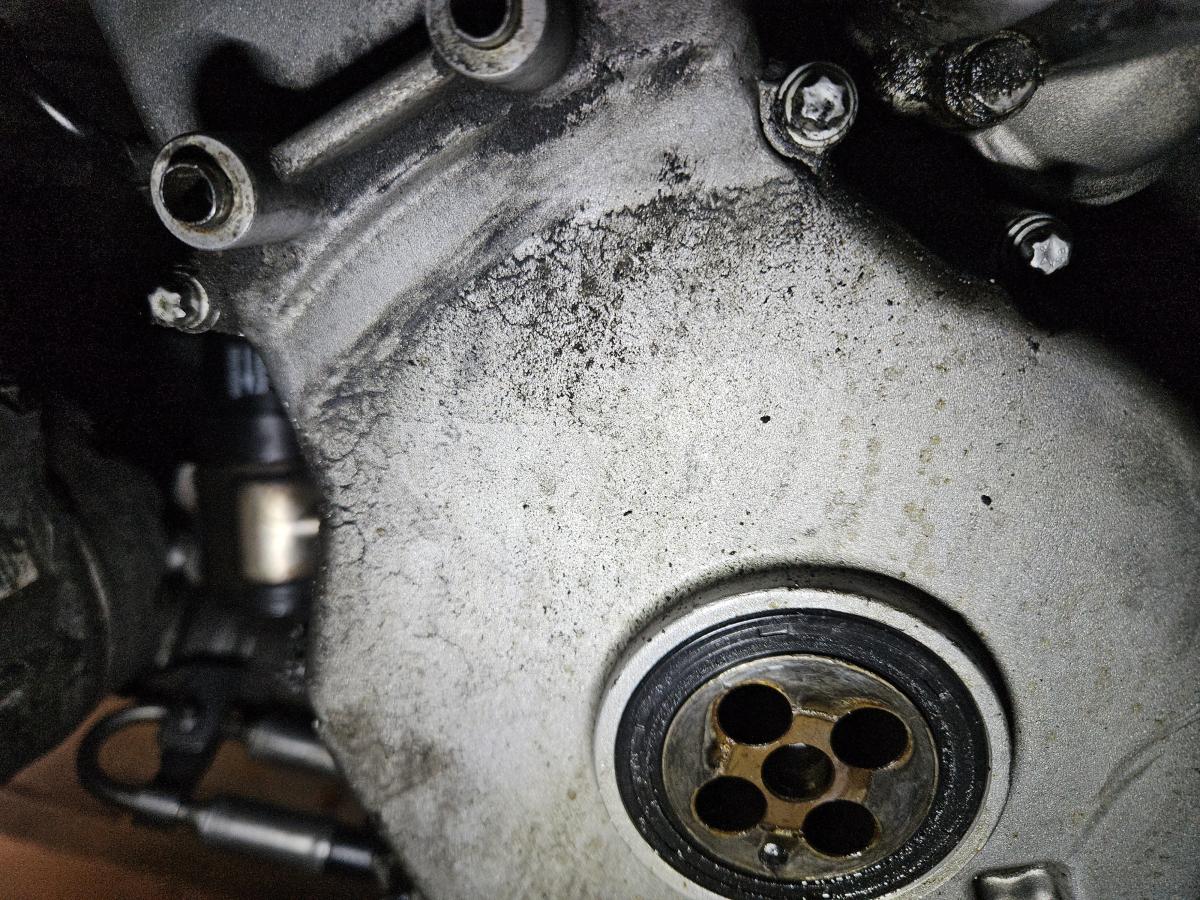

          Let's backtrack a bit to see how we got here.

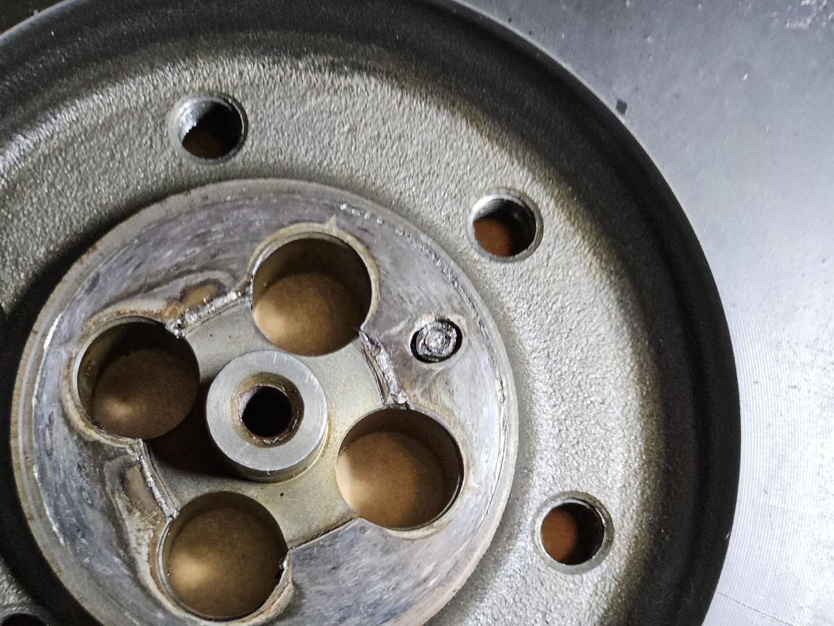

          Started by drilling out the dowel in the damper and cleaning up the mating surface. This is what it started out like:
          Center punched the dowel and it started to move around, so I kinda just kept at it to free it up:
          Did a bit of drilling and got it out fairly easily. After that, I hit all those super marred/galled (not entirely sure where that built up material is from, if I'm being honest) spots with a dremel and then went over everything with some wet 800 grit. I taped the sandpaper to a large socket to have somewhat of a flat reference for it:

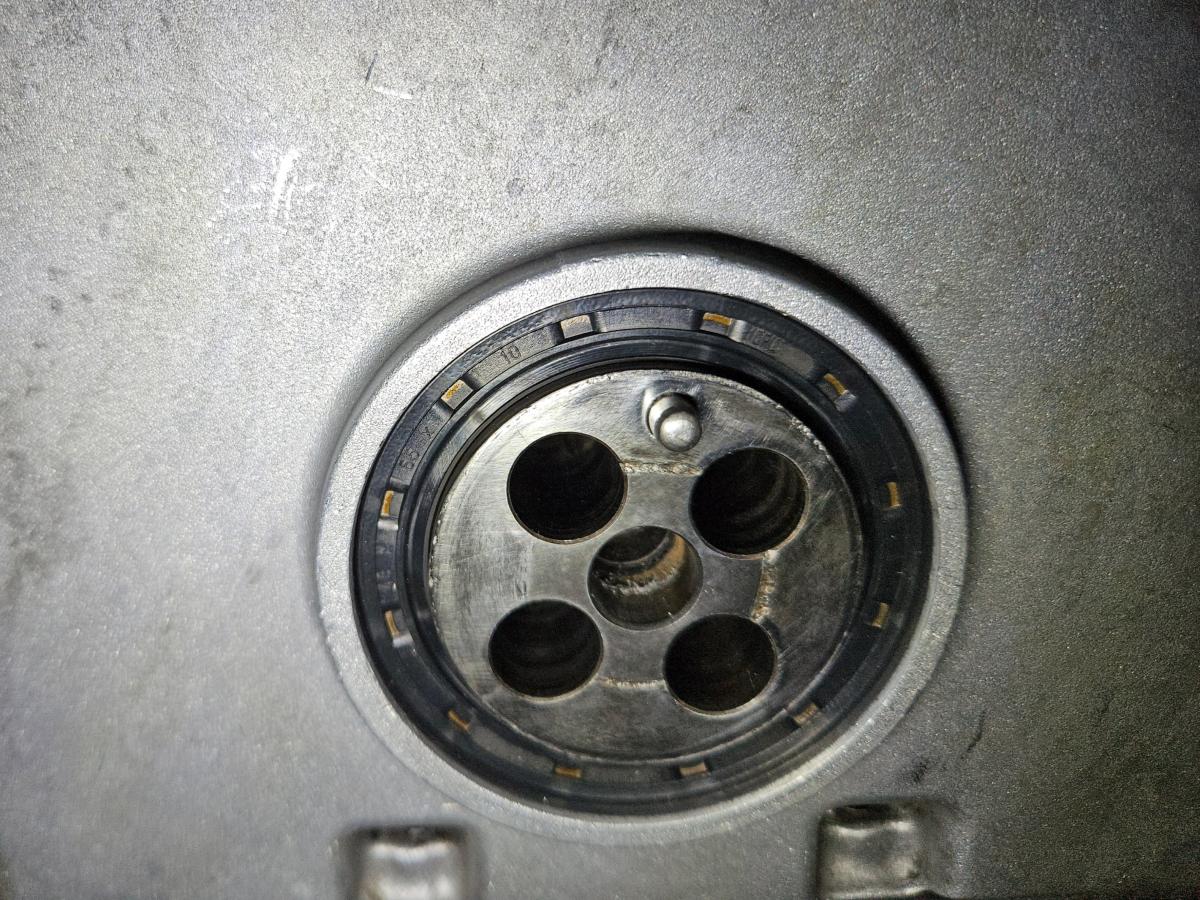

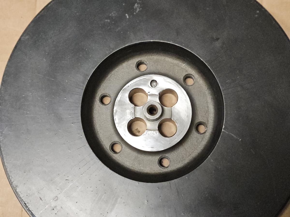

          Any imperfections that remain are below the mating surface, so they're staying. I did pull the harmonic balancer from my spare engine out of storage to see if I should just use that one instead. Turned out to be a bit rustier than I remember. It needs refinishing and I just have no desire to tackle that additional project right now, so sticking with the one above.
          Next up, I ran the 800 grit around the edge of the crank sprocket to knock off any high spots from all the marring. I also taped some wet 800 grit to the handle of my crank holder tool (it's multiuse!) and used that to quickly skim the mating surface. The marks you see are all below the mating surface, so I decided not to risk getting a dremel near them and just left them alone. Less is more approach for this one:

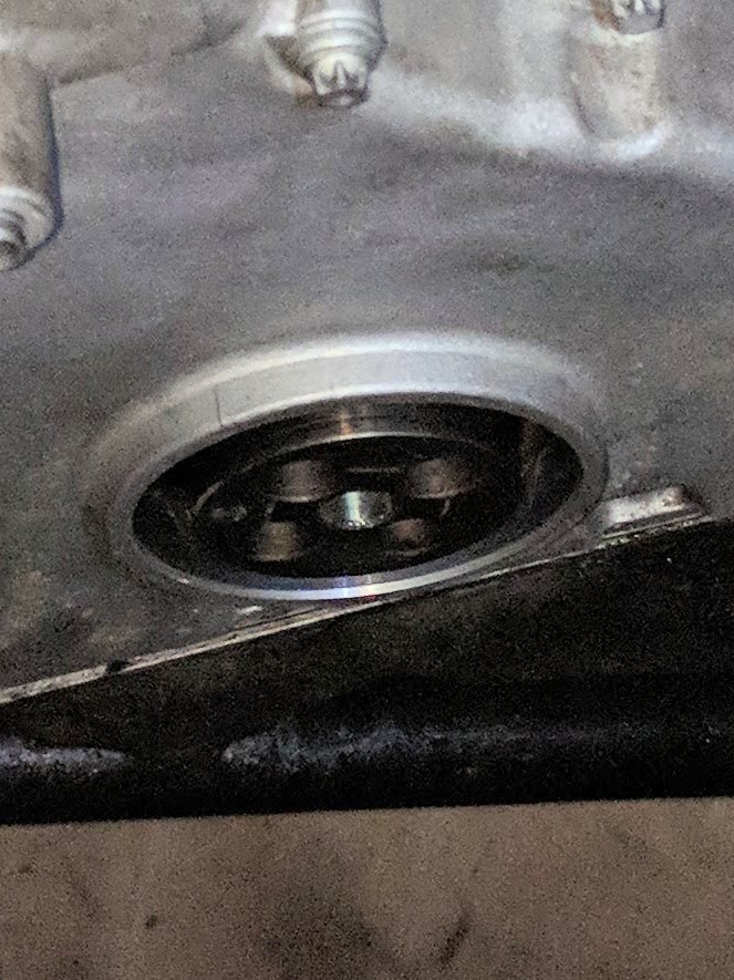

          I realize that these parts are in kinda terrible condition, but I just really don't want to take the engine apart any further. Car has 14X,000 mi on it, so the head gasket will likely need to be swapped soon. I plan on taking the timing chain cover off and swapping the sprocket then. Might refresh the spare harmonic balancer I have or just install a new one, we'll see.
          Front main seal installed perfectly on the first try. It did start off a bit crooked, but a quick tap got it squared away. I wish all my previous install attempts had been as easy as this one!
          Last bit of the puzzle was to get the dowel installed. I was able to tap it in most of the way, but the last couple mm required pressing. I installed the damper and finished pressing it in with that. To make sure that it was fully seated and both mating surfaces were making adequate contact, I (terribly) cut some clearance into a piece of paper and put everything together with the paper in between the damper and the crank:

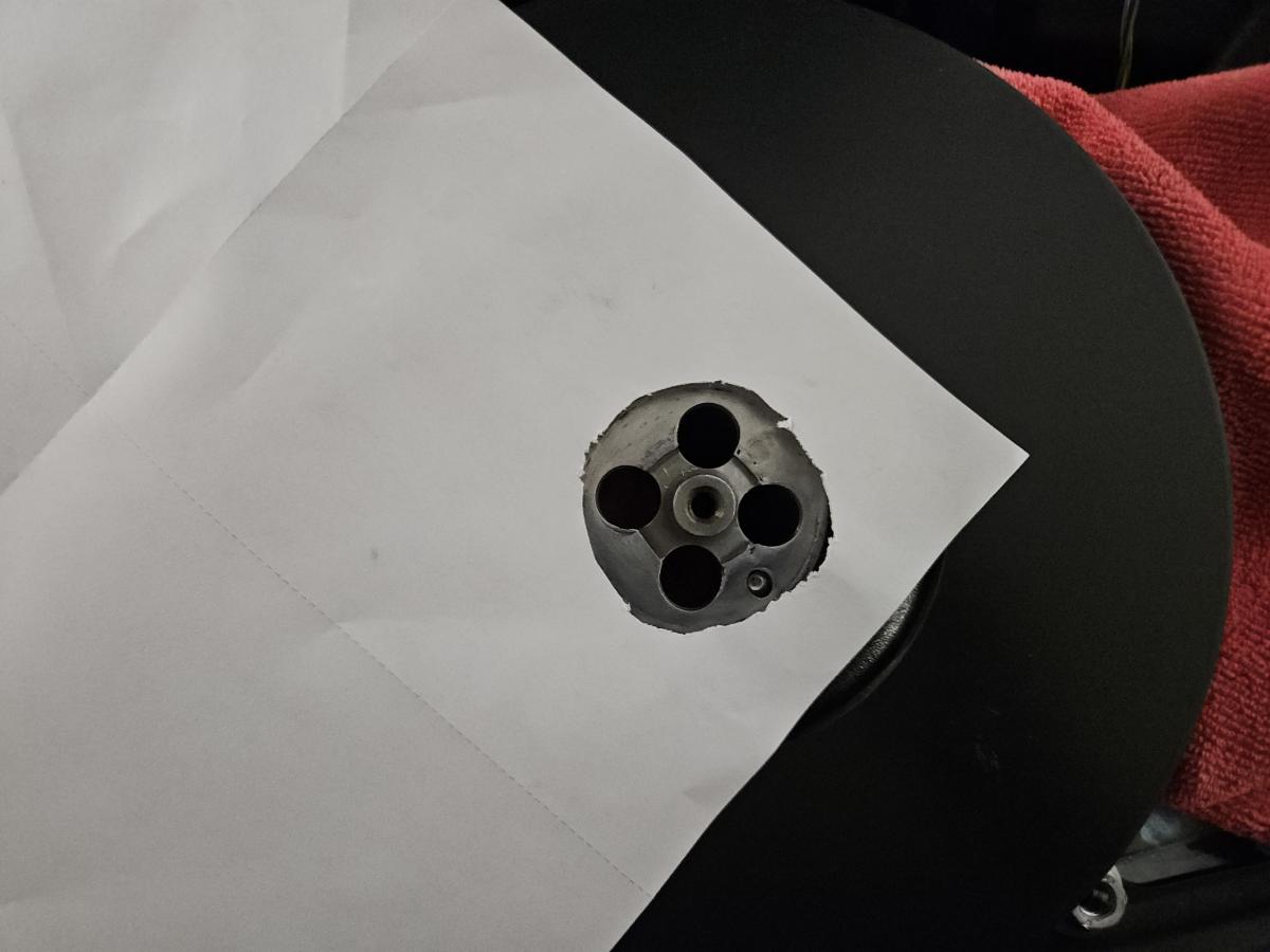

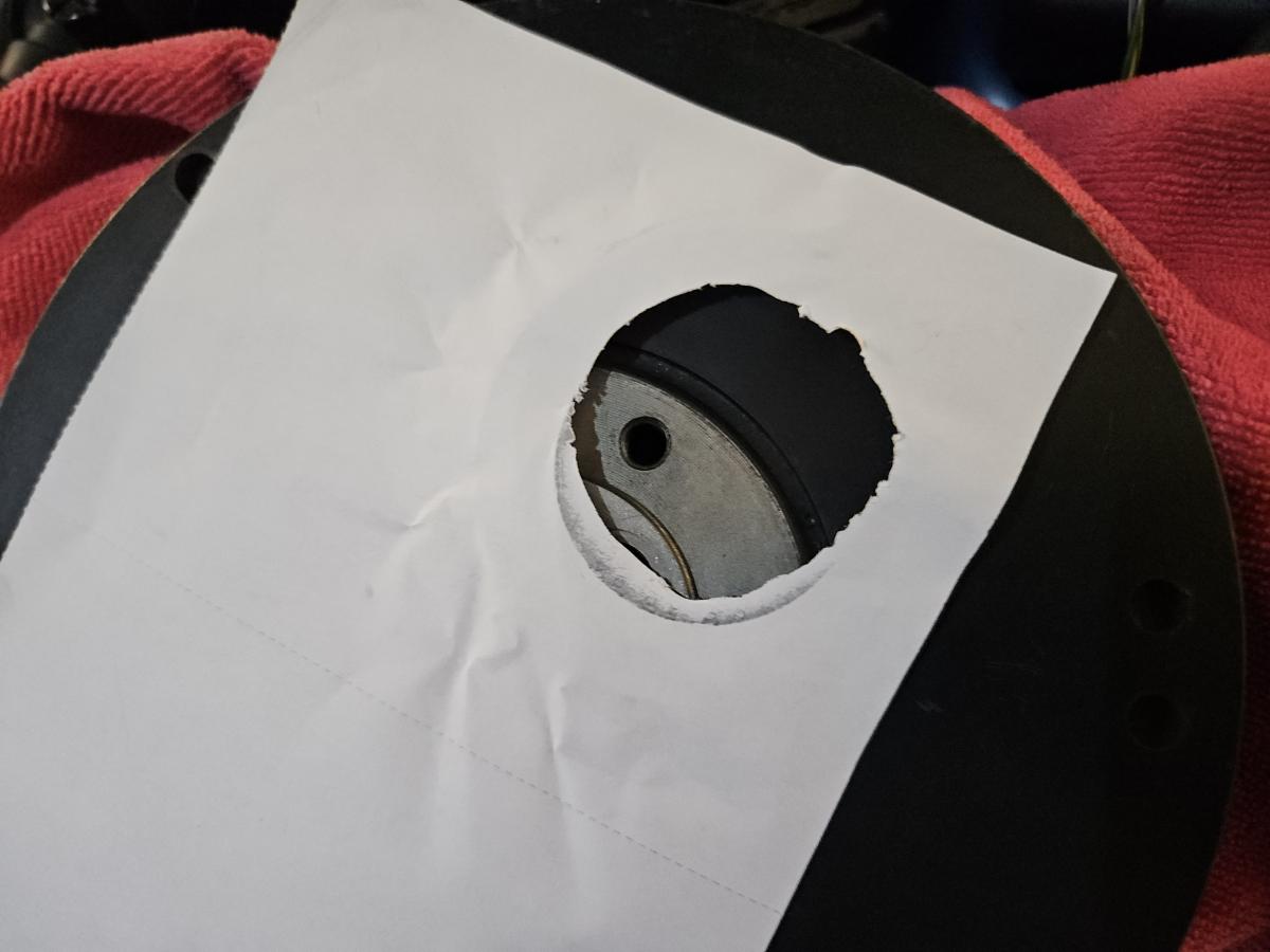

          Wiggled the paper around as I was tightening the bolts to check if the surfaces had mated or not. It caught as the bolts bottomed out and I wasn't able to wiggle it around any more, nice!

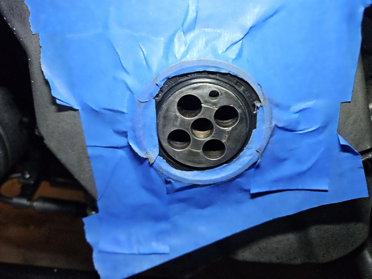

          And finally, here's the "fixed" crank sprocket:
          Happy to have gotten the hard parts out of the way. Now just need to get everything reassembled and take the car out for a spin. It's been out of commission for waaay too long.

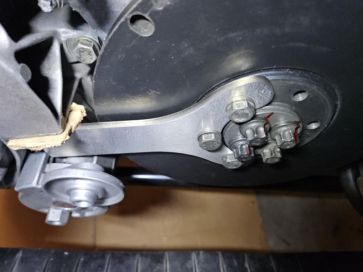

                  Although I do have to say that my crank holder tool worked great:

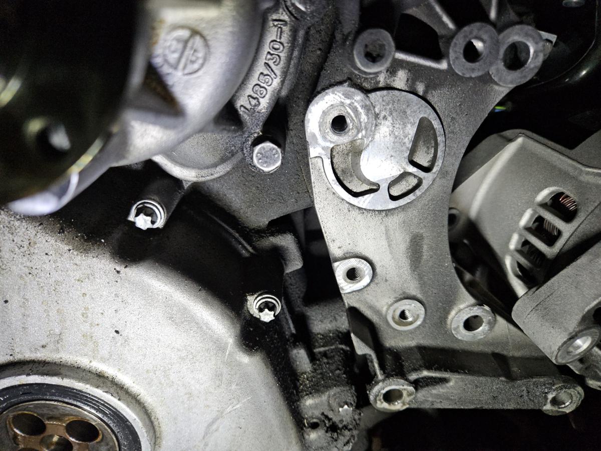

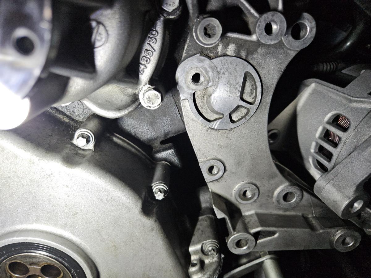

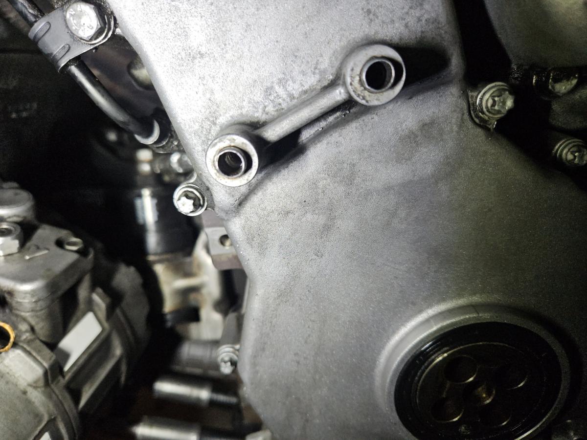

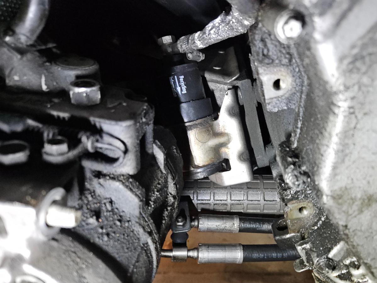

                  Also, here's some before and after pics of the front of the engine:

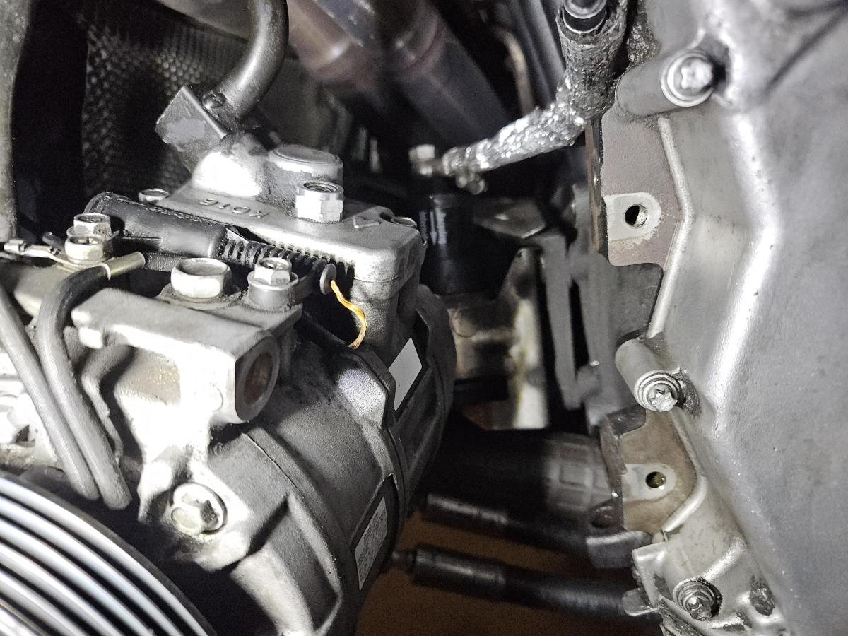

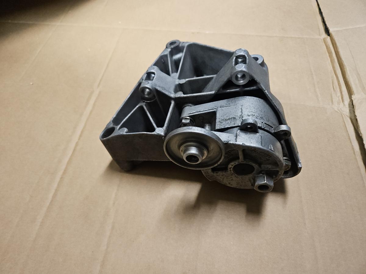

                  Not spotless cause my fingers were really starting to hurt at this point, but it's SO much better. Will at least let me see if there are any other leaks in the future.
                  The most disgusting part was by far the AC compressor bracket. Had to pressure wash that one to clean it up:

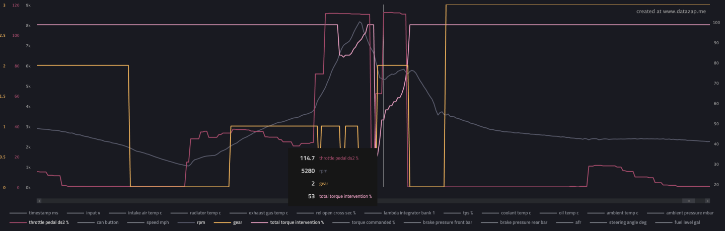

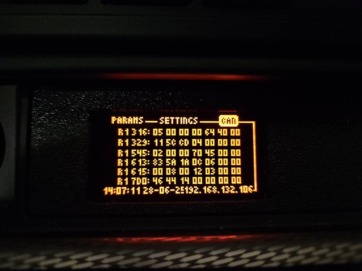

                    Flashed karter16's custom DME FW today to get extra data over CAN and it works perfectly (0x7D0 is the new message):
                    Log of a drive around town immediately after flashing the modified FW: http://datazap.me/u/heinzboehmer/csl...?log=0&data=15
                    Thought it was funny that you can see the lack of traction very clearly towards the very end:
Name:	Screenshot 2025-06-28 at 3.16.19 PM.png
                    That's a hard shift from first to second at redline. Note that the slope of the RPM curve is way slower when in second, even though throttle pedal is at WOT. Pink line tells the full story: DSC is kicking in.

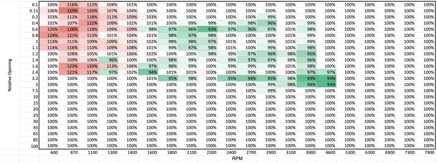

                    With everything on CAN now, I was able to do multiple rounds of VE tuning without having wires running all throughout the cabin. Just tell gauge.s to start logging, drive around, import logs into tuning spreadsheets, flash car and repeat until satisfied. The only changes I ended up making were down low, but it seems to have resolved essentially all the remaining weirdness. The way it drives now is extremely close to how it drives with the stock airbox + tune.
                    Here's the changes that the VE tuning process resulted in, for reference:
Name:	Mullet v28 Heinz VE Tuning Comparison.png

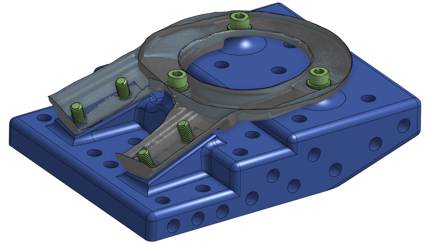

                          I engineered cheese:
Name:	Screenshot 2025-06-29 at 1.41.41 PM.png

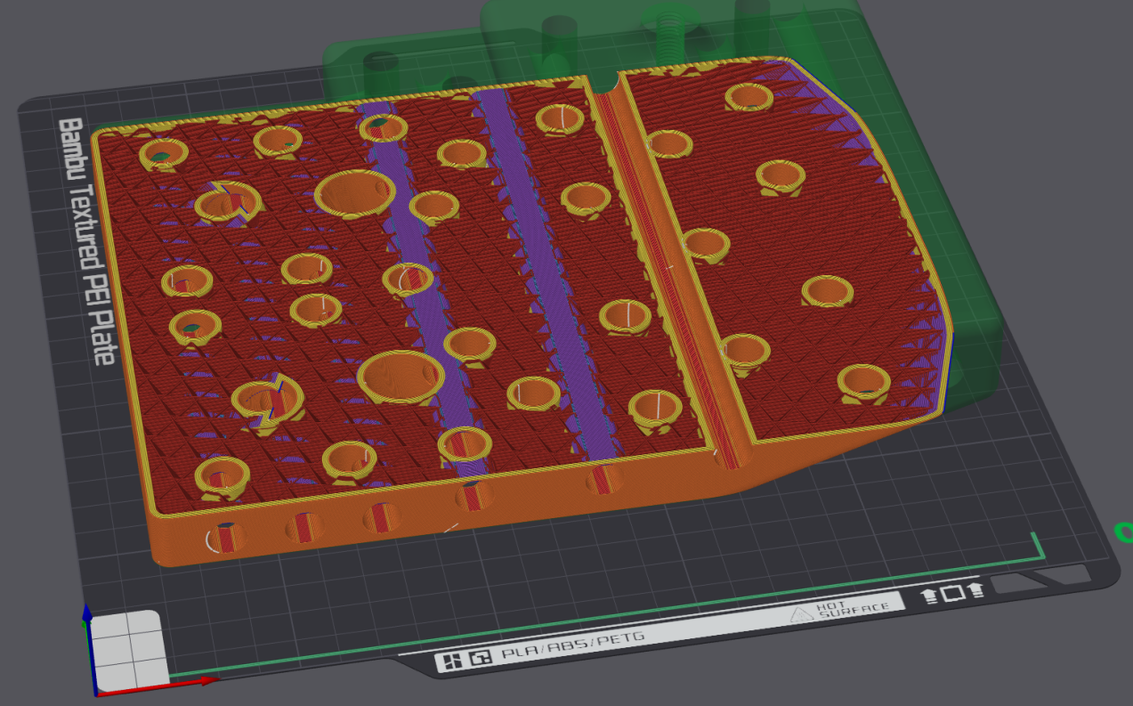

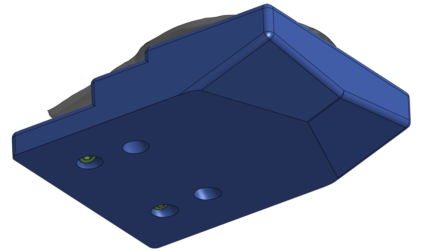

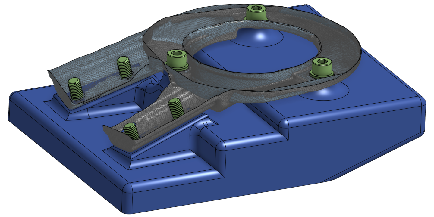

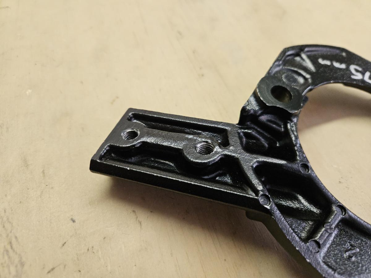

                          Following the success of the 3D printed front main seal and stud install tools, I decided to see if a 3D printed fixture would work for holding the stock strut bar brackets at the correct angle in the mill.
                          Here's some pictures of the fixture without the holes to better show the geometry:
Name:	Screenshot 2025-06-29 at 1.57.20 PM.png
Name:	Screenshot 2025-06-29 at 1.57.57 PM.png
                          Those cuts in the rear are parallel to the strut bar mounting surfaces. Surfaces are fairly flat on the brackets, but there are some casting imperfections:
                          I'm gonna give them the lightest of skims just to get rid of the bumps. The cuts in the fixture will act as a reference when setting them up in the mill. That setup is going to end up being pretty tall, but there's no good way around that thanks to the geometry of these things. If it ends up being too tall, I'll just touch them up on the belt sander instead. Perfect flatness is not crucial here.
                          So why make it all swiss cheese-like?
                          The answer, counterintuitively, is that the holes add stiffness. This part is way too big to print with 100% infill, so the holes are there to force the slicer to add more walls inside the part. Should drive stiffness up significantly:
Name:	Screenshot 2025-06-29 at 1.43.20 PM.png
                          Will this work? Maybe
                          Will this crack as soon as I tighten down the vise? Maybe
                          Will this shatter as soon as the end mill touches the aluminum? Maybe
                          It's unconventional for sure, but I figured I would give it a shot. I did find a bunch of youtube videos of people doing very similar things, so that gives me hope. If it doesn't end up working, I'll have to make/improvise a similar fixture with stiffer materials, so this part will still be very useful to have as a reference.
