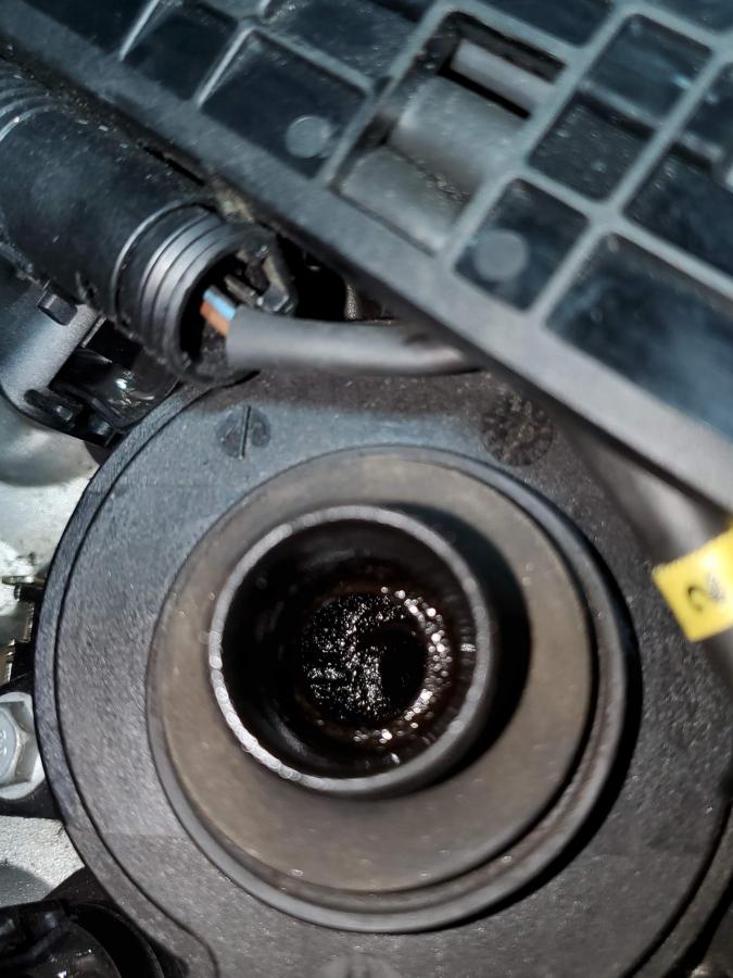

                              Replaced the oil separator in my engine because it was looking pretty disgusting and cleaned the associated parts:
                              Click image for larger version  Name:	20210810_214547.jpg Views:	0 Size:	78.1 KB ID:	156130
                              Then took the old one apart and made this thread with my findings: https://nam3forum.com/forums/forum/m...aning-interval

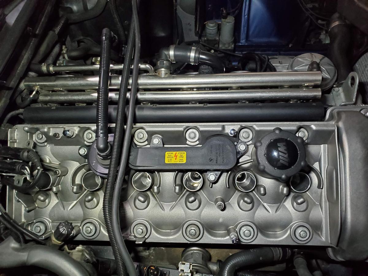

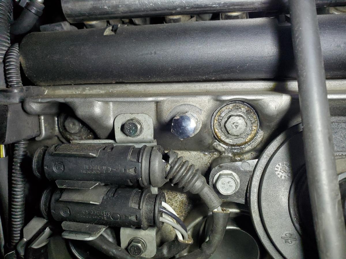

                              While I was there, I did some cleaning up of the valve cover, as it too was looking disgusting. Probably just a lot of previous owners and myself saying "eh I'll clean it next time I'm in here".
                              Before:
                              Click image for larger version  Name:	20210827_212436.jpg Views:	0 Size:	185.4 KB ID:	156131
                              Closeup of one of the really bad areas (the sensor with the torn boot got replaced when I did headers):
                              Click image for larger version  Name:	20210826_213031.jpg Views:	0 Size:	187.2 KB ID:	156132
                              And after:
                              Click image for larger version  Name:	20210828_170326.jpg Views:	0 Size:	168.1 KB ID:	156133
                              Much nicer!

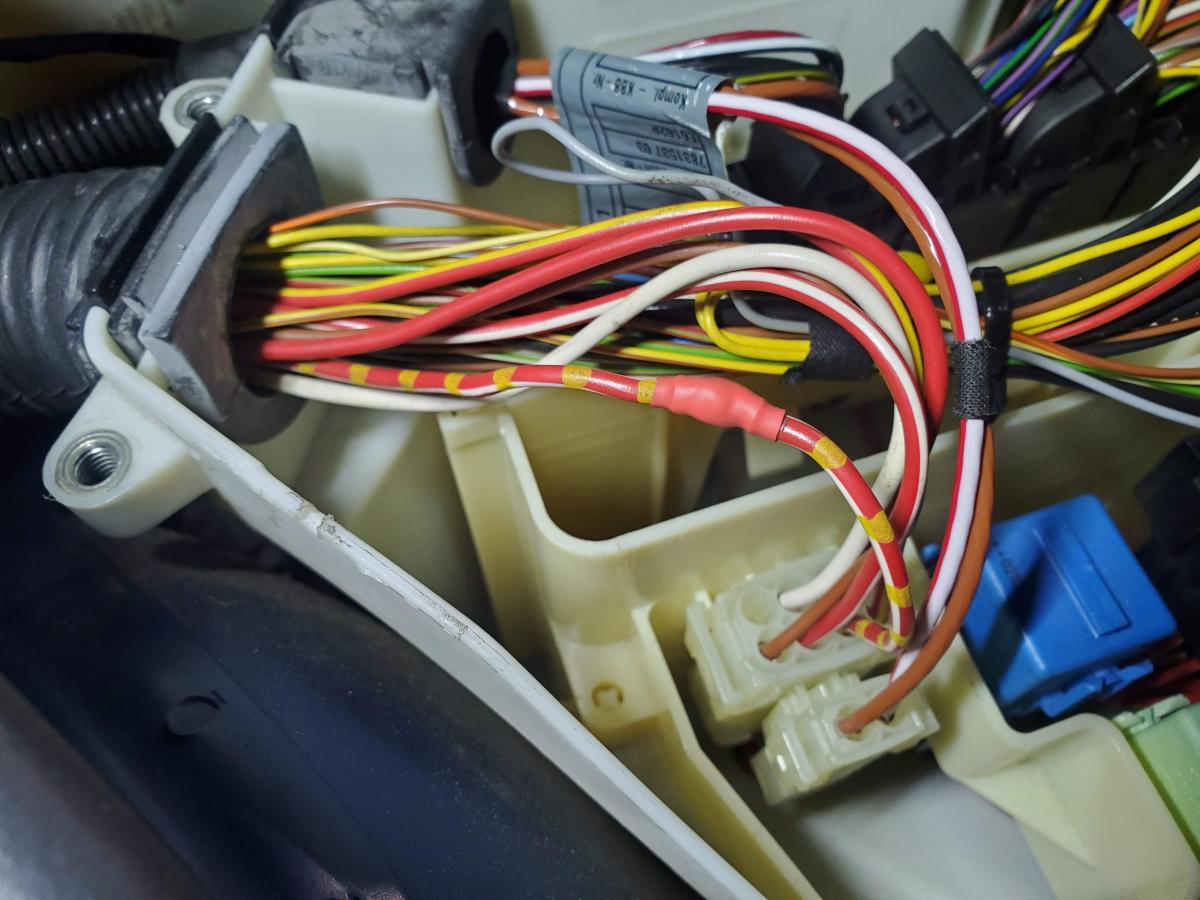

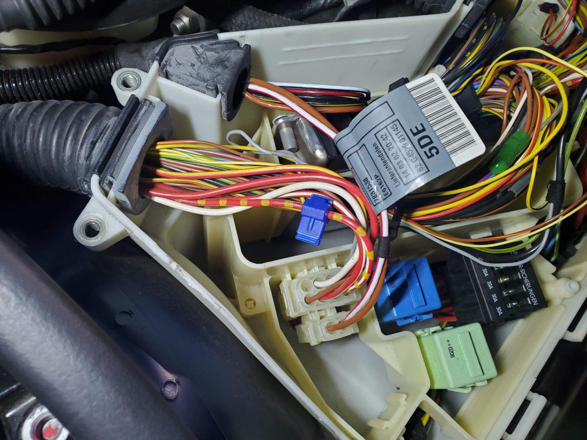

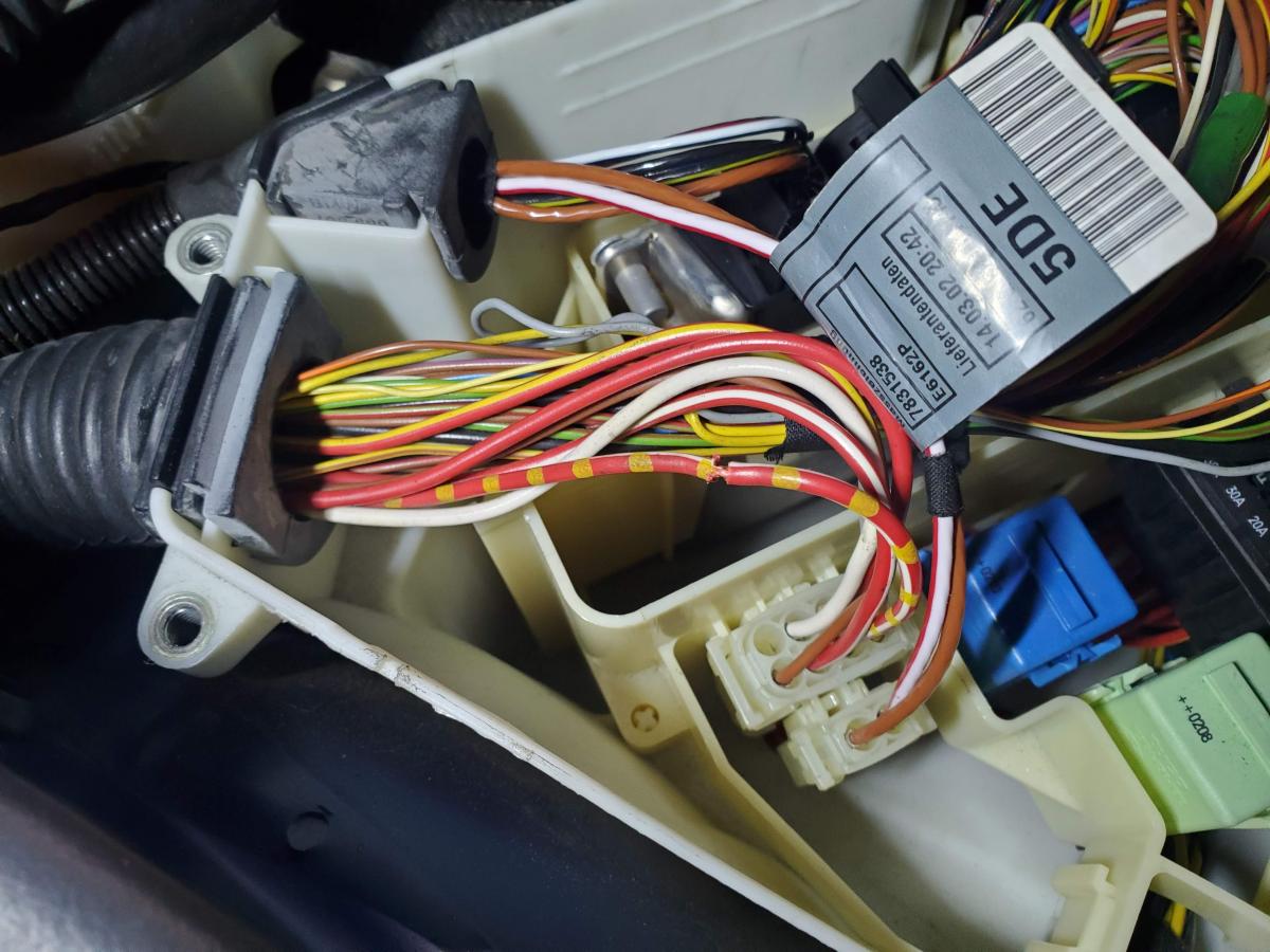

                              Since I was cleaning up the engine bay, I also fixed a wire in the DME area that had previously been used as a source of power for angel eyes. Cut, resoldered, applied adhesive lined heat shrink (for water ingress protection) and then covered that with some red heat shrink (which unfortunately made it look pretty lumpy) to sort of match the original wire color.
                              Click image for larger version  Name:	20210817_193227.jpg Views:	0 Size:	161.7 KB ID:	156134
                              Click image for larger version  Name:	20210817_193322.jpg Views:	0 Size:	135.5 KB ID:	156135
                              Click image for larger version  Name:	20210817_195740.jpg Views:	0 Size:	119.6 KB ID:	156136

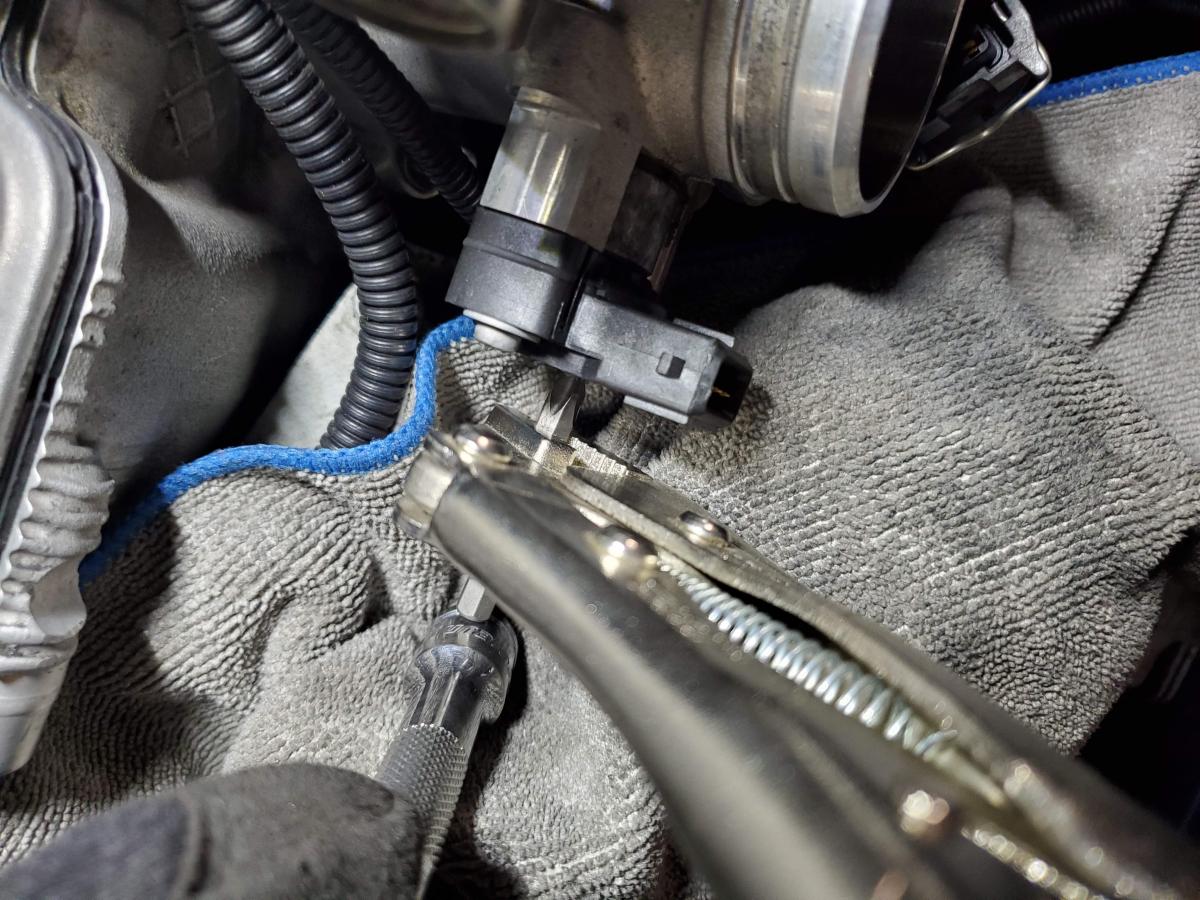

                              Upon returning, I ordered both engine bay TPSs and replaced them. Front one was surprisingly hard to get off. I ended up grabbing a philips bit with a pair of vice grips and wedging a 3/8" extension between the bit and the engine hoist point so that the bit wouldn't slip.
                              Click image for larger version  Name:	20210827_203939.jpg Views:	0 Size:	177.8 KB ID:	156137
                              BMW, why not just make these hex head bolts? Managed to not strip the head of the bolts, but probably a good idea to order new bolts if changing this part out.

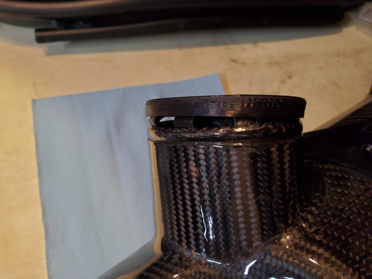

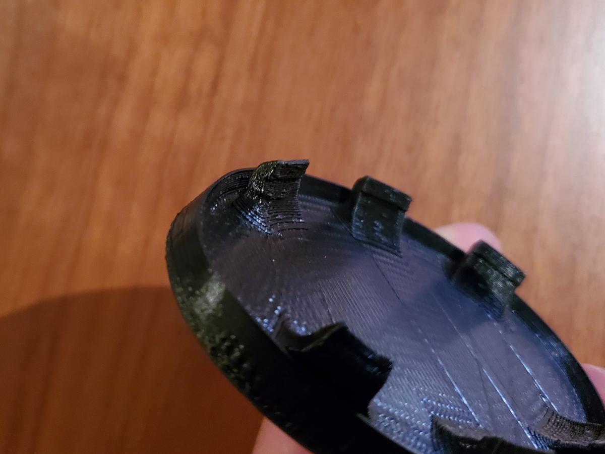

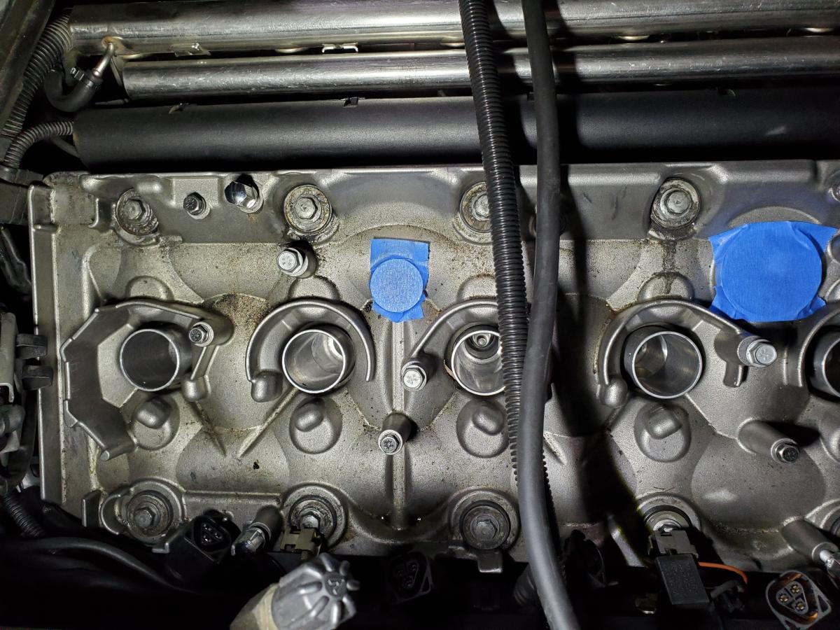

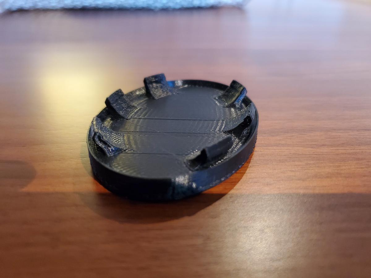

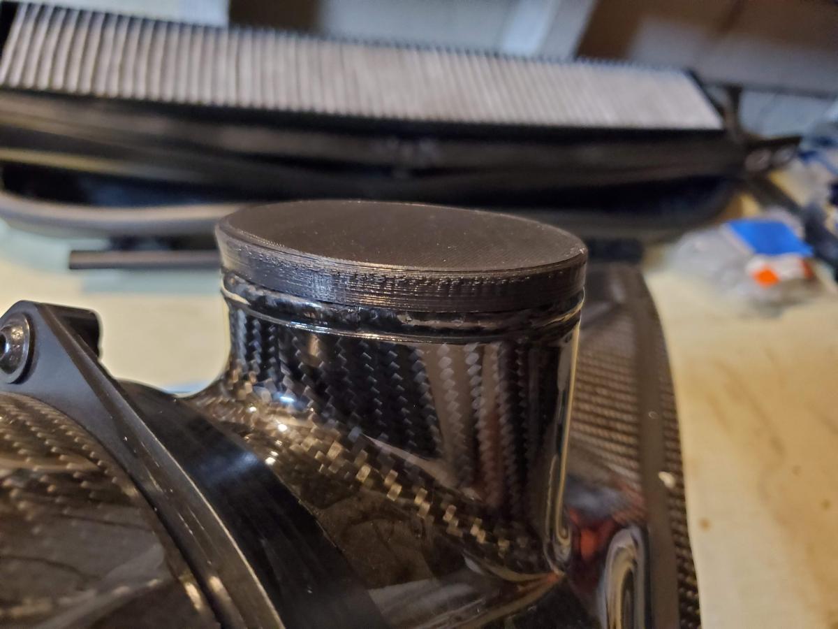

                                Decided that the idle air hole in the bottom of my Karbonius airbox was doing nothing, so I started looking for ways to cover it. I emailed Karbonius to ask if they had any suggestions and they offered to 3D print me a bespoke piece that would just snap in! And they sent it to me for free! I really do like that company a lot.
                                Anyway, here's what they sent over:

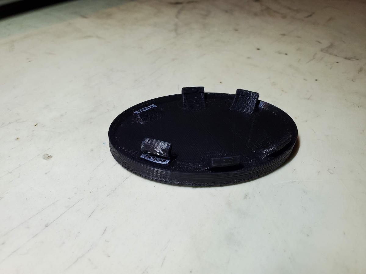

                                I took off the unfiltered section to put it on, as I didn't want to break any of the tabs. But even after being super careful, I still managed to break a couple:
                                Guess the printing layers made it easy for the shearing to occur.

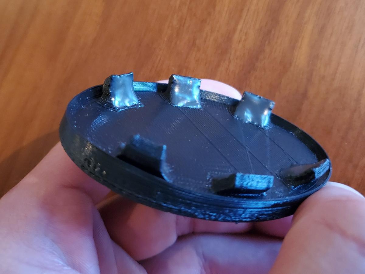

                                No worries though, grabbed a heat gun, melted the plastic on the tab and cap slightly and stuck them back together:

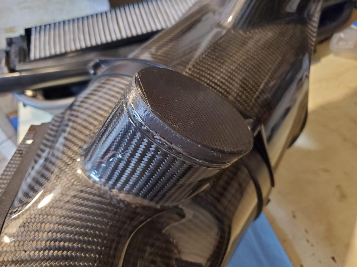

                                I then went over the tabs with some of the epoxy I had left over from my VinceBar install to give them a little more strength:

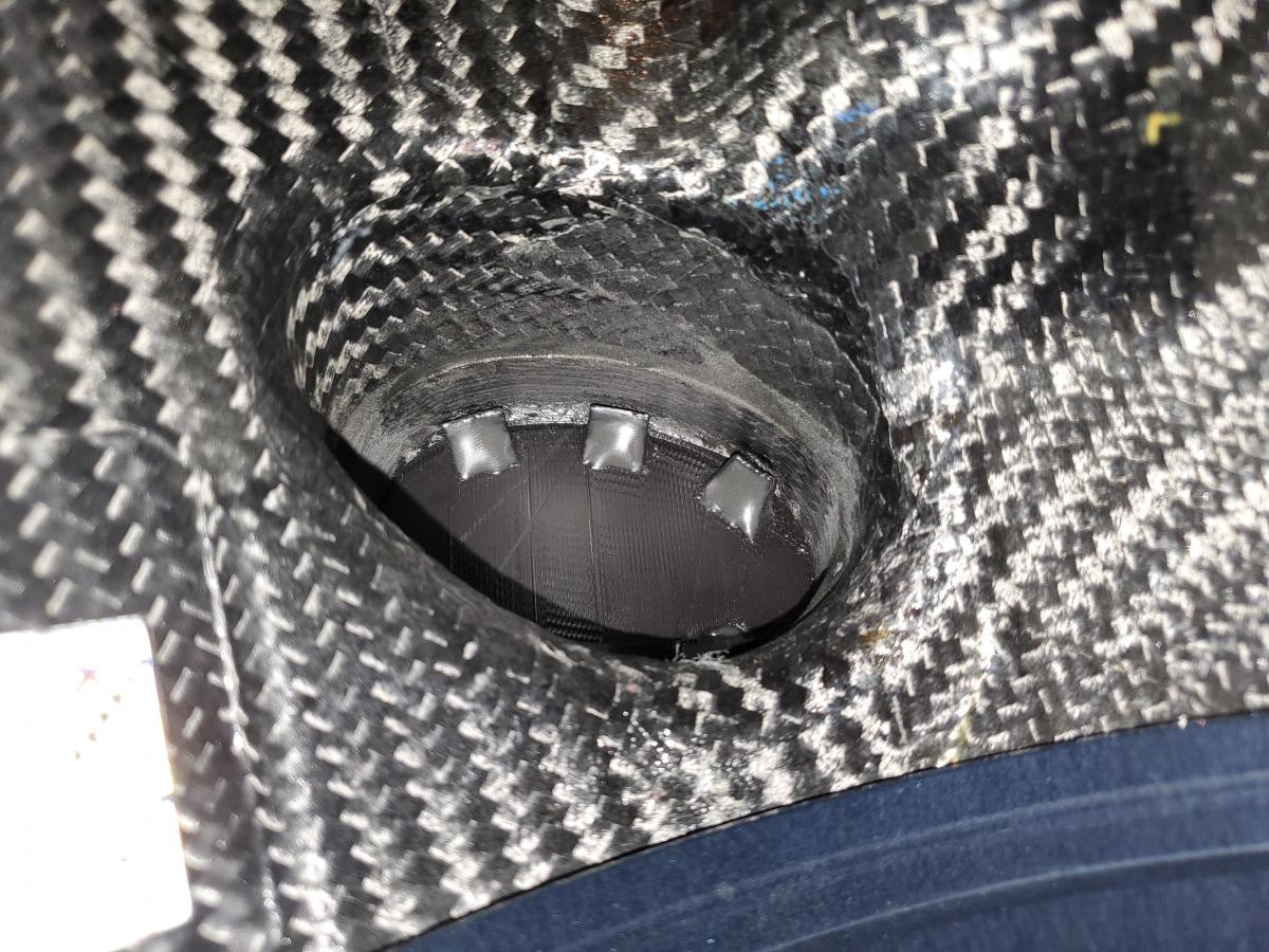

                                Here you can see why the tabs originally sheared, fit is quite tight:
                                My fix worked though and the cap actually seals quite well:
                                All in all, pretty satisfied with it. Couple more revisions on the tabs could make this pretty much perfect out of the box.

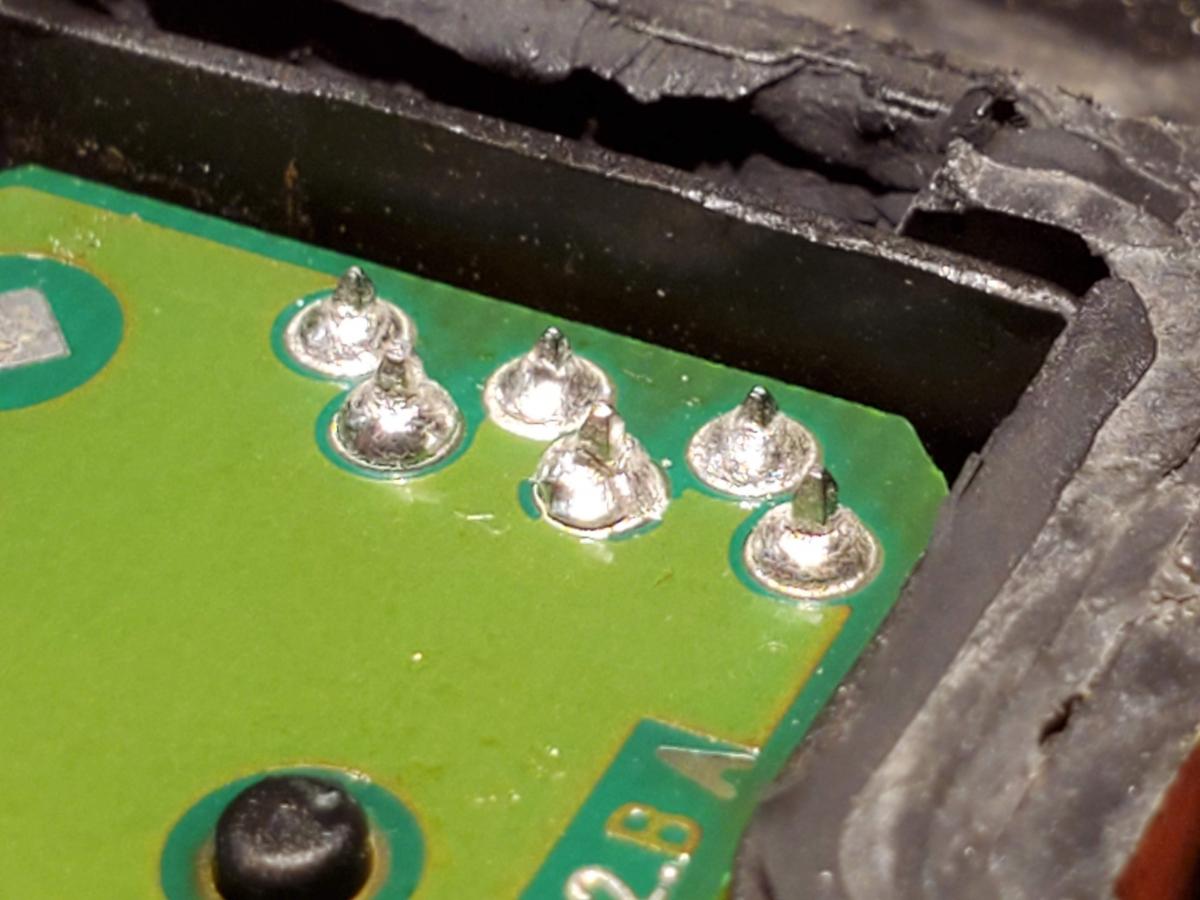

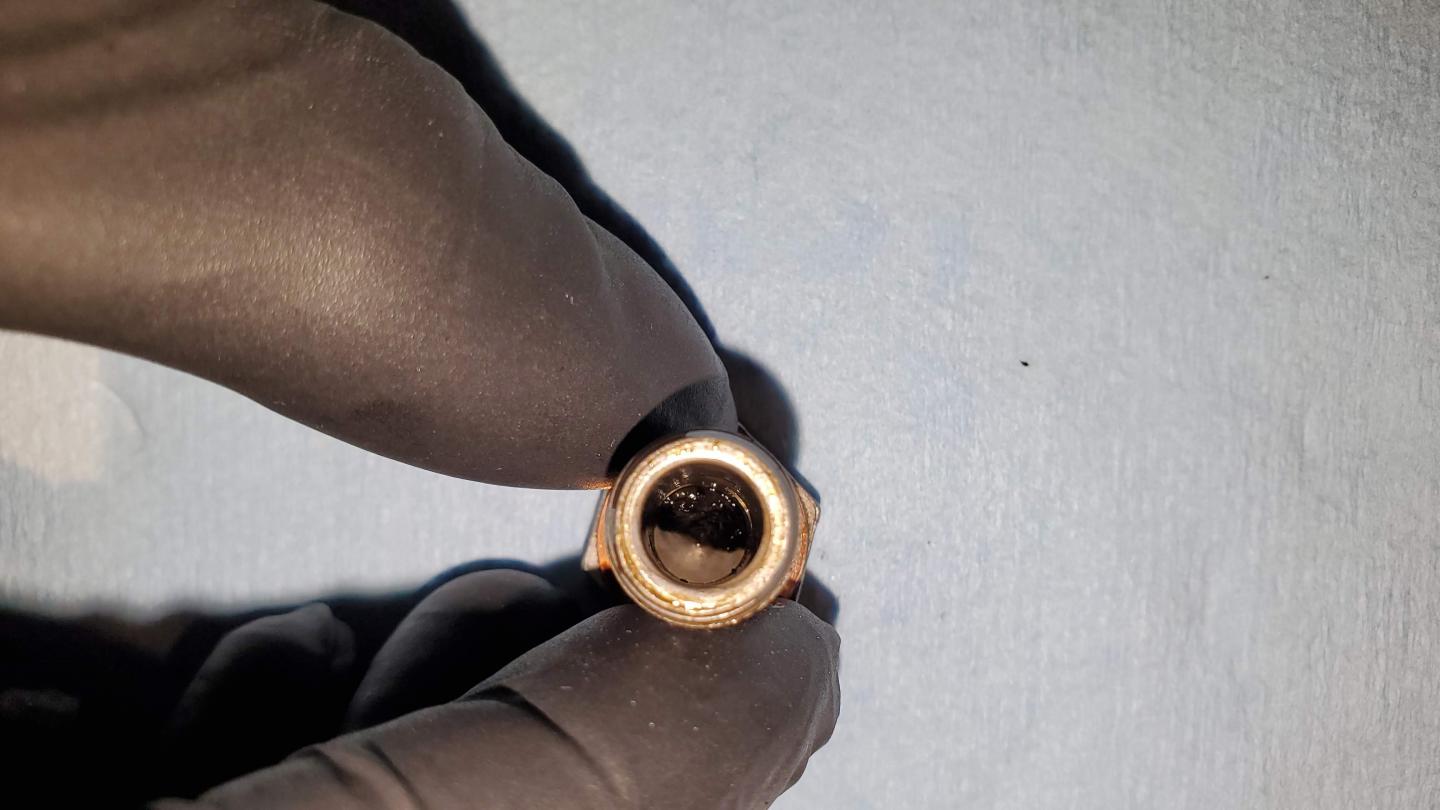

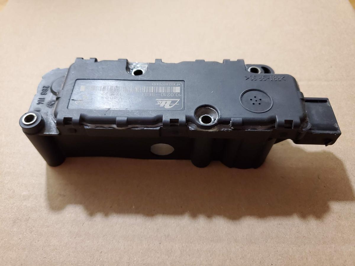

                                After that, I decided to open up my VANOS solenoid and do my own version of the Beisan fix (mostly because I can't help but mess with everything).
                                Found some solder joints that didn't look that great:
                                Documented the process with a short DIY here: https://nam3forum.com/forums/forum/m...-solenoid-pack

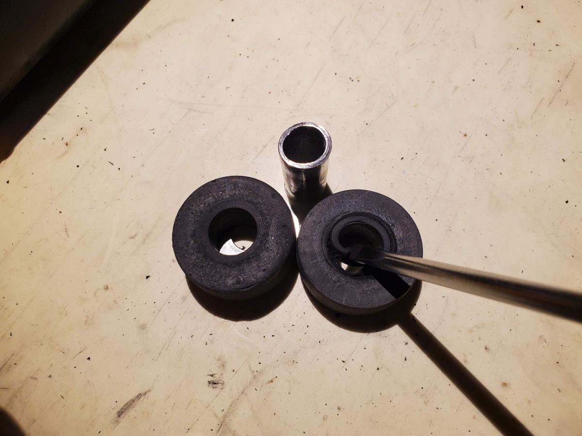

                                I then swapped out my rear shock mounts. Originally changed them out when I did my RACP plates, but found that they had failed. First time around, I used some Bimmerworld mounts because the design was supposedly superior to stock, but this time I went with OE Lemforder. Stupid cheap and they didn't fail during the 100k mi they were on the car for.
                                Pic of how the Bimmerworld mounts failed:
