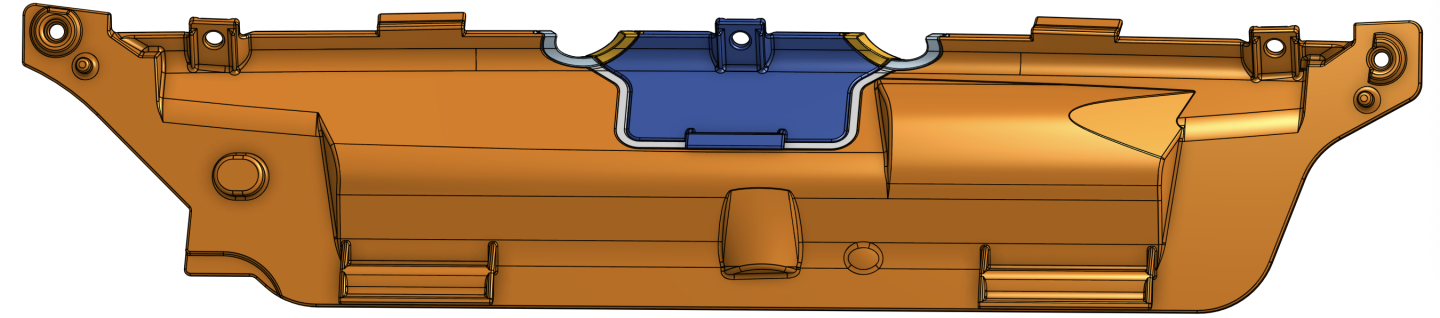

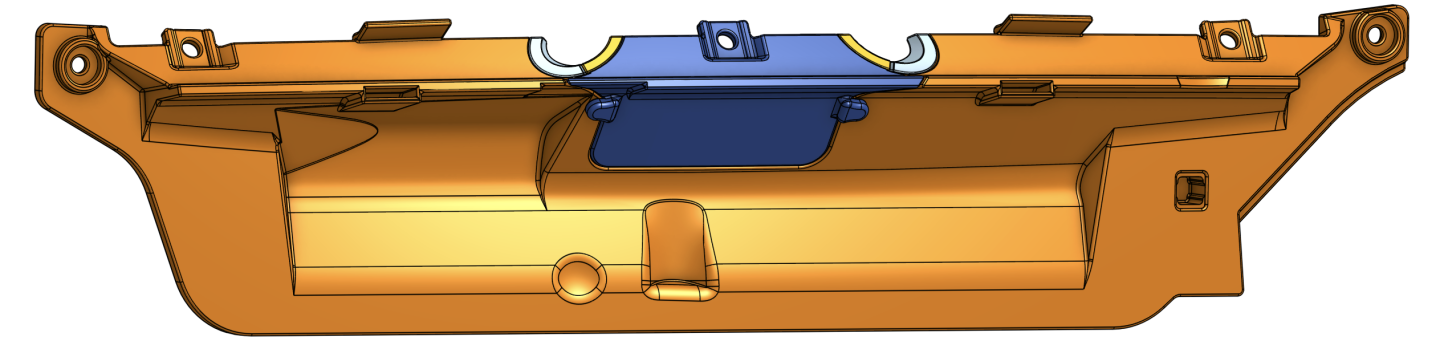

                              Finally sat down to finish the design for the firewall plug. As mentioned, the removable insert that provides tool clearance was the only part that still needed work. This is where the design is at:

                              Those two tabs house the magnets that hold it in place before the filter housing is fastened. I'm fairly confident they'll be strong enough to hold the part up, but I might have to tweak that part of the design a bit.
                              Currently printing out the insert to prototype with. I did a lot of guessing with the clearances needed so that it can pivot forward and out, so it will definitely need some testing.
                              As for the gaskets, I'm thinking of printing them out of this stuff: https://recreus.com/en-en/products/filaflex-82a
                              It's a bit firmer than I would like, but I really need something that can withstand the heat in the engine bay. Vicat softening temp for that stuff is 113 C, so it should be fine. If that doesn't work, I'll have to resort to printing out molds and casting some silicone gaskets.
