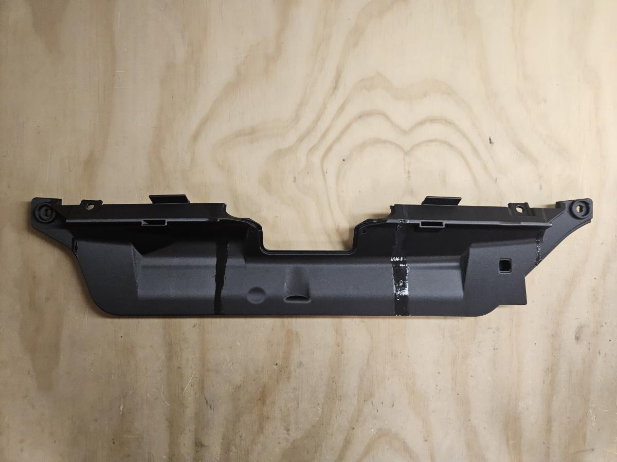

    It did look 90* but I didn't spend a bunch of time staring at.
    When it cools down outside I'll pull it apart and compare to a stock one.

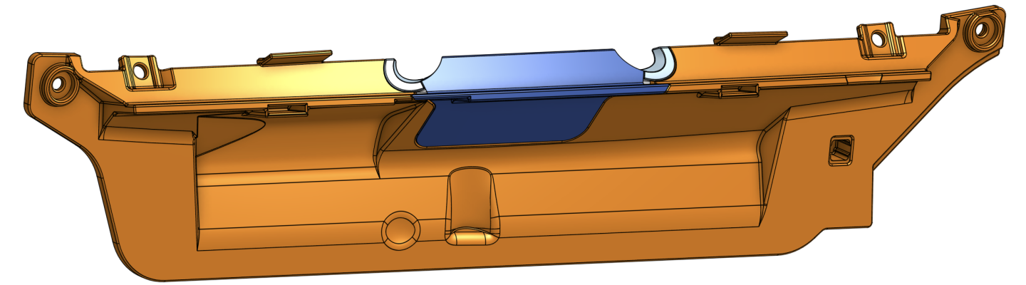

                  Life got busy, so haven't had too much time to work on car stuff. I did manage to chip away at the HVAC plastics design, though.

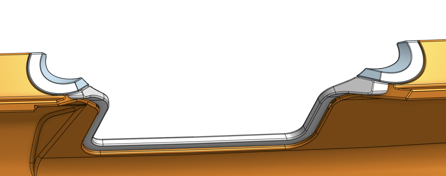

                  Firewall plug is basically done. Here's what it's gonna look like:

                  Sealing is bit of a challenge with this design. This part needs to seal against the firewall, the removable insert (dark blue part), the filter housing and the braces. Gonna be printing out TPU gaskets for all of that. Here's a clearer view of most of the sealing surfaces and the associated gaskets (light blue and grey):

                  The removable insert still needs some work. Need to model in the gaskets for the braces and the fastening point to the cabin air filter housing. Should be fairly straight forward to do.
                  Plan is to have the insert be held up against the firewall plug with magnets, then fastened to the filter housing using the OE hardware.

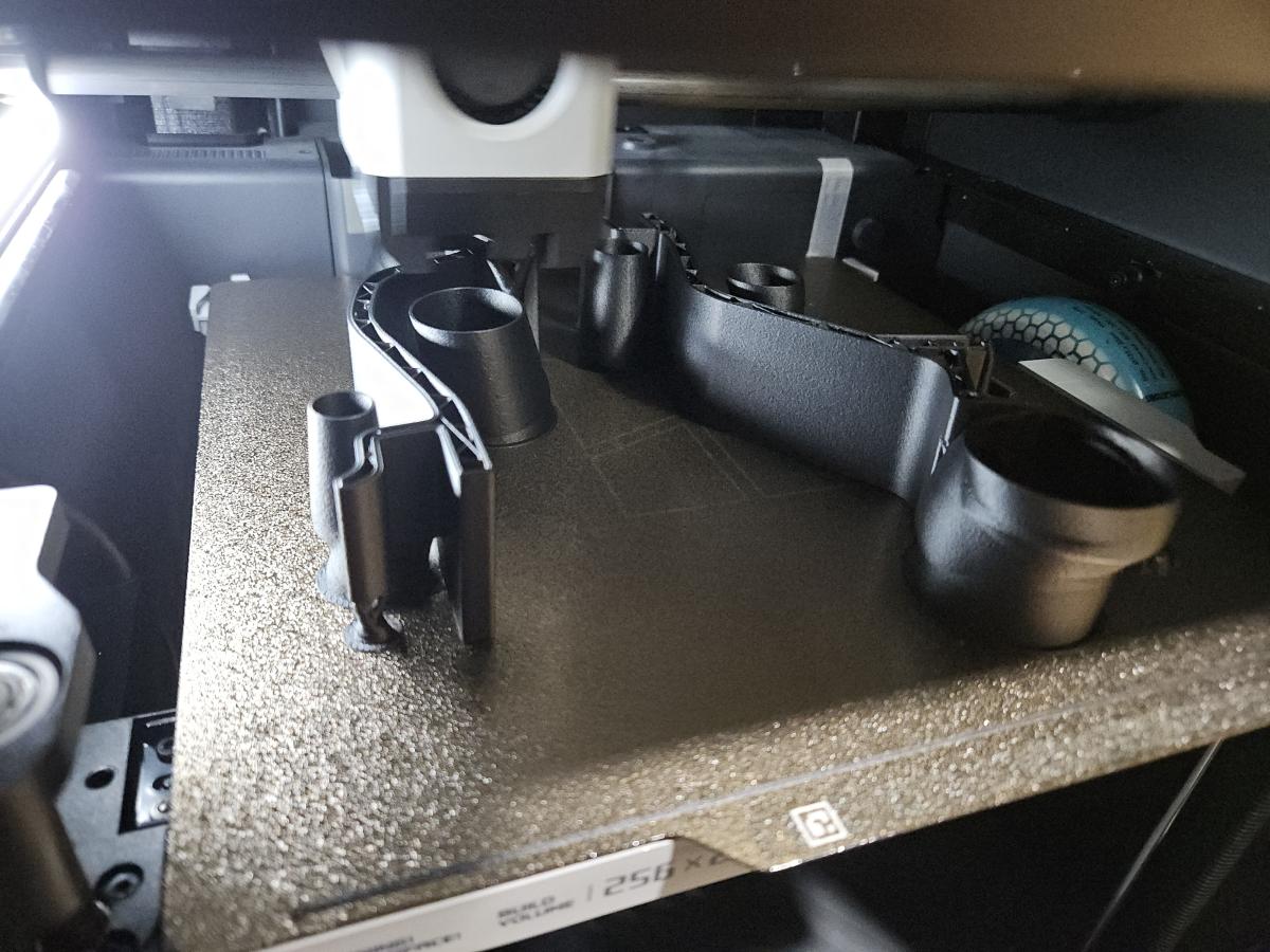

                  Printed the firewall plug (no insert) out of PET-CF. My mind is blown every time I see this material get printed, surface quality is just nuts:

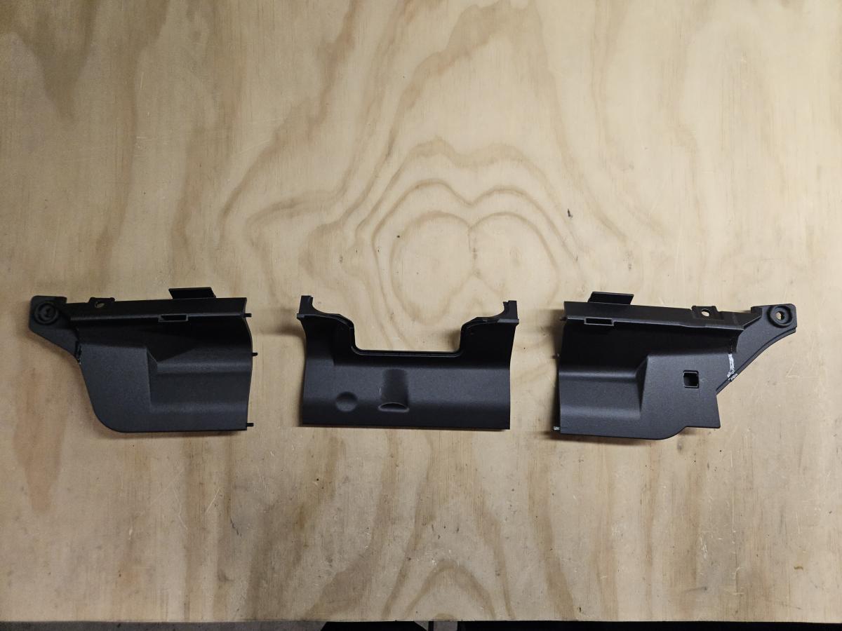

                  As mentioned previously, the whole thing is too big for the printer, so I sliced it up into three parts and printed some dowels to locate all the pieces together. I made the dowels separate parts so that they could be printed in a favorable orientation:
                  All glued up:

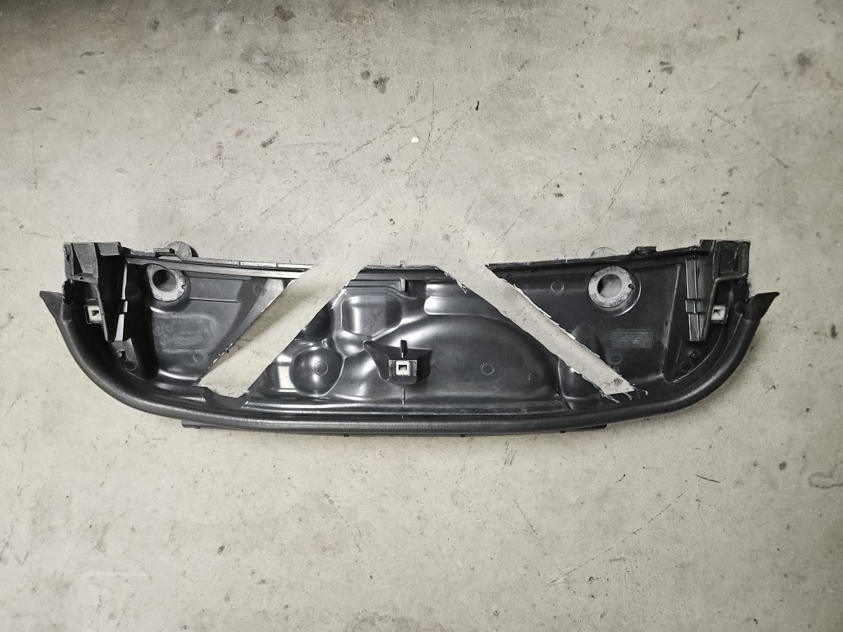

                  This is where I should have stopped, but I'm doing a track day at Thunderhill tomorrow and it's forecasted to be >90 F, so I definitely want some thermal insulation. Cabin air filter housings are like $30 on eBay, so I horribly hacked mine up to fit:

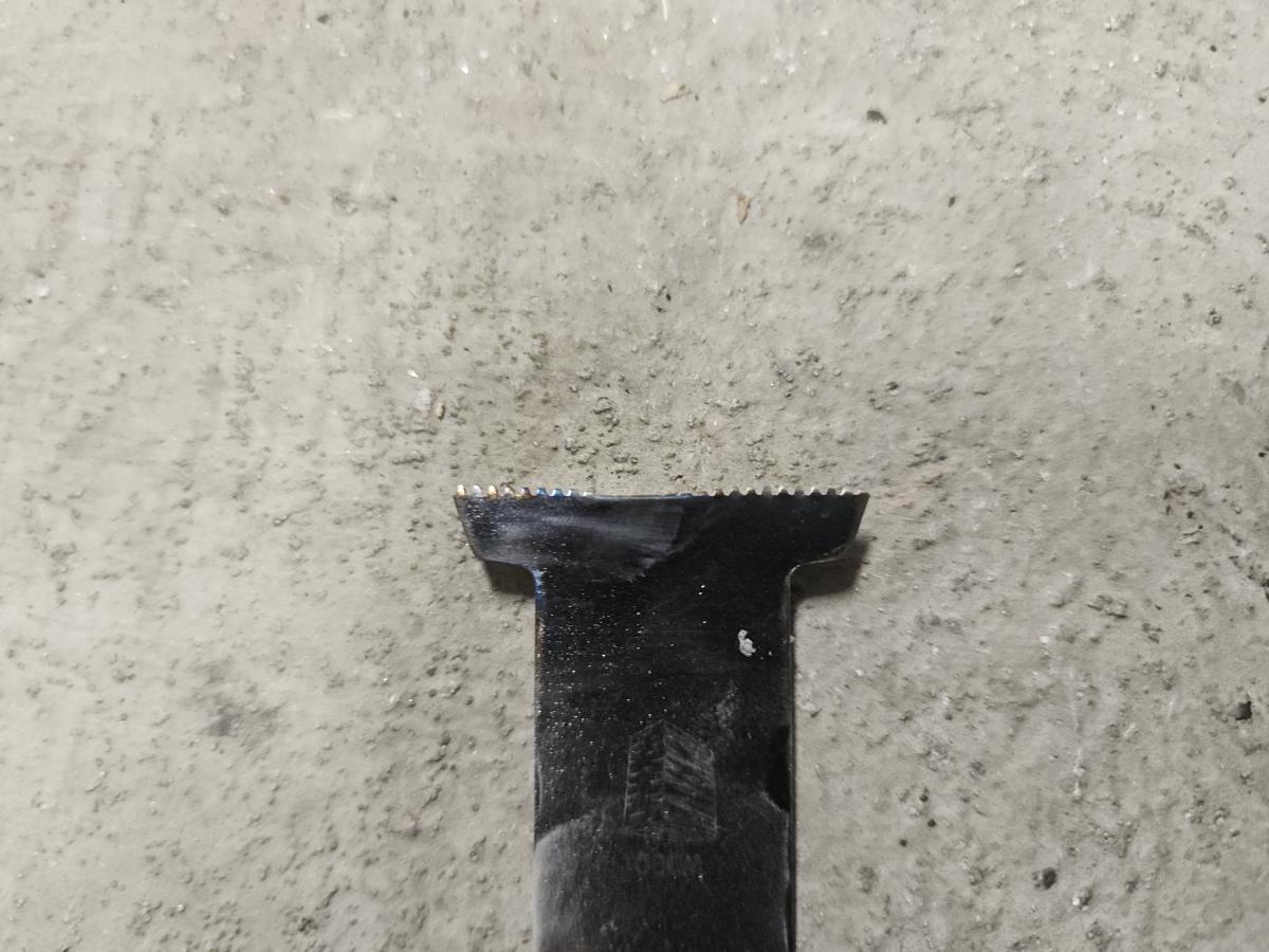

                  Sidenote: I forgot to swap the blade on my oscillating cutter and accidentally confirmed that the material that the part is made of is definitely glass fiber reinforced
                  Absolutely does not seal, but at least it'll protect against most of the radiant heat:

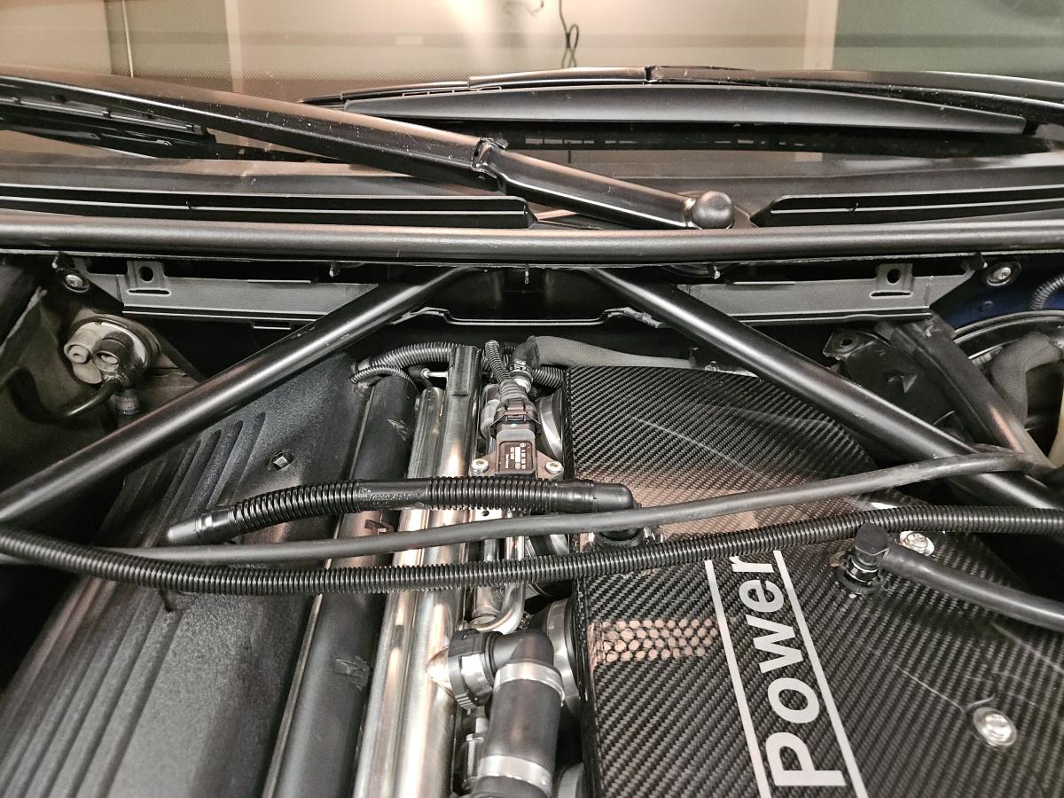

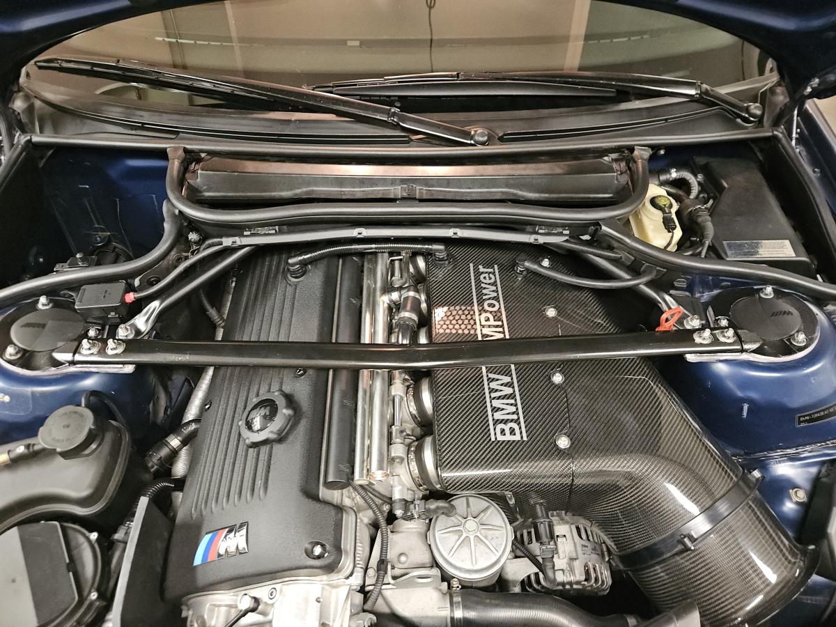

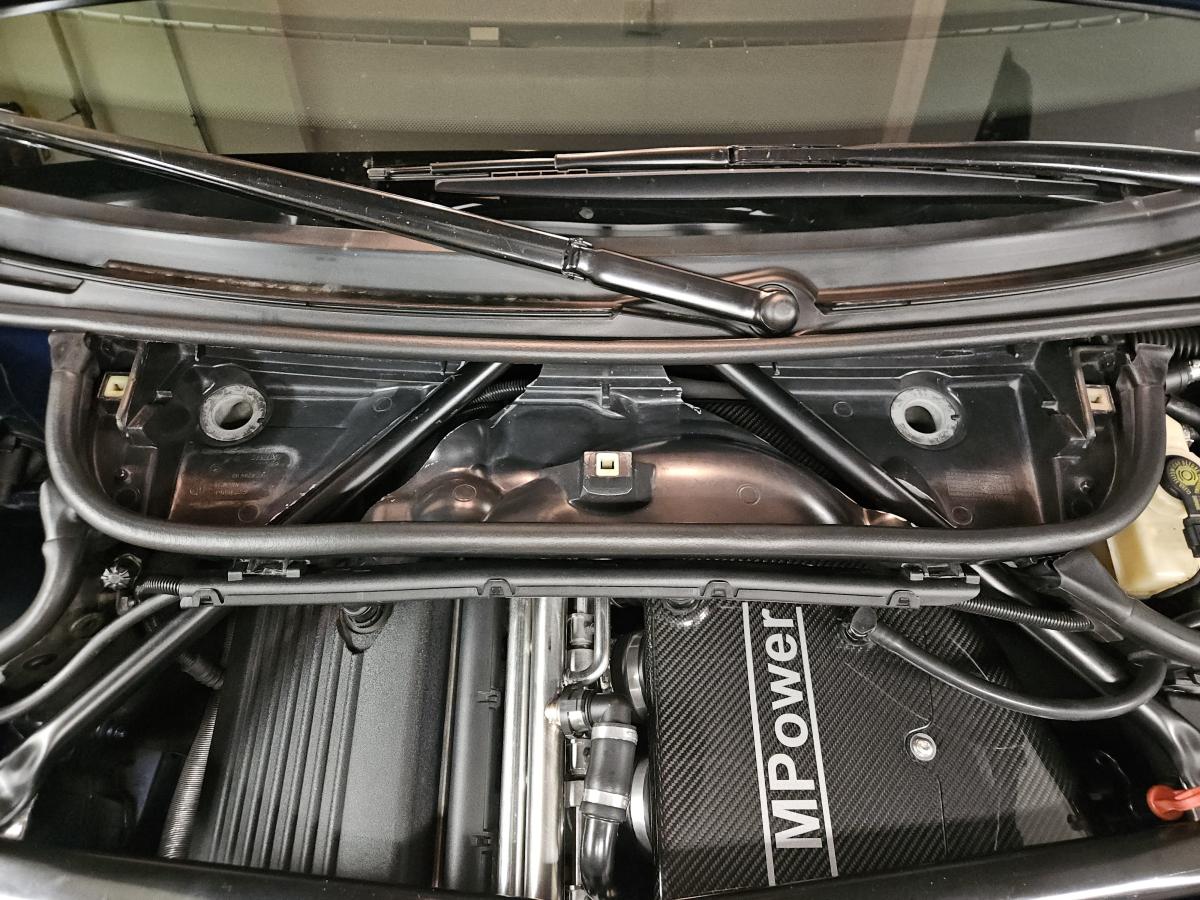

                  Also, this is really cool. First sneak peek at the fully assembled engine bay:
                  I'm honestly really, really happy with how inconspicuous it is.
                  More to come...

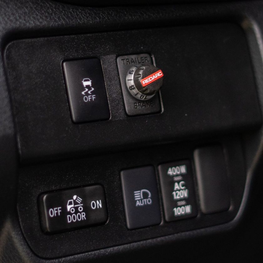

                                After writing the post above, I've been researching filments till now... and ended up ordering Prusa's PETG CF. From what I gather, surface finish is a little better still, in exchange for heat tolerance-- so won't be using it around exhaust bits.
                                ... going to save it for special occasions. Really went down this road because I want to print a bezel for the trailer brake controller I just ordered for the Land Cruiser.
