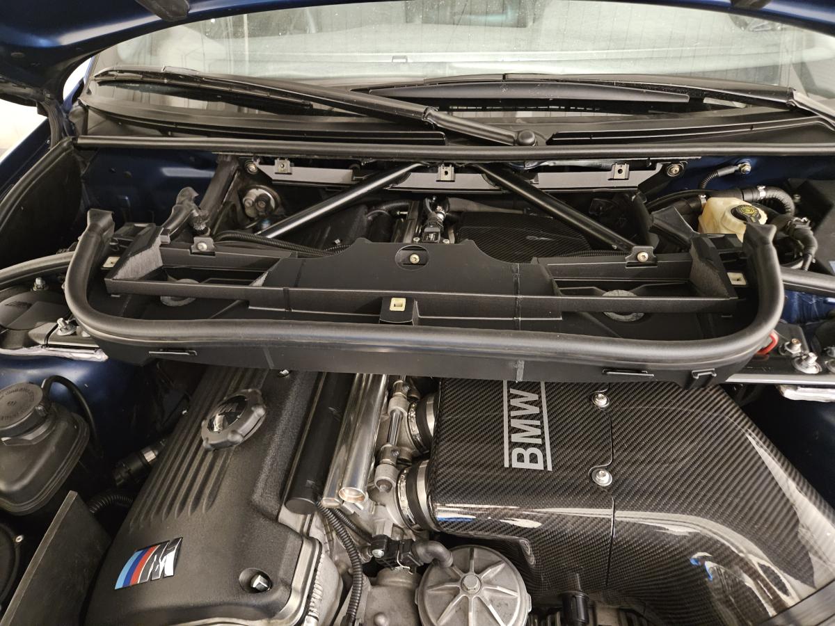

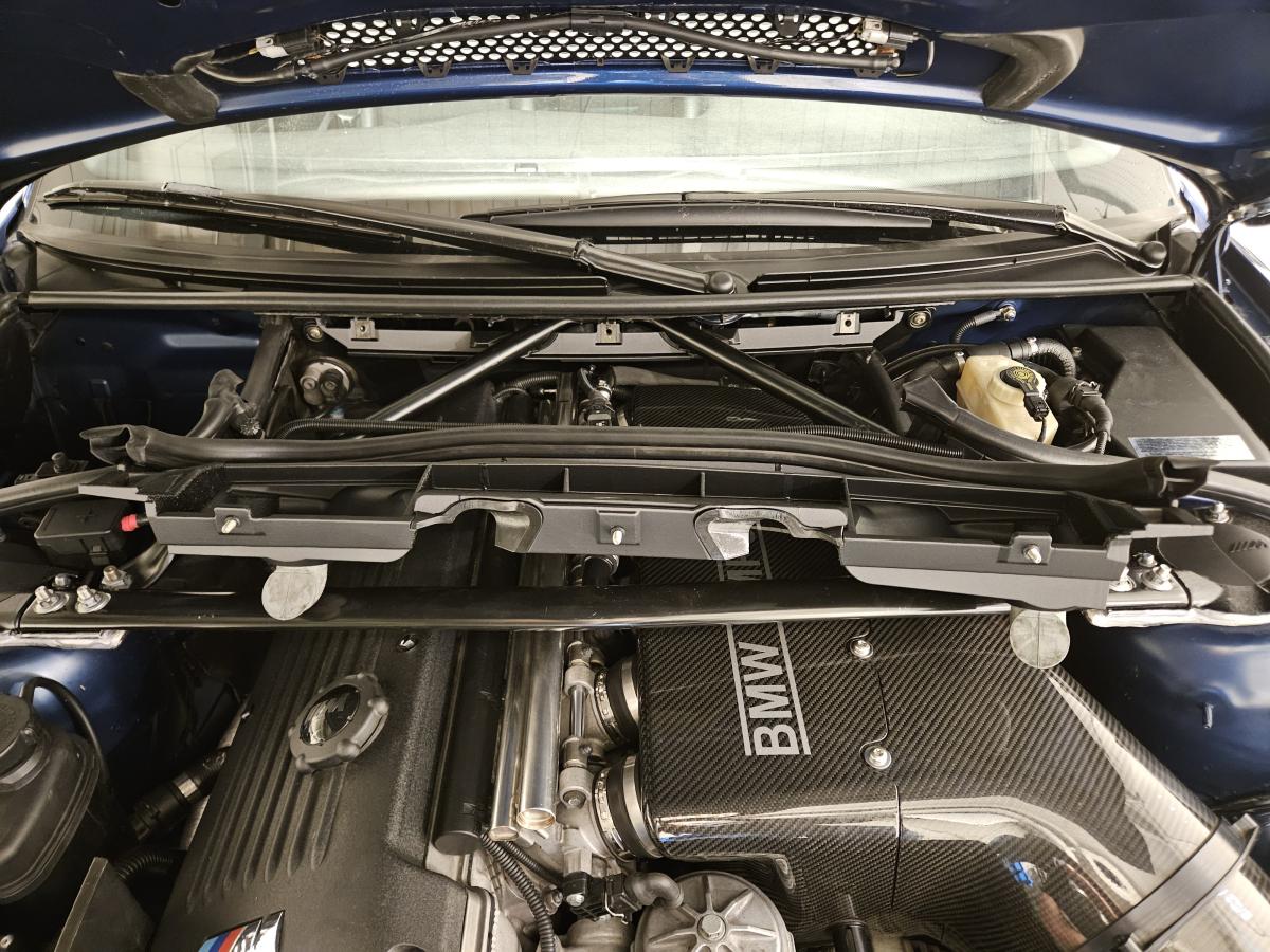

        Aaand done!

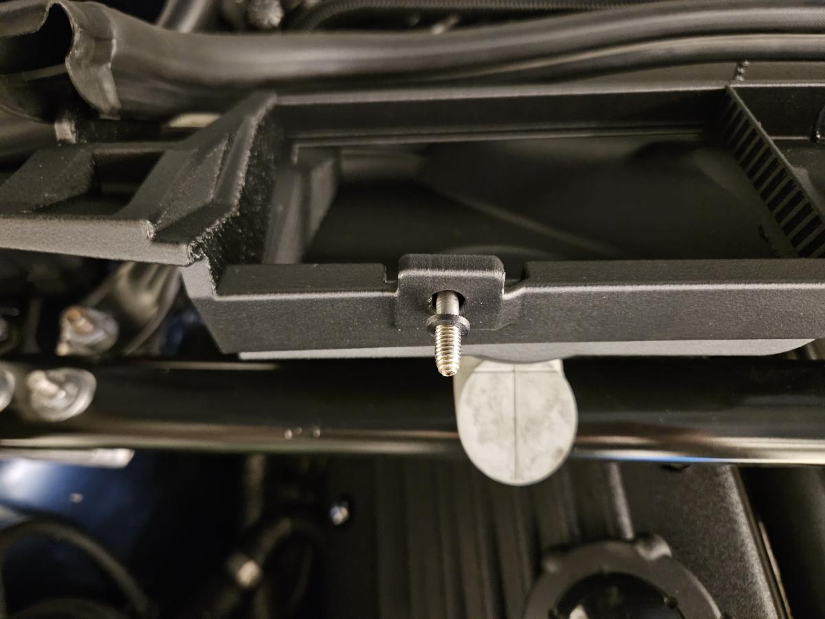

        Well, not entirely done. Still waiting to receive the flat gaskets that seal against the plug and the filter cover. Oh and need to make the strut tower brackets pretty. I'll get to those details later.
        Printed some retainers for the screws as well, to try and make it harder to lose them.
        Not sure yet if they make it better or worse. Middle one definitely helps, but the outer two kinda get in the way. Might end up removing the retainers for those.

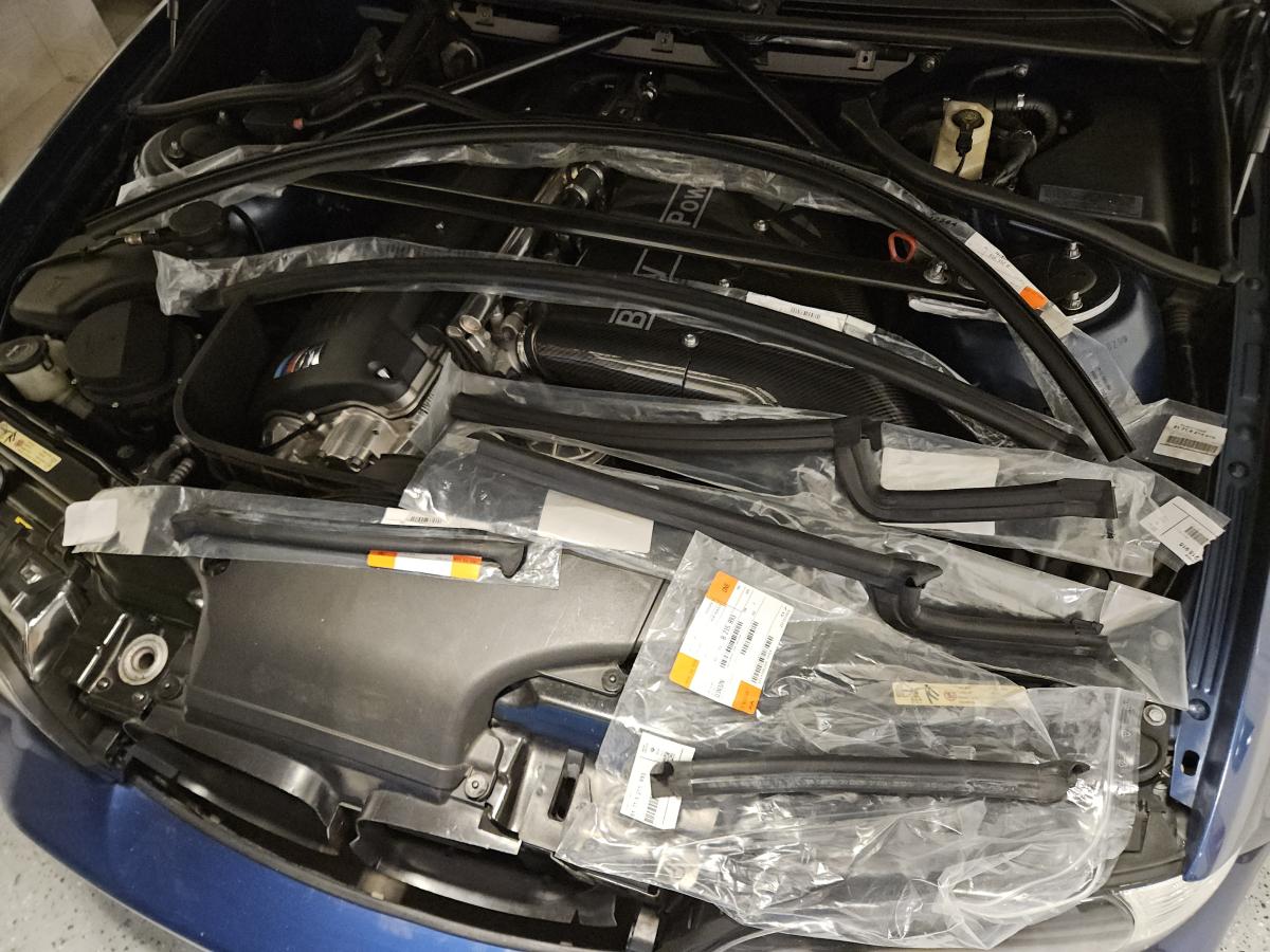

        Also replaced all the hood seals while I was at it, as they were original to the car and kinda starting to fall apart:
        I'll try to get some pictures with better lighting this weekend.
          New hood seals! Luxurious.
            Right? I felt so fancy putting them on.

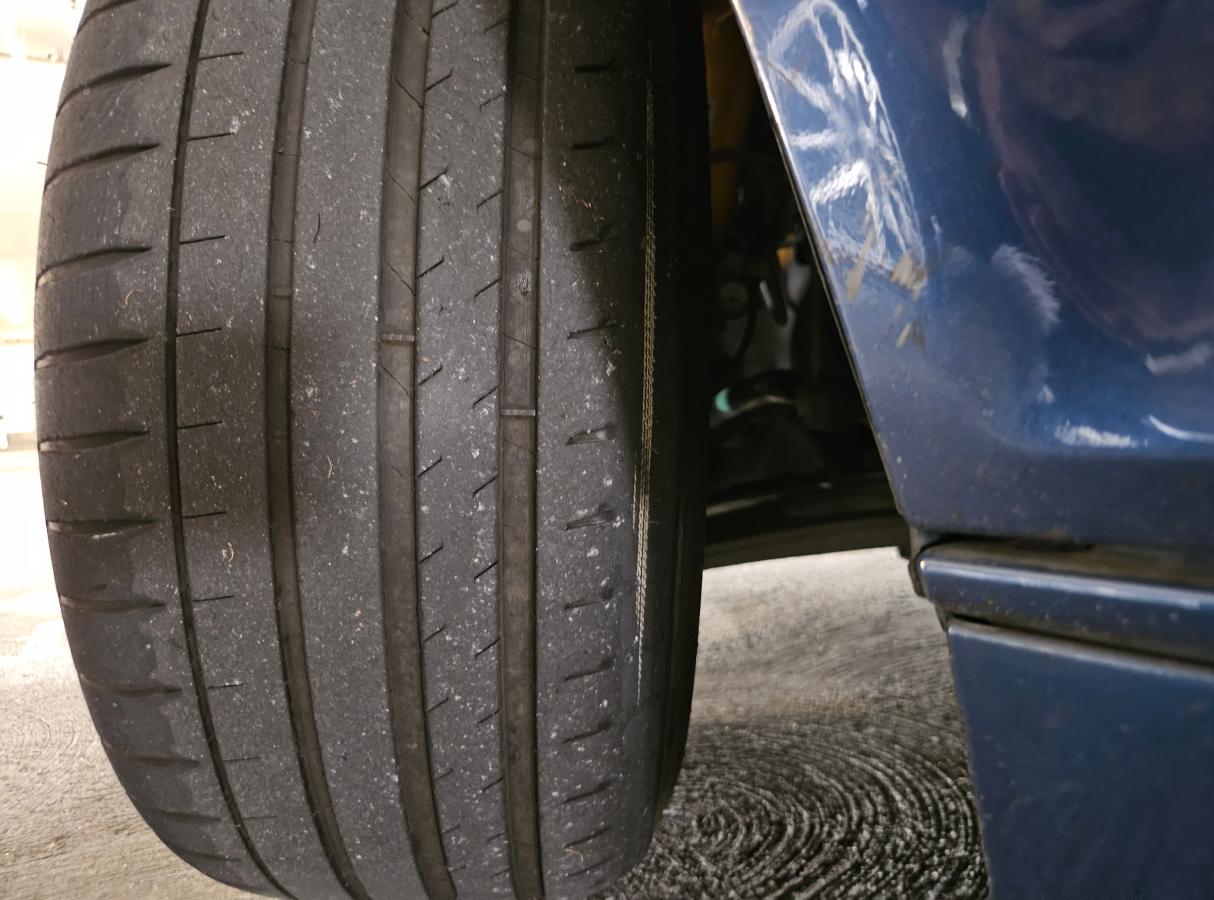

            Speaking of fancy, my street tires have been heat cycled out for a bit now, but I was holding out to see if Michelin would finally release the PS5SSS5Super in 18", so I hadn't gotten new ones. But then I noticed this:
            Fine, guess I'll swap them out for a new set of PS4Ss. Gave the mobile tire guy who's always at the track a call and he swapped tires for me in my driveway. Not having to stuff a bunch of tires into a car and then drive to the tire shop was truly the ultimate luxury, don't think I can go back.

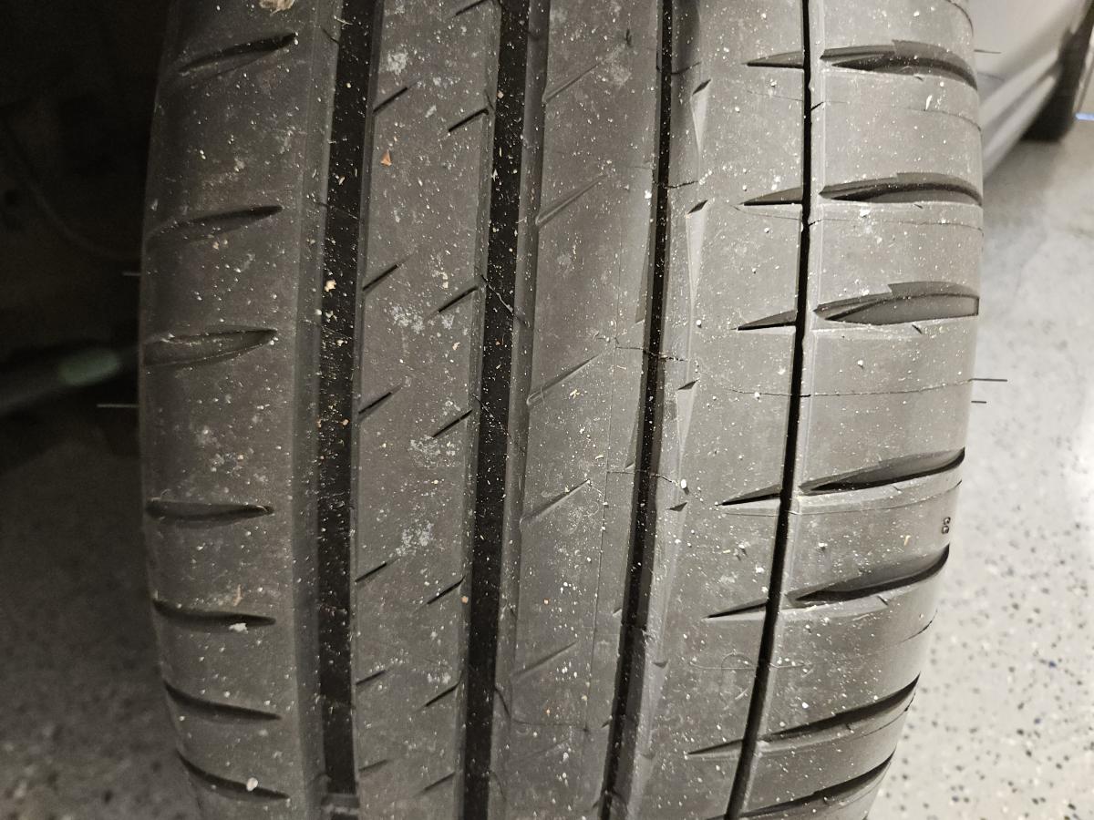

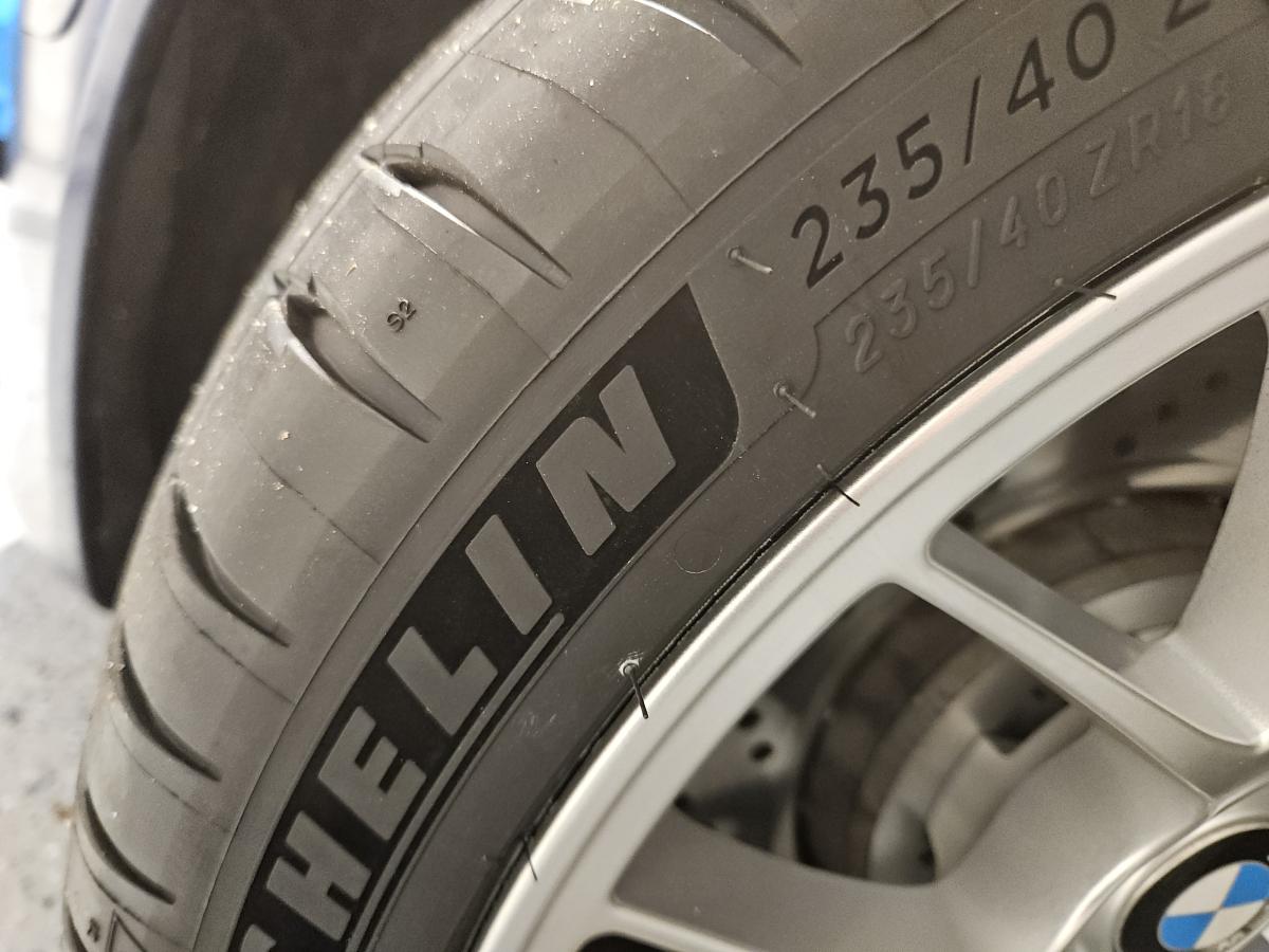

            I did notice this texture on the new tires, guessing it's to enhance contrast for aesthetics.

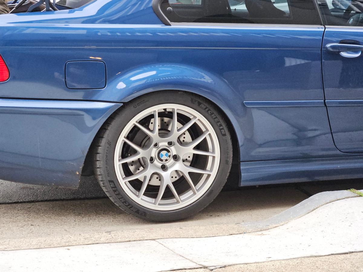

            Also, decided to give up on road force balancing. I've always asked for it in the past, but it seems to still result in vibrations at higher speeds (80+ mph). Went with a traditional balance this time around and the car feels perfectly smooth. Good stuff.

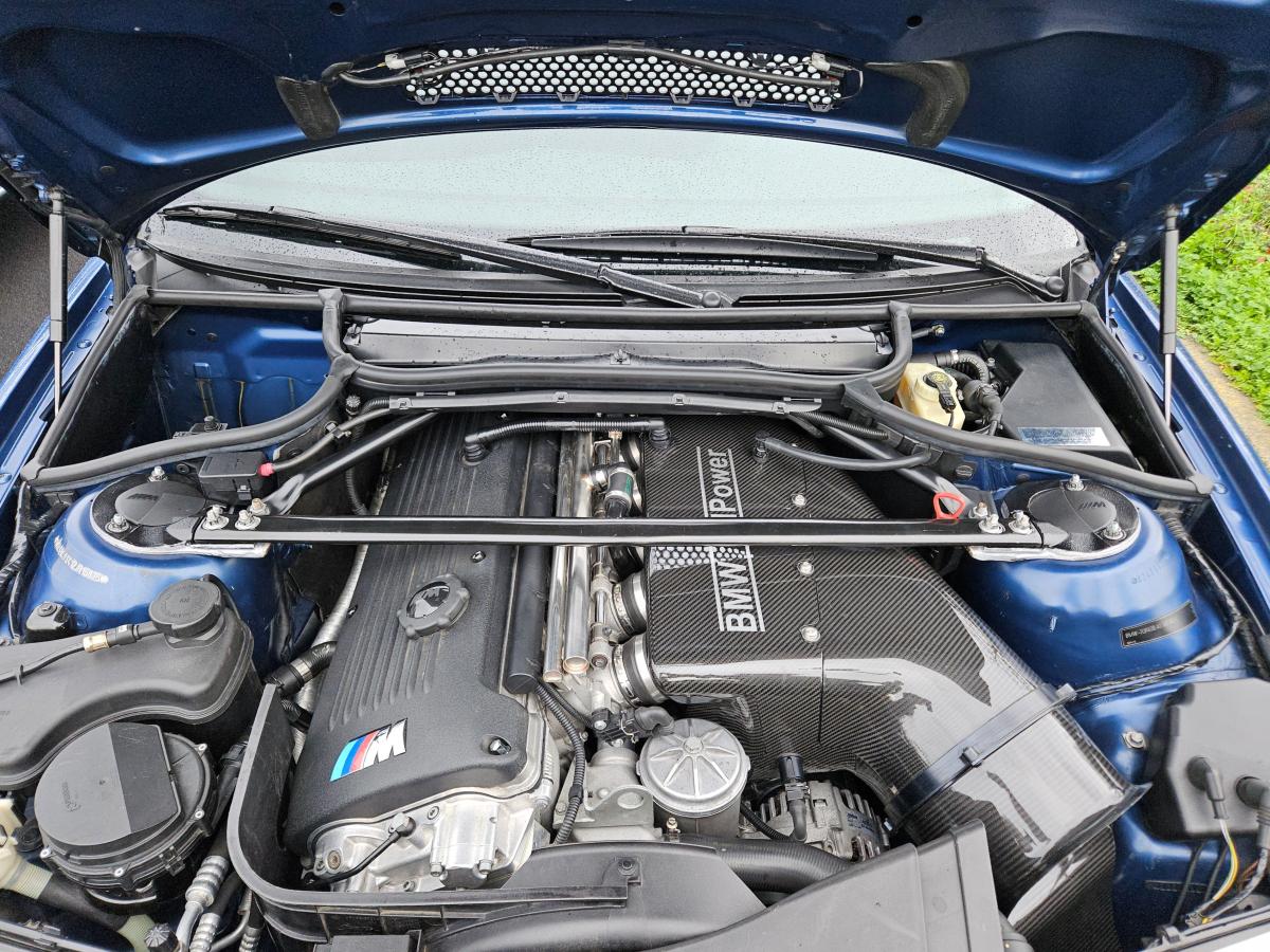

            Lastly, got a daylight pic of the final final final v3 version of the strut tower bracing. You can barely tell they're not stock. Amazing.
              Wow bracing and cabin air filter housing looks absolutely OEM, truly an amazing job!! I think I know what the next project will be after finishing the engine swap in the E30
                Hell yeah! Would be super cool to see these parts on other cars.

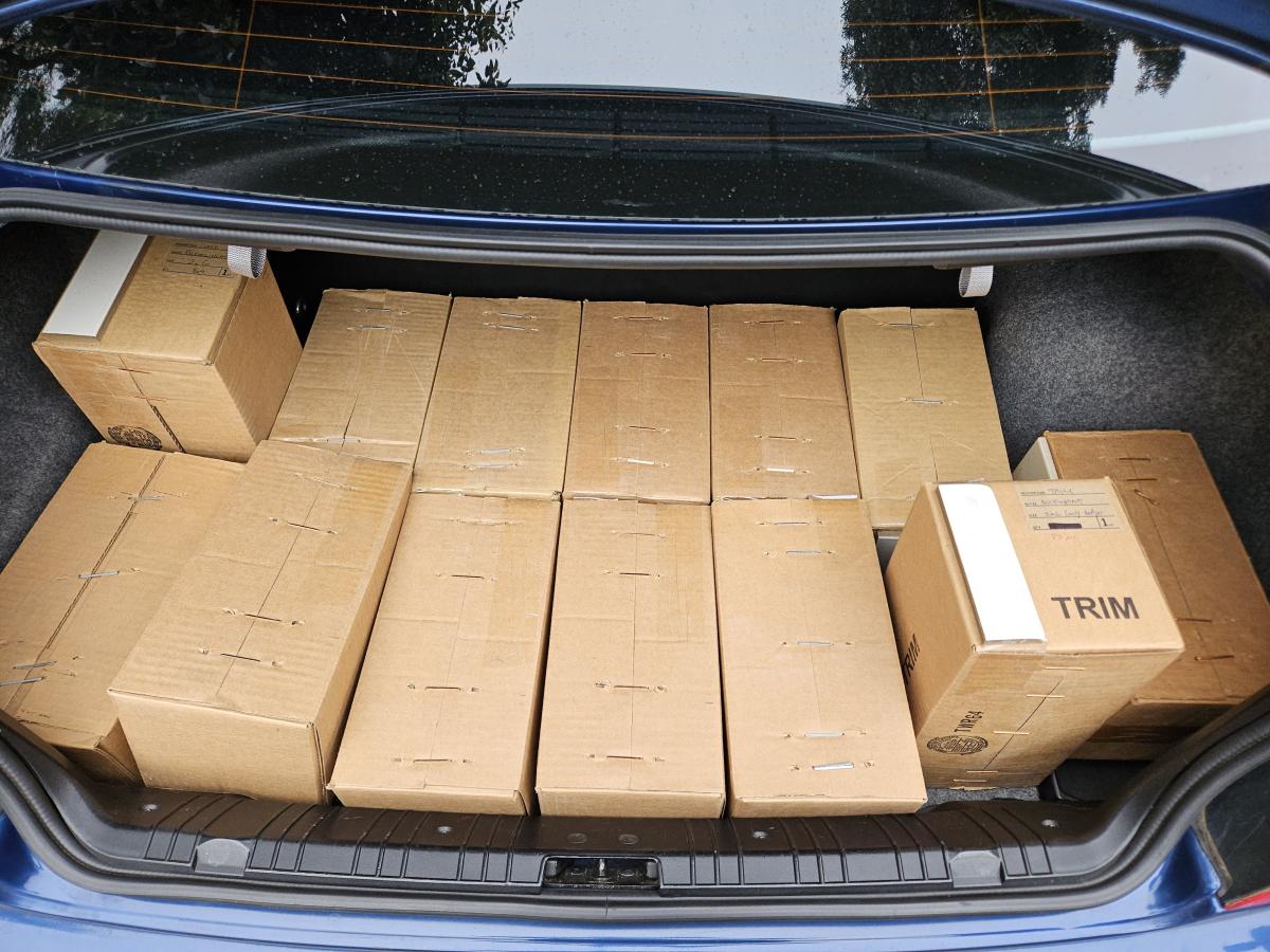

                  Man, I love this thing. Just a few weeks ago, it was flying off the racetrack and today it hauled a bunch of tile for a bathroom remodel (with working cabin air filtration!).
                  Click image for larger version  Name:	20251221_132635.jpg Views:	0 Size:	160.5 KB ID:	330826
                  Who knew that throwing a couple hundred pounds of tile into the trunk was all you needed to prep the car for instagram fame?
                  Click image for larger version  Name:	20251221_142832.jpg Views:	0 Size:	150.2 KB ID:	330827
                  What a good car.

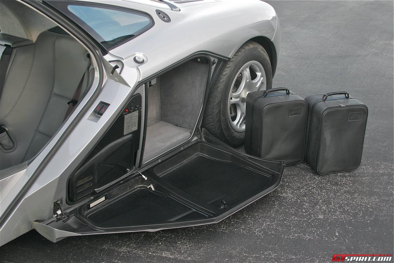

                    ^ You couldn't do that in a McF1
                      McF1 has way more space than you'd expect in those side pods.
                                Check your toe
                                I see road force balancing (RFB) more as a diagnostic tool than something I would routinely do. I used RFB to determine how out of round a wheel was - can't always see it on a dynamic balancer or if the tire was bad (it happens). I never saw a situation where a RFB fixed a vibration issue where a dynamic balance couldn't. In some cases, a RFB made noise and vibration worse. Whoever is mounting a new tire needs to understanding the markings on the side of the tire to orient the high point of the tire with the valve stem which typically optimizes the balance.
                                IMO, RFB as a routine is the nitrogen of tire balancing - mostly useless, makes the shop more money, and is often "flat rated" by techs. Meaning they say they did it...but didn't do it.
