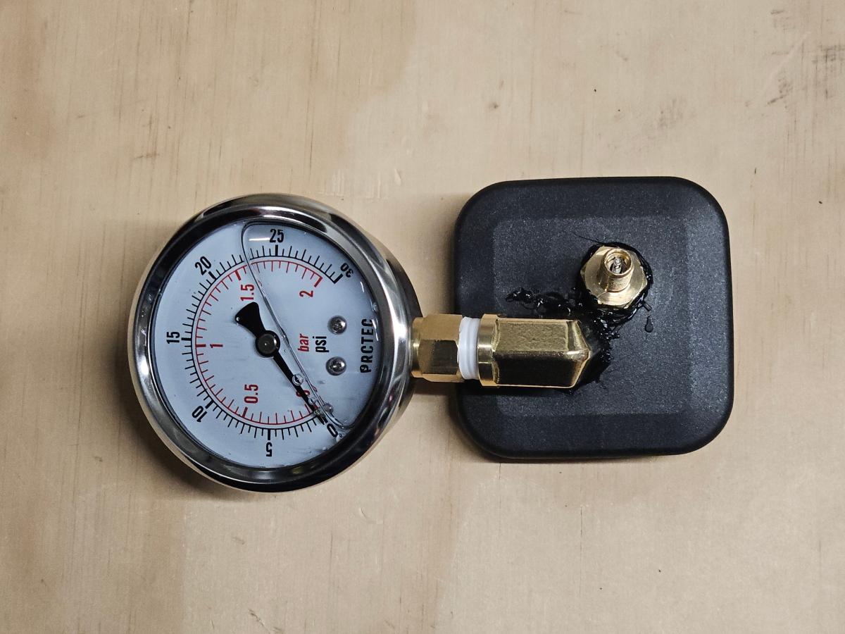

      I don't want to start randomly throwing parts at the problem though, so I'm gonna rig up a pressure tester and grab some data first. Pretty sure I have a spare oil fill cap somewhere, so should just be a matter of drilling and tapping a hole for a pressure gauge. Stay tuned.
      Coming back to this.

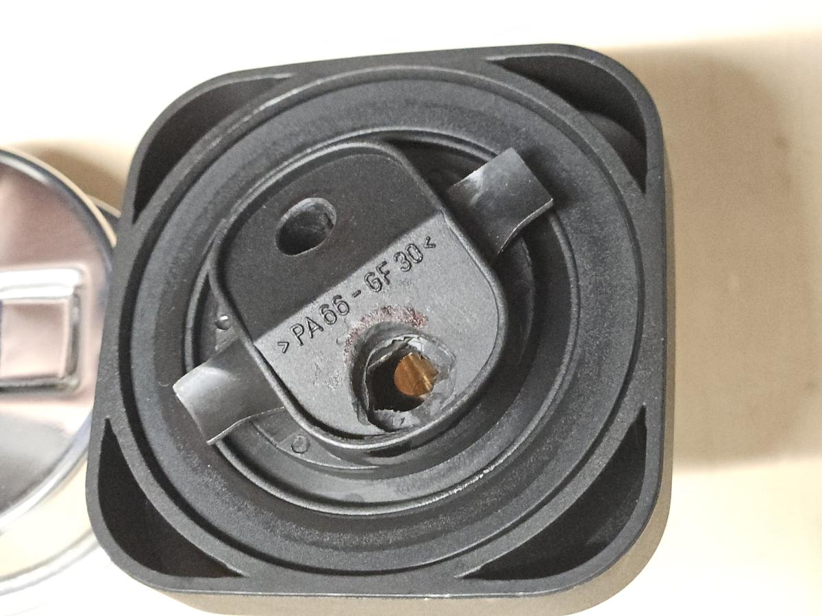

      I did not, in fact, have a spare cap in the stash, so I ordered a cheapo one.
      Turns out the cheapo cap is hollow inside:
      Click image for larger version  Name:	20260416_202623.jpg Views:	0 Size:	128.4 KB ID:	352195
      Slathered a bunch of RTV on the threads to try and salvage this attempt:
      Click image for larger version  Name:	20260416_202644.jpg Views:	0 Size:	116.4 KB ID:	352196
      But I'm not at all confident that it will seal. Think it's highly likely that the next update on this effort involves a CAD screenshot of a custom cap with NPT ports on it.
