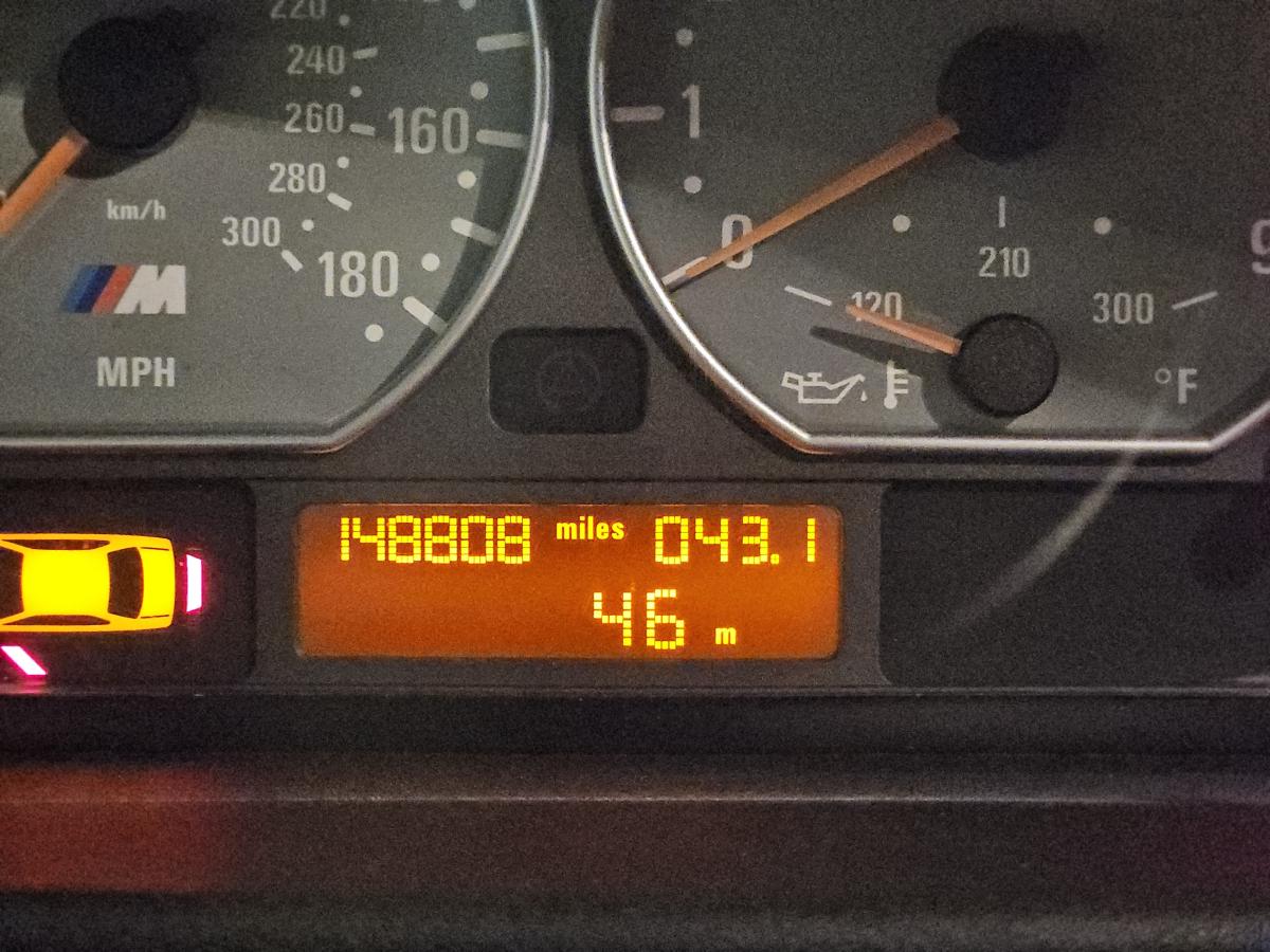

    Looks like it's 'm' because there is no freedom units version of short distance:

      Makes sense. There's the "F" used for the temp, but trying to use that in place of "ft" would probably have been very confusing.

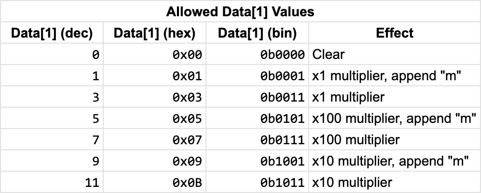

        Also, finished running through all Data[1] values and only came close to dying of boredom 15 or 20 times.
        Anyway, this is how the values are encoded, to the best of my understanding:
        Click image for larger version  Name:	Screenshot 2026-04-13 at 10.37.39 PM.png Views:	4 Size:	59.2 KB ID:	351675
        Full investigation here if anyone is curious: https://docs.google.com/spreadsheets...it?usp=sharing
        Worth noting that there is no x1000 multiplier. I must have sent 10x100 and seen 1000 earlier or something along those lines.
        Even with the multipliers applied, the weird base10/16 counting still happens. I'm starting to wonder if this is an undefined-behavior-type bug/oversight. Maybe the mi/km theory has some credence and BMW only ever planned to display max 10mi/16km for each of the multiplier stages.

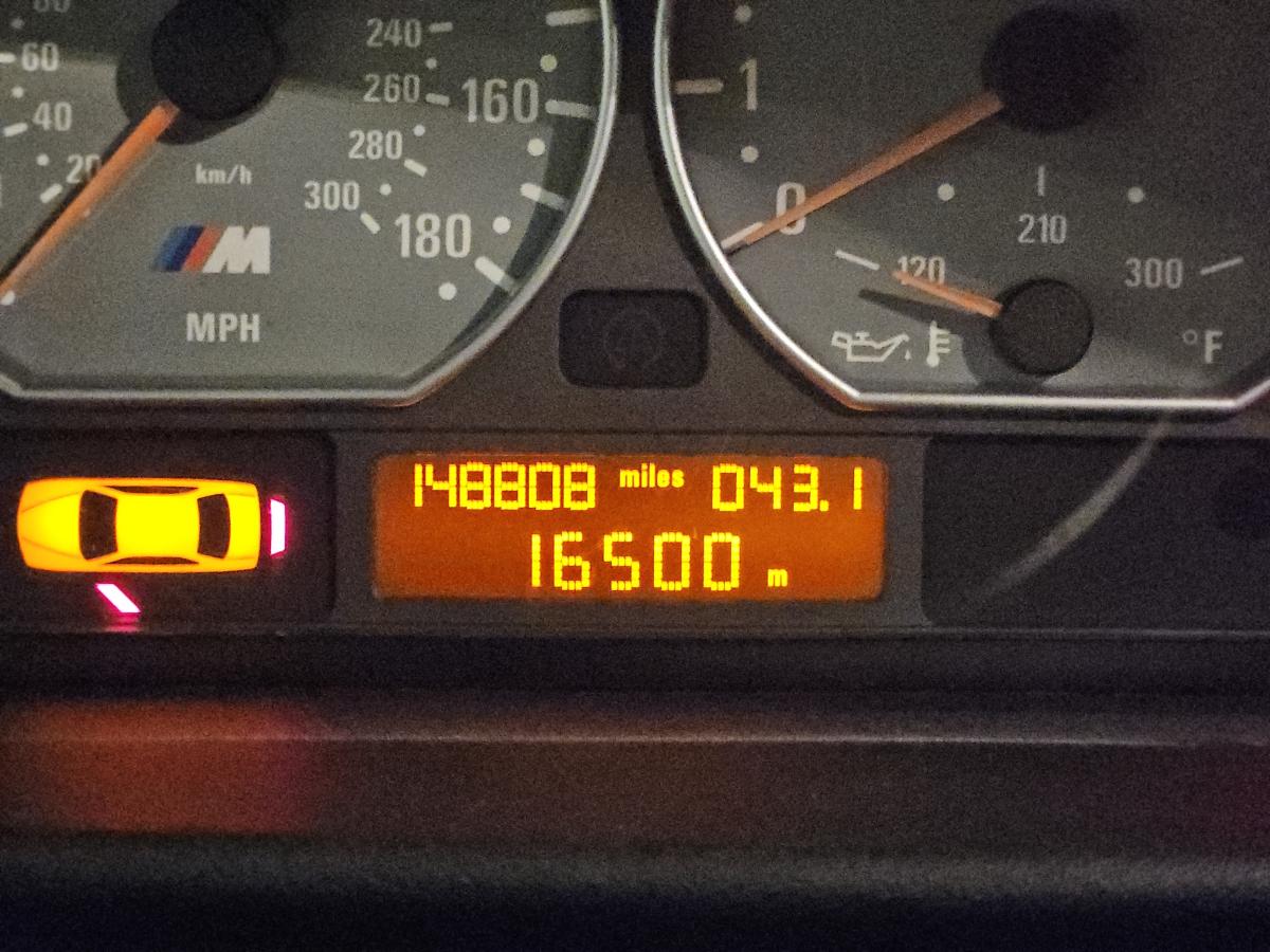

        Regardless, the x100 multiplier still works with the 165 max. Not that I see it being particularly useful, but it's good to know that you can go that high:
            Freedom units are missing because the British use yards as their unit of distance (or at least that's what BMW baked into the Navi when coded for GB).

                        I emailed you about this, but for the sake of the forum at large, I believe BMW is using binary coded decimals rather than converting the byte to decimal.
                          Just curious - if that was the case wouldn't it mean that the max value you can get from a byte is 99? whereas Heinz is managing to get to 165?
                          Edit: actually I think what you're saying is that the cluster assumes BCD but its assuming it's going to get the right value and its actual implementation is looser and allows you to overdrive it in slightly weird ways.
                            Yes, input validation is not something these engineers really cared about.
                            I think 0xFF is translating to decimal 165 because of an overflow —
                            0xF = 15
                            So, 1515, but somewhere in the logic the 15 and 1 are being added to the same register.
                              0xF = 15
                              Love it - that makes complete sense!
                                Yep! Think Ted cracked the code. BCD makes total sense.
