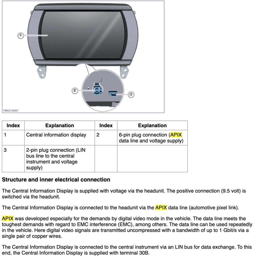

                    Any idea how it displays images? I vaguely remember there being a bunch of stuff on the board behind the screen. Guessing the input is some digital protocol that talks to the nav computer and then the circuitry behind the screen figures out all the displaying/touching bits?
                    Edit: Looks like the answer is a protocol called APIX:
Name:	Screenshot 2026-04-12 at 6.08.23 PM.png
                    First time hearing of this, but it seems pretty powerful. Copy paste from INOVA's website:
                    The new APIX3 technology supports transmissions of up to 6 Gbps over one shielded twisted pair (STP) cable and up to 12 Gbps over a quad twisted pair (QTP) connection.
                    APIX3 offers a number of unique features for in-car video, such as:
                    - Enables the transmission of multiple video channels on one connection (which supports advanced cockpit architectures);
                    - Supports 100 Mbps Ethernet and other serial interface protocols;
                    - Provides advanced diagnostic capabilities, including cable monitoring, for preventative detection of cable degradation.​
                    That's impressive. Seems like you could figure out how to package the screen in the dash and then just run a single cable to a controller that can live basically anywhere.

                      I can send you a photo if you'd like. Personally? No idea. It's like an old clamp down ribbon cable. I think the Switch has connectors that look similar.
                      The accompanying board takes in APIX. Now, there are “tons of” eBay kits for like aftermarket reverse cameras that override the iDrive view to display their own. Aftermarket iDrive kits for NBT non EVO do this too. So there are cost-effective ways to broadcast to it and receive inputs for touch. I just have my mini board I'm designing and power a high-yes display like that requires way more compute and probably custom drivers than what I'm working on, so that's when I walked away. Sticking to my strength areas with frontend web/mobile design and backend design.

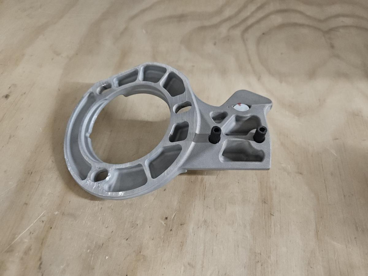

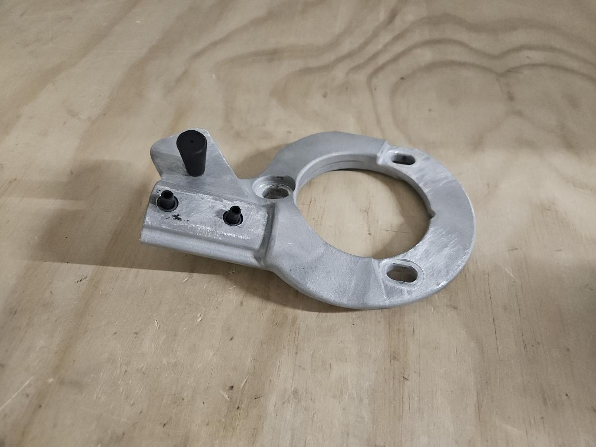

                              Brackets and braces dropped off for paint. Hopefully will have them back within a week or so.
                              I printed out these caps/plugs to try and make the lives of the guys at the bodyshop a little easier:
                              They're meant to stop the threads from getting painted and, in my mind, are easier than masking tape. The plugs are also hollow to provide a convenient place to hang the parts from.
                              I'm not the one painting the parts though, so these might be dumb and get thrown out, we'll see.

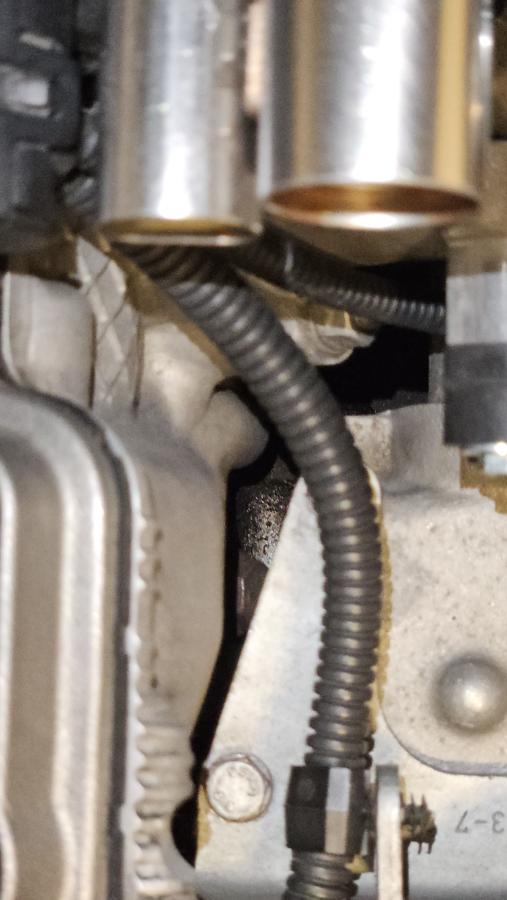

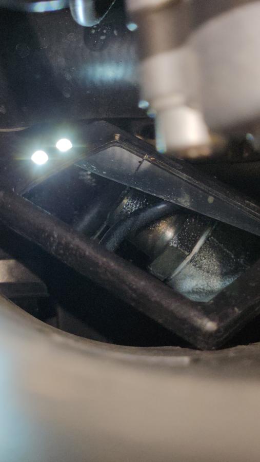

                              I think there's only a couple suspects left and one of them looks kinda suspicious:
                              It's really hard to see back there, but it does look wet right under the bolt that holds the top of the chain guide. I'll likely have to pull the intake and investigate more, yay.

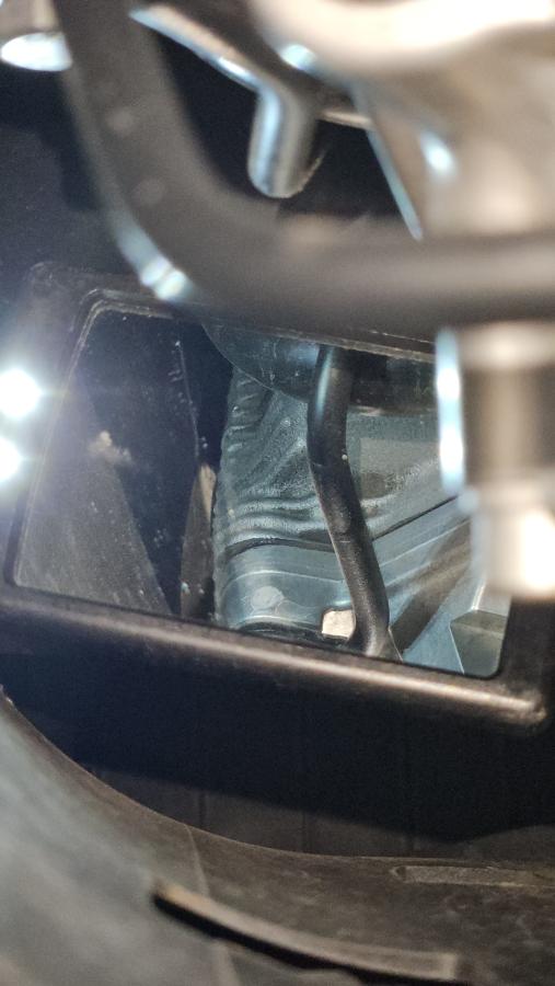

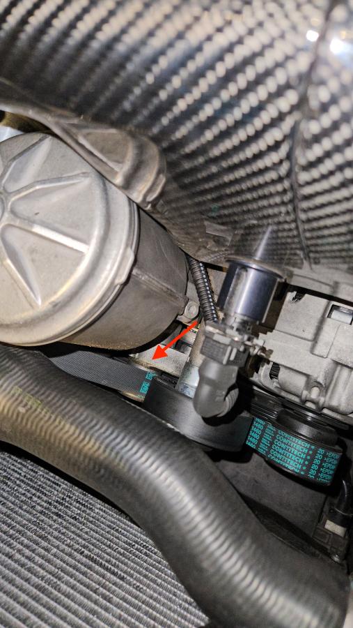

                              I'm starting to wonder if something in the PCV system is clogged and not allowing the positive pressure to vent correctly, which, in turn, is pushing oil past random seals. I replaced the oil separator and cleaned the channel in the valve cover a few years ago, but it might be time for another service.
                              I don't want to start randomly throwing parts at the problem though, so I'm gonna rig up a pressure tester and grab some data first. Pretty sure I have a spare oil fill cap somewhere, so should just be a matter of drilling and tapping a hole for a pressure gauge. Stay tuned.

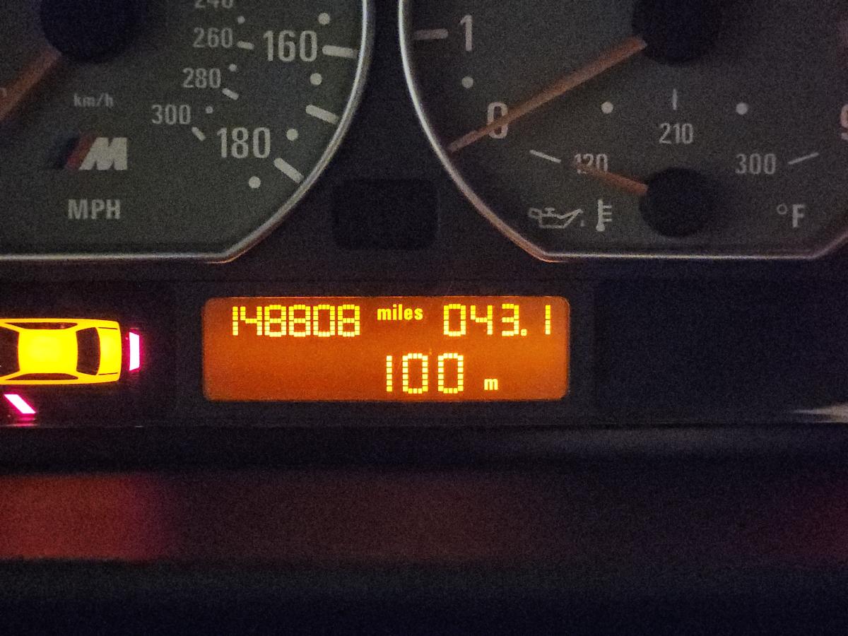

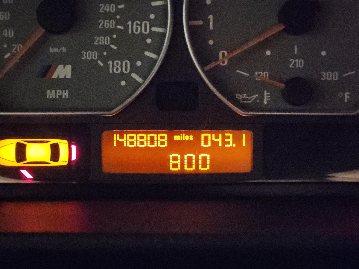

                                Continued messing with the low OBC in the cluster while I wait for my PCV diag tools to arrive.
                                Unfortunately, Obioban's mi/km theory didn't work out. I coded my cluster with a bunch of different unit combinations and still got the same weird base10/16 counting strategy. Still haven't figured out why it does this.
                                I also swept through a couple things I thought might yield results:
                                1. Entire uint16_t (had the BlueBus send out commands at 200 Hz so I didn't have to sit there all day) for the data value. Same deal, counted to 165 and reset back to 0, regardless of what the high bits held.
                                2. Entire one hot encoding of a uint64_t while holding the lowest byte static at <some_num>. Was hoping to find hidden flags this way, but again, no change.
                                So then I turned my attention to the other two bytes in the data field of the message and found something interesting!

                                I like the "m"! Can use it to represent "money shift". As in, "if you downshift with the revs this high, you'll money shift". Love it.

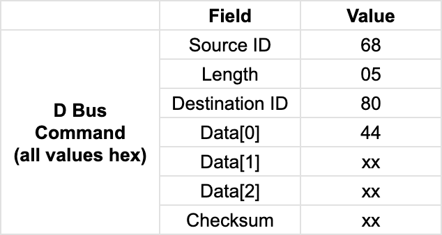

                                Here's the low OBC I-Bus message is structured:
Name:	Screenshot 2026-04-13 at 8.46.28 PM.png
                                where:
                                • Source ID: ID of module sending the message.
                                • Length: Data length in bytes + 2 (1 byte for destination ID, 1 byte for checksum).
                                • Destination ID: ID of module meant to receive message (0x80 for IKE in our case).
                                • Data[0]: 0x44 tells the cluster to write to the low OBC.
                                • Data[1]: Tells the cluster how to interpret Data[2]. Encodes multipliers and additional symbols to display. This is the interesting one.
                                • Data[2]: Data to communicate to the cluster. Bounded to uint8_t.
                                • Checksum: XOR checksum.
                                So, basically just structured like a normal I-Bus message, except the first two data bytes tell the cluster what to do with the data and how to interpret it.
                                Data[1] feels very "flag-like" (for lack of a better term), so I've just been poking around with sending various one hot encoded combinations and seeing how the cluster reacts. Based on my highly scientific messing around, I think the following options exist:
                                • 1x multiplier
                                • 10x multiplier
                                • 100x multiplier
                                • 1000x multiplier
                                • Display "m"
                                • Clear low OBC
                                For completeness I'm gonna go go through all possibilities for Data[1]. It's a uint8_t, so I think I can sit through the 256 combos and not die of boredom. Wouldn't want to miss some hidden format specifier just because I was impatient. A negative sign would be particularly cool, but not holding out too much hope.
                                Also worth mentioning that I double checked my cluster's coding and all units are set to imperial. Seems a bit weird that you can trigger an "m" instead of a "ft" symbol like this, but maybe the "m" is the only symbol allowed.
