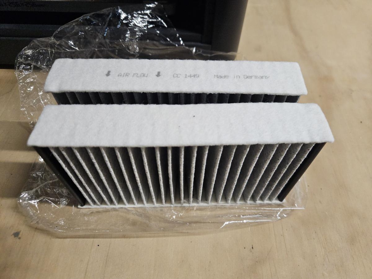

        First off, don't think I ever updated on this, but managed to get the filters I wanted from FCP:
        For anyone following along at home, you want the Corteco CC1449, not the Corteco CP1449.

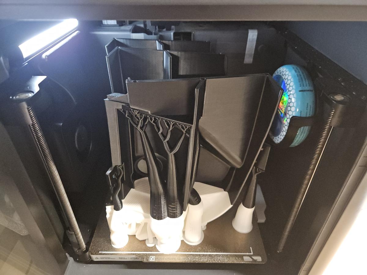

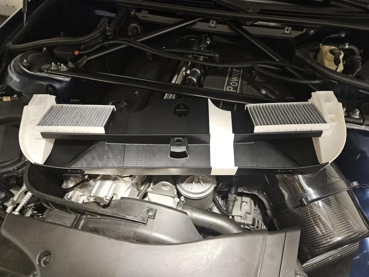

        Anyway, printed a last prototype out of some scrap spools I had laying around. Managed to squeeze all parts into one build plate, which was fun to see:
        Printed with just 1 wall and basically no infill, so the thing is dumb flimsy, but it works fine!

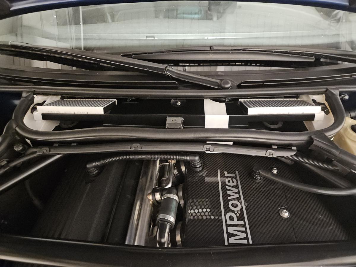

        Couple small tweaks needed, but it's looking great.
        Have started printing the PET-CF parts. Will update here when they're all ready.

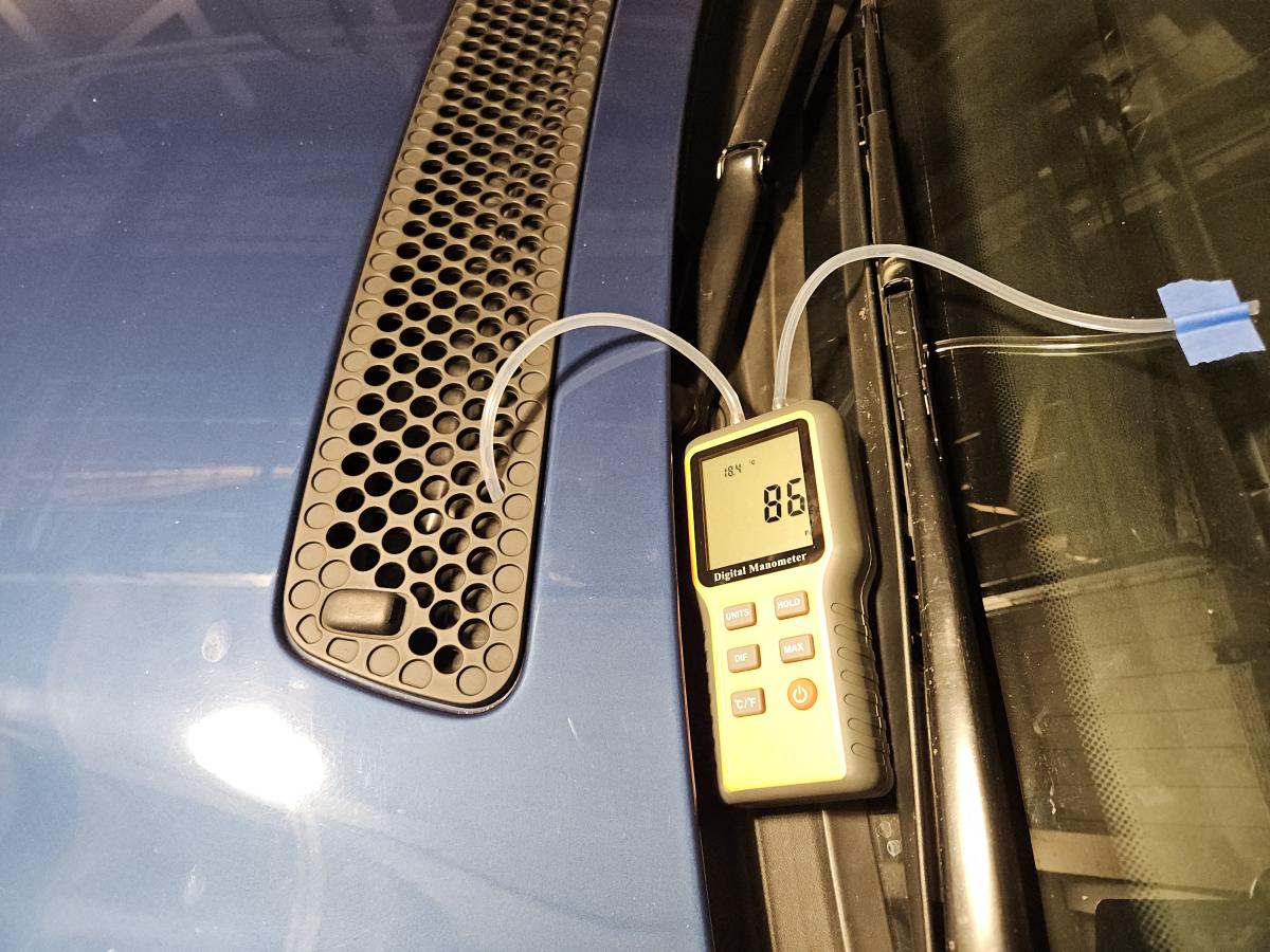

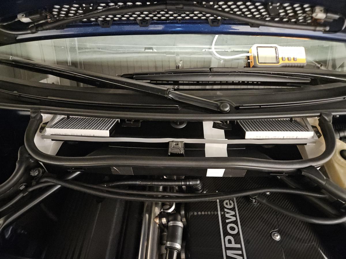

                      Alright, experimental setup ready.
                      Got myself a cheapo digital manometer, since I thought it would be a bit more versatile than the fluid ones. I really have no way of checking precision or accuracy, but the readings are very repeatable, so I'm gonna say it's good enough for this test.
                      Started by sealing the prototype with some random hardware store window seal tape. This is as good as it's gonna get, since the printer has been busy with the PET-CF parts and I have yet to get to the gaskets. Don't think this would hold up to engine bay temps, but that doesn't really matter for a static test with the engine off.

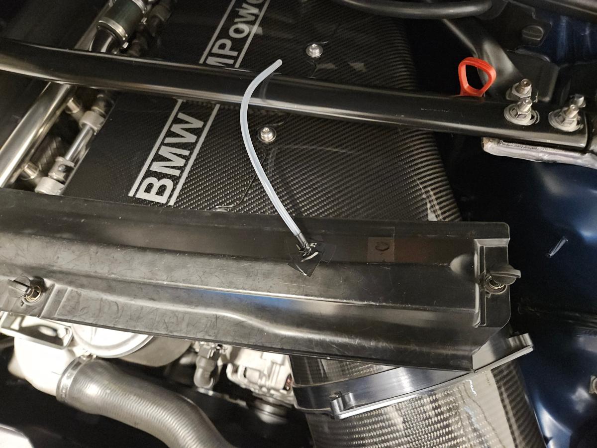

                      I then drilled a hole in the filter cover and sealed one of the manometer hoses against it.
                      (Sorry, what was that? No, I didn't drill the first hole in the wrong spot and then had to cover it up. No idea what you're on about...)

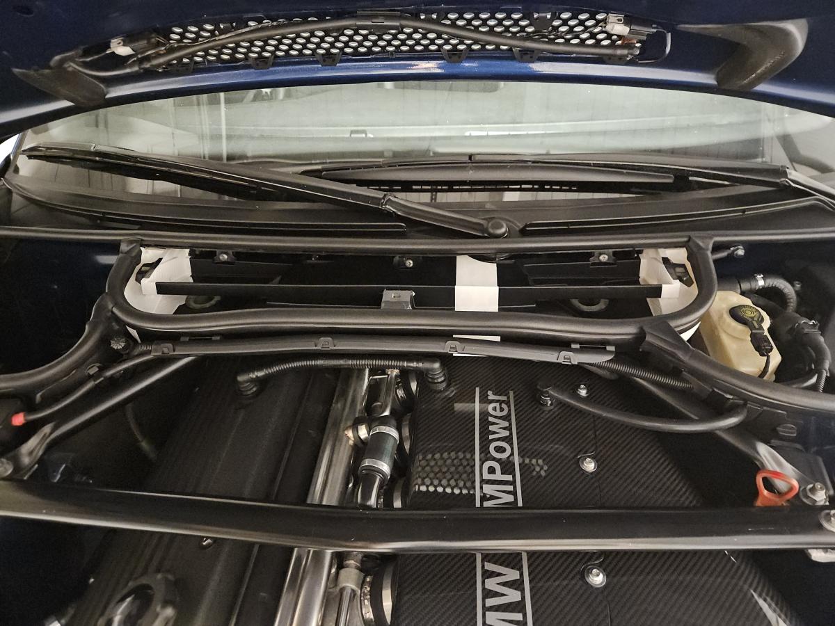

                      Plan is to take all measurements with the hood closed, to replicate real operating conditions. Easy enough to route the hose out through the hood grill and then connect it to the manometer. Reference hose got taped to the windshield to make sure that's the same throughout the tests:
                      (Ignore the reading for now, I'll get some real data tomorrow.)

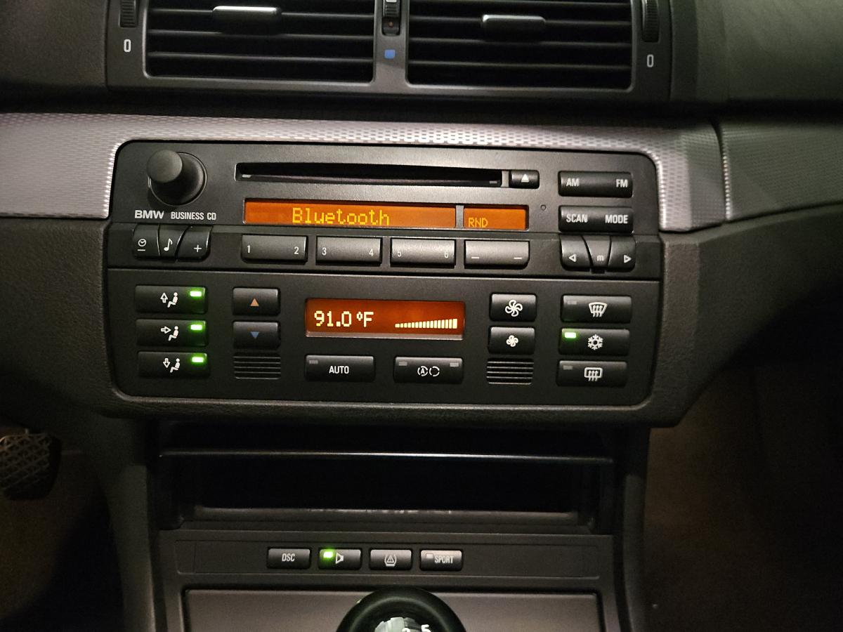

                      I also spent some time messing with the climate control settings to find what resulted in the biggest reading on the meter with all the plastics installed, but no filters. The readings were fairly small even if I covered a large portion of the intake area, so I figured that getting the unrestricted pressure difference as high as possible would give me more reliable data, as I wouldn't be running into the resolution limits of the measurement device as much. This is what I landed on:

                      Lastly, just want to write something down that was on my mind throughout this setup process:
                      I don't think the way I've set it up will give accurate data on the pressure drop across each filter. I played around with putting the reference tube under one of the filters, but it was hard to put it in a spot where the readings were repeatable. Also, swapping out the housings means moving the reference, so I just decided to instead take relative measurements with ambient pressure as the reference. This means that my results will really only tell me how the stock and X5 filters behave in relation to one another. However, comparing to stock (i.e. what the system was designed for) is kinda the only thing I care about, so this testing should still result in some valuable data
