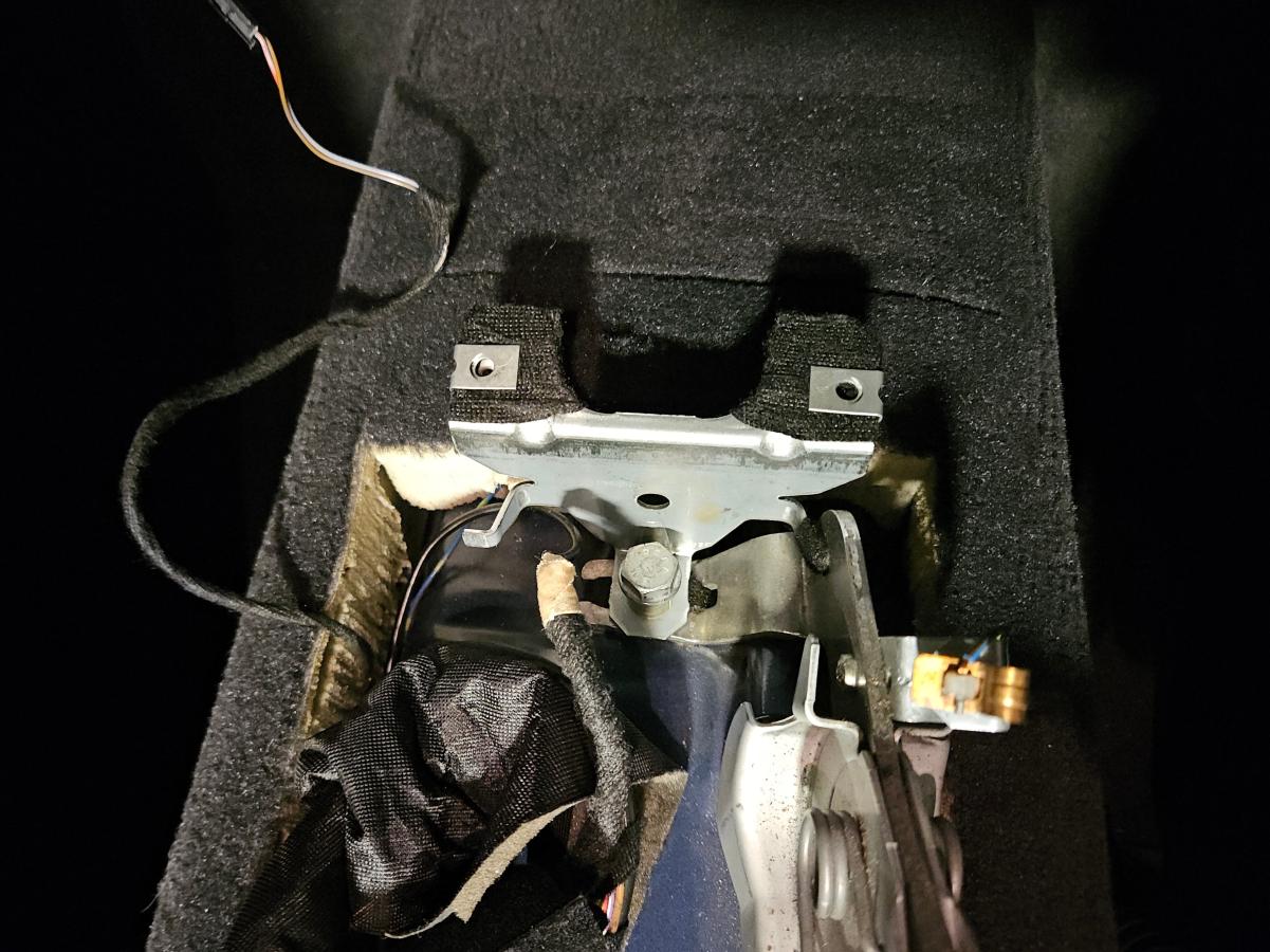

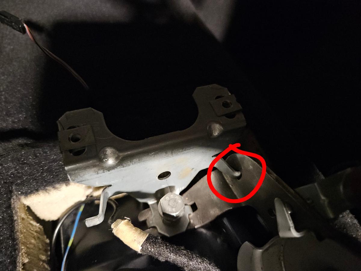

    Took the center console apart, kept banging on stuff and realized that the rattle was coming from the locating tab for the center console bracket:

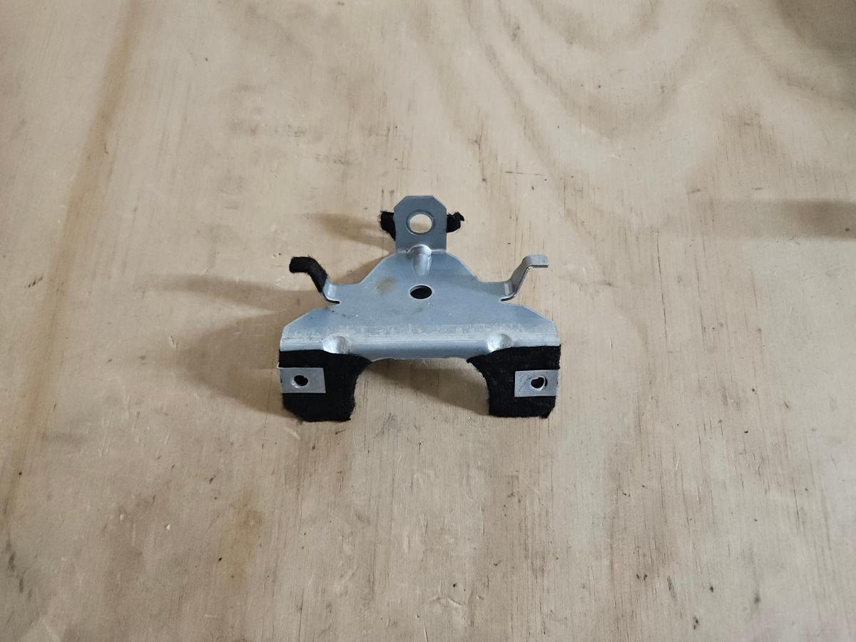

    Turns out that when the handbrake is pulled up, its bracket flexes juust enough to butt up against that tab and stop the rattle. How annoying.
    Copious amounts of tesa tape later and the rattle is gone!

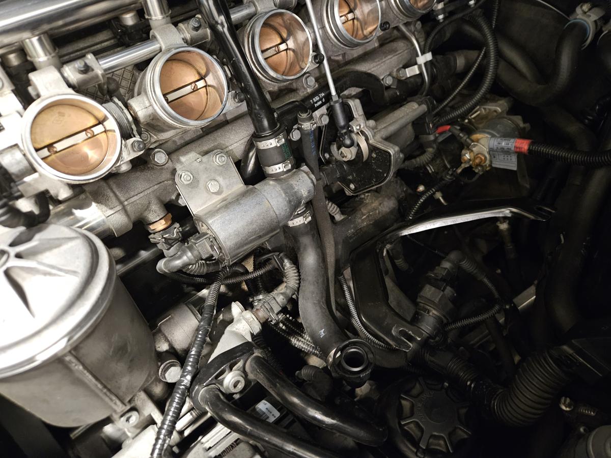

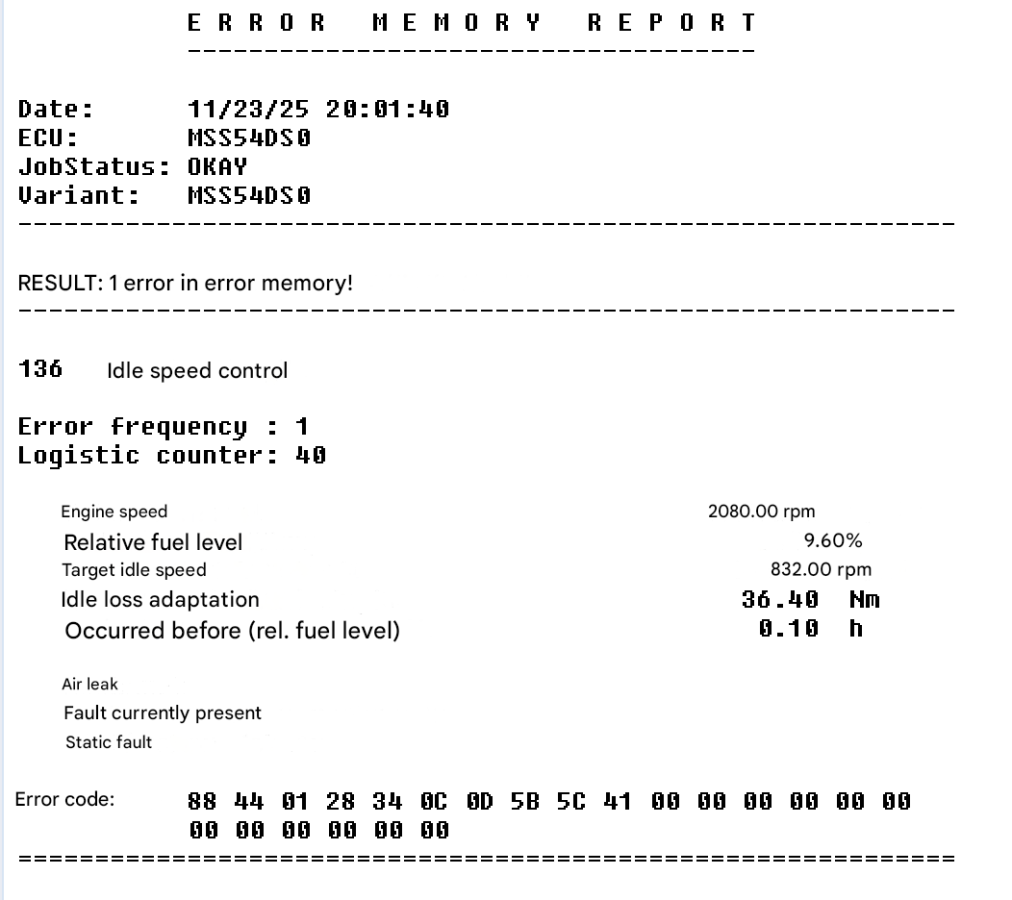

      So, car went into limp mode twice on me today (reset codes in between). This was the only code in the DME when I got back home:

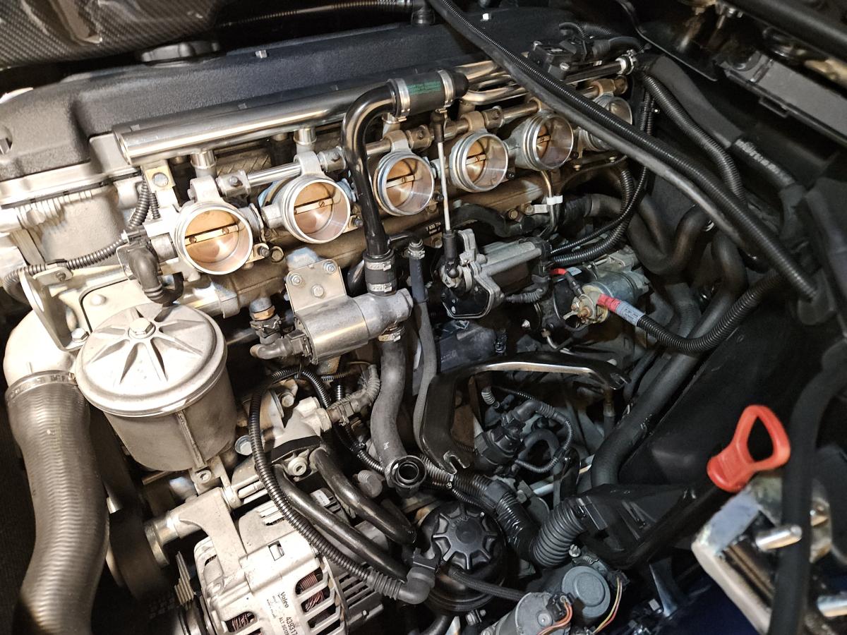

      Took the intake side of the engine apart to see if there were any obvious issues.
      Hmm, no wonder:

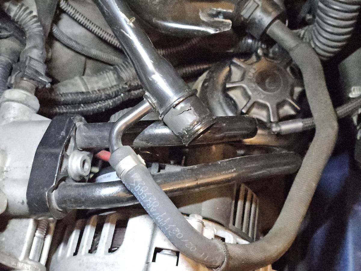

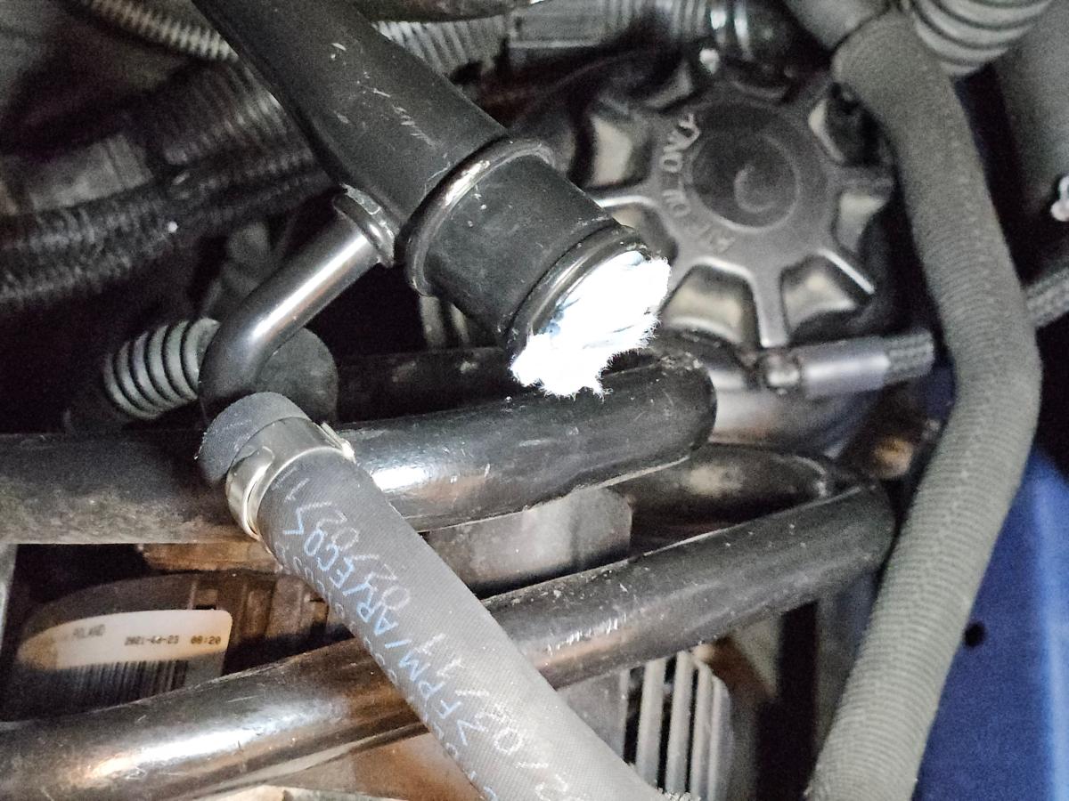

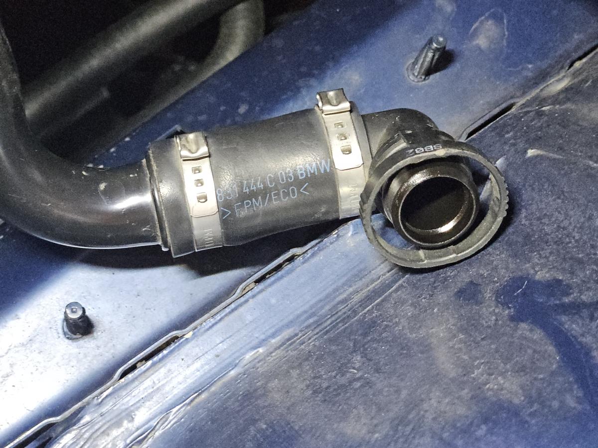

      I guess that's not really all that surprising for a 23 year old hose that was held on with a shitty hose worm type hose clamp.
      The rest of the hoses in the idle air path aren't looking that great, so decided to replace all of them. However, turns out those two small hoses on the tube that goes to the idle air rail are $50 EACH. I feel dumb paying that much for 50mm of hose, so time to look for an alternative.
      Stock hose has "FPM/ECO" printed on it and measures in at ~20mm ID/~30mm OD:
      The FPM (Viton) part is easy, but the combination of both FPM and ECO seems a bit harder to find in those dimensions. I'm sure I can find a distributor, but have to keep looking.
      Also, I just have to say that it felt really nice to only have to remove the left brace and still have all the necessary access to the intake side of the engine :

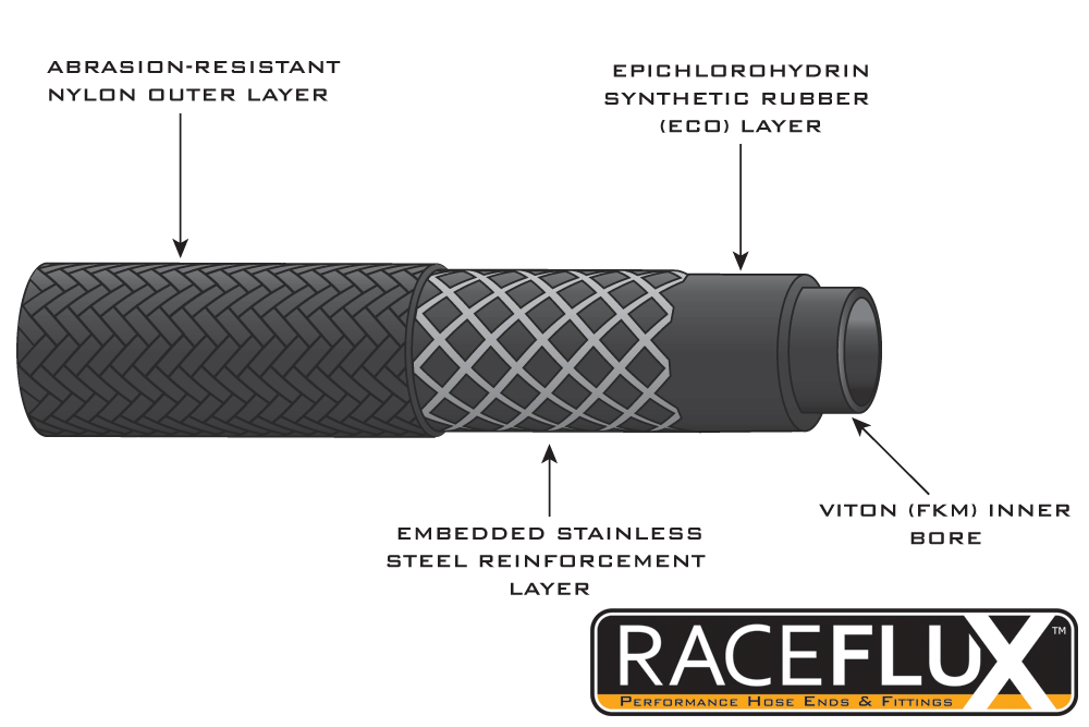

            Yeeeah, I'm slowly starting to realize this. There are no good consumer sources for the hose, unfortunately.
            The only lead I have is that -16AN hose is almost the exact same dimensions. There seem to be some companies that produce what I want, albeit with a couple extra layers that I would have to remove. e.g.:
            I have yet to find someone that sells an FKM/ECO/whatever hose in -16AN size, though. I'll keep looking, but it's totally possible that I'll need to give in and just buy the BMW stuff.

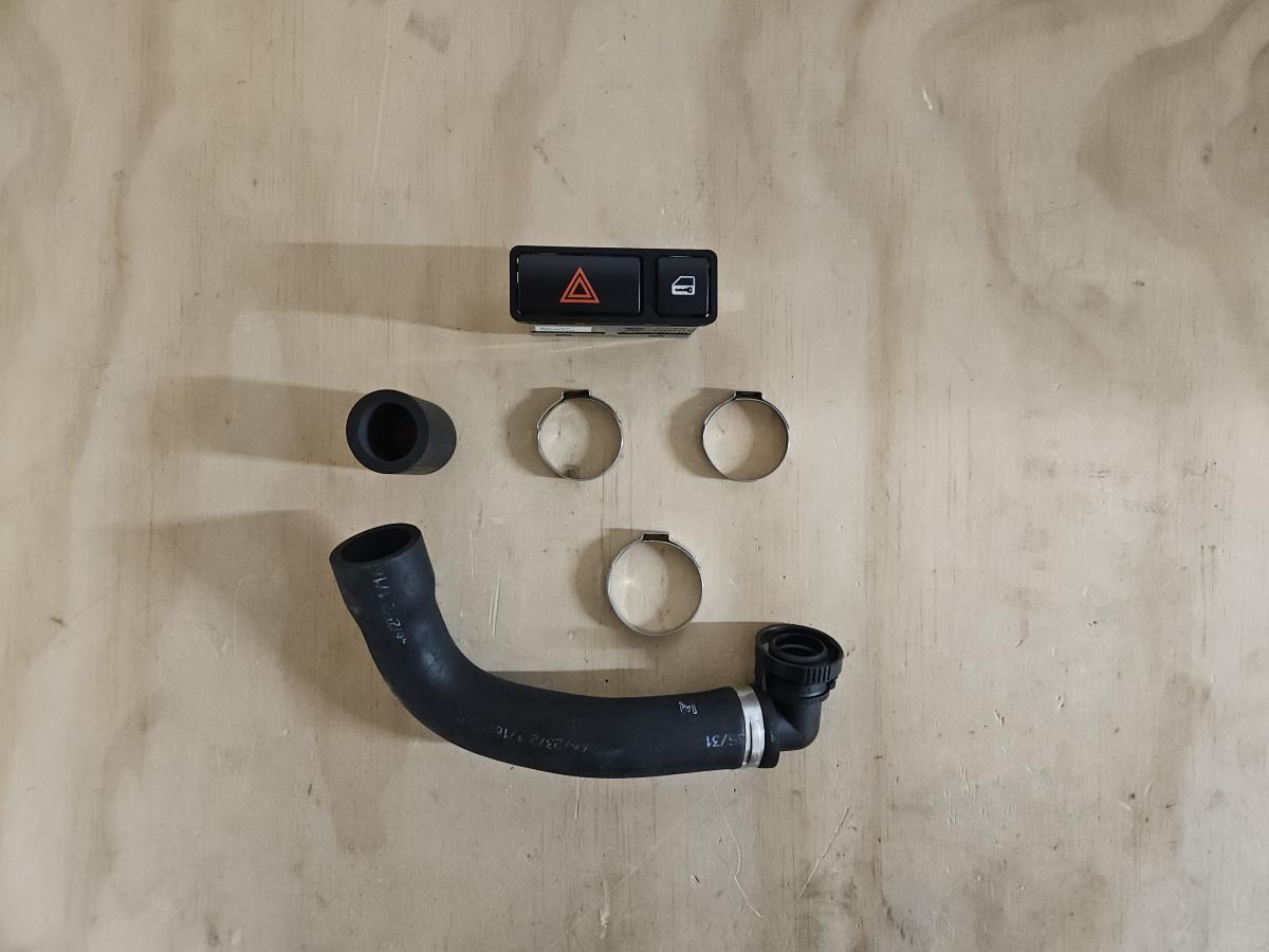

                    Most parts arrived:
                    The top hose for the ICV has a lead time, so that's arriving later. Also, I broke the door lock button on the hazard switch when cleaning the car up after that off track adventure, hence the new one on the bench.

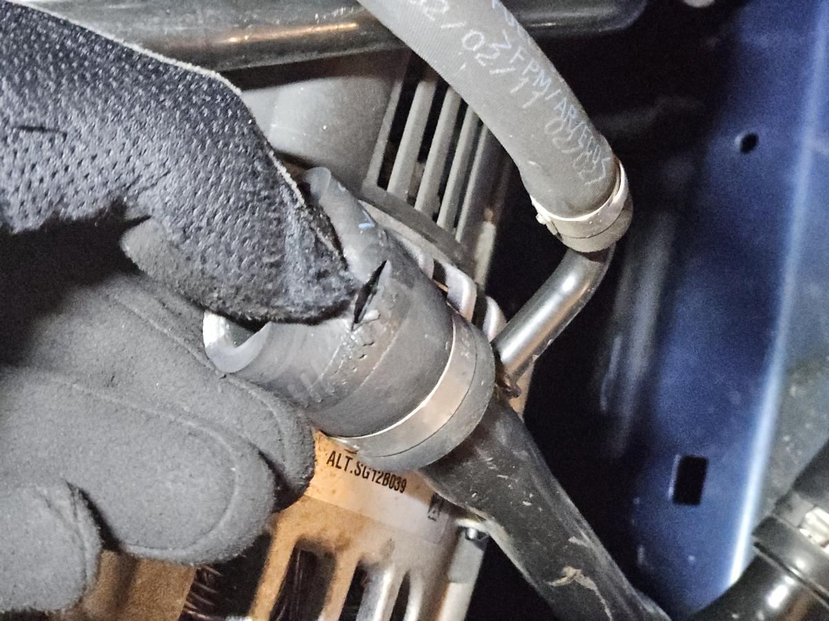

                    Old hose put up a bit of a fight coming off:
                    Nothing a plastic scraper and some patience couldn't take care off though:

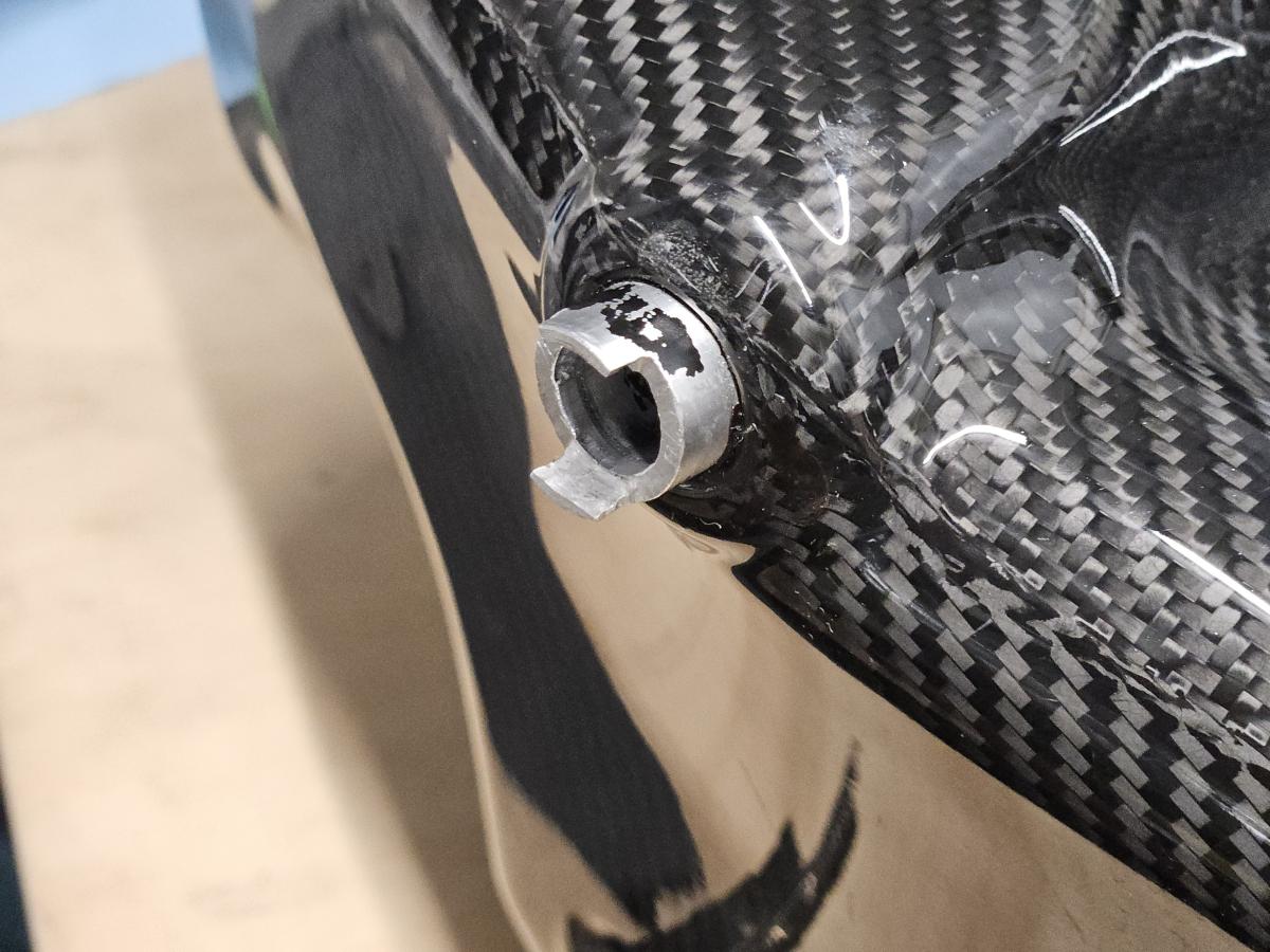

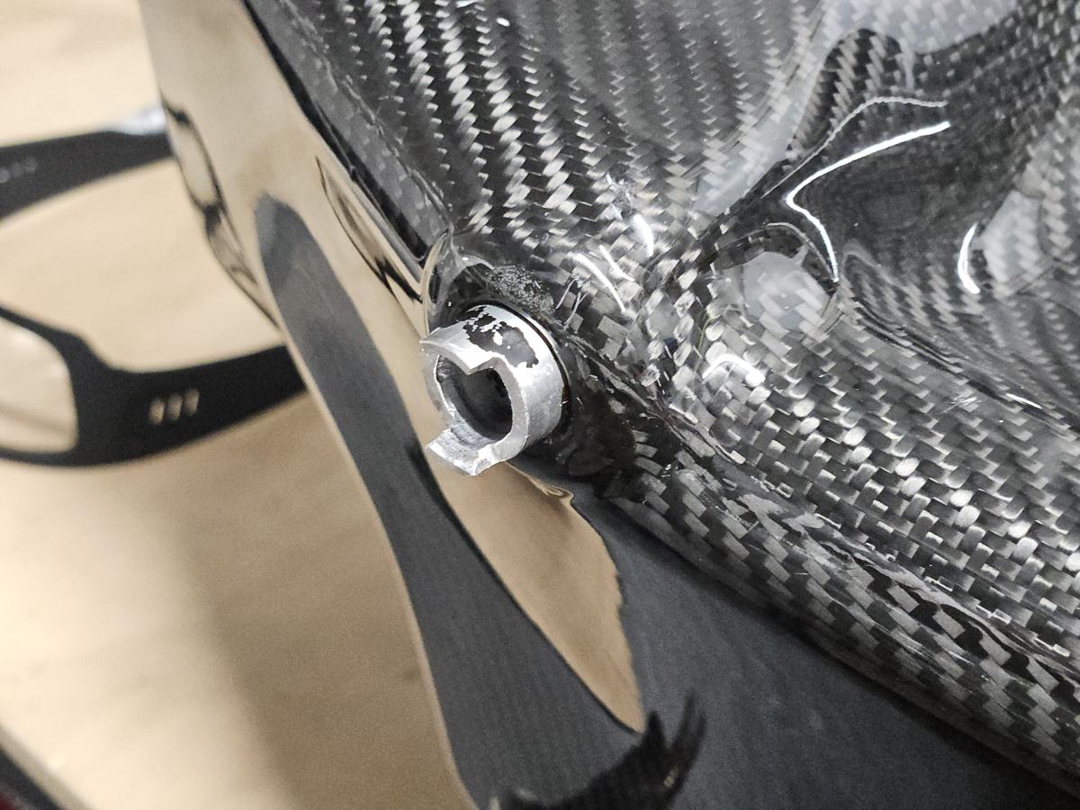

                    Also, I found the oil drain line disconnected from the airbox, sigh. Guess replacing the line wasn't a real fix.
                    Decided I had had enough of it, so busted out the dremel and hacked away at the aluminum boss on the airbox.
                    First, cut some clearance into the sides of it (tape is only there as a reference for the cut line):
                    Next, I trimmed back the lip on the inside of the two tabs:

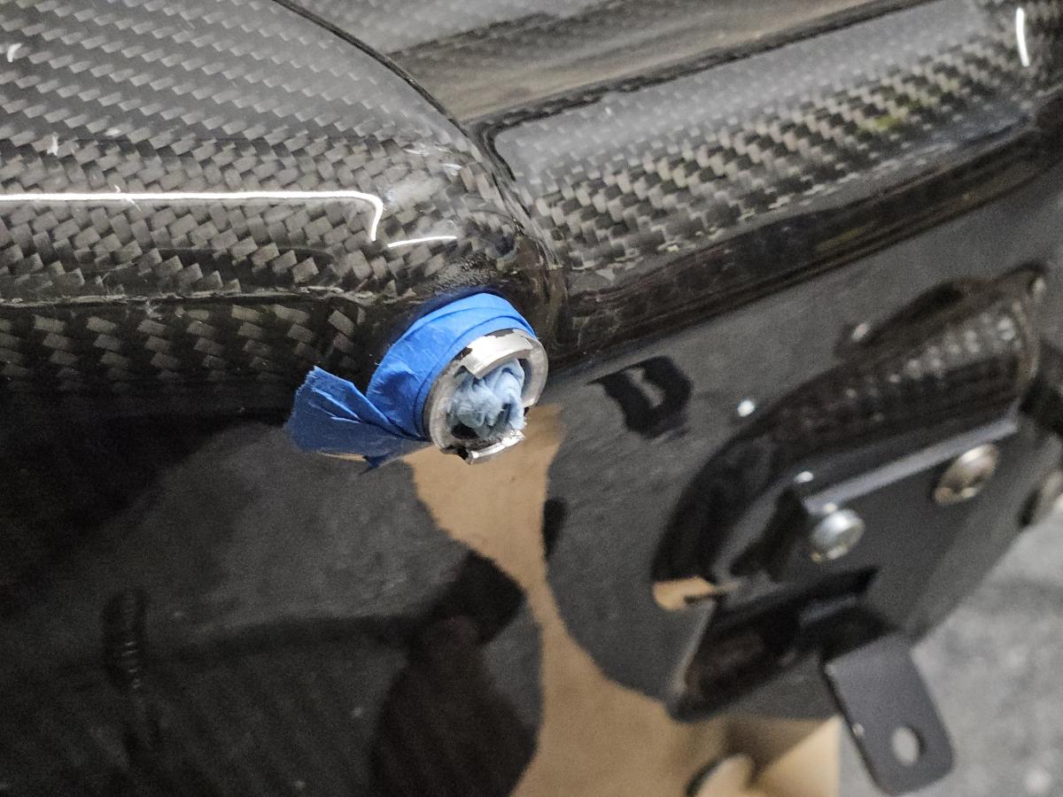

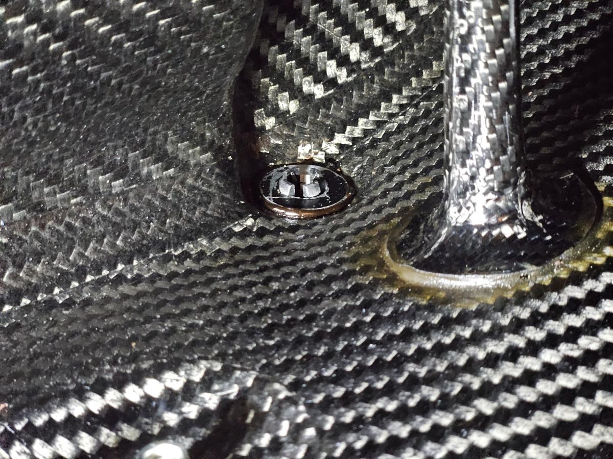

                    Not as pretty as what came from Karbonius, but the hose actually clips in now!

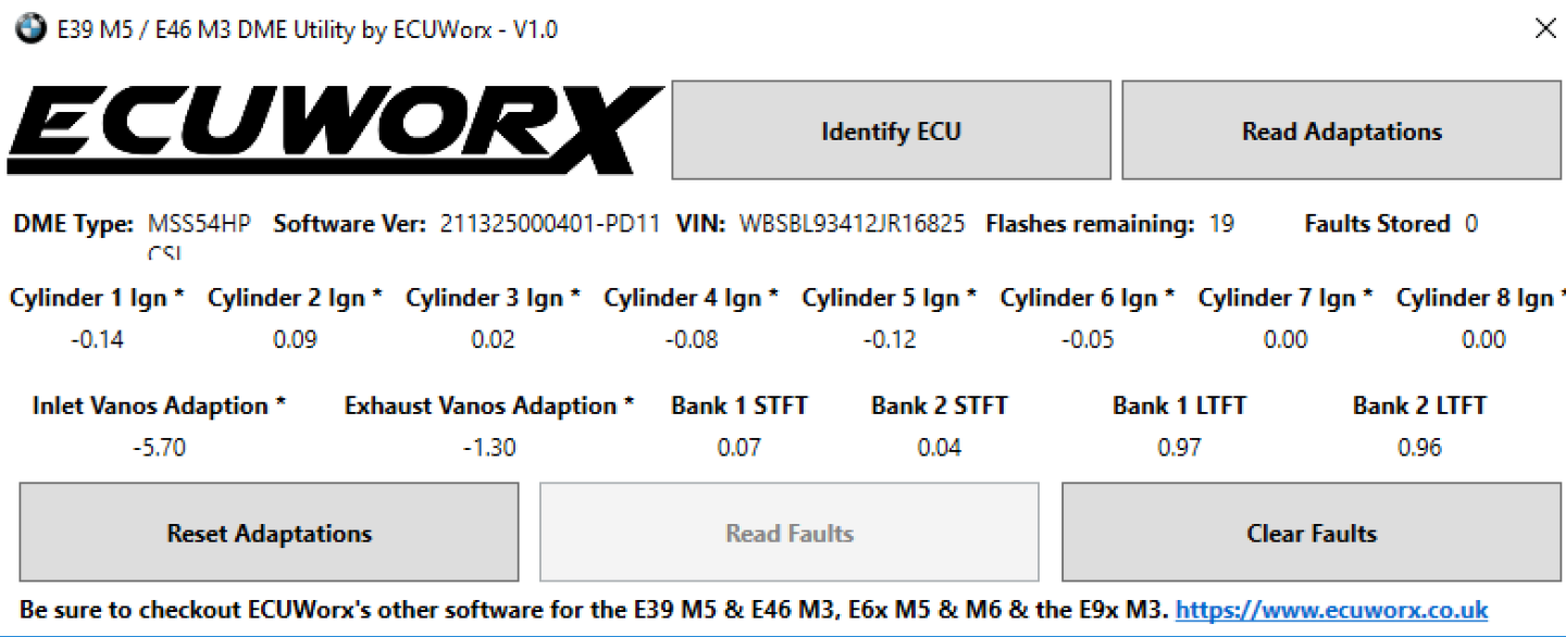

                    Just to drive the point home, here are the adaptations before:
                    And here they are after the fixes, a reset and ~30 min of normal driving:

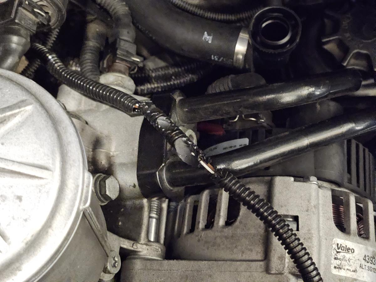

                          When I had the intake off last week, I noticed that the harness I recently built for the MAP + IAT looked like this:
                          Guess the conduit I used wasn't exactly rated for high temps. So I did some looking around and ended up ordering some 1/4" ID Drossbach 014NDBUG. Looks pretty much identical to the BMW stuff and is made of high temp nylon rated to 150 C.

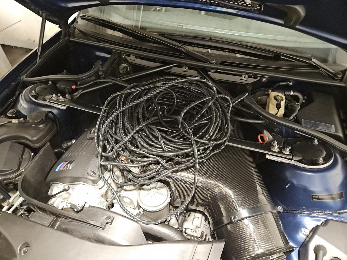

                          Now all I need to do is figure out what to do with the 98ft of conduit that I have left over:
                          Yeeaah, I probably should have stopped to think what 100ft of conduit actually meant before just blindly accepting that as a minimum order quantity...
