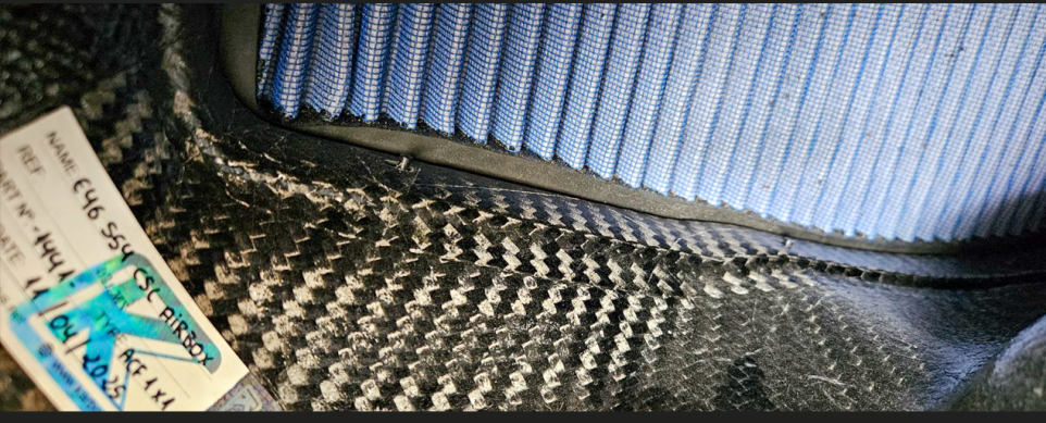

              The tabs on mine look like they are plastic, but I guess they could be anodized aluminum.

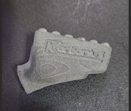

              It also came with this key chain which appears to be made on the same 3D printer that the battery cable holder attached the airbox was made on.

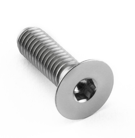

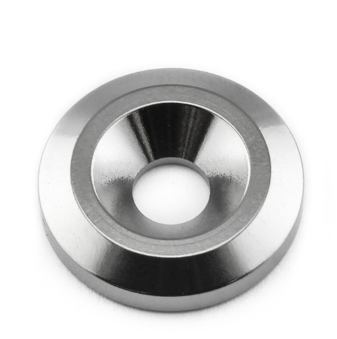

                I was thinking something like this combo would work, but I need to take a better look to see if 22mm OD is too big.
ID:	312490Click image for larger version
                Titanium M6 Countersunk Washer with 22mm o/d. These are ideal for use with countersunk bolts in bodywork applications where a low profile is required but also a wider diameter to distribute pressure and prevent pull through. Manufactured from high grade titanium these are an incredible 40% lighter than steel equivalents whilst also offering, strength, corrosion resistance and polished good looks. Available in 5 colour options.
                Probolt-USA the number one supplier of Aluminum, Stainless steel, and Titanium to the Motorcycle Race Teams in the USA. Also a very large selection of Kits for your Road going Motorcycle Fairing, Engine, Frame, Brakes, Wheels, Forks, Screen, all in Stock in the USA.
                Titanium for the weight saving for my vert...
                heinzboehmer apologies for the journal hi-jack
                2004 M3 Silbergrau (Silver Grey) ◙ Convertible ◙ SMG ◙ Karbonius CSL Airbox ◙ Mullet Tune ◙ Front 996 Brembos ◙ Status Gruppe V2 Headers ◙ CPI RTX Sec 1 ◙ Kenwood DMX958XR
                  Click image for larger version  Name:	image.png Views:	7 Size:	126.3 KB ID:	312490Click image for larger version  Name:	image.png Views:	7 Size:	93.4 KB ID:	312491​​
                  I was thinking something similar but with a rubber or plastic washer, but never mind that. Titanium FTW.

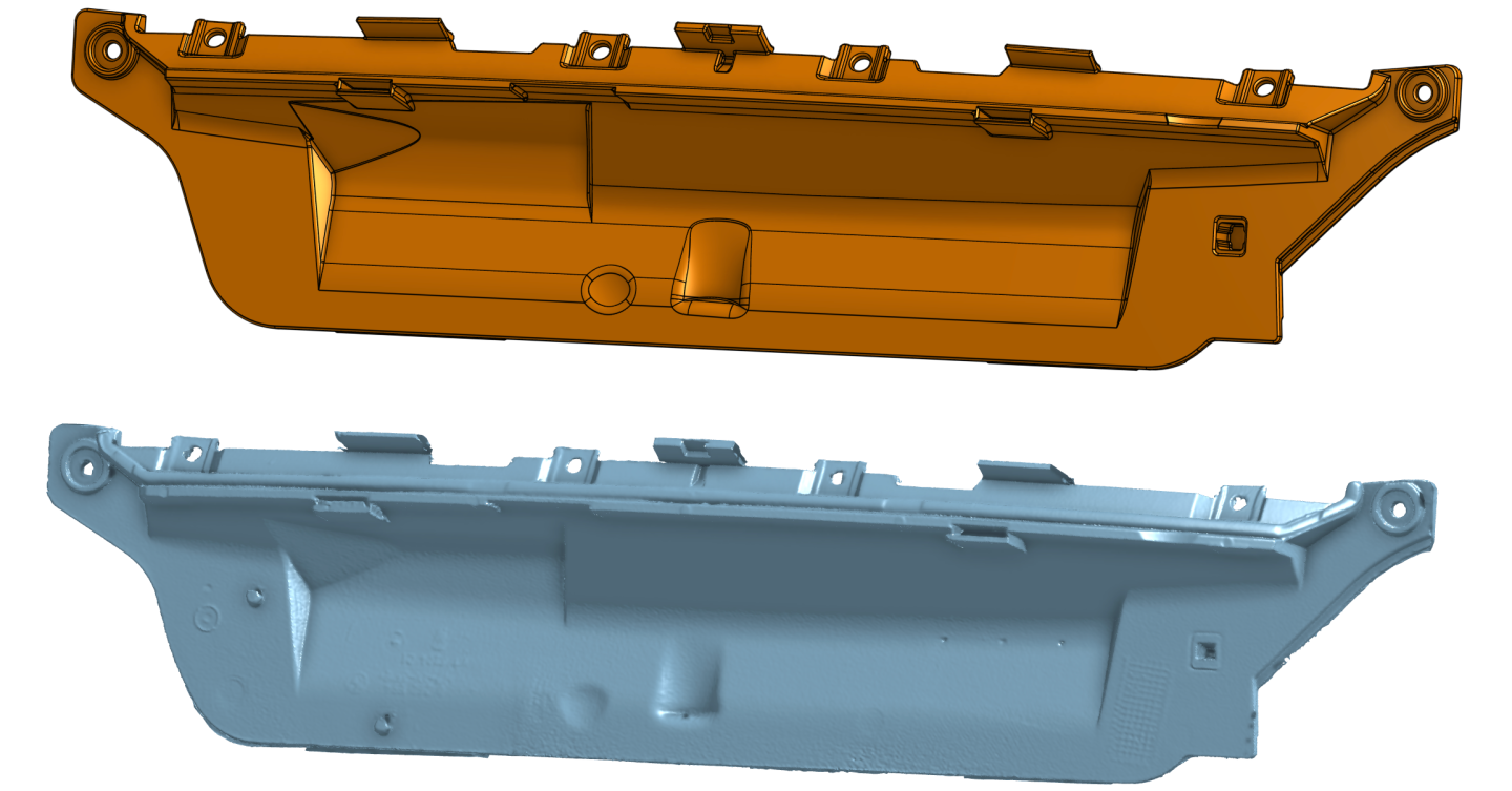

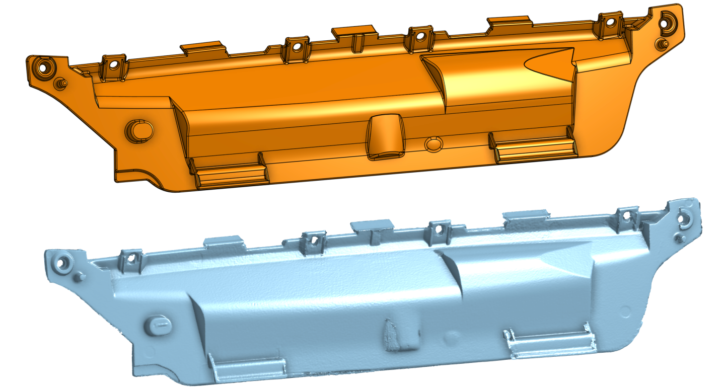

                            Also, this took absolutely forever:
                            Click image for larger version  Name:	Screenshot 2025-07-23 at 6.13.45 PM 1.png Views:	12 Size:	577.7 KB ID:	312977
                            Click image for larger version  Name:	Screenshot 2025-07-23 at 6.14.16 PM 1.png Views:	12 Size:	694.3 KB ID:	312978
                            I started with this piece cause it looked simpler than the cabin air filter housing, but, man, was I wrong. Essentially no surface on it is flat, except for the one that butts up against the firewall. Took me a really long time to figure out how to approach all of the curves.
                            Yes, I realize that a lot of the geometry is there for mold release, but I want to make something that fits all E46s, so I decided to spend the extra time and recreate it as closely as possible. More time spent in CAD land saves me from redesigning the piece down the road if it turns out to not fit on some other chassis configuration.
                            I also decided to not model the front clip retainer into the piece. I like the idea of using the stock injection molded piece for serviceability. BMW does not sell these separately, so I'm gonna have to go junkyard diving for some. Fortunately, they're just plastic welded in, so they're easy to pop out with a razor blade. This part could also conceivably be recreated, but printing it in a favorable orientation might be tricky.

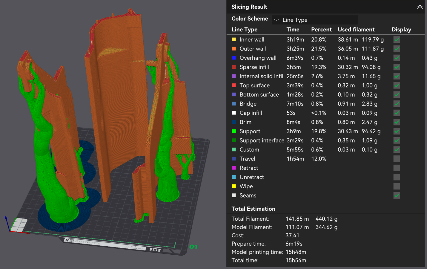

                            Also, did some preliminary slicing of the model and the printed version should weigh in at 300-400 g, depending on my choice of material and infill. For comparison, the stock piece weighs in at 1618 g. I do need to split it up into three pieces to fit in my printer, so I'll add some features to bond all of them together nicely. For now, I just added some slicer-generated dowel connectors:
Name:	Screenshot 2025-07-23 at 11.21.34 PM.png
                            With the stock geometry recreated, I can work on modifying it to accommodate both the braces and the tilted filter. Got some ideas flying around in my mind already for how to approach that. More to come.
                            Sidenote, since I essentially made a 1:1 replica of the piece, anyone can print it out without modification and save ~1.2 kg. Who's up to be the test fit guinea pig? Hit me up and I'll send you the stl (I'll distribute widely once fitment is validated).
