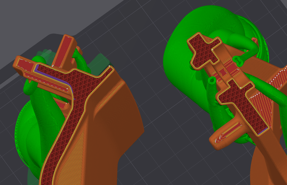

          Yep! That's the plan. I've been doing some research to see what the optimal infill config would be. At first glance, I would think a fairly high infill percentage would work better, as that would minimize convection in the small air pockets. But then you also get more thermal bridging from the infill walls, so would need to do testing to find the optimum balance.
          However, I did have a thought this morning. "My" design is a 1:1 copy of the stock piece (i.e. same thickness), so if I print it out of a material with similar thermal conductivity to UP-GF, then any amount of air in the interior should result in a lower thermal conductivity.
          Quick (unsubstantiated) search says that UP-GF and PET-CF have similar enough thermal properties, so I'll probably just choose an infill with a non-continuous volume (e.g. cubic) and print it with the lowest infill percentage that still results in a strong and dimensionally accurate part.
            Generally the best thermal impedance will come from the smallest air volumes and the lowest gravimetric density you can get away with, so you’re on the right track. I’d probably pick a reasonably high infill personally as the weight penalty isn’t that great. Cubic is a good choice as you definitely want closed cells. You should re-run the Slon test with a desk heater and an IR thermometer!

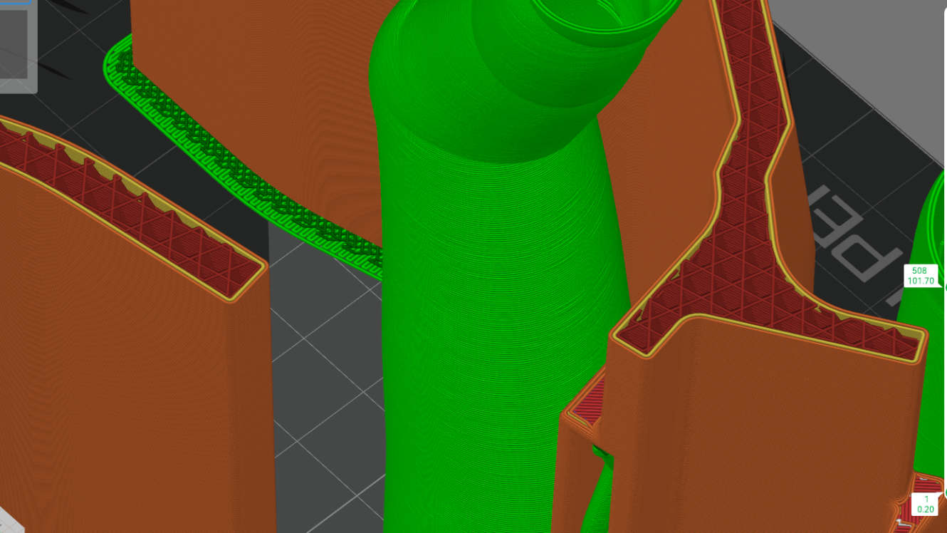

              Hmm, going from 10% to 75% cubic increases weight from 345 g to 746 g.
              I know 75% is a lot, but it's right around what looks correct for a moderately closed cell insulator:

              Stock is fully solid, so any air volume inside the part (assuming identical exterior dimensions) should increase thermal impedance, no?
                For reference here is 40%

                    The air in the print should increase thermal impedance vs stock, yes. But also CF will decrease it, so this is an application where fiberglass filament will beat carbon filament.
                    For temps I’d probably assume 150C max, which is a 50ish C premium over coolant/head temp to account for heat from the exhaust manifolds from heavy ripping straight to idling and heat soaking. Keep in mind your setup is effectively vented to atmosphere through the hood right now.

                      But also, to the carbon point, higher infill means more thermal bridges. Sounds like there's an optimal point somewhere. Might need to do some testing to find it.

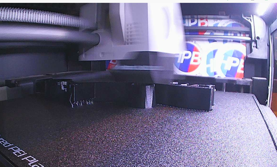

                          We'll see what happens...
                          45min down, 17hrs to go, lol
                              Hell yeah! I'm excited to see how it turns out.
