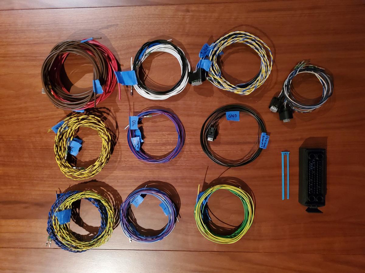

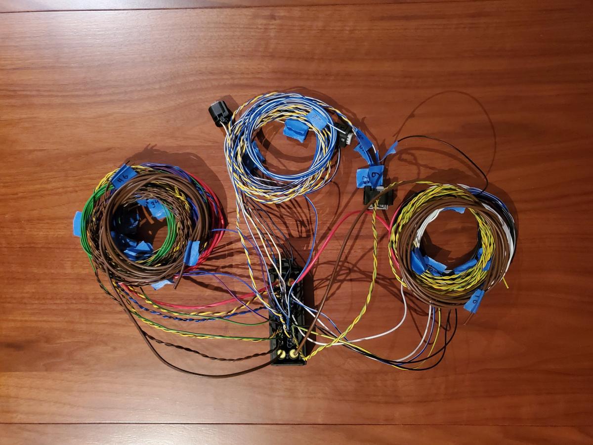

    Everything labeled to make the soldering step less of a pain:
    Click image for larger version  Name:	20221012_010315.jpg Views:	0 Size:	152.2 KB ID:	188386

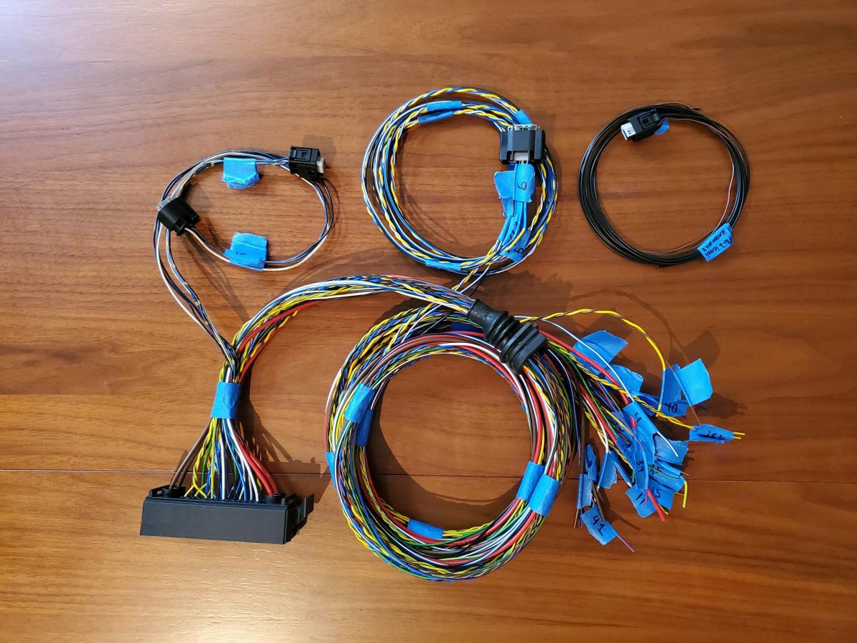

    Clipped into the MK60 connector:
    Click image for larger version  Name:	20221012_015507.jpg Views:	0 Size:	153.5 KB ID:	188387

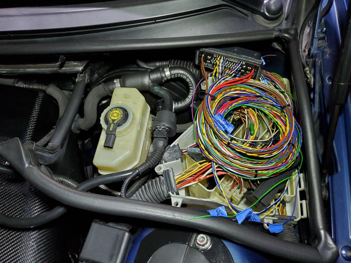

    Tried my best to keep this organized, but that's kinda impossible with ~35 2.5m long wires. The three stacks correspond to the three rows on the connector.

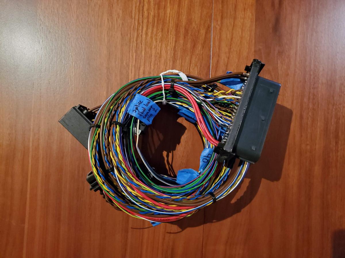

    Ah, much better:
    Click image for larger version  Name:	20221012_113122.jpg Views:	0 Size:	161.8 KB ID:	188388
    Top right is the connector for the brake fluid level sensor. Both the ground and signal pins need to be spliced into existing wires, so I'll leave that for later.

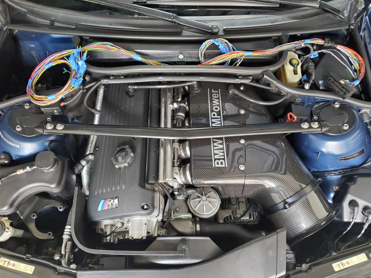

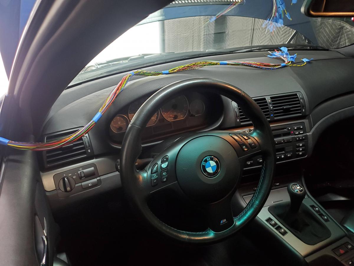

    Also did a quick test fit:
    Click image for larger version  Name:	20221012_114330.jpg Views:	0 Size:	192.2 KB ID:	188389
    Reaches across the engine bay to the location of the MK20 connector no problem. Crudely tested length when routing behind the dash as well:
    Click image for larger version  Name:	20221012_114523.jpg Views:	0 Size:	116.4 KB ID:	188390
    Looks long enough for that too! It seems like I somehow managed to take accurate measurements. What a concept.

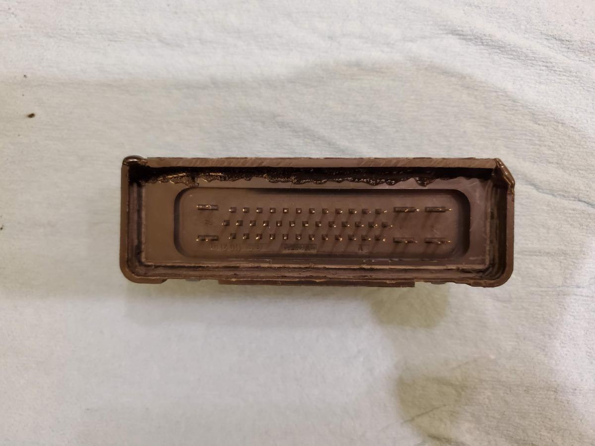

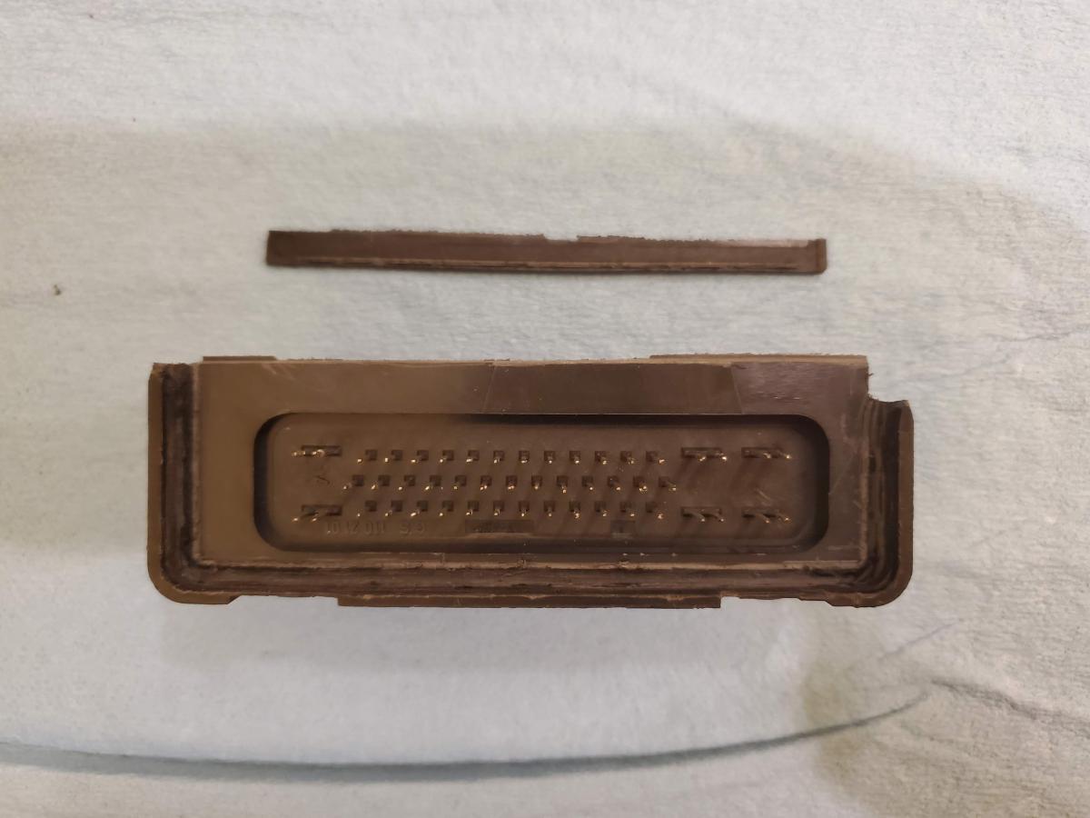

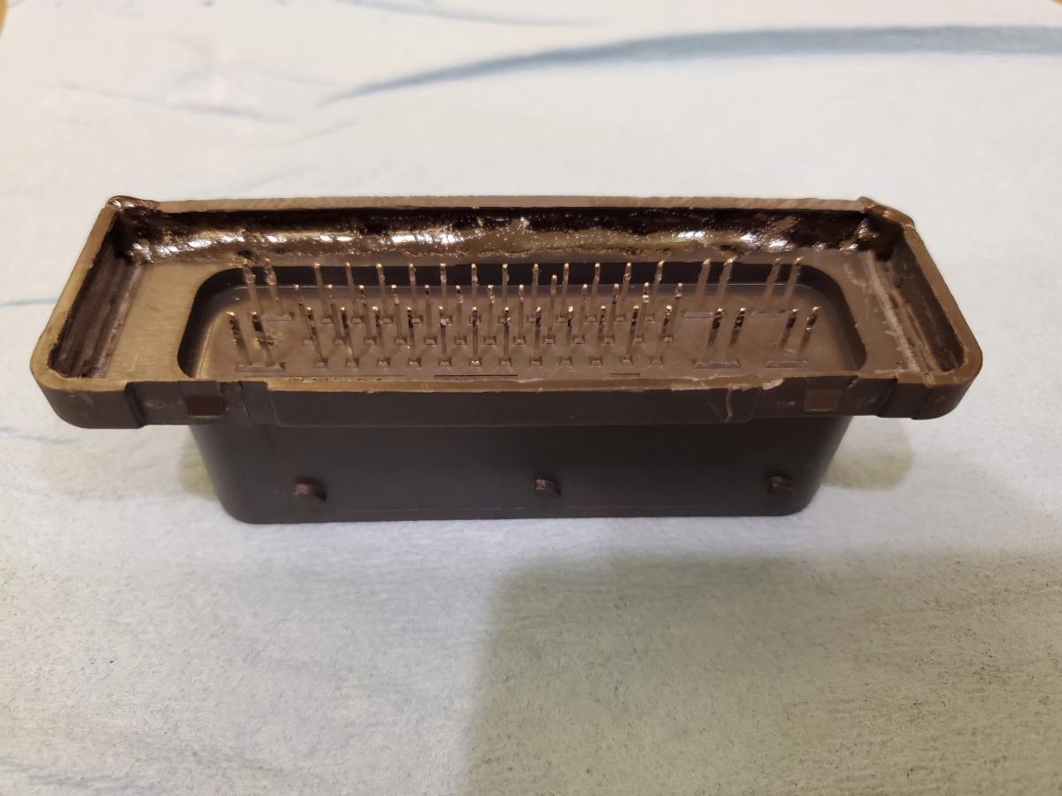

      First had to clean up the MK20 connector I chopped off of the spare unit. Cut it down to a more reasonable size and cut a slit in the bottom of it. Yes, I went a bit too far in one spot, but it didn't actually matter. Also, the standoffs are held onto the PCB with some plastic screws on the bottom. I did this to keep consistent spacing between the board and connector.
      The idea was to heat this up and then bend the plastic to create a ridge like there is on the other three sides. Of course the plastic snapped immediately, even after generous heat had been applied.
      Oh well, just glued in in place instead.

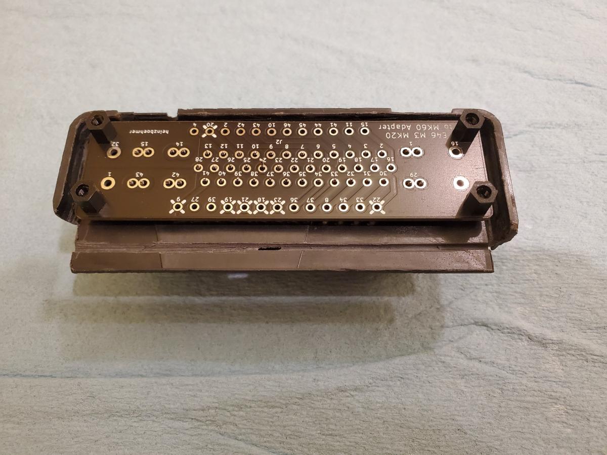

      Started on the PCB work by trimming the wires on the harness so that they were all the same length and then soldering them onto the PCB.

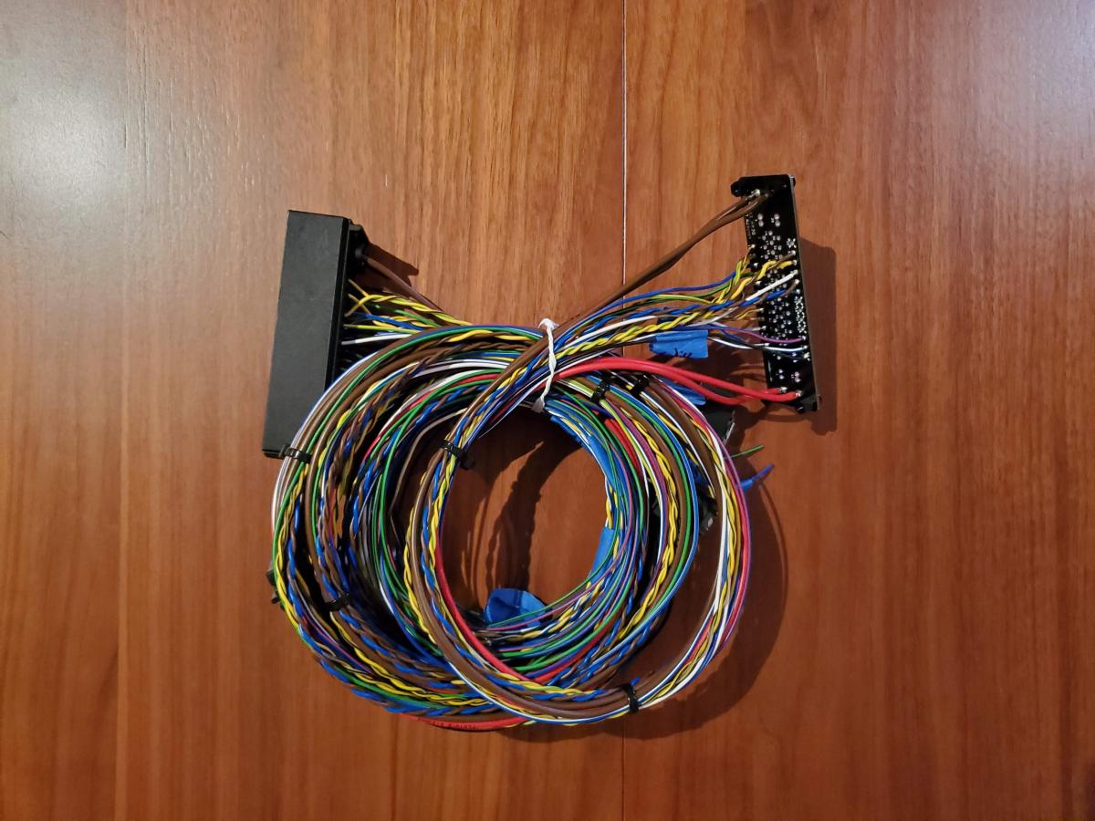

      Then the PCB went onto the connector.
      It's done!
      Well, not really. As is obvious in the pics, there are still some labels on the wires. Most of them are on the DSC sensor connector. I kinda measured for it, but there's a possibility that it ends up being too long and I need to trim it. Decided to keep the labels on to make that work easier for me in the future.
      Then there's the two unpinned wires. Hard to spot, but you can kinda see them right under the PCB on the first harness pic. These are for m track mode (for the future) and the TPMS reset button, so they will be getting wired directly to their respective switches.
      Last is that label right in the center that says something about splicing one thing into another. The brake fluid level sensor has two wires. One that gets spliced to a ground and another that gets spliced to a wire that runs from the MK60 to the instrument cluster. I still need to actually test fit the harness and am not sure exactly how long to keep these two wires, so I'll just do the splicing later. It's not a critical feature so I'm not too worried about it.
      But besides that, the harness is ready to go on the car. The only thing that might annoy me is a light for the TPMS on the instrument cluster. If it does, I'll just pull the wire up (or down, need to check wiring diagrams) manually and reset it that way for now.
        Okay now it's actually done.

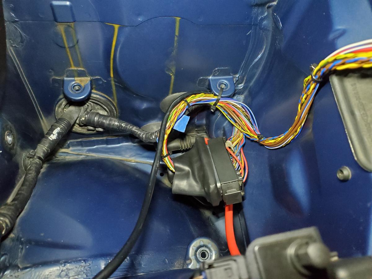

        Installed the DSC sensor under the driver's seat and forgot to take pictures of that. I need to go back in there to route everything permanently, so I'll take pictures then. Surprisingly, the bracket did not fit and I had to enlarge one of the holes. Unsure if that's because later cars are different or if it's because the module I bought came off of a convertible.
        After that, I ran the sensor harness from the DME area to under the seat. I just followed the existing wires and clipped my wires into the wire holders alongside the others.

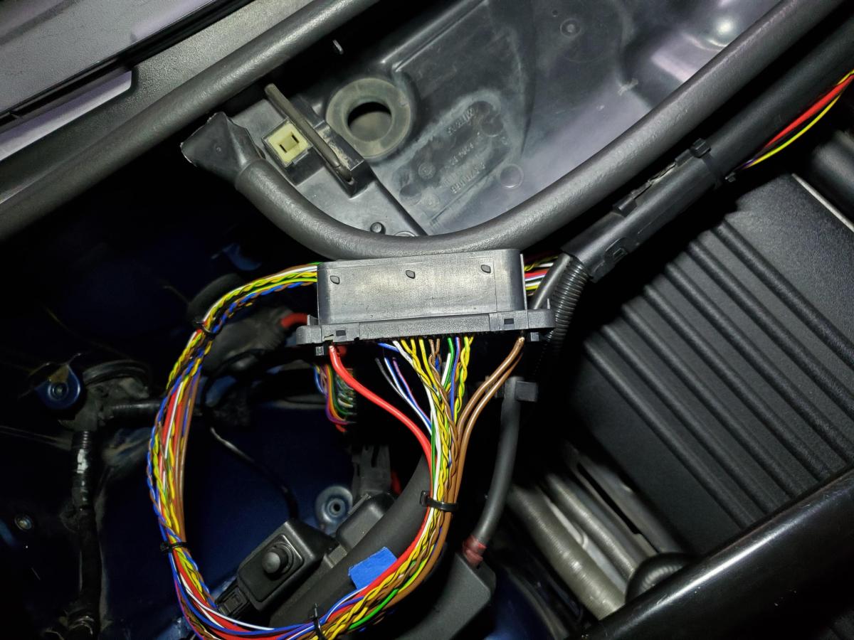

        This is what the DME area looked like after that:

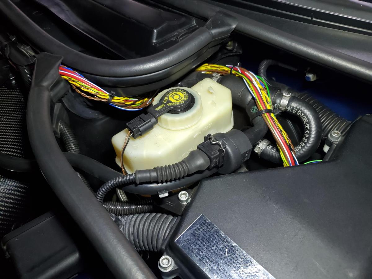

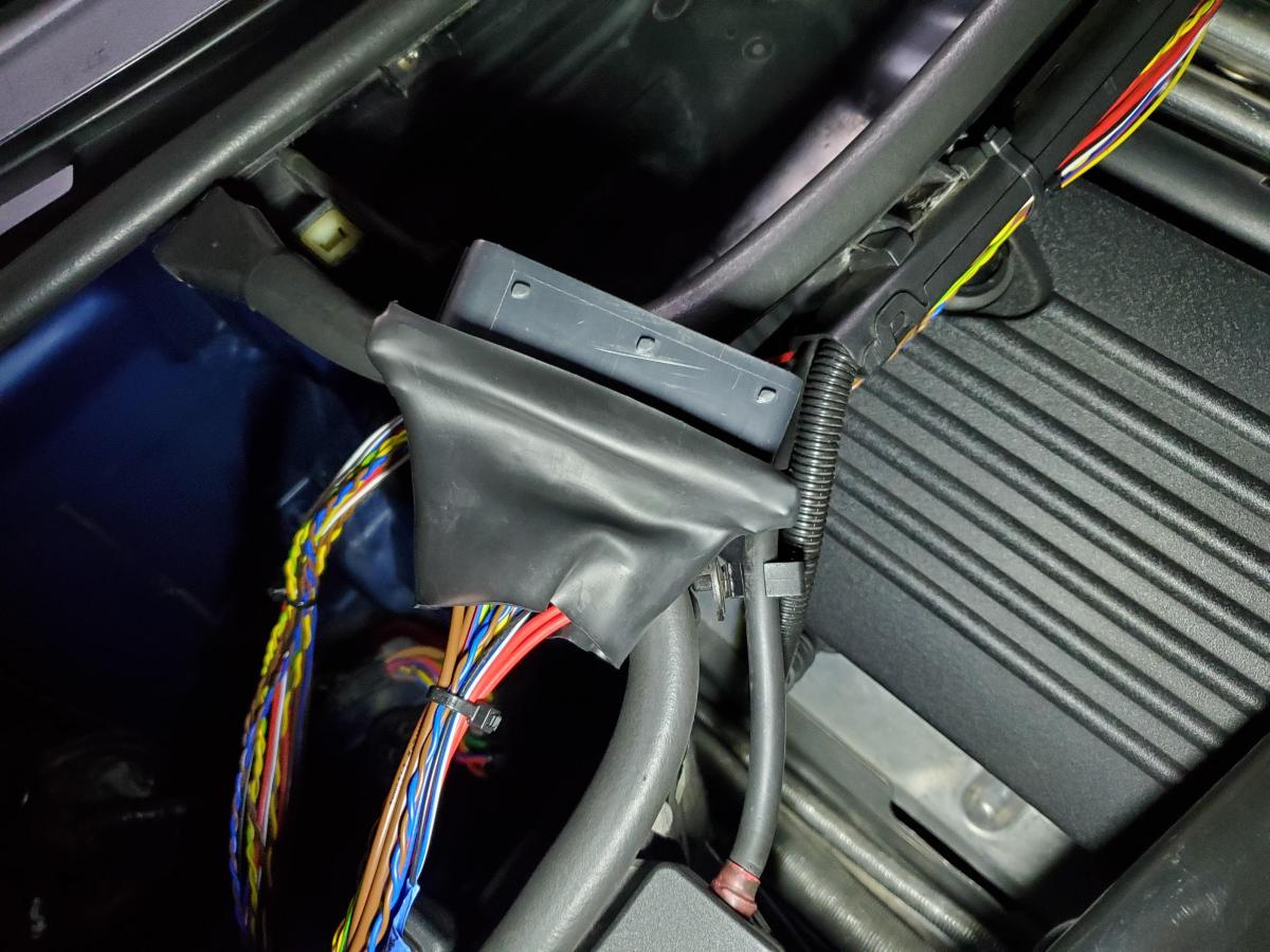

        I then routed the MK60 plug to the module and spliced the brake fluid level sensor in. Also forgot to take pics here unfortunately, but here's how I (temporarily) routed it in the DME area.
        I ended up zip tying the harness to the holder where the alternator cable goes to get it to the other side of the engine bay.

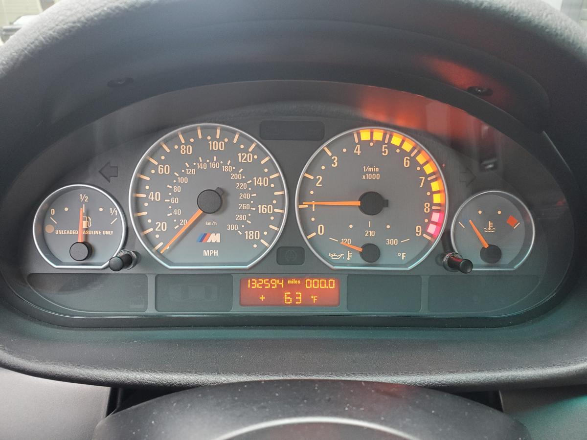

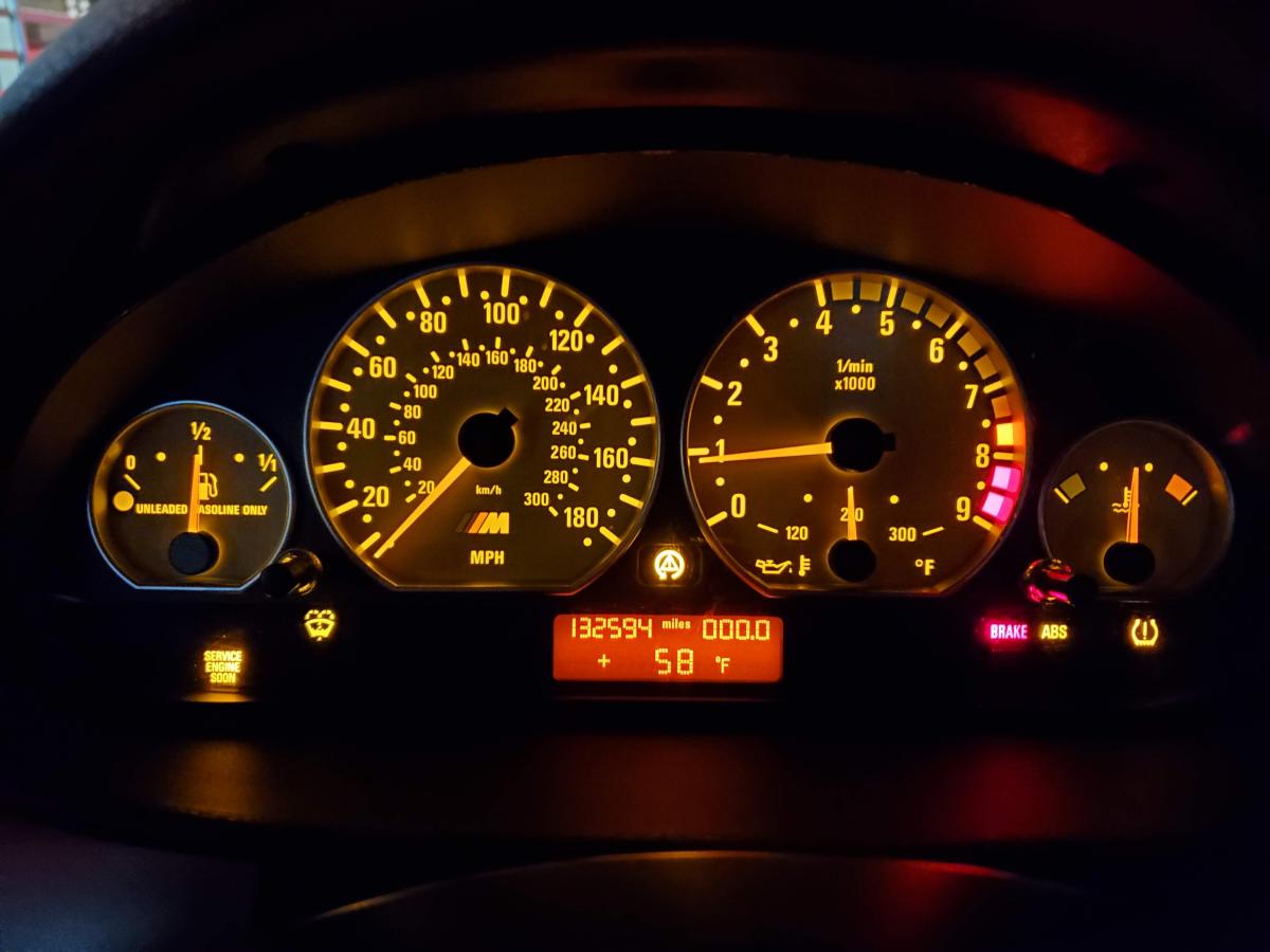

        And then it just worked!
        Went out for a test drive and truly everything worked. Traction control, ABS, M track mode, everything. Hard to believe that no troubleshooting was required, but that's fine with me.

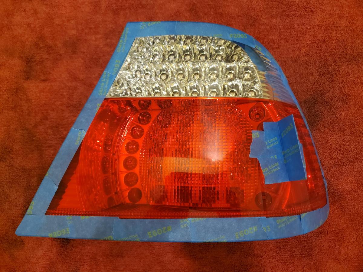

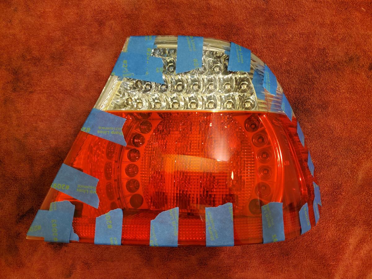

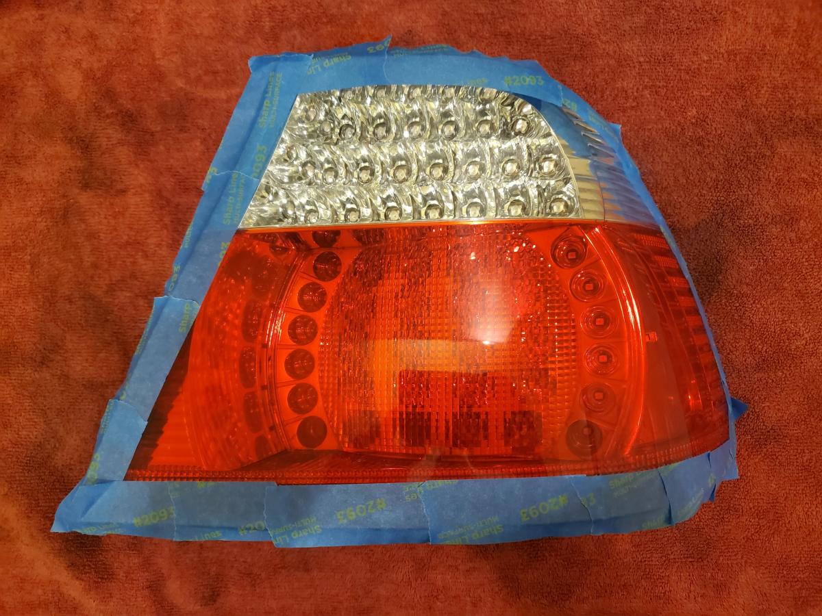

                  First off was fixing my rear taillights.

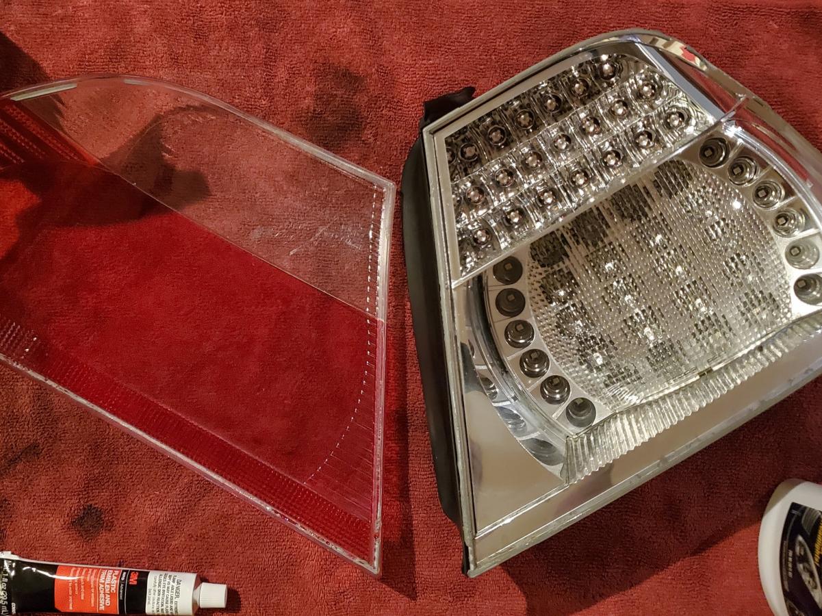

                  Since my garage is so tight, whenever I want to access both sides of the car, I usually put it up on dollies and push it around to center it. I must have not been paying a lot of attention when I did this for the MK60 swap because I ended up pulling on one of the taillights and ripped half of the lens off. Lightly pulled on the other and part of the lens came off too, so I decided to reglue them entirely.

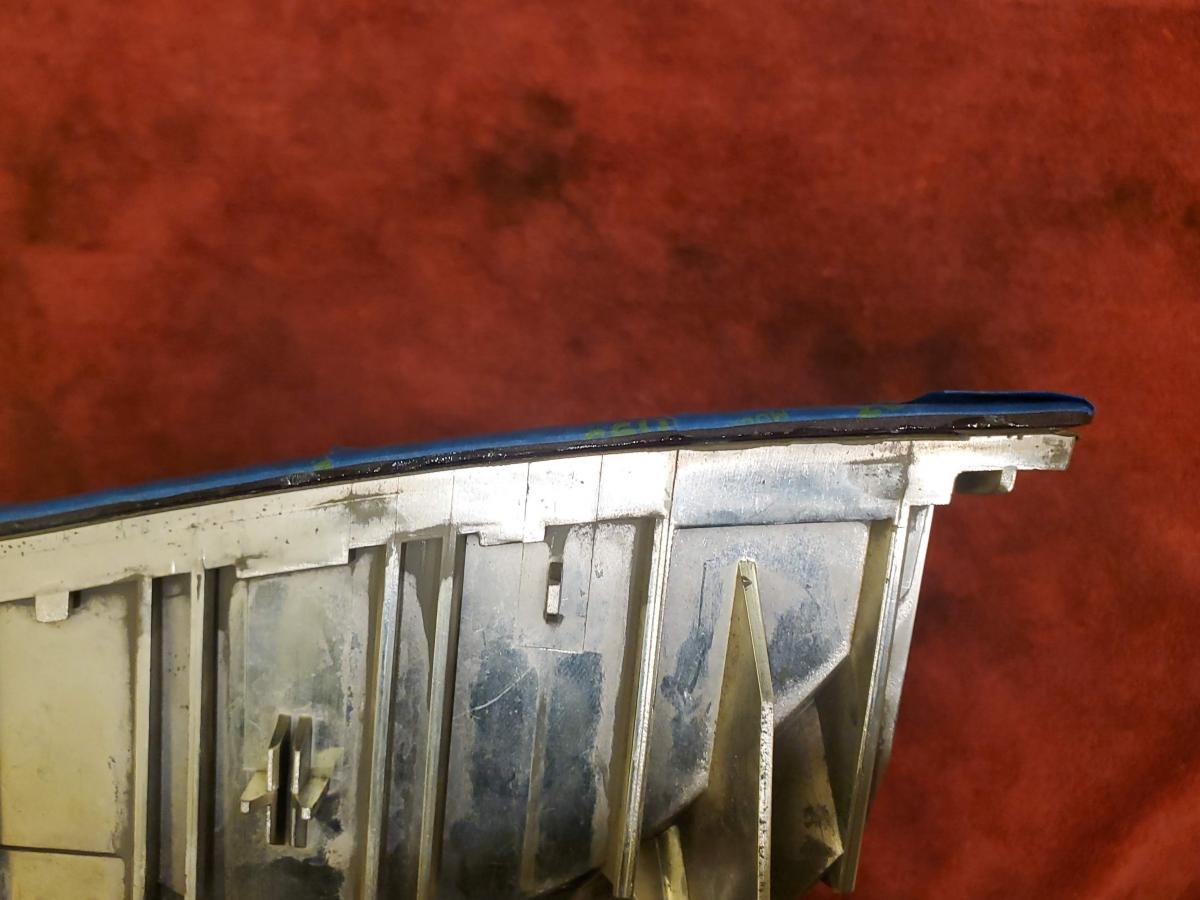

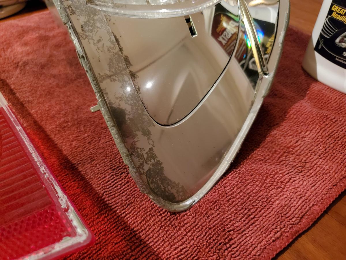

                  Started by using a heat gun to go around and soften all the remaining adhesive. Then pulled then lenses from the housings:
                  Click image for larger version  Name:	20221024_220041.jpg Views:	0 Size:	230.3 KB ID:	191082
                  This was harder than expected and took me quite a bit, but I managed to not break anything. I did, however, find that one of the insides was very pitted and gross looking:
                  Click image for larger version  Name:	20221024_220159.jpg Views:	0 Size:	173.6 KB ID:	191083
                  I thought I might be able to clean it up with some plastic polish, but I quickly discovered that the chrome layer is super thin. Sooo don't do that. I ended up just cleaning it as much as I could with some isopropyl alcohol and left it alone. I did polish the inside of the lens, though. After that I put a bead of 3M plastic emblem and trim adhesive on the lens, stuck it back on the housing and used some masking tape to hold it on. Left it like this for 24 hours:
                  Click image for larger version  Name:	20221024_233339.jpg Views:	0 Size:	214.9 KB ID:	191084
                  The adhesive worked great, but the adhesive applier (me) kinda sucked. I wasn't confident that I had fully sealed the lens against the housing, so I decided to add another layer of adhesive to act as a final seal. First I taped up the edges, trimmed everything nicely and added a tape handle to make holding the light easier:
                  Click image for larger version  Name:	20221027_115644.jpg Views:	0 Size:	180.1 KB ID:	191085
                  Click image for larger version  Name:	20221027_210356.jpg Views:	0 Size:	183.6 KB ID:	191086
                  I then smeared some more adhesive along the perimeter and took the tape off while the glue was still sort of wet. Meh, came out okay:
                  Click image for larger version  Name:	20221027_210430.jpg Views:	0 Size:	95.4 KB ID:	191087
                  I'm glad that water won't get into them, but I might be on the look out for another set of these. Not fully satisfied with my repair and also have that housing with the messed up chrome.

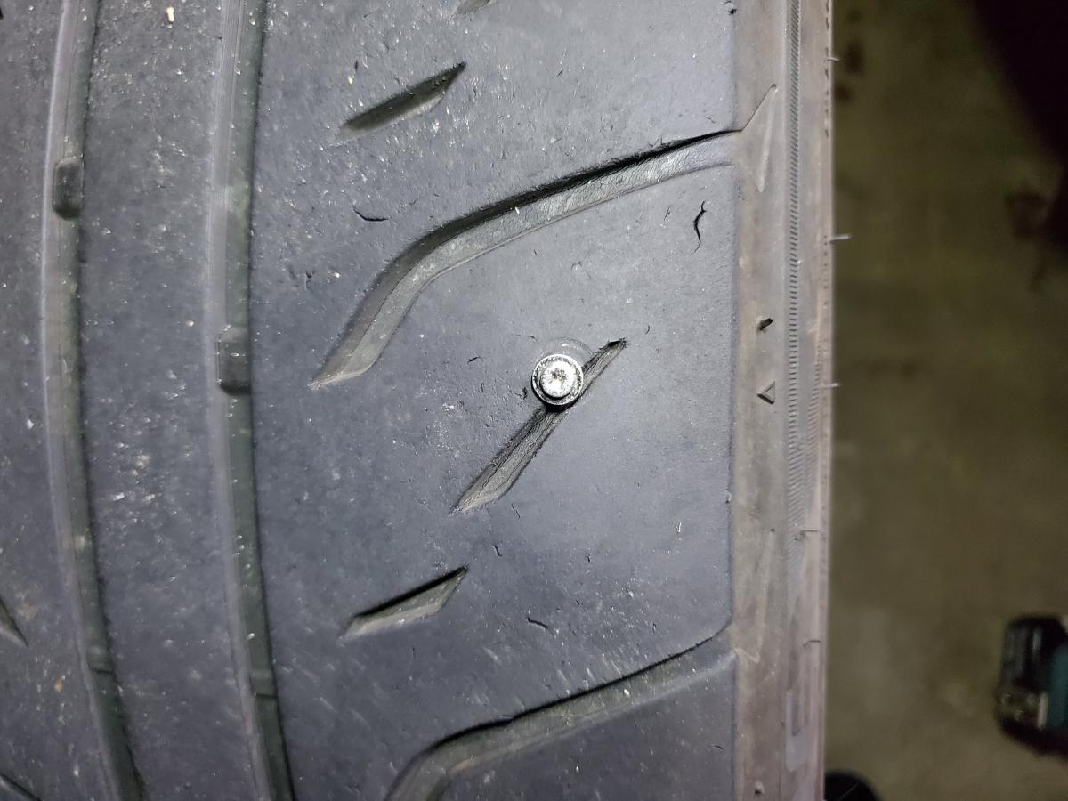

                  I drove around on them for a bit after the swap and also found this in one of them:
                  Click image for larger version  Name:	20221022_201005.jpg Views:	0 Size:	109.7 KB ID:	191090
                  Fortunately it was not a long screw, so it didn't puncture the tire but honestly wtf. This is the the third or fourth screw I've gotten in my tires over the last year and I've only driven around 4000 miles. What do people do that actually drive their cars around every day? Are they just patching tires every week? Or am I just extremely unlucky?

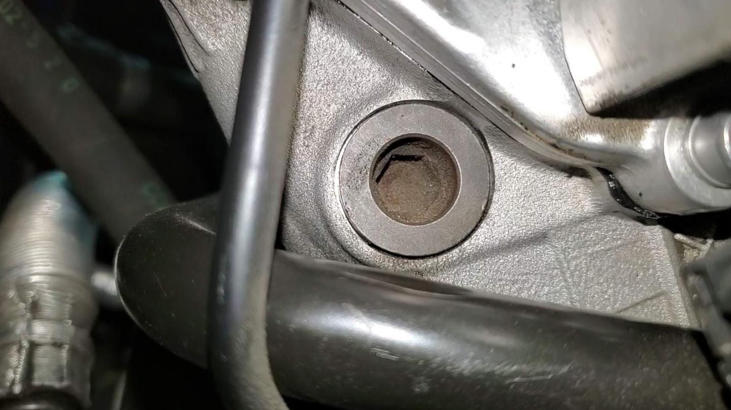

                  Was undoing all the track stuff from the car and found some fluid in the belly pan. Followed it up and saw this:
                  Click image for larger version  Name:	20221102_202310.jpg Views:	0 Size:	124.4 KB ID:	191097
                  You can see the weep hole is facing forward, so I'm pretty sure the fluid didn't boil, but rather sloshed out of the reservoir under hard braking.

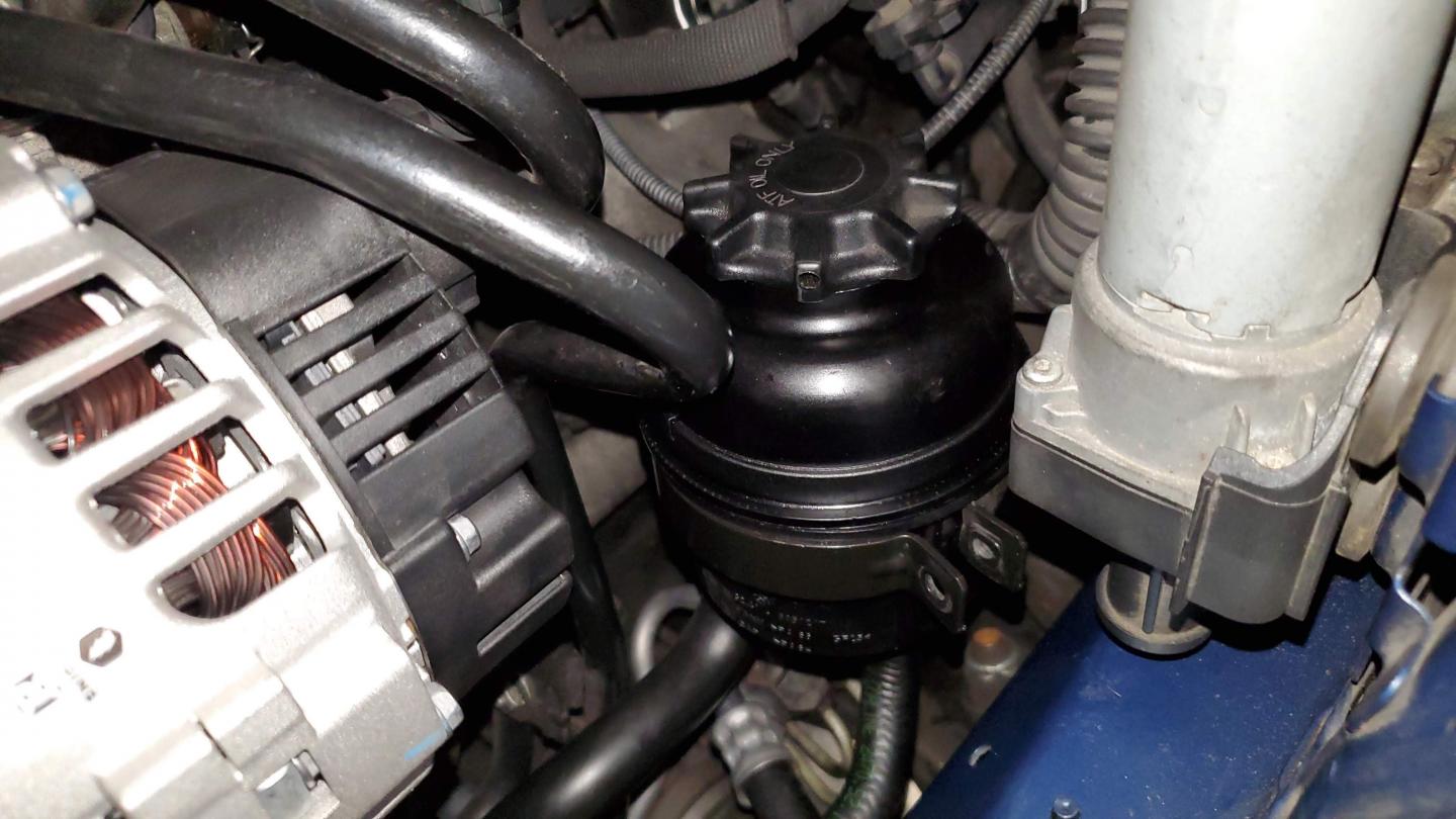

                  Also flushed the PS fluid the lazy way (just the reservoir) after speaking to a friend with much more track experience about how often he flushes his.
                  Click image for larger version  Name:	20221102_203747.jpg Views:	0 Size:	114.9 KB ID:	191099
                  It honestly looked fine, but I had some in the garage so whatever.

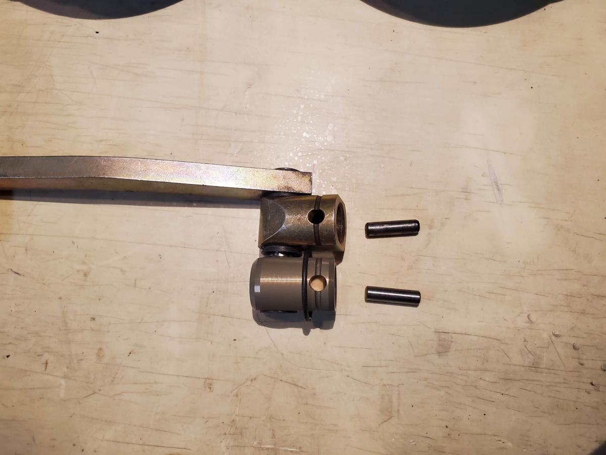

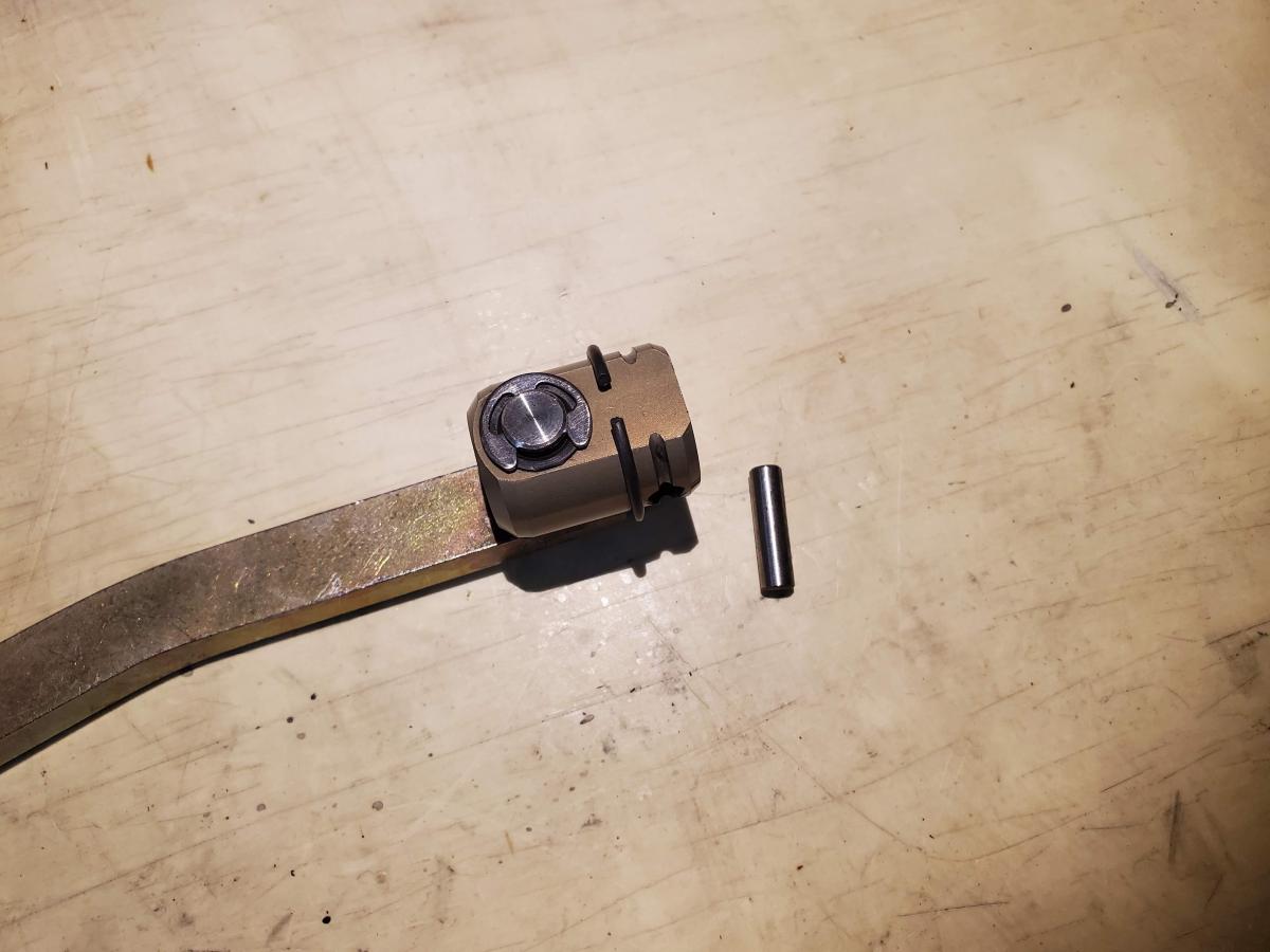

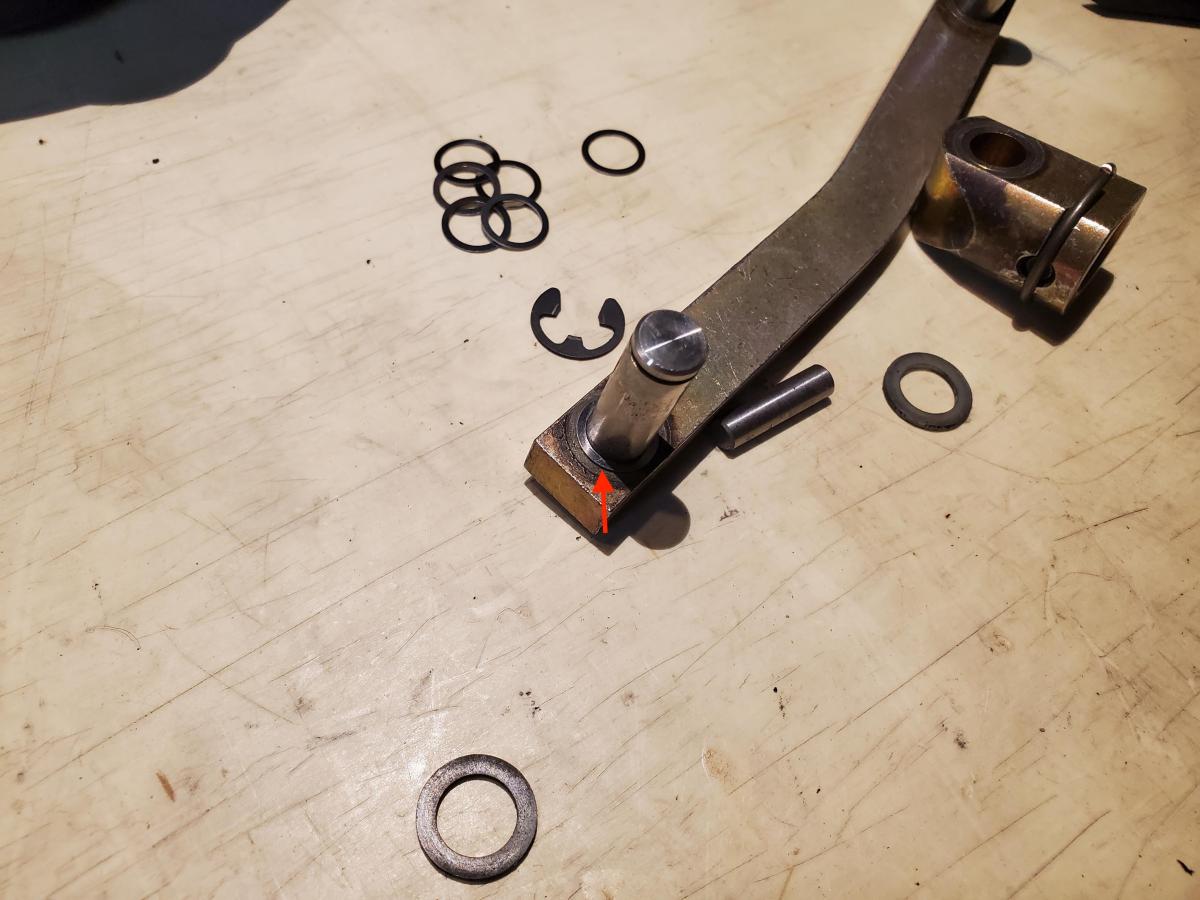

                            Now for a new episode of "Heinz tries to solve the 420g's sloppy shifter". To recap, I've done the following over the years:
                            • Replace all rubber shift bushing with poly stuff and replace everything else with stock parts.
                              • This wasn't great and I'm pretty sure the poly bushing at the rear cause my shift carrier to rip out of the chassis.
                            • AS SSK
                              • Most noticeable upgrade, went back to OE rubber bushings as well
                            • Remove transmission and replace all detents and springs
                              • Honestly no idea if this did anything on its own, as I did it along with a clutch and the AS SSK
                            • Couple different shift knobs
                            None of this has ever made the transmission feel as good as I want it to and yet I keep thinking that the next thing will solve it.
                            Anyway, the next thing that will solve it is something I noticed when I was doing my MK60 swap. The AS SSK comes with its own selector rod joint and I saw that there was a bit of play between that and the selector rod. Additionally, it doesn't have the foam insert, but rather a rubber stop, so there's very little preload against the shift rod coming out of the transmission.
                            I decided to swap it out for a fresh genuine BMW part to see if that made any difference. Quick comparison of the two:
                            Put the BMW part on and there was still a similar amount of play, so I decided to shim things until it was gone. I found that the shims I used for the PS pump pressure regulator fit great onto the shaft, so I put one of those on:
                            This did make everything a bit too tight when reassembled, so I slowly sanded down one of the plastic washers with 800 grit sandpaper until everything felt nice.
                            Back on the car it went and I can happily report that it did make a difference. Made a quick video to show it (and no I didn't have to add overlays or anything because it was otherwise impossible to see, what are you talking about):
                            I should have measured the play before and after, but forgot to do so. However, if I measure off of the videos, it looks like the many hours of effort reduced play at the top of the knob by 3mm. All the play in the linkage is gone. Looks like the remaining play is between the pin and the shift rod on the transmission as well as within the bell housing itself.
                            It does seem to feel a little nicer when shifting, but I could 100% just be imagining things.
                            Tune in next time to watch me machine a custom selector rod joint and take the bell housing off to mess with things in there. All for an extra couple mm of play reduction. Or maybe I'll just go for the nuclear option and swap in an S6-53 transmission. George Hill sells a very nice looking kit that will probably tempt me sooner or later.
                            For now, I'll just have to ignore the play that's still present and tell myself that spending that much time on my back trying to install the new selector rod joint was worth it.
