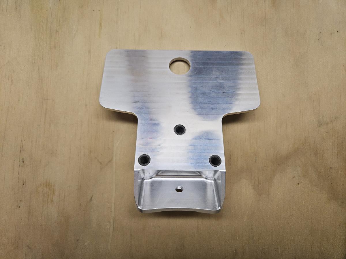

    Heinz, who did you commission to machine out the brackets?
      I got them manufactured through Protolabs. Chose the longest lead time they offered to get the cheapest price. Came out to around $1k.
      Went with Protolabs because that was the best balance of price and lead time out of the typical big online manufactuters. There were WAY cheaper options (almost exclusively overseas), but none of them would tell me the composition of the material they would be using, so I decided against them.
      Of course, someone recommended this place a few days after I placed my order with Protolabs: https://www.rapidaxis.com Local, all machining done in house and comparable prices. I would have gone with them had I known about them earlier. Oh well.
      I'll likely be using them for powder coating and maybe even for 3D printing the molds for the CF cabin air filter housing and firewall plug (since they're too big for my printer and would need to be printed in sections).
      Anyway, this is likely a way more detailed answer than what you were looking for, but it reminded me of some details I had yet to document. I'll also be posting a detailed cost breakdown of everything once it's all finished.
        Timeserts installed and fitment of hardware validated with 3D printed fasteners:

        Looking good!
        I need to temporarily swap back to the stock airbox this week for, uh, no reason. I'll likely bond this in when everything is out.

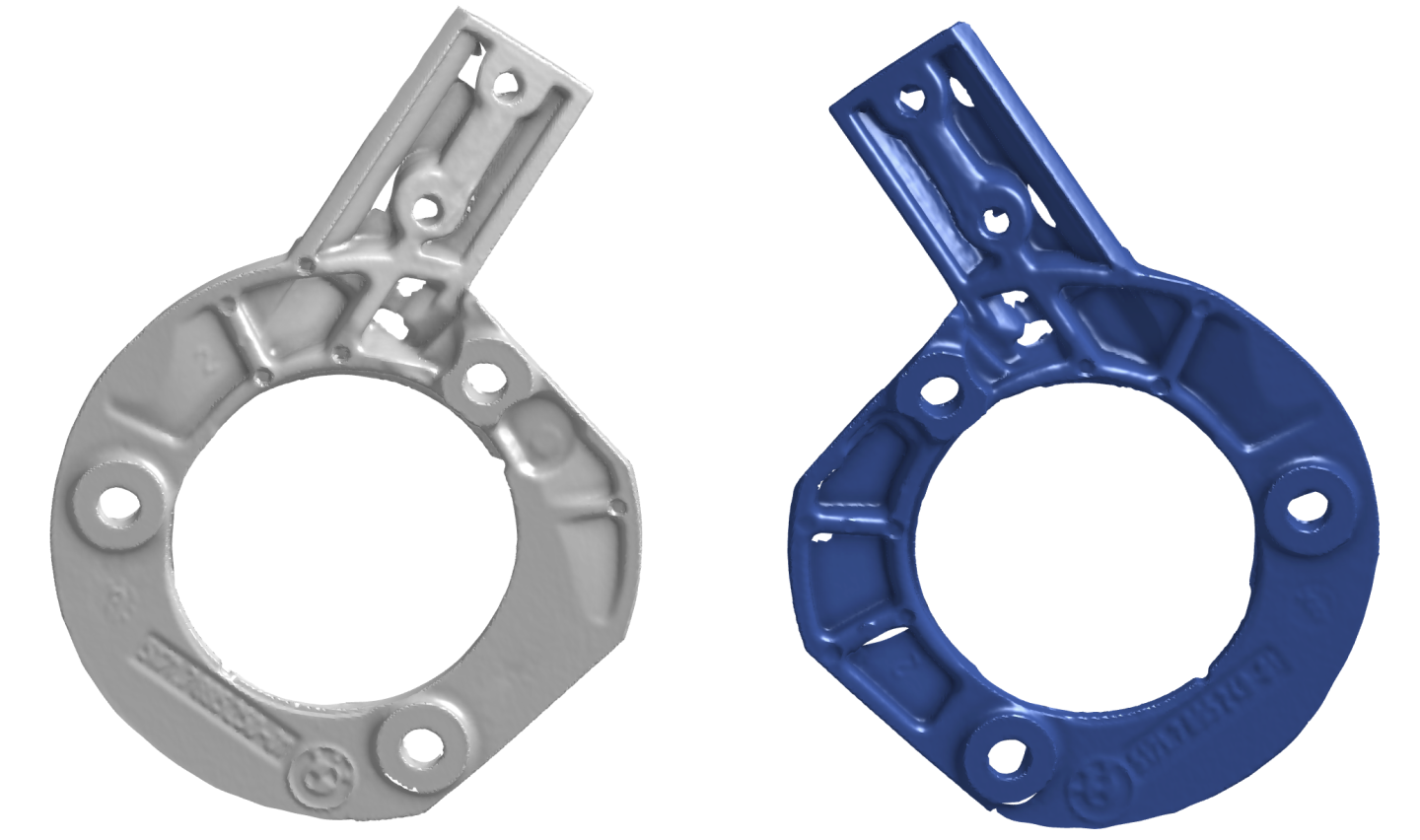

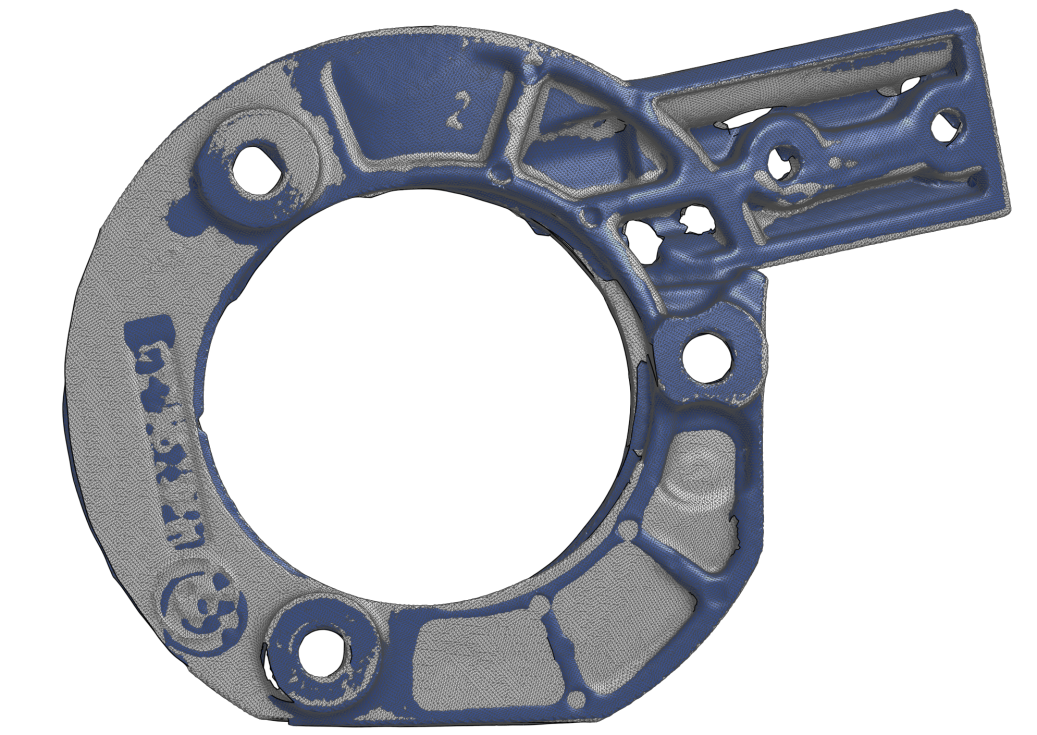

              Before I started doing anything, I wanted to verify that the profiles of these are indeed symmetric (brackets themselves are not symmetric, passenger side has some extra clearance for the positive terminal):
Name:	Screenshot 2025-06-04 at 2.46.29 AM.png
              Nice.

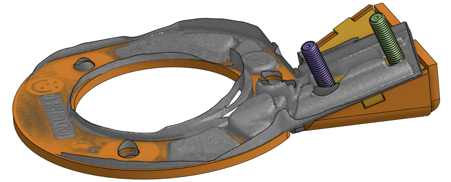

              With that out of the way, I moved onto the actual design. As a reminder, my plan is to machine down the bosses on the stock brackets and sandwich them in between my brackets and the stock bar.
              The only real constraint (besides the obvious spatial ones) is that I can't machine the brackets down too much. The passenger side one gets fairly thin where there's clearance for the positive terminal:
Name:	Screenshot 2025-06-04 at 10.05.32 AM.png
              My plan is to fully machine down the bosses and just barely skim the rest of the surface to get it fairly flat. Quick measurements say that I'll be taking about 3.75 mm of material off, but I won't know for sure how much it ends up being until these are on the mill. I'll start with the hard one (passenger) and then copy whatever I do over to the other one. Hopefully I can get down to the shop soon.

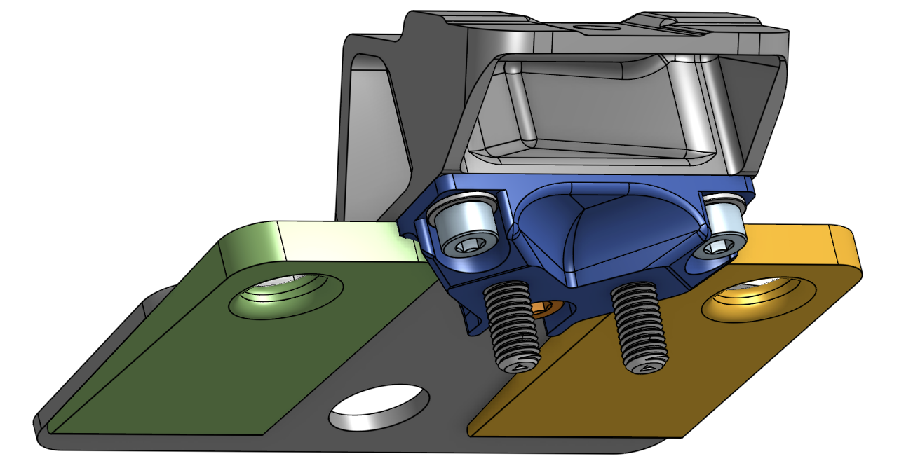

              Anyway, here's my initial approach for the bracket. There's a decent chunk of stuff to work around in these areas, so the funky geometry is a result of that:
Name:	Screenshot 2025-06-05 at 12.06.47 AM.png
Name:	Screenshot 2025-06-05 at 12.07.03 AM.png
Name:	Screenshot 2025-06-05 at 12.07.56 AM.png
Name:	Screenshot 2025-06-05 at 12.08.18 AM.png
              These are designed to be laser cut, bent and welded. M8 press in studs will be used in my bracket and I'll drill the threads of the stock brackets out so that the new studs can pass through. M10 stud for the E86 brace is not shown, but it'll go somewhere in the protruding yellow section. I'll have to fit a prototype up in the car to see if that section is long enough, it might not be as is.
              I still don't know if this current design is manufacturable, though. Some of the bends look like they'll be hard to pull off. Fortunately, I should be able to extend any problematic walls and then cut the piece down myself post bending.
              The other concern I have is that the stock brackets don't leave a lot of room for gusseting the section with studs to the flat section that goes on the strut tower. I did my best with that S shaped wall, but there's no room to do much more than that. I think it should be fine, mostly because of these reasons:
              1. Plan is to get these brackets made out of 4.75 mm thick 304 SS, so they should be tanks.
              2. The stock brackets will help with the stiffness of the entire assembly. Remember I'm really only machining down the bosses, so they should be as strong in bending as they are now.
              And that's about it for now on these. I really can't do much more until I get myself in the shop and machine the brackets.

                  You can eliminate the S shaped wall because you’ve otherwise boxed the shape in by attaching it to the aluminum strut brace. Pretty sure that little wall will not have much contribution to strength and you can avoid weakening the material by eliminating welds. You might wind up just redesigning strut tower bases entirely when this is said and done though
                  If you’re doing new bases, you could also add fastener locations on the fender side for future gusseting to the corners of the windshield too. You know, for a future project..
                    Where do the E86 strut bars boit to? One of the existing press in studs?
                    I still have to figure out where/how I want those to land, so I haven't modeled the studs in yet. But they'll go somewhere in the protruding yellow surface. I printed up a prototype, so I'll do a test fit and post up some pictures in the coming days.
                    Oh good call! Completely overlooked the weakening of the material. Will incorporate that suggestion into the design.
                    And yes, I'm doing my best to keep the stock look, but there is a decent chance that I abandon that entirely and just redesign the entire thing.

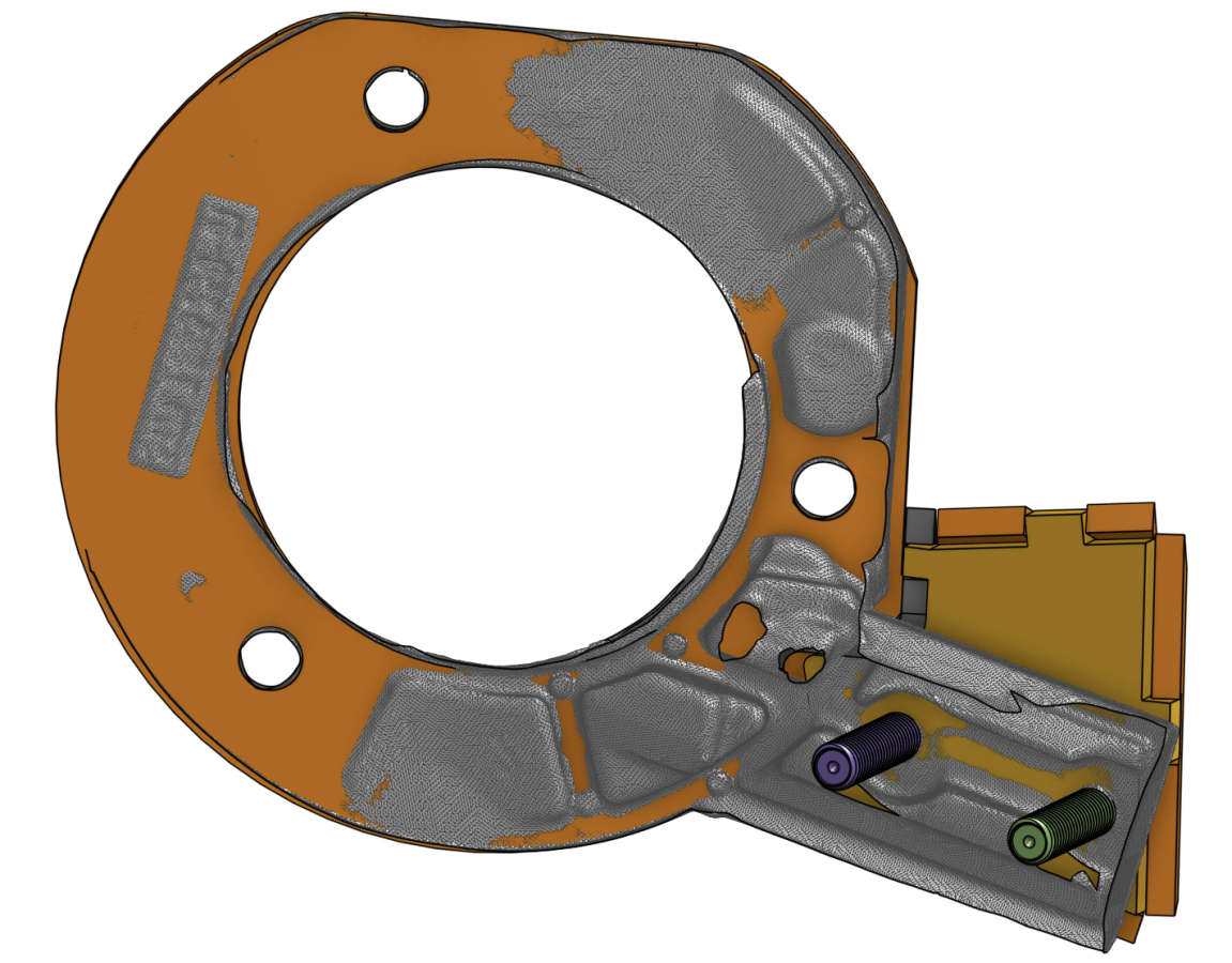

                          Click image for larger version  Name:	20250531_203111.jpg Views:	101 Size:	108.6 KB ID:	306941
                          Click image for larger version  Name:	20250531_202831.jpg Views:	97 Size:	92.3 KB ID:	306942

                          Okay, I lied a bit with this post. Timeserts were dry fitted, not actually installed. Couple notes from the real install:
                          1. By complete coincidence, smee123 made me aware of the fact that Loctite threadlocker is only designed to work on what they call "active" metals. Important thing to know is that if you're using threadlocker on aluminum (or other "inactive" metals), you should also be using their activator, so I did.
                          2. The clearances on the back hole are tight. I designed it so that a bottoming tap would be needed to cut the thread for the insert. The tap in the timesert kit seems to be a custom diameter, but an M10x1.25 tap is very close and cuts those last few threads just fine.
                          Piece is actually ready for install now, will be doing the bonding tomorrow. Quick picture of all the hardware needed:

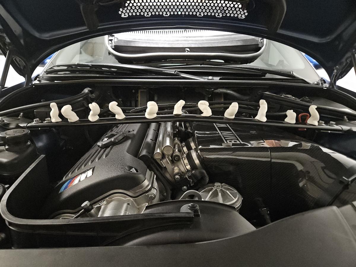

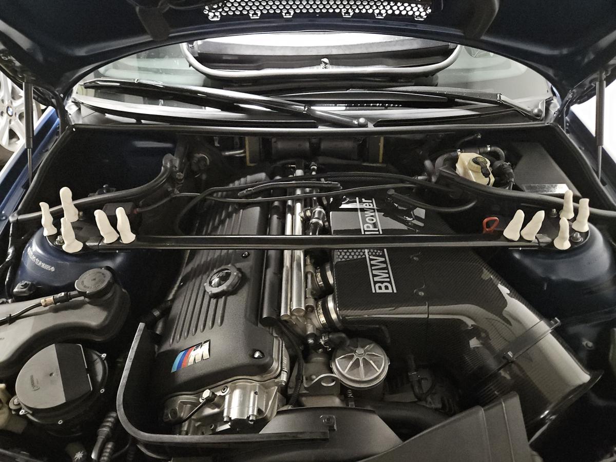

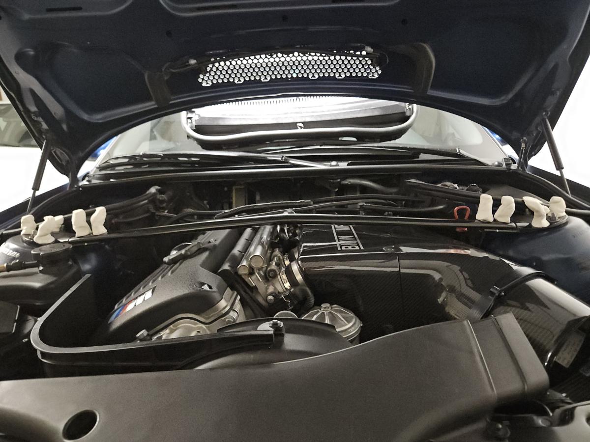

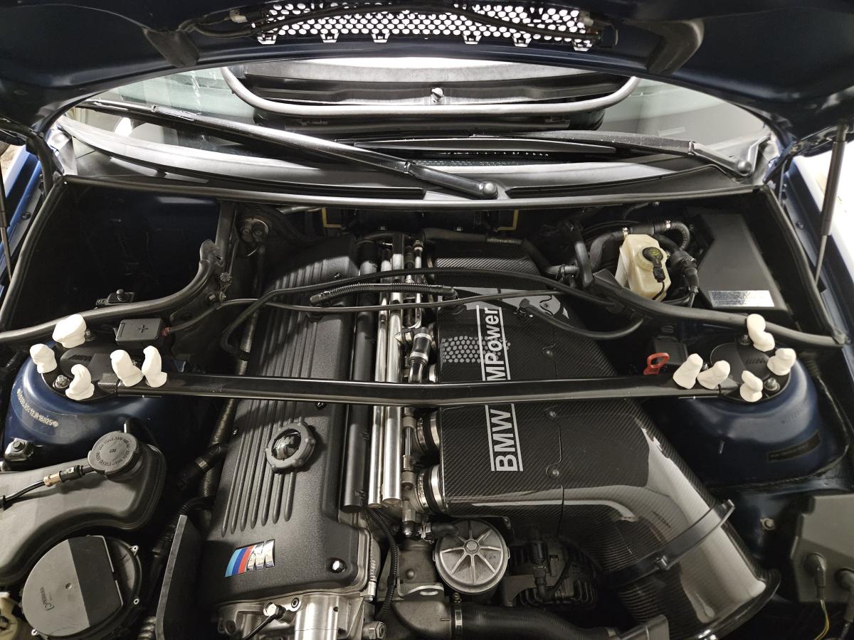

                          Moving on to the the strut tower brackets...
                          One concern I have is that the stock pieces will be spaced up slightly when all is said and done. How much displacement depends on the amount of material I machine off. If I use the 3.75 mm value, that means the brackets and bar will end up 1 mm taller. Additionally, the replacement studs will stick up 2.25 mm more than stock, so max height change will be +3.25 mm.
                          This is a small amount, but I still wanted to be sure that it wouldn't cause an issue. So I grabbed some modeling clay and squished it in between the hood and potential contact points:
                          Test setups:
                          Results:
                          Honestly, wow. That's way, way more clearance than I was expecting. Not even gonna bother measuring, my stuff will fit just fine ​
                            Wow there really is a lot more clearance under the M3 hood. I had to cut my non-m hood a little just to clear the factory strut brace.
                            Mask off the area well before sanding, it’ll be worth it. And don’t skimp on adhesive - wet each surface first then S shaped or fishbone shaped beads to allow air to flow out while you install will give you the best chance of a good bond with fewest air pockets. I always prep with acetone then one directional IPA wipes right before bonding as well.
                            Good luck!
