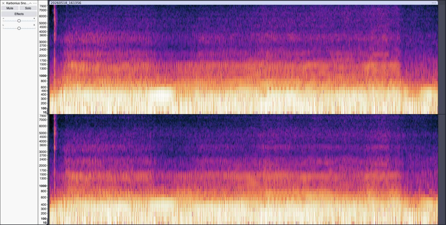

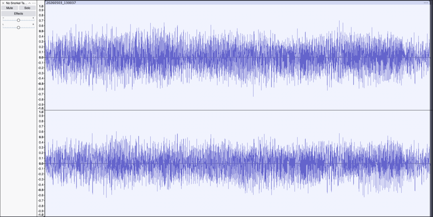

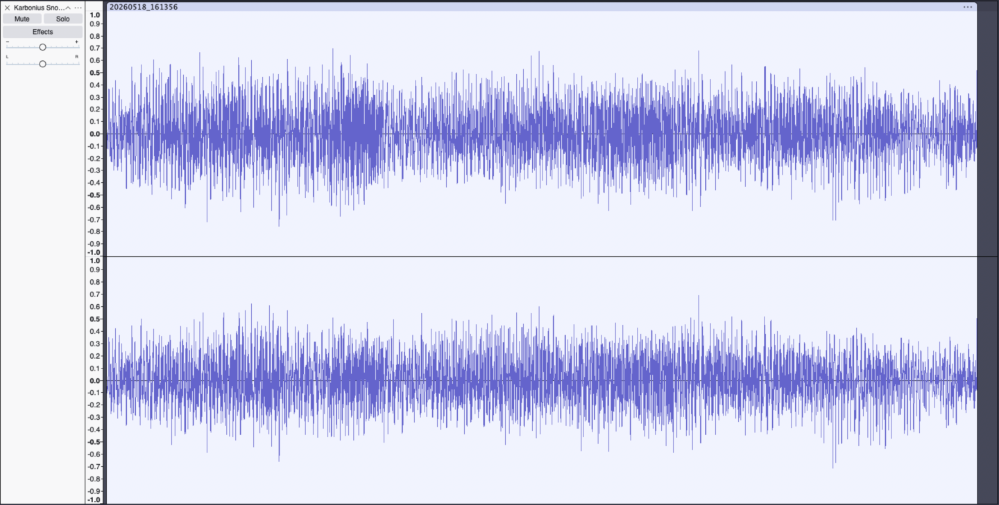

            This change was immediately obvious: less snorkel, more rowdiness. It's not louder, but the overtones in the noise are slightly higher pitched, which makes it feel louder.
            And this isn't just subjective! I have data to prove it.
            First, a comparison of the waveforms of a pull from 3k to 8k rpm (same on ramp, similar weather, mic in the same spot, both WOT). Note that the amplitude is basically the same between both.
            No snorkel:

            Snorkel:

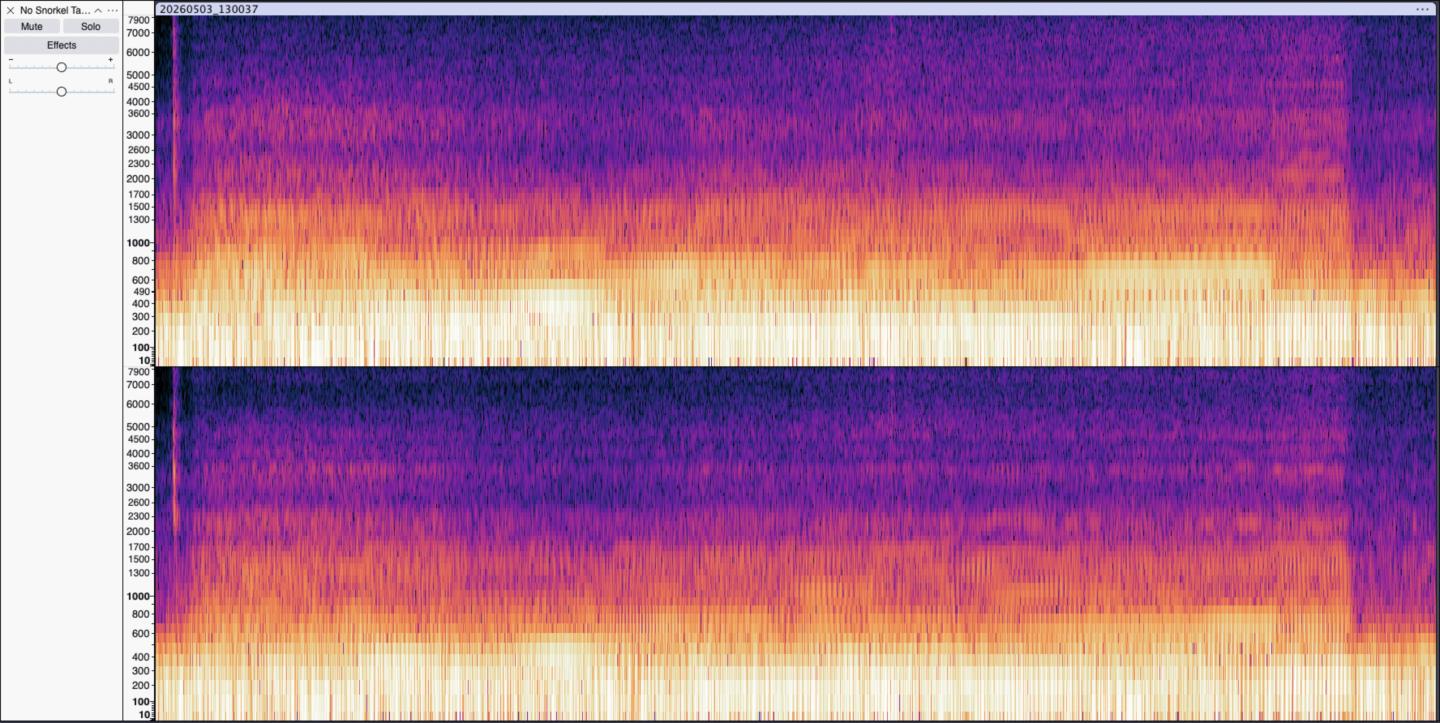

            And here's a spectrogram comparison of the same clips.
            No snorkel:
Name:	No Snorkel Spectogram.jpg
            Snorkel:
Name:	Snorkel Spectogram.jpg
            The difference is very obvious in the spectrograms. Notice how much more higher the frequencies are pushed without the snorkel. With the snorkel, they're all bunched up in the low end.
            Cool to see, but I think I'll be keeping the snorkel for the sake of those IATs
            (also worth noting that this is with the cerakoted snorkel. I'm not sure how much the coating affects the sound, but it sounds pretty similar to what I remember the uncoated snorkel sounding like. I wish I had captured audio of that combo as well, just to know for sure)

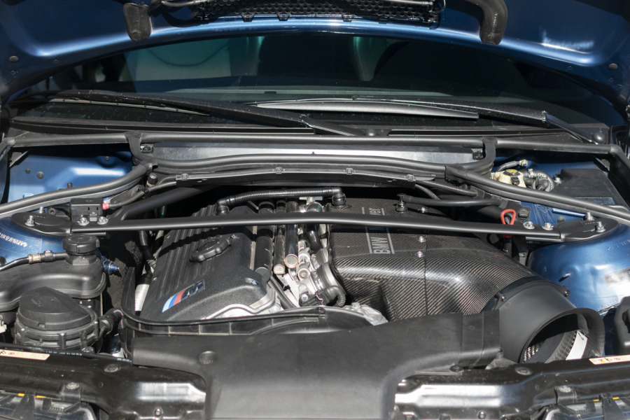

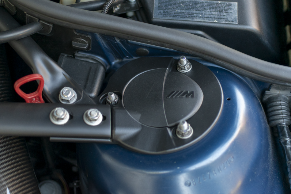

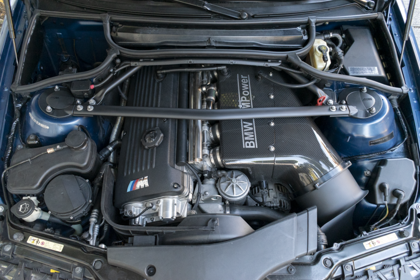

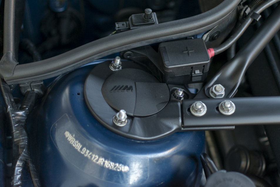

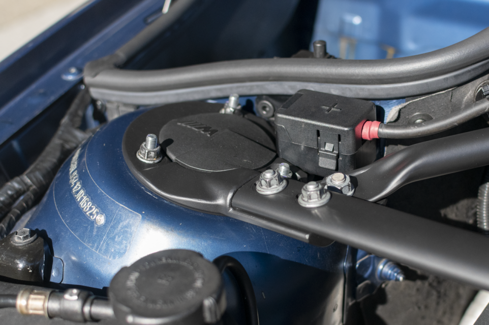

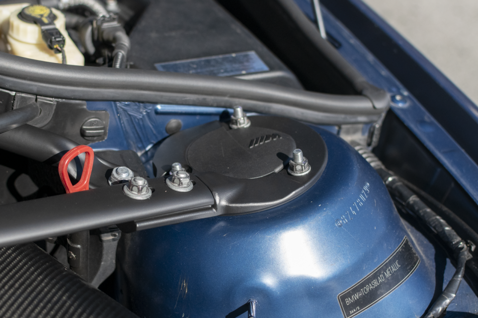

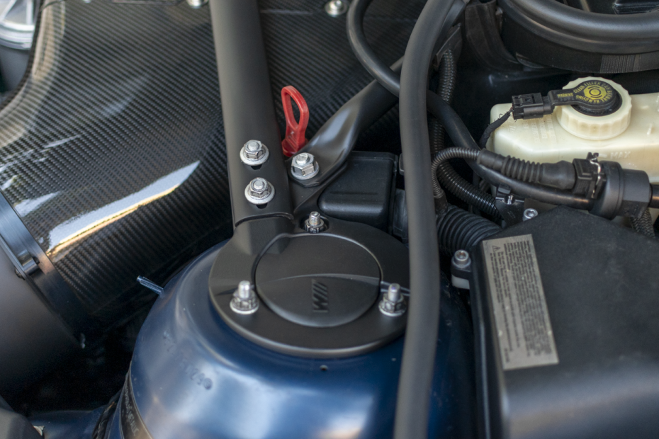

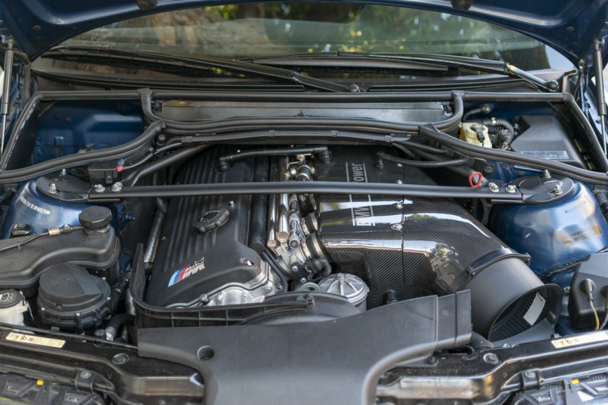

            Anyway, too much talking. Ending this one with some much better engine bay pictures, in a couple different lighting scenarios.:

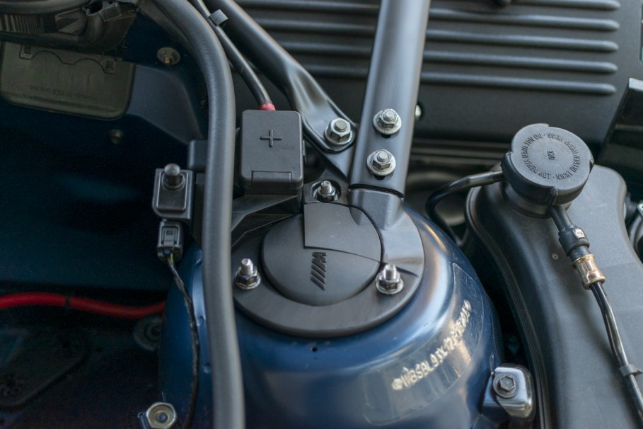

              Both brace and snorkel turned out amazing with the cerakote!
              The snorkel might need a sticker delete
                Yeah, sticker is pretty unsightly. I asked for it to get masked cause it has manufacturing info on it, buut all of that came off when unmasking.
                Which means that if I do remove it, I have to figure out how to blend the overspray with the raw carbon under the sticker. Soooo I've just been ignoring it.
                  My Z4 braces just showed up
                  And the brace looks sooo good, but that snorkel being cerakoted vs CF is the chefs kiss IMO.

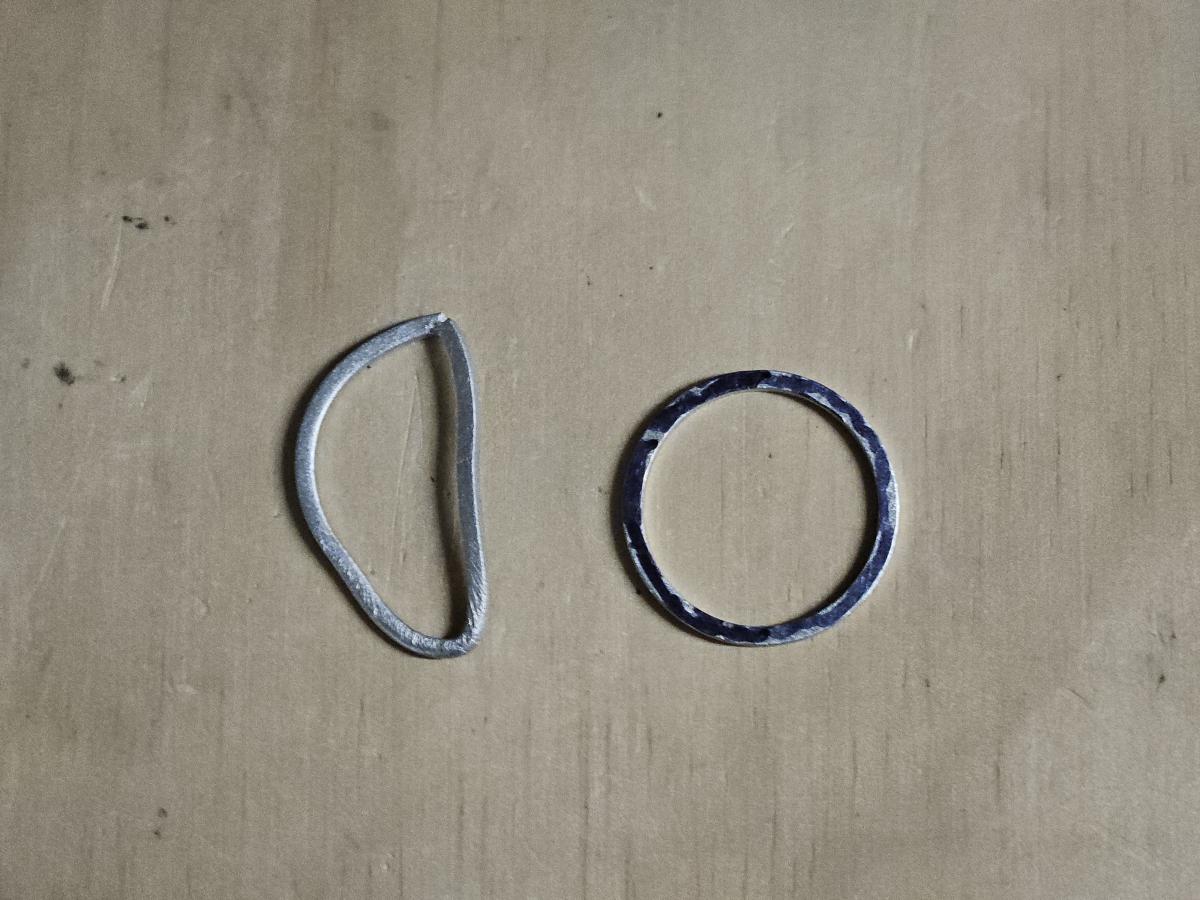

                          First, let's document the annealing process.
                          I hung the crush washer from a bent paper clip and used a propane torch to heat it up (was afraid MAPP would pretty much immediately melt it), then quickly quenched it in some room temp water.
                          My first attempt involved trying to judge temperature by eye and resulted in this:
                          Click image for larger version  Name:	20260603_201046.jpg Views:	0 Size:	127.0 KB ID:	357358
                          So, for my next attempt, I scribbled with a sharpie on one side of the part (as can be seen above) and hit it with the torch from the non-sharpied side. Once all the sharpie disappeared (i.e. part had heated all the way through), I quenched it in the water.
                          Supposedly, sharpie ink disappears right around the annealing temp for aluminum, which is why it can be used as a temp indicator. Can't remember where I learned this trick, but thank you brain for stashing that bit of info away.
                          This method worked significantly more reliably.

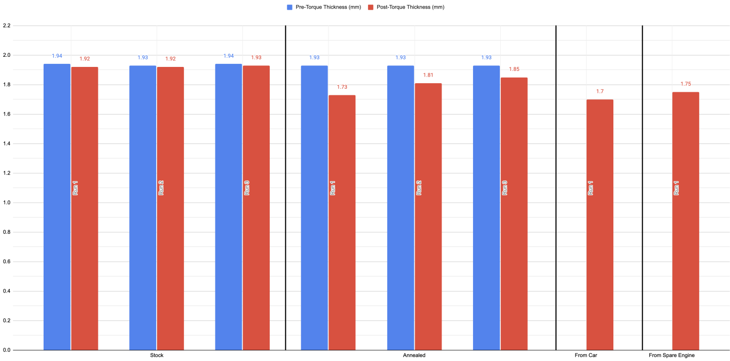

                          Here's an overview of the experiment:
                          1. Measure thickness of crush washer pre-torquing.
                          2. Torque tensioner along with above crush washer on spare engine to factory spec. Spare engine is used here so that torque wrench is on straight and the procedure is repeatable.
                          3. Measure thickness of crush washer post-torquing.
                          I also found a crush washer stuck on the head of the spare engine, so I measured that one + the leaky one that came off the car for some extra data.
                          Some givens/assumptions before diving into the data:
                          • I assessed four different "versions" of the same part:
                            • A new stock crush washer (1)
                            • A new crush washer that I annealed (2)
                            • The crush washer that came off the car (3)
                            • The crush washer that I found on the spare engine (4)
                          • (1), (2) and (3) were all purchased at the same time. I placed an order for ~20 a couple years back, so it's highly likely that they were all produced at the same time, in the same factory, from the same material, etc.
                          • (4) has a completely unknown history. It's highly unlikely that it's from the same batch as the others.
                          • (3) was torqued by me following the BMW spec.
                          • (4) was torqued by someone else to some unknown value.
                          • Pre-torque thickness of both (3) and (4) are unknown. Since (3) is likely from the same batch as (1) and (2), we can assume that its pre-torque thickness was similar to that of those.
                          • For max scienceness, I prepared three samples of (1) and three samples of (2), then ran the experiment on all of them.

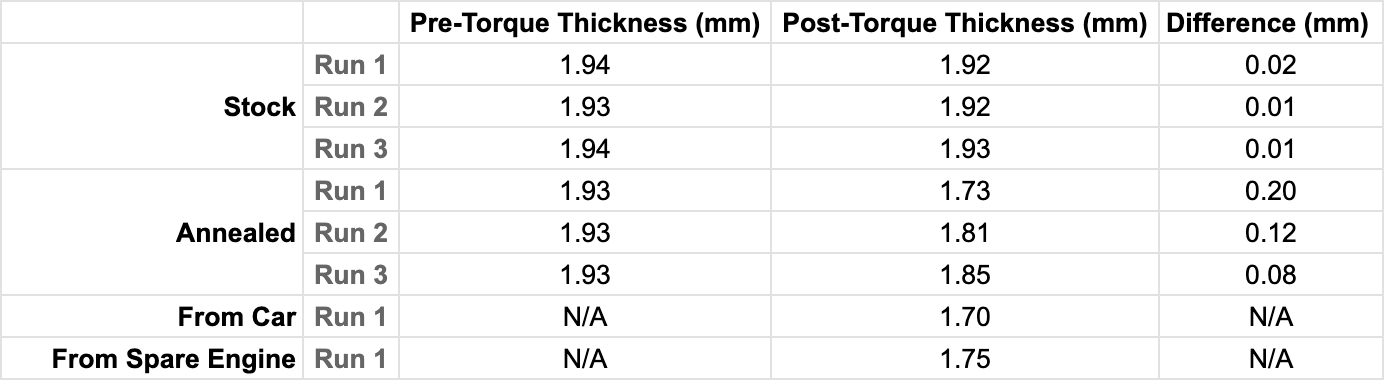

                          Data:
                          Click image for larger version  Name:	Screenshot 2026-06-04 at 1.24.04 AM.png Views:	0 Size:	58.9 KB ID:	357360
                          Click image for larger version  Name:	Screenshot 2026-06-04 at 1.16.32 AM.png Views:	0 Size:	50.1 KB ID:	357359
                          From this, we learn the following:
                          • (1) crushes by a small, but very consistent amount.
                          • (2) crushes by a larger, less consistent amount. I suspect the lack of consistency comes from the annealing process. Doing so with a torch is not super repeatable, which likely leaves the hardness all over the place. Nonetheless, they still crush more than (1), implying they're softer.
                          • The post-torque thickness of both (3) and (4) are closer to (2) than to (1), even though they were not annealed prior to torquing.
                          The first two observations confirm that the annealing works, but I think that the last observation is by far the most interesting one.
                          The fact that the used crush washers are closer to the annealed ones makes me wonder if this part is gradually annealing from engine heat cycles, causing the joint to lose clamping force over time. This is a bit of a logical leap, since we don't have the pre-torque data, but this could explain why this part seems to develop a leak over time, rather than leaking immediately. I'm for sure gonna be checking the torque on the tensioner after some time.

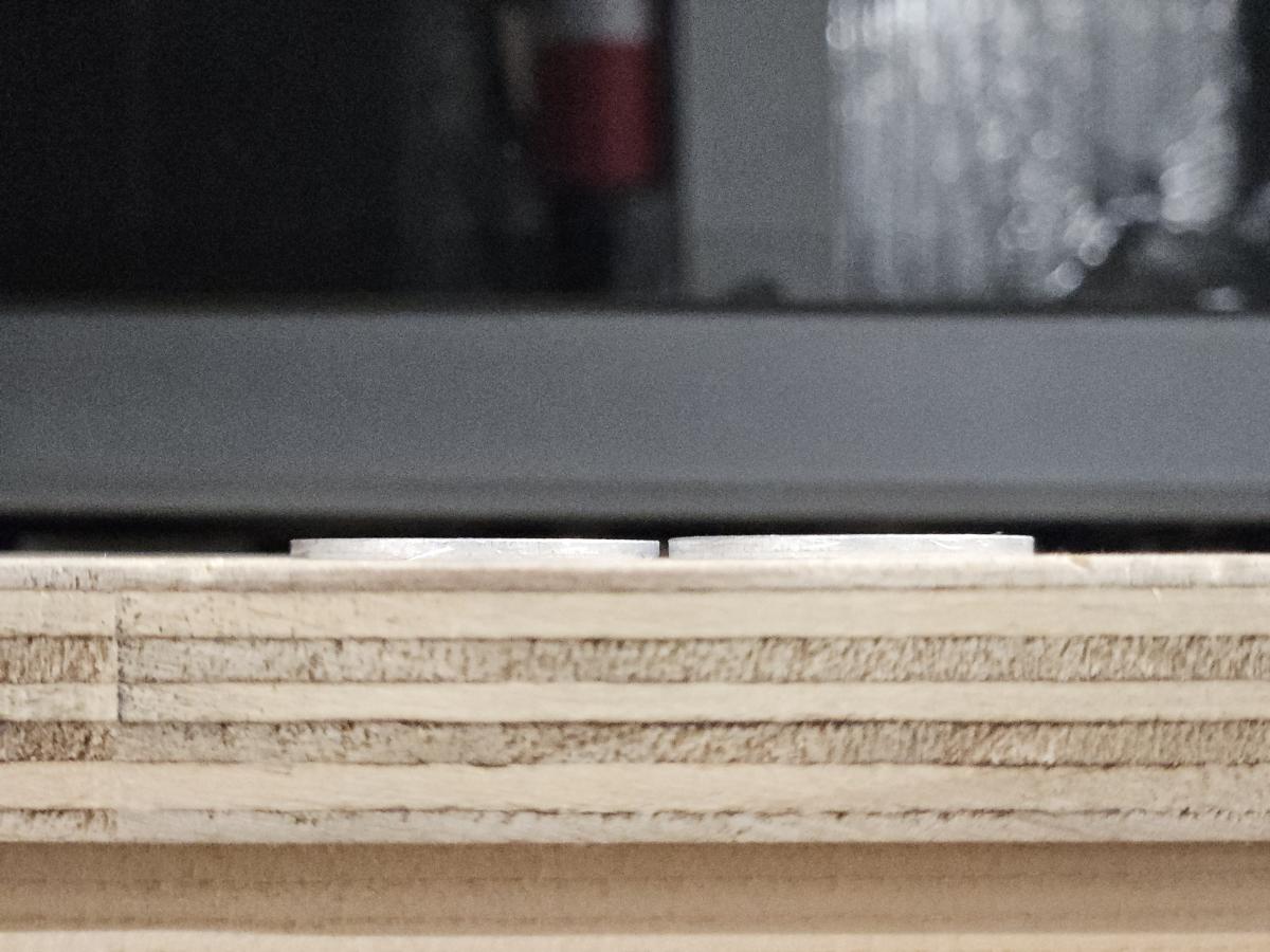

                          Here's a post-torque comparison of an annealed (left) vs stock (right) crush washer, as well. It's subtle, but you can tell that the annealed part crushed more:
                          Click image for larger version  Name:	20260603_211145.jpg Views:	0 Size:	118.5 KB ID:	357361
