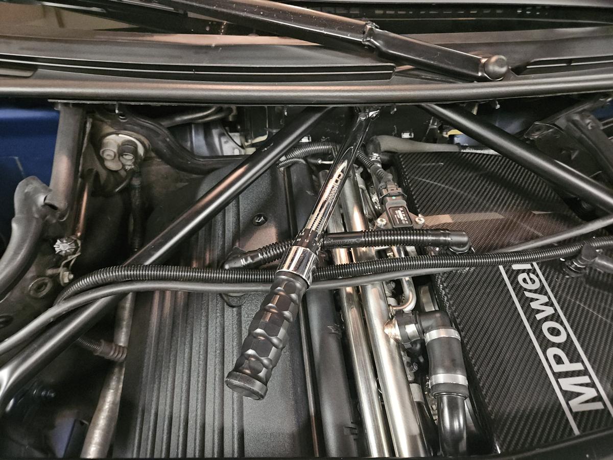

                    Tool arrived for the last little detail on the mechanical side of the braces:

                    BMW spec for the nuts is 41 Nm, so a regular box wrench is more than adequate for doing them up, but using a torque wrench makes my brain happy.
                    Adapter measures 51 mm from center of box end to center of drive end and torque wrench measures 330 mm from center of drive end to middle of handle. Quick bit of math tells me torque wrench needs to be set to 35.5 Nm (26 lb ft) to achieve 41 Nm at the fastener with the adapter completely parallel to the torque wrench.
                    Looks like I got my tool clearance measurements right cause I can torque both nuts no problem

                    Side note: this is probably the first time I've ever found a use for the center position on the torque wrench ratchet mechanism. This position doesn't let the wrench ratchet, so it ensures the adapter stays parallel. Pretty nice.

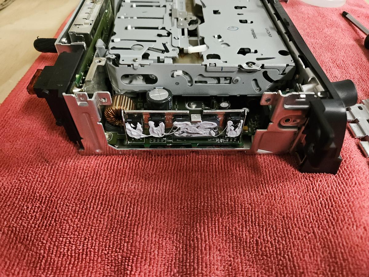

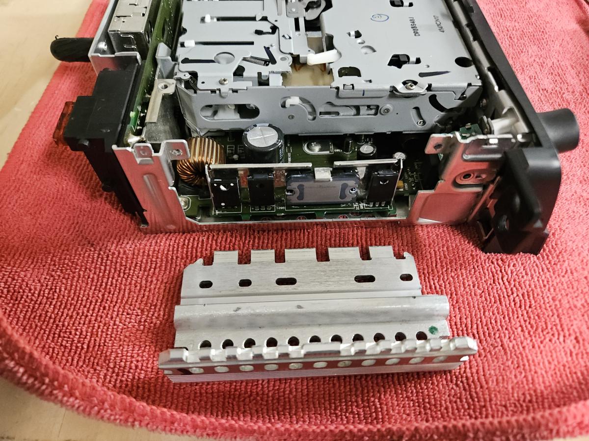

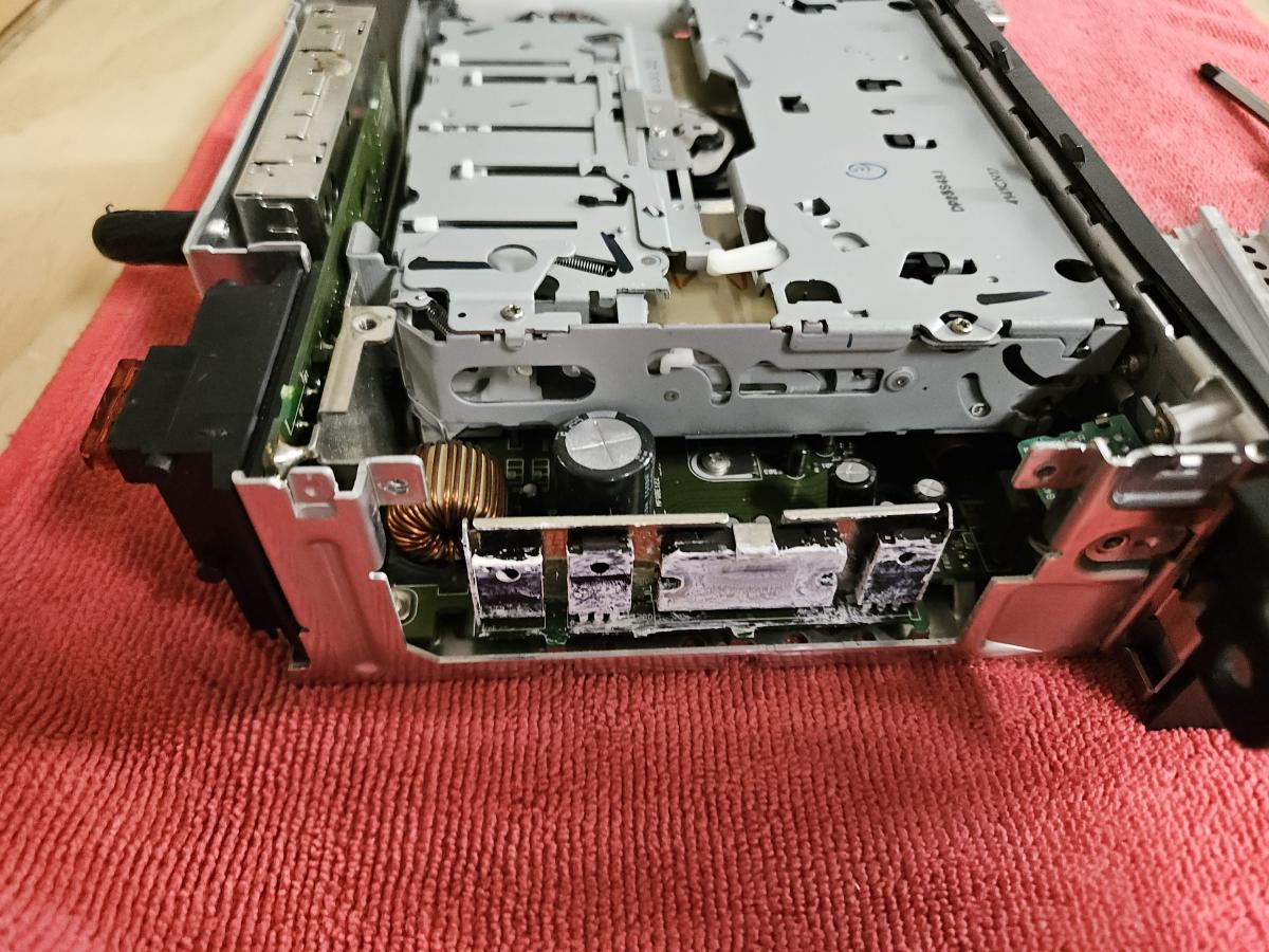

                    Also, it's been getting warmer and audio system is back to overheating and shutting off when parked in the sun
                    There's a heatsink inside the head unit with thermal paste that looked just as bad as the stuff in the HK amp, so I serviced it:

                    (yeah I suck at applying thermal paste, leave me alone)
                    The issue seems to only happen when the car is parked in direct sun, so it sounds to me like the HK amp is a more likely culprit. I honestly doubt this is going to fix it, but it was super quick, so worth a shot. I might be looking into replacing that HK amp soon though.

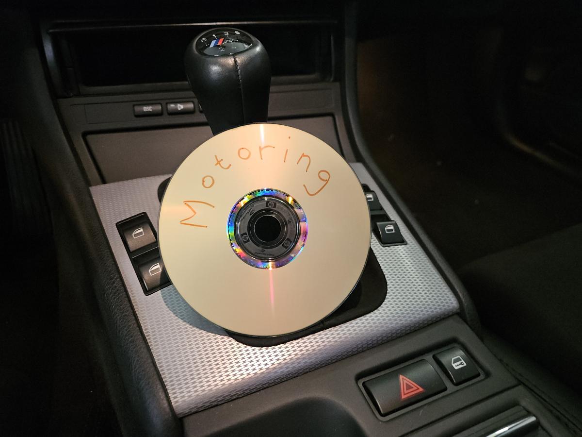

                    Also, disassembling the head unit reminded me of this awesome gift that the previous owner forgot in there when he sold the car to me:
                    It's mostly 70s and 80s stuff, it's great. This is full track list, just for fun:
                    1. You Should Be Dancing - Bee Gees
                    2. Overkill - Men At Work
                    3. Refugee - Tom Petty & The Heartbreakers
                    4. I Don't Want To Live Without You - Foreigner
                    5. No. 1 - Chaz Jankel
                    6. Everything She Wants - Wham
                    7. Promises, Promises - Naked Eyes
                    8. Cold As Ice - Foreigner
                    9. This Must Be the Place (Naive Melody) - Talking Heads
                    10. Gypsy - Fleetwood Mac
                    11. Tiny Dancer - Elton John
                    12. Careless Whisper - George Michael
                    13. I Guess That's Why They Call It the Blues - Elton John
                    14. Sister Christian - Night Ranger
                    15. Ai No Corrida - Chas Jankel​
                    CD is back in the head unit, waiting to be rediscovered sometime in the future
                      Hell yeah. I’d also add 5Nm or something to account for that cut thread running torque issue above if those are the same fasteners, you know, just to be pedantic. You’ll be fine either way really.

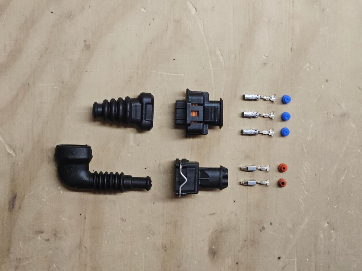

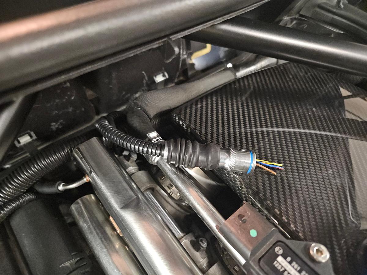

                        Re(re)wired the MAP and IAT sensor connectors:

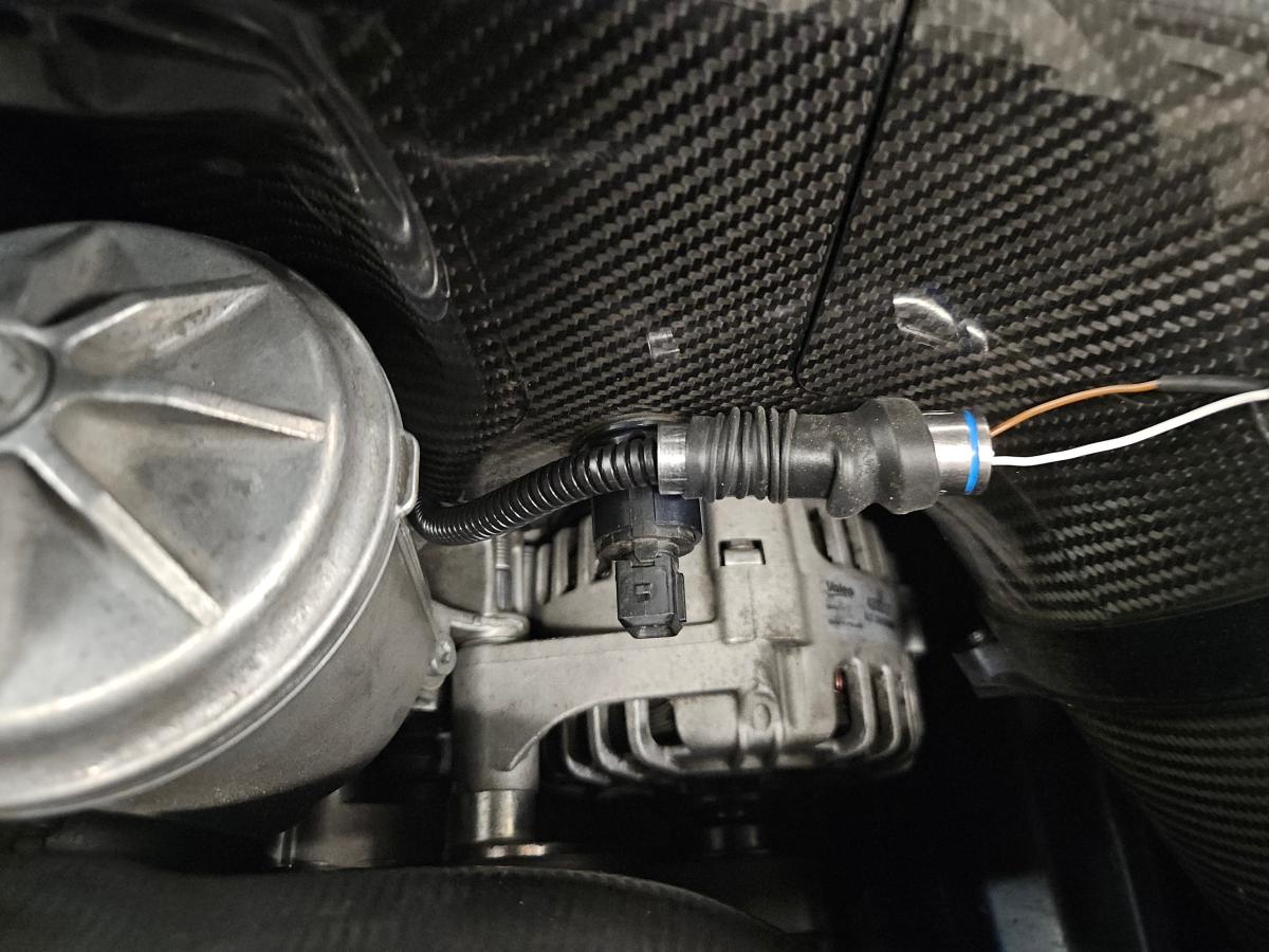

                        To get the boots on, I lubricated a deep 10 mm socket with some krytox and slipped the boots over that first. Worked like a charm:

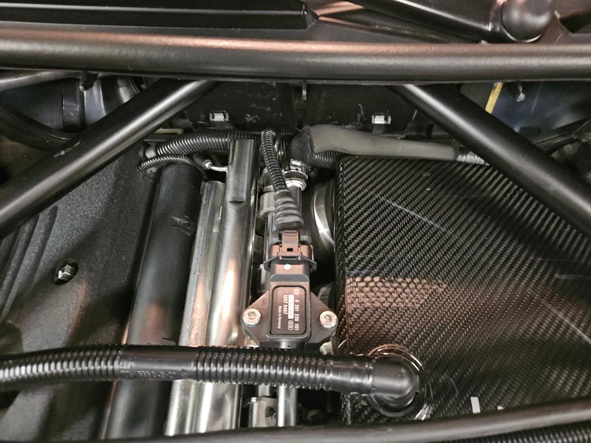

                        Some crimping later and done:
                        Very happy with the quality of this new MAP connector. Definitely nicer than what was on there before.
                        Unfortunately, not at all happy with the quality of the ECS kit I ordered for the IAT connector. I thought it was composed of genuine parts, but that is most definitely not the case. Should have looked more closely.
                        Had BMW parts on there before and quality was way better. To boot, the ECS crimp terminals are bigger than the BMW ones, so I wasn't able to reuse the old stuff.
                        I know this is insane, but I'm gonna order some genuine crimp terminals (12521427612) with my next FCP order and swap back to the old connector. Will do that off camera cause this work is getting repetitive and boring.
                          This is not insane at all, it is these little details that my ADHD fixates on and must be fixed so I can find something else to fixate on.
                          The 10mm deep socket over the boots is a great idea, I ended up using solid core wire on my IAT because for the life of me I could not get 2 stupid wires inside of (12517508831) to make the 90° turn in (12521732635). I am going to give this a shot as solid core wire is not a great idea.
