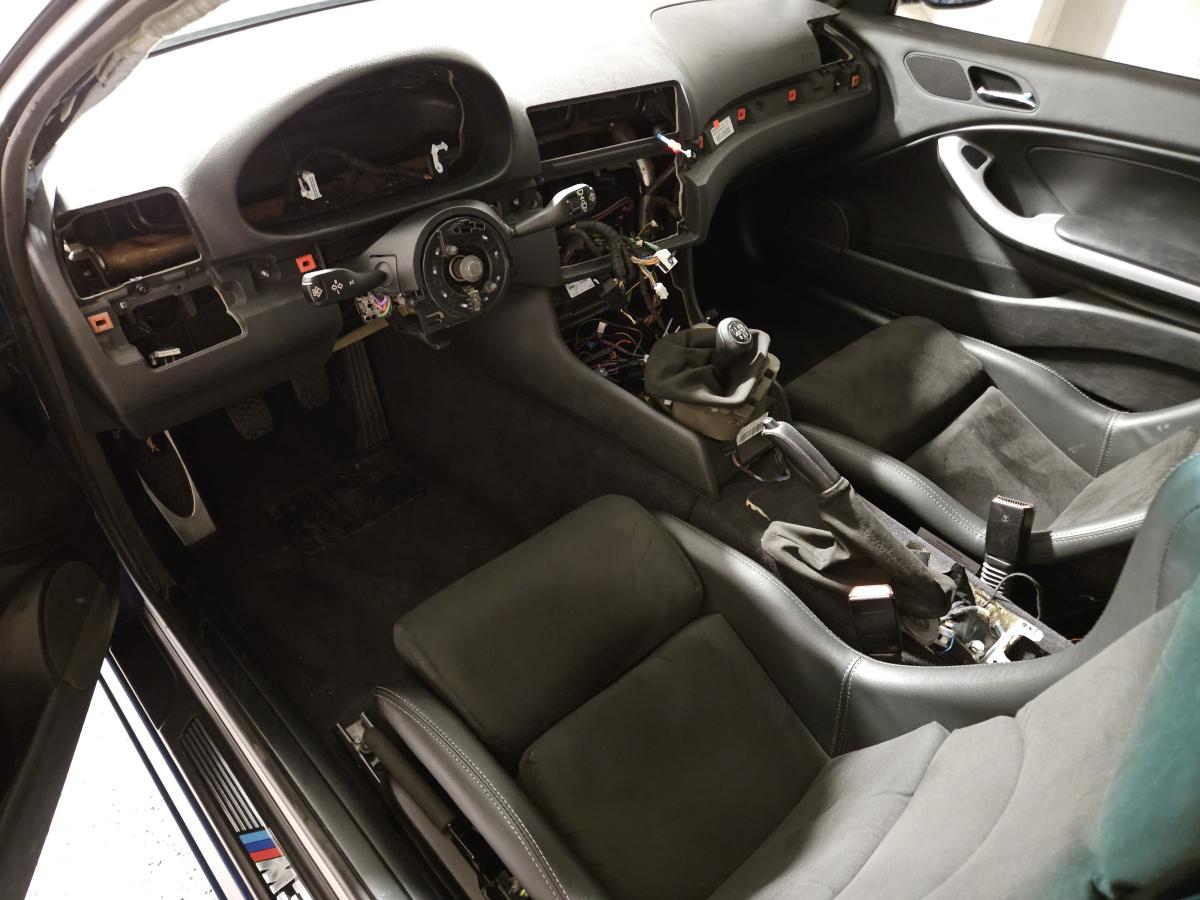

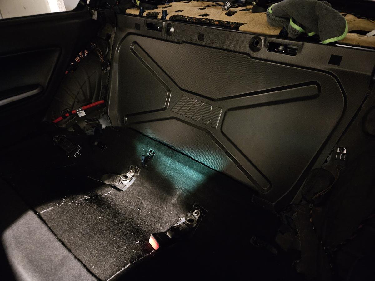

                          Many, many hours later, the interior is clean again.
                          I started by just vacuuming things out, but I just kept finding dust/sand everywhere. Started taking things apart and quickly arrived at this:
                          Ended up basically taking the entire interior apart. Was crazy to see just how far into things the dust made it.

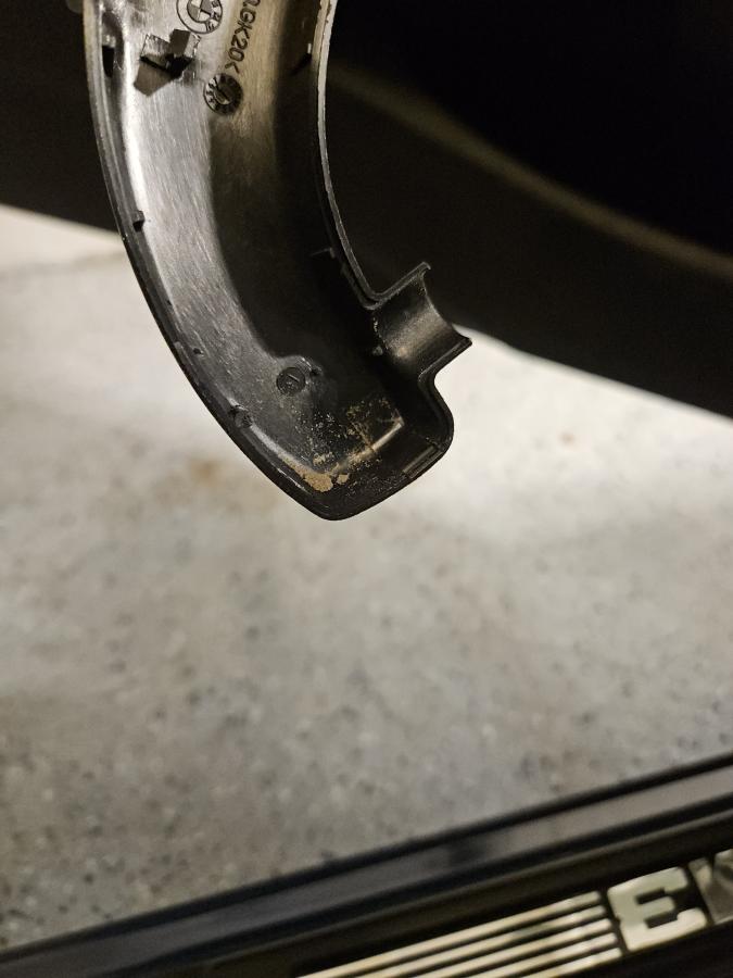

                          For instance, found sand dunes in the trim for the rearview mirror:
                          I guess that's not too crazy, since it's not exactly a sealed part. But look at this:

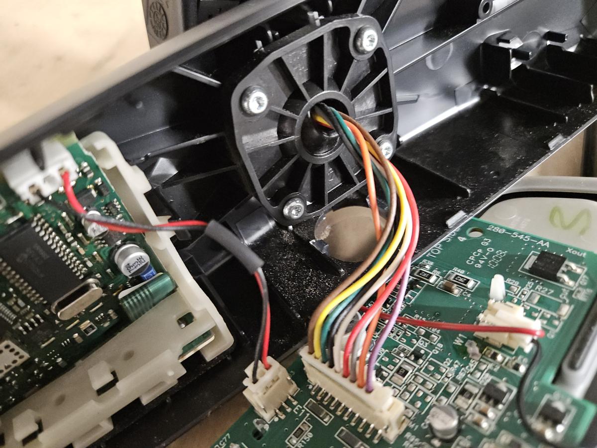

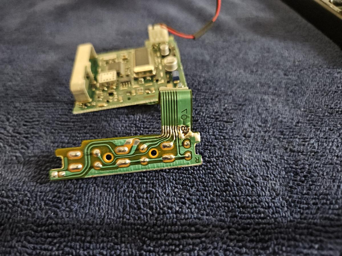

                          Unfortunately, I broke the ribbon cable for the homelink module when taking it apart, so had to break out an emergency repair:
                          I smeared a bunch of glue on top of the solder butt joint to try and make it reliable, but I can't imagine this fix will last long. Oh well. At least the daughterboard with the ribbon and buttons should be an easy piece to scavenge out of a junkyard mirror. Added to the list.

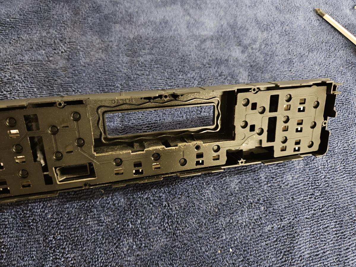

                          I also took anything with buttons apart and cleaned out everything on the inside. This is what all of the buttons on the car looked like and why everything felt crunchy when pressed:
                          Funnily enough, now some of the buttons are so clean that they squeak when pressed. Bought some of the Krytox that comes in a bottle with a syringe cap, so will go around the car with it to make everything nice again.

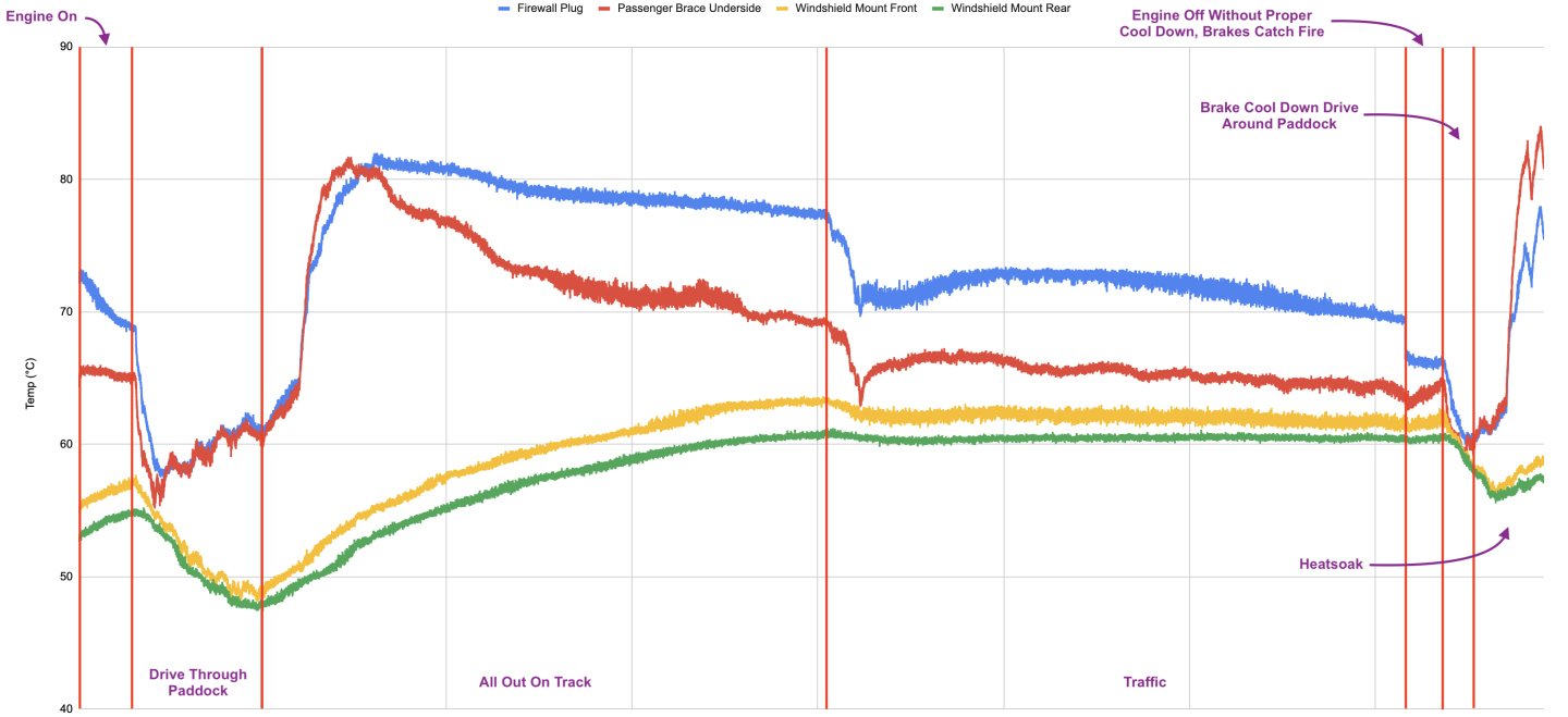

                            Finally sat down to analyze the thermocouple data. Quick notes on the test setup:
                            • Logged as many scenarios as I could, so data would include multiple driving styles (highway, around town, on track).
                            • Track day was at Buttonwillow 13CW.
                            • Ambient temps were between 20-28 C.
                            • No clouds, sun was out all day.
                            • Car was purposefully not parked in the shade to maximize heatsoak.

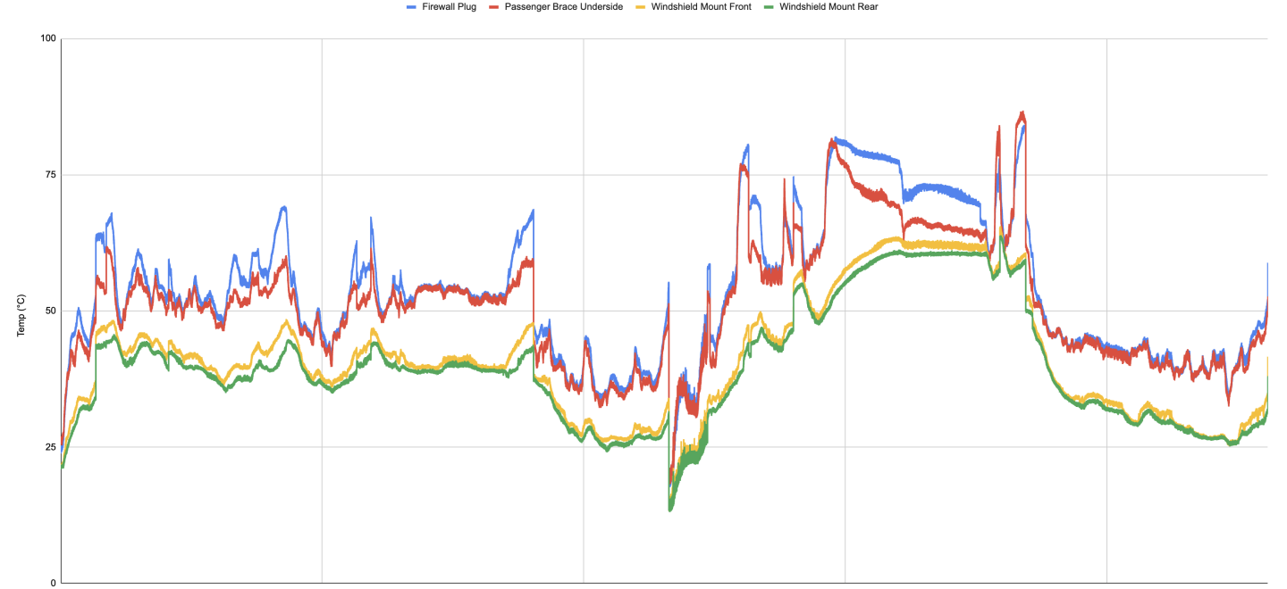

                            Alright, let's jump straight to the analysis. Unfortunately, there is way too much data for datazap to handle, so you guys only get non-interactive images this time. Here's everything I captured throughout the day concatenated into one big chart (vertical discontinuities are from when the ignition was off, x axis is time elapsed):
                            Some key takeways after looking through the data:
                            • Any airflow in the engine bay quickly drops temps for all thermocouple locations (more on that in a bit).
                            • Temps behind the firewall consistently trail engine bay temps by ~20 C, which means the thermal insulation properties of the 3D printed parts work!
                            • At steady state, the engine bay thermocouples settle at ~60 C and the ones behind the firewall settle at ~40 C.
                            • Convection seems to play a bigger role in the temps of these parts vs radiation.
                            • Max values for each location follow:
                              • Firewall Plug: 84.1 C
                              • Passenger Brace Underside: 86.8 C
                              • Windshield Mount Front: 65.5 C
                              • Windshield Mount Rear: 63.9 C​

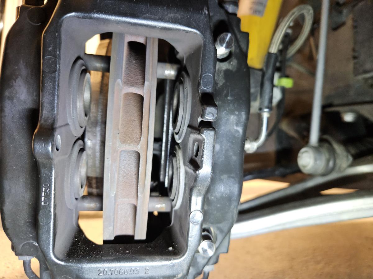

                                parked the car and my front brakes immediately began to smoke (I'm guessing the dust boots are once again toast, yay), so I had to jump back in the car and drive it around the paddock for a bit to cool them down.​
                                Well, turns out I was wrong.
                                Swapped back to street pads today and I couldn't find a single crack on any of the dust boots. They're all still in perfect shape:
                                Honestly kinda blown away that the dust boots survived that.
                                Also, I have no idea what did catch on fire, but I can tell you that smoke was pouring out of both front wheels before I hopped back in to do the cooldown lap of the paddock. Maybe it was from tire rubber stuck to the inside of the wheels?
                                Anyway, I'm super happy that I don't have to swap the dust boots out for the millionth time.
