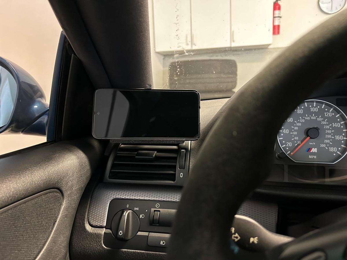

        I have a CarPlay piggyback unit in the E82 daily and can't say I miss it in the E46. BlueBus does everything I need it to do, except for navigation. I've driven a couple E46s with CarPlay retrofits and don't love the screen position, especially compared to the where the screen is on the E82. I find it super hard to quickly glance at the nav screen in the E46.
        If I do want to pull up a map, I just use my phone on a mount up on the dash. I printed this thing and really like where it puts the screen:

            If I do want to pull up a map, I just use my phone on a mount up on the dash. I printed this thing and really like where it puts the screen:]
            Love it! I'd rather use my phone for nav than have an aftermarket stereo.

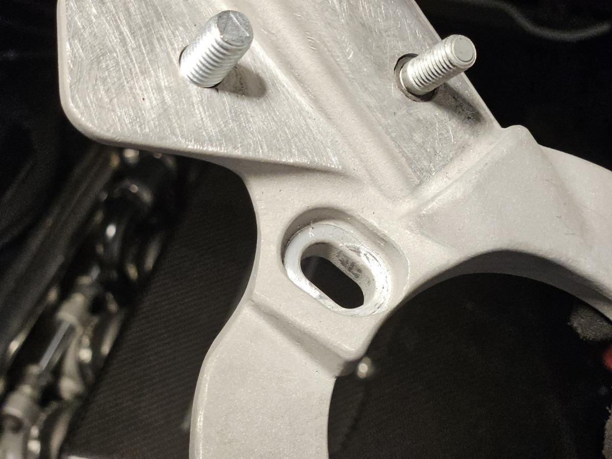

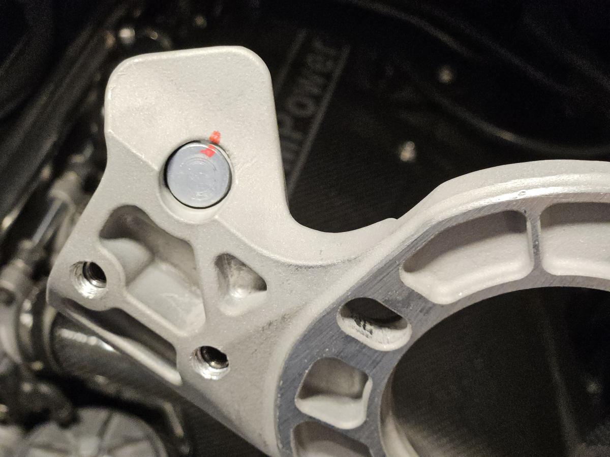

                  Well, the brackets have survived 500 street miles and a track day. Think I'm gonna call that a tentative success. Time will tell how quickly these will fatigue, but I'm not too worried about them.
                  Here's what they look like now:

                  No cracks, no weird witness marks and all fasteners still torqued to spec. Off to paint!

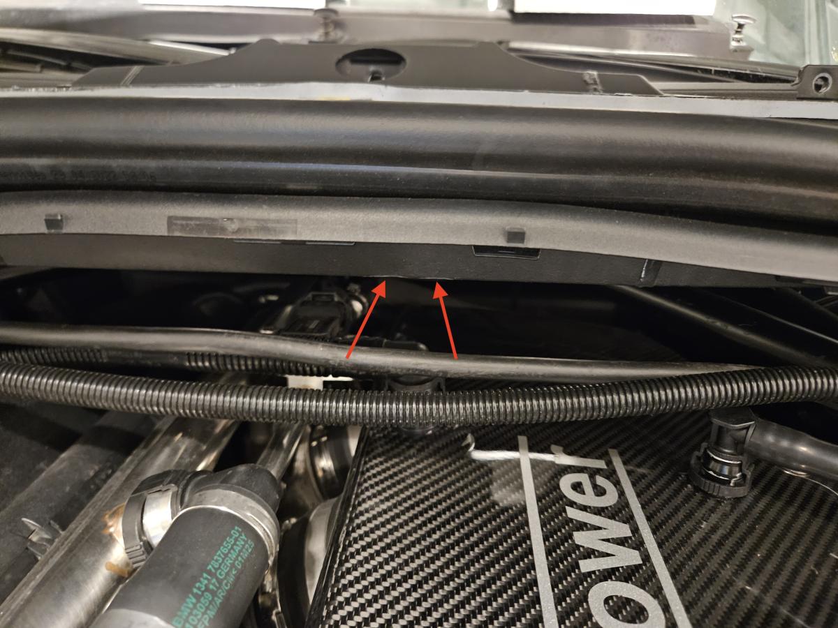

                  I did notice one other thing though. Looks like the cabin air filter housing is dynamically contacting the PCV hose on top of the engine:

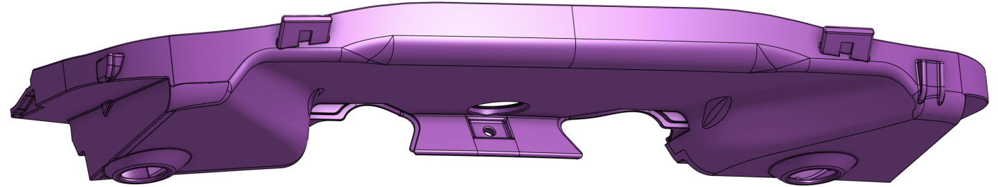

                  Fixed in CAD by adding a big fillet to the front, similar to how the BMW part is designed:

                  I was feeling too lazy to reprint/reassemble this part, so I tried heating up the one I have and making some clearance manually. That didn't work at all, so came up with a genius strategy: ignore!
                  I'll probably eventually reprint this, but the interference is minor and I'm not all that worried about it. I'll throw some tesa tape or similar on the part so that it doesn't cut through the PCV hose and it should be fine.

                      I think I just didn't leave enough clearance. The stock part tucks up a lot up front, but I left more material on mine because the cutout for the braces makes it a bit floppier. The radius I added yesterday gives an extra 8 mm of clearance and should keep the part's stiffness pretty much unchanged.
                        New mounts will make it worse, engine would raise a bit v worn / used ones. Fillet was the right choice for sure
                          Turns out the painter who's gonna paint these parts is on vacation until next week. No big deal, but the final beauty shots are slightly delayed.
                          The car has no front bracing installed at all right now and I'm kinda excited to drive it around like that for a bit, especially after becoming used to the stiffened chassis. Will report back on driving experience.
                          Coincidentally, I just got word that the mill is back up and running, so I'll get a chance to mill the last two slots before paint. After looking at everything yesterday, I really dont think the milling is at all necessary, but I've already done one side and the asymmetry is gonna bother me forever if I don't do the other.

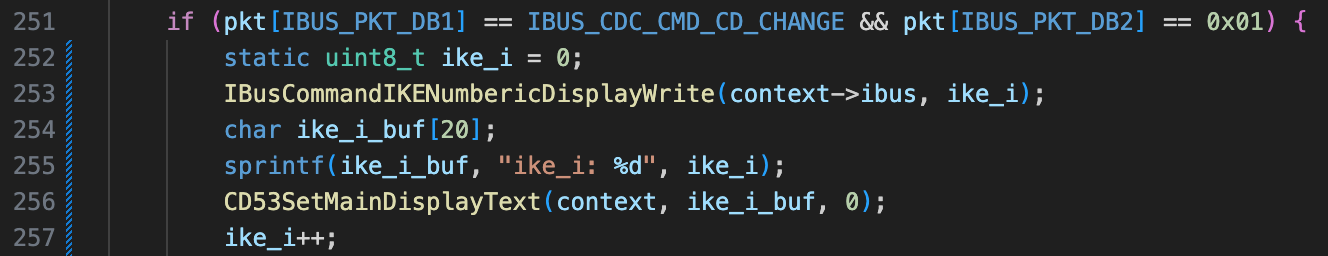

                            The factory nav can display the distance to the next turn in the cluster, so I figured I could exploit this capability and display whatever I want (well, mostly) by sending IBus messages with my BlueBus. As per usual, Ted's codebase is awesome, so there's already a function to handle this.
                            Here's my horribly hacky proof of concept code that you see running in the video:

                            I still don't exactly understand why the number displayed in the cluster doesn't follow the number sent to it via IBus, but that's a question for later. It seems to be counting in base 16, but displaying in pseudo-base 10, super weird.
                            I tried with a uint16 as well, but the number in the cluster reset back to 0 once ike_i went above 255. I think I'll sweep through a uint64 just to see if there's any interesting behavior from the cluster with the higher numbers, but I doubt I'll find anything.
                            Anyway, the real question is what to do with this newfound capability. I'm thinking that displaying the current gear might be a good starting point. My Gauge.S already calculates that, so just need to figure out how to get the info from it to the BlueBus and should be good to go.
                            A friend also suggested adding a "do not downshift" indicator, where some extra symbol is displayed next to the current gear whenever downshifting would result in an overrev. Seems like symbols are off the table, but I might be able to rapidly flash the displayed gear or something along those lines. We'll see.
