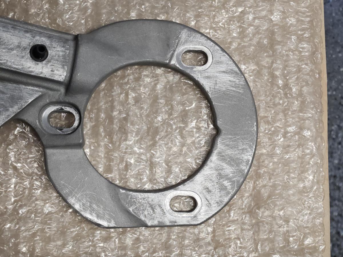

                  Also, nice, managed to finish the two remaining operations without breaking the mill again:

                  Also, took the unbraced M3 down to the machine shop and I'm very surprised at how much I didn't hate it. I was expecting it to feel almost disgusting in the hands, but not at all. It does feel floppy and there is a very obvious amount of grip missing when driving it hard, but it felt fine.
                  The loss of rigidity is fairly noticeable during normal driving as well, especially with the amount of extra steering input it needs to handle things like fast sweeping turns on the highway. The amount I usually give it felt like 20% too little.
                  Also, rather amusingly, I found myself instinctively leaning sideways in my seat to counter the lateral loads I'm used to. I had no idea this was something that I did, but it became very obvious after taking some fast on ramps and finding myself overshooting the lean. Guess my brain was expecting more grip, but the chassis never caught up
                  All in all, definitely prefer the braced car, but it's comforting to have confirmed that all these changes simply augment that special E46 feel and don't flat out replace it with something else.
