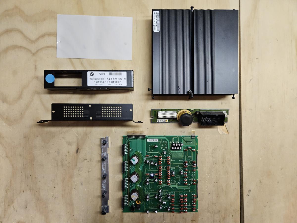

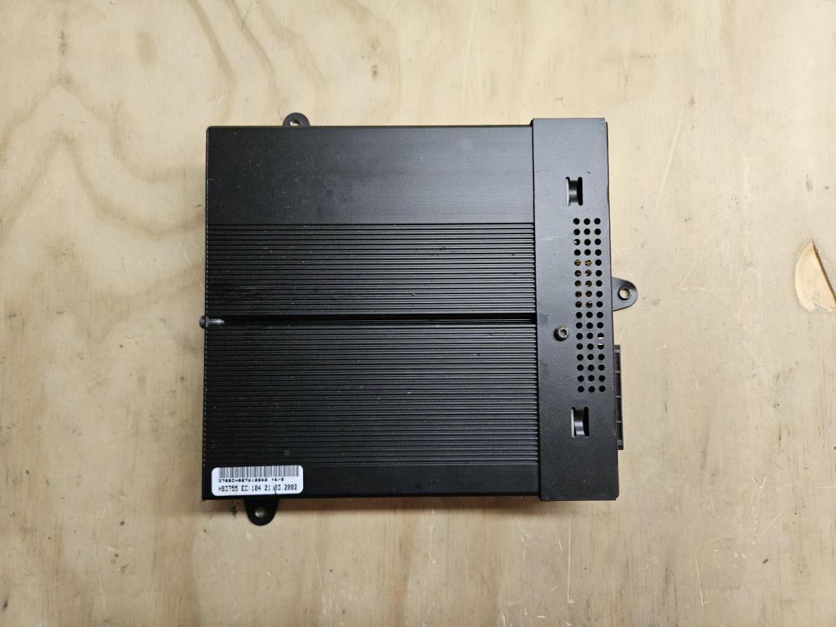

      Harman Kardon amp in the trunk was acting up. When I parked the car in the sun, the amp would overheat and no sound would come from the speakers. So, I took it apart to clean it and replace the thermal paste:
      Click image for larger version  Name:	20250511_143042.jpg Views:	0 Size:	106.2 KB ID:	304883
      Click image for larger version  Name:	20250511_144338.jpg Views:	0 Size:	127.1 KB ID:	304884
      That's what the unit looked like straight from the car. I was honestly very surprised at how clean it was. I was expecting it to be filled with dust, but nope.

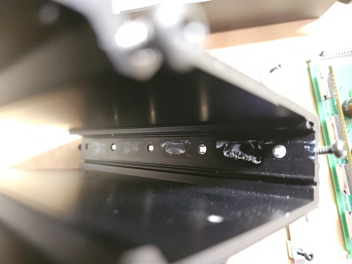

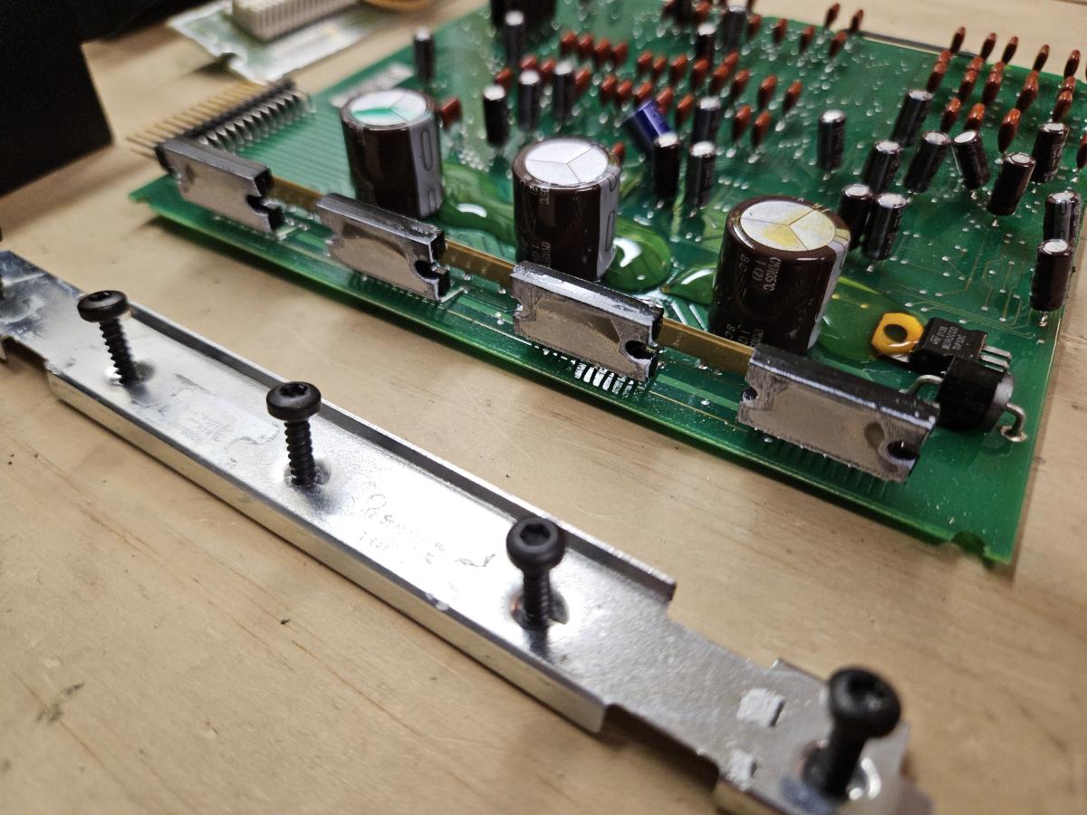

      23 year old thermal paste was definitely not doing its job anymore though:
      Click image for larger version  Name:	20250511_144604.jpg Views:	0 Size:	139.0 KB ID:	304885
      Click image for larger version  Name:	20250511_144618.jpg Views:	0 Size:	81.8 KB ID:	304886
      Cleaned the old stuff off, replaced with new and done. Hopefully this fixes my issue.

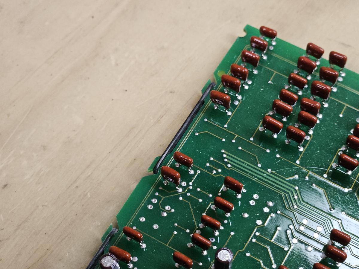

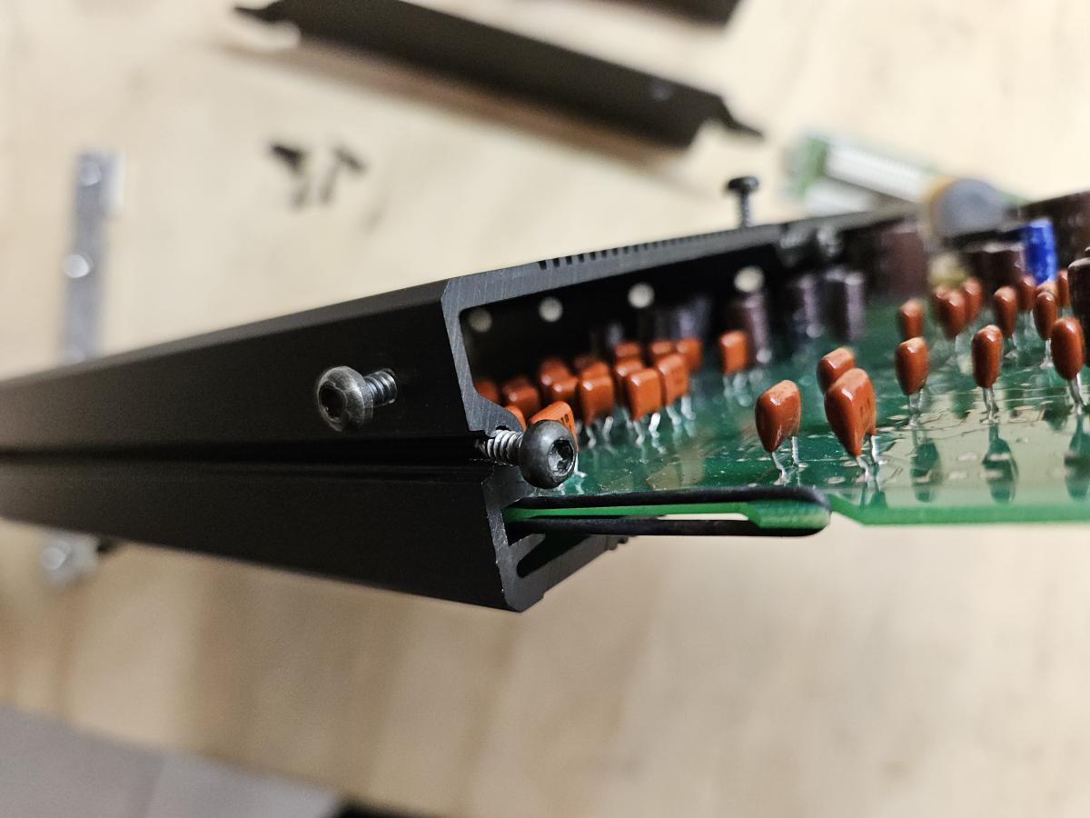

      Also, I have to say that I really like how this thing is designed. The housing is extruded aluminum, so the board slides in from either side. The long silver strip then clamps the amps to the housing and acts as more area for heat to dissipate. The part I thought was most clever is that the board isn't directly fastened to the housing. Instead, it's held in place by the front daughter board (with the harness connector), the heat sink clamp and these rubber bands that friction fit into the housing:

      Good stuff, gonna have to steal that rubber band idea for some future design of my own.
      The one downside of this design is that assembly is a bit fuzzy, as you can smear the thermal paste everywhere if you're not careful. But overall, thumbs up from me.
