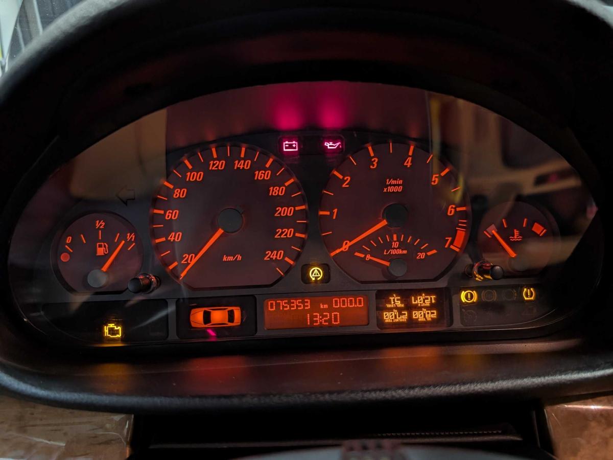

                      Someone did something very similar, just not OLED:
Name:	Screenshot 2026-07-10 at 11.23.46 AM.png
                      But something about it just looks... off. Not the upside down screen, just looks out of place to me for some reason.
                      There's also this: https://shop.sorek.uk/products/gauge-s-pod-52mm
                      But again, not stock looking enough.
