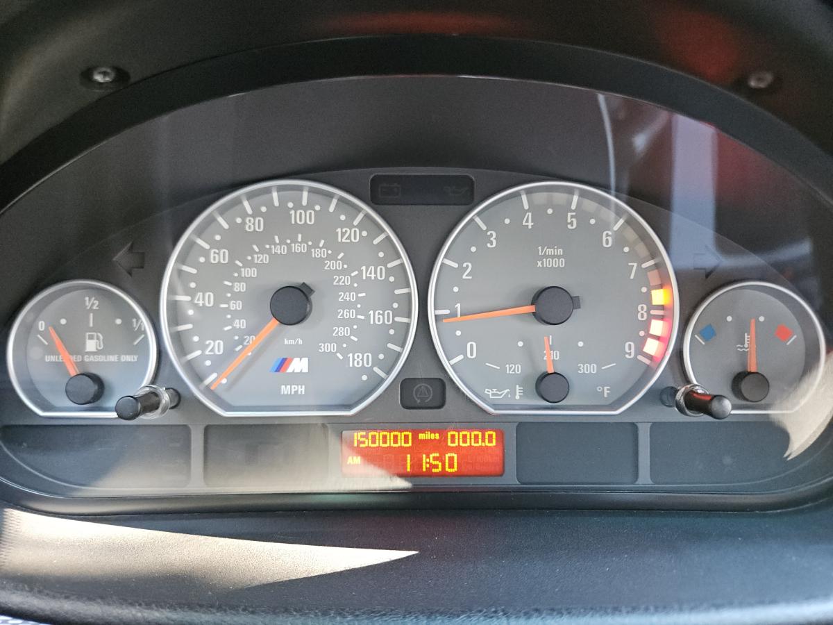

    And of course something had to break. Fortunately it was just the clock adjuster. Instead of doing the sensible thing and fixing the cluster, I decided to write a bit of code and have the car's time auto sync to GPS.
    I've configured Gauge.S to send the GPS time out as part of its D/I Bus relay packet. On (electrical) cold start, the BlueBus will wait until it sees a valid time (in reality waiting for the GPS to lock), then set it. Works great!
    Setting the timezone and DST is kinda clunky with the CD53, but it works just fine. If I'm bored one day, I might add latitude, longitude and date to the D/I Bus relay packet, then spend (probably an unnecessary amount of) time coming up with an algorithm that can efficiently do a lookup on a world timezone map and set everything automatically.
    Repos (1, 2) updated with the config and code.

      Slick!! I love it - that's a great QoL improvement!
        It really is! Feels nice to never have to worry about setting the clock again.
          ... but how will you reset the trip?

          This is repair fix for cracked button mechanism on cluster gauge for clock adjusting.Just cut small remaining pieces from cluster to fit this fix.Print laying flat with supports.Easy fix for free (i hate guys selling this on ebay for 40$...I made it in 10mins)
            Trip is push on the LH button, clock is turn on the RH button

              Ha. Damn it.
              Shows how often I use the trip :P

                Weirdly, only the "forward" adjustment broke. Turning the knob CCW and pushing it in still works. But yes, I need to actually fix this at some point, the auto time was just me being lazy. Writing some code on the couch was more appealing than taking the cluster apart at that moment for some reason.

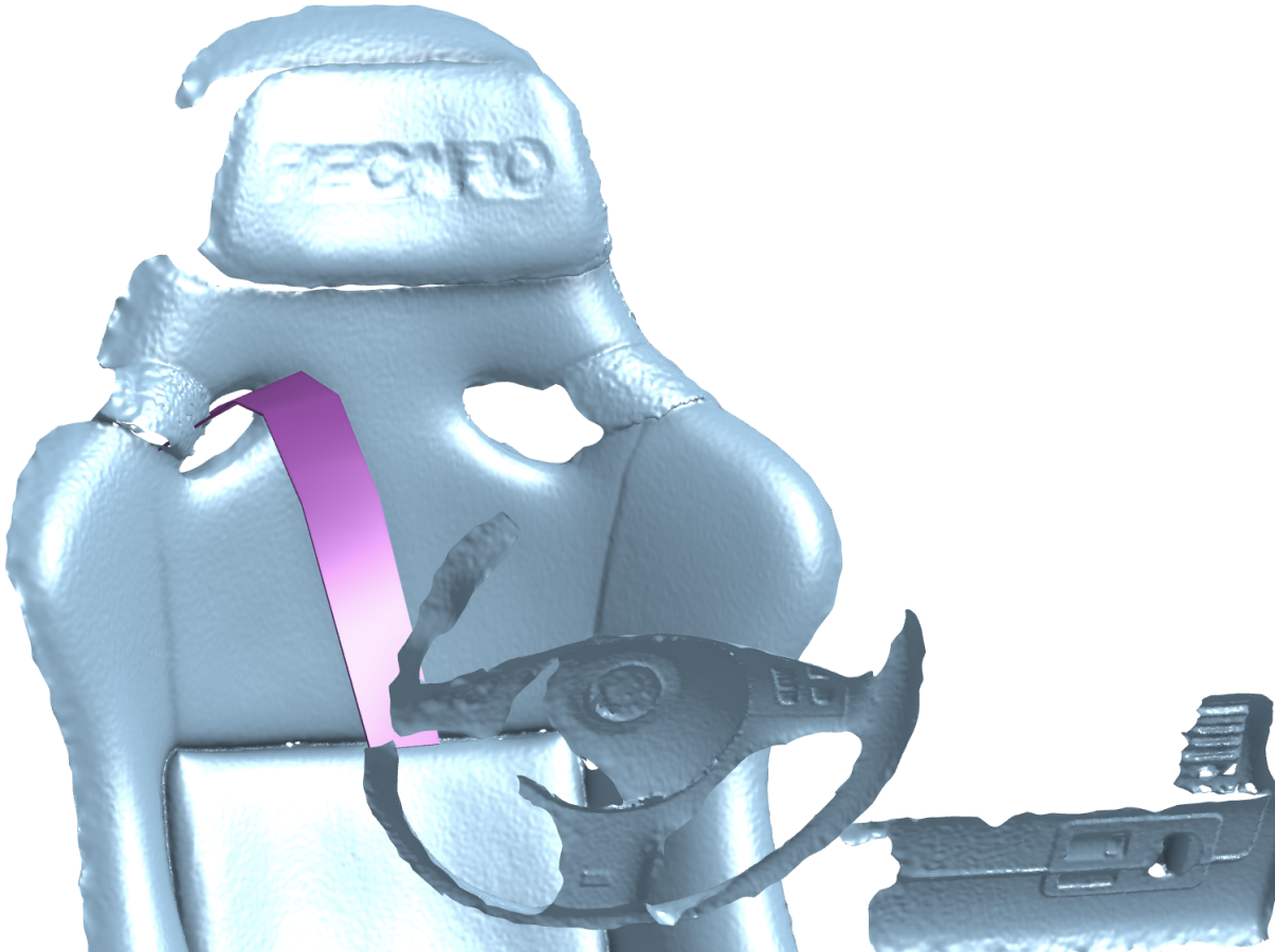

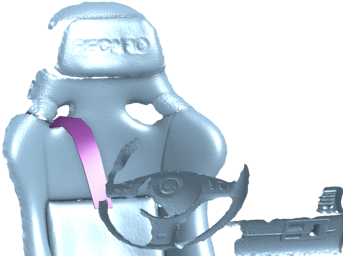

                                I've been driving the car around more these days and comfort has really begun to be a problem. Years of tweaking the seating position plus the custom seat cushions have made them bearable in most cases, but it's clear that the seats are designed for a different body shape.
                                So, I've decided to give the Pole Position ABEs another shot. Light, 3 point compatible, quick fit compatible and don't cost $15k like the 997 GT3 buckets do . The only sticking point is the height of the harness holes. I've sat in them before and know it's close, but wanted a way to quantify it before comitting.
                                zivagolee let me sit in his with my helmet and HANS on and we grabbed some scans. Yep, it's close:

                                It's technically fine, but I kinda hate how little margin there is.

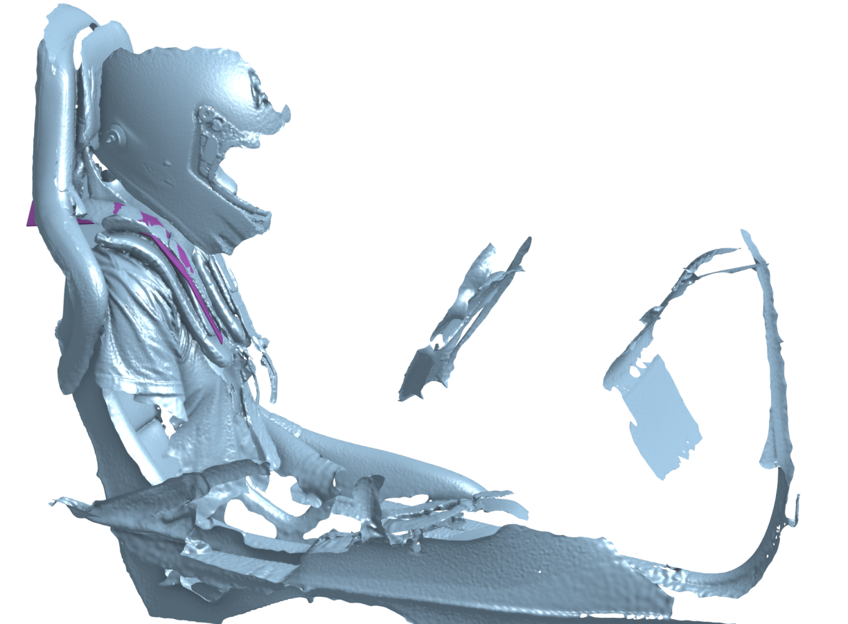

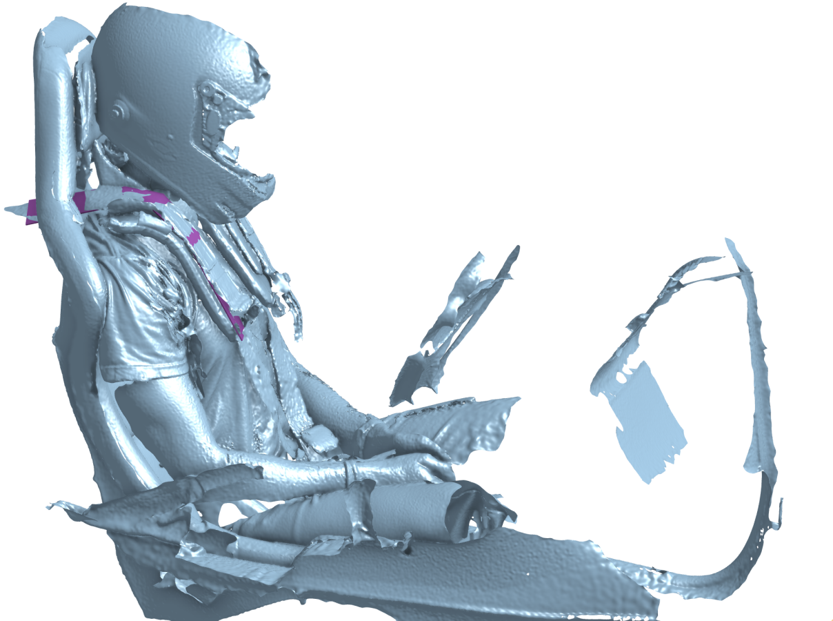

                                Howeeever, that scan has me sitting on ~50 mm of street-spec comfy cushions, so let's see what happens when I sit directly on the seat shell:

                                Ohhhh yeah, that's much more like it. Harnesses fully rest on the bottom of the harness holes without the seat cushions, which is exactly what I want to see.
                                My plan is to make myself a second set of thinner track cushions and swap them out when needed. I'll have to play around with thicknesses to balance comfort and harness height, but it should be totally fine. It's not like I'm doing endurance racing in this thing.

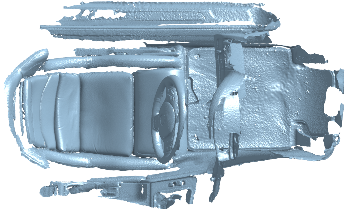

                                Since I had the scanner out, I went ahead and scanned my car with the Nogaros to use as a reference:

                                It's funny seeing from this angle just how far out of line the steering wheel is from the seat. Custom brackets should help with that!
                                I should be able to tuck the driver's seat closer to the transmission tunnel, to get some better alignment. I might even angle it slightly towards the center of the car to make it feel less offset. This will for sure restrict how far the seat can move forward, and thus, how easy it is to get into the back, but that should be alright. I can design the passenger seat bracket to prioritize a larger opening behind it when slid all the way forward, which will help a lot. I don't go back there too often these days, but it's nice to have easier access.
