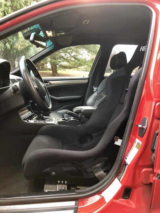

    Are you just going to run the stock seat belt buckle? I've got a buddy with ABEs and the buckle is laced through the side hole. Its fine once you get in, but it sure is annoying getting in and out.

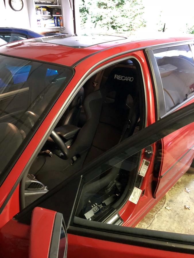

      Post the L-R offset you calculate/use here! I’ll have to measure what I did for the sportsters but I’ve got another 5mm room to go inward or so, and the devil on my shoulder has considered designing another seat frame to use it. Also remember that the farther inward it is, the tougher it is to get in/out of the car. Especially with a bucket, which can really strain your left knee. This is the reason I sold my Z3 coupe - knee pain from getting in/out of the bucket, and I only fit in it with a bucket.

              I should be able to tuck the driver's seat closer to the transmission tunnel, to get some better alignment. I might even angle it slightly towards the center of the car to make it feel less offset. This will for sure restrict how far the seat can move forward, and thus, how easy it is to get into the back, but that should be alright. I can design the passenger seat bracket to prioritize a larger opening behind it when slid all the way forward, which will help a lot. I don't go back there too often these days, but it's nice to have easier access.
                That's the plan! Is your buddy's receiver placed above or below that elastic divider in the side hole? Recaro advertise that divider as a safety feature that isolates the three point from a 4/5/6 harness and I think you're supposed to put the factory receiver on top, so that the elastic holds it out of the way when you get in/out. I have an email out to Recaro to confirm, but have not heard back yet.
                Regardless, custom brackets should help here too. I can play with the fore/aft offset of the seat to the factory sliders to get the receiver in the correct spot. Gonna try to emulate BMW's factory placement on the F82 M4 GTS.

                          I'd like to see an overhead shot taken through the sunroof of a CSL seat and compare how centered the seat is in relation to the steering wheel.
                            Just need a donor to scan! Beats a photo
                              I was going to say scan, but I don't know if karter has a 3D scanner and I did not want to give him another project
                              Maybe Kaiv still has his set?
                                He sold his, but if there’s anyone else in SD, you know I’m game to scan.
