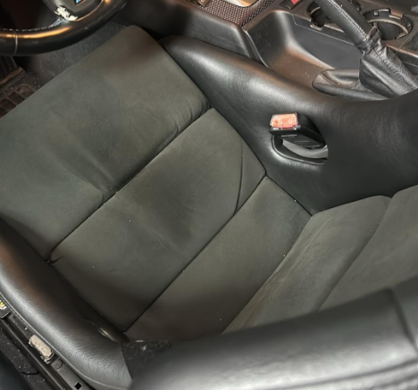

    Just need a donor to scan! Beats a photo
    I can do a photo through sunroof, or a iPhone scan but don’t have a proper scanner…
    Edit: also my car is RHD lol

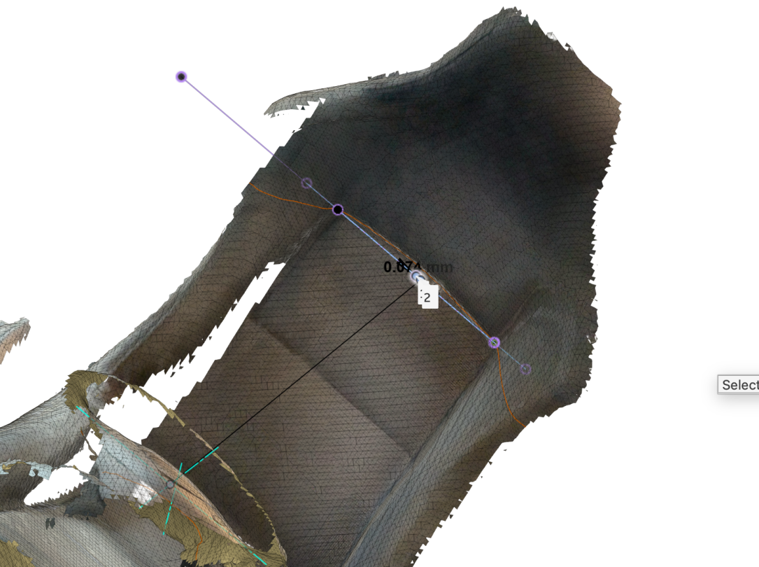

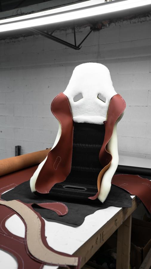

      Hmm, okay, well, looks like I'm gonna be poking myself in the lower back whenever I get into the car. I wonder if I can modify the seat cover so that it looks and works like the M4 GTS seat...
      Edit: I think the answer is no. Thought there would be more foam between the cover and seat shell:
      Click image for larger version  Name:	Screenshot_20260825_202324_Chrome.jpg Views:	3 Size:	84.9 KB ID:	365030

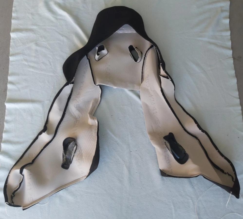

      Edit 2: Wait, there is! It's just on the shell side, not the cover side. I'll have to mess with the seats once I have them in hand:

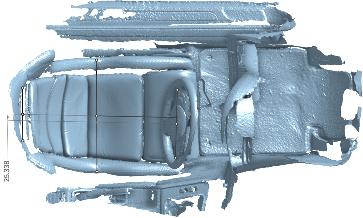

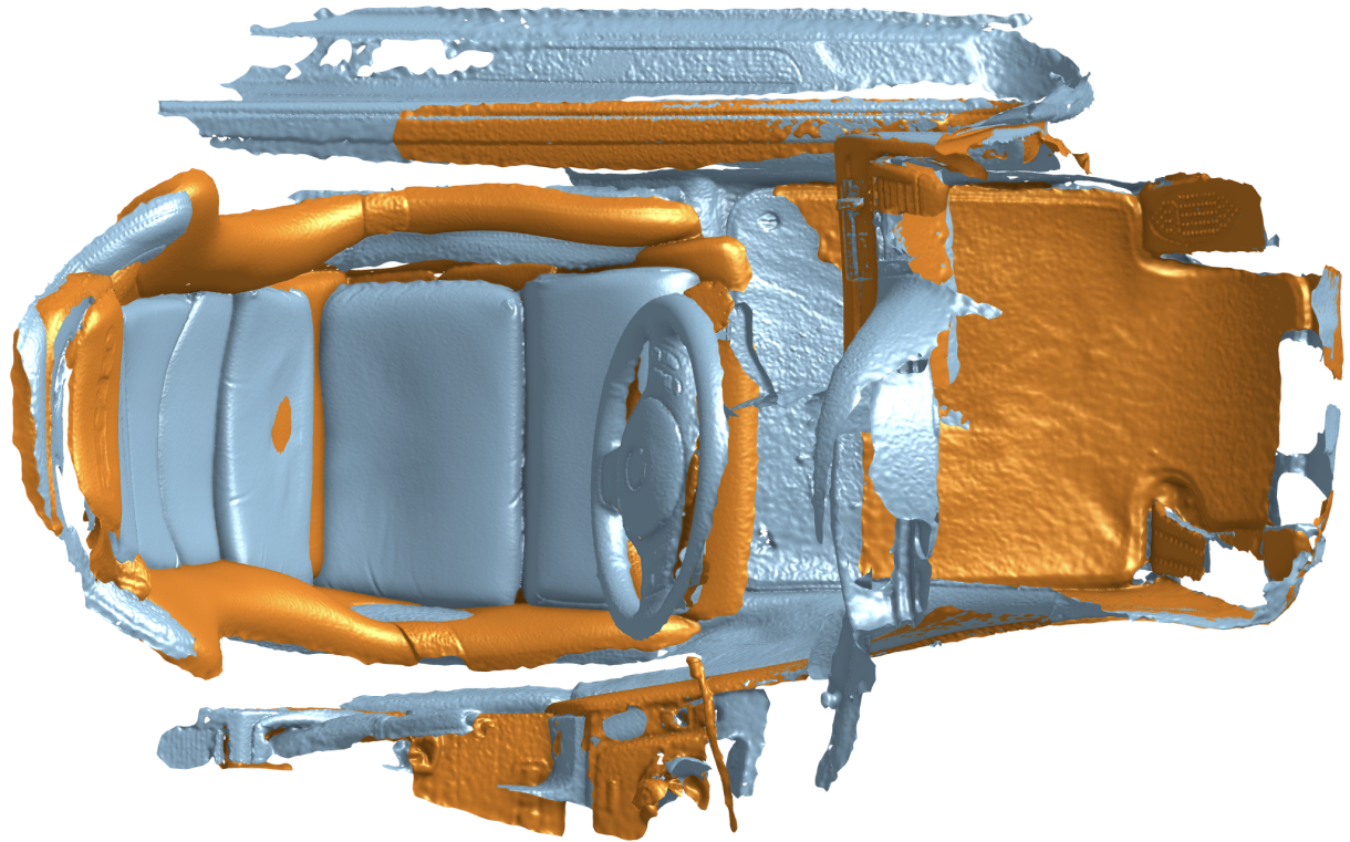

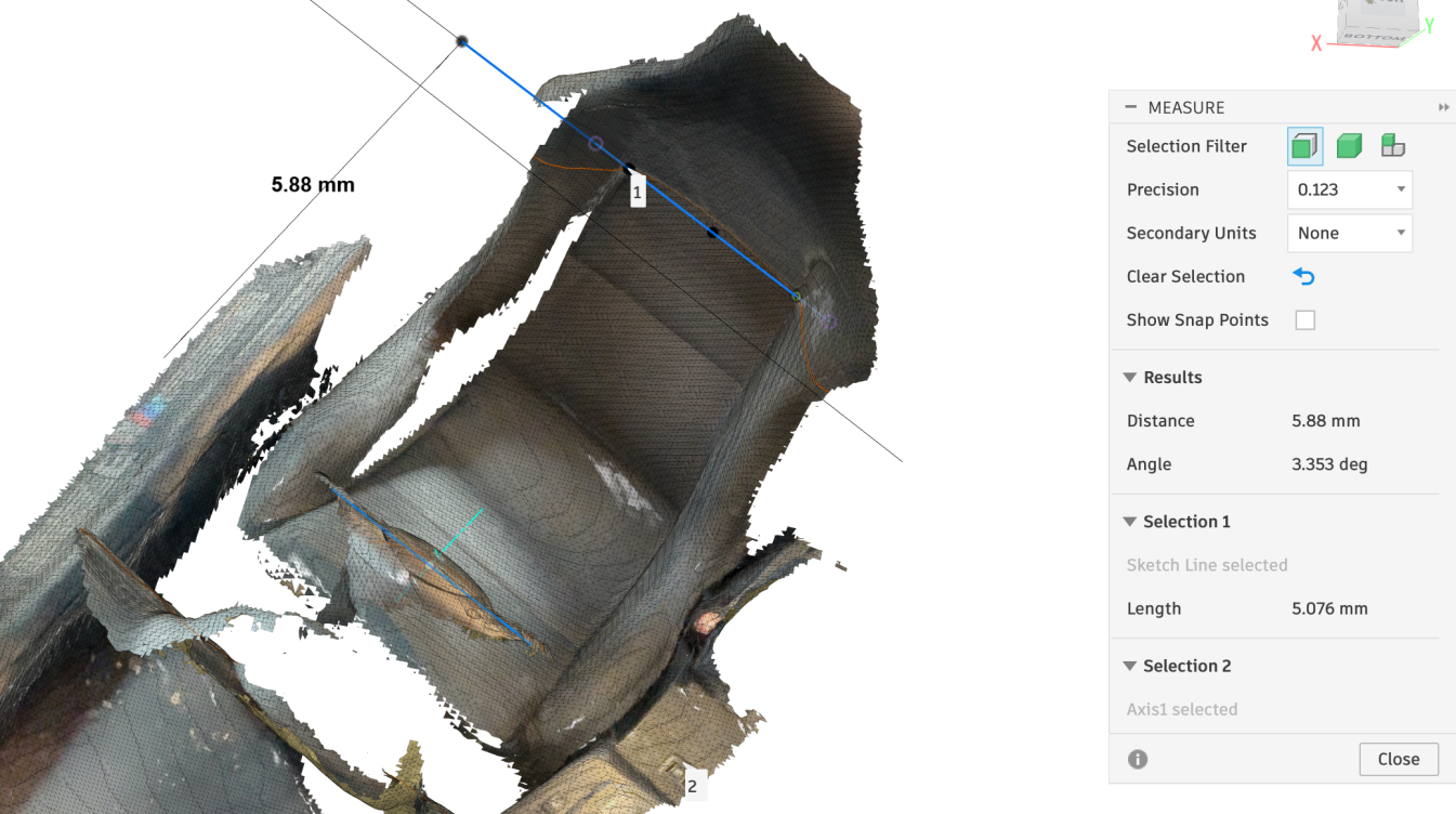

        Pretty rough and quick (units are somehow messed up, e.g. what shows as 5.88mm is actually 58.8cm). Appears that the angle between the seat and the steering wheel differs by approximately 3-4 degrees. You can also see in this scan how the seat is positioned as close to the transmission tunnel as possible, there's quite a gap on the door side.
        Click image for larger version  Name:	Screenshot 2026-08-26 at 6.21.04 PM.png Views:	0 Size:	868.7 KB ID:	365037
        And seems to be <1cm off between centre of wheel and centre of seat.
        Click image for larger version  Name:	Screenshot 2026-08-26 at 6.31.54 PM.png Views:	0 Size:	833.0 KB ID:	365038
        I'm sure a proper scanner would make this more accurate, but I don't think it's miles off - I got a decent enough capture to define decent reference points where it mattered.

          karter16 Is it easy enough to measure the static offset of the seat to the rails? Curious to hear that number as the CSL seat is sort of notoriously wide/loose, so comparing to the tunnel is tough. I'm at 26mm offset toward center with my latest brackets and could probably get to ~31 without the pedals feeling weird.
              Yep just measured - seat is offset ~30mm (allowing for a few mm of tolerance for manual measuring) towards the centre.
              Edit: did not divide by 2

                            Nice, thank you! For reference, the Nogaro Brey Krause combo puts the seat ~25mm off center from the steering wheel (in my seating position). I think the PP ABE is wider (outer dimension) than the CSL seats, so we'll see how close I can get them. I think I can do better than 25mm though.

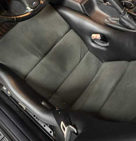

                                I don't know if you considered these, but I have them on my car with the PP ABE and I've been really happy with them. I used OEM manual sedan sliders.
