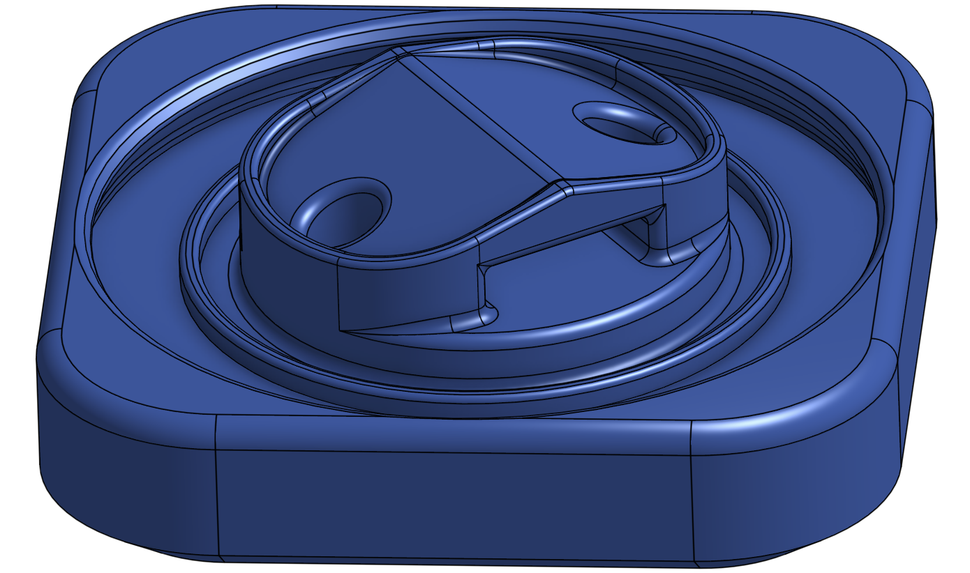

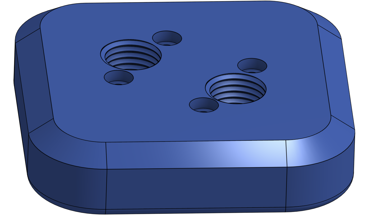

              Sooo this is printing now:

              I plan on transferring both the seal and the metal retainer over from the cheapo cap.
              I also plan on printing it in the orientation shown in the first pic, so that the perimeters of the NPT threads are one continuous extrusion and the part doesn't split as soon as I screw something into them. Unfortunately, this means that if the part sees a failure along the layer lines, there's a chance that the metal retainer (and some plastic debris) will drop down into the engine.

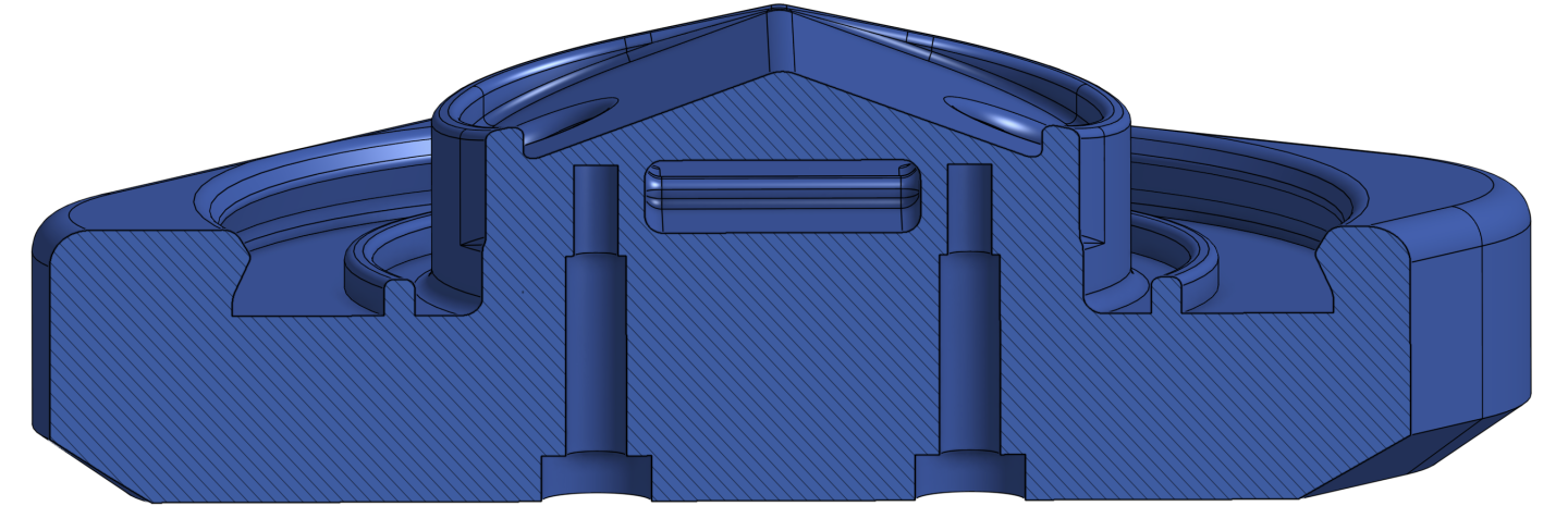

              Scenario above is probably unlikely, but it makes me paranoid, so I added features for four M3 screws to reinforce the part. Easier to see in a cross section:
