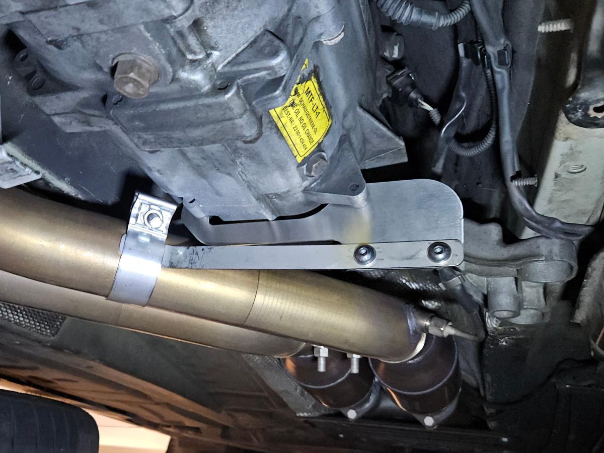

            Couple of updates.
            First up, the transmission exhaust brace is great. Greatly dampens the tinny, high frequency vibrations at about 2.5-2.7k rpm. They're not eliminated, but rather the brace seems to shift their frequency down quite a bit. It's no longer a rattly metallic noise and is now more reminiscent of the typical low frequency engine NVH present in most ICE cars.

              Couple of updates.
              Holy crap, I've got this same noise and couldn't figure out where it was coming from, lol. This has to be it.
                  I forget, are you on stock headers/section 1? It's nowhere nearly as pronounced with those as it is with the supersprint stuff, but the transmission brace should still make a difference. Wonder why BMW included it on the non-Ms but not on the M3...
                    Stock headers and RE Rasp and the noise is most pronounced in the RPM range you quoted, plus its a hard noise to describe but high frequency vibrations pretty much sums it up.
                      I really thought it was the nature of the M3. I need to try this now for sure.
                        Sooooo where can we get the CAD files for that exhaust brace?

                          Here ya go! Attached. You’ll just need a relevant exhaust clamp for your pipes and some fasteners.
                          edit: the brace parts on my car and Heinz’s car are made from 304 SS - spacer is .125” and the two brace parts are .074” thick.

                            Got a McMaster link for the hardware/clamp? We could make this an easy to order kit, between sendcutsend and McMaster.
                              Not off hand but I believe I used M8 x 16 or 20mm cap head screws, washer and nuts. You’ll need 4 fasteners, 2 nuts, 2 or 4 washers to suit. For the bigger SSv1 pipes, this is the clamp we’ve been using: EVIL ENERGY 2.5 Inch Exhaust... https://www.amazon.com/dp/B08HW8ZF4Z...p_mob_ap_share

                                the rectangular bracket seems to be missing the bend line-- got a location/bend angle for that?
