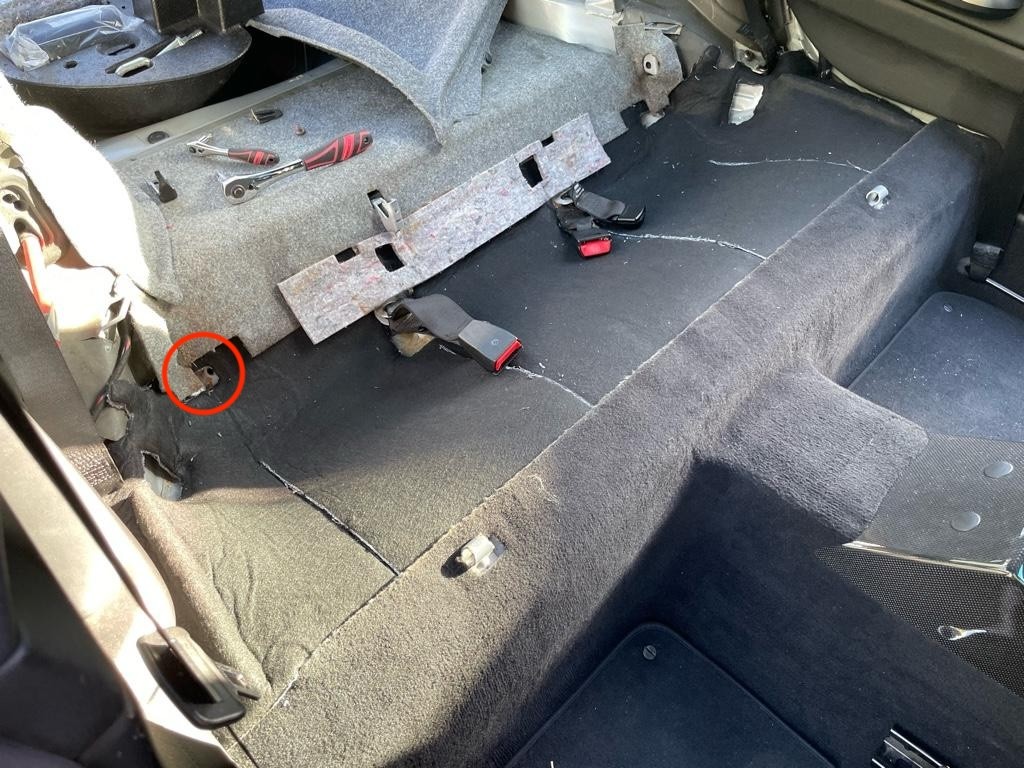

    I had to trim it a little, to make it fit.
    A friend texted me this picture last night, of his install. Everybody’s doing it.

        I'm going to have to go double check mine now - I don't recall having to trim mine, but I'd be surprised if my car is somehow different to you guys.

          I haven't taken the car on the highway yet, but I hope this helps quiet down the little bit of remaining diff noise.
          Oh look at that! Yours doesn't fit well either:

          No big deal, this thing is super easy to trim.

            Curiously, the cutouts for the isofix brackets did not line up and I had to extend them a bit. This part seems to fit well on Obioban and karter16's cars. Maybe it's an early production thing?
            The other thing I had to trim was the flange the extends into the trunk, but only because I have the Slon wall in the way. Looks like it would have fit just fine without that.
            Also, pleasantly surprised that the extra cutouts on the side line up perfectly with the anchor points for my harnesses. Very nice.
            That part is for a Compact, which has a whole different rear bench area, I am surprised that it fits reasonably well tbh.
              Interesting. Parts diagram says 51488252759 fits the M3. Maybe they consolidated the two parts at one point into something that (mostly) fits both the coupe and the compact?
                It‘s a mistake in the catalog I think, but regardless, who knows.
                BMW has 6 left so if anyone wants one, be quick.
                Fwiw I think 51488204055 is the correct part, listed for Sedan/Touring but looks a lot more like what the coupes came with from factory.
