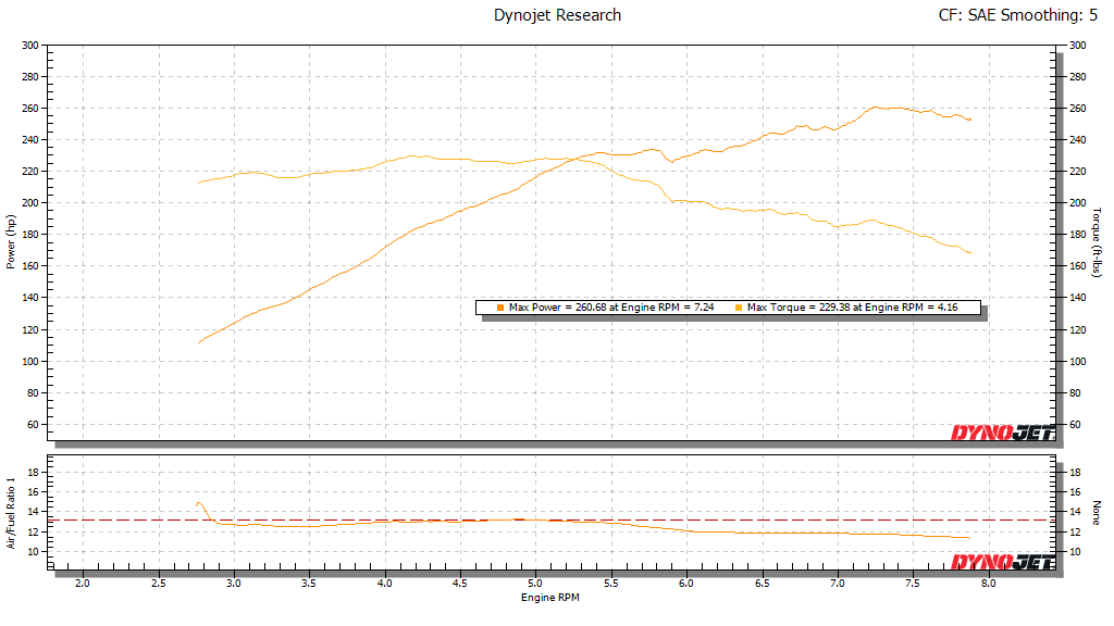

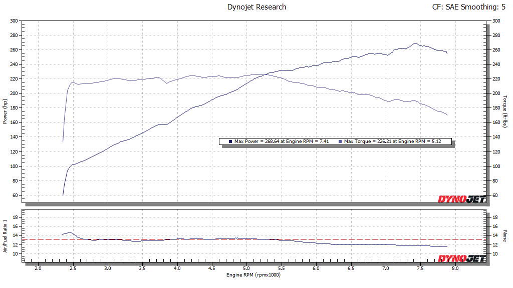

        My car is completely stock right now, so took it in for a baseline dyno run.
        Here's the setup:
        • 126270 mi
        • 100% stock US spec pre-facelift M3
        • Converted MSS54 running stock 2501 HP software
        • All engine maintenance done
          • Rod bearings replaced ~13k mi ago
          • VANOS done ~13k mi ago, passes VANOS test with no issues
          • Engine retimed ~2k mi ago
          • Valve adjustment done ~2k mi ago
        • No mechanical fan, just aux
        • Dynoed at Sonoma racetrack so altitude is ~sea level
        • 70ºF ambient temp
        • Dyno said 50% humidity, weather app said 90%, so unfortunately no clear answer for that
        • All O2s are original, got new ones in a box ready to go in when my V1s arrive, but potentially left some power on the table because of this
        • Running Shell V-Power 91 octane
        Click image for larger version  Name:	All Runs.png Views:	0 Size:	59.7 KB ID:	118162
        269 max WHP, 230 max WTQ

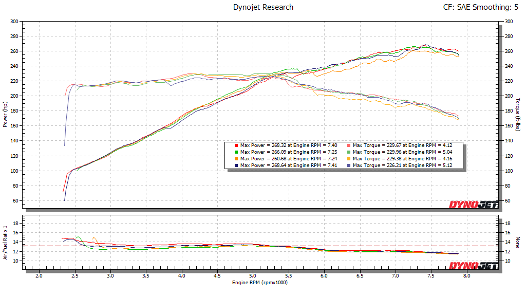

        First three runs were done back to back with one fan flowing air into the radiator. Fourth run was done after letting the car cool down for ~5 min and pointing another fan at the driver's side fog light area. I've attached all the individual runs to this post in case anyone wants to take a look at them.
        Results were pretty much exactly what I was expecting. I think I told the dyno operator I was expecting to see 270 WHP. I'll be back when I get my CSL airbox back on and then back again when the V1s go on to get a full dyno tune.

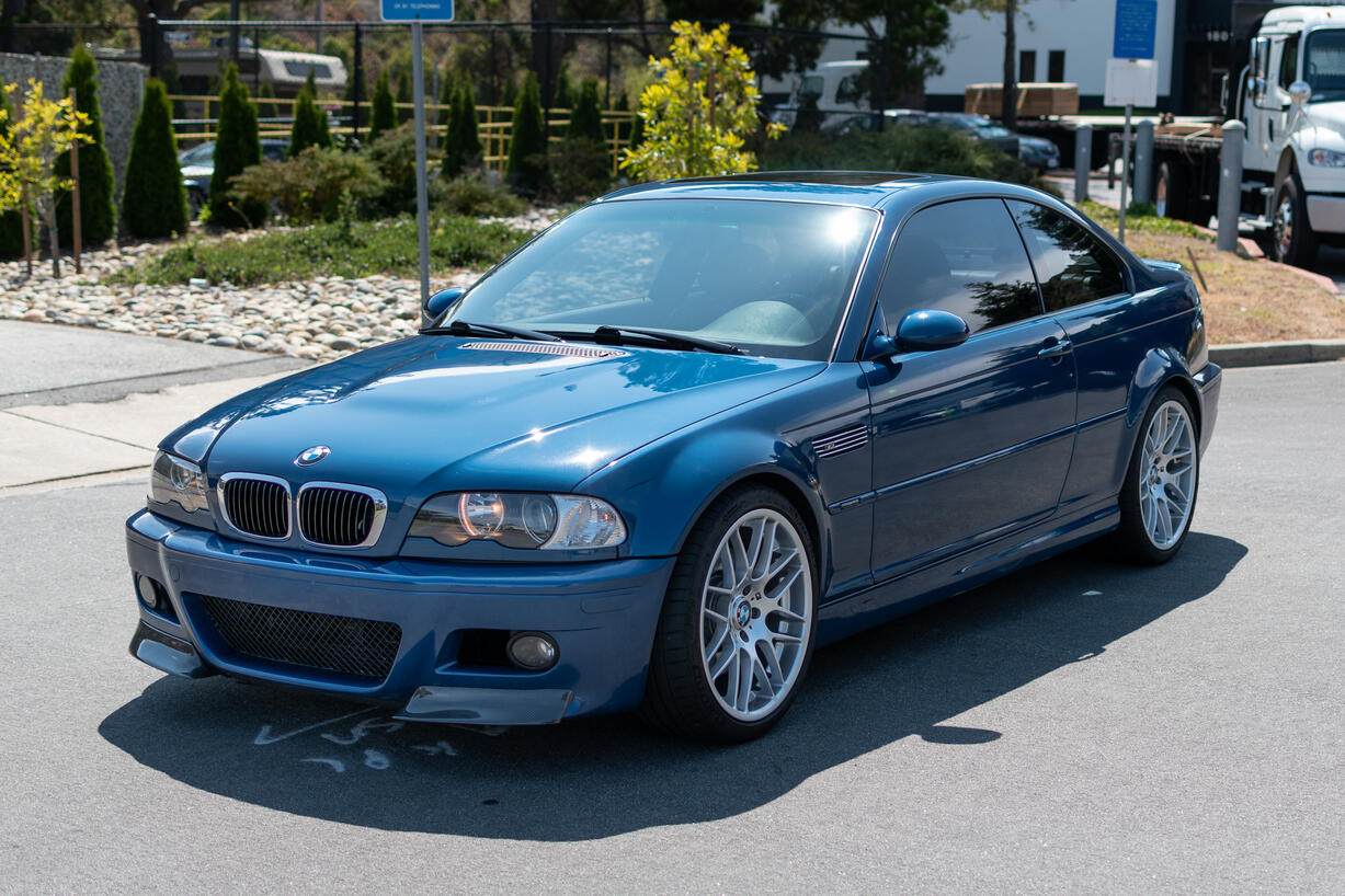

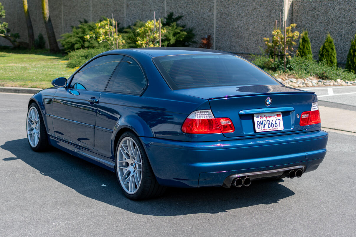

          I also took some pictures of the car right after the paint correction. The paint looks awesome in the sun now.

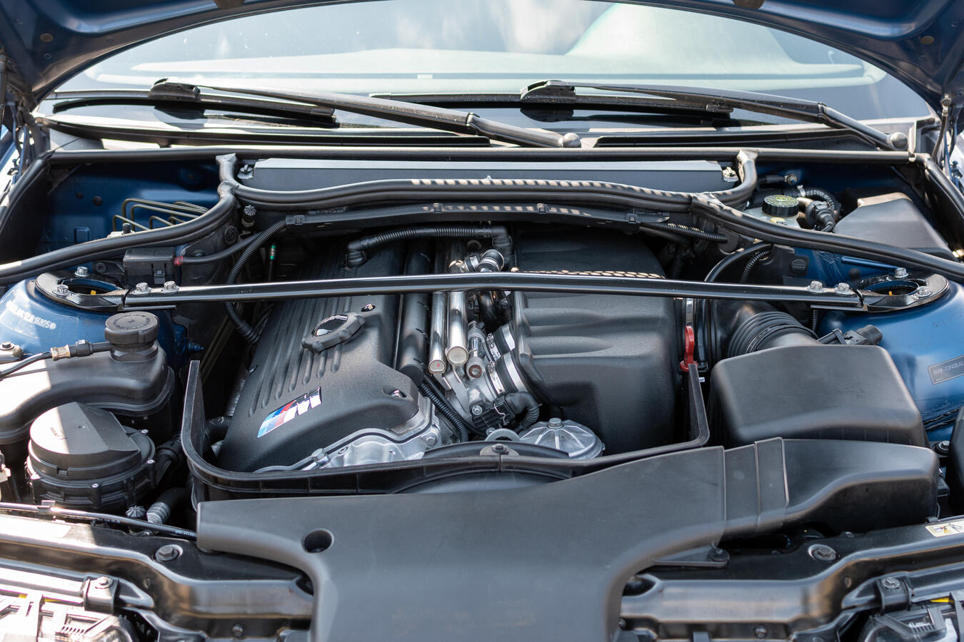

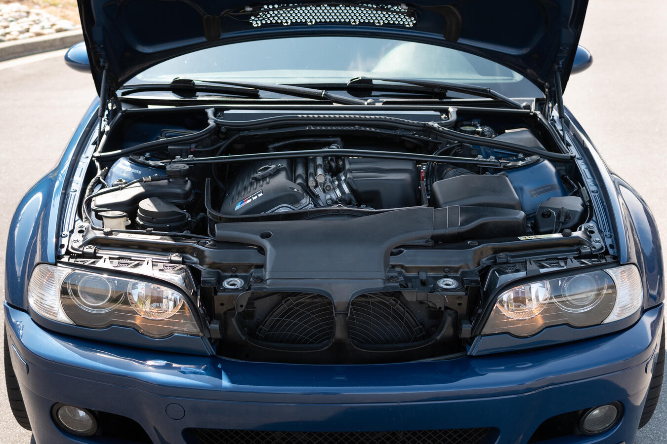

          Honestly, even without the airbox, the engine bay in these cars looks amazing.

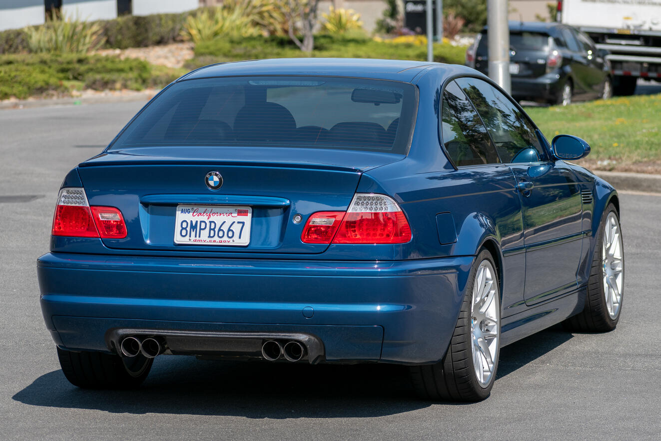

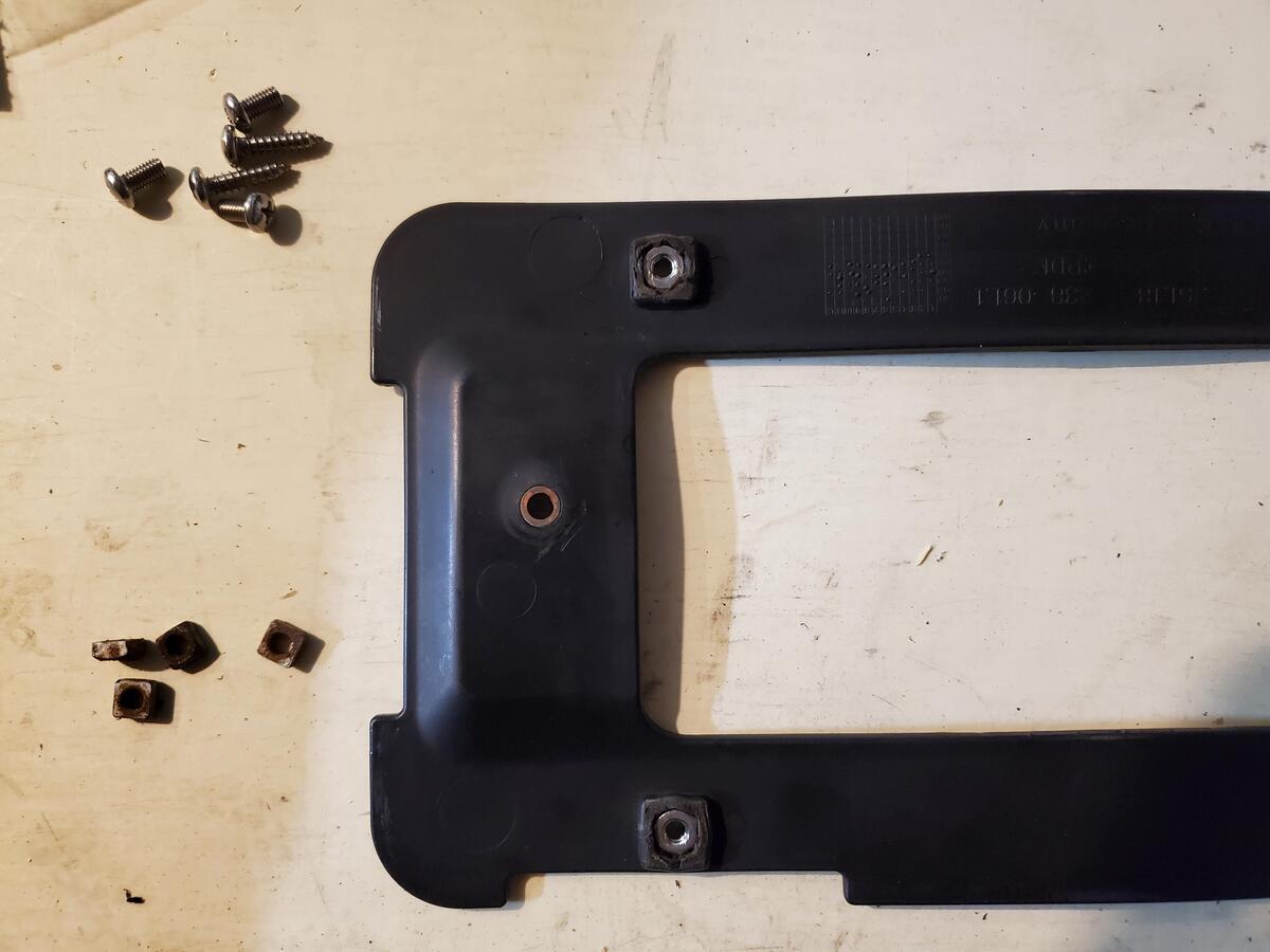

                      One other thing I did after the paint correction was to replace the hardware in the license plate bracket. The heads of the screws holding the bracket to the trunk were a little bit rusty and the square nuts pressed into the bracket were a lot bit rusty. I had to hold the square nuts with vice grips (through the plastic) to get the plate off when I removed it.
                      Definitely not paying BMW $40 for a new one, so instead I just bought matching hardware at the hardware store. Bought new screws to attach it to the trunk, hex nuts to press into the bracket and some new license plate screws that look identical to the BMW ones. The hex nuts I bought have a slightly bigger footprint than the stock square nuts, so they're not going anywhere after being pressed in.
                      New hardware at the top left and in the bracket, old square nuts are in the bottom left. You can see the bracket sustained some damage when I was battling against the old square nuts, but it doesn't affect the fit of the new nuts, so not a big deal.
                      I also cleaned up the metal inserts for the screws and added some foam behind the nuts, so that they wouldn't scratch the paint.
