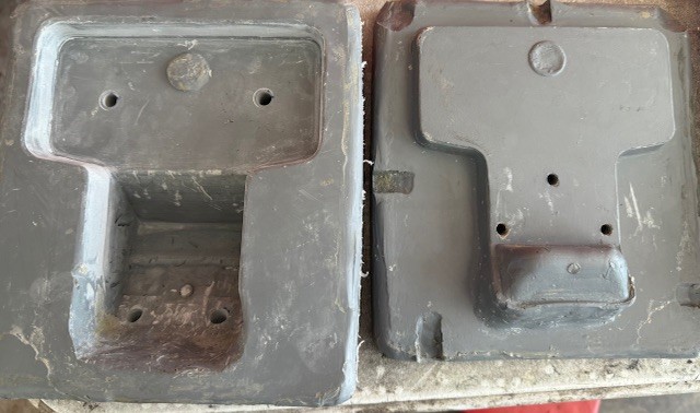

    V2 of the mold. Lots of learning from V1 and this one came out much better. Still had to tear up the 3D printed part. Need to figure out how to eject parts from the cavity. The threaded inserts are in stock and enroute to me to make the CF part.

                    Did something I should have done when I finished printing and assembling my modified firewall plug. I weighed it.
                    Stock: 1618 g
                    Mine: 436 g
                    Came in a little higher than my estimates. Guess the extra walls from the splits, adhesive, gaskets, magnets, etc. all do add up.
                    Still saving 2.6 lbs over the stock part with no downsides, so not complaining!
                      For such a substantial reduction, this is more a result of the material more than anything, right?

                        I suspect most of the weight loss comes from the manufacturing method. It's essentially hollow on the inside, whereas the stock one is solid.
                        Edit: Actually, we can work this out. Let's see.
                        CAD says the part has a volume of 702.913 cm3 and we know stock weighs 1618 g (ish, I think I took everything off of it, but I can't remember). That gives us a density of ~2.30 g/cm3 for the UP-GF material used in the stock part.
                        The datasheet for the PET-CF I printed mine out of says it's got a density of 1.29 g/cm3. Had I printed it fully solid, it would have weighed 907 g. The last 500 g or so (the geometry is slightly different for mine and it has all the extra gaskets and hardware, so not apples to apples) of savings come from the hollow interior.
