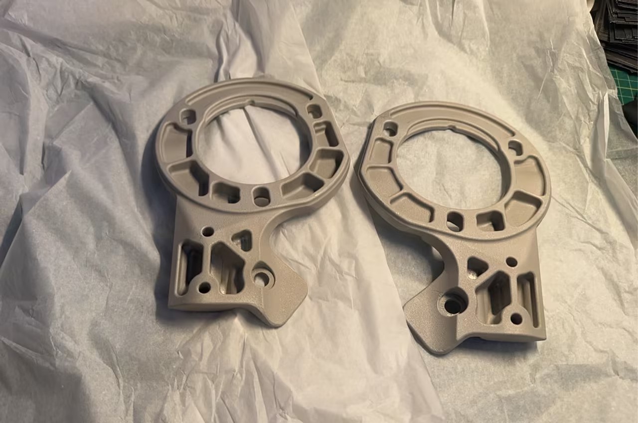

                              Update from the manufacturer:
                              So cool.
                              Now just have to wait for them to get to me. I'm excited!
                                Man, we're really living in the future.
