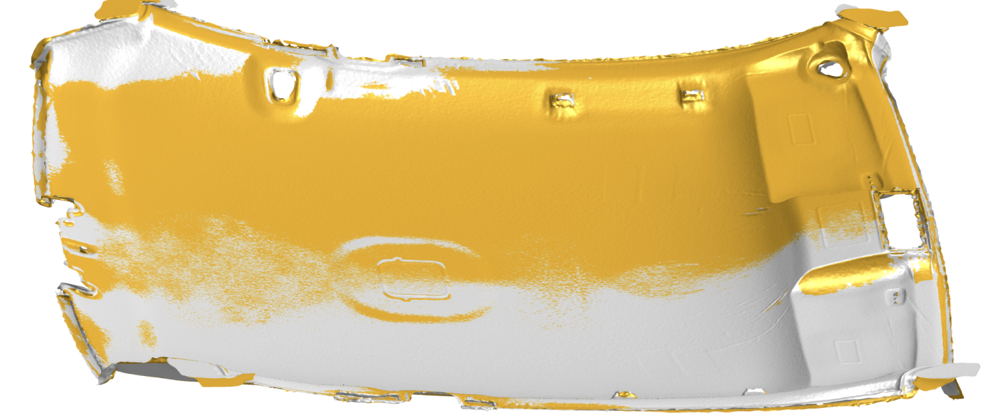

                  Also, have started working on the CAD model and wow, it's been a struggle.
                  For the previous scan, I hung the part vertically from the ceiling, thinking that that would allow it to keep its shape. Unfortunately, mirroring the part along its short axis in the digital world made it very apparent that this assumption was incorrect.
                  I messed around with it for a while, thinking that I had my coordinate axes slightly tweaked, but eventually came to the conclusion that the part was deformed when I scanned it. This is as good as I could get it:
Name:	Screenshot 2026-05-06 at 8.53.02 PM.png
                  That gap is roughly 20 mm across. Nowhere near acceptable.

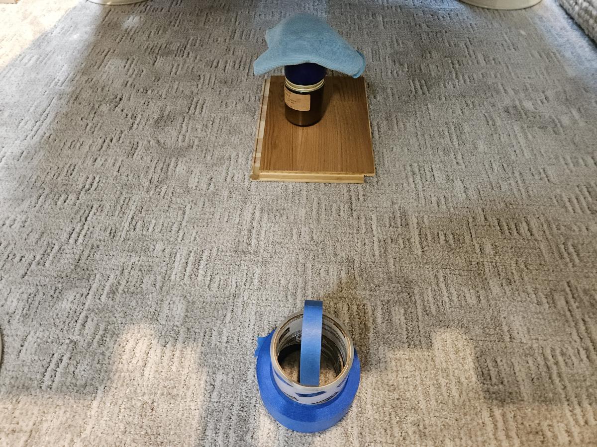

                  So, I gave up on that scan and redid it. This time, I built a professional fixture so that the part could lay horizontally on the ground without distorting:
                  For anyone following along at home, you'll need exactly these parts for max precision:
                  • 4x Dinner plates
                  • 1x Flooring sample
                  • 2x Varied candles
                  • 1x Folded over MF towel
                  • 3x Assorted rolls of tape​

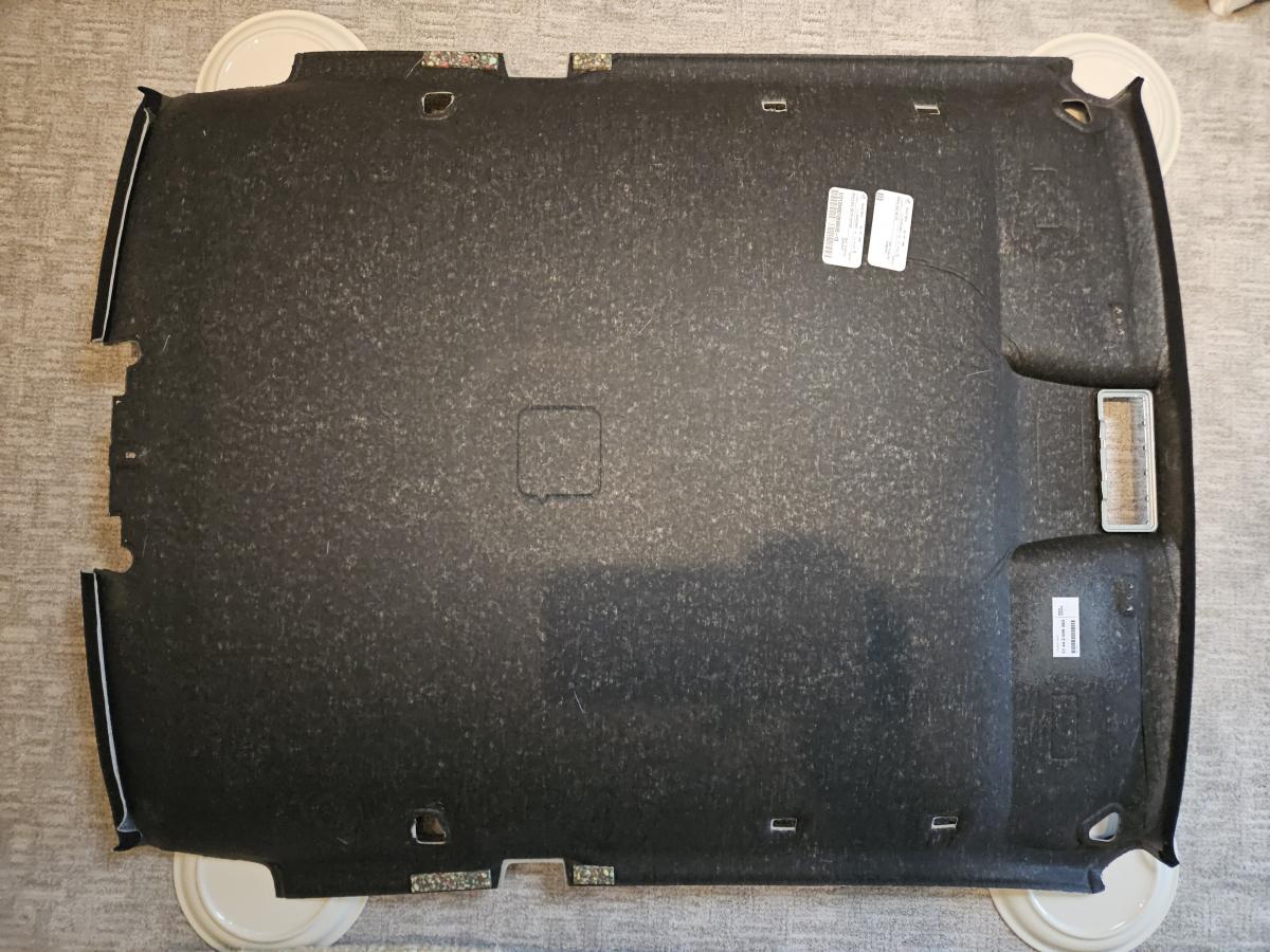

                  I set everything up so that the headliner was juust barely resting on the plates. They're not there to provide any support, but rather to provide flat references for plane alignment in CAD.

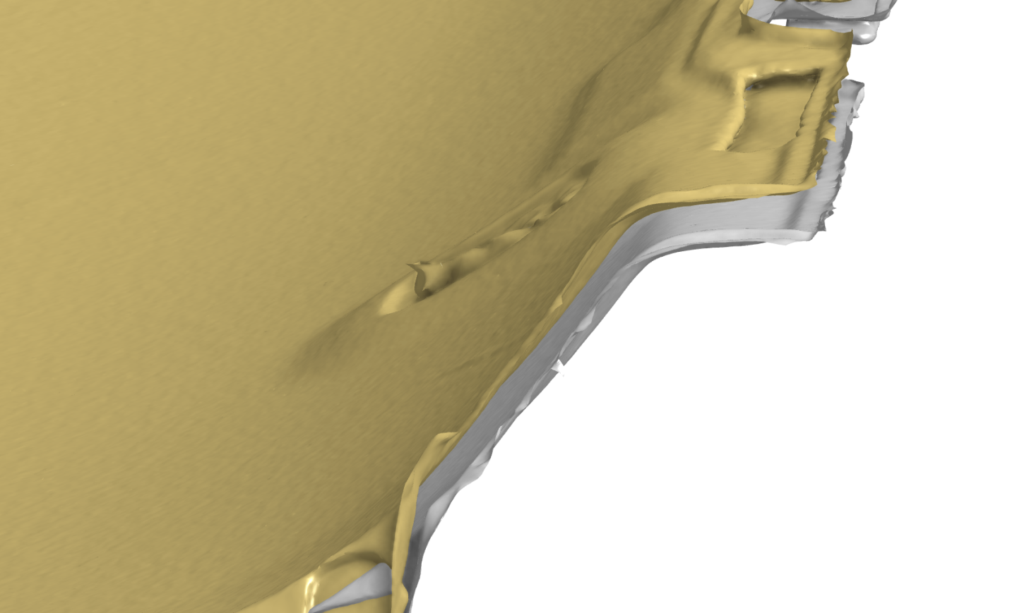

                  Newest scan is muuuch better (have updated the previous link):
Name:	Screenshot 2026-05-07 at 12.24.40 AM.png
                  Gray is the scan and yellow is the mirror. Not entirely perfect, but I didn't expect it to be. Can absolutely work with though.
                  Now it's just a matter of getting lost in surface land and coming out the other side with a model.
