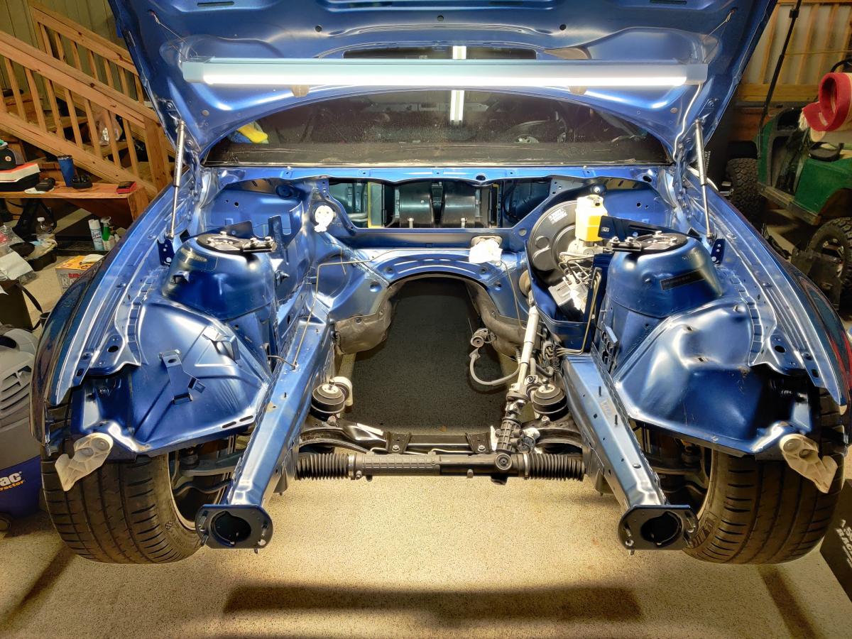

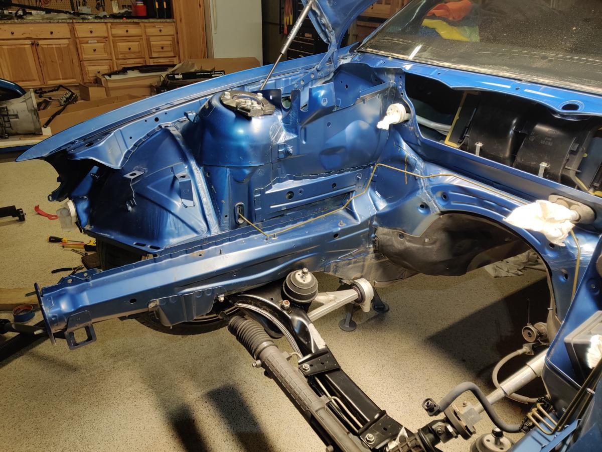

      Front radiator support finally removed.

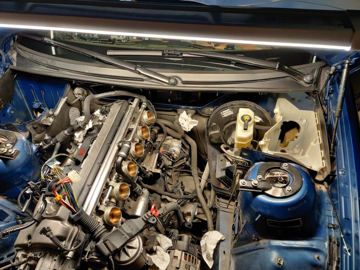

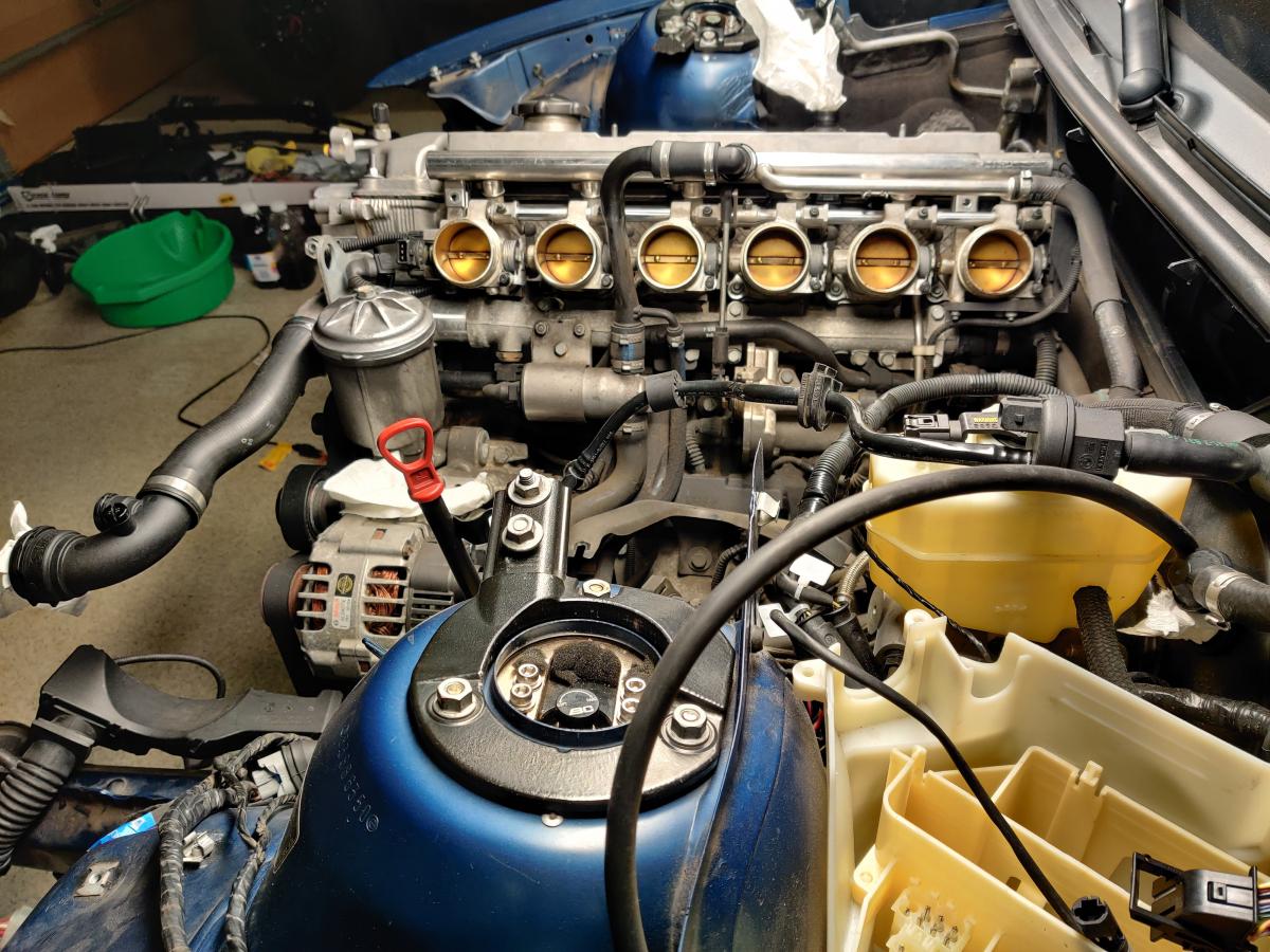

      Intake removed, ITBs are cleaner than I expected.

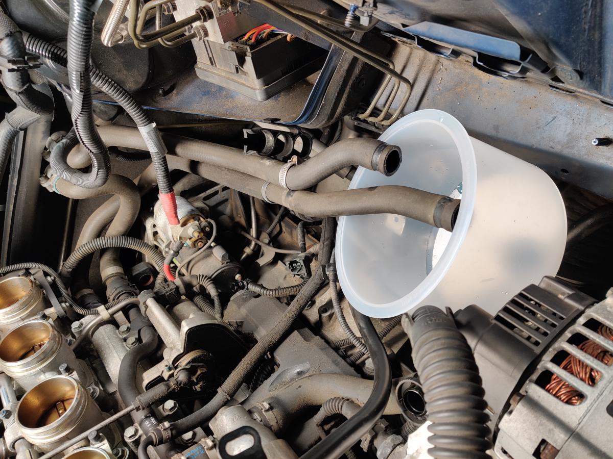

      Disconnected aux water pump and drained as much of the heater core and coolant passages at the top of the motor as I could. I hate messes and do everything I can to avoid having to clean them up.

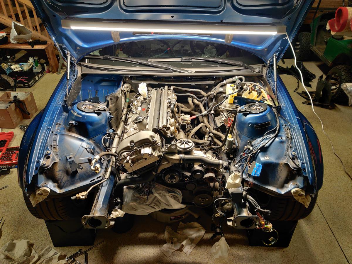

      Brains box wiring removed. You can also see in the upper left where a mouse got after my insulation/sound deadening in fierce way.

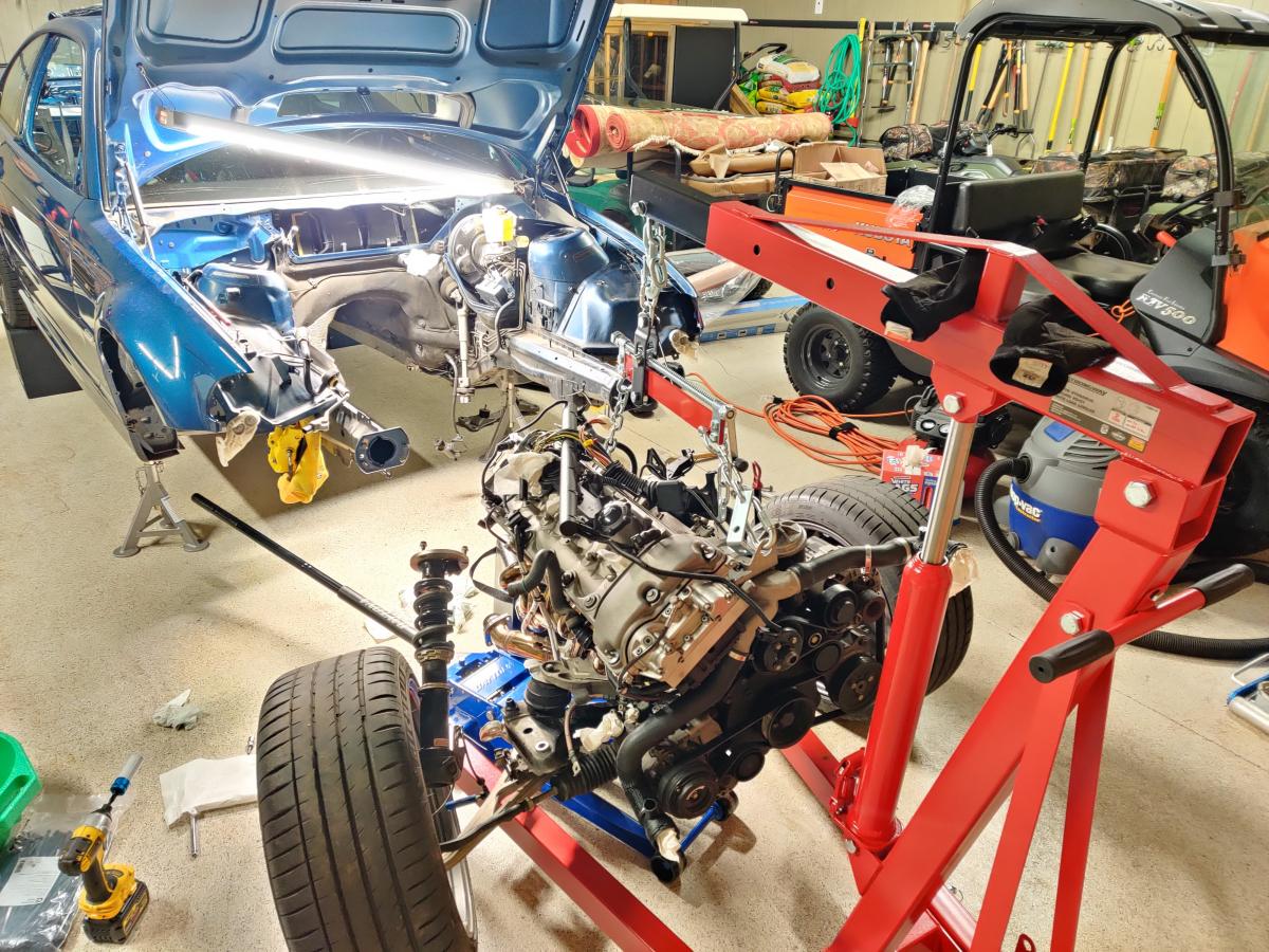

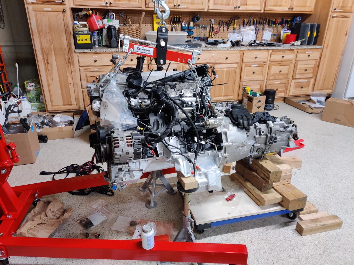

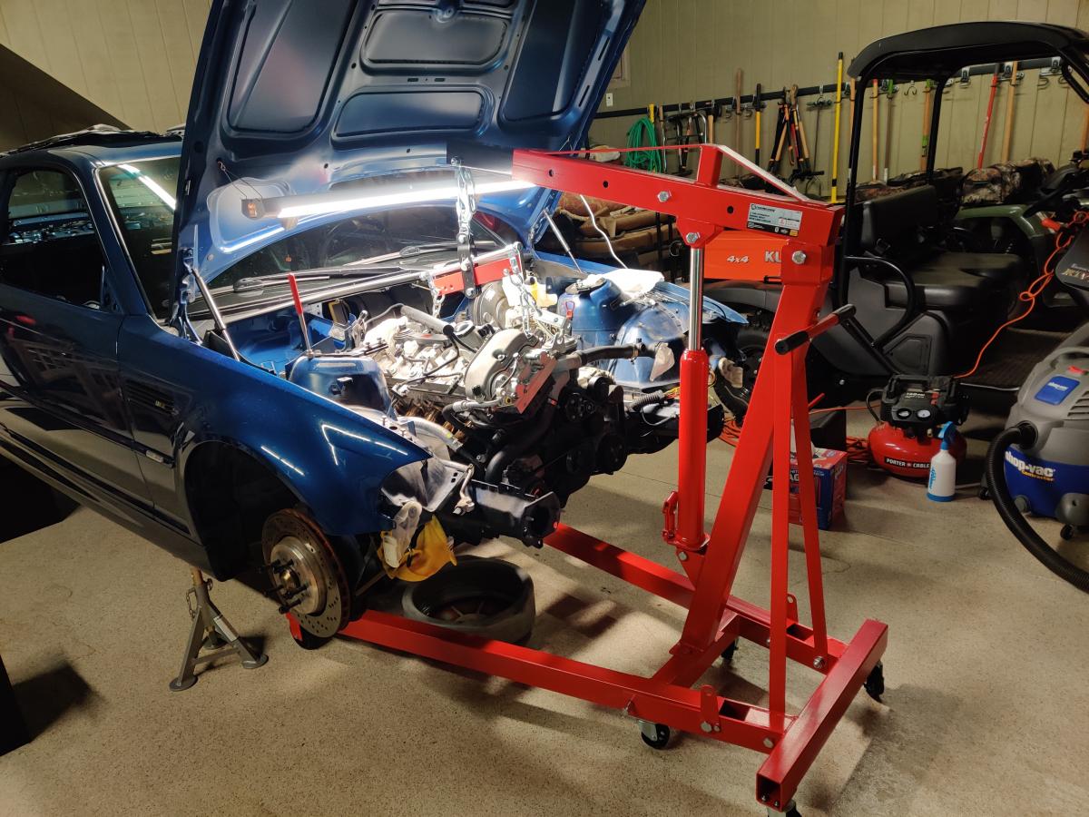

      Engine removal

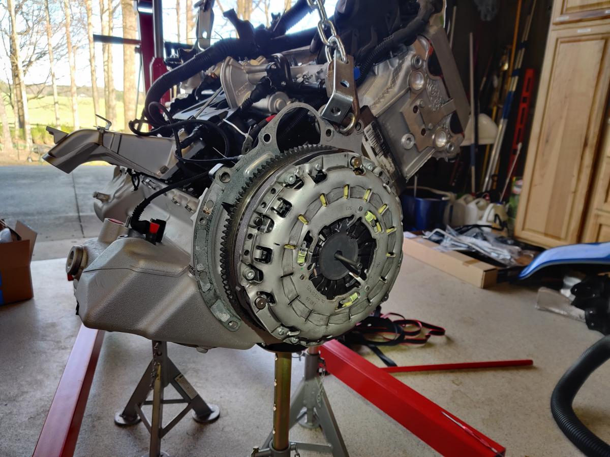

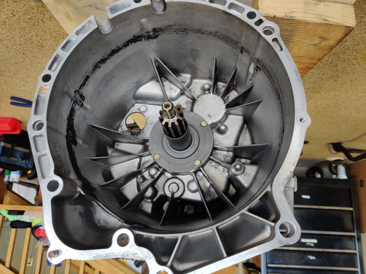

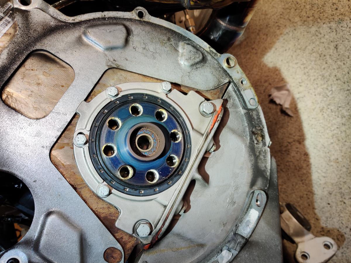

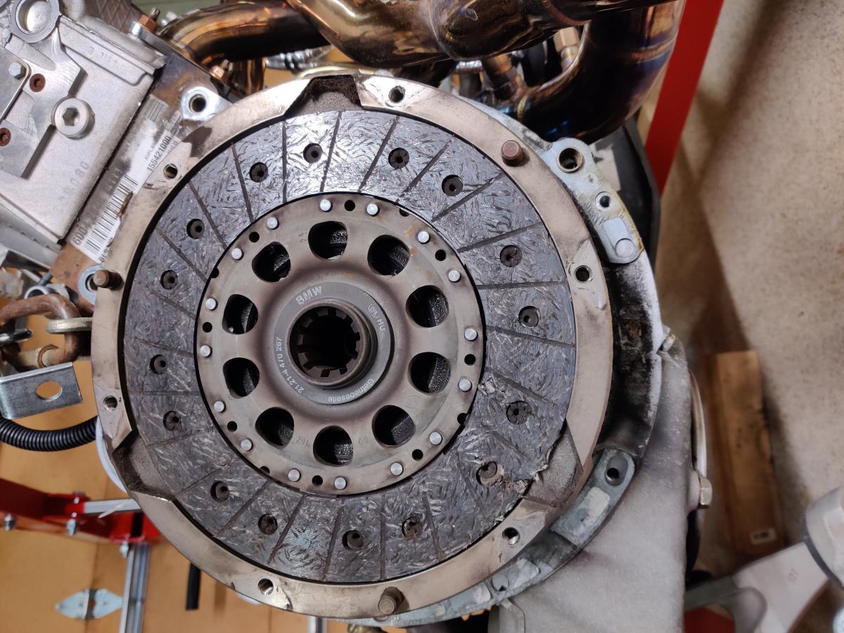

      Clutch removal. You can see a chunk of friction material missing in the lower right and the irregular wear pattern across the face of the entire thing. Apparently this is a symptom of a bum dual mass flywheel. I’m still weighing the pros and cons of SMF vs. DMF. Also thinking about the N54 conversion Turner (aka ECS) sells.

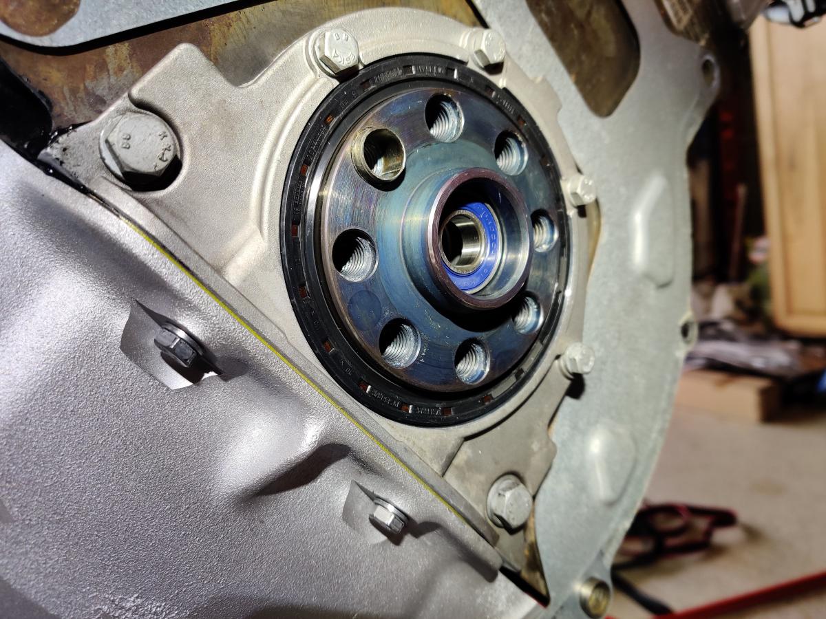

      Blue crank. So cool.

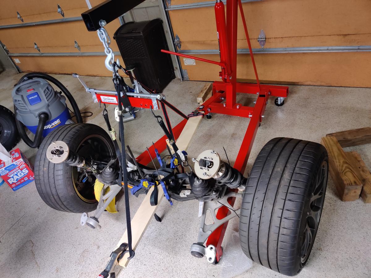

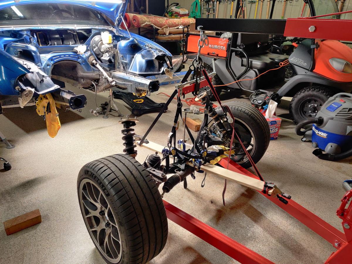

      Wrangling the octopus in an attempt to create a rolling chassis

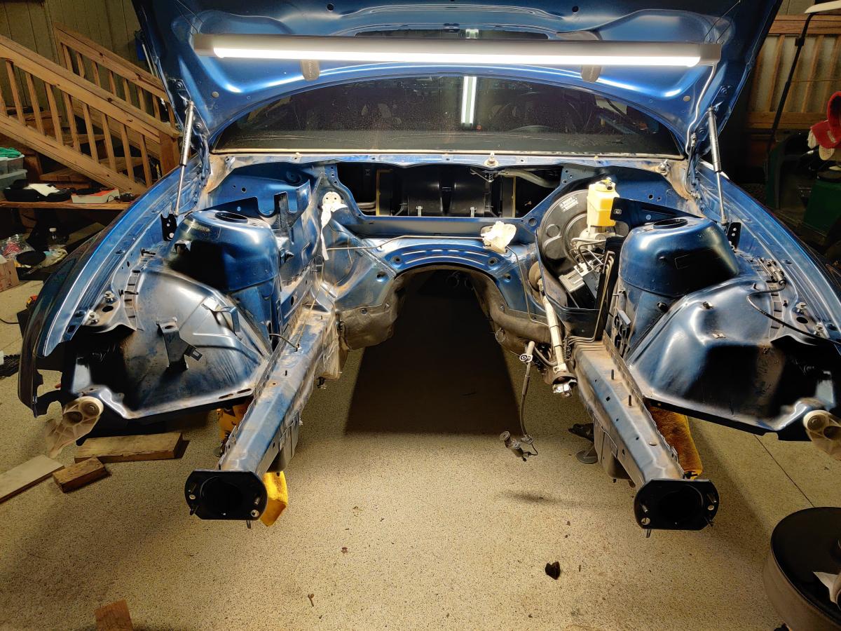

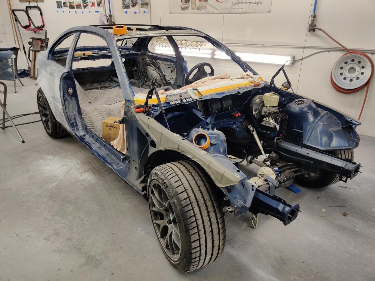

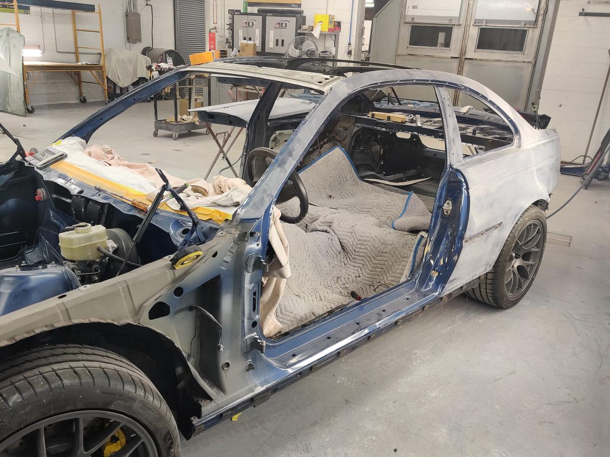

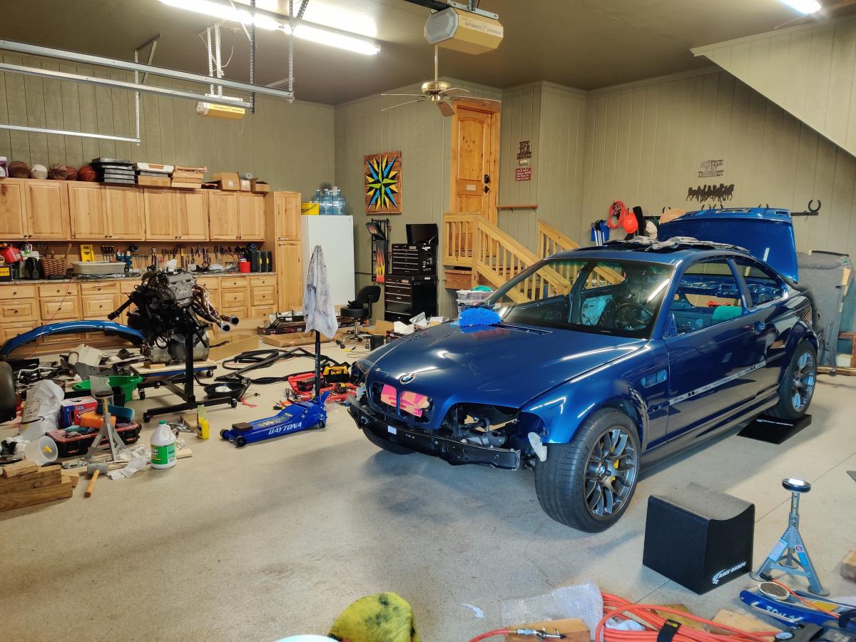

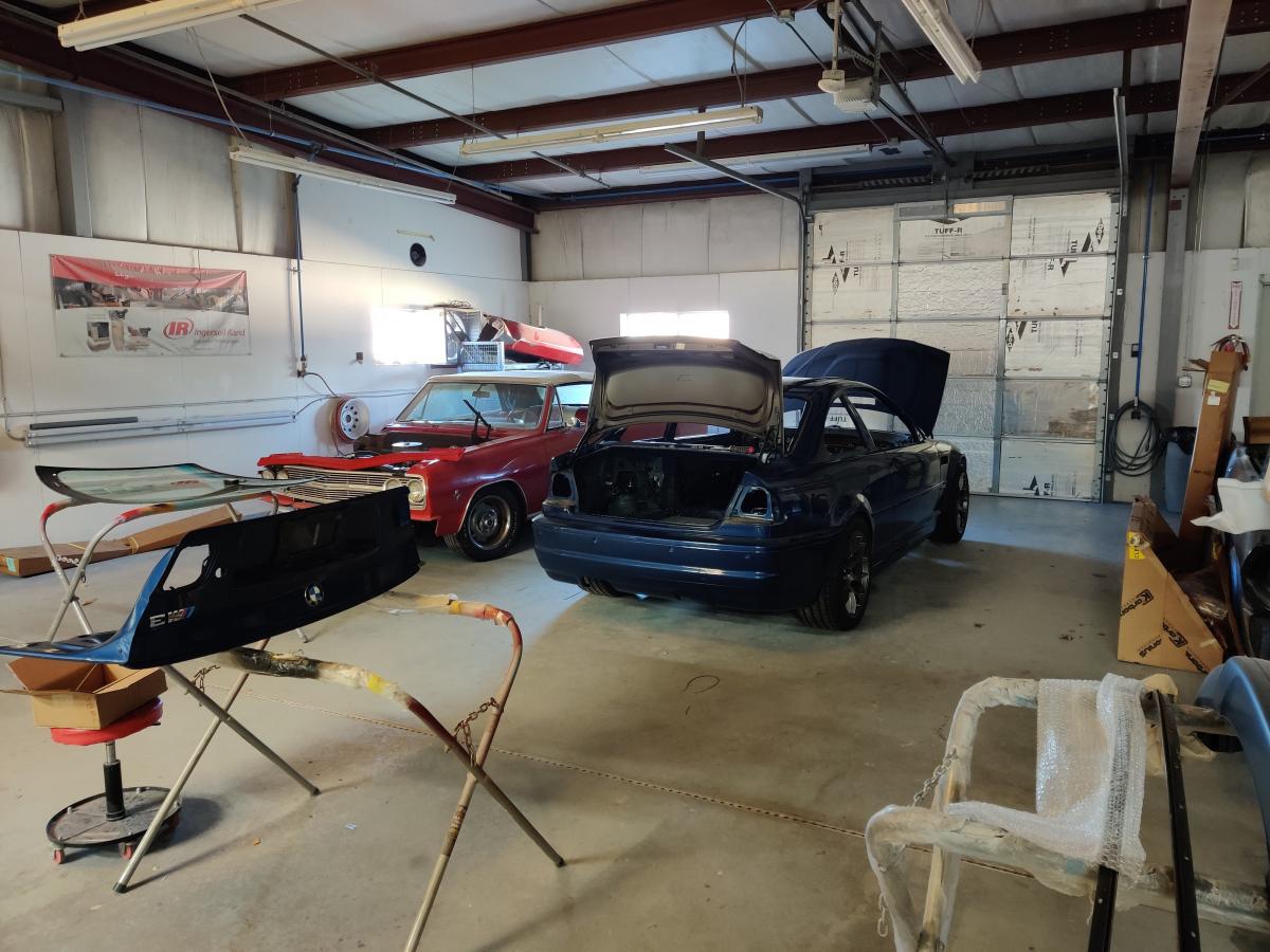

      Rolling chassis ready for the paint shop

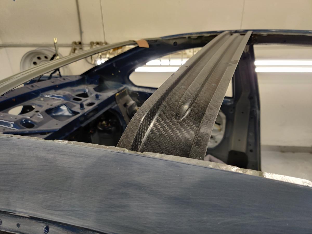

                Wish the lighting in this pic was better, but here is the old trunk removed with the new Karbonius carbon trunk fitted.
                Click image for larger version  Name:	IMG_20220219_093446.jpg Views:	0 Size:	141.4 KB ID:	157328
                The quality of the trunk is top notch. The paint shop rolled their eyes and smirked when I said I have a carbon deck lid. "Those things never, ever fit well" was their reply.
                Turns out fitment is spot on. They were extremely impressed with the quality and fitment, as am I. Karb is doing things right. This is an extremely complex piece and I'm diggin their take on the CSL deck lid.

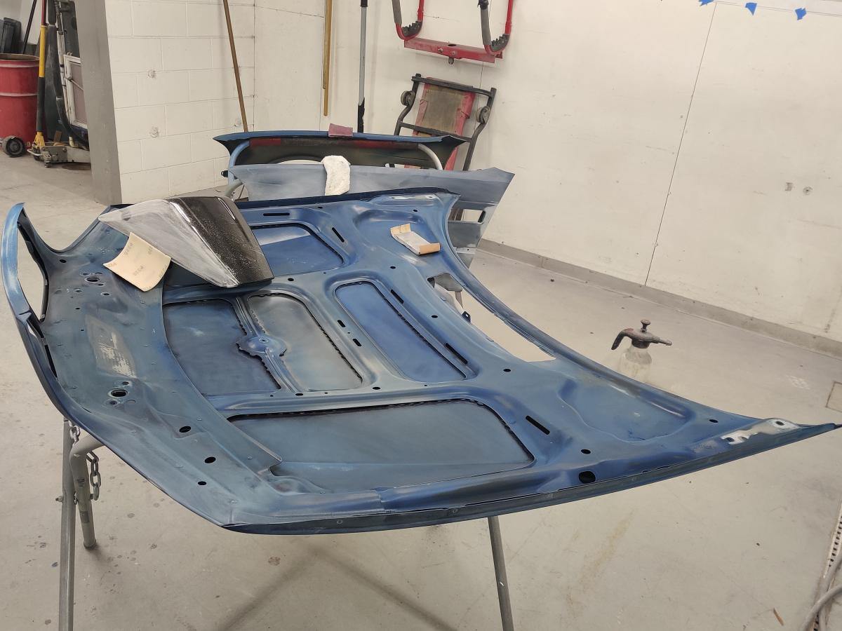

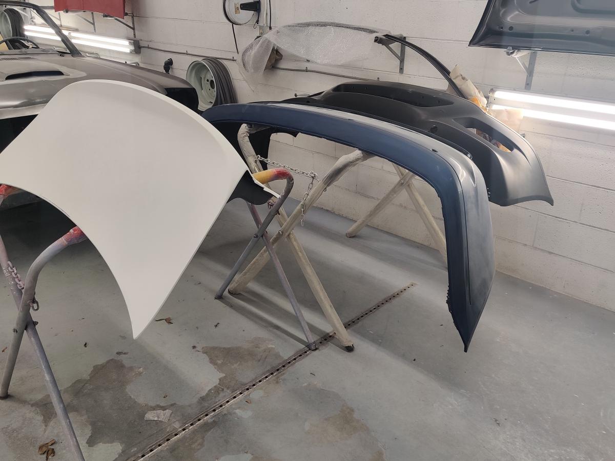

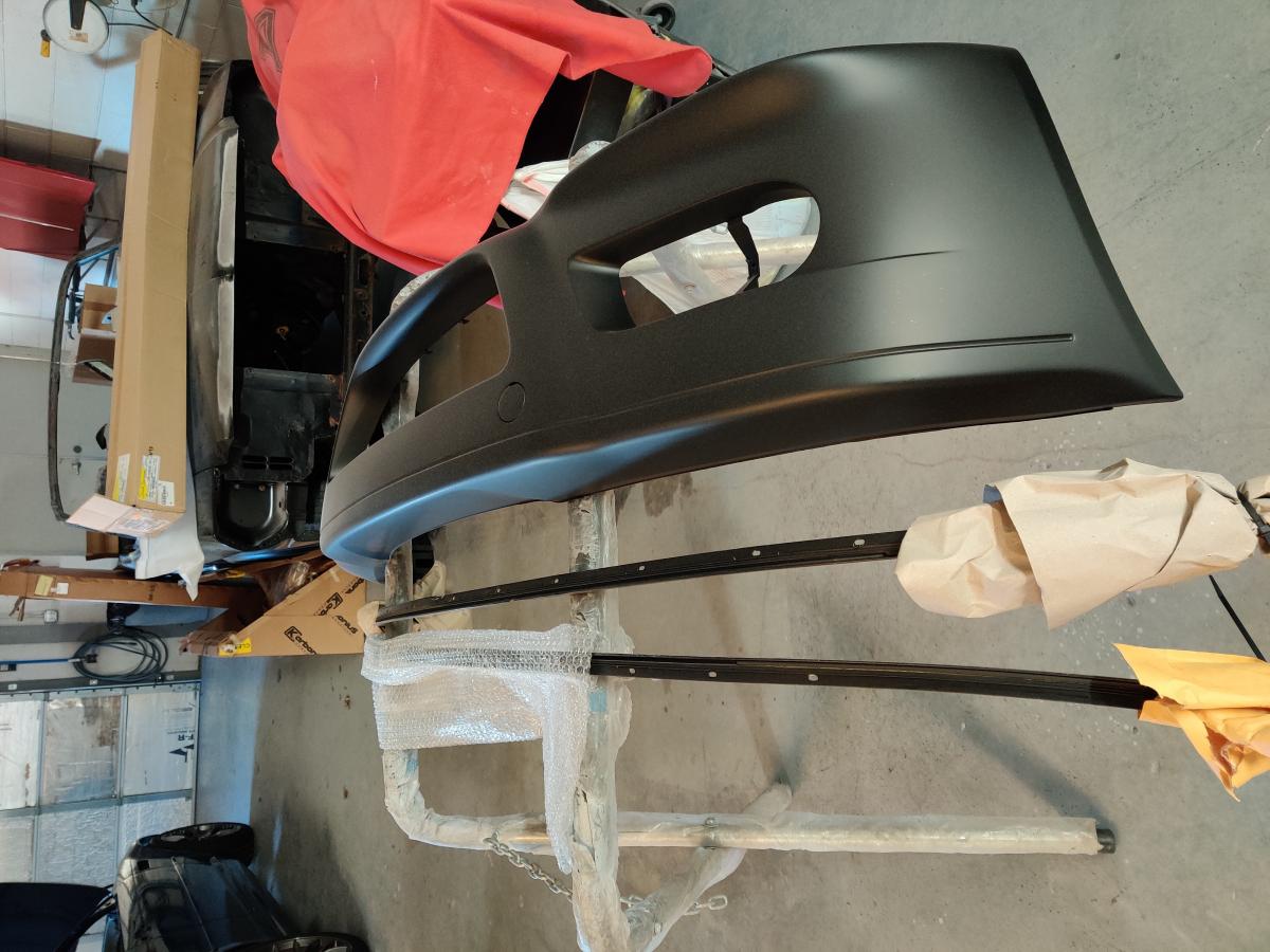

                  Euro bumper awaiting paint. That's also my matte shadowline trim that will be painted Gloss Black. The rubber seals are in surprisingly good shape so decided why the hell not. No way am I paying $2600 per side for the OEM BMW ones.
                  Also - sorry again for the sideways shot, I legit can't figure out why these are getting rotated 90 degrees left when I upload them here.
                  Click image for larger version  Name:	IMG_20220219_095430.jpg Views:	0 Size:	125.2 KB ID:	157340

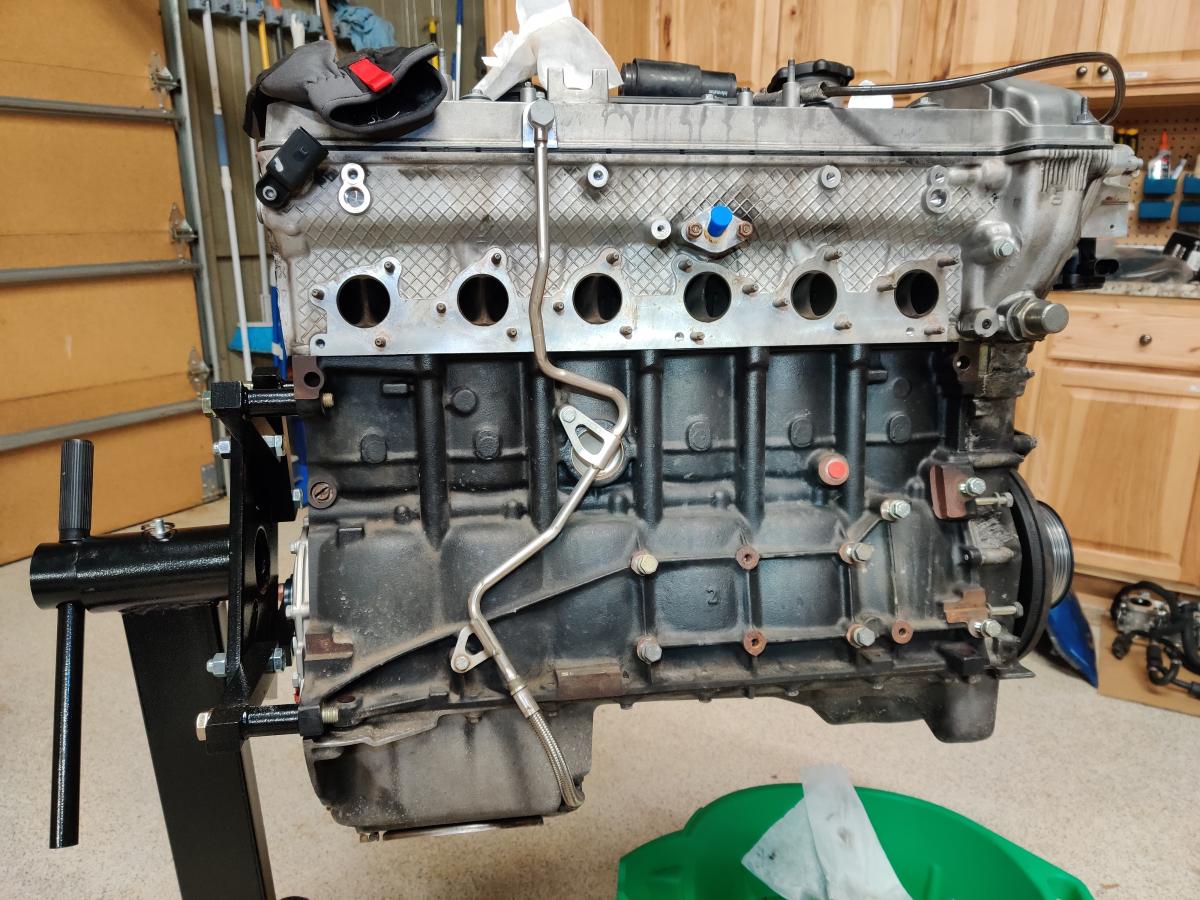

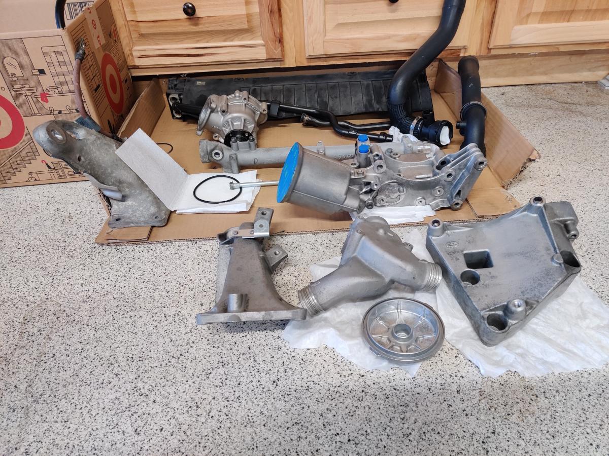

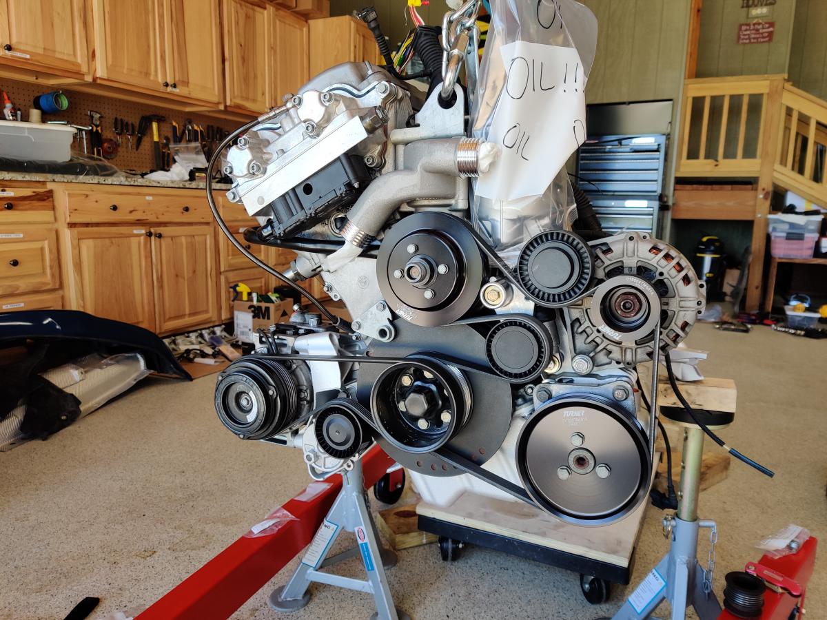

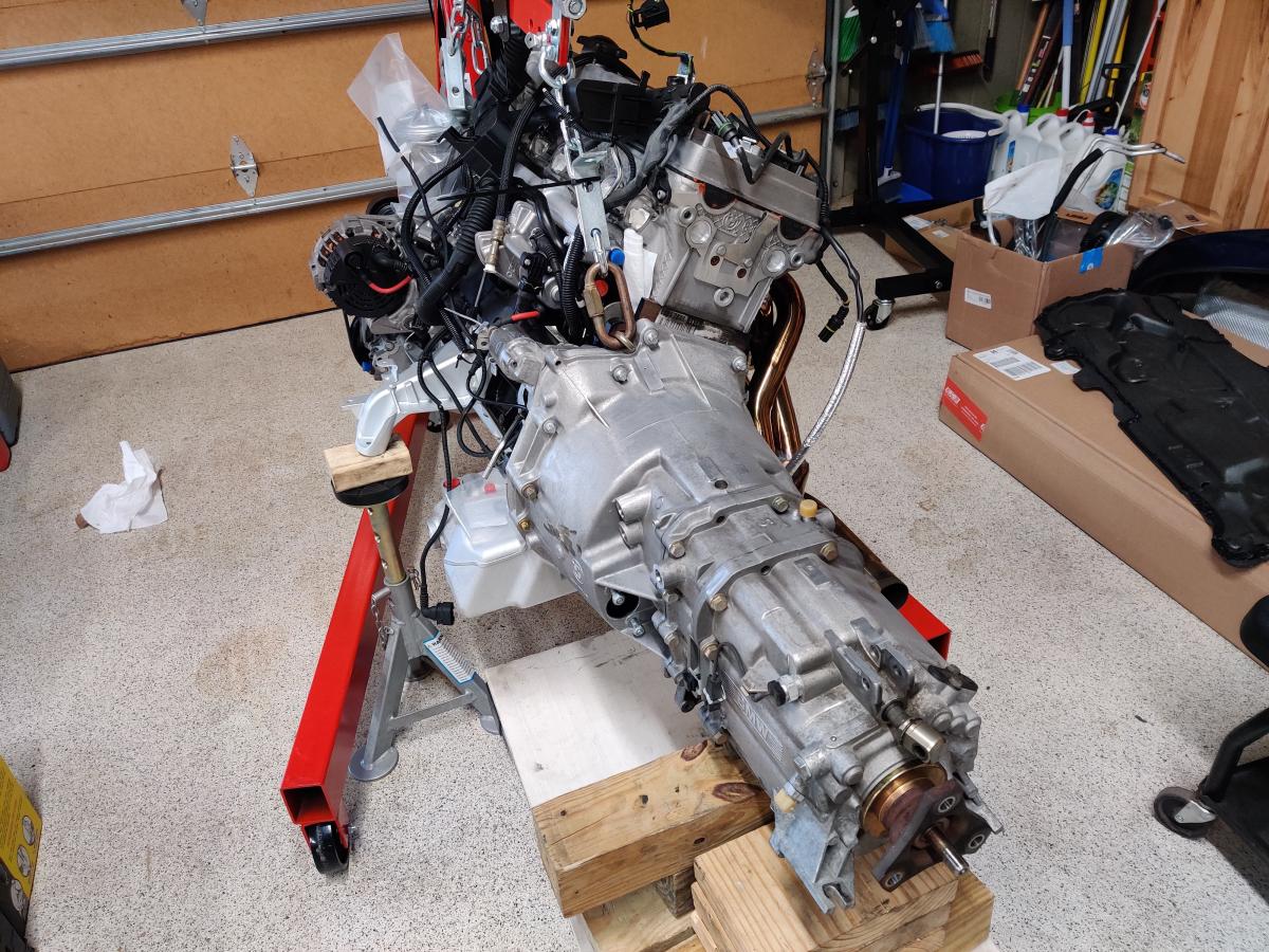

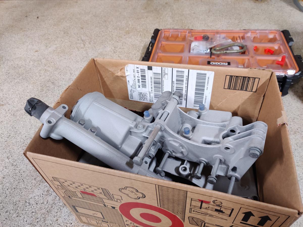

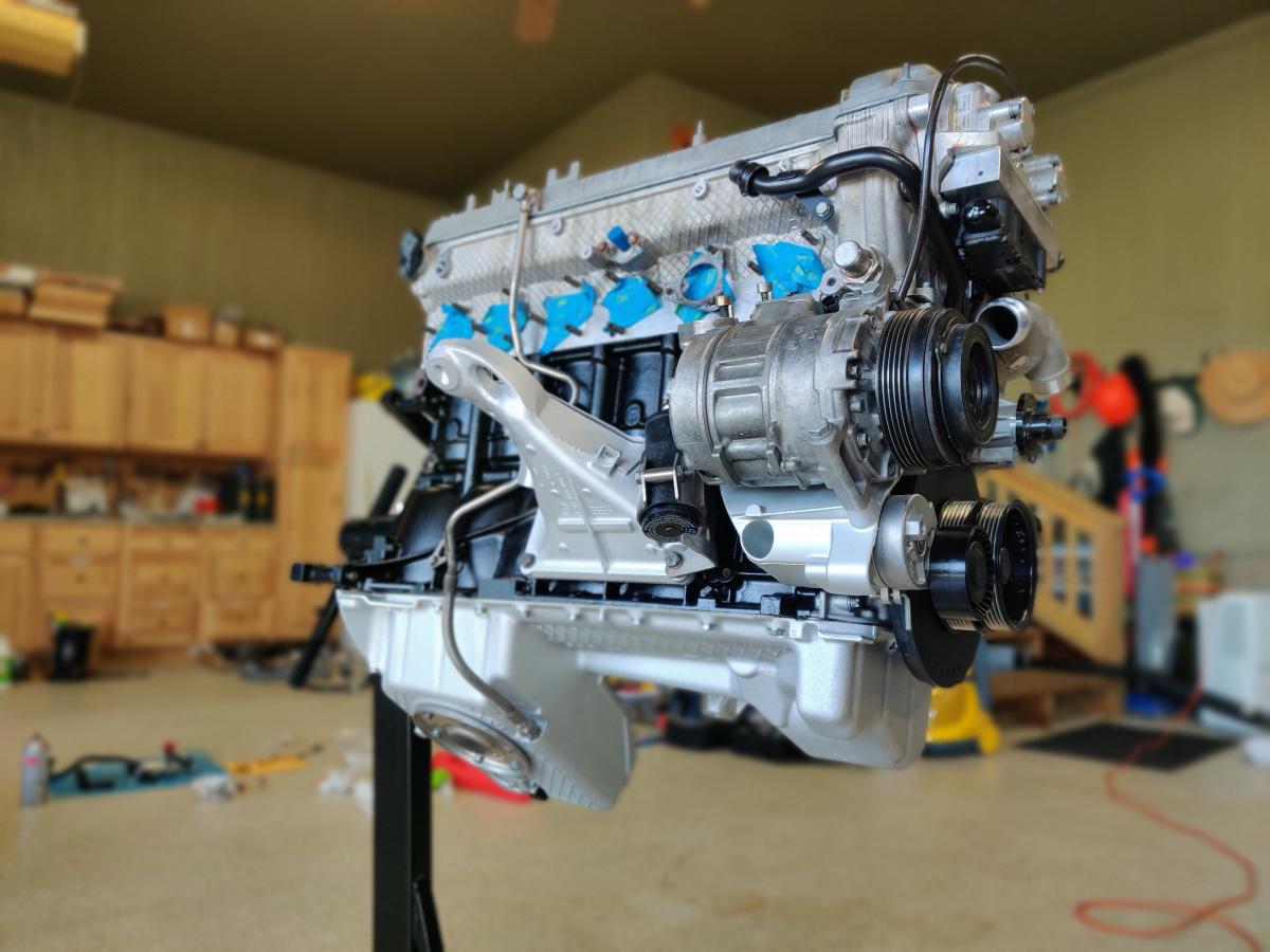

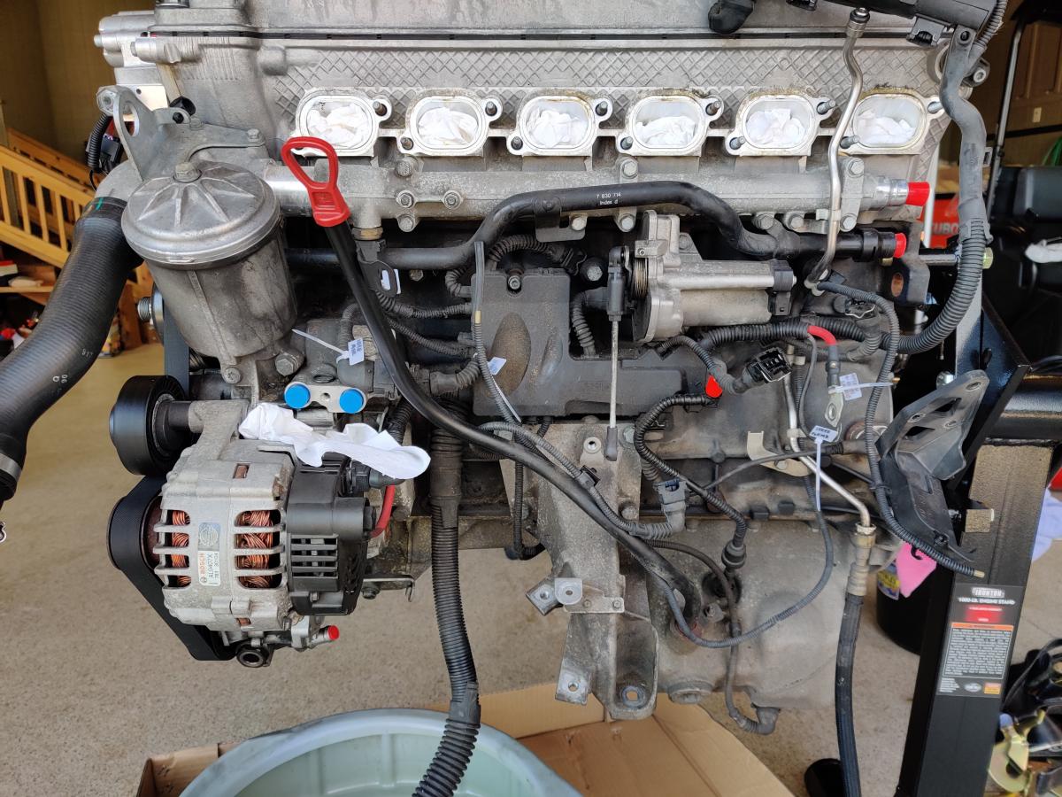

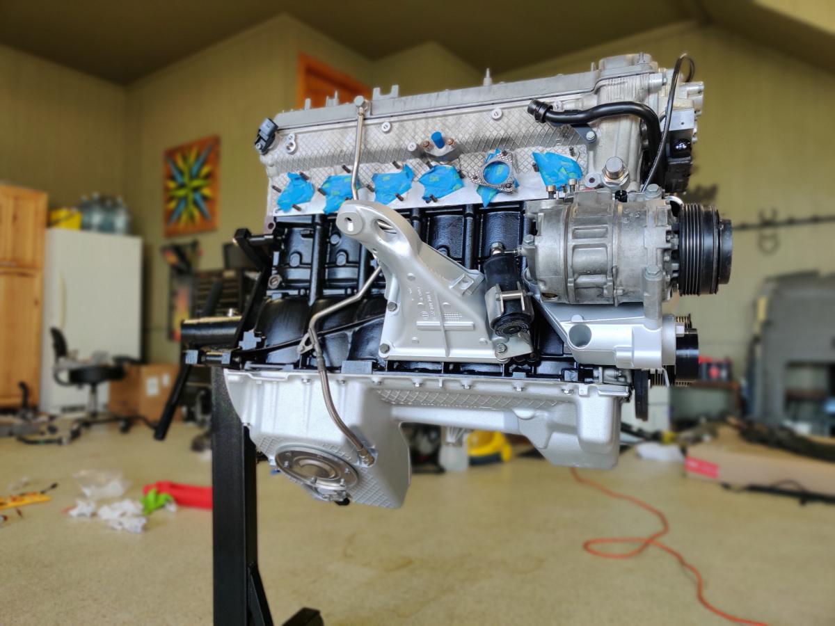

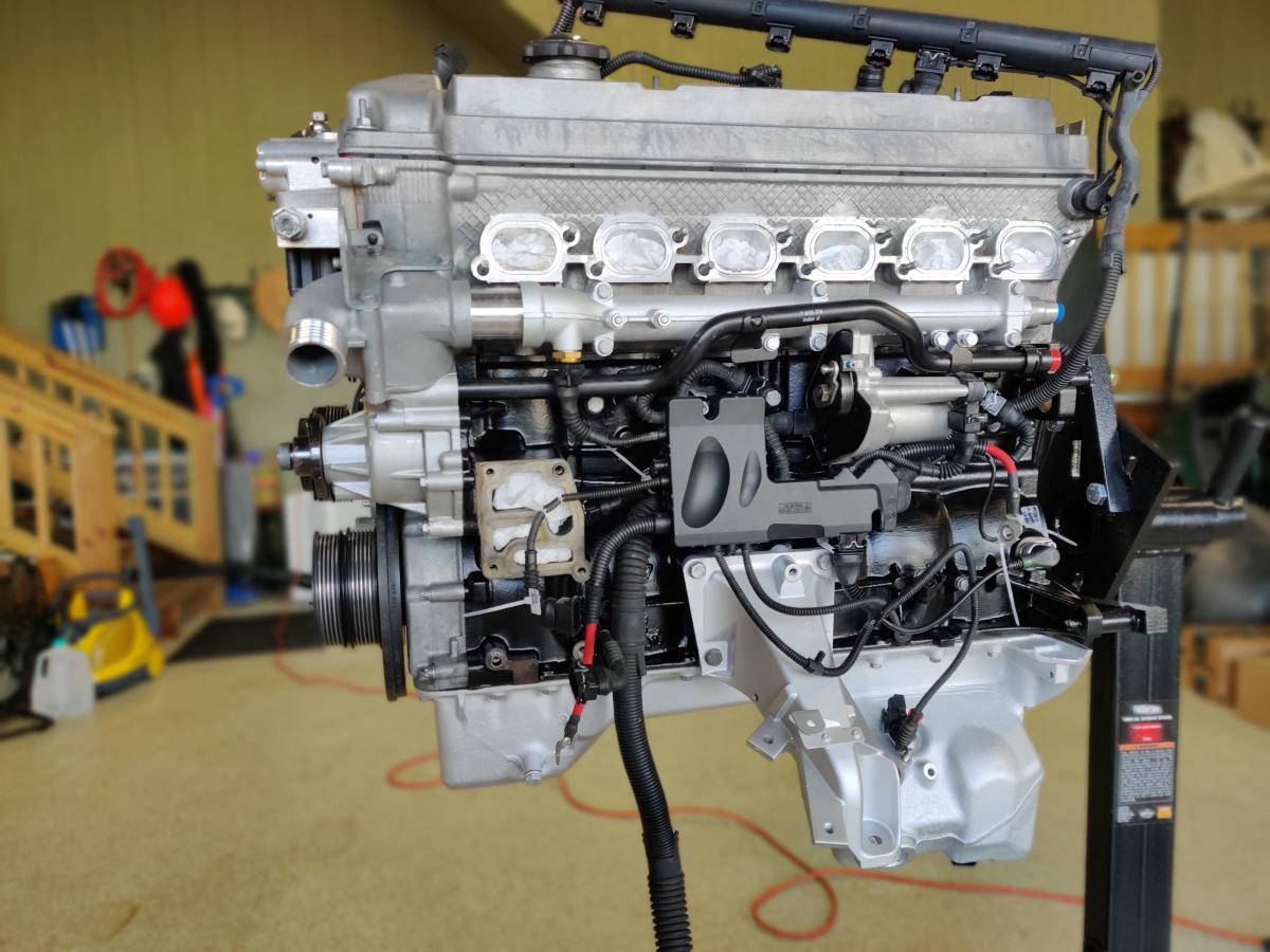

                  With the car at the shop, I turned my attention to the motor. I removed everything that bolted onto this thing, including the headers. Don't hate on my Agency Power tubes, still trying to decide if I want SSV1 + SS catted section 1. I mean... the answer is yes, just not sure I want to shell out the $4k at the moment.
                  Click image for larger version  Name:	IMG_20220212_130901.jpg Views:	0 Size:	223.0 KB ID:	157341
                  Dirty birdy.
                  Click image for larger version  Name:	IMG_20220212_132659.jpg Views:	0 Size:	191.9 KB ID:	157342

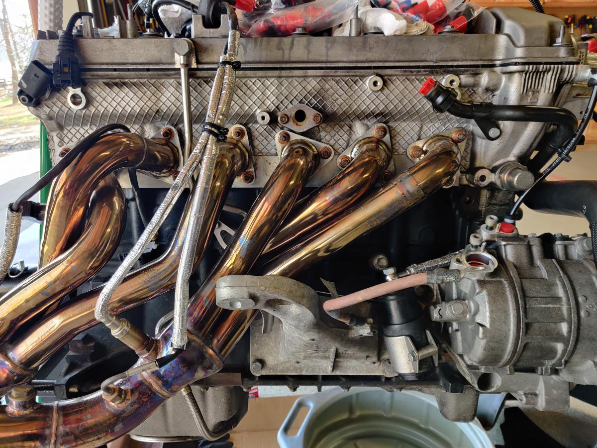

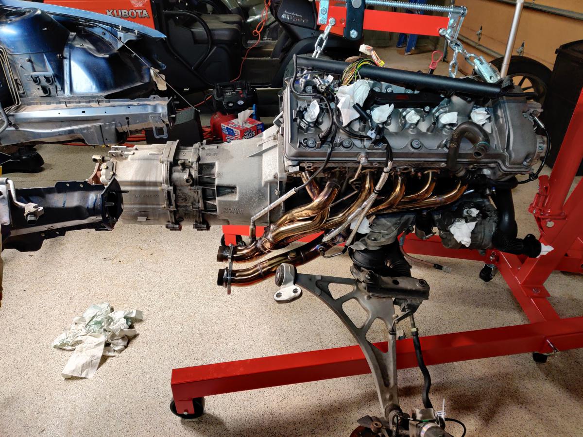

                  Headers off.
                  Click image for larger version  Name:	IMG_20220218_132525.jpg Views:	0 Size:	171.9 KB ID:	157343

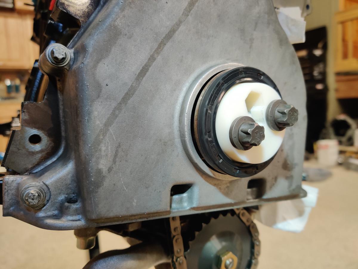

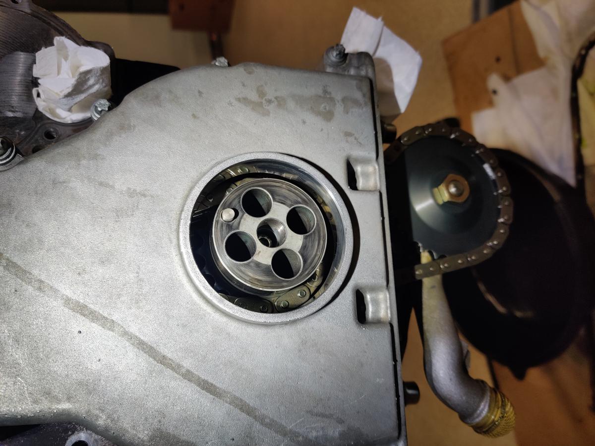

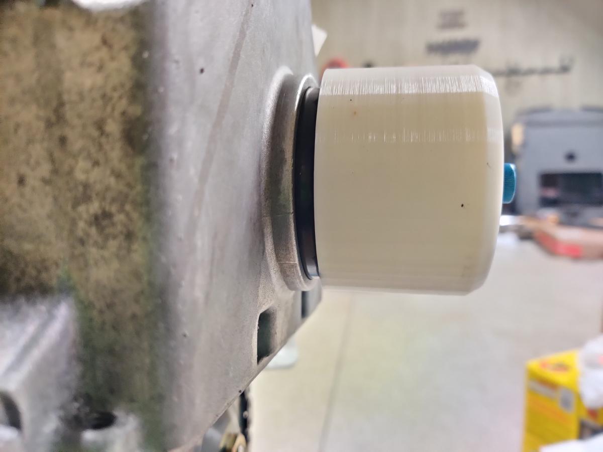

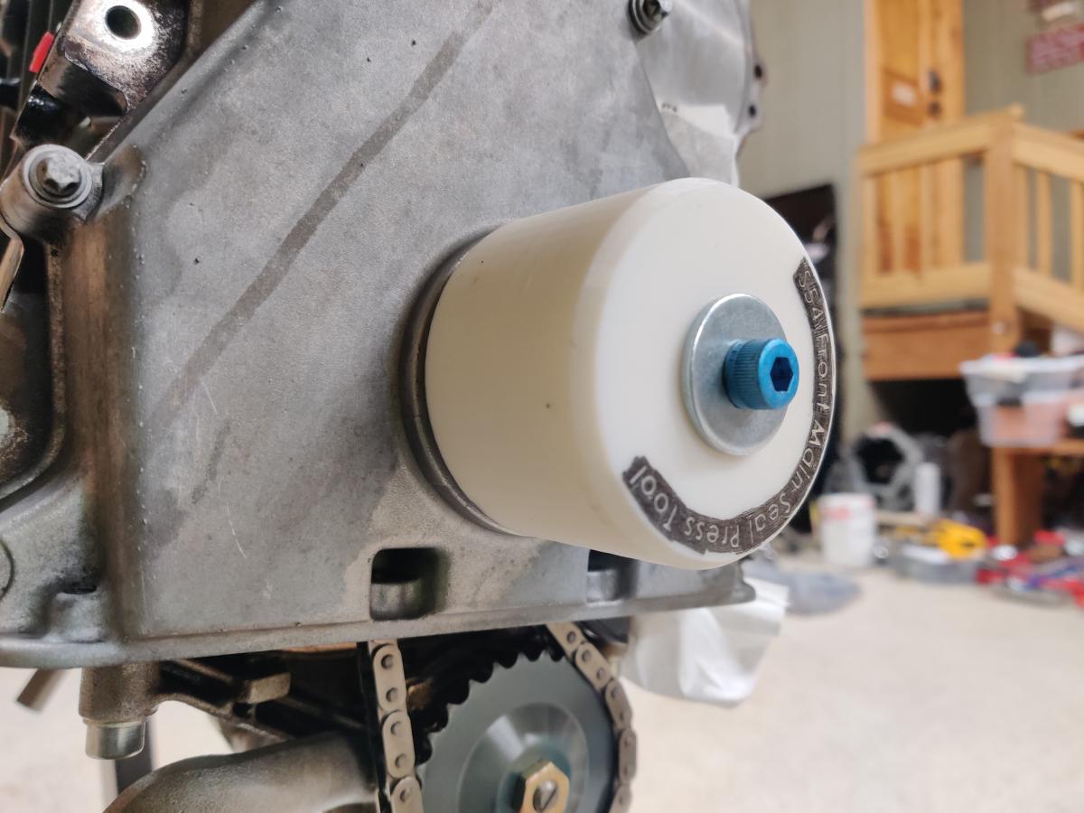

                  Custom crank holder vibration damper removal tool.
                  Click image for larger version  Name:	IMG_20220219_123826.jpg Views:	0 Size:	146.5 KB ID:	157344

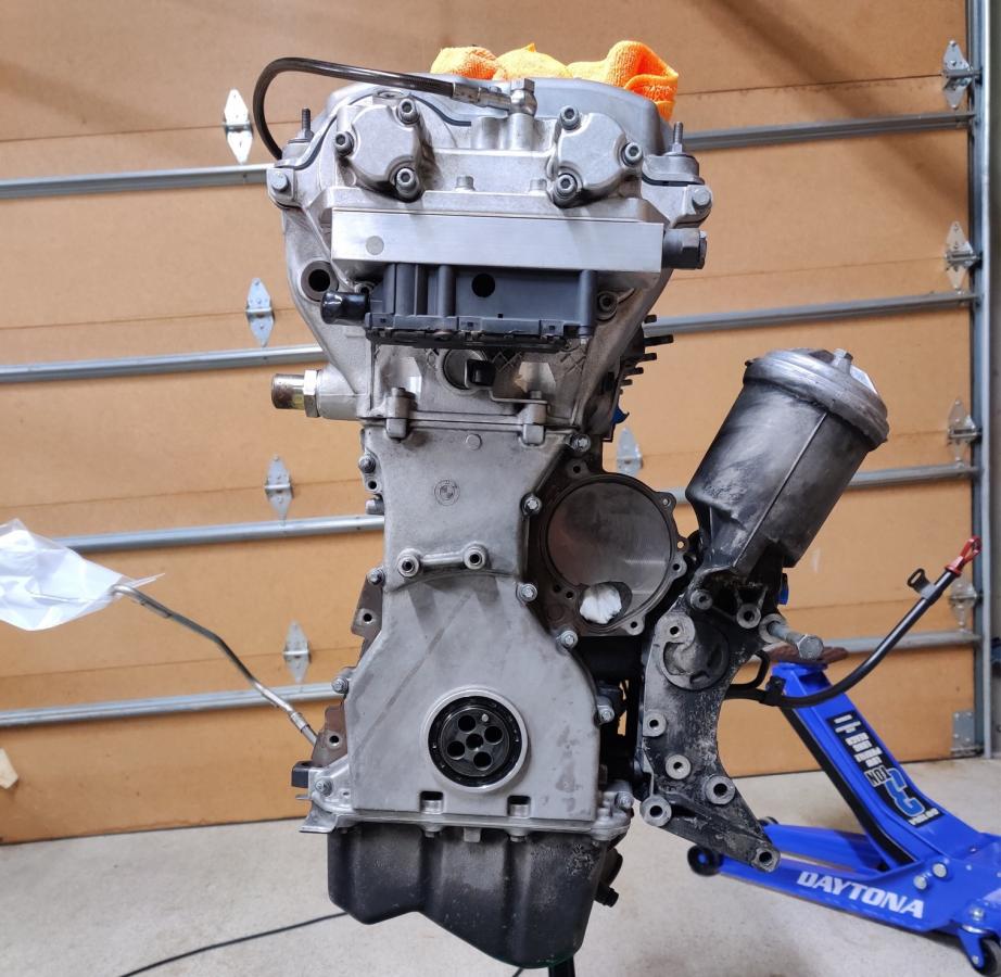

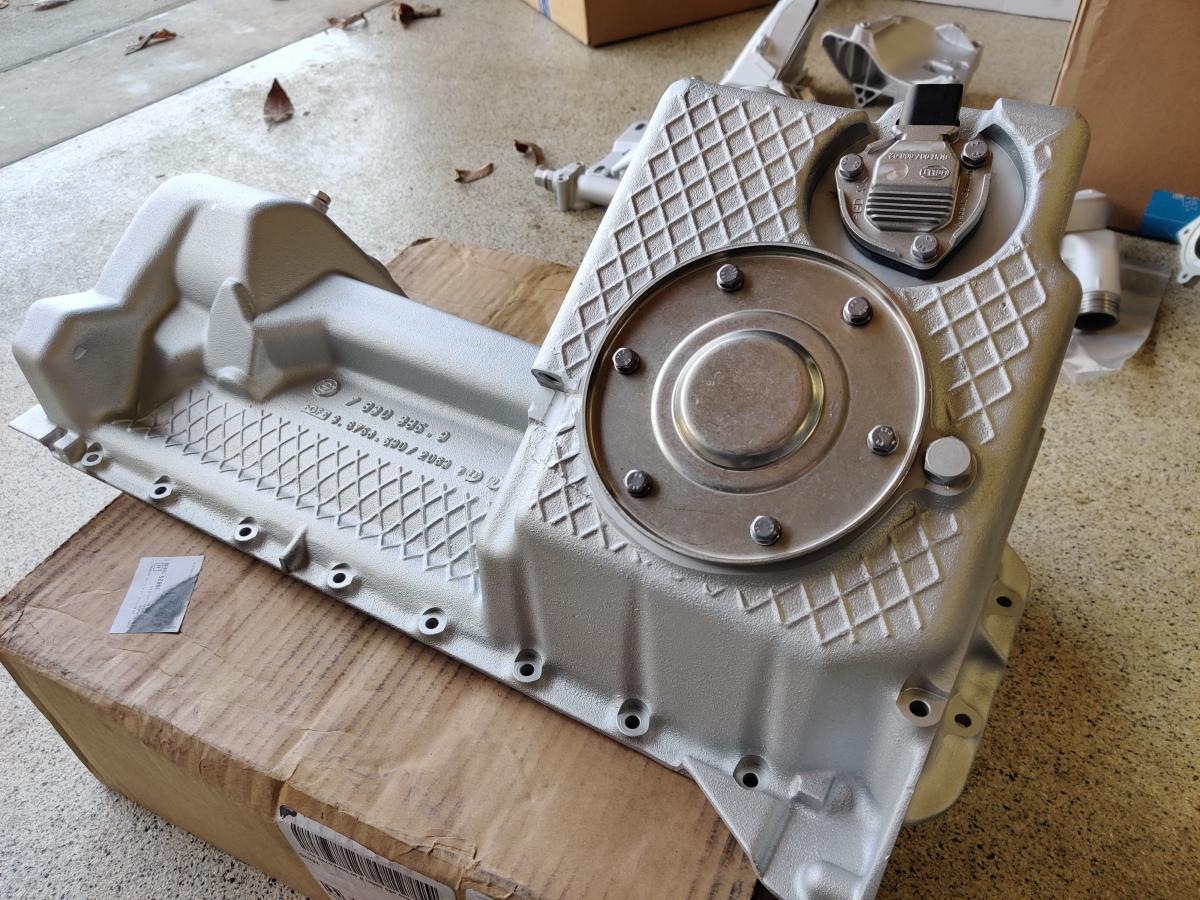

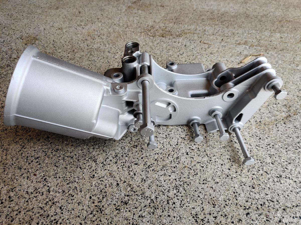

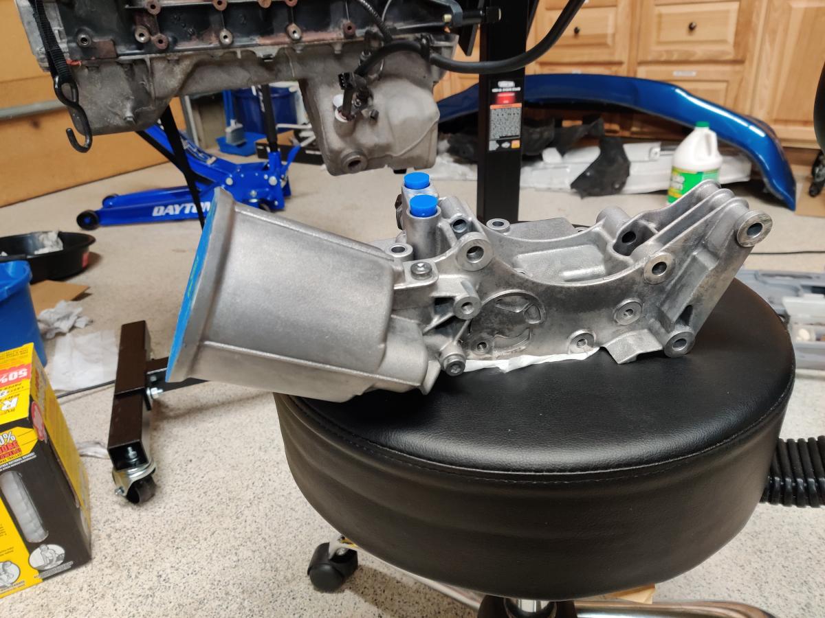

                  Oil filter housing needs some TLC.
                  Click image for larger version  Name:	Dirty oil filter housing.jpg Views:	0 Size:	108.6 KB ID:	157346
                  ...four hours and a lot of Simple Green later...
                  Click image for larger version  Name:	IMG_20220220_150822.jpg Views:	0 Size:	146.1 KB ID:	157345

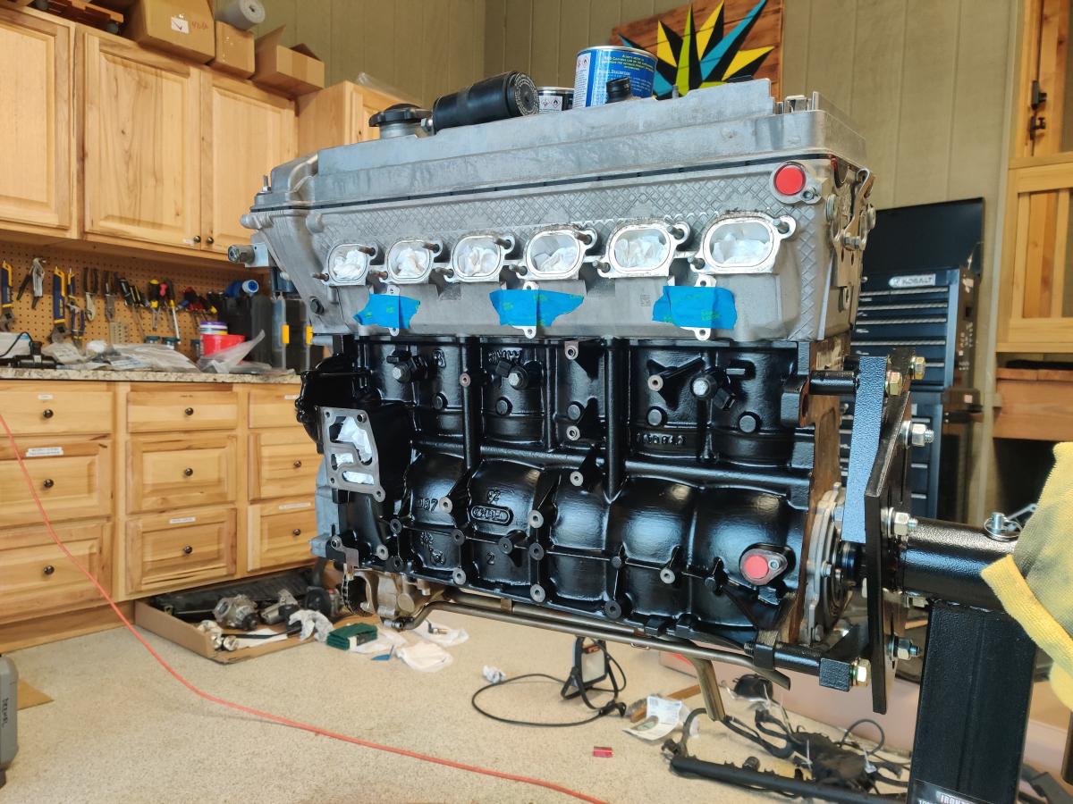

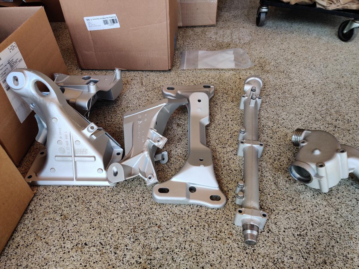

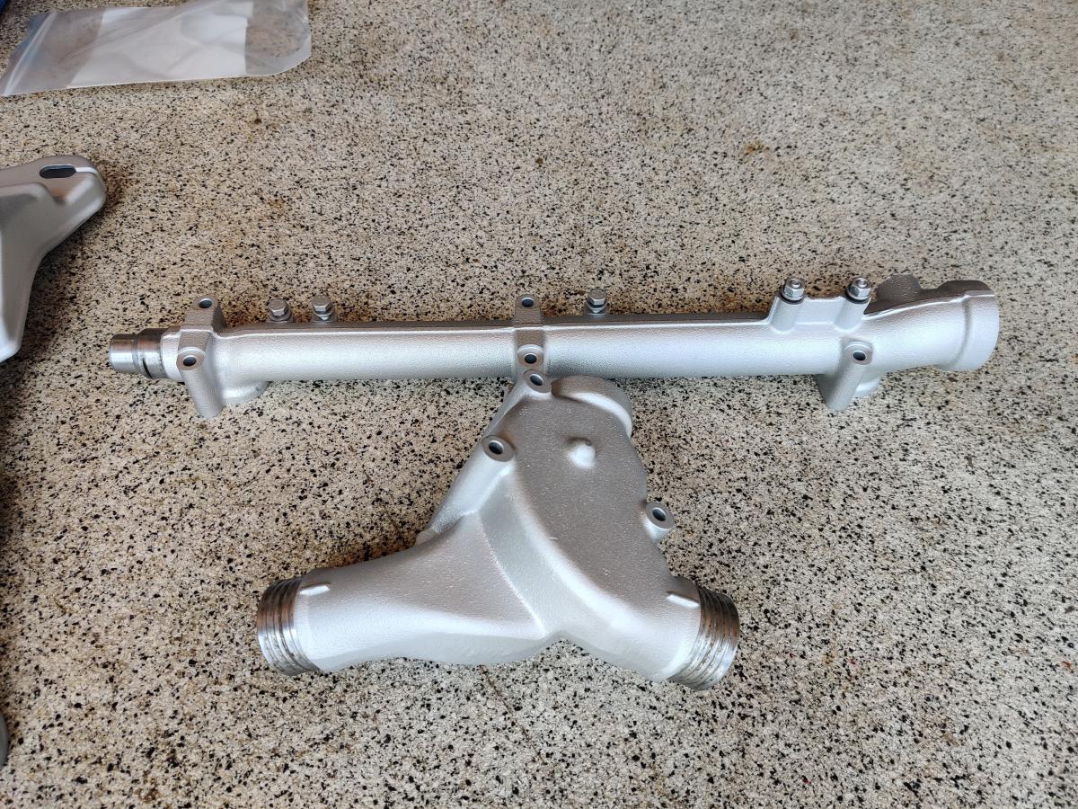

                  Slowly making my way through de-greasing miscellaneous engine parts. PSA: now is a good time to go buy stock in Simply Green's parent company.
                  Click image for larger version  Name:	IMG_20220221_173546.jpg Views:	0 Size:	234.4 KB ID:	157347

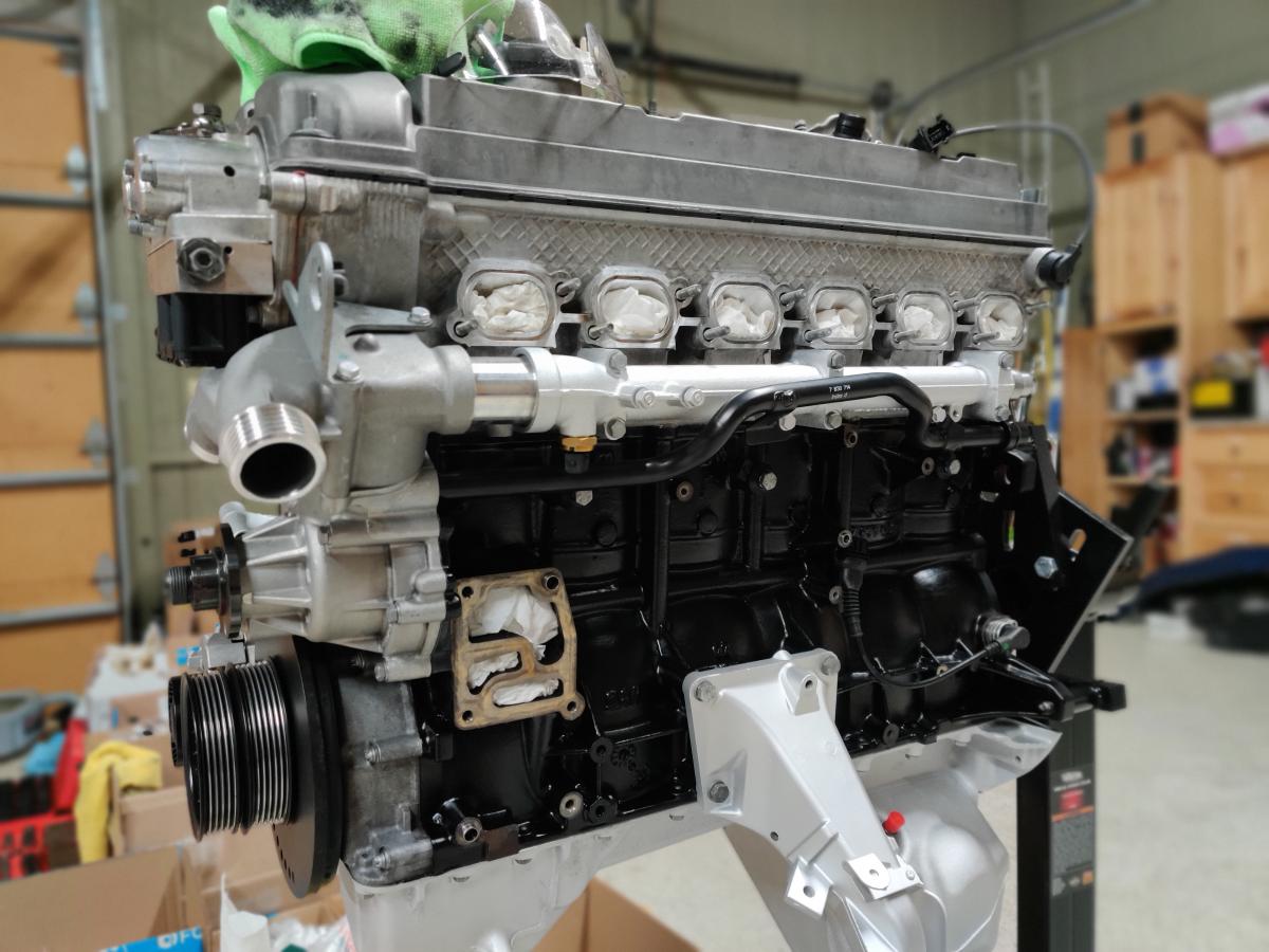

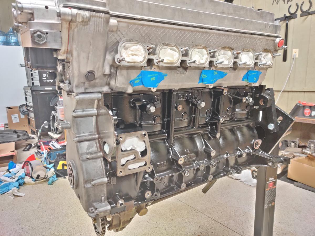

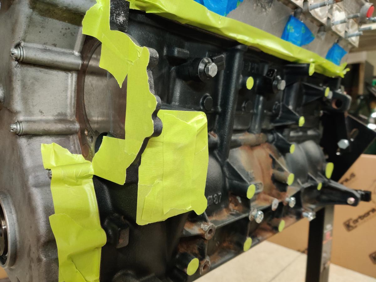

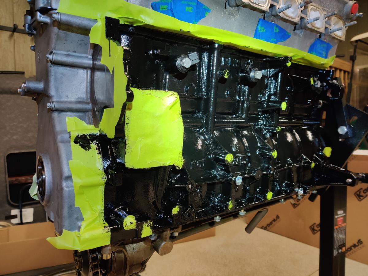

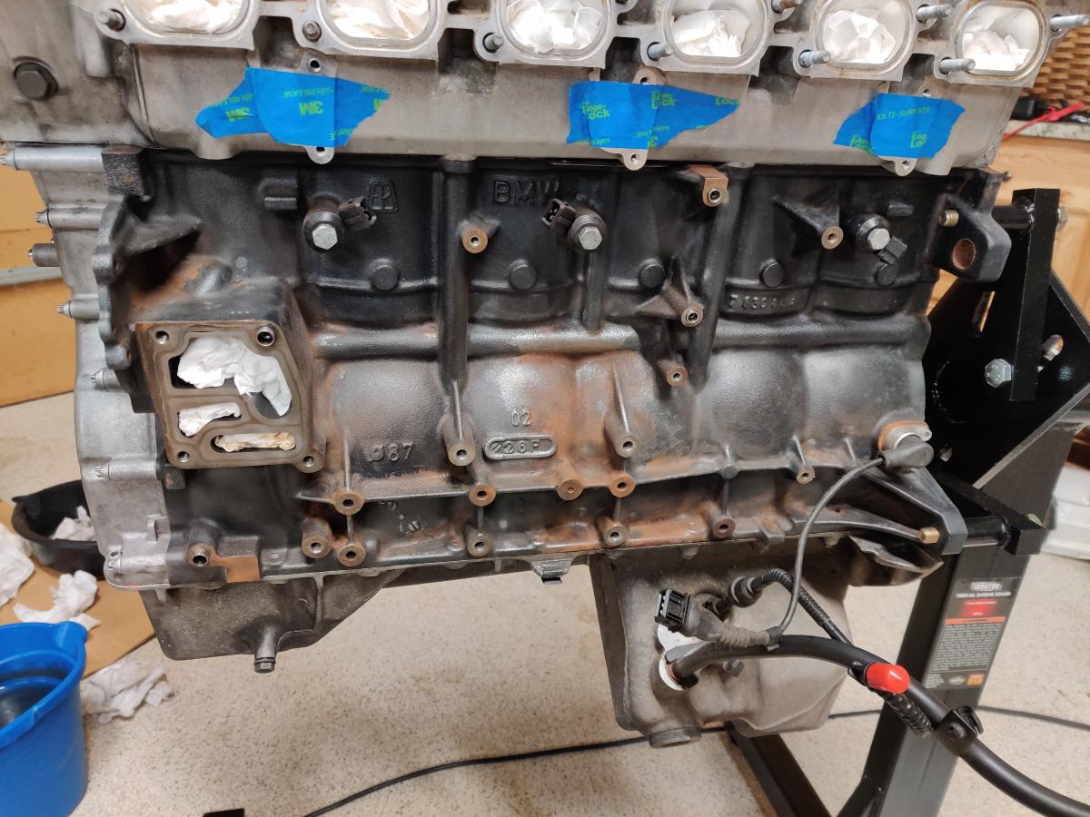

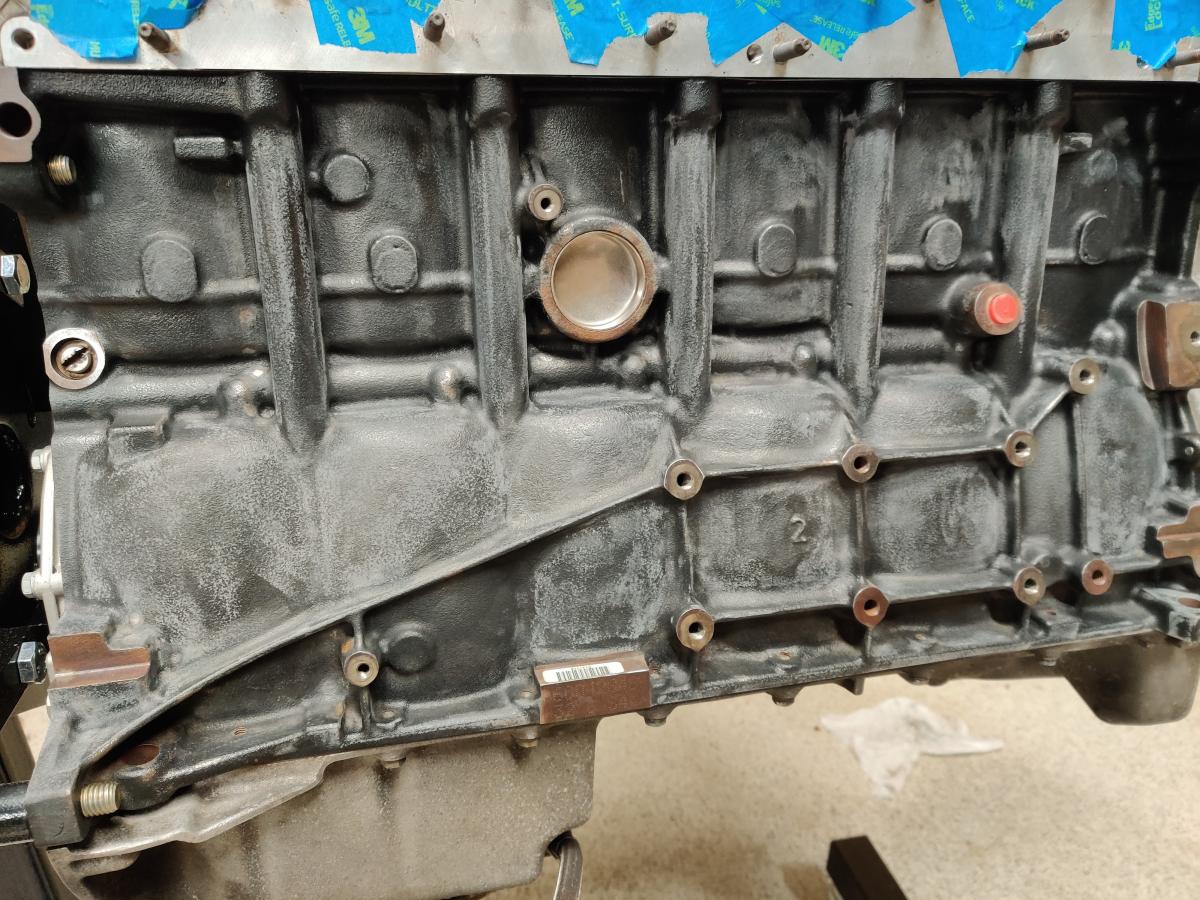

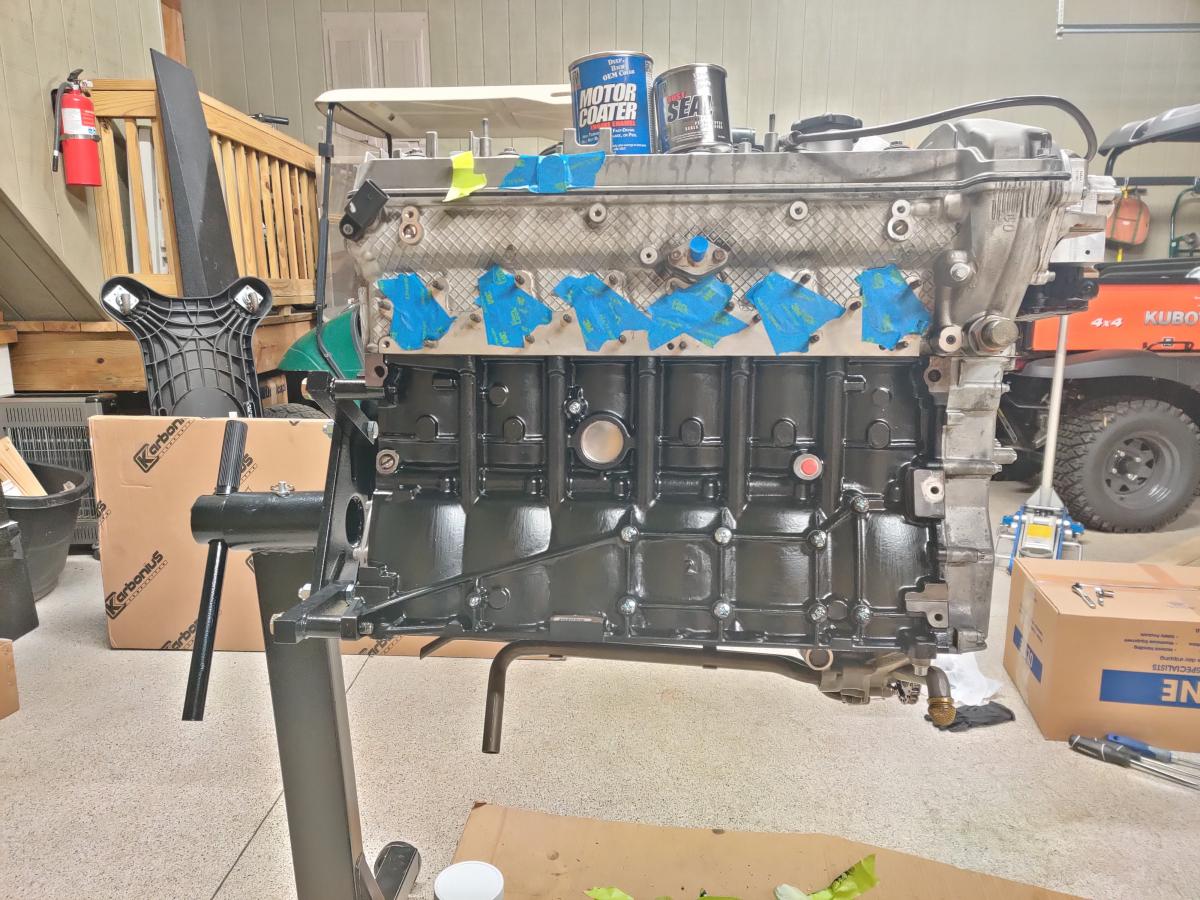

                  Got tired of scrubbing small parts, so turned my attention to the motor. However... that took lots of scrubbing so I'm still not sure what logic I was applying.

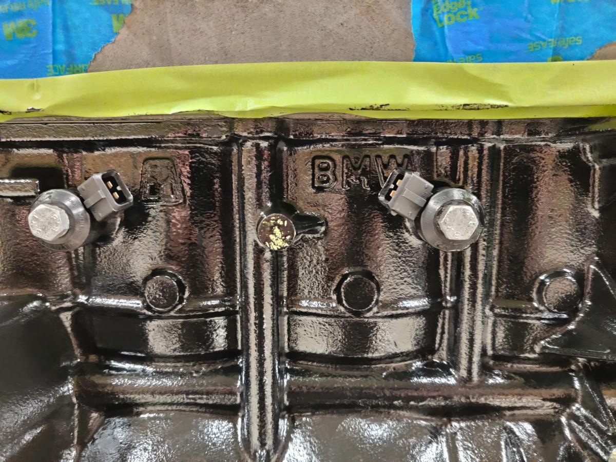

                  Removed any loose and flaking factory paint. I'm following KBS Coatings and their 4 step Rust Seal process:
                  1. scrub, scrape and sand until your fingers fall off and there is no flaking paint or rust left
                  2. apply KBS Klean to degrease the block
                  3. apply Rust Blast to prep any exposed metal or remaining surface rust
                  4. apply RustSeal to encapsulate any remaining rust.
                  I've used this before and LOVE the ease of application. It goes on with a brush and the coating levels itself out if you don't go too heavy with each coat and apply multiple light coats. It dries rock hard when done, and then you top coat it (next set of pics). IMHO, it's a better POR15.

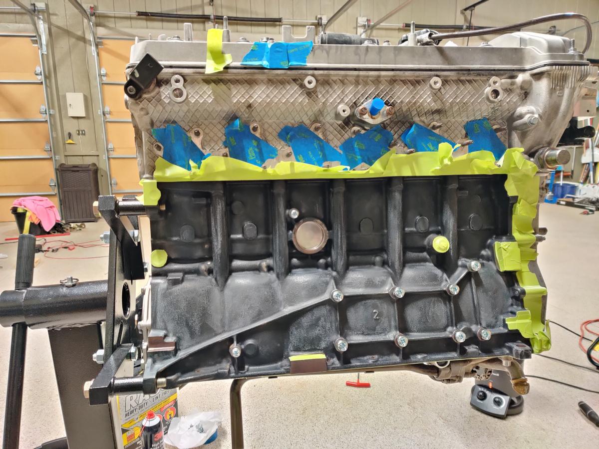

                  Click image for larger version  Name:	IMG_20220220_155831.jpg Views:	0 Size:	158.9 KB ID:	157348
                  Sanding in progress on the passenger side (the driver side for anyone in the UK or NZ or any other RHD country), where the factory paint was in much better shape than the driver side.
                  Click image for larger version  Name:	IMG_20220220_162407.jpg Views:	0 Size:	190.5 KB ID:	157349
                  Masked off. I hate masking with a passion. I'm so freaking particular that it takes me HOURS to get to this point.
                  Click image for larger version  Name:	IMG_20220226_143000.jpg Views:	0 Size:	150.9 KB ID:	157350

                  Some in progress shots of the RustSeal.
                  Click image for larger version  Name:	IMG_20220226_154327.jpg Views:	0 Size:	155.1 KB ID:	157354
                  Click image for larger version  Name:	IMG_20220226_154405.jpg Views:	0 Size:	198.4 KB ID:	157355
                  You can see how well this stuff levels out on its own. This is still drying (I used a satin black to match BMW factory finish, however here it looks gloss) and you can see how well the coating self-levels. Stuff is awesome. This is with a paint brush!
                  BTW - I have new ping/knock sensors on the way so I'm using the old ones to "mask off" the block as I got tired of cutting out masking tape circles.
                  Click image for larger version  Name:	IMG_20220226_183159.jpg Views:	0 Size:	203.7 KB ID:	157356
                  And finally the top layer of Motor Coater. With it still tacky, I pulled the masking tape off. I have found that if you pull the tape off while the coating is still curing, it's way easier to remove and you end up with a better final finish. You just need to go slow and pay attention so you don't leave finger prints in the final finish.
                  Click image for larger version  Name:	IMG_20220227_170219.jpg Views:	0 Size:	179.2 KB ID:	157357
                  Click image for larger version  Name:	IMG_20220227_170259.jpg Views:	0 Size:	167.3 KB ID:	157358
                  Click image for larger version  Name:	IMG_20220227_172648.jpg Views:	0 Size:	183.8 KB ID:	157359
                  Up next is cleaning up the timing cover and the head. That will be easy by comparison.

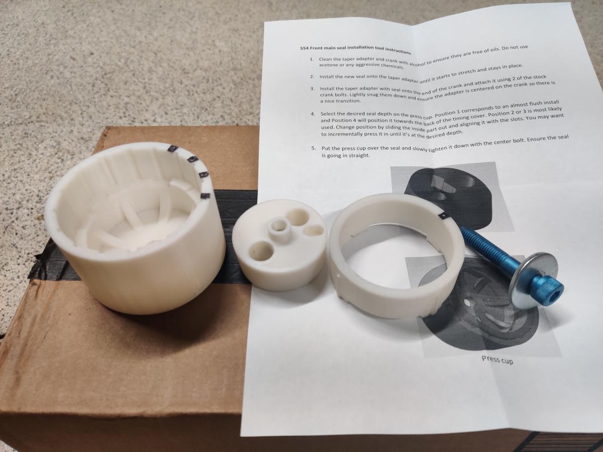

                              Couple of quick updates.

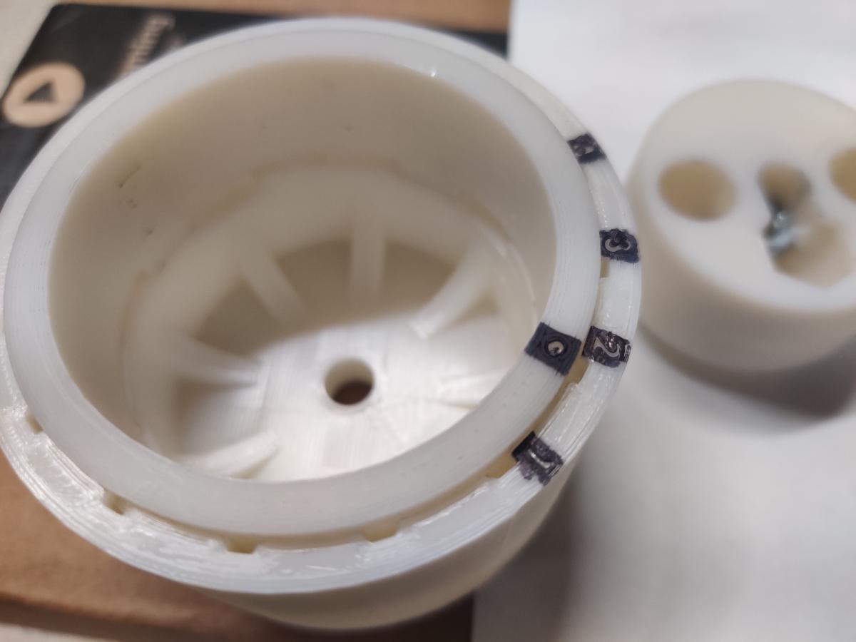

                              Front main seal:

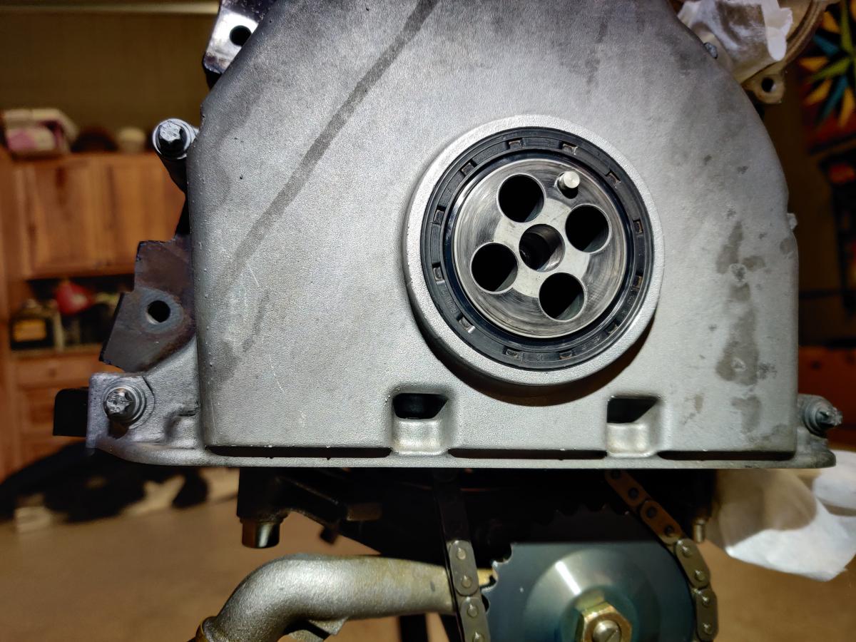

                              New front main seal installed. I did a trial run of cobra's 3D printed FMS installation tool. He's planning on renting the tool out (I rented it from him). It's pretty freaking slick!!
                              Came with instructions, super clear and easy to understand.
                              Click image for larger version  Name:	IMG_20220312_114148.jpg Views:	0 Size:	98.8 KB ID:	159952
                              There are 4 positions for the inner cup that presses the FMS into the housing. Each position sets the seal about 1.5-2mm further into the timing chain cover. This allows the seal to be installed dry, but also at a different depth than the seal you just took out. It's super ingenious and I'm completely blown away by the simplicity of the tool, but the complexity of the design.
                              Click image for larger version  Name:	IMG_20220312_114359.jpg Views:	0 Size:	55.0 KB ID:	159953
                              Click image for larger version  Name:	IMG_20220312_114245.jpg Views:	0 Size:	53.1 KB ID:	159951
                              I think he may be working on some revisions based on feedback. I'll let cobra chime in if he wants.
                              This tool is incredibly well thought out. I bought 3 seals and used only 1, so we can now officially call it "idiot proof".
                              A few more pics:
                              Click image for larger version  Name:	IMG_20220312_151725.jpg Views:	0 Size:	151.8 KB ID:	159954
                              Click image for larger version  Name:	IMG_20220312_152812.jpg Views:	0 Size:	114.4 KB ID:	159955
                              Click image for larger version  Name:	IMG_20220312_152903.jpg Views:	0 Size:	91.5 KB ID:	159956
                              Click image for larger version  Name:	IMG_20220312_154033.jpg Views:	0 Size:	101.2 KB ID:	159957
                              Click image for larger version  Name:	IMG_20220312_154019.jpg Views:	0 Size:	65.3 KB ID:	159959
                              Click image for larger version  Name:	IMG_20220312_160615.jpg Views:	0 Size:	154.8 KB ID:	159958

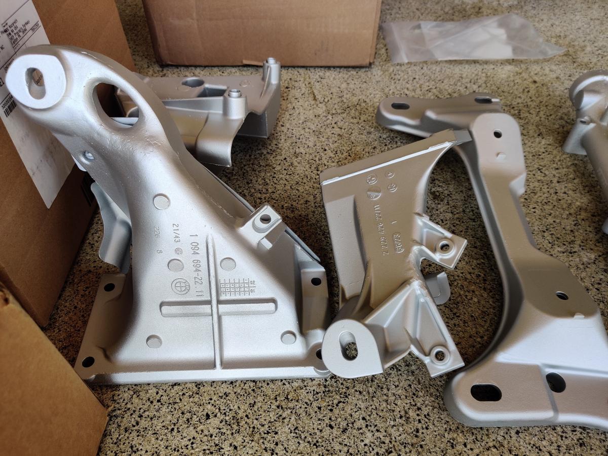

                              Cerakote coating on engine bay parts:
                              After asking the shop that's doing the paint work for a recommendation on the best way to remove oxidation on aluminum, they offered for me to come in on a Saturday morning and sandblast the bits and pieces myself. SUPER COOL of them. Here is what they ended up looking like:
                              Click image for larger version  Name:	IMG_20220226_154455.jpg Views:	0 Size:	166.6 KB ID:	159942
                              The plan was to then satin clear coat them myself. Easy as can be. However, all the clear coats I could find that would withstand engine temps without yellowing required baking to get the finish up to optimal hardness/protection. The "regular" clears seemed to cap out at a working range of 200-225F. Not gonna work for these engine bay parts.
                              However, I was reluctant to bake some of these parts due to not knowing what's inside them (the oil filter housing, in particular). I thought there was an oil thermostat inside it (there is) plus some check valves (there are) that might have plastic/rubber/viton/whatever seals - nonmetallic is what I'm getting at. Pretty sure there are.
                              So I continued to research Cerakote. They make a room temp cure product that isn't quite as good as their super-high temp stuff for headers, exhaust parts and the like, but it's still FAR BEYOND the temperatures these parts will ever see. Heck, even their H-Series and Elite series don't have that high of a cure temp, and with these parts already sandblasted, I figured this was a no-brainer and safe. I WAS WRONG.
                              Without belaboring the points in that thread any further in this one, I'll focus on the positive. These parts looks absolutely amazing.
                              Click image for larger version  Name:	IMG_20220319_122108.jpg Views:	0 Size:	274.7 KB ID:	159950
                              Click image for larger version  Name:	IMG_20220319_115103.jpg Views:	0 Size:	273.8 KB ID:	159943
                              Click image for larger version  Name:	IMG_20220319_115109.jpg Views:	0 Size:	183.8 KB ID:	159944
                              Click image for larger version  Name:	IMG_20220319_115126.jpg Views:	0 Size:	333.1 KB ID:	159945
                              Click image for larger version  Name:	IMG_20220319_145613.jpg Views:	0 Size:	219.0 KB ID:	159946
                              Click image for larger version  Name:	IMG_20220319_145619.jpg Views:	0 Size:	193.6 KB ID:	159947
                              Click image for larger version  Name:	IMG_20220319_145635.jpg Views:	0 Size:	172.2 KB ID:	159948
                              I love how the oil pan looks contrasted against the freshly coated motor, and all new fasteners for the sump, oil pan and the oil temp sensor (also new).
                              Click image for larger version  Name:	IMG_20220319_170826.jpg Views:	0 Size:	153.3 KB ID:	159949

                                While the car was off at paint, I continued progress on putting as much as I could back together. I cleaned up the transmission as best I could, installed a new clutch fork pivot pin (steel BMW p/n 21511223281), throw out bearing guide tube, and all the miscellaneous extras one typically does when refreshing the clutch. Sorry about the upside down photo... no clue.
                                Click image for larger version  Name:	IMG_20220327_155740.jpg Views:	0 Size:	158.6 KB ID:	165445
                                Started bolting bits and pieces onto the motor. I absolutely love how the coolant tube looks in Cerakote - too bad the thing will be mostly covered up!
                                Click image for larger version  Name:	IMG_20220326_113106_Bokeh.jpg Views:	0 Size:	122.7 KB ID:	165447
                                Crank pulley installed along with the AC compressor. I cleaned up the compressor as much as I could too.
                                Click image for larger version  Name:	IMG_20220326_153145_Bokeh.jpg Views:	0 Size:	111.9 KB ID:	165448
                                Click image for larger version  Name:	IMG_20220326_153153_Bokeh.jpg Views:	0 Size:	103.2 KB ID:	165449
                                Throttle actuator and engine wiring harness:
                                Click image for larger version  Name:	IMG_20220326_160204_Bokeh.jpg Views:	0 Size:	133.8 KB ID:	165450
                                New rear main seal. I opted to install just the seal rather than getting the unit with the seal holder/housing (whatever that aluminum piece is called that bolts up to the back of the motor). The install of the seal into the that housing was easier than I expected. Also installed a new pilot bearing. I went BMW Genuine after hearing about fitment issues on the non-BMW units.
                                Click image for larger version  Name:	IMG_20220327_155623.jpg Views:	0 Size:	183.3 KB ID:	165451
                                New DMF flywheel (Luk) and self adjusting clutch (Sachs).
                                Click image for larger version  Name:	image_34485.jpg Views:	3 Size:	160.7 KB ID:	165446
                                New Turner under-drive pulleys and mated the transmission to the motor. Also installed a new started motor.
                                Click image for larger version  Name:	IMG_20220410_123041.jpg Views:	0 Size:	193.1 KB ID:	165463
                                Click image for larger version  Name:	IMG_20220409_164934.jpg Views:	0 Size:	207.1 KB ID:	165464
                                Click image for larger version  Name:	IMG_20220413_190546.jpg Views:	0 Size:	225.5 KB ID:	165465

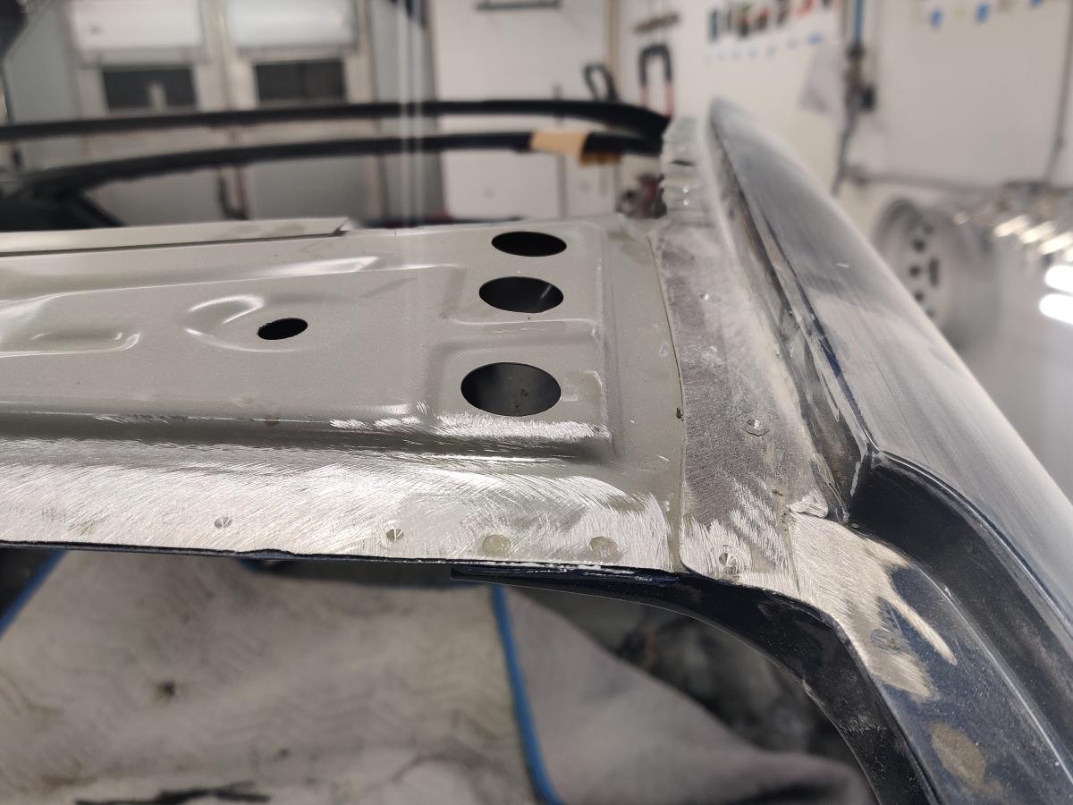

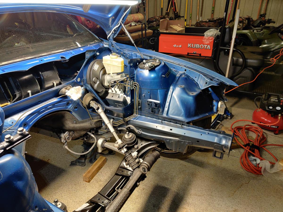

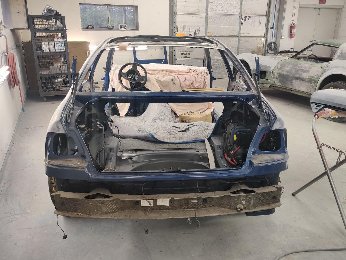

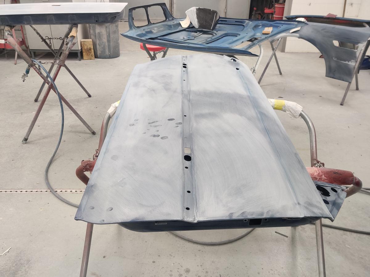

                                And a few in progress shots at the shop.

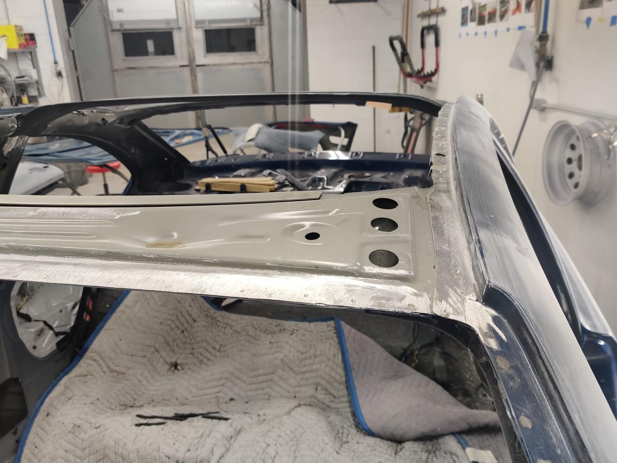

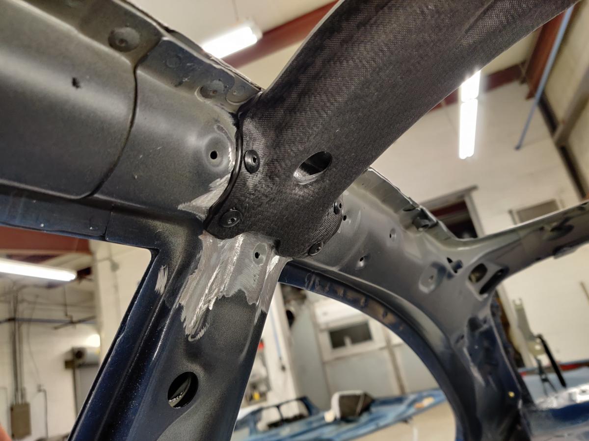

                                Slon Workshop carbon roof bow epoxied and riveted in place. I REALLY wanted to do this myself, but the roof arrived while the car was at the shop and it made sense for them to do it. I didn't want to risk damaging a freshly painted car so...
                                Click image for larger version  Name:	IMG_20220330_081758.jpg Views:	0 Size:	96.2 KB ID:	165452
                                Click image for larger version  Name:	IMG_20220330_081805.jpg Views:	0 Size:	119.2 KB ID:	165453
                                Doug at Vintage Restoration did an amazing job a removing the roof. Hands down, this is better than I would have done. He's a master fabricator and some of the things I saw him do on other customer's vehicles are amazing. Perhaps is best I left this job to the pros.
                                Click image for larger version  Name:	IMG_20220330_082948.jpg Views:	0 Size:	113.5 KB ID:	165455
                                Click image for larger version  Name:	IMG_20220330_082945.jpg Views:	0 Size:	127.5 KB ID:	165459
                                Gotta crack a few eggs to make an omelette.
                                Click image for larger version  Name:	IMG_20220330_083221.jpg Views:	0 Size:	116.0 KB ID:	165458
                                Click image for larger version  Name:	IMG_20220330_081819.jpg Views:	0 Size:	163.9 KB ID:	165456
                                Click image for larger version  Name:	IMG_20220330_083144.jpg Views:	0 Size:	111.2 KB ID:	165457
                                Click image for larger version  Name:	IMG_20220330_083117.jpg Views:	0 Size:	117.9 KB ID:	165460
                                Click image for larger version  Name:	IMG_20220330_083232.jpg Views:	0 Size:	170.5 KB ID:	165461
                                Click image for larger version  Name:	IMG_20220330_082633.jpg Views:	0 Size:	187.2 KB ID:	165462
                                Click image for larger version  Name:	image_34491.jpg Views:	3 Size:	113.5 KB ID:	165454
