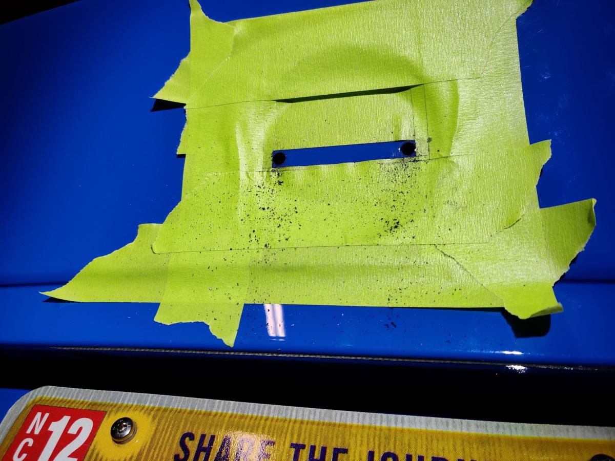

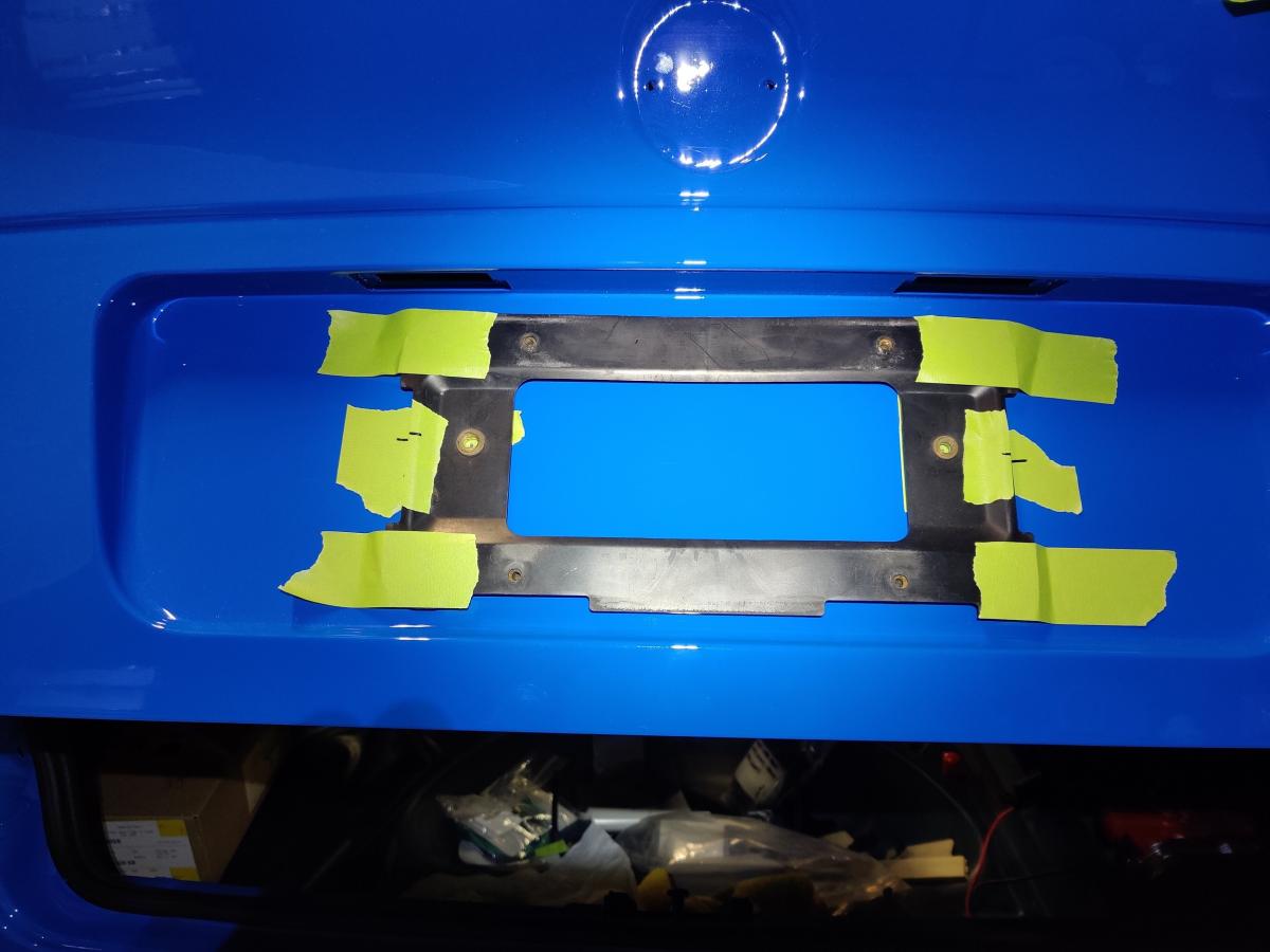

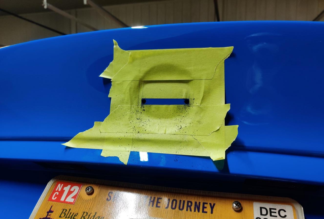

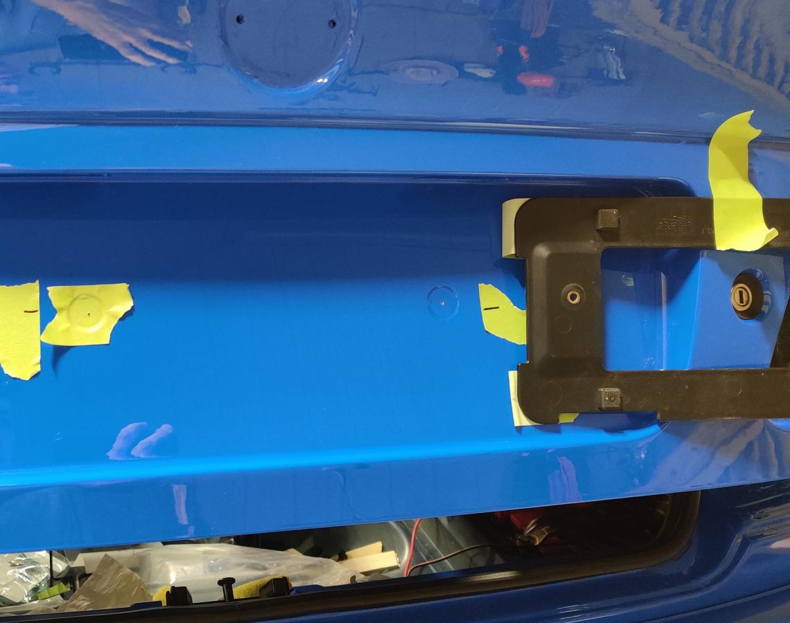

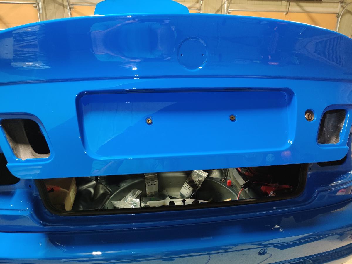

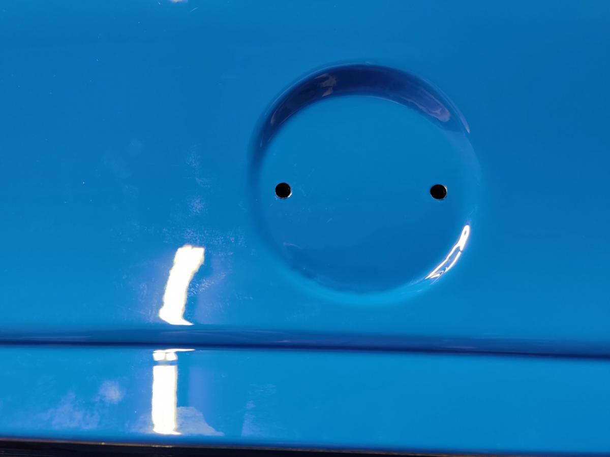

          License plate mounting holes (reposted from above, edited slightly)

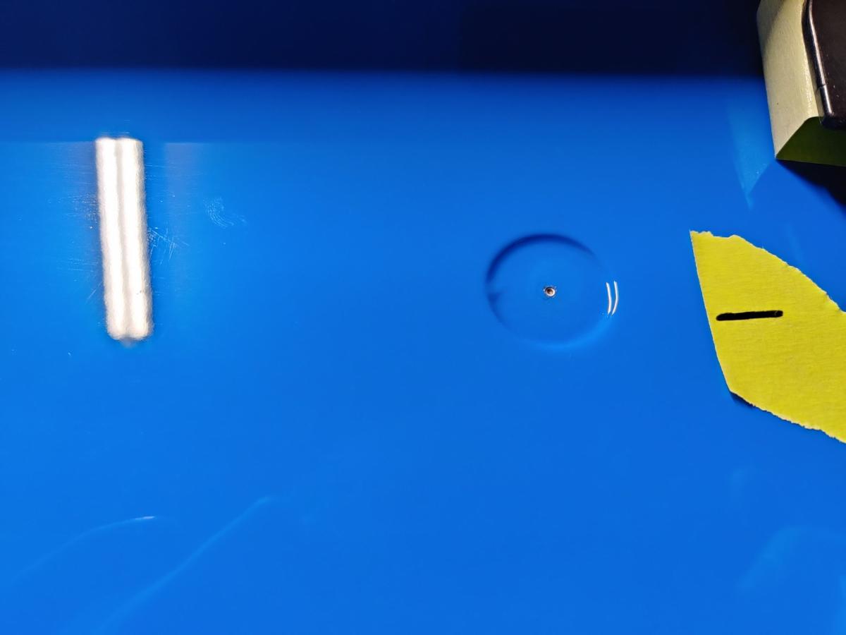

          Drilling out the license plate mount was a bit of a pain. This is a pretty big hole to need to punch through carbon. I don't have a ton of experience drill through the stuff, but know you need to use light pressure so the drill bit doesn't catch and tear through the trunk.
          After marking the hole locations with the old licence plate mount/bracket, I used a center punch to dimple the paint/trunk. I just used my hand a pressed in (did NOT use a hammer). I then took the smallest drill bit I had, and slowly "drilled" into that center-punched dimple by hand. As in, I held the drill bit in my hand and slowly made the initial marks you see below in the 2nd and 3rd pic following this paragraph. After I had a good start, I then switch to an actual drill bit and very slowly with very light pressure, drilled into the trunk...
          Click image for larger version Name:	IMG_20220521_162128.jpg Views:	66 Size:	70.8 KB ID:	173589
          Click image for larger version Name:	IMG_20220521_161930.jpg Views:	65 Size:	86.3 KB ID:	173591
          Click image for larger version Name:	IMG_20220521_161947.jpg Views:	66 Size:	39.0 KB ID:	173590
          Click image for larger version Name:	IMG_20220521_165534.jpg Views:	67 Size:	96.7 KB ID:	173592

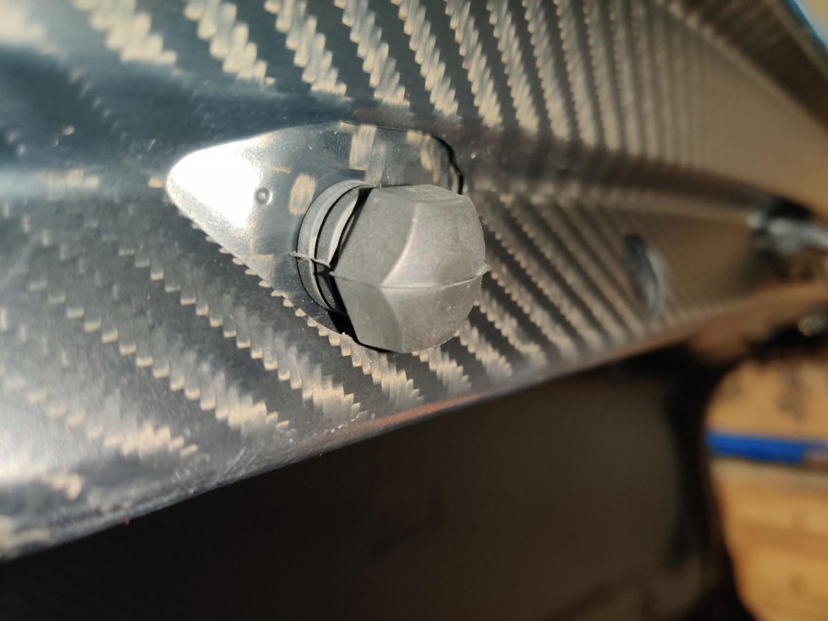

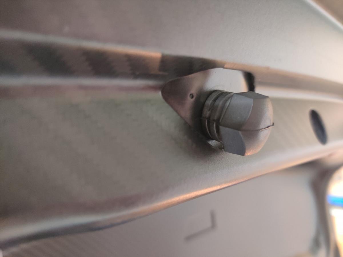

          Rubber trunk bumpers / stoppers
          The factory rubber stoppers (dense rubber - they almost feel like plastic) used on the steel trunk are screwed into the bottom inner-edge of the trunk and prevent it from slamming into the body work. You can adjust the height of the stoppers based on how far in you screw them. While the catch that mounts inside the luggage compartment for the trunk latch prevents the trunk from closing too far in the center, the rubber stoppers on the sides are equally (if not more) important for preventing the trunk from contacting the body. Ask me how I know...
          You can't just transfer the factory stoppers over to the Karbonius trunk, however. The holes in the Karbonius trunk are too narrow for the factory bumpers/stoppers - despite my best efforts, I couldn't screw them into trunk. Don't even try - they won't fit.
          So I measured the ID of the hole, then hit Google for a solution. I found it in a GM bumper that's used on Firebirds, Camaros, etc. It's GM part number 10279121 and here is where I got it:
          https://www.gmpartsdirect.com/oem-pa...umper-10279121
          These are a tight fit, but work perfectly. The shank of the screw is exactly the same OD as the ID of the trunk holes (~18mm). So while it's a bit snug, they fit really well, won't budge due to vibration and look factory.
          Click image for larger version  Name:	IMG_20220626_120625.jpg Views:	25 Size:	51.0 KB ID:	183081
          Click image for larger version  Name:	IMG_20220626_120651.jpg Views:	25 Size:	78.4 KB ID:	183082
          Click image for larger version  Name:	IMG_20220626_120703.jpg Views:	25 Size:	102.7 KB ID:	183083

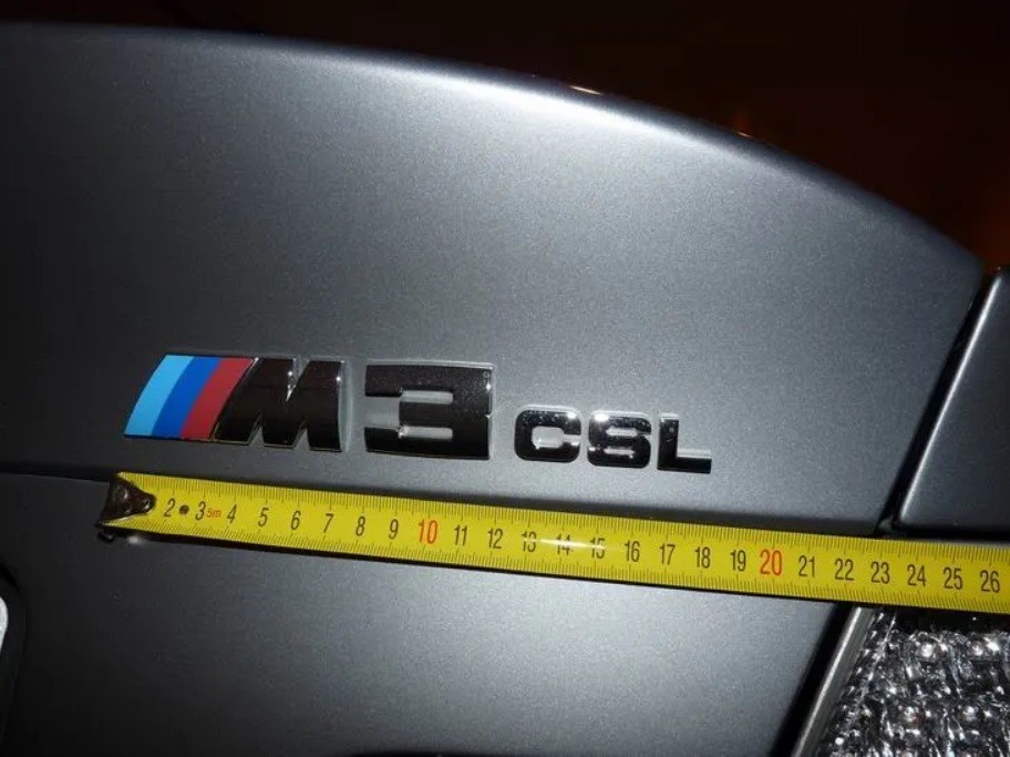

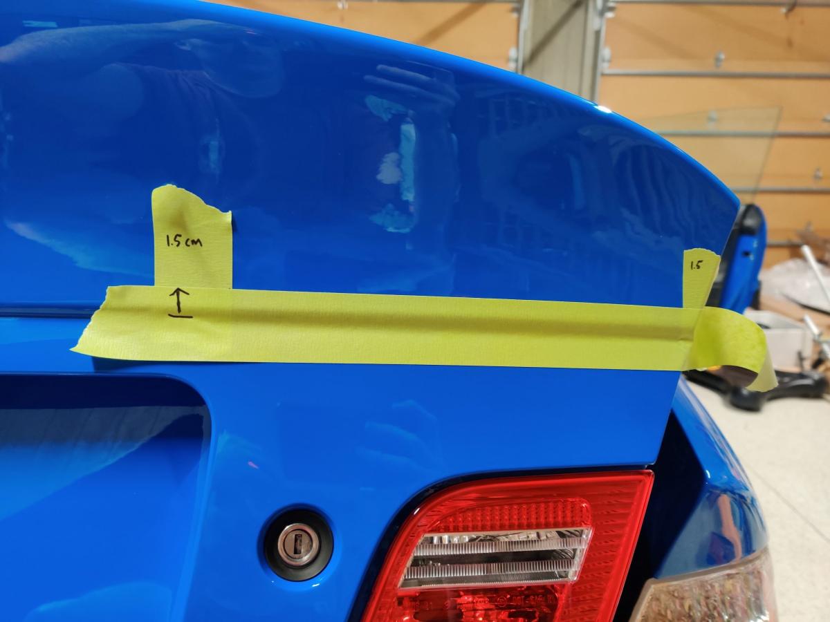

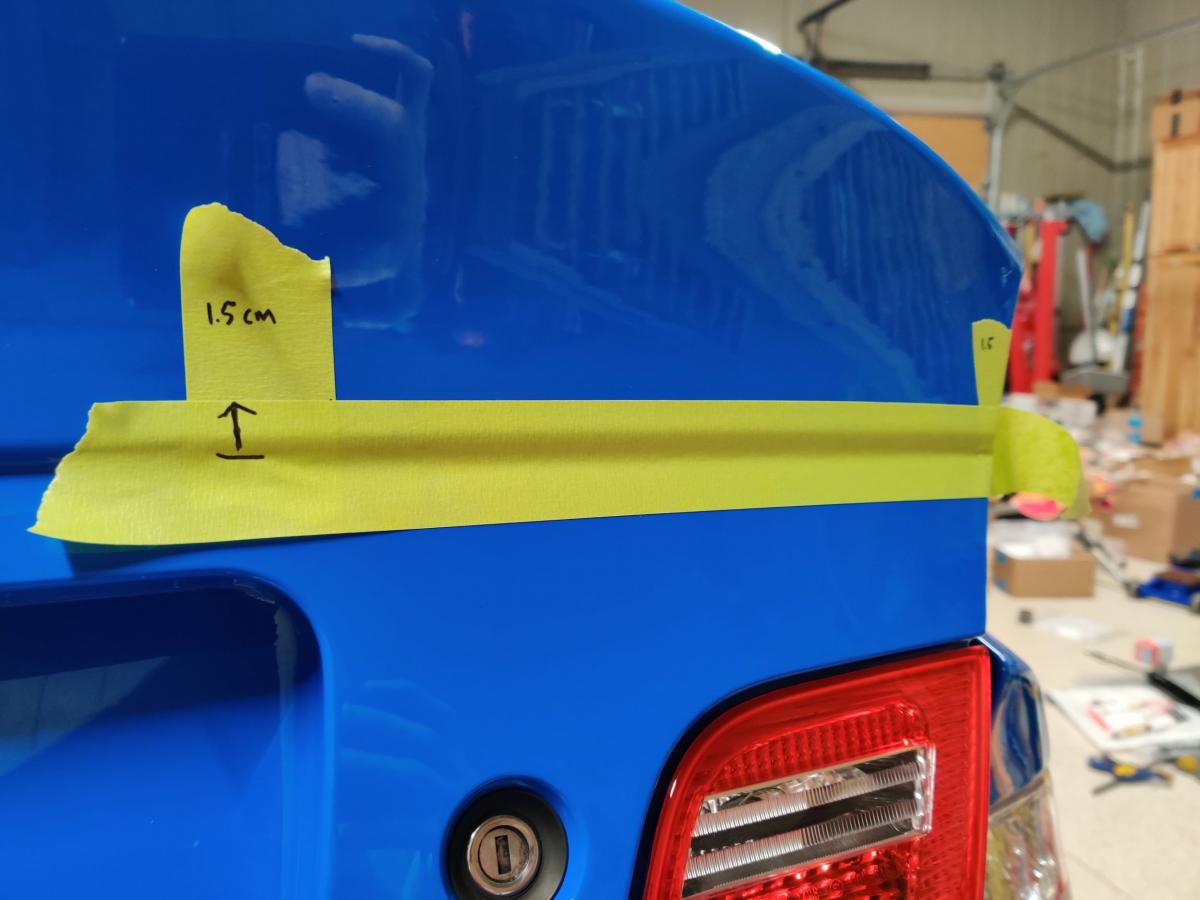

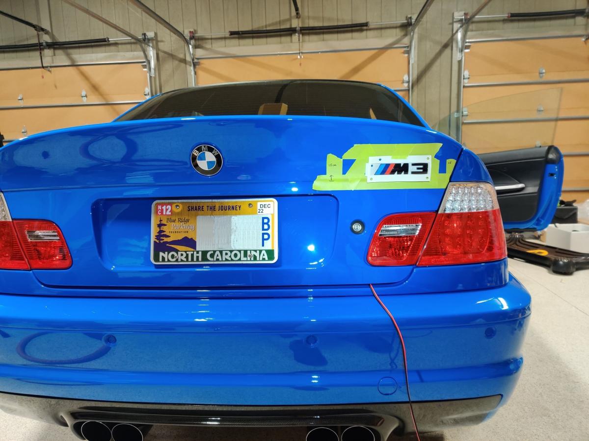

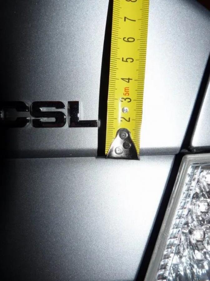

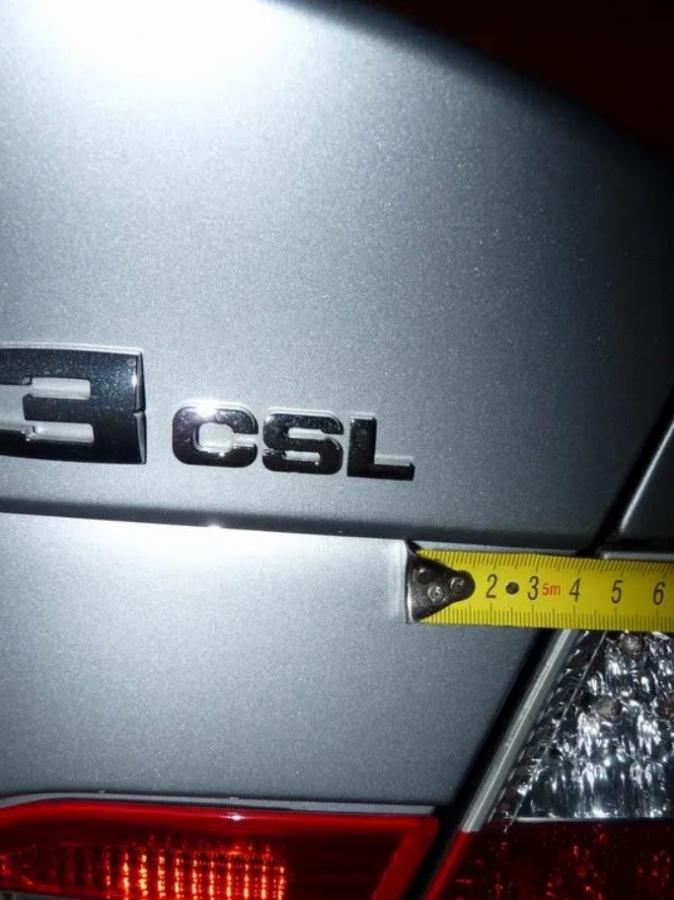

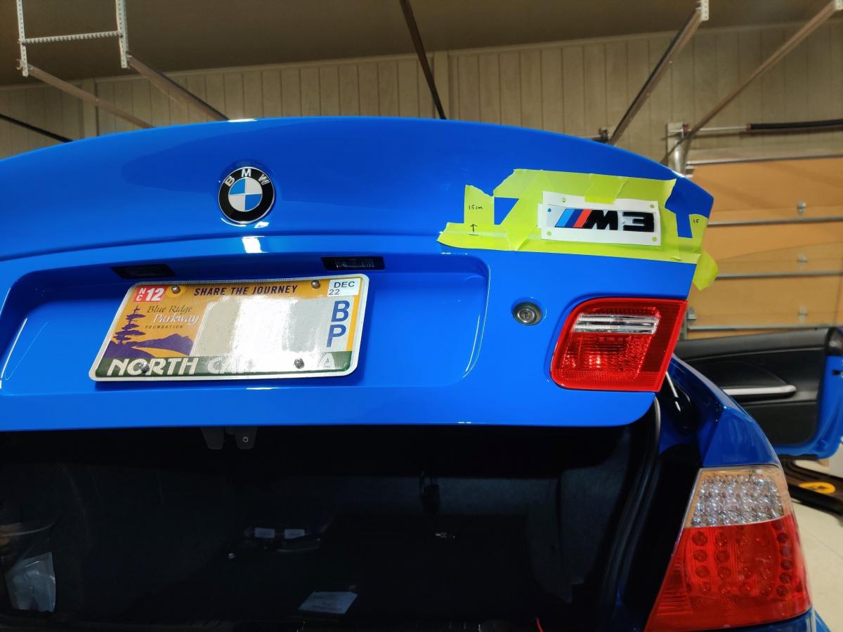

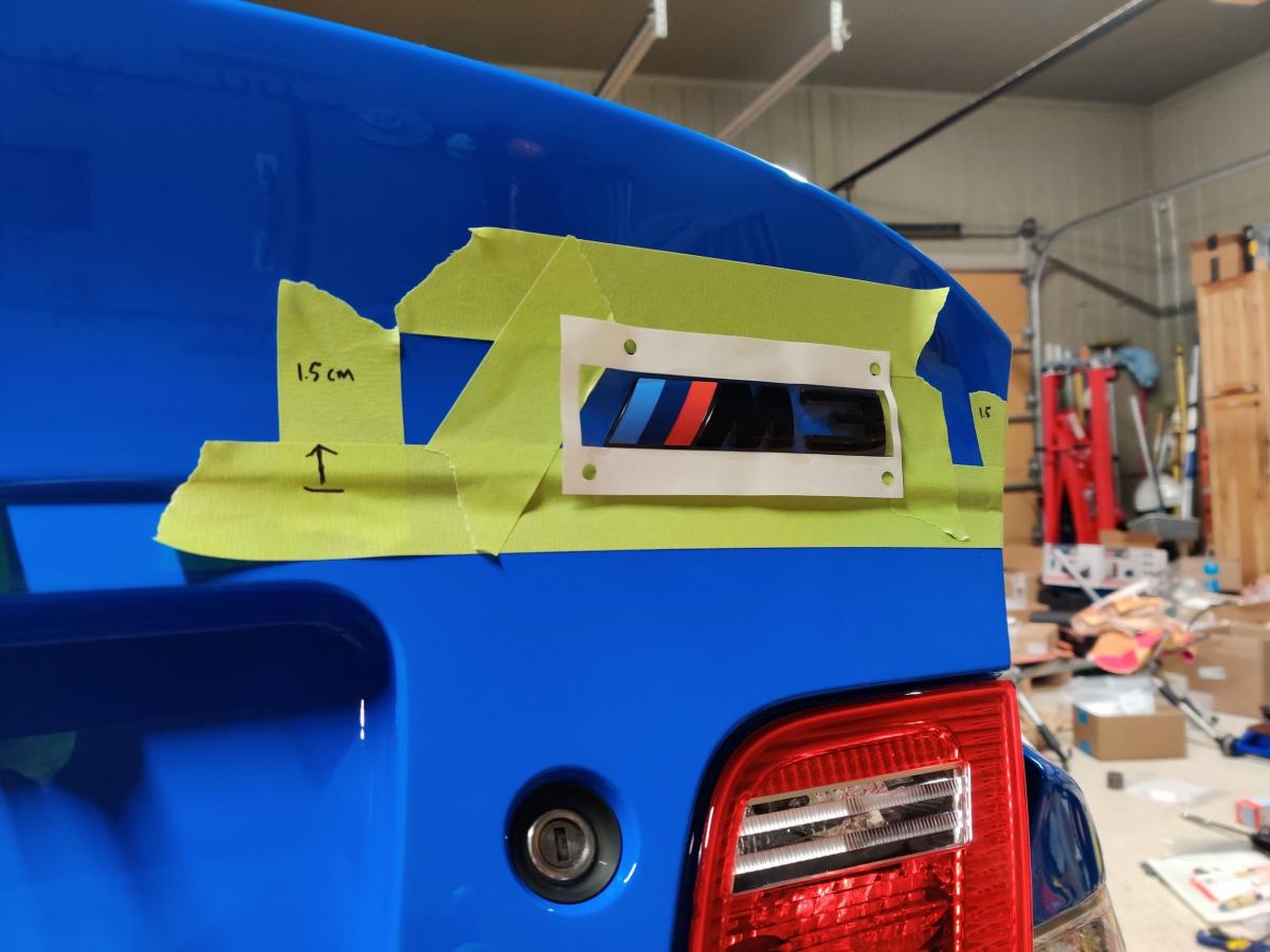

          ///M3 trunk emblem alignment / badge bootlid alignment
          I found a post on CSL Register from the always helpful NZ_M3 where he measured the "M3 CSL" badge on his actual CSL. Go here:
          I wanted the badge in the same general area. However, because the regular M3 badge doesn't have the "CSL" lettering hanging off the end of it, I took this approach.
          • The distance from the bottom edge of the body line in the bootlid is 1.5cm (see pics)
          • The right most measurement is 4.5cm from the trunk edge
          • The left most measurement is ~22.5cm from the trunk edge
          • This puts the centerline of the badge at 13.5cm
          • I used masking tape to make a template of sorts, getting the 1.5cm height from the body line as shown, and also marking the CL at 13.5cm (not shown, bad pics, sorry).
          • I then took the centerline of the my new "M3 only badge" (less the CSL lettering) and mounted it up.
          In my opinion, this approach leaves the perfect amount of negative space, based on other reference points on the trunk - the body line underneath it, the trunk edge, spacing to the inner portion of the trunk, relationship to the brake light and so forth.
          Pics from CSL Register:
          Click image for larger version  Name:	M3 CLS badge 1.jpg Views:	25 Size:	163.8 KB ID:	183087
          Click image for larger version  Name:	M3 CLS badge 3.jpg Views:	25 Size:	113.0 KB ID:	183088
          Click image for larger version  Name:	M3 CLS badge 2.jpg Views:	25 Size:	74.3 KB ID:	183089
          Click image for larger version  Name:	M3 CLS badge 4.jpg Views:	25 Size:	68.2 KB ID:	183090
          Where I put the M3 badge:
          Click image for larger version  Name:	IMG_20220605_155034.jpg Views:	25 Size:	80.4 KB ID:	183091
          Click image for larger version  Name:	IMG_20220605_155044.jpg Views:	25 Size:	75.2 KB ID:	183092
          Click image for larger version  Name:	IMG_20220605_155524.jpg Views:	25 Size:	126.7 KB ID:	183097

                      thats pretty slick with the bump stops you used. Looks factory!
                          Took a while to find those bump stops for the trunk but they work perfectly! Hope others can benefit from it.

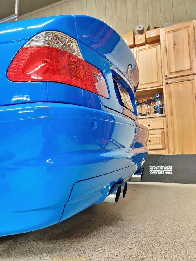

                              Dropping off the Burkhart Engineering / a.k.a. HappyBuyItNow eBay CSL-clone diffuser off at Vintage Restoration today. They are going to paint it up CSL style.
                              In the meantime, I put the stock diffuser back on. Doesn't look too bad! With the Karbonius CSL trunk, I expected not to like it but I really don't mind it at all.
                              Also, the stock diffuser went on with ease - it just pops in place. Really makes me wish I bought a higher quality diffuser... which to be fair, I thought I was getting with the Burkart Engineering piece. See this thread. Their white-labeled eBay diffuser fits and is good enough, but it takes some finessing to get it "just so". The stock piece just pops in place and it's perfectly aligned. Done.

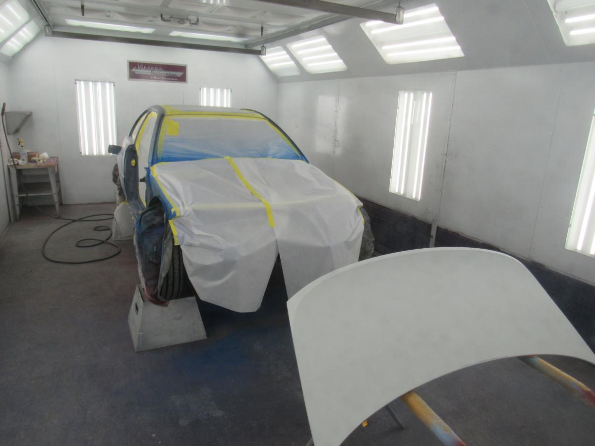

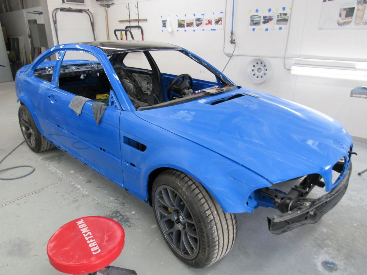

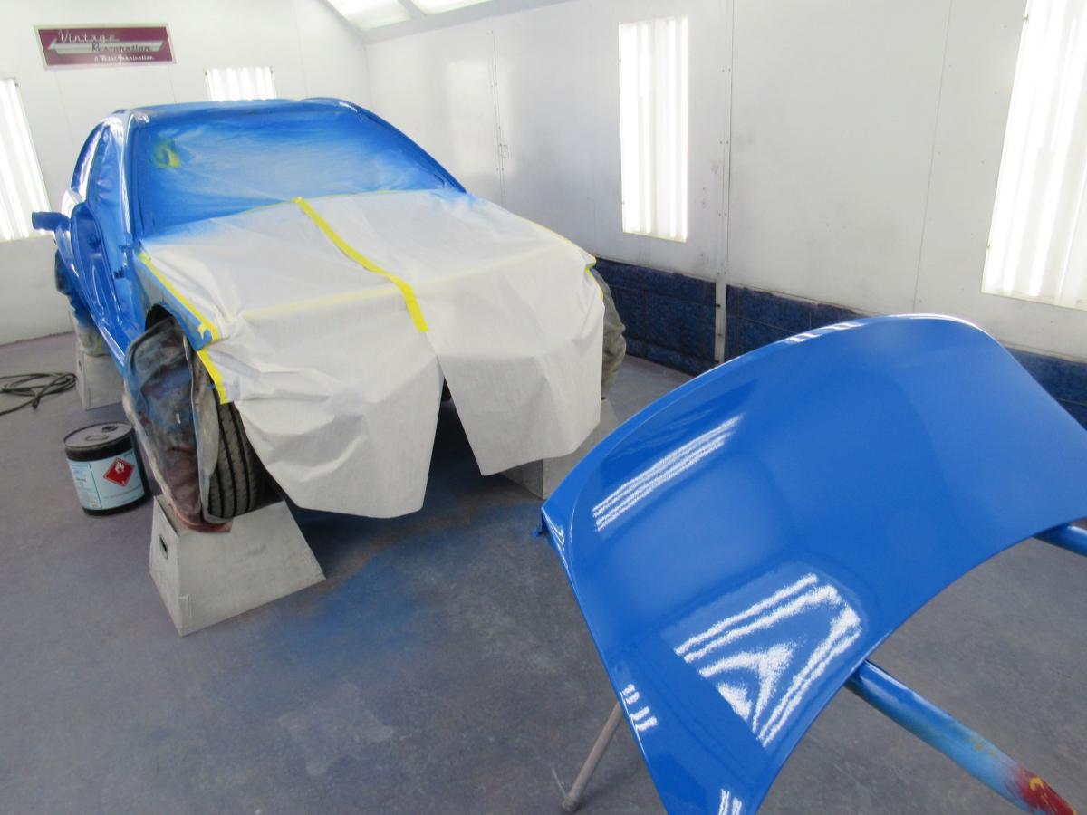

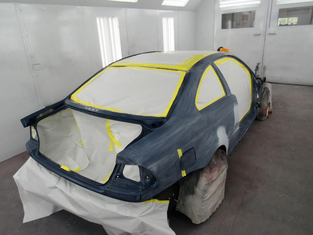

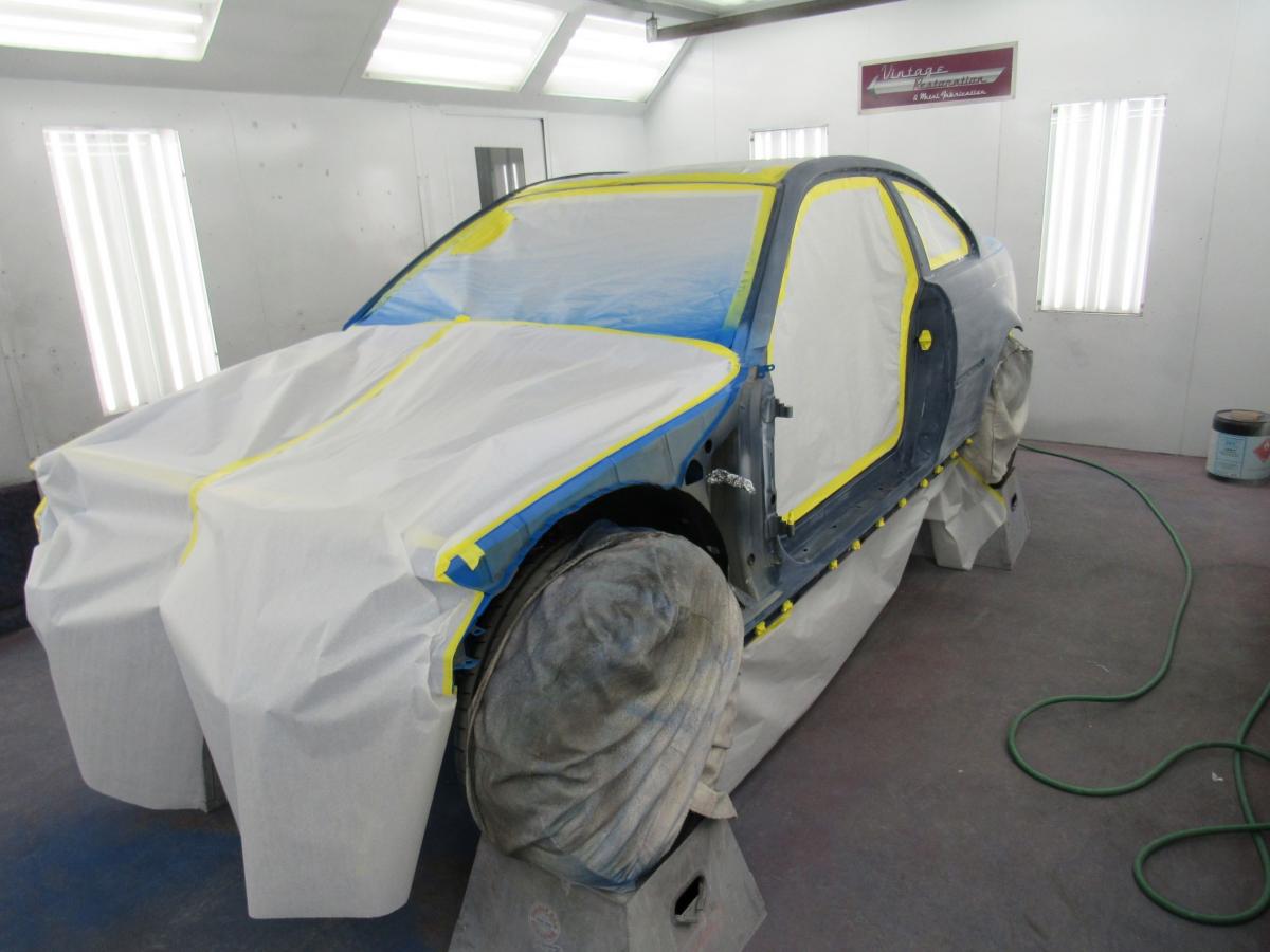

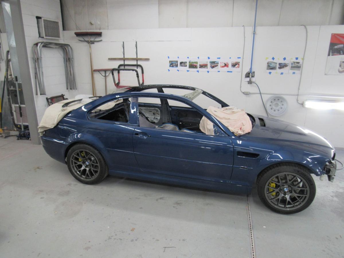

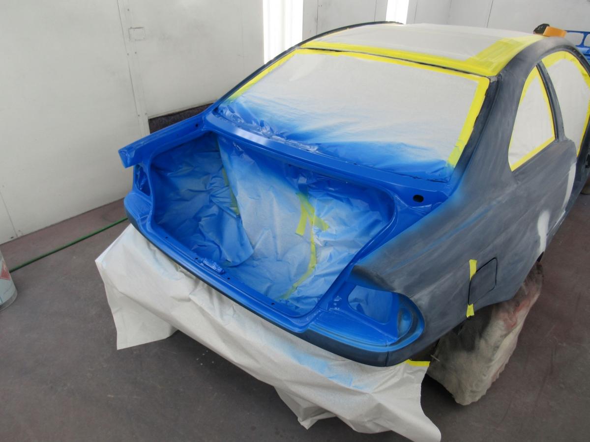

                              Build thread: Topaz Blue to Shark Blue

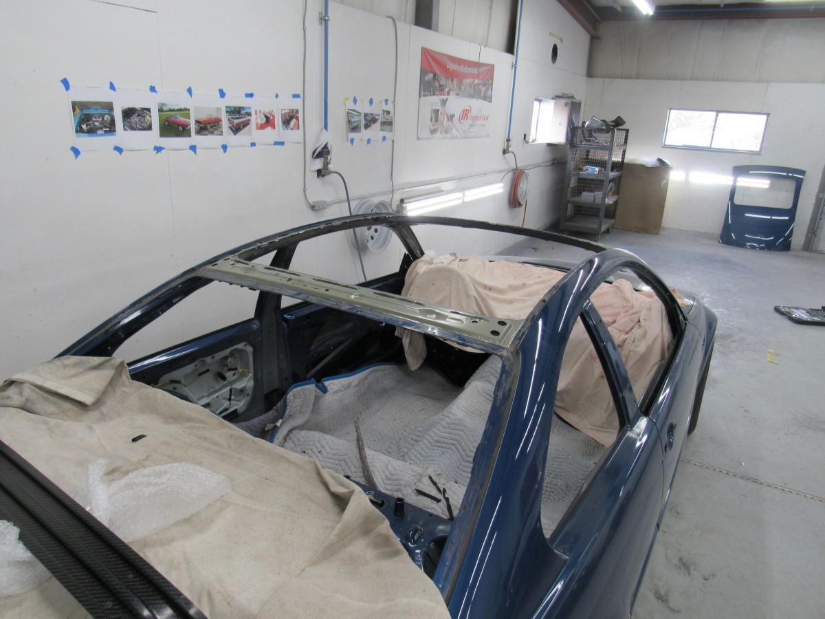

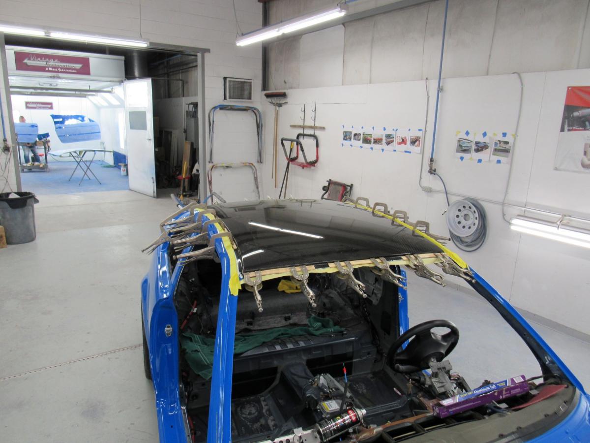

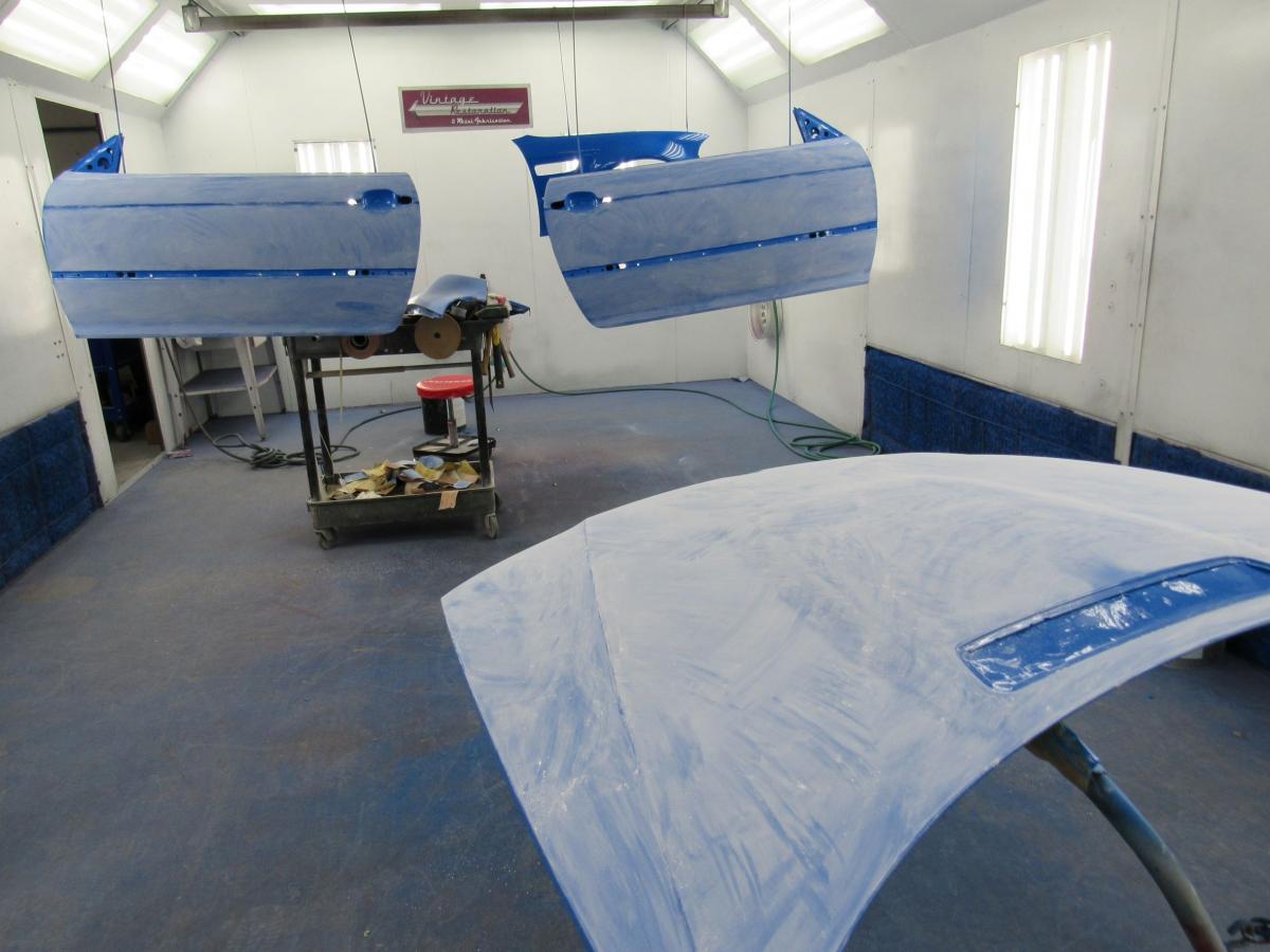

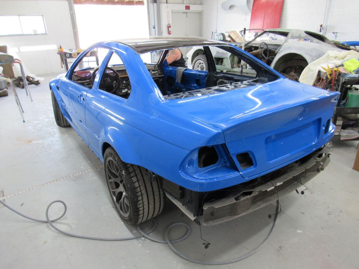

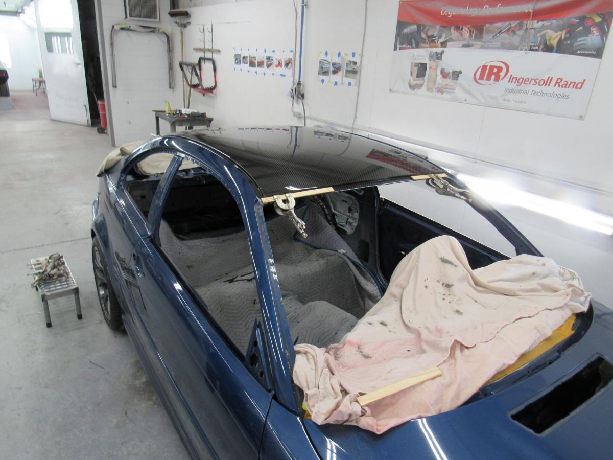

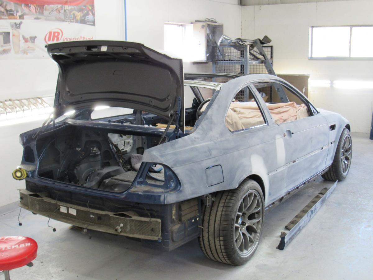

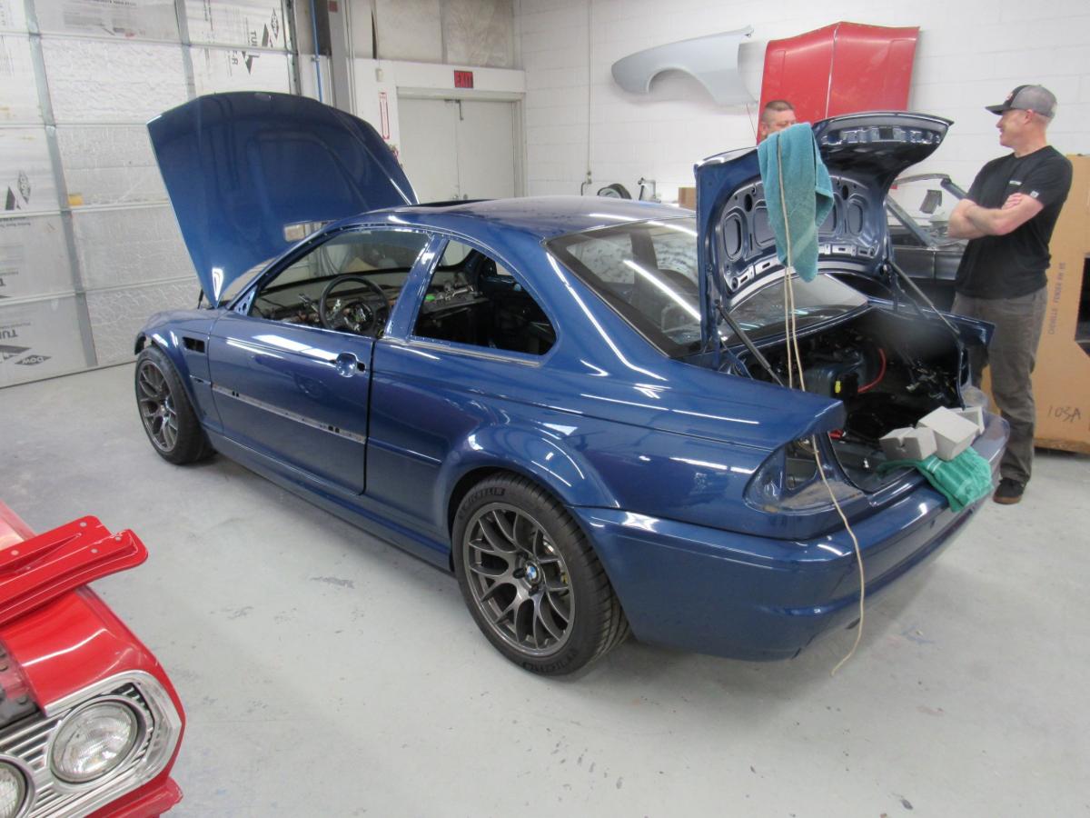

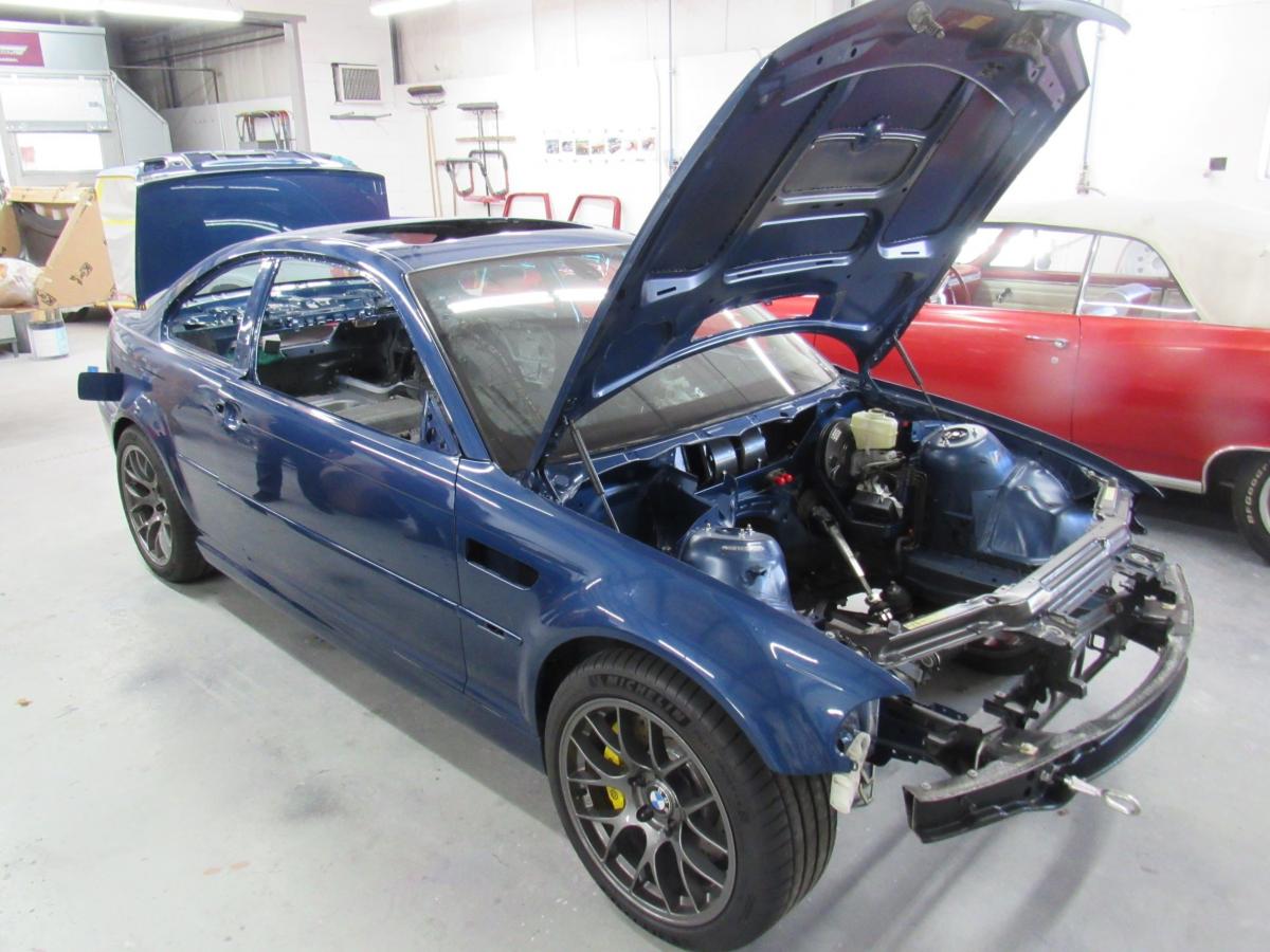

                                In the prior post, I finally got around to dropping off the diffuser at Vintage Restoration for them to paint it. While there, they gave me a thumb drive with some in-progress pics. The quality of the photos aren't the best but neither are mine. For completeness sake, I wanted to post some of them here.
                                The day I rolled the car into the shop:

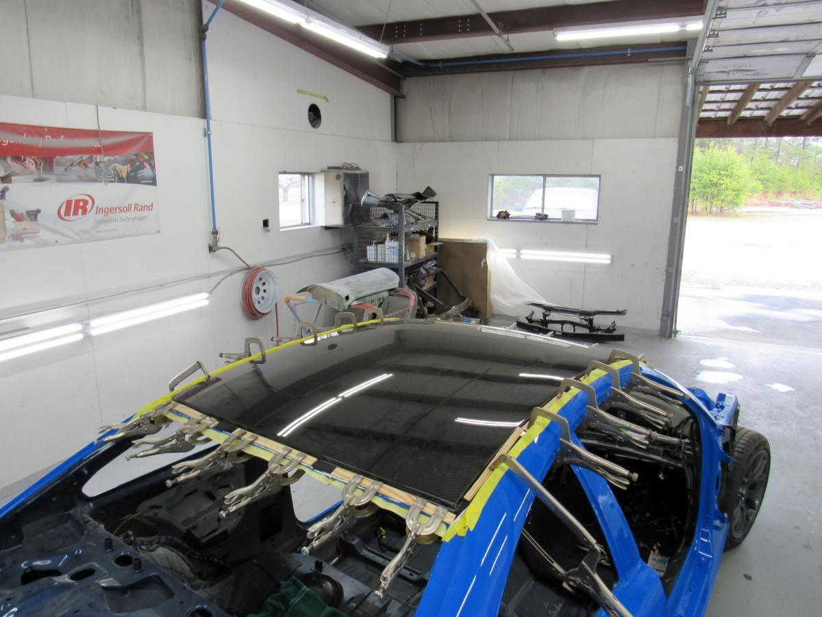

                                Roof cut out:

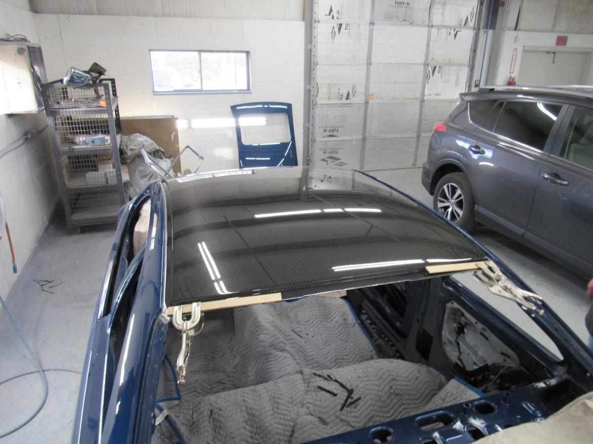

                                Test fitting the carbon roof before any paint or body work began:

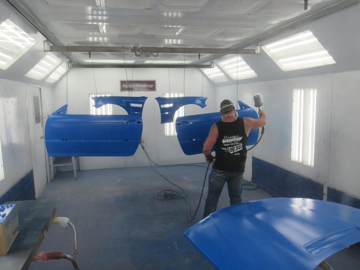

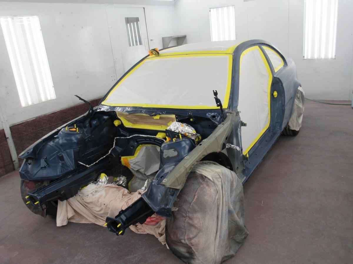

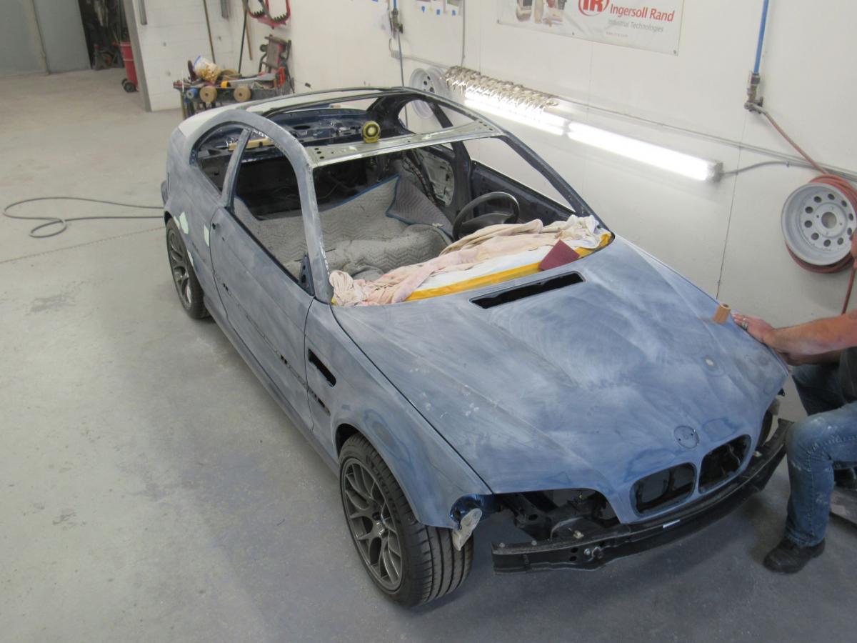

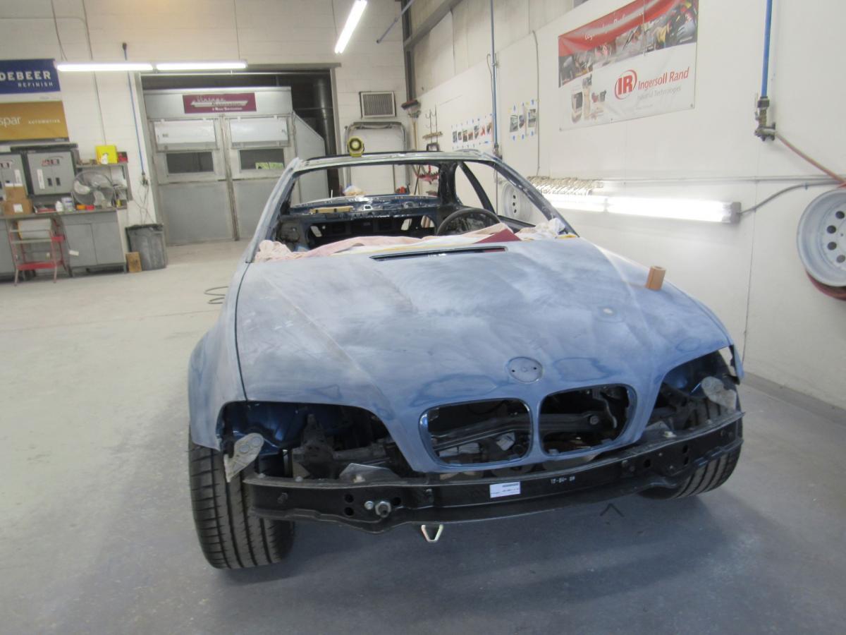

                                Sanding and prep. The car was very straight - with the exception of a couple of door dings from the previous owners, there was very little bodywork needed. They PDR'ed the dents as much as possible to use the least about of filler/Bondo as possible.

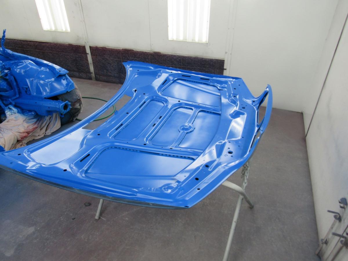

                                In the engine bay and the trunk recess, I went with a satin clear to match the factory look and feel. I debated clearing these pretty heavily (less work for the shop) but ultimately landed on keeping it as factory as possible. I'm glad I did - with the matte carbon Karbonius intake, satin just looks correct, IMO.
                                Reverse taping:
                                After applying the base color coats. The hood (bonnet) and hood hinges are satin too:
                                Satin under the hood:
                                And now taping off the satin for the exterior body panels that are gloss, and shooting the Sharking MF Blue:

                                Gluing up the carbon roof:

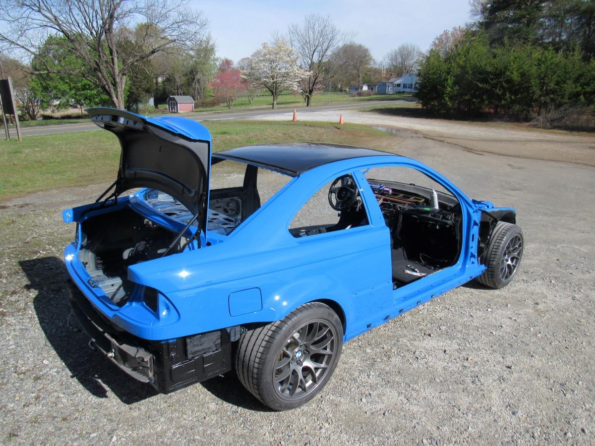

                                After wet sanding and another coat of a paint or clear - I'm not sure what stage this is exactly. I know they wet sanded the car multiple times in between base coats and then finally after all clear coats:

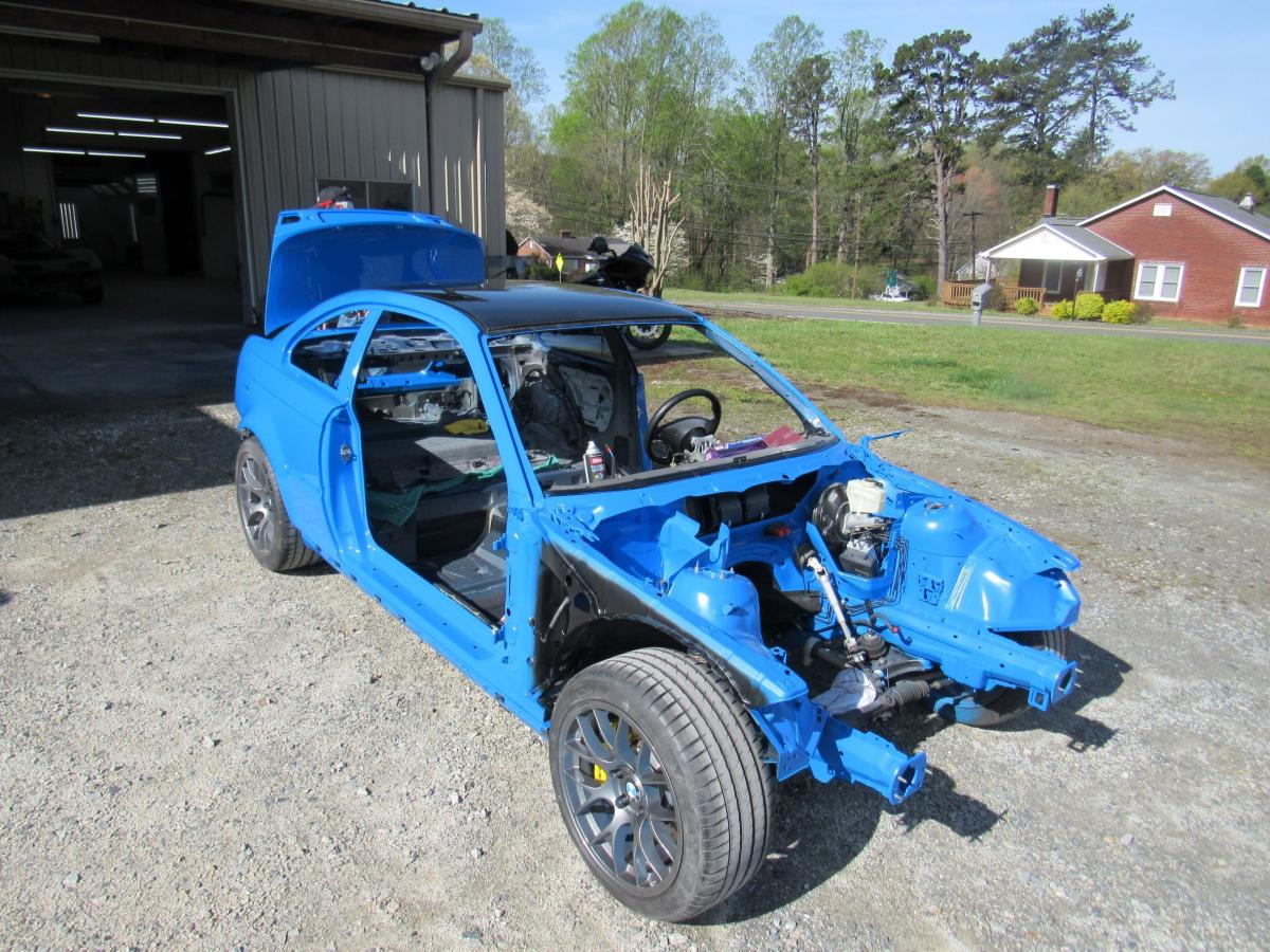

                                Rolling the car out in the sun to help cure the paint. I believe this was during some of the in between wet sanding stages based on the file dates of these pics:
