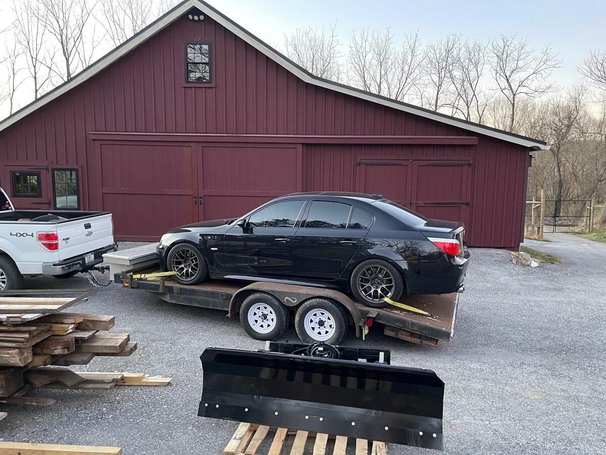

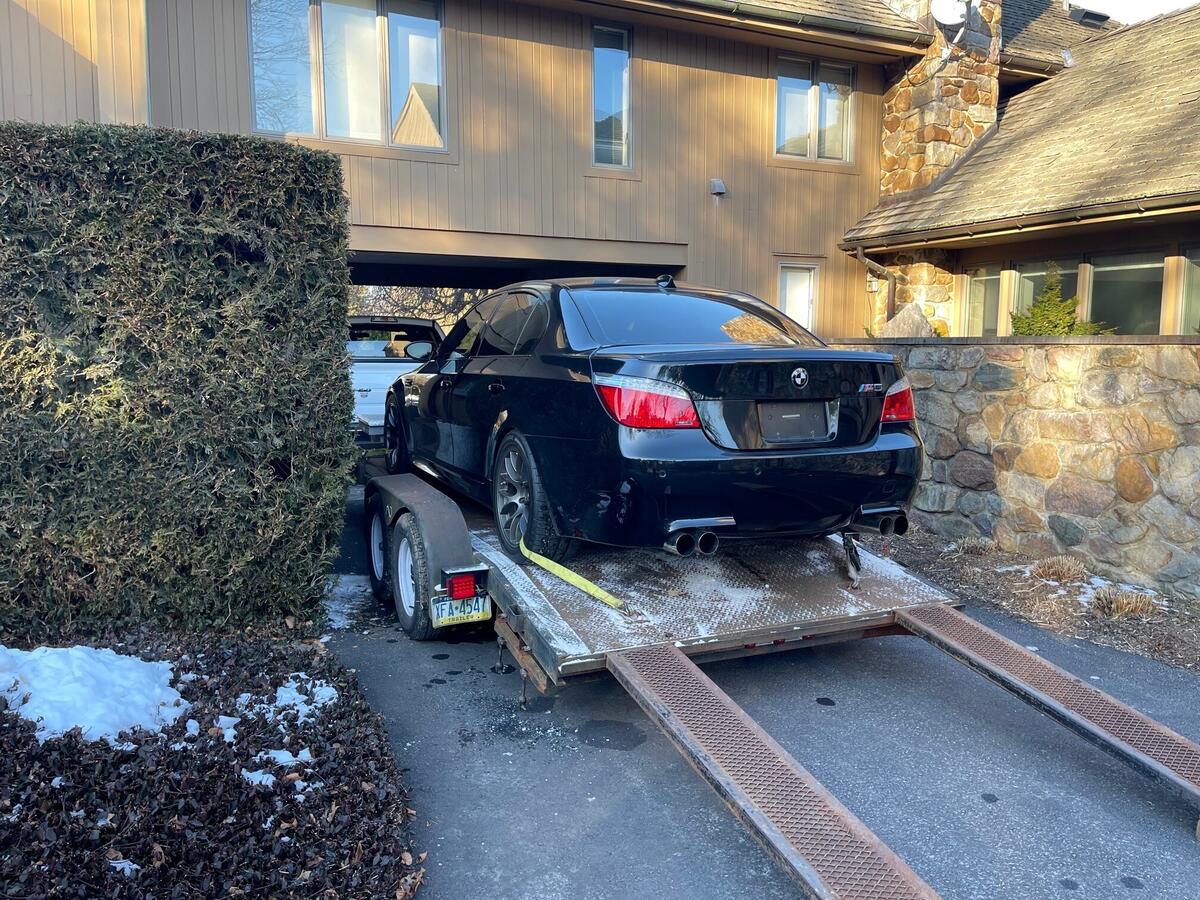

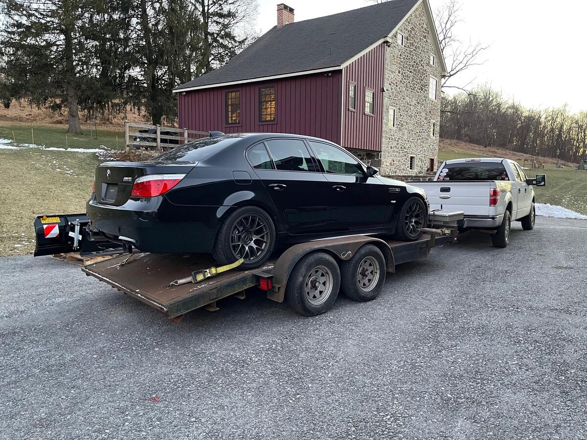

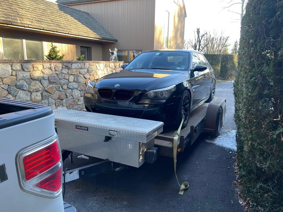

    Pictures at pickup and when I got it home:

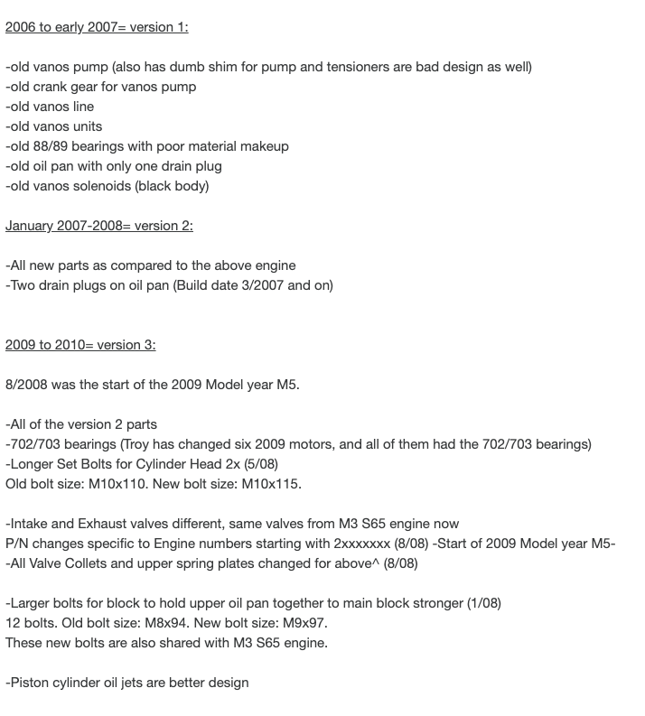

                  I feeling hopeful that maybe the S85's reliability reputation has more to do with the earlier versions than the later versions. I had no idea how many production cycle updates they had for it, most of which were in place by 2008. Of those that aren't the big ones will be addressed during the rod bearing job (bearing update and oil squirter update).
                  Most of the other stuff in the final update seems like it was to create more part sharing between s65 and s85, so hopefully that was more for consolidating costs than actual improvement :P

                    From 2008 on you have the 'good enough' version
