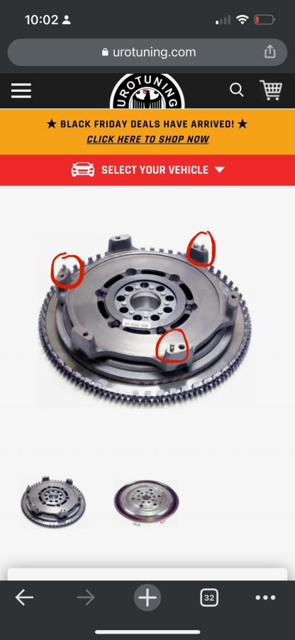

    Interesting, we've done the S85 (OE) and S65 (SPEC) kits, but not an OE S65. Seems people do the S65 often, curious to hear your issues.
    Did you buy a BMW flywheel and an LuK S85 kit or all BMW?
    There were 3 dowel pins on the M3 flywheel that did not line up with the M5 pressure plate.
    (all OE(M) parts)

      There were 3 dowel pins on the M3 flywheel that did not line up with the M5 pressure plate.(all OE(M) parts)
      Ahh that makes sense, did y'all not try the S65 clutch and pressure plate or just switch over to the S85 flywheel at that point?
        At that point, didn't see any reason to screw around with it and just went all S85 parts.
