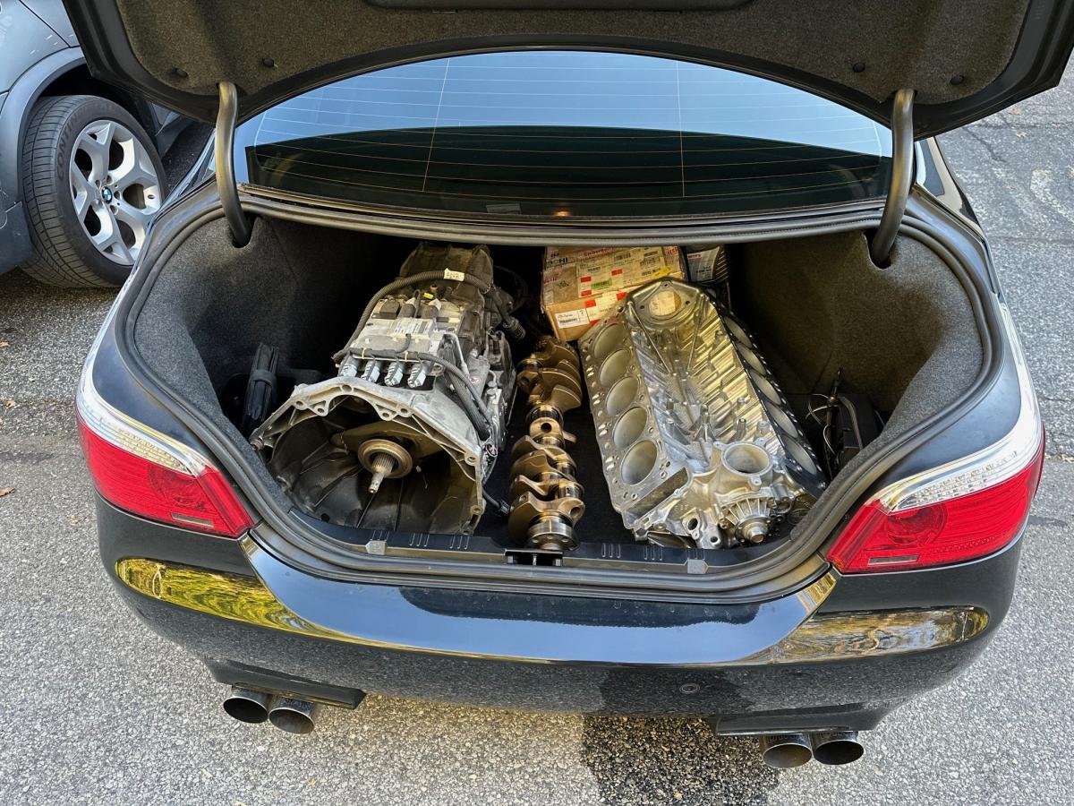

          And a few parts leftover, you know, standard e60 M5 spares to keep in the trunk:
          Damn, spun bearing took out the block too? Did it lock up and mess up the cylinder walls? Or was it some other failure mode?
            #65
            screwed up cylinder wall.
            Need to find something fun to do with it and/or the crank, for the house/garage.

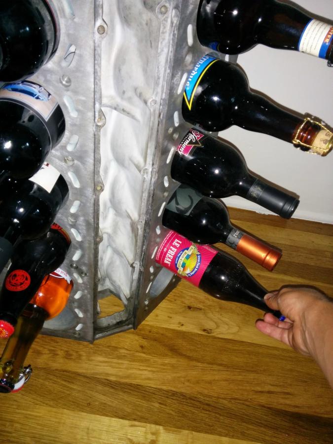

                    Engine blocks make great wine/beer racks, just put a piece of glass on top
                    Click image for larger version  Name:	IMG_20140824_185253.jpg Views:	0 Size:	86.3 KB ID:	239665
