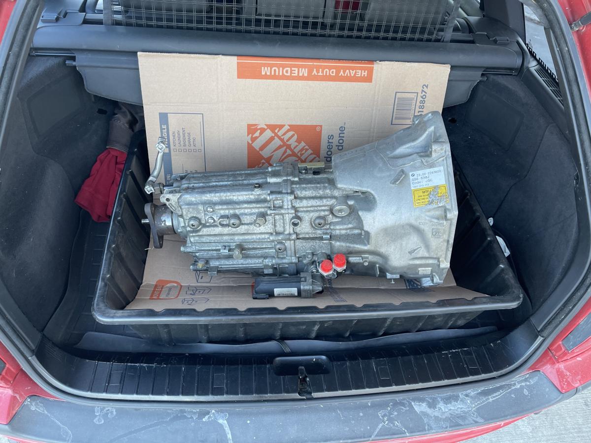

            Welllllll....
            Just ordered the parts to manual swap it.

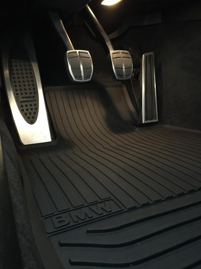

                  Picked up the most important part today:

                    Welcome to the club! My 07 has 85k miles on the clock when I bought it and I refused to drive it until I replaced the rod bearings. It’s fun to drive but doesn’t have the raw power feel that the E46 M3 has. I actually prefer it though for daily driving. I’m sure you’ve seen them already, but if not make sure you check out sretens YouTube series on the E60.

                      E9X M3 gearbox? Will you be doing a DIY thread?

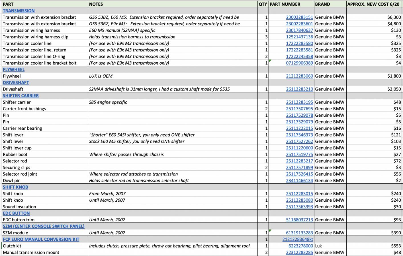

                        Just made the biggest parts order of my life.

                          Since you are making it rain at the dealer, add some stainless steel pedals to finish it of.

                            I may have set enough money on fire for one day :P
                              Sigh.
                              Driveshaft is NLA. LUK flywheel is out of stock with no estimate of when it'll be back.
                              I chose the wrong pandemic to 6mt swap an e60 M5.
                              (custom driveshaft and OE BMW flywheel it is)
                                So it's about 5k to manual swap it depending on the cost of the trans used?
                                Considering E60 M5's are still like $5.99 for SMG ones, that's a damn bargain.
